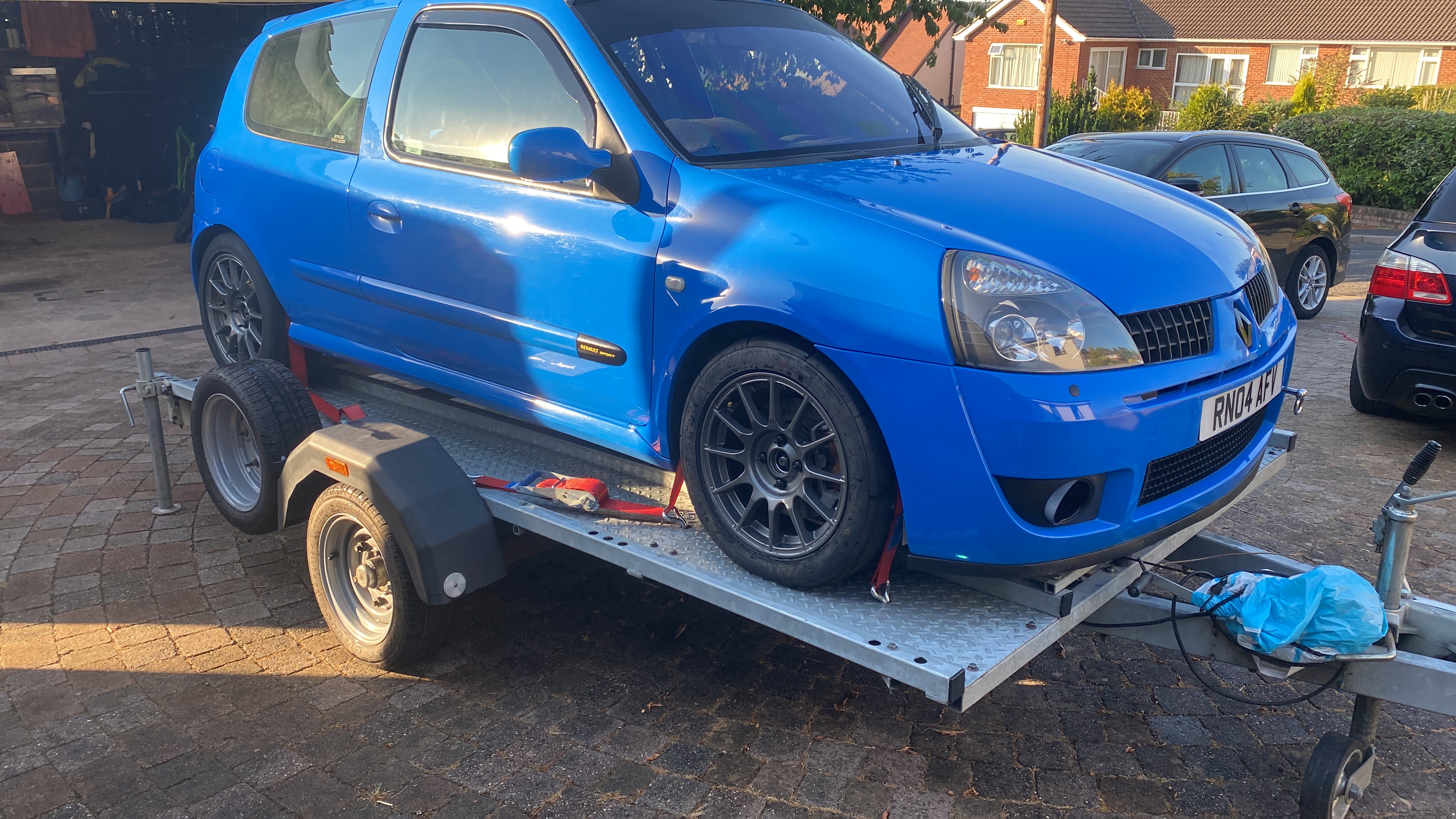

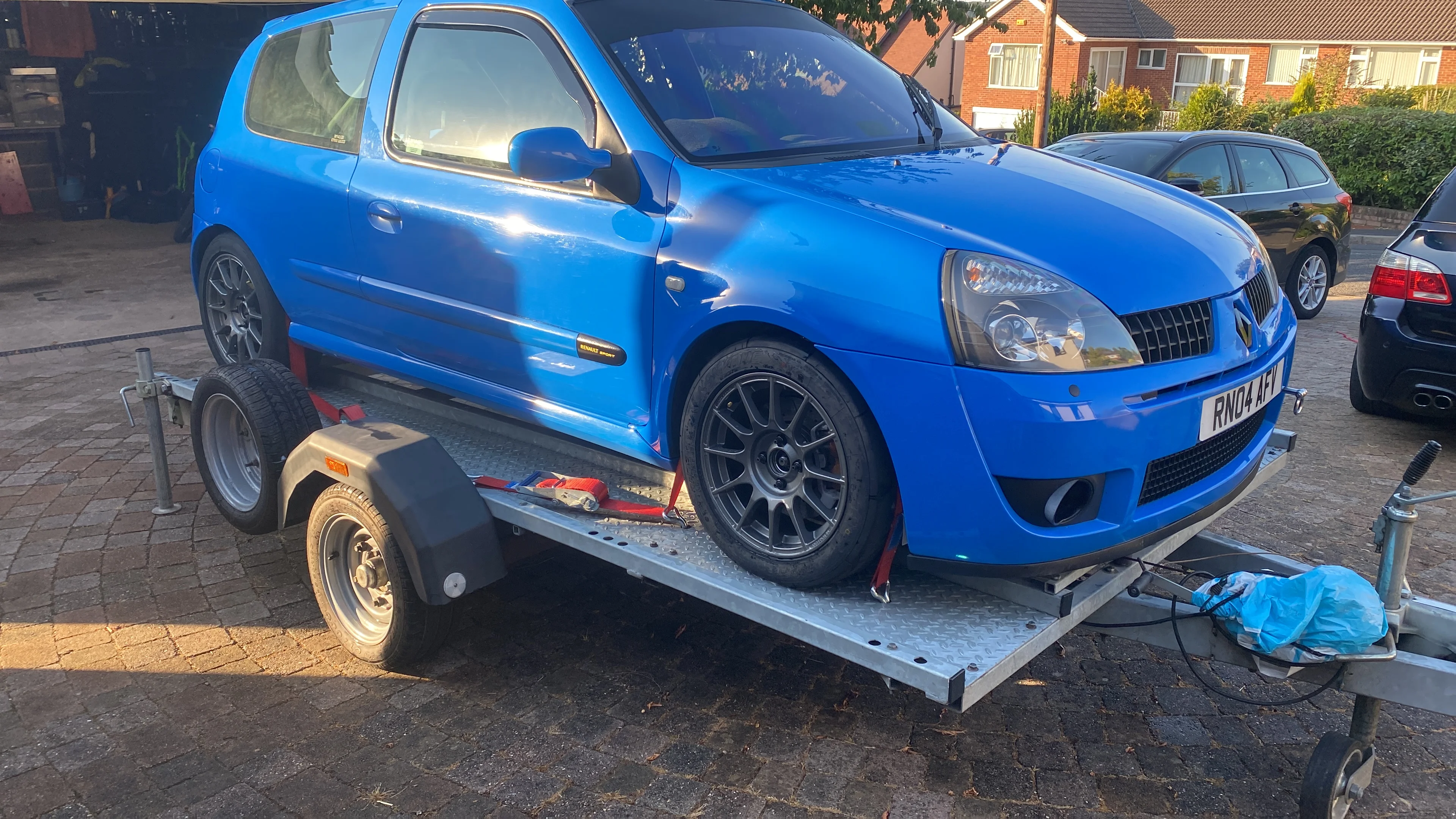

Really good, i do the geos myself as I have on the Lotus platform, and it was easy to setup.
I’m running 2.6 camber on the front but think it needs 3.
It needs a diff really but I’m not spending that cash!
What are you running?
