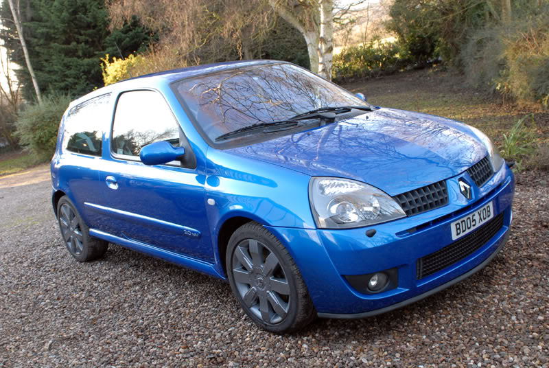

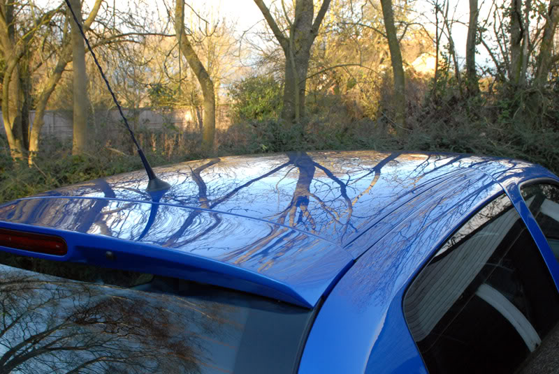

Finished both claying and polishing. Tbh, I didnt notice the car looking 'worse' after claying. The bar did look quite dirty at the end though, and there were quite a few noticeable spots and other bits of crap that it took off too :D
A few pics after polishing :)
The only thing that looks naff is the tyres :(
