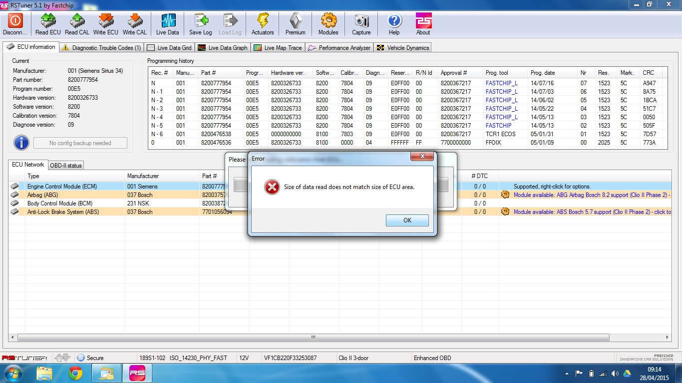

I used to own a Trophy and remapped that with the RS Tuner to the 98 ron map. I wanted to do the same for my car. I've removed the intake, refitted CAT and exhaust centre section and it smells like it's running rich.
The error I'm getting is
I am thinking the ECU is locked and cannot be remapped?
Henk has sent me the OEM map but I can't upload it.
Any ideas?

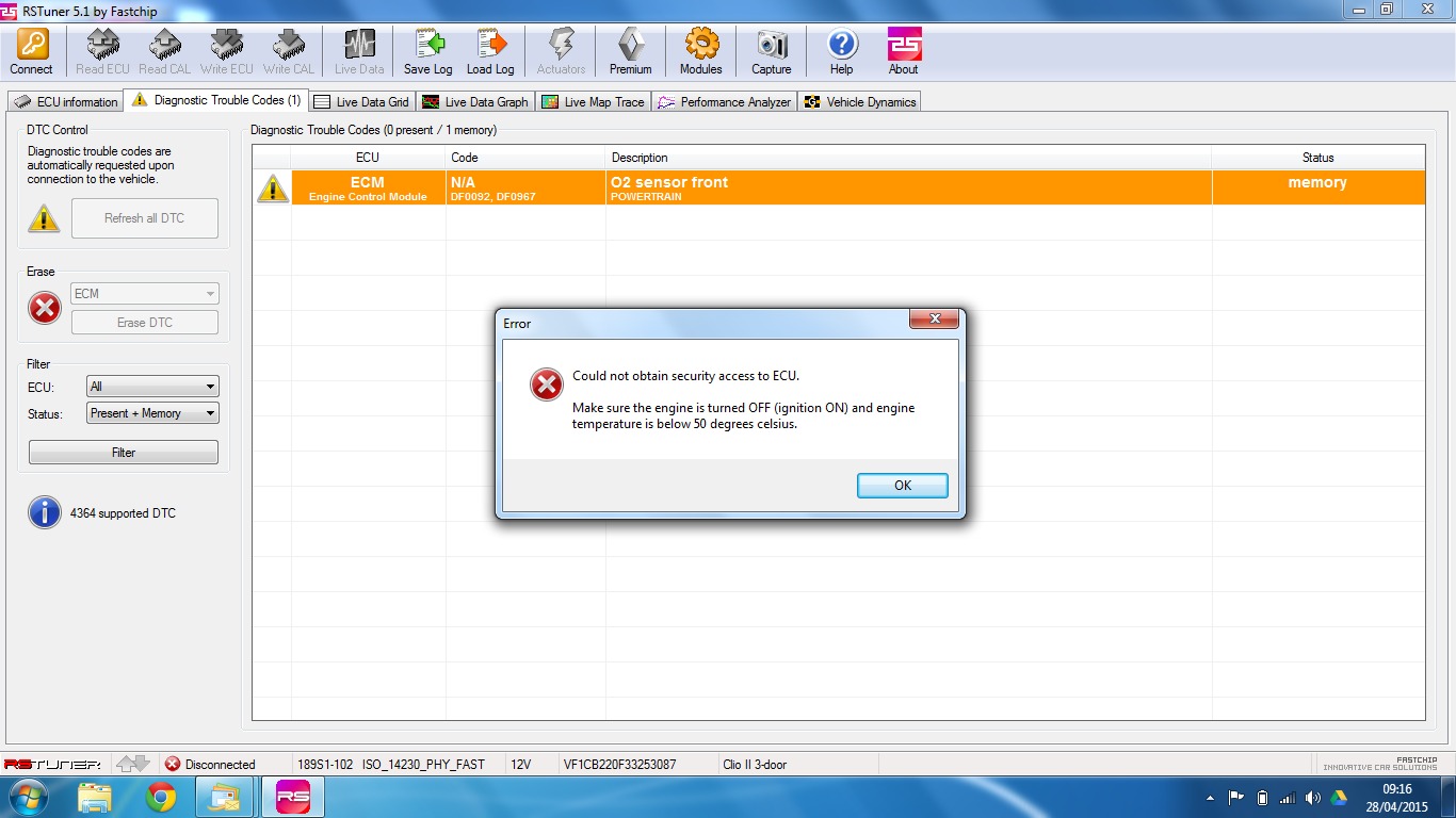

its got the rs tuner remap already on it matey,running rich could be the front lambda sensor causing that
  Clio 182
I have a replacement lambda to fit. However after putting the car back in the light went off and has stayed off. I'm wondering if it actually needs it now?

I've had another go installing the OEM map (provided by Henk) and it's taken it. However it was already tuned with the standard map. I think I already have the 98 Ron map which looks to have already been installed in the past on the ECU.
