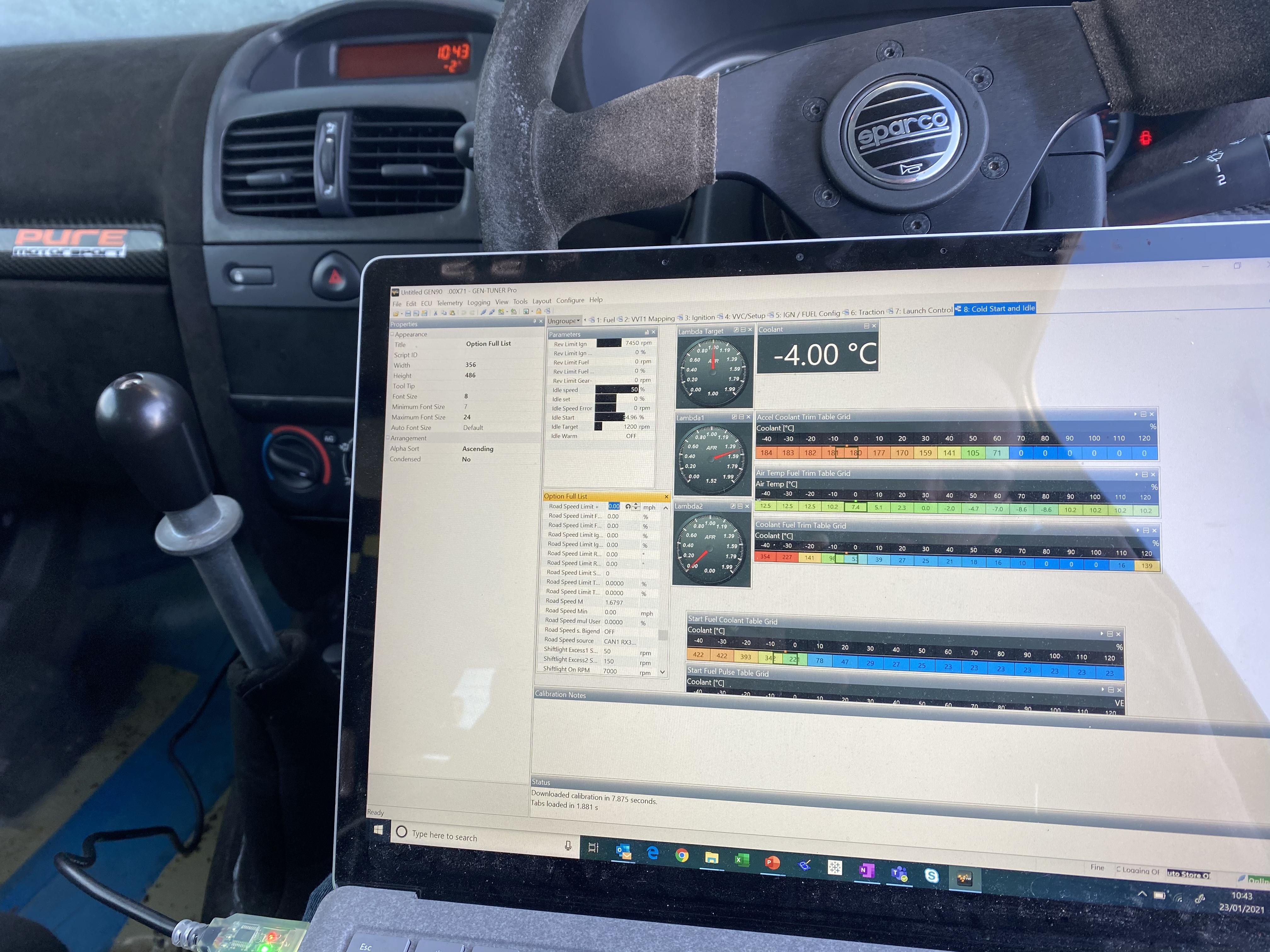

Some pics for a word heavy thread.

Thanks for sharing David.
I've also been playing with the cold start map. I'll share my setting and specs for comparison. (yours are probably better)
I thought I had it nailed. Then reminded myself it's around 8 degrees here this week. Where as last week it was around - 1. So I think I'll have to revisit this one.

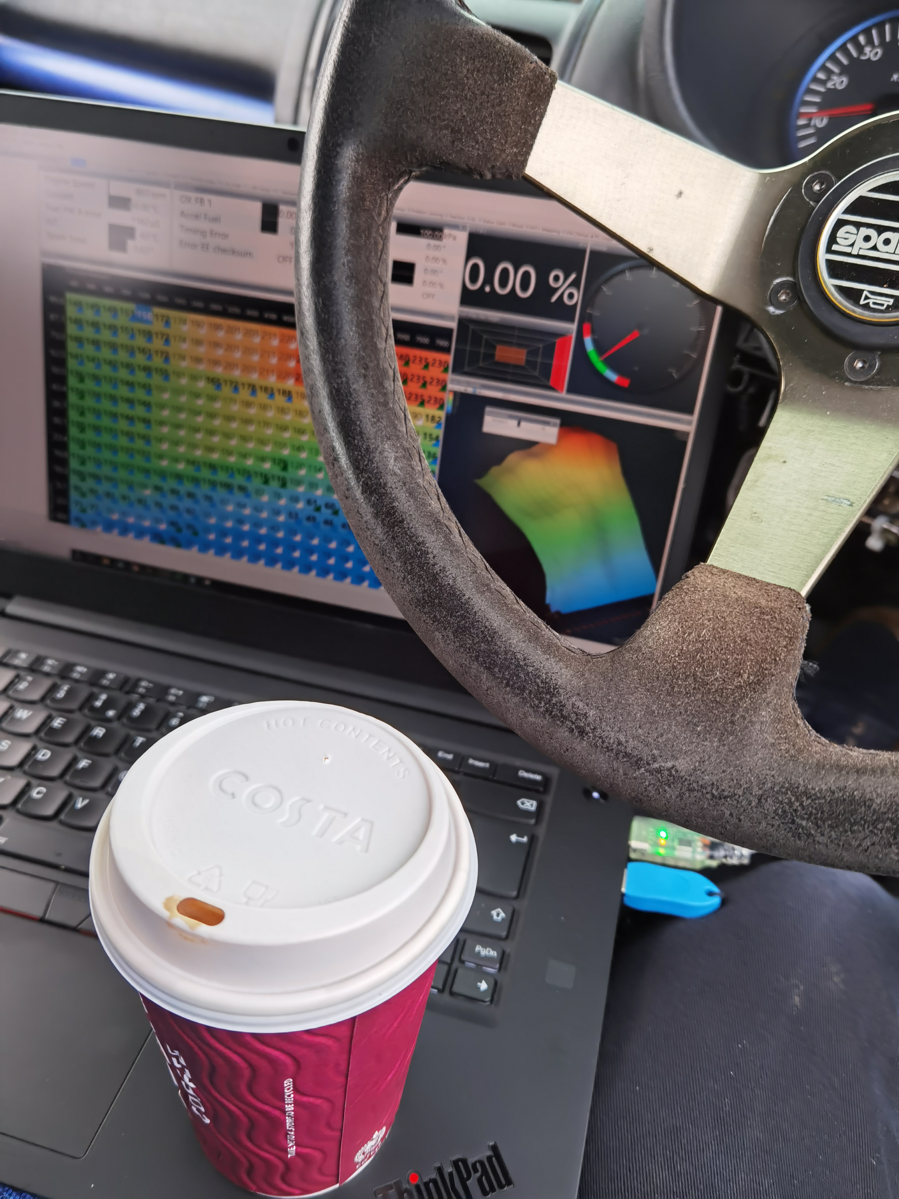

My work in progress picture.

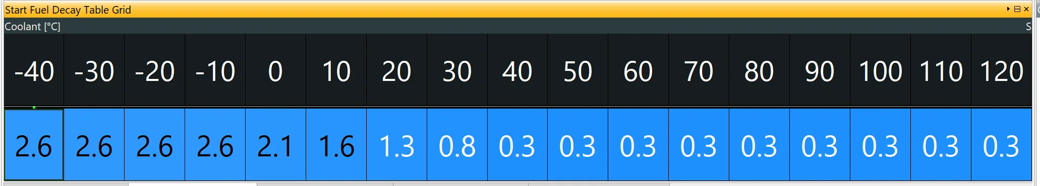

1) Prime Pulse (initial injection of fuel to help with the first fire). The Gen90 has this.
2) cranking enrichment. On other ECUs I’ve worked on this controlled cranking and after start by counting the revolutions of the engine after start. Sometimes it’s two seperate tables. Can’t find an equivalent in the Gen90.
3)warm up enrichment. This is a 2D table with just a multiplier. Again the Gen 90 has this.
I’ve used options 1 and 3 to get the starting better but would expect the 2nd option in there somewhere. Let me know if you have found it.

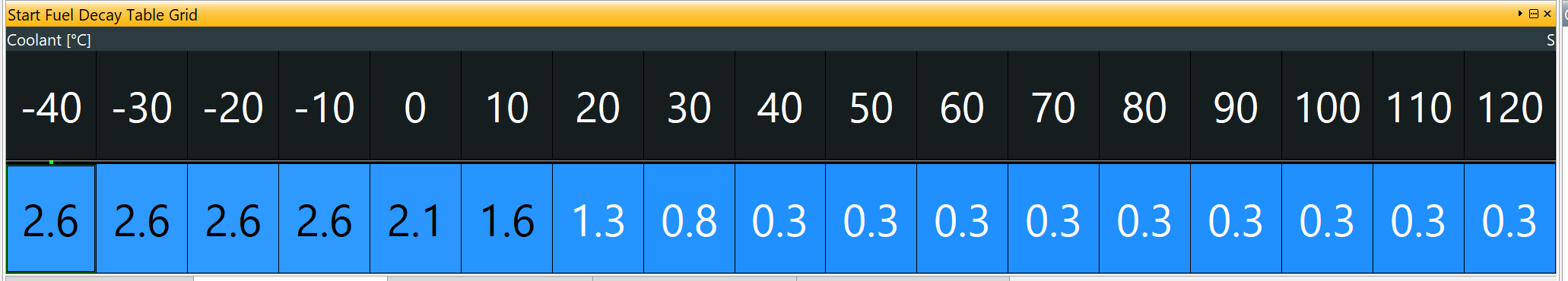

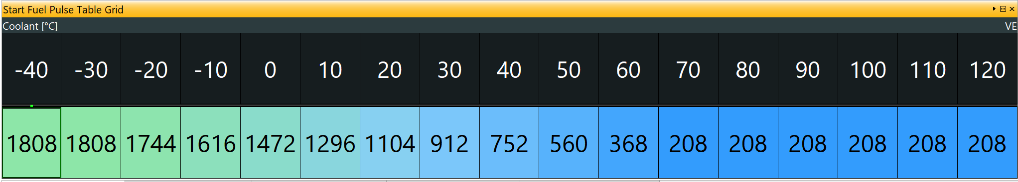

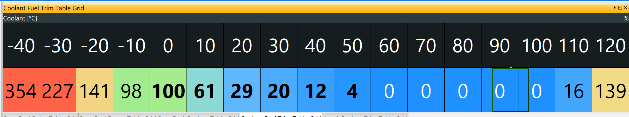

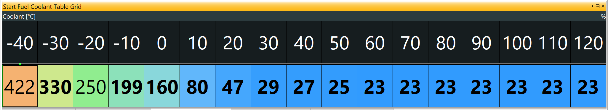

@David Stuart
So for option 2 I have used "Start fuel coolant table" which I believe is similar to the cranking enrichment. I have also used "start fuel decay table" which I believe is how quickly the start fuel table enrichment decays. I could also be well off the mark of how these are used.
Start fuel coolant table -
Start fuel decay table -
Option 1 table Start pulse -
Option 3 Coolant fuel trim (mine is running abit to rich on warm up i think)
Watch the values below -10. We are unlikely to hit temperatures that low in the UK - a duff sensor could mean you seriously flood the engine. For my cars I don't go below 0 as they never get started or driven at those temperatures so any vale below 0 is set to the 0 deg value.

Painful hahah. To be honest I don't have any road car stuff to compare it to.
I suppose it's okay. I've been setting the channels up in the gentuner software, saving and exporting into GEMS data analysis software. Maybe better software to use, I'll have to look into it.
The resolution of some of the channels isn't great, and I haven't worked out how to set the logging frequency.
Do you have any tables for adjusting the start fuel as a function of throttle pedal position? I quite like that option on other systems as you can set the start up to be slightly lean, then as you open the throttle the car starts, saves constantly flooding the engine during initial set up. Although your car might start with too much fuel you will find the oil quite quickly begins to smell of petrol.
Yeah. I’ve heard of people mapping in no fuel at 100% TPS and 500 RPM as a “flood clear” as well. I’ve never done it but the idea is that full throttle off the key if you flood your engine it gives you a means to just pump air through it and try again.
I’m personally trying to get a start off the key with no throttle input. I think you are right that the decay and the coolant factor work together as 2 2D tables that would be a crank count / coolant factor on other ECUs.
Flob
Yes flood clear is quite standard and very handy sometimes!
Setting enrichment based on TPS (if that option is available) can be really helpful, either leave it so on a warm day it will start on the button, but on a cold day you add throttle (to minimise the risk of flooding due to excessive and untested enrichment) OR data log to see how much throttle got the car started nicely, helps you get in the right ball park.
I personally prefer to leave it so on a cold day you need to add a little throttle - reason being that with very cold engines I prefer to get a few extra revolutions of the engine before it starts - although more recently I have added a fuel pump kill switch for this reason... Some of the cars I don't drive for weeks or months which is a touch deal for them come start up with no oil at the top end.
