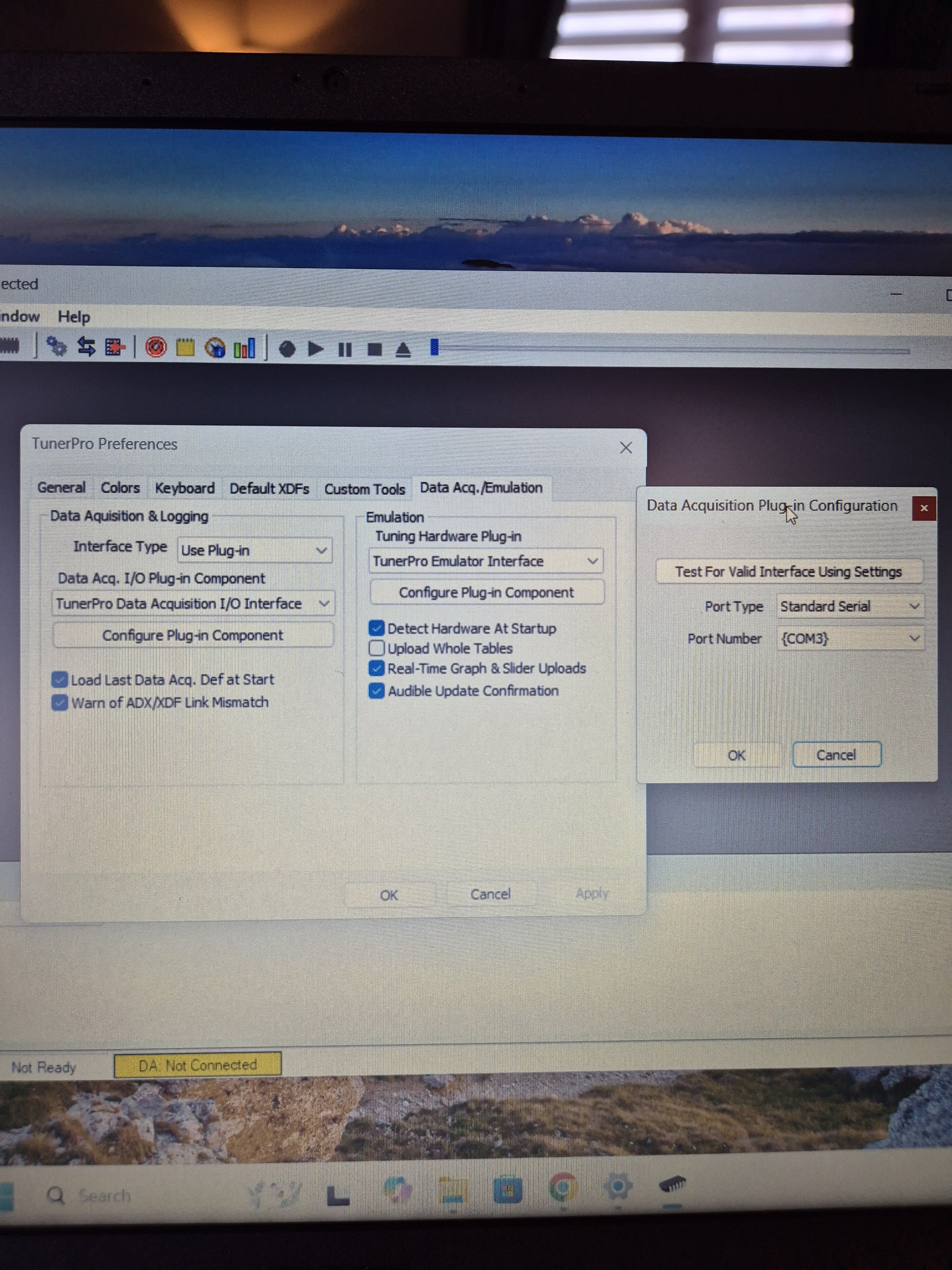

Looking for some help from those of you familiar with the Gen90 ECU and the conundrum of trying to connect to it.
Purchased the ecu 2nd hand, installed into my Ph1 after the pin swap and car starts & runs. Purchased a cable and software licence from ktec, received jist a cable and no dongle. Emailed them to ask if the licence is now within the cable only, after nearly a week they are still looking into it.

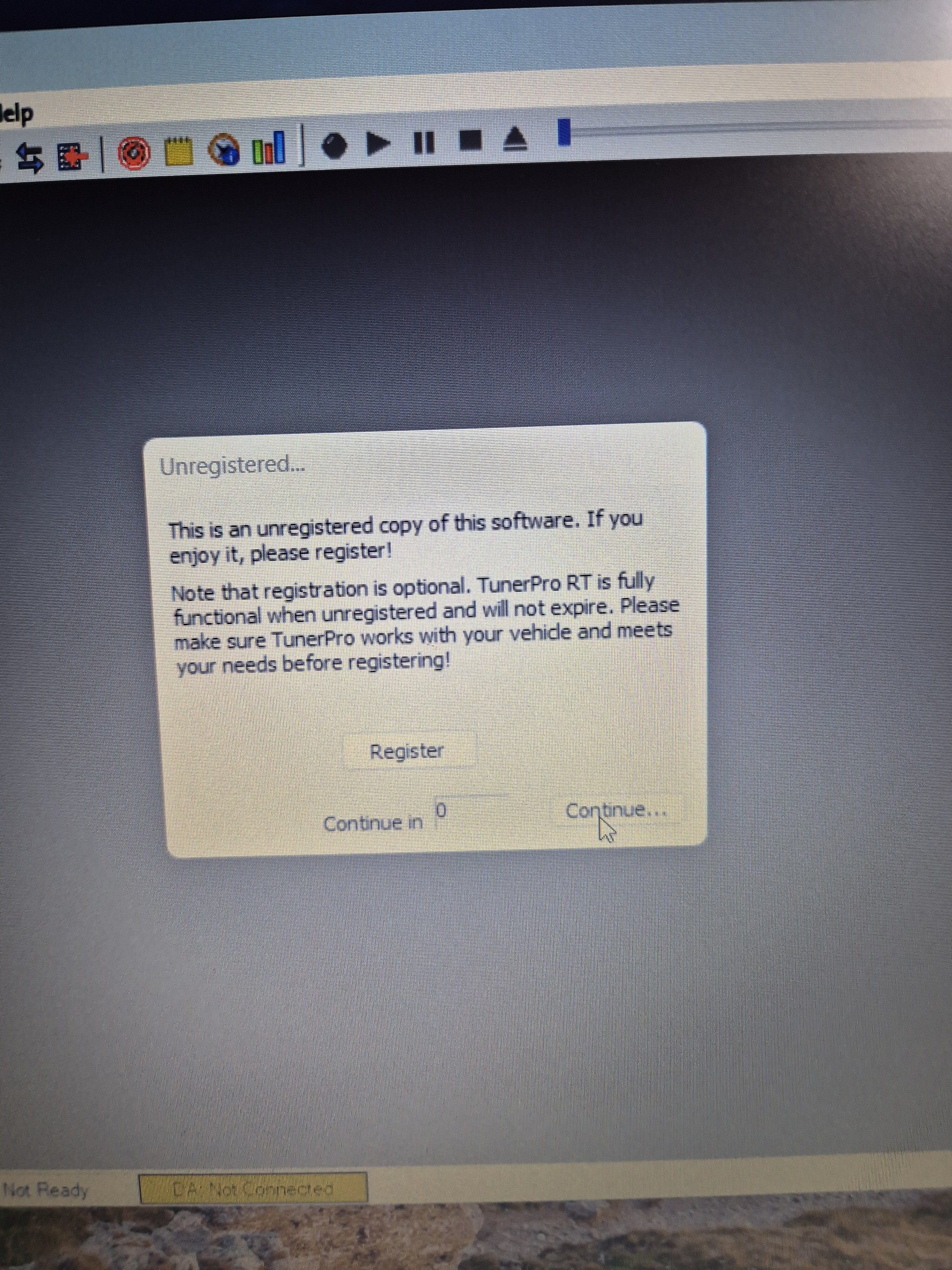

Downloaded tuner pro & tuner pro RT, I believe the RT is the version to use? Changed preferences to the serial port, selected COM3 as the port also. When plugging the cable in it comes up under device manager, lights flash on the usb and then go out. Still unable to connect to the ecu with it in the car.

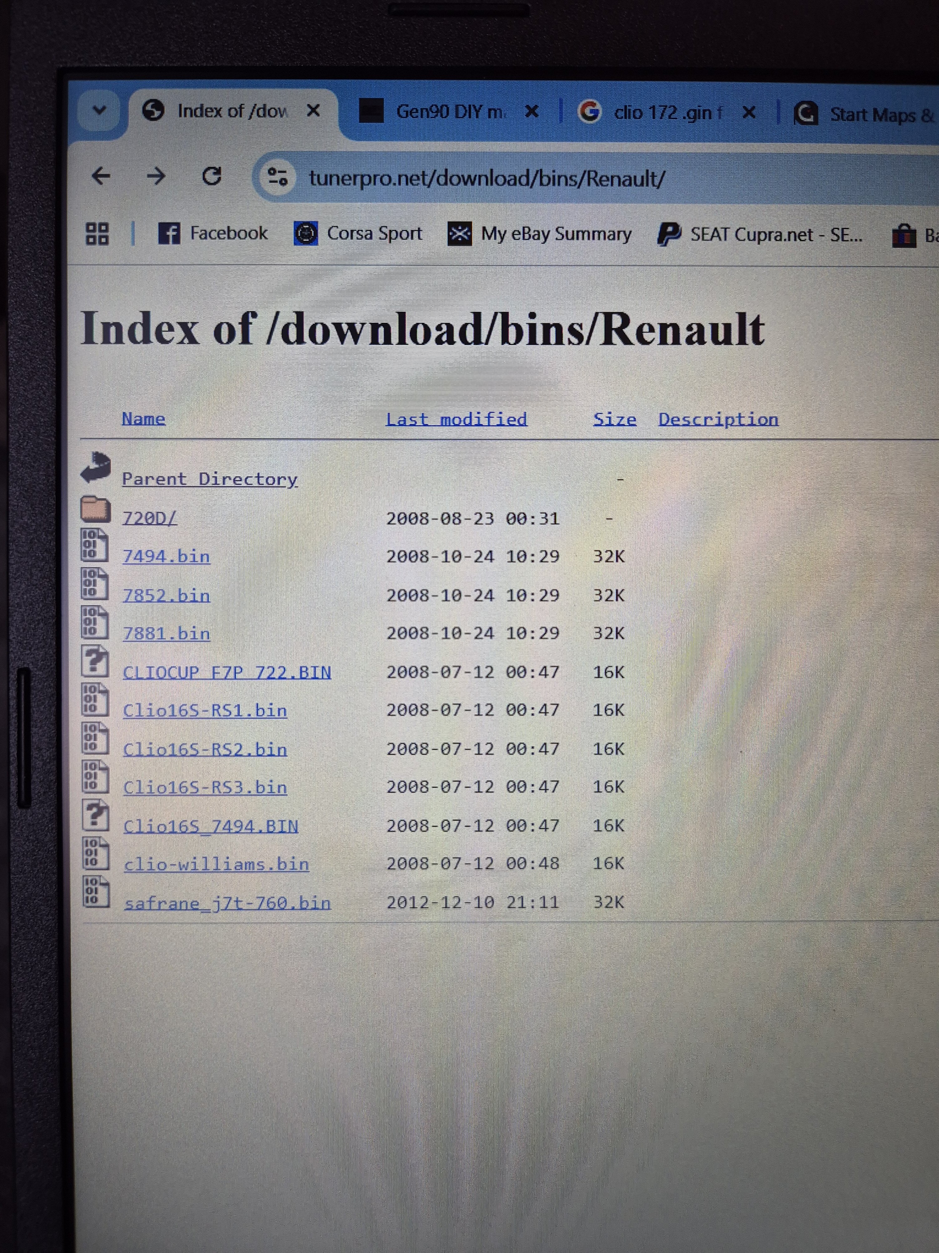

Also believe I need a .gin file to use so tuner pro can read data from the ecu, would anyone have one at hand suitable for a Ph1 172? I see there is one listed for a cup when you google .gin files, also came across a list on the Gems website however nothing listed for Renault or Clio
One other point I noticed I have no rev counter, is this common for a ph1 running gen 90 or have I a dodgy connection somewhere? I see on the pin out list that pin 24 is the rpm signal from the crank sensor and this doesn't move between ph1 to ph2. Id also assune if there was a wiring issue it would also throw a crank sensor fault and not run?

Ktec needs to send you the usb license dongle, the cable doesn’t enable the license. It’s just a usb to serial converter with the right plug for the ecu.
They must also send you the .gin file suited for your gen90 firmware.
Don’t expect anything else from them, even having to send the gin file is a dramatic experience for them.
Btw, gen90 doesn’t throw error codes, so forget scanning for errors.
Your only option is to see live data, and try to figure it out for yourself. With a bit of luck maybe someone had a similar problem with the rev counter and post about it here in the forum.

From reading up I need to access the ecu first to then see what version its running which then determines the .gin file required to match.

Nearly a month on, gave up with chasing ktec for the software licence. Emailed Gems direct and within the hour I had the correct software emailed over. Few emails back and forth to sort out the licence due to an IT issue their end but all solved with no drama's and got connected to the ecu ok
