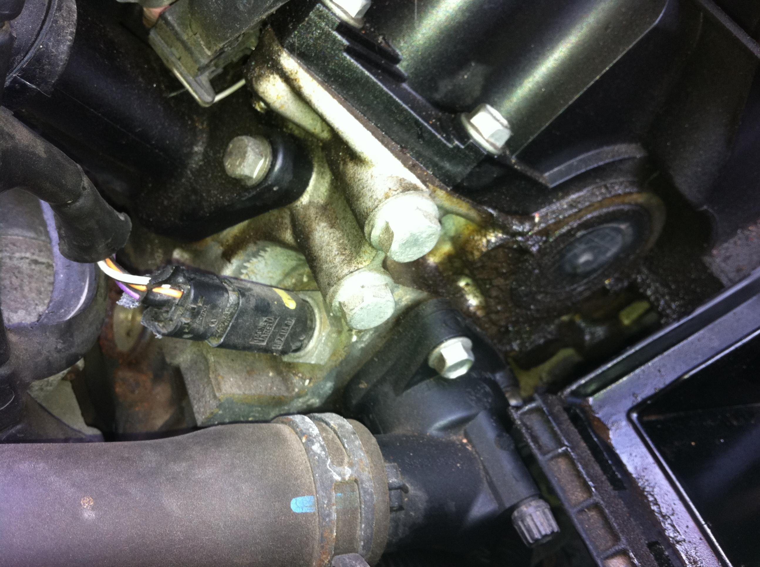

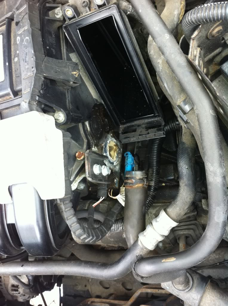

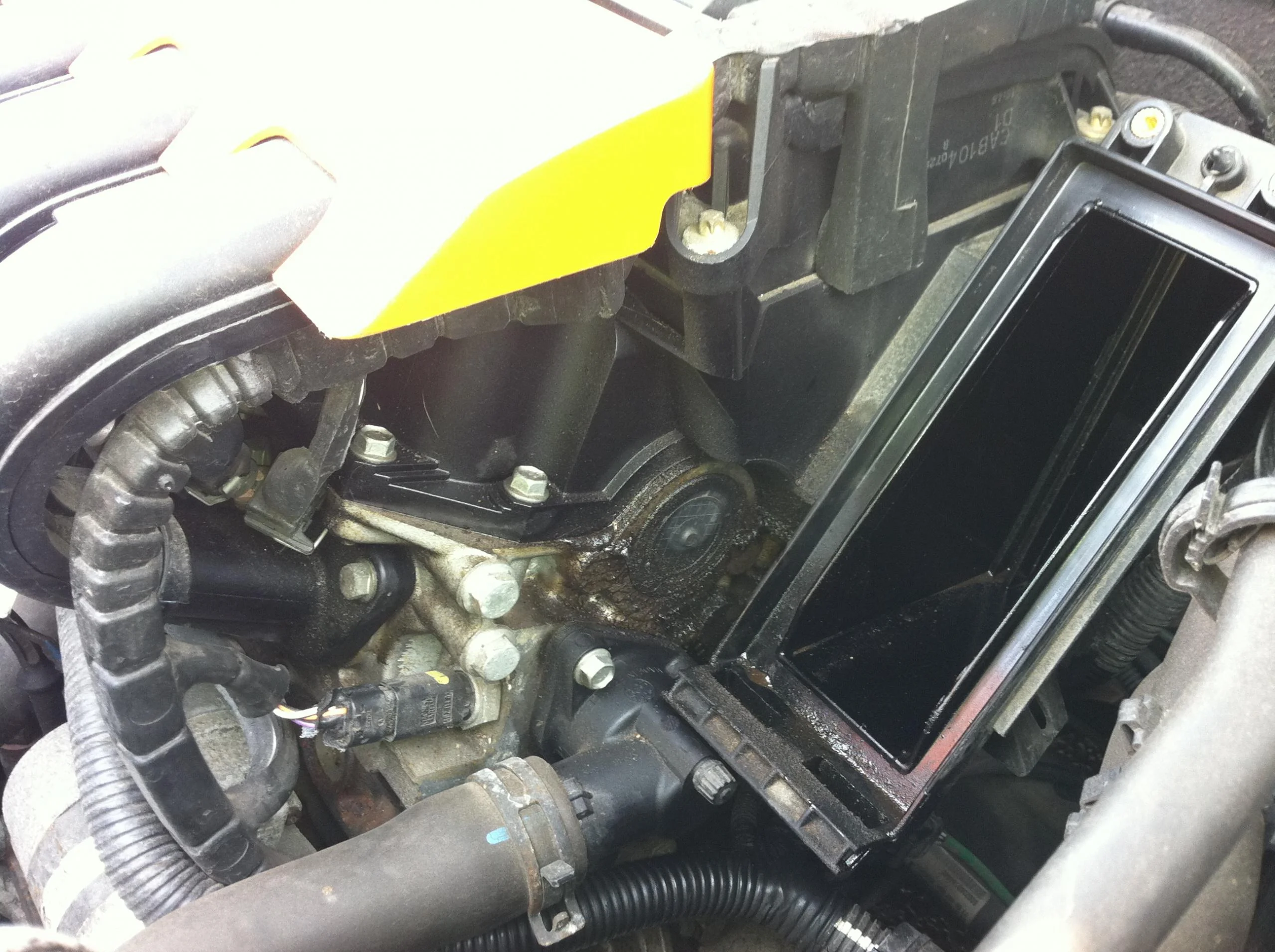

IMG_0221.webpIMG_0222.webpRight, still can't find it, so any help would be great. To the left are a few pics with the airbox removed.
I'm looking for the 'wings' of the sensor, but can't see them at all.

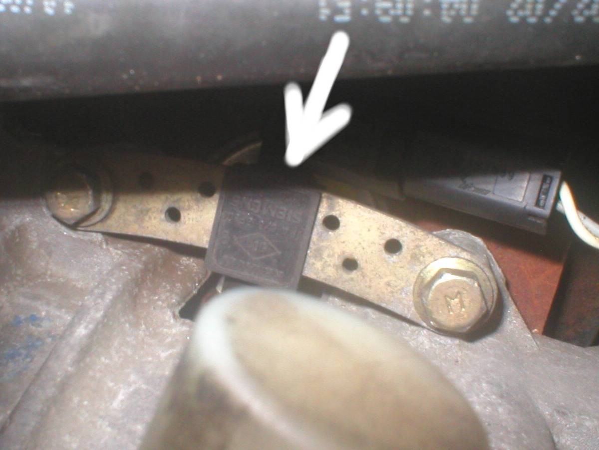

The above thread shows the TDC sensor on a 1999 1.4 megane, so i'm sure its completely different to an 03 1.2 clio, but cheers anyway.

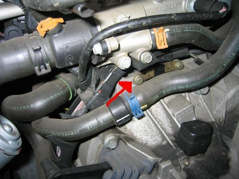

I would get you a pic but thats all I have from my old 1.2 (the second image is not mine)

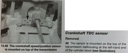

The sensor is mounted on the top of the transmission bellhousing at the left-hand end of the cylinder block:
To remove the sensor, remove the air cleaner housing, trace the wiring back from the sensor to the wiring connector, and disconnect it from the main harness. Unscrew the retaining bolts and remove the sensor. To refit, work backwards.
From my Haynes , hope it helps
