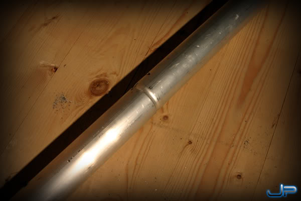

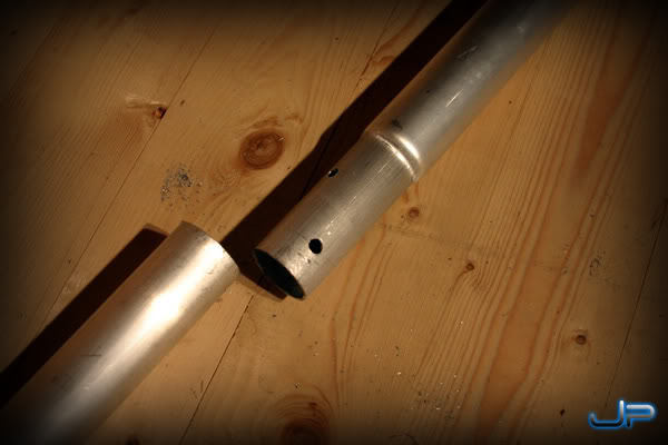

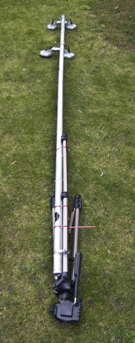

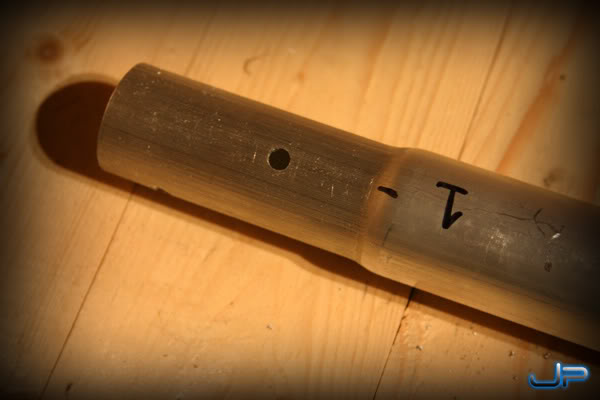

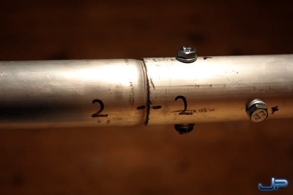

thanks guys, the rig looks like this, its made of 5ft lengths of aluminium that has a flange on them allowing the top of one to go into the bottom of the other, i drilled and bolted them to stop them coming apart, for this shoot i only used two poles but i have 2 more if i really need them (making it 20ft long), the poles are then held to the suction mounts using jubilee/hose clips, allowing them to be moved about to get a suitable position
i will probably change the tripod for something else at some point like a monopod or a superclamp with just a tripod head
lol! Get rid of the tripod straight away m8, god know how much that things weighs!
Get a superclamp and tripod head, that's what I use - its much simpler to use, and you get a lot more freedom when framing the shot :)
ROFL! Errr....no it doesnt!
There is no other car, just the camera attached to a 'pole' which is attached to the car!
If there's another car, why use a rig?! :S
I thought it was a rig coming off the side of a different car because I've seen them like that. No need to be like that, rigs come in different designs.
yeah shadowness i was thinking of the superclamp idea, this was just for testing the tubes etc, it worked quite well and the best bit is that its portable as the tubes connect together so i can fit them all in my clio.

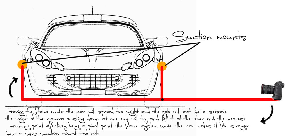

i did look at under car rigs too like these (and the pic you posted) but still using suction mounts
like this 2 second photoshop
and
That looks quite a lot of work to photoshop out! Personally I find this method to be the easiest to me at the moment (I would like to do the under car magent option, but thats a bit more pricey lol!)
