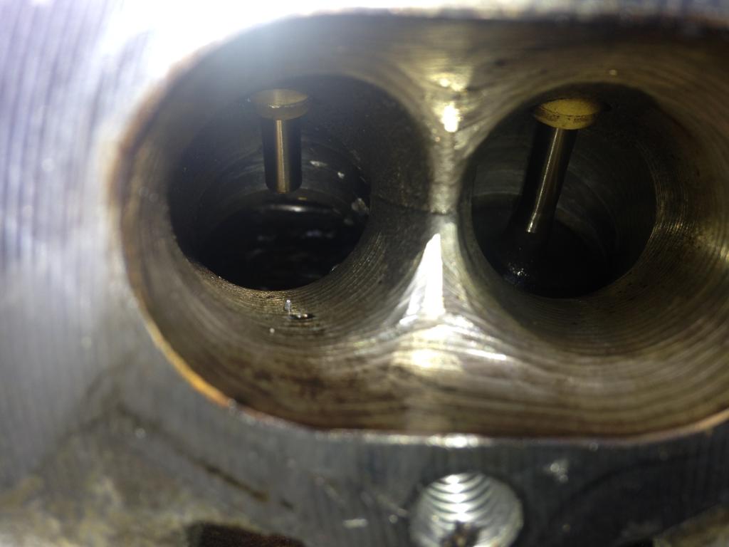

I'd have the manifold off and have a look down the spark plugs see if you can see anything otherwise head off and see what the damage is.

the is engine is dead.taken of top inlet and got sprinkle of metal :banghead: So gunna get new engine.been offered a ph1 172 engine saying it's better then a 182 engine any advice

Have you even read the thread, he states there was metal in the inlet.
Sounds like yet another dropped valve on a f4r, happened to me last year. Seems to be happening more frequently now these engines are starting to age.
Pick a replacement engine very carefully and be wary of Renparts who will happily lie through their teeth as to the condition of engines they have in stock.
