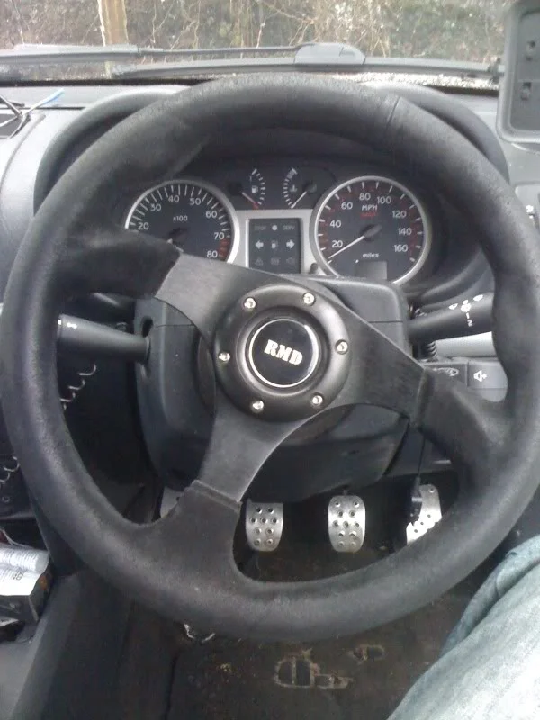

LOL this is where my steering wheel is to drive straight....
If I let go it pulls to the left and if I put it central I can go round slight left hand bends :)
