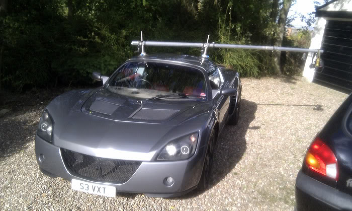

I built my own based on their design. It can either go under the car, using their clamping system, like this:
OR..it can go on top, which is the more common method as the under-car method doesn't work for all cars:
It wasn't that cheap to build, but not quite as hard as I expected. Although I did have help, as the aluminium poles were welded by a Dad's friend.
If you go with the on-top-of-the-car option, you just need some aluminium poles (or CF if you want to push the boat out!), and two suction mounts.
Hope that helps for now, any other Qs, just ask :)

LOL i would be to nervous to even touch it incase something happened to it, What materials did u use/where did you get it?, How do u fix the camera mount onto it/where do u buy seperate camera mounts? and how do u make clamps ect? total NOOB to this! any help atall is appreciated.
I bought some aluminium tubing from a metal works place (we deal with them through work), my dad's friend welded the ends up, so they can slide into each other.
Camera attaches to the tubing using a manfrotto 035 super clamp with a tripod head fixed to it.
The metal work guy at work helped me modify the suction mounts so they each have an 035 super clamp attached to them, holding the tubing at the car end.
