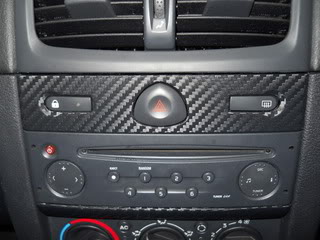

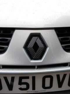

Looks ace mate, really good!! Really want mine done just like yours, but dont have time or patience to do it, or money to buy already done ones!! Might have to bite bullet and get some to try.
Any tips anyone?
Does anyone have any idea how much stuff the 50x50mm sheet would do? Provided it all goes well?
I would like the bullets, both diamonds, dash and steering wheel trims and gearknob. Would it theoretically be enough?
Thanks in advance
no. 50x50CM might be though. Buy more than you need though (much more) if this is your first time using the stuff, oh and a good heat gun will make things much much easier.
Yeah I've just realised 50mm is tiny!! Lol. Thanks for the advice, will a hairdryer work? Any other tips? really want to have a go and get the bits done. I'll get that ordered Tuesday to start.
make sure your bullets are clean and wipe them over with something (IPA, white spirit, panel wipe, whatever). also make sure they are as smooth as possible, maybe give the a very light wet/dry sanding in places. I found even the slightest mark showed through the vinyl. i would definitely recommend a heat gun for when doing the bullets too because you're going to need a lot of heat to mould the vinyl around the lettering. more heat gives more stretch in the vinyl.
remember though to use short bursts of heat so not to 'melt' the vinyl when using a gun. something blunt to push the vinyl around the lettering is also useful.
One final question. I've had a go, but on the dash strips I can't get a perfect finish on the curves at the ends. How have you done it? Also do you let it set and then trim right down, or mould the excess around the back?
