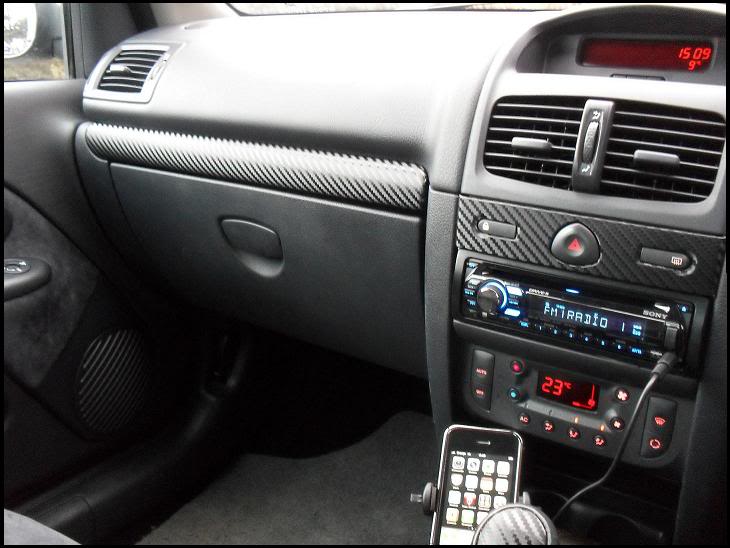

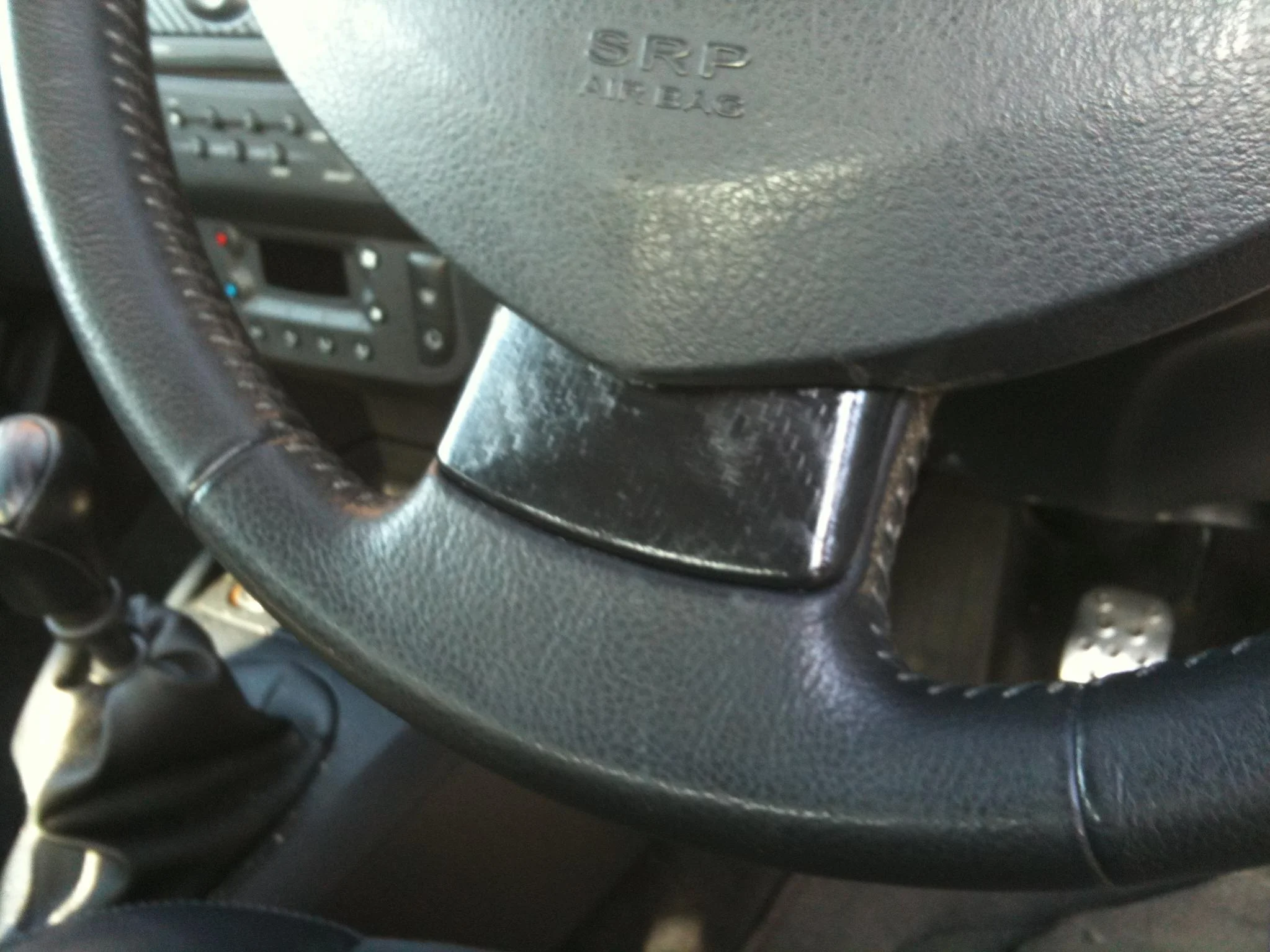

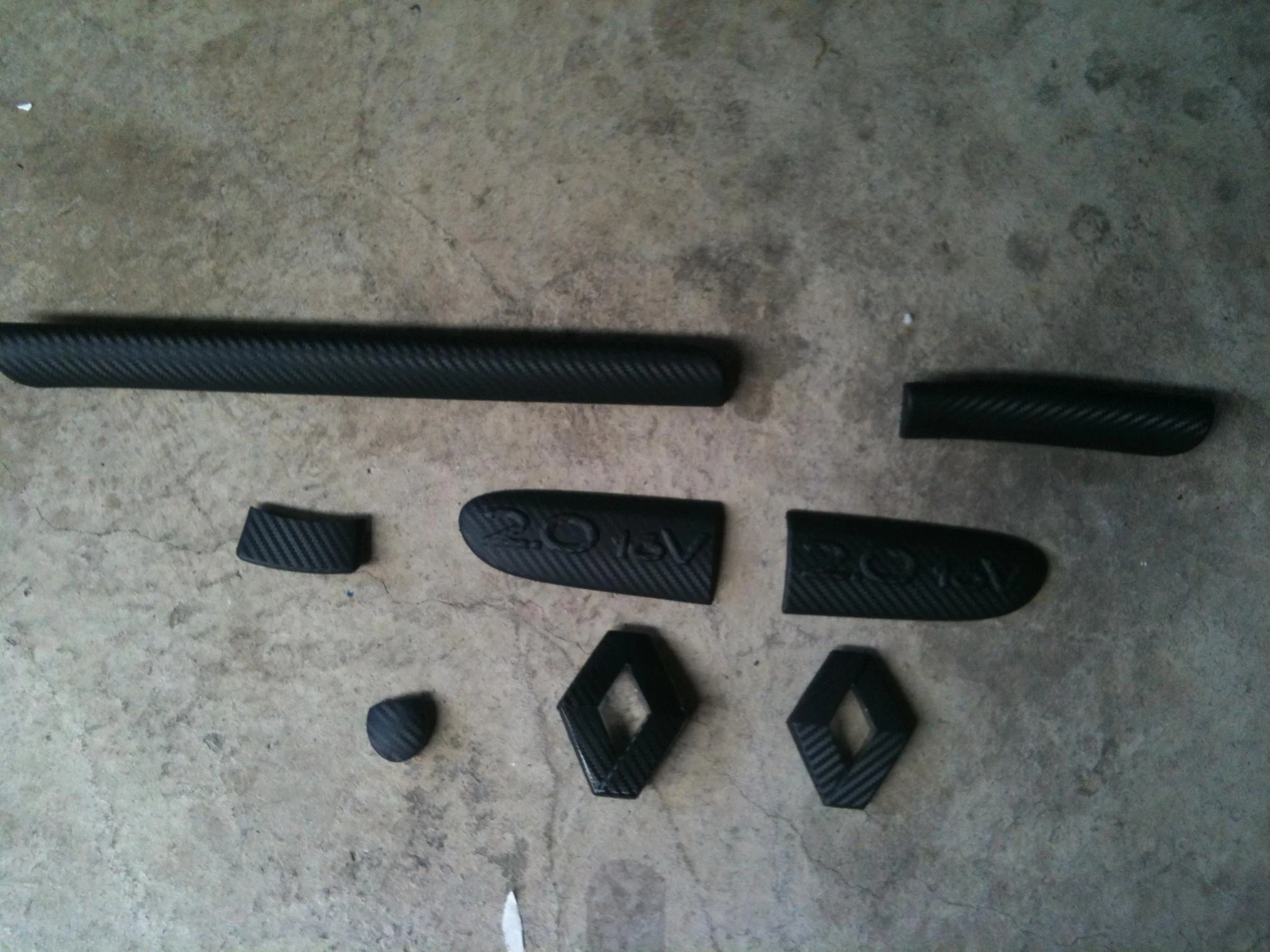

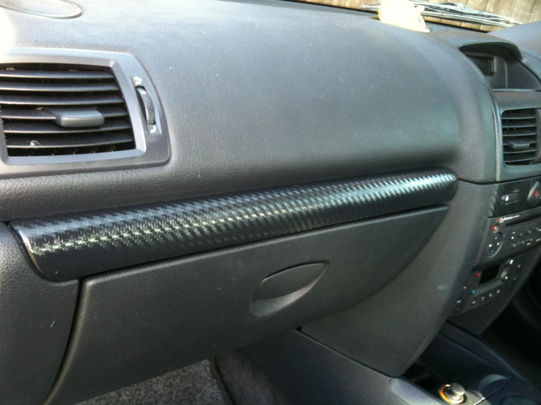

Ordered some 3M carbon wrap from ebay to have a go at covering some dash parts and it turned out much better than i thought
Also done the other small dash strip and the steering wheel insert
Not bad for a tenner i think :p

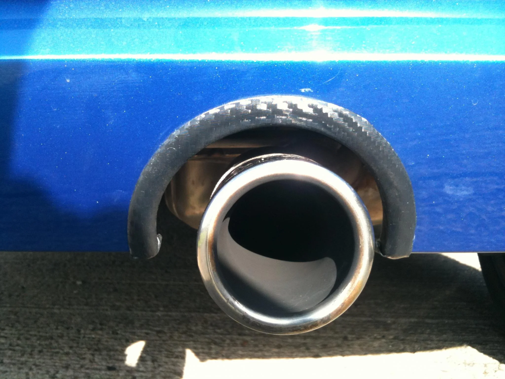

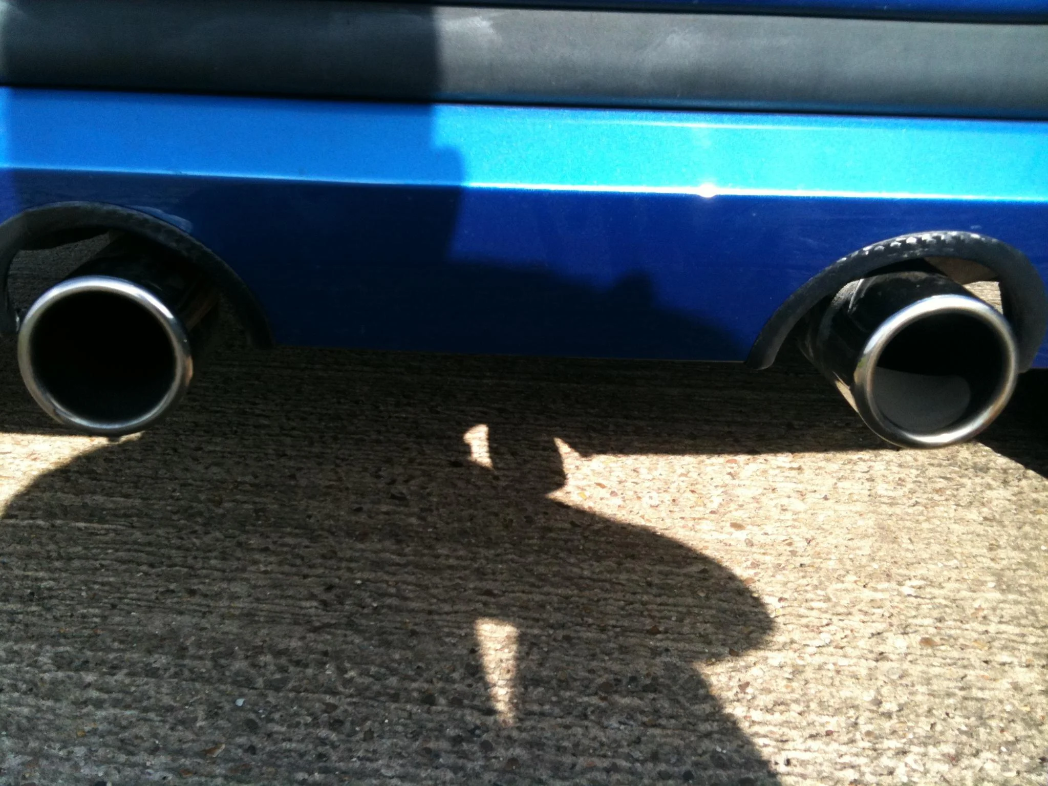

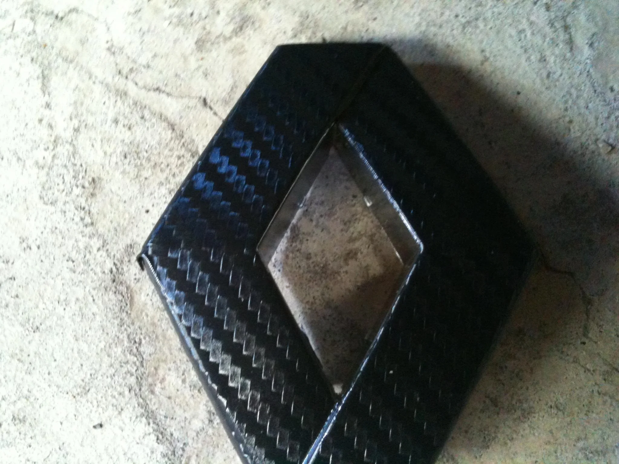

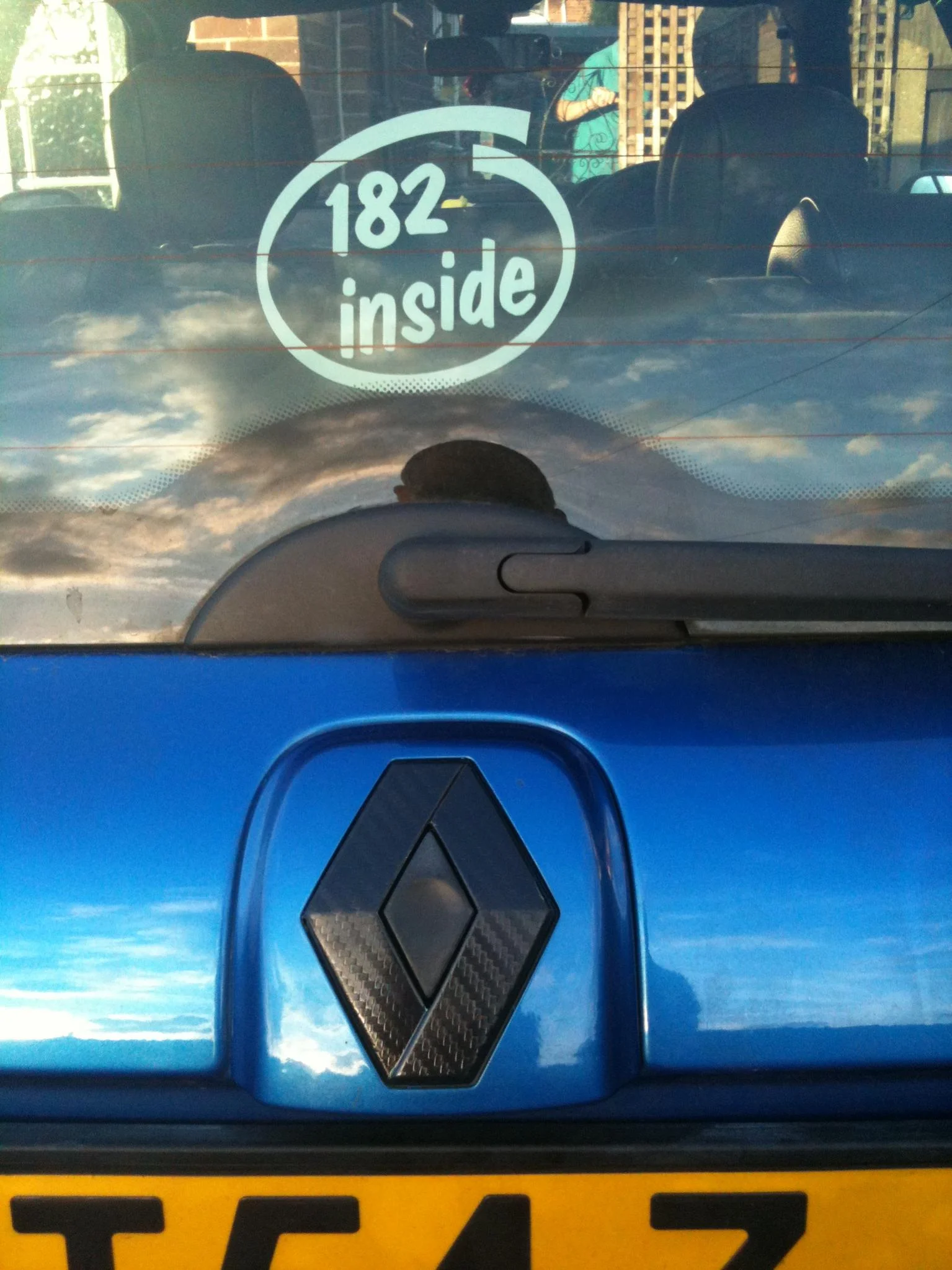

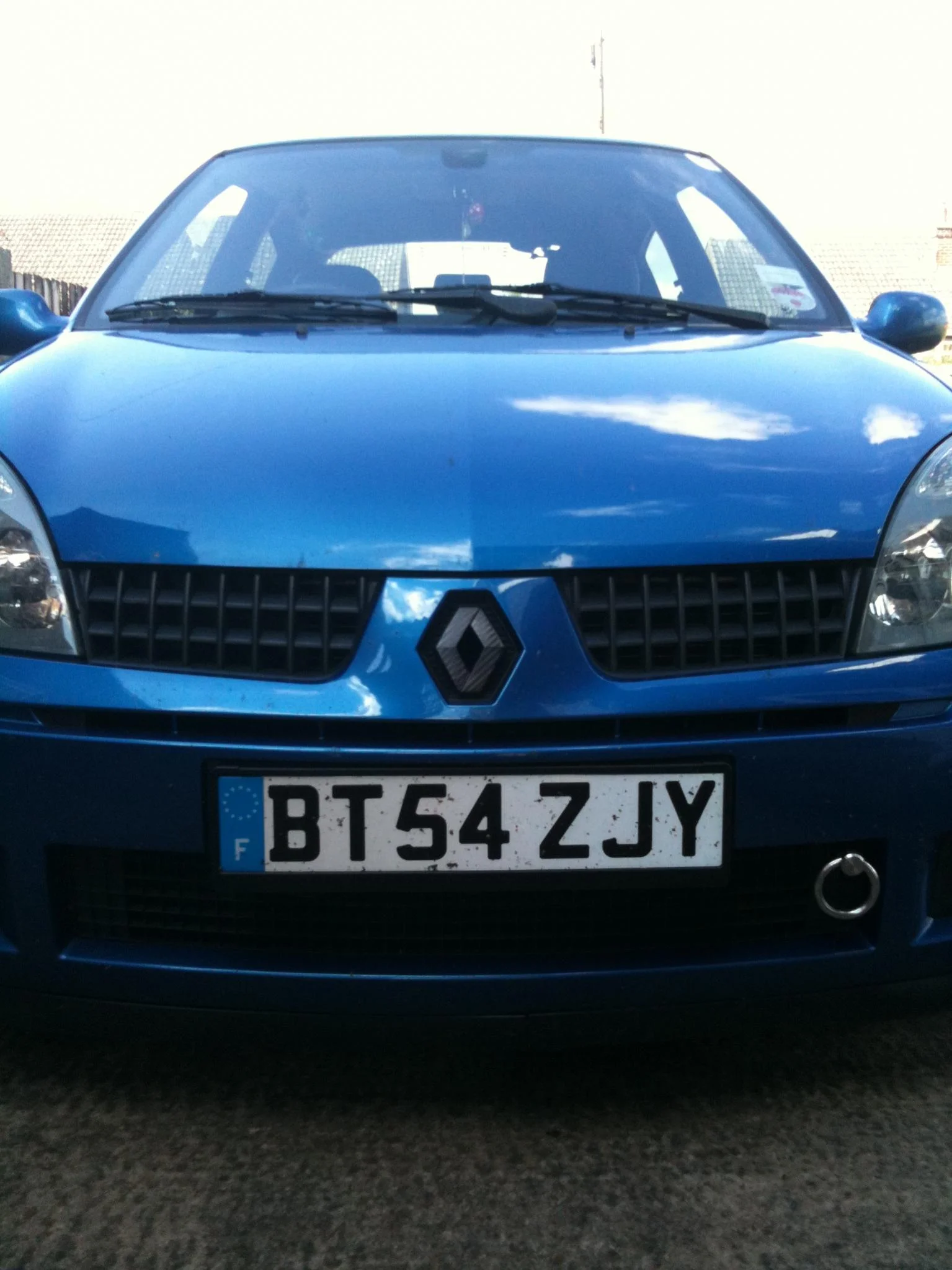

Ive got some on mine and ive done
Bullets
Front and rear dimond
Exhaust surrounds
Dash strips
Hazzard panel
Gear knob insert
Steering wheel insert
Looking at doing bumper insert and interior light soon
  A3 2.0TFSI QUATTRO
IMG_0029.jpgIMG_0032.jpgIMG_0055.jpgIMG_0065.jpgIMG_0067.jpgIMG_0054.jpgIMG_0039.jpgIMG_0035.jpgIMG_0053.jpgIMG_0030.jpgIMG_0040.jpgIMG_0064.jpgIMG_0034.jpgIMG_0056.jpg

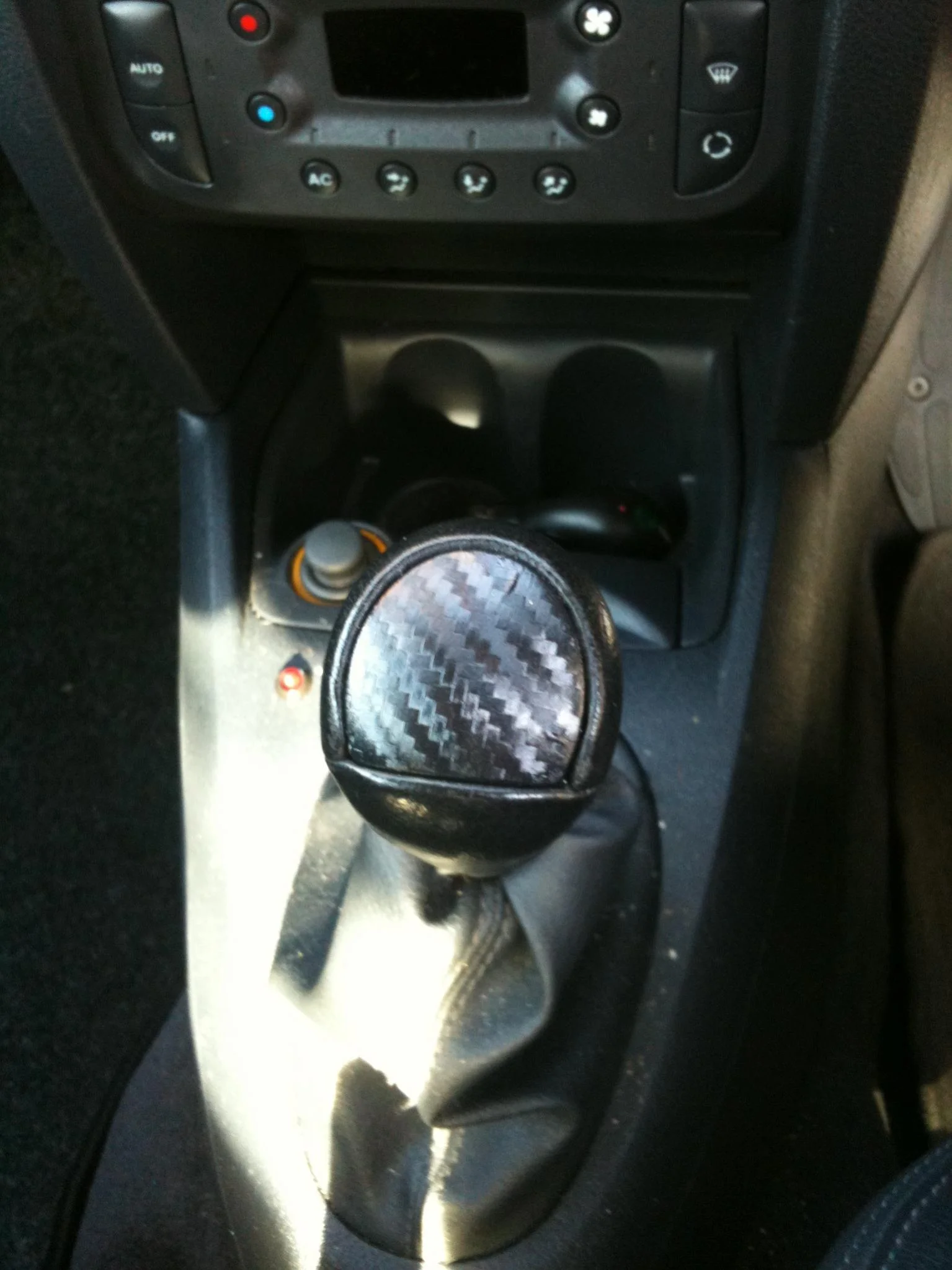

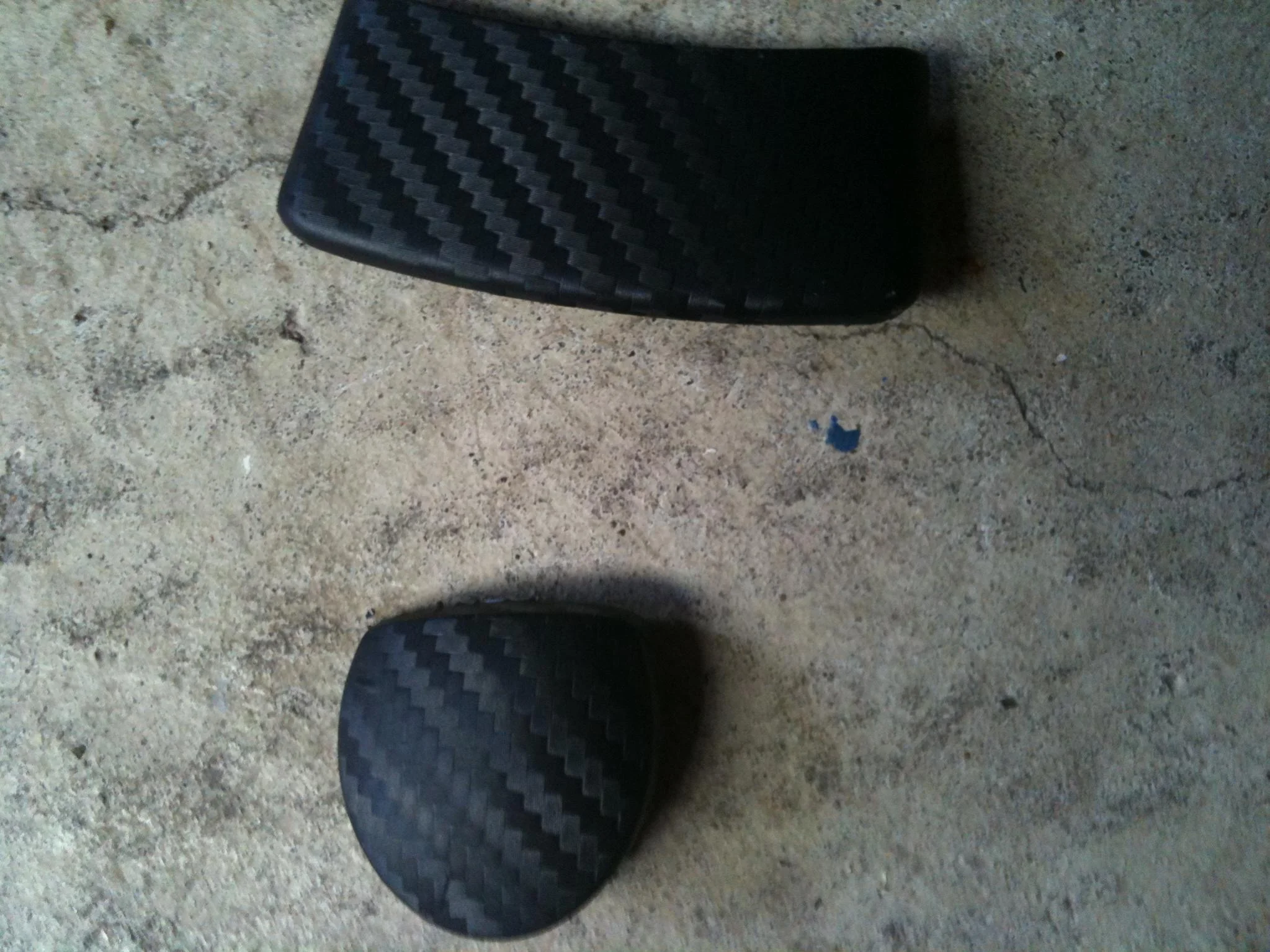

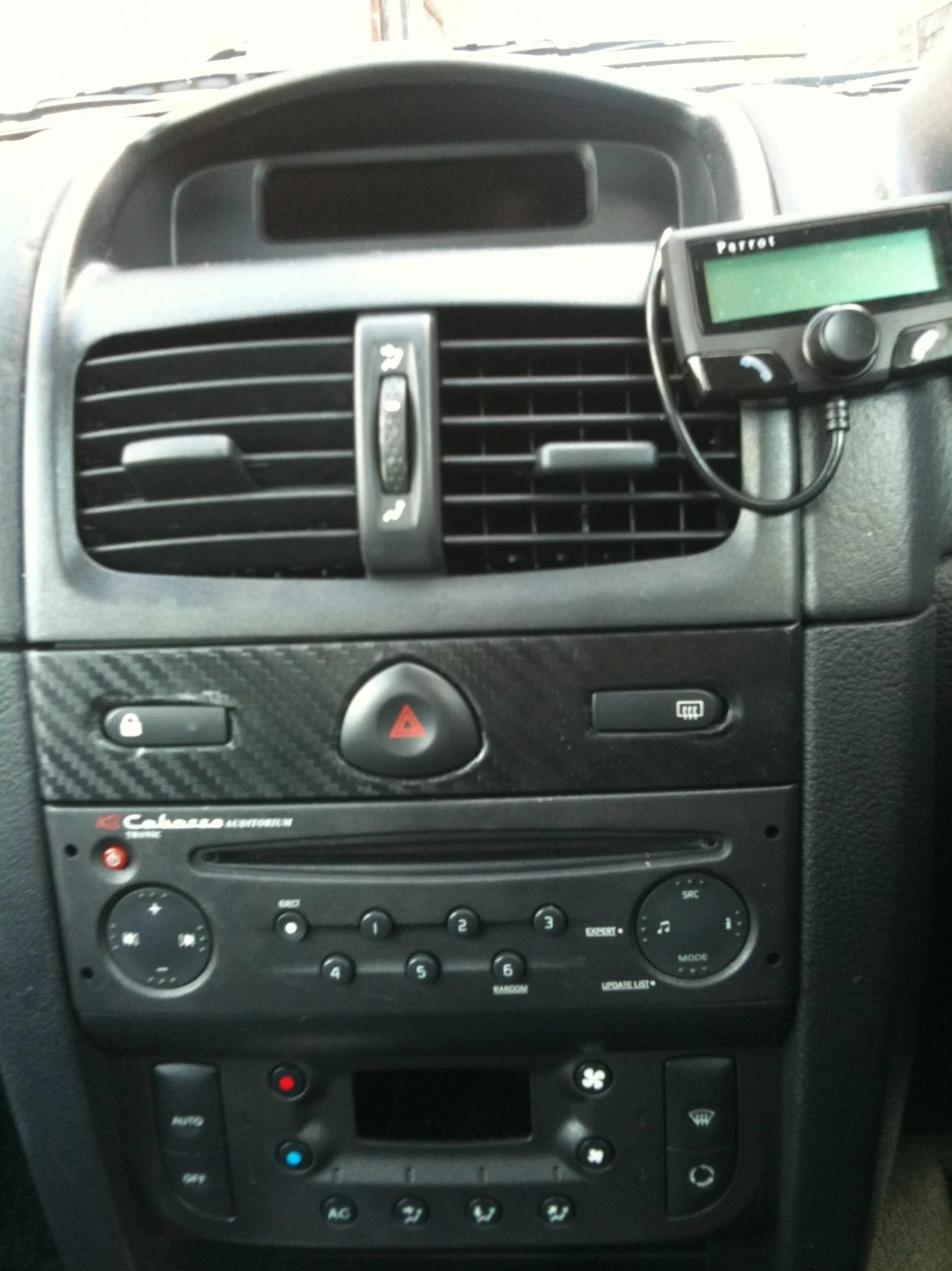

in no order the only thing is the gear knob has a slight bubble and so does the hazzard panel

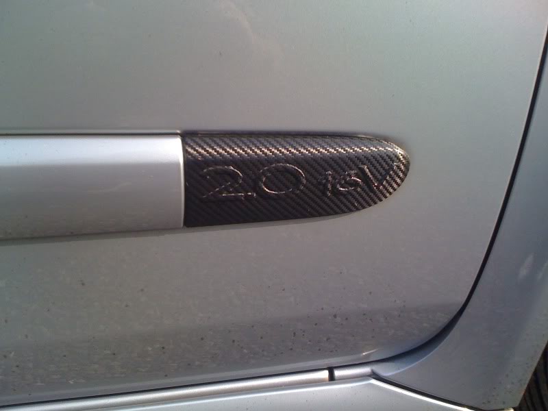

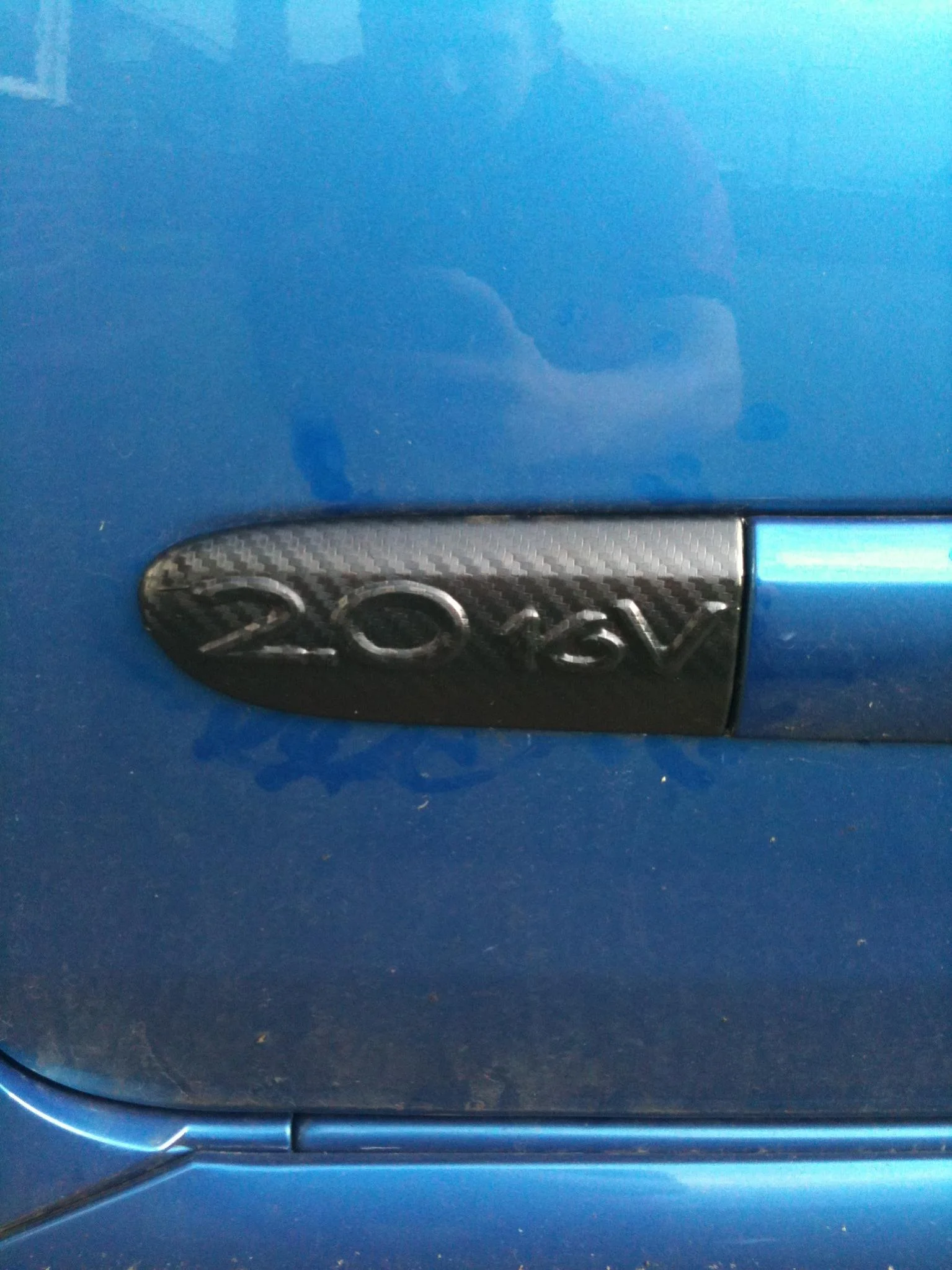

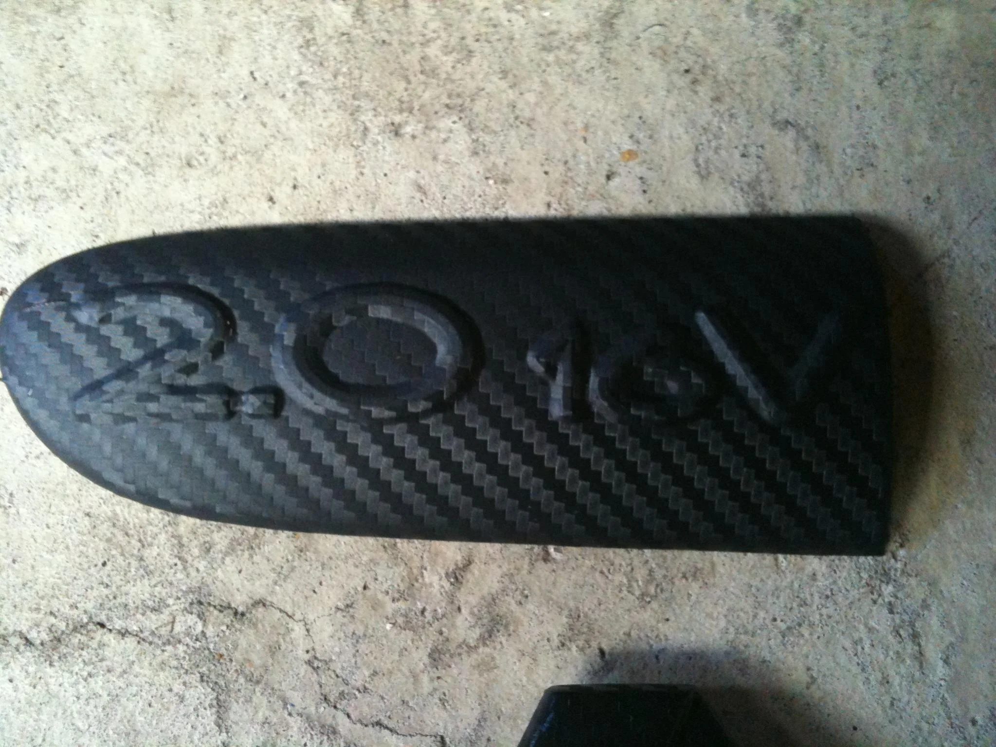

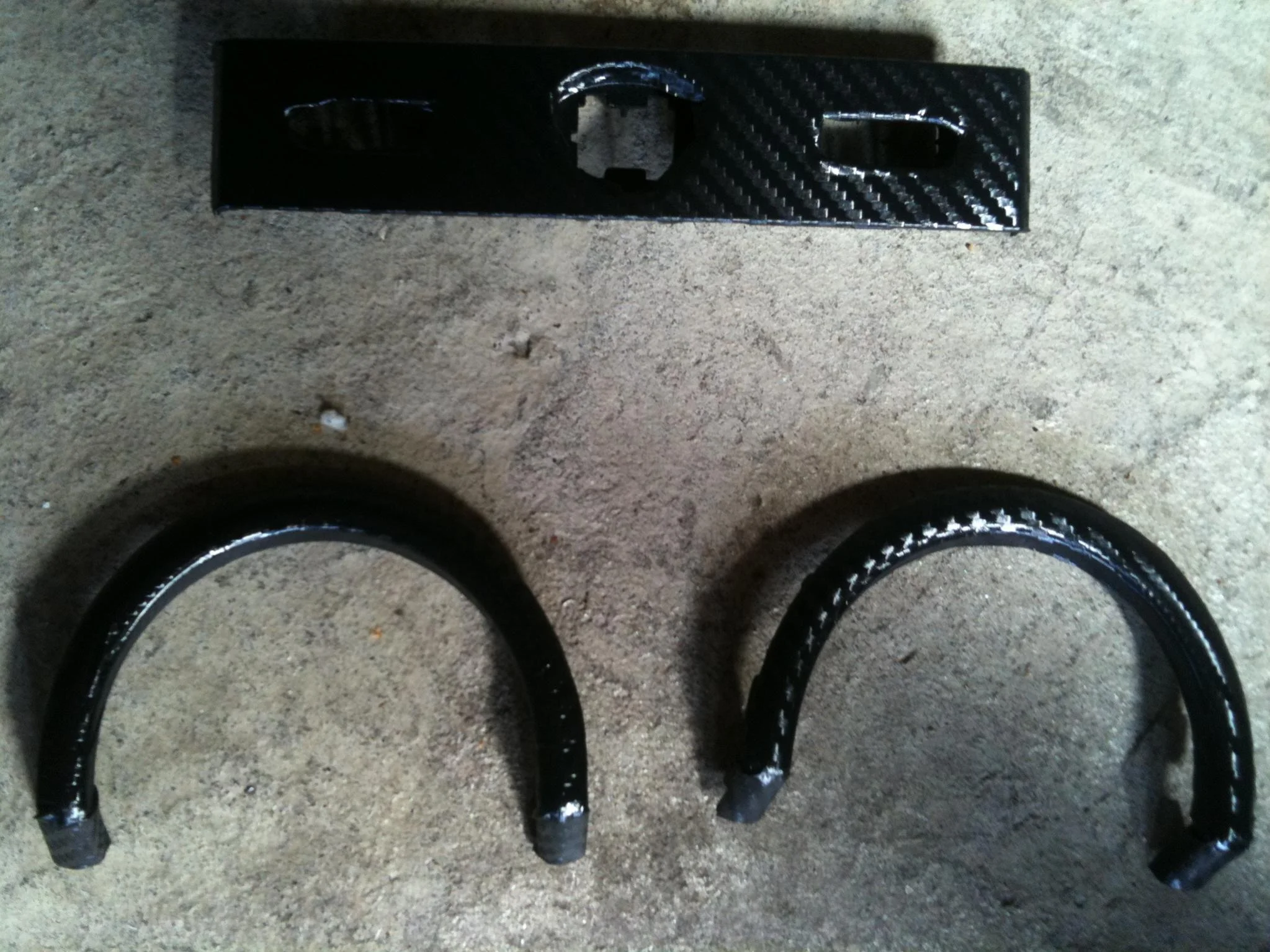

I used a hair dryer to stretch over edges a old top up card to push it in around the "2.0 16v" and lots and lots of Patience
  Clio 172 RS2
Don't stretch it! It pulls back a bit after cooling down... 2.0 16v lettering should be applied tighter
Use more 'patience'.;)
  A3 2.0TFSI QUATTRO
a bit of patience is all thats needed realy the longer you take the better it will come out ive done all my bits made loads of mistakes and binned bits and still got plenty left form the size of sheet i used

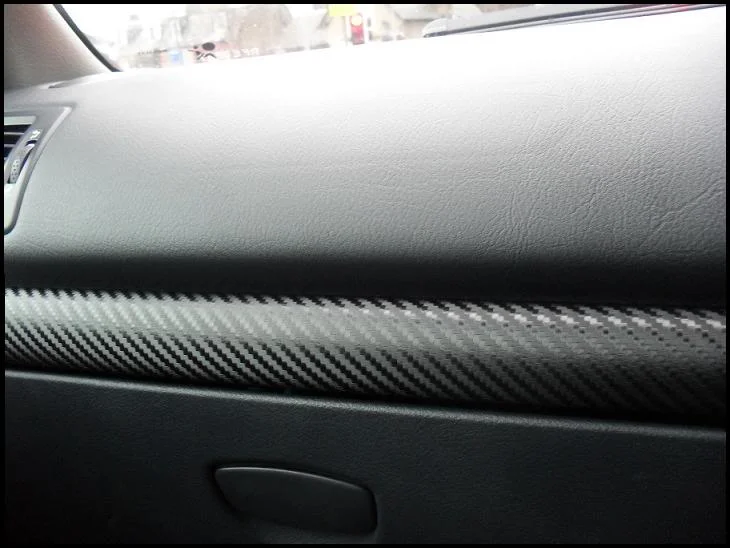

The dash inserts start from middle outwards and you only need the heat mainly for the edges pretty straight forward once you have do a few bits
If you get a bigget than needed bit try more complicated bits after dash strips once you got the hang
