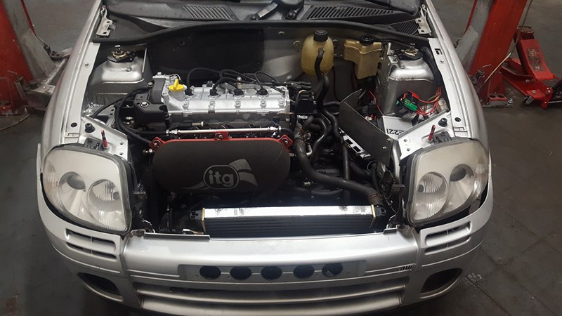

okay so my ITB build is nearing completion, just have some small tinkering to do and withing a couple of weeks it should (fingers crossed) be ready for mapping at EFI. Prior to that i am wanting to get the engine timed correctly to suit the 438 catcams i have fitted (i believe they need timed to 421 settings)
The engine is currently timed to factory settings however is there someone out there who can help in timing the engine correctly to best compliment the cams and ITB's. Im based in Newcastle but happy to take the car anywhere in the UK if it means getting the best out of it.

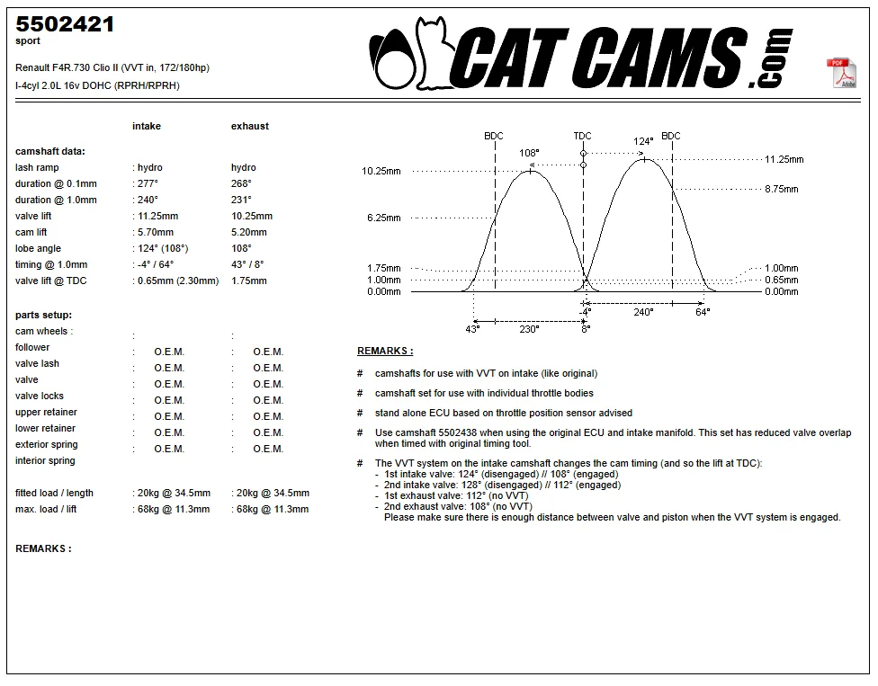

Thats right – in short, the 438 has the same lobe profiles as the 421, and with the 421 being more suited to ITB’s you should re-time the 438’s such that they act like 421’s. From memory the inlet timing is fine Mark but you need to move the exhaust cam. I don’t work with them mechanically Mark so it’s not the sort of thing I’d remember I’m afraid, but if you go to Catcams website and look at the specification of the 438 and compare it with the 421 you’ll be able to see how many degrees it needs to turn, and in which way.

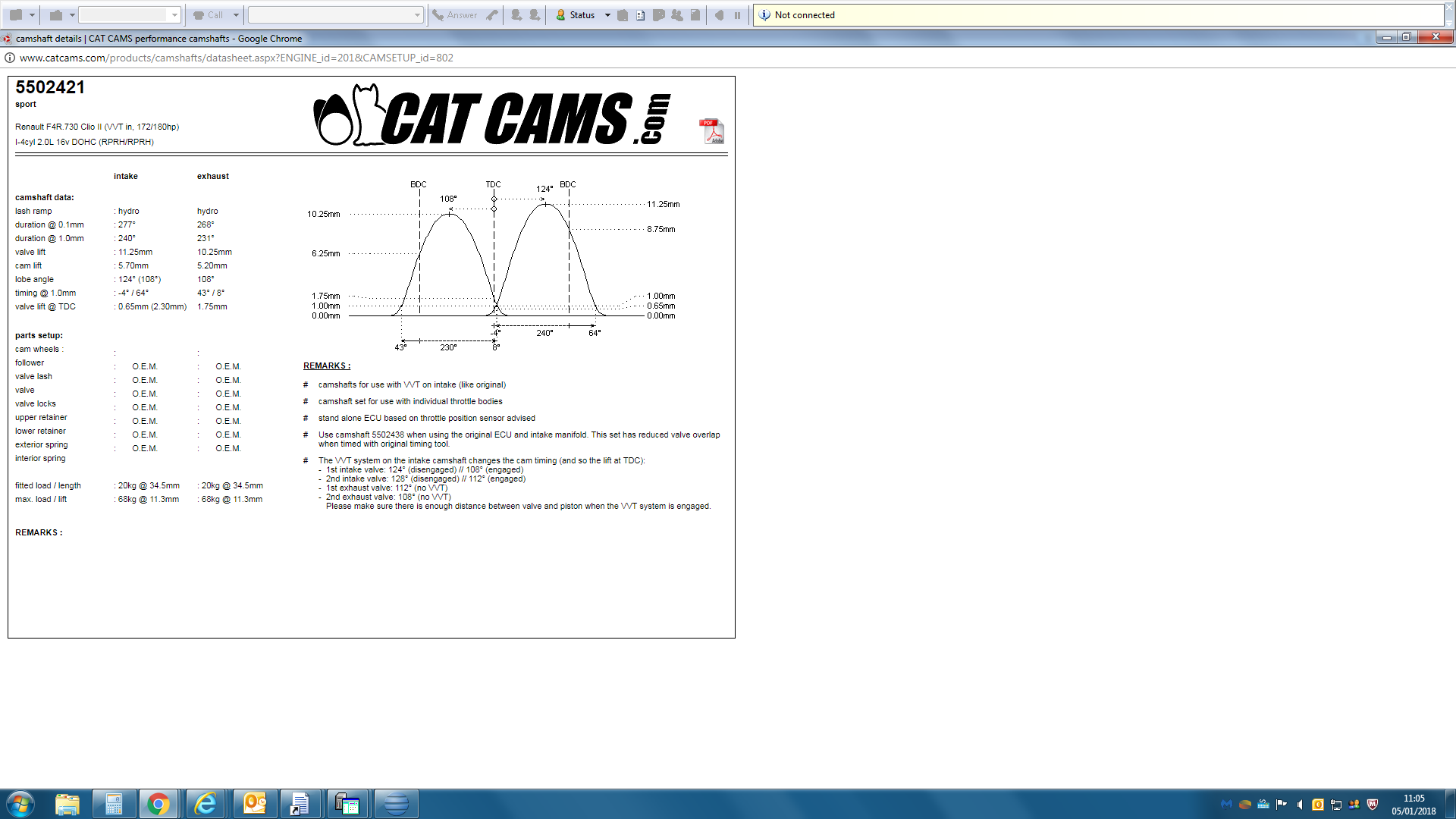

421 spec

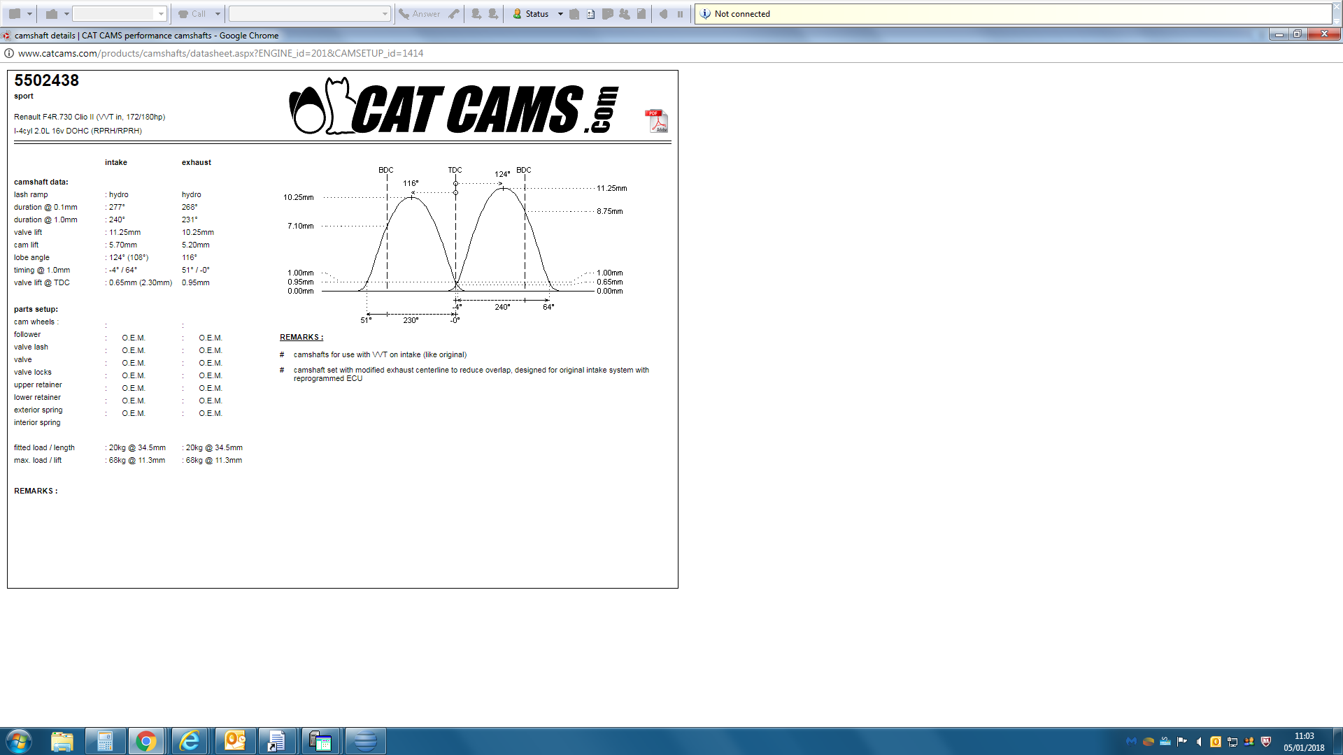

438 spec
Only difference i can see is to the lobe exhaust angle by 8 degrees
