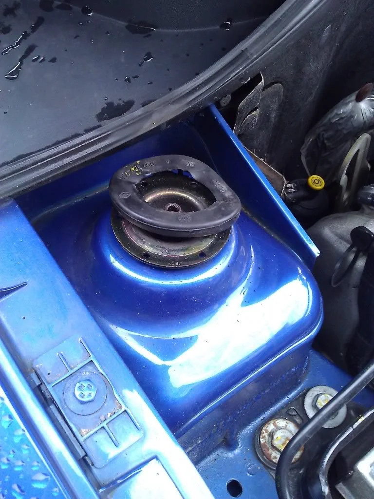

So the Front NS has been knocking for a few days now, over bumps and rough surfaces it sounds like something is moving....
so after checking the wheel and strut lower bolts all is fine and tight...
then looked under the bonnet...
is this the problem??
The rubber seems to have torn away from the metal disc and the nut wont tighten up as much as the other side :/

Get track rods etc checked? That top mount needs changing though. If that's the only thing you can see that's wrong its the best place to start imo.

It's not the top mount mate. It's just a rubber coated flange to stop the suspension strut falling out of the turret. To change it just undo the nut inside. Should be a £2 or£ 3 but knowing Main dealers they will be charging £10.

Well iv got one comin now from ClioSpares....
seems like the rubber bit that has torn off could have stopped it from making a noise? Especially since the nut wont tighten up properly on it now...
iv had both the drivers side wheels off and checked everything and its all tight so must be this :/
