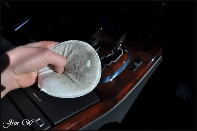

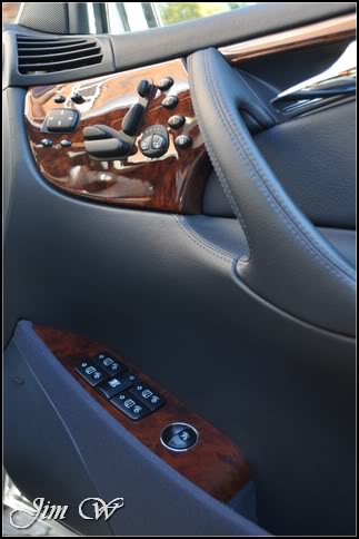

Whilst Jonny got to work on the wheels/underside of the Porsche, I had de-cluttered the Mercedes interior, wiped all the plastic fascias, cleaned and hydrated the leather and later polished the britework.
Jeffs Prime used on the wooden trims:
Lovely interior on the Merc; very classy!

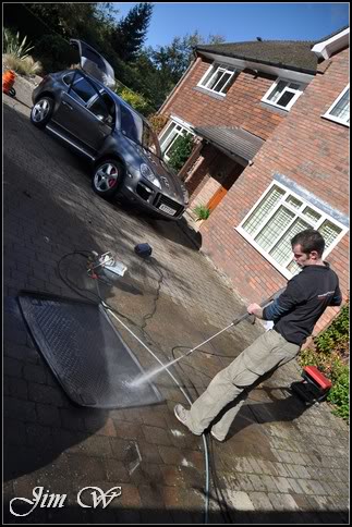

Removing the rubber load liners from both cars, soaking in G101 and scrubbing before rinsing and leaving to dry in the sun.

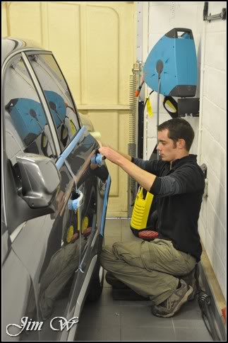

Not many photos taken throughout this stage; with time against us, we just had to crack on. Menzerna Power Finish 203s used to lift the surface movement and lighter swirls.

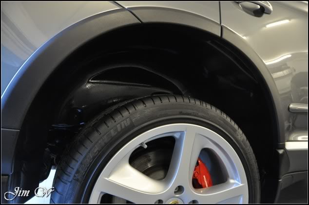

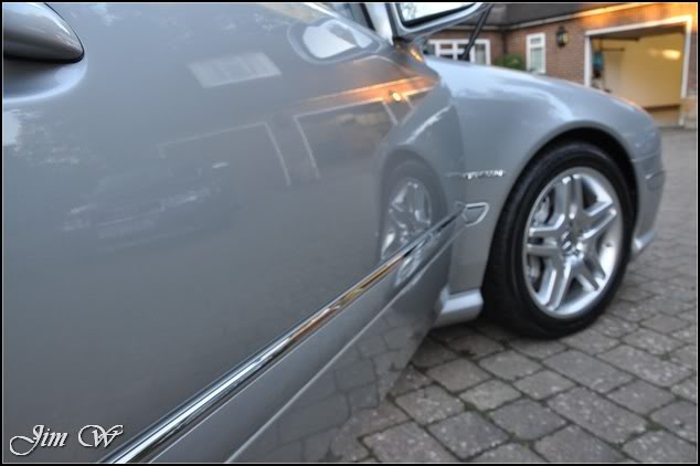

With the machine work out the way and an IPA wipedown given on both vehicles, they were finished with Collinite 915 Marque D'Elegance wax and various dressings/finishing touches attended too (arches, tyres, wheels, trim, glass, exhausts, engine bay etc)
Plastics dressed with Megs All-Season:

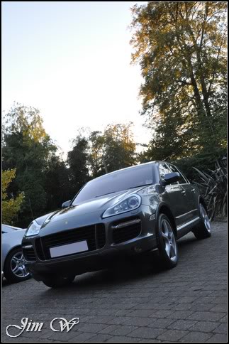

With the glass being the only thing left to do, we hurried the cars outside to grab a few final photos before we lost daylight completely.

Jonny taking on the Toothpickery work:

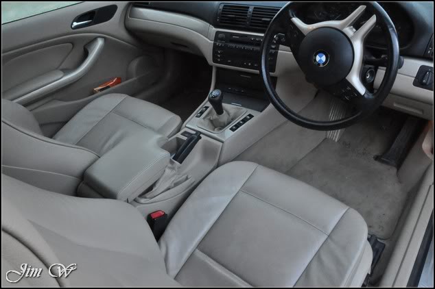

Little did we know, the interior on the BMW was of a light brown/cream colour. Take any 10 year old car with a light coloured interior and chances are, it’s seen better days!
Today, I barely even touched the Golf! By the time I had finalised the ‘tidy up’ on the BMW interior, Jonny had fully cleaned, clayed, cleansed and waxed the Golf and was waiting on me to finish up so we could swap.

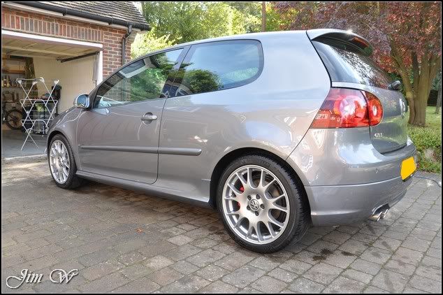

The Golf’s paintwork was cleansed with Poorboys’ White Diamond, and, much like the Porsche and the Mercedes, protected with Collinite 915 Marque D'Elegance for max durability.
With the Golf making a daily commute to the train station to head on into the city, it had accumulated a fair amount of iron filings and rough fallout that had bonded to the paints surface.
Aquartz’ Iron Cut made light work of this and we were able to remove all contaminants with a single wipe.
Meanwhile, I’m battling on with the BMW interior.
The rear shelf where the hood folds into was a little dirty:
Lots of grubby areas on the plastics and leather:
Armed with AS G101, AS Bio-Brisk, a JML Magic Sponge, a VAX 6131 extraction machine and lots of patience, we were finally getting somewhere!
Before:
After:
Jonny lending a hand with the mat extraction:
And the colour of the water from extracting the mats properly:
Here’s my attempt; this was the second bucket of warm water used to rinse the leather cloths. After the leather was cleaned, a thorough damp wipe was given to help clean up residues and any smears still present.
As Jonny had already cleaned the mats, I was just left with the carpet. Scrubbed with Bio-Brisk and then flushed with the VAX, I’d say they came up pretty well!
(Water collection from the carpet cleaning stage)
A massive (well needed) improvement.

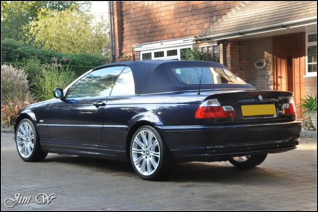

BMW was cleaned, clayed and cleansed with PoorBoys’ Black Hole before protecting with Collinite 915.
Nice line up in the garage now:
