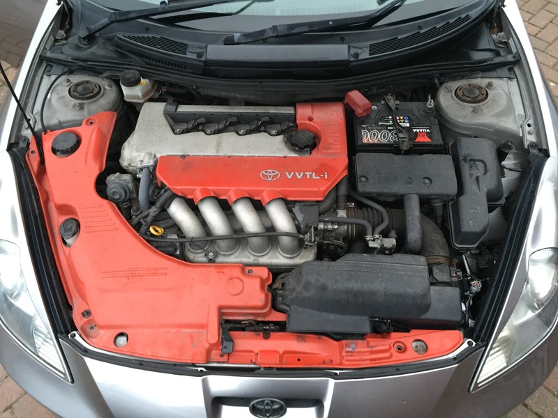

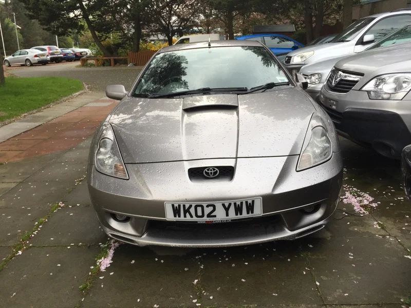

So I bought this on Saturday, I was fed up of putting fuel into my Shogun Sport V6 and my criteria was cheaper on fuel, tax and insurance. It will just be used as a stop gap for the summer between rebuilding my A4 Avant Audi engine and the selling of my jeep.
After searching through all the local rags, gumtree, FB and Auto trader, I went and looked at a good few cars ranging from a 1.4 Seat Leon to 320ci E46 BMW's to Audi a3's, all of which were being sold as 'excellent' or 'mint' condition in some cases, most were riddled with faults and most importantly for myself who doesn't mind doing a few mechanical jobs the body work had seen its best, that was until I seen this thing sat at the side of a local dealers forecourt. I managed to speak to the dealer at 7pm on Friday and asked if he could throw a bucket over it and I would come for a look on Saturday, the car itself had sat around for circa 6 months waiting to be retailed after said dealer had been broken into and various cars/equipment being stolen. I turned up on the Saturday, some air was put in the tyres and the car jump started, I took it on a short run to clear the brakes and give it a little test drive... returning quite happy with what I had seen and heard I offered some money and I was on my way home.

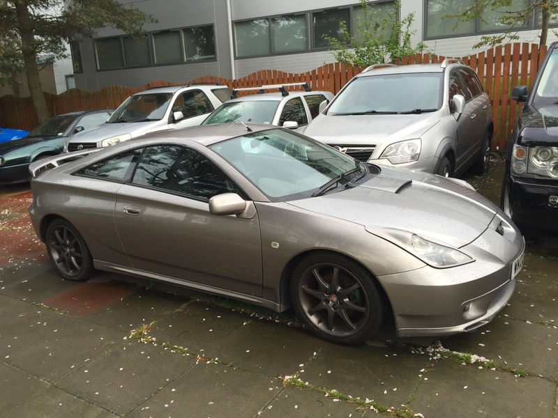

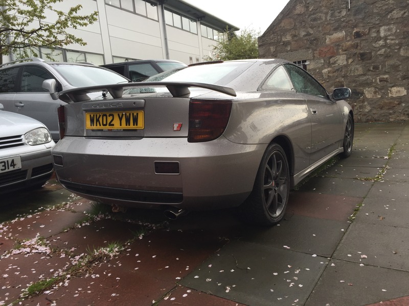

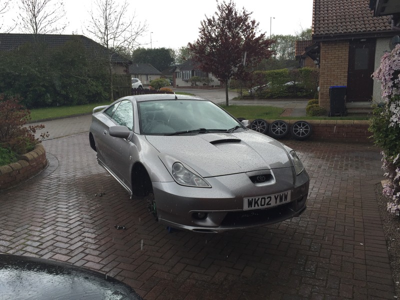

So the car is on 75,000 miles, it's the more sought after 190bhp model and is also a t-sport so the upgraded splitter, spoiler, skirts, leather interior, double din head unit/cd changer and projector headlights from what I know, it also has a detachable tow bar haha which I'm told the previous owner had used for a mounted bike rack, quite handy for myself tbh to shunt my trailer.

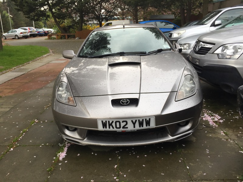

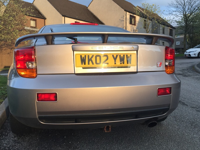

Some pics as it was bought.
5 alloy wheels which is a bonus.
The car has some doubtful 'mods' and colour choices but nothing I won't put right myself quite easily.

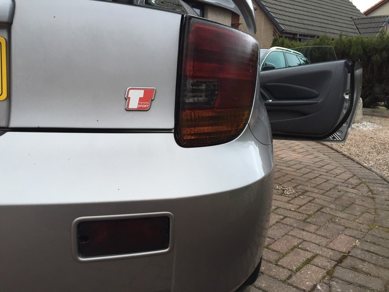

Fly eye tints on all rear lights.

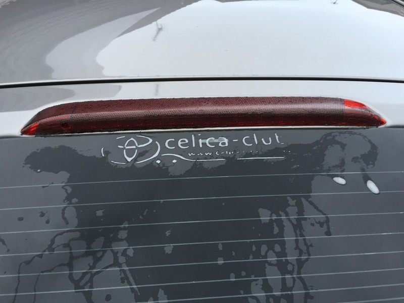

Celica stickers on rear and side windows.

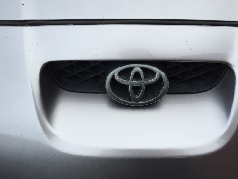

Painted badges.

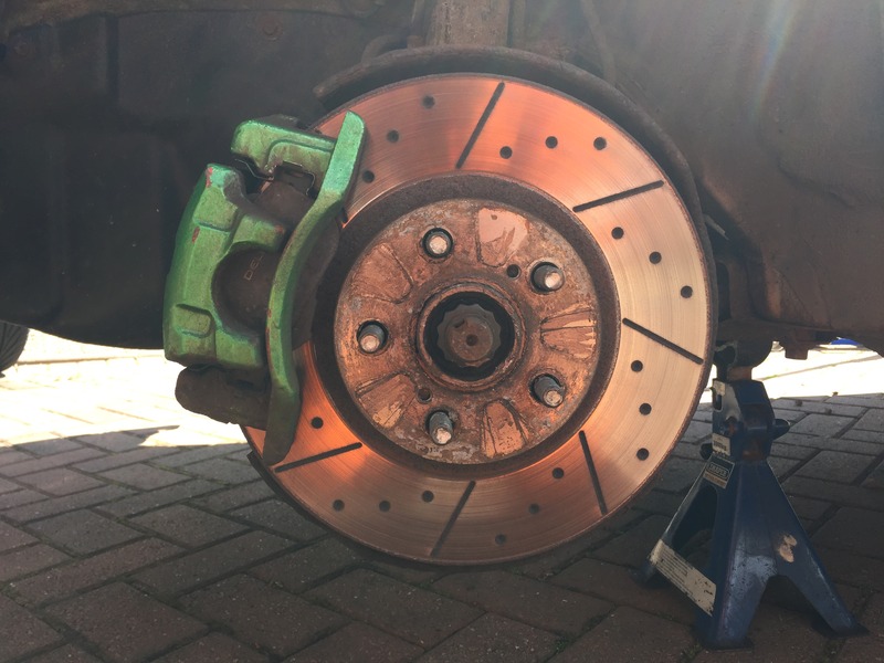

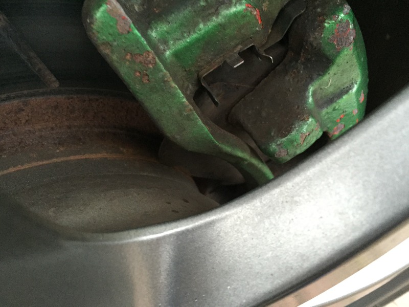

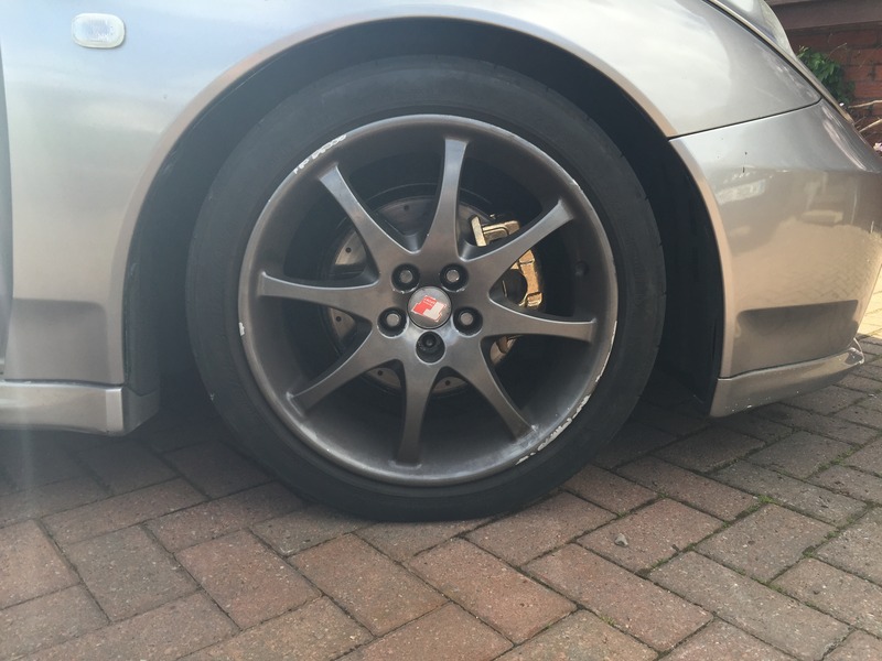

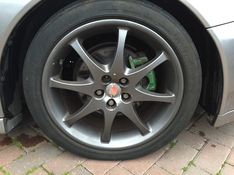

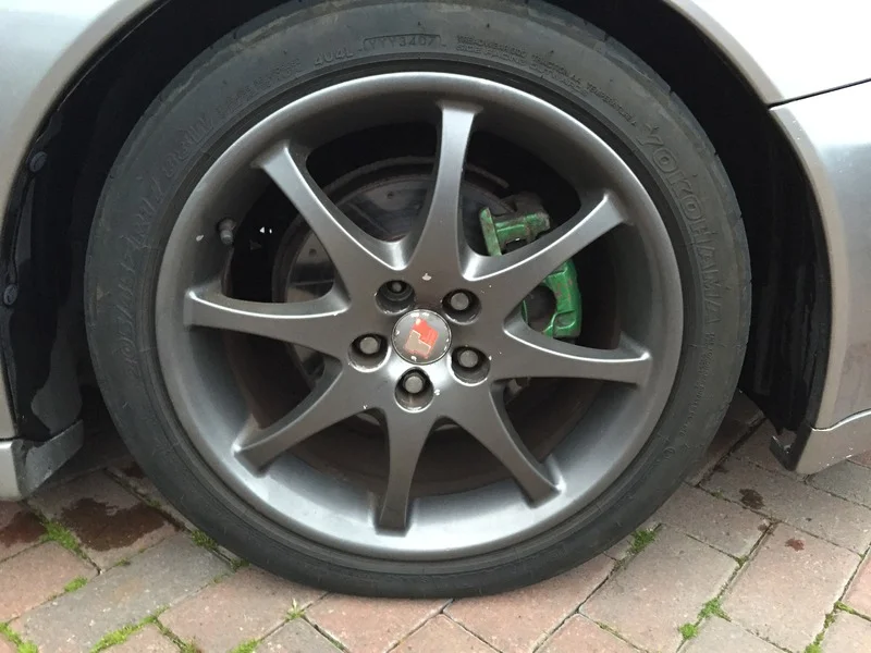

Green calipers, including slipped anti vibration pad that was rubbing on disc.
Painted engine covers.
So things that flagged up on the test drive were the brakes needed cleaning up from sitting around, nearly new discs and pads all around though, there's a wheel bearing or two needing done but it's hard to tell as these things have a lot of cabin noise, wheels and splitter need some attention, the splitter is a weird one as it's literally just the splitter that's stone chipped to death. Missing wheel nut from where there was a missing locking key socket and the lockers were removed, new window wipers and an exhaust donut needs looking at, there's a small blow form the front section. Also I'll be doing the cam lift bolts which are only a few pound by themselves but you have to remove the rocker cover and get access to the VVTI unit, this is just a precauitionary measure from where they can shear and are quite a bit of work to resolve at that stage.

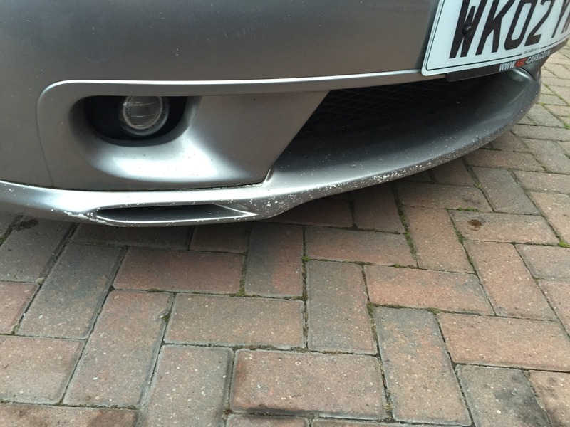

The wheels and splitter will be getting some rattle can attention when I get a chance and I'll throw a set of half decent tyres on.

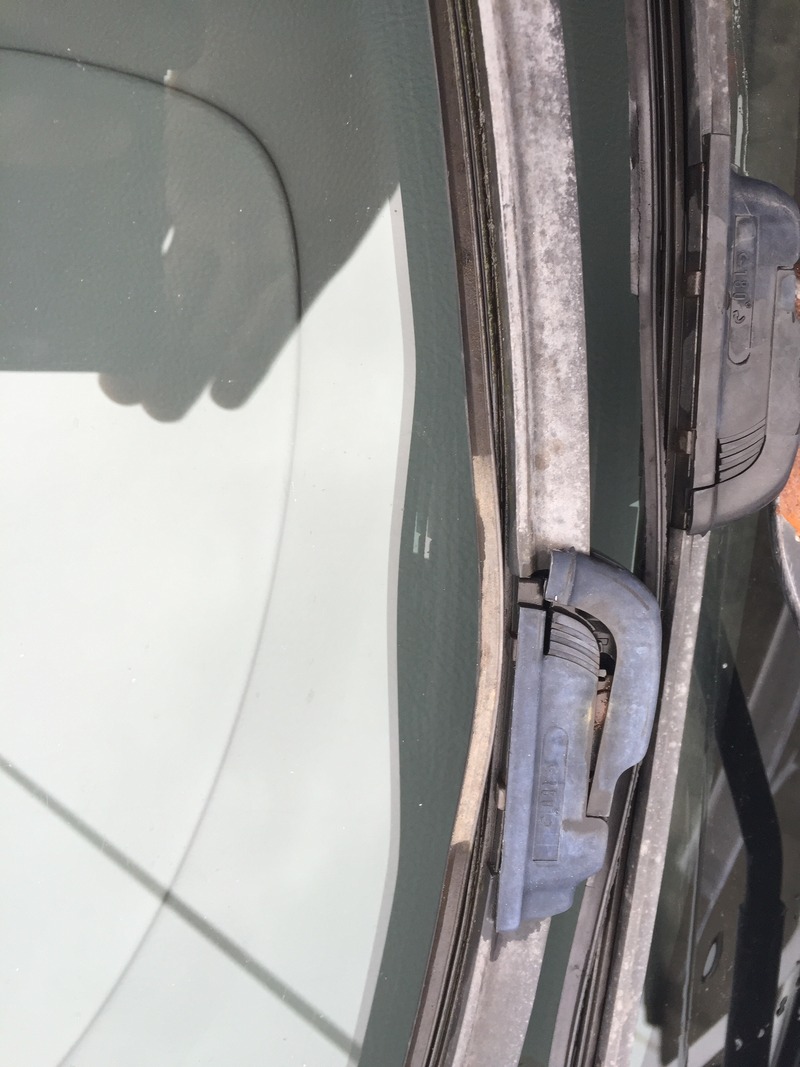

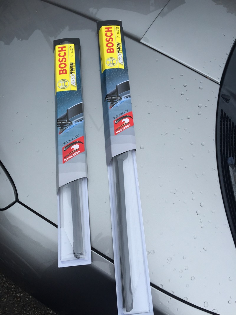

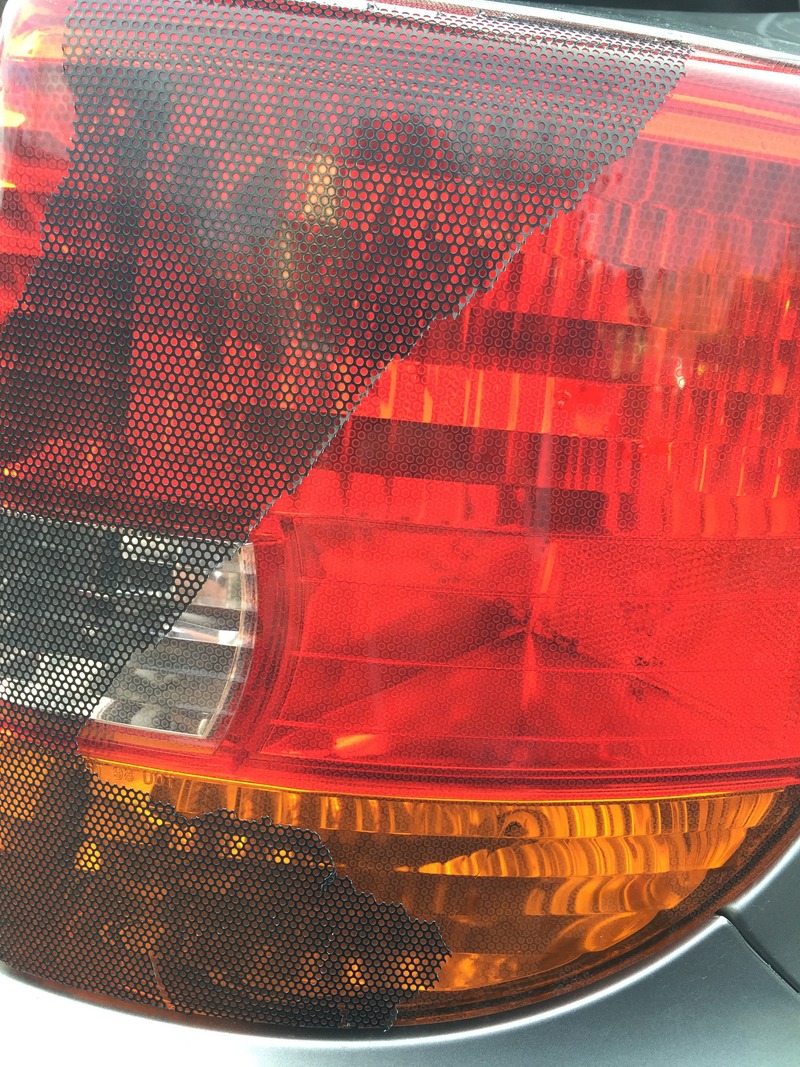

So today I started to look at some of the jobs that didn't take long. I bought some new wiper blades which were well needed and I removed all stickers and fly eye wrap. Already looking better IMO.ill strip the brakes down over the coming days and just out some more miles on it to see if there is anything else that needs looking at, seems a good one though.
Old.
New.
Half way to removing fly eye.
All removed and lenses quickly polished.

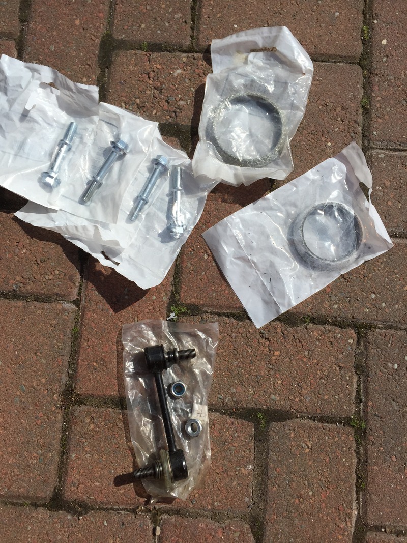

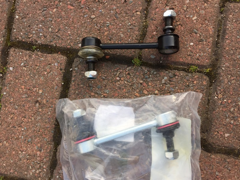

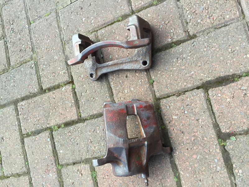

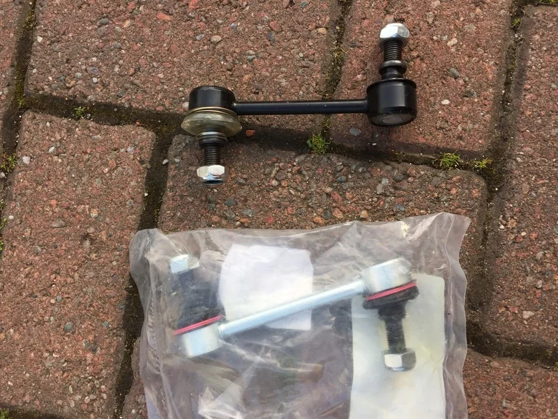

Thank feck for pattern parts, Toyota were needing circa £90 for this lot minus arb link (which I found knocking about the boot) whereas I got them for a total of £14.92, total spend including the wipers is at £37.96. I hope to spend less than £250 all in.
Sod's law, get it up off of all fours and the heavens open :rage:
  Cup In bits
So I take back what I said about pattern parts, typical motor factors.... They can't organise a pish up in a brewery.

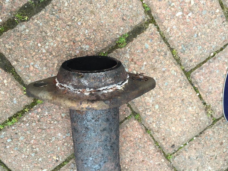

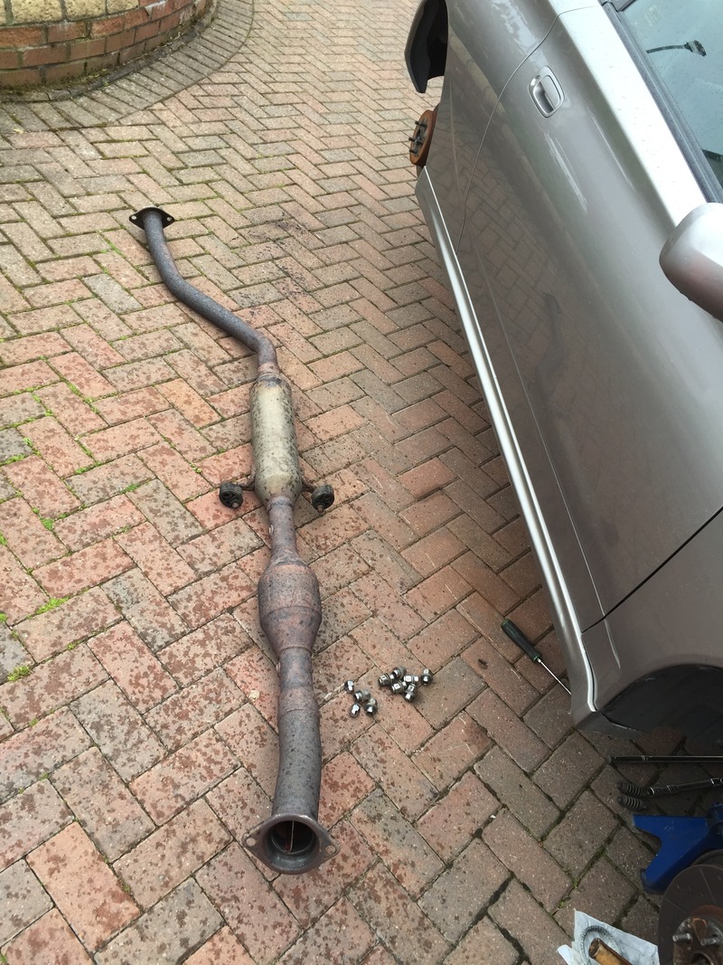

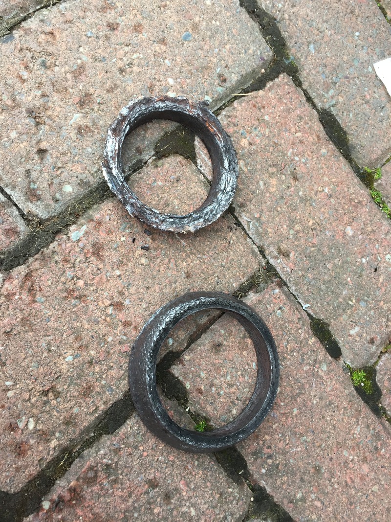

I got the exhaust off and sure enough the donuts had seen their best. All was well until I went to fit the manifold to centre section donut. It's was nothing like the part I had taken off and that was all they stocked :rage:. So back on with the exhaust with copious amounts of exhaust paste, I'm now driving a tractor sounding car but I will buy genuine donuts and get that done soon.

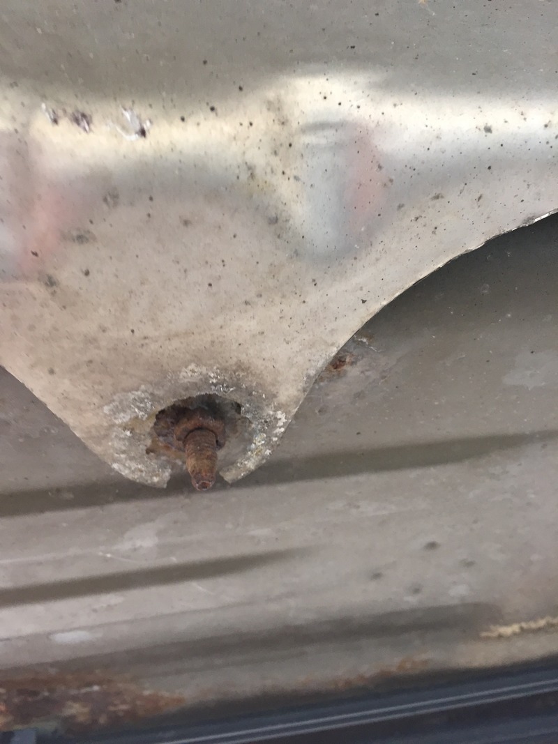

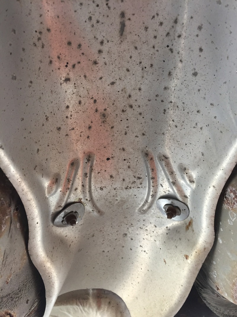

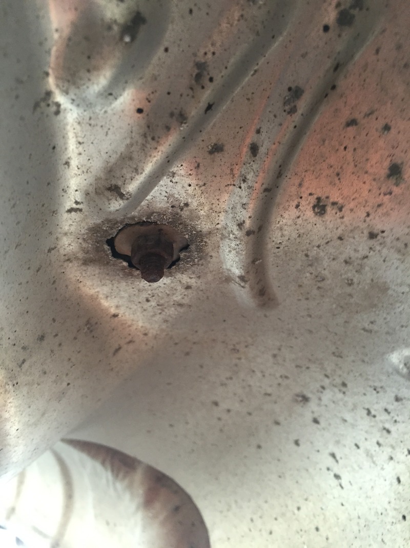

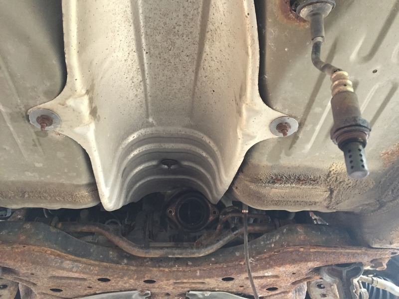

A couple of the heat shields he rotted around fixings so I made up some curved washers to secure them before the exhaust went back on.

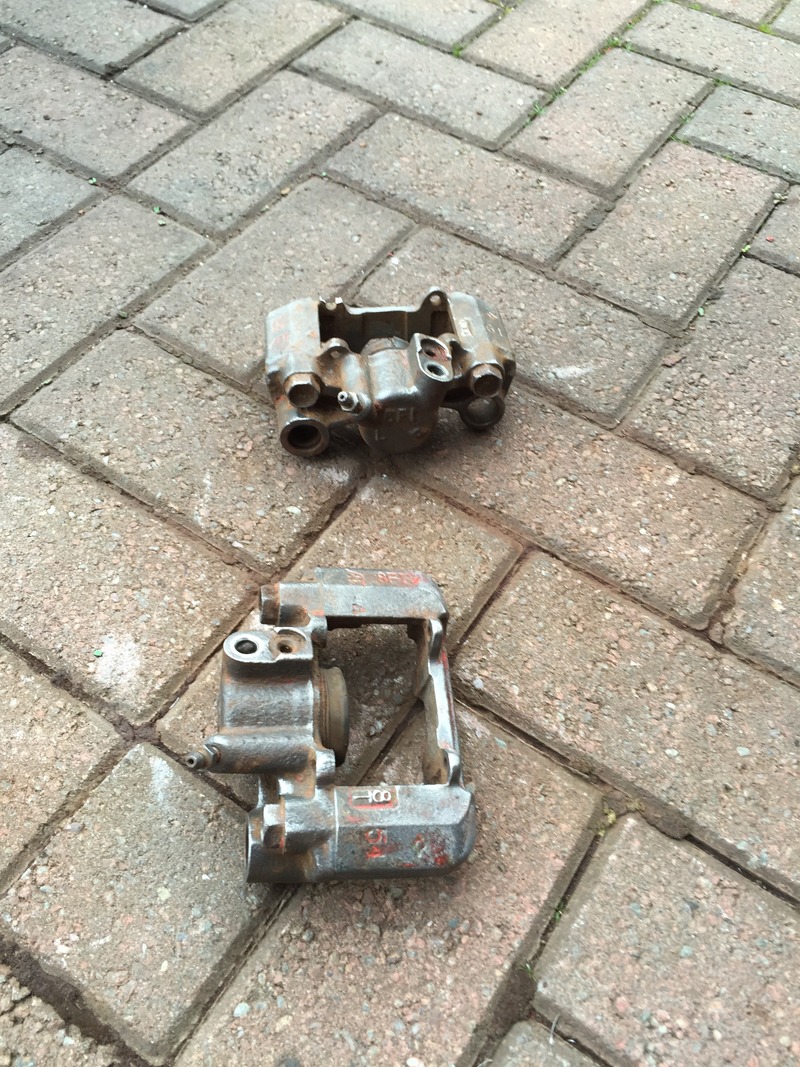

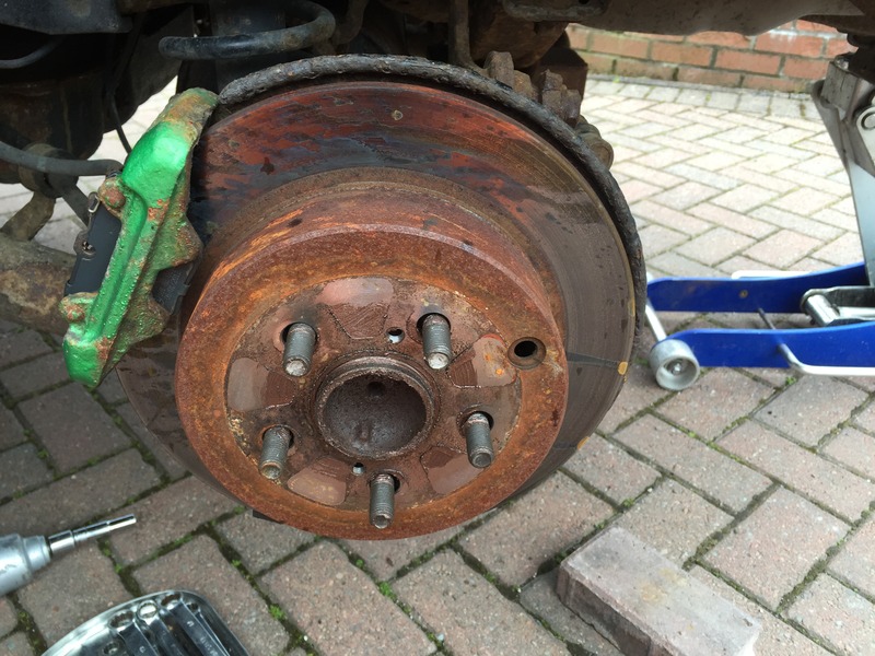

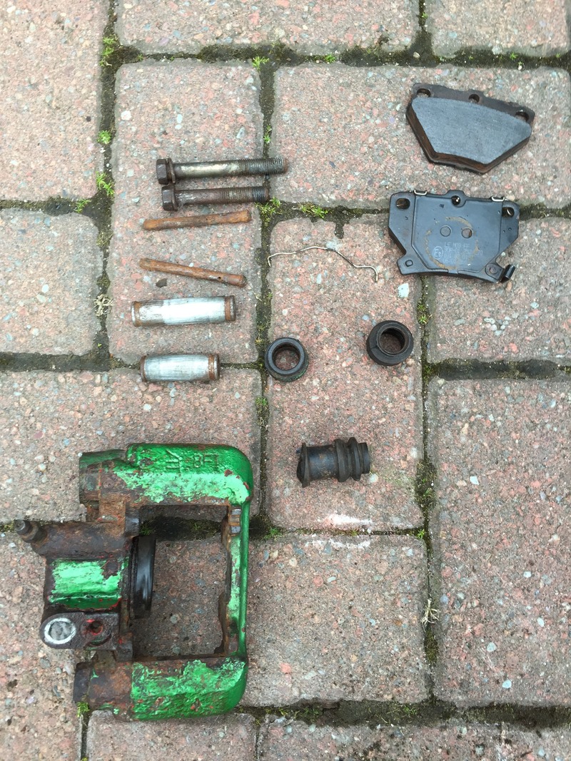

I then moved on to the rear brakes inbetween down pours to get rid of the lovely caliper paint colour.
I stripped both rear calipers, cleaned up discs, calipers and backing plates.
Poor pic but I then have gave everything a coat of hammerite black to keep things fresh.

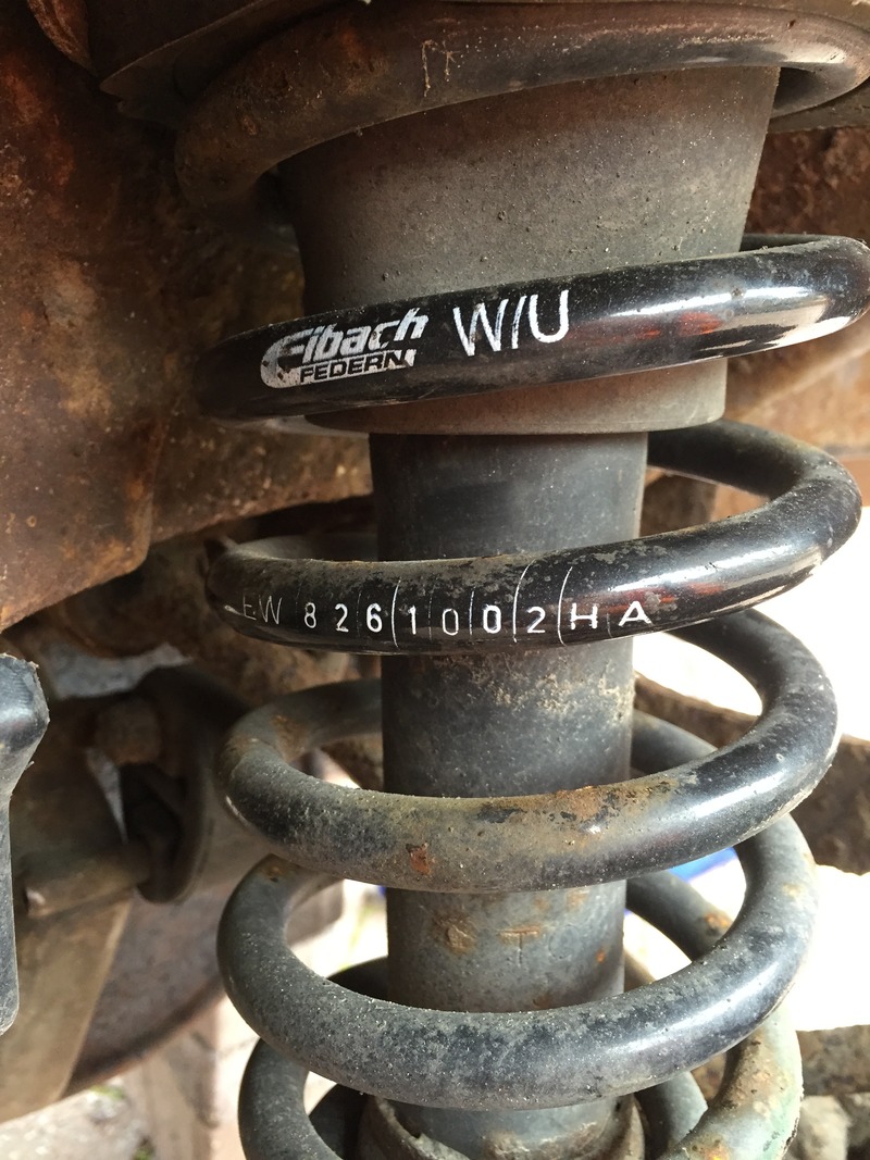

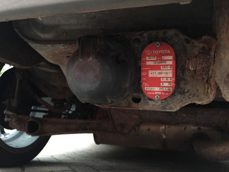

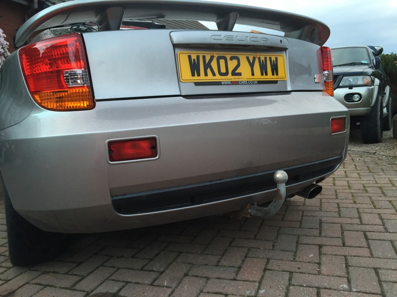

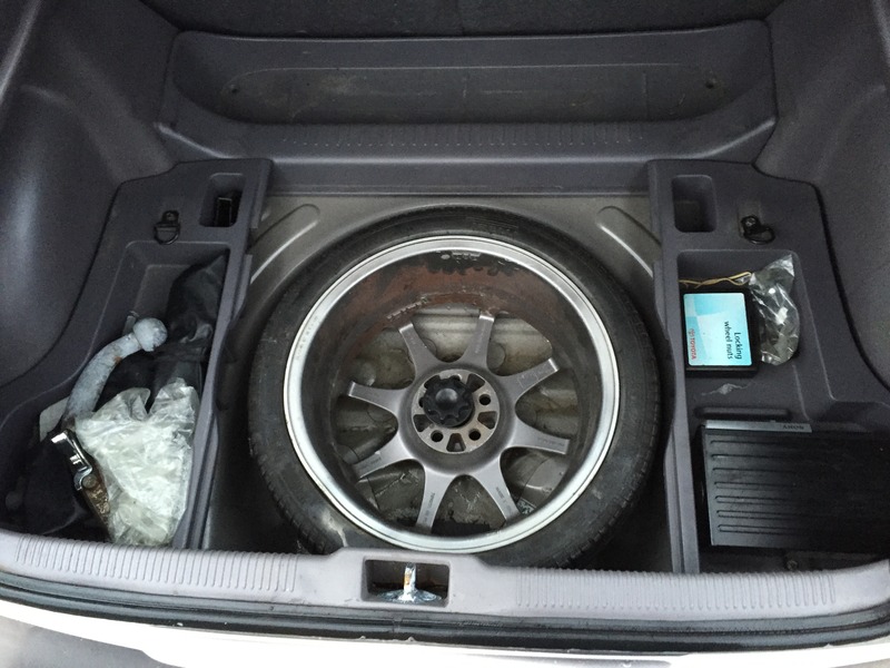

While doing the brakes I noticed its fitted with Eibach springs so that's a bonus and also the tow bar is original Toyota, why they make a tow bar for that I don't know haha.
Smart......
That leaves the front brakes to strip and clean and the exhaust to be redone later in the week.
Any suggestions for some half decent tyres for under the £200 mark? 205/45/17?
It has Parada's on the front at the moment and as you would expect it's under steer/wheel spin central. I just want a good all rounder, it's not going to see track... Or not yet, I might crumble this summer and book it up.
  Cup In bits
Tow bar needs to be rid of. Car looks nice, do like these.
I'll take off the bumper, clean up the tow bar mount and paint it all black so it can't be seen. If I take it off it will leave a cut out in the bumper which will annoy me more than having the bar itself haha, that and it's handy for shunting around my car trailer.

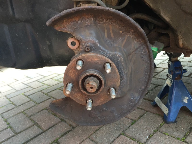

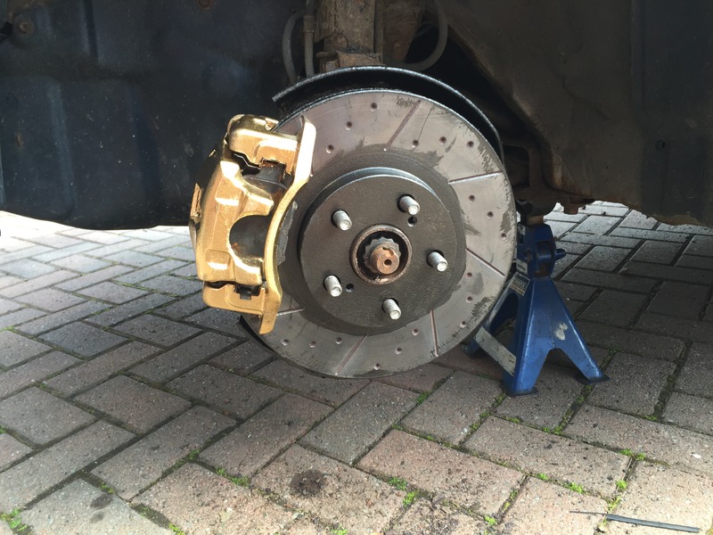

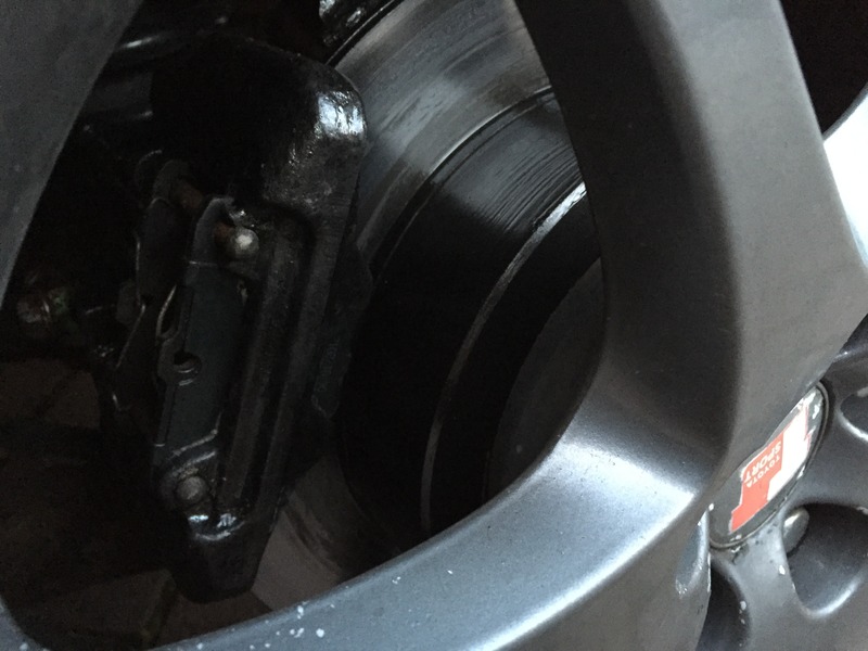

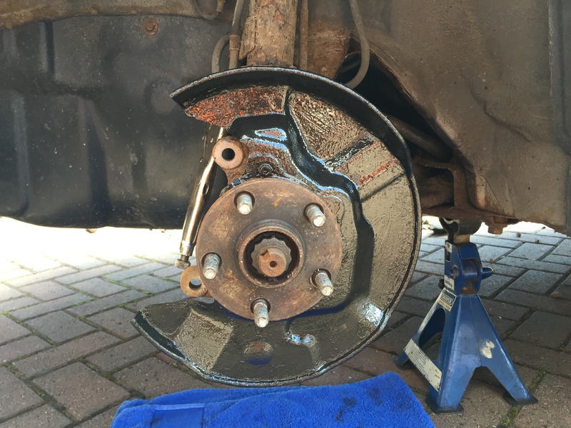

I set about the front brakes today.
What I started with.
Cleaned and painted the backing plates quickly.
Chipped off any rust and wire wheeled of the remaining paint.

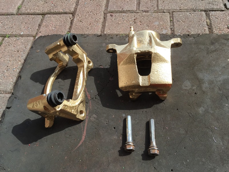

Painted the fronts gold this time as I think it suits better, unsure wether to do the backs to match or run the gold/black look.

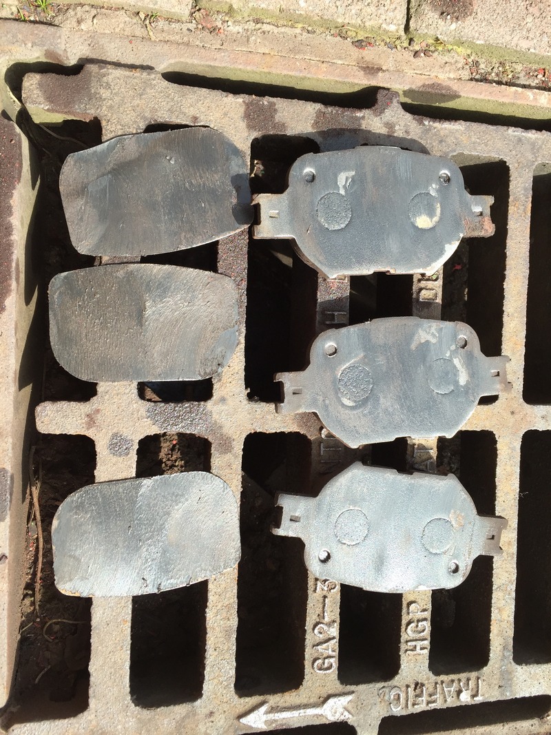

The anti vibration pads had parted from the pads so I cleaned and re applied some adhesive to secure them back on.
All built back up.
And after a spin around the block to clear the excess paint from the discs.

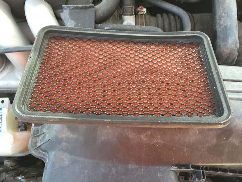

I found that it has a Pipercross filter fitted too so that's a bonus now all the service bits are complete, the dealer had done the engine oil/filter, pollen filter... I'll clean the air filter and maybe do the box oil to keep things right. The brake fluid was flushed through while doing the calipers.

Next up is the exhaust gaskets again, I bit the bullet today and ordered from Toyota to the sum of £58, add that to the £20 for wheel balancing and the previous costs, the current total is at £103.96 taking into account the returned gaskets that were wrong. I have ordered a rear wiper, aerial to rid it of the awful bee sting job and also I'll get some alloy lockers bought too.

My exhaust gaskets arrived today from Toyota and hopefully the Big Red front caliper rebuild kit arrives in time that I ordered today, the front brakes weren't releasing how I would like after the strip down/paint so I'll do both while I'm at it. There's a rear set of nipples coming too as they're not looking too clever.
I also have a RARB link on order to make a pair with the one that came with the car, it would be rude not to for £18. The VVTL-i lift bolts should arrive within the next week along with the rocker cover gasket to do that job and also a rear aero wiper to complete the set. That lot so far stands me circa £180 so I should come in under my £250 budget by the time I paint the wheels and splitter. No doubt I'll find something else to tidy up/renew though.

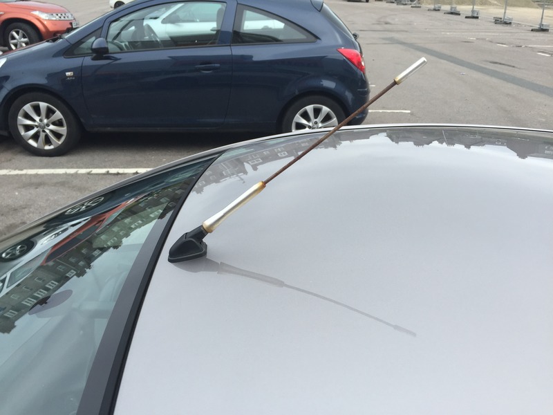

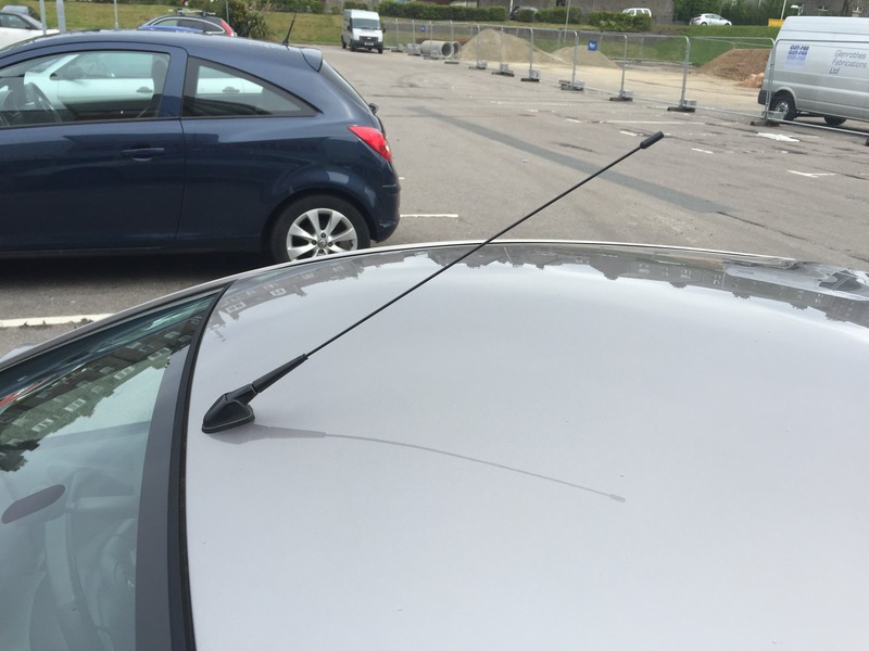

I'm rid of the awful Halfords special aerial and I'm getting all my needed channels now

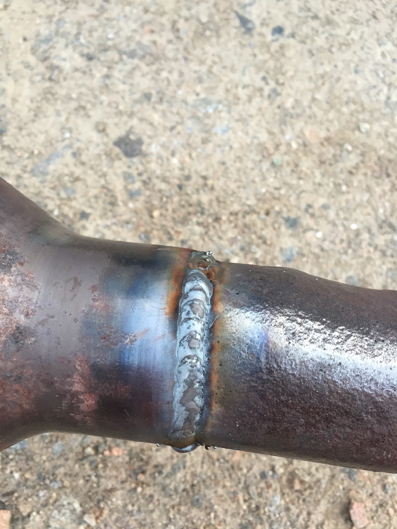

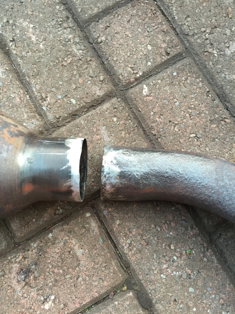

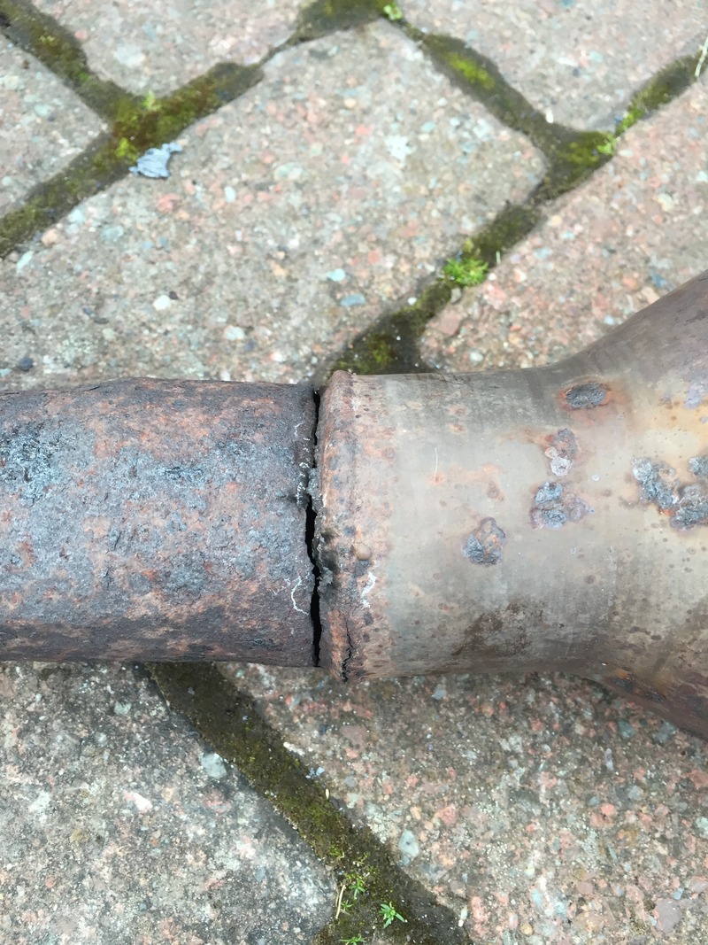

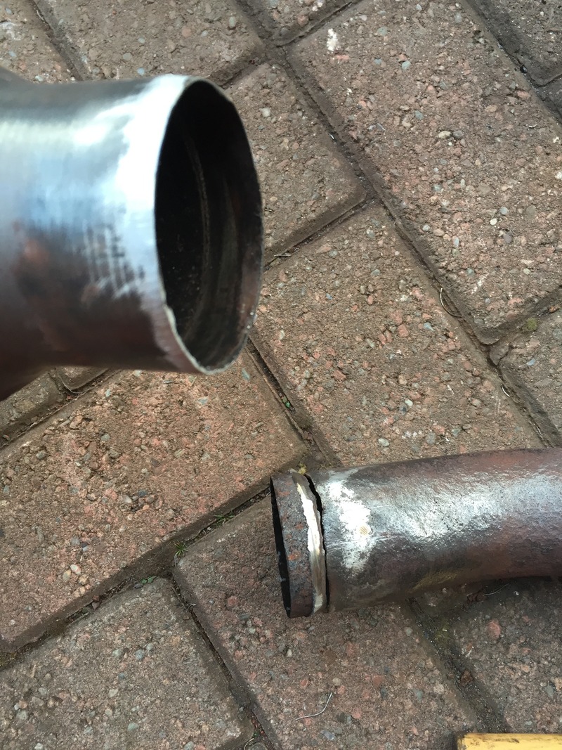

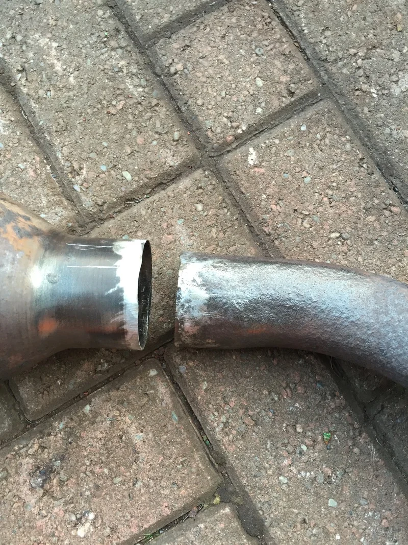

So attempt no. two at the exhaust tonight after receiving the gaskets.
All was well untill I spotted this which I have no idea how I missed it.
I was pretty pissed knowing I had no gas in my welder and it being Friday night, nothing's ever easy. I chopped and prepped it anyway and went down my lock up with the hope someone else was knocking about to get a shot of their welder. Glad fully there was a welder going spare so stitched it back together.
That wasn't going to be the end of the exhaust woes either, not having the luxury of doing it on the car it was welded about 5 degs out of c**k and I lost 10mm in length chopping it so I'll have to extend the rear section by 10mm and orientate the flange for a perfect fit, that's for another day though.
It just wasn't my day, having removed the boots and painted the black RARB link to match the other I realised there is about 5mm of difference in length between the two, so that's another job to be looked at.
