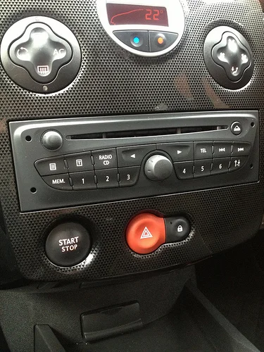

The settings button is on the original head unit on mine. The button looks like a pair of volume sliders.
nothing in any of the setting fella, going to pop up to renault at some point and give them a look - think its a software thing they can fix no problem

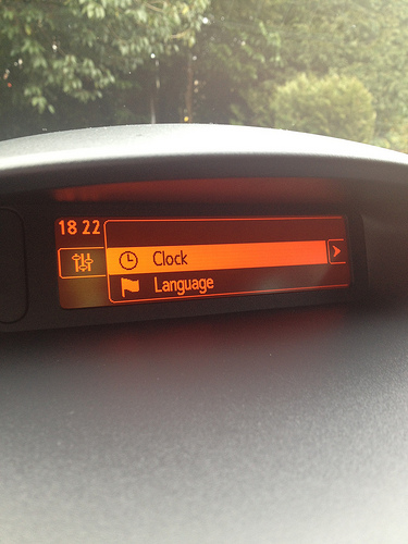

These ones?

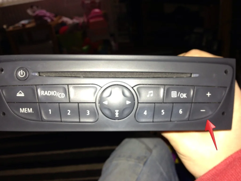

Again, I don't know if the radios and screen fitted were different if you had the RS Monitor from factory, but heres mine.
You can see the settings button in the bottom right hand corner.
Radio -
Screen -
Had a idea... It said on the CLIP "clock" - present... I bet that's when my old one had the clock built into the screen not going through the radio?!
Apparently so, the guy reckons the RS monitor will work too... just plug clip in and change the configuration. You'd need a digital monitor too
