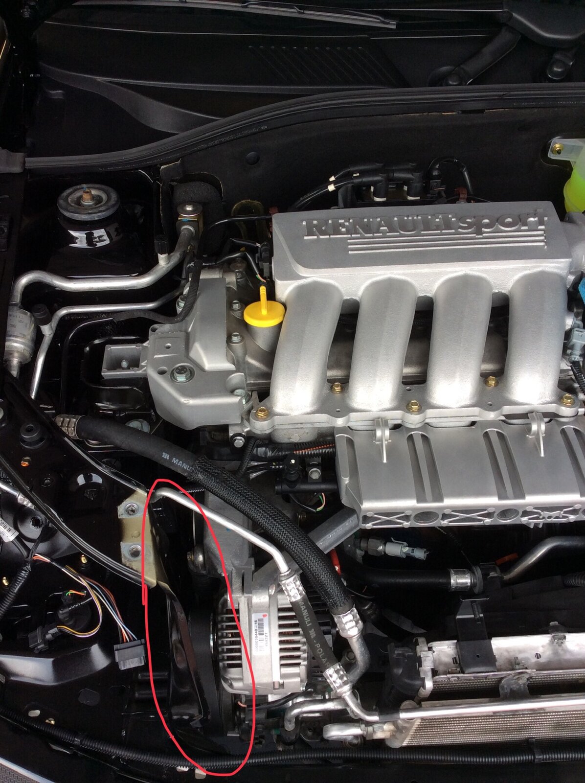

So changed my alternator as it failed followed the guides and very please with myself.
But
Started it up and now the belt screeches loudly, if I press in the alternator it change tone but donee not go away. If I give it a little Rev it does though but comes straight back.
Can anyway help rather cross now and worried I have caused more issues, it looks ok.
I have ringed we’re it it’s screeching from
Thanks

It’s ok I have solved the problem it was not the belt it was coming from the top manifold. I had removed it and when replaced torqued the bolts but it seems to have settled and they were not tight enough but once tightened high pitched squeal went
