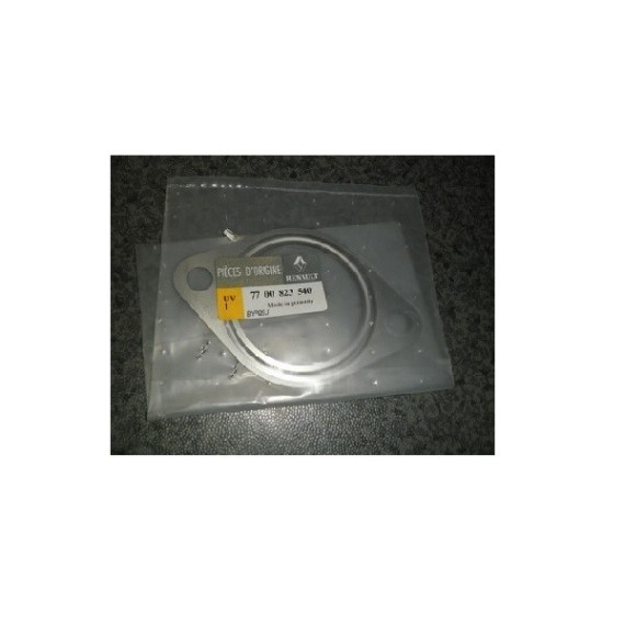

Yes, seen these. But they don't seem to come with a gasket between manifold and Cat?
Is it not needed- or do you buy seperately
Seems a bit daft to buy a fitting kit without a gasket

They do, comes with 2 bolts, 2 nuts, dohnut gasket, 2 fibre washers and 2 steel washers and 2 springs

what about the flat gasket manifold end?
1408605
  monaco 172
Manifold to cat is the link I posted.
The only other you will need is cat to centre section which looks very similar to your link above
Yes, my error. Cat to centre section gasket
Wonder why they don't put that gasket on the fitting pack
