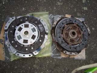

Edit: My old clutch:
Doesn't look that bad, but I don't really know what I'm looking for lol. Just nice to have a shiny new one on not a rusty old one!
  Astra 1.9Cdti SRi
If you put your hand on the front of the clutch plate and you can feel the circle bits, then its worn down, on the new one you shouldnt be able to feel them.
Remember to put the clutch the right way round aswell,
