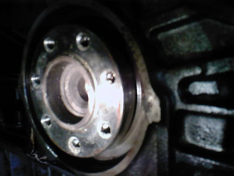

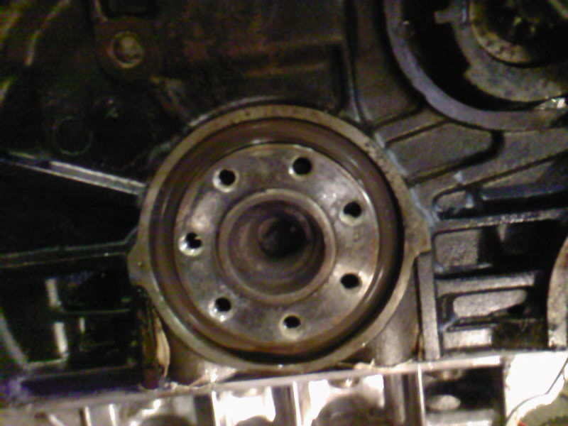

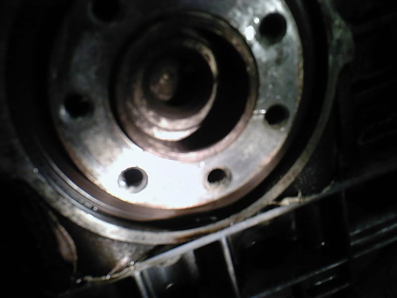

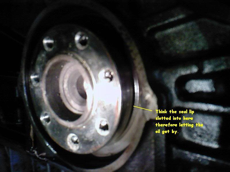

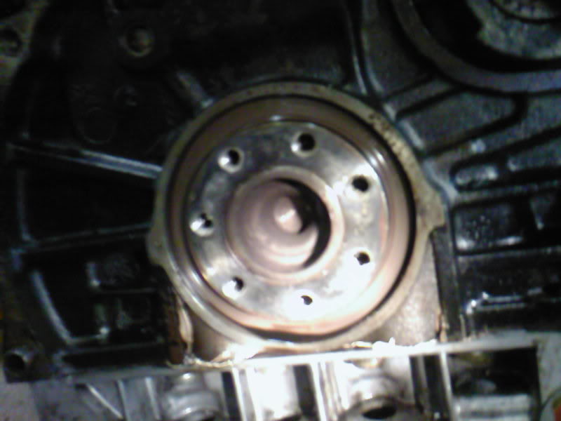

Bump to an old thread. After the oil seal leaked again I am having another attempt at sorting it as I've had to remove the engine to replace the gearbox anyway. Here's some pics. I think I can answer our own wrong doings. As the seal wasn't as deep as the original my dad knocked it all they way back and we reckon that the lip slotted into the groove and it wasn't meant to.
Basically I jsut want some assurance on how to do it right by people who've done this before. First time it failed with a crappy cheap seal from Panjetani's and second time it failed on the Genuine Renault seal. The seal did seem to come out very easily with a screwdriver though, didn't really seem tight enough. So I just want to know if my theory is right before I go and blow another £18 odd on a seal and put it all back together.

yup, it should sit just about flush with the face of the blocks machined surface, knocking it right back will gaurantee a leak.
