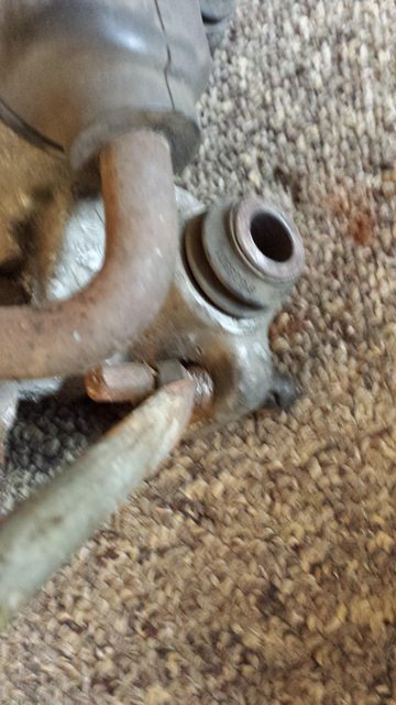

Oggy997 ClioSport Club Member Car 997, e208, I.D. Buzz Mar 15, 2014 #1 Got a binding caliper, plan to change them over although not sure how I get the cable out from the caliper? I just cut it from the 172 but obviously cant do that to the 182 Im fitting it to :/

Budgie Car 330i. E30 Touring. Mar 15, 2014 #2 Screwdriver and a hammer. Hit it out. With the caliper still on the car.
Oggy997 ClioSport Club Member Car 997, e208, I.D. Buzz Mar 15, 2014 #3 Which way? It looks like it goes left to right (looking at the image) but it's not budging. Last edited: Mar 15, 2014
M Mr R. Car A special one. Mar 15, 2014 #4 To the right in the 1st picture. Its rusted in, WD40 is your friend.
Oggy997 ClioSport Club Member Car 997, e208, I.D. Buzz Mar 15, 2014 #5 Soaking it in GT85 now, is it always a b**ch to remove? Seems wedged in.
Oggy997 ClioSport Club Member Car 997, e208, I.D. Buzz Mar 15, 2014 #6 Got it out with a fair bit of force! Easier to get a new one in I hope?

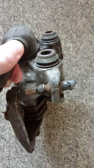

Oggy997 ClioSport Club Member Car 997, e208, I.D. Buzz Mar 15, 2014 #7 (can't edit) I annihilated the residual cable in the spare caliper - I guess it's a new cable every time you fit new calipers? Or was I too heavy handed ?
