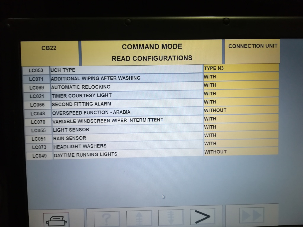

I got a can clip device, and after browsing through menus I landed here:
LC051 rain sensor present.
At least it is in the configuration...

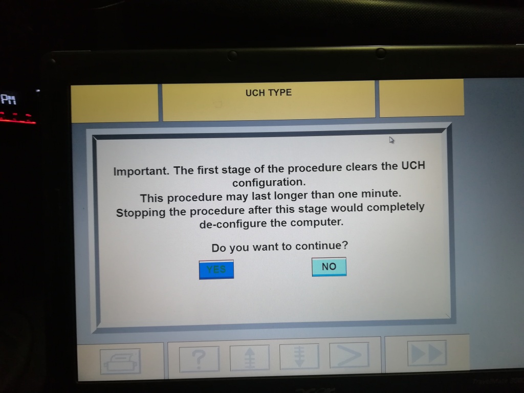

Btw.. If I choose the menu for writing parameters to the uch (which I guess is the right place to change that value) it says this:
And here I stopped... Because I don't know what the procedure will ask. If it will ask only the values posted before there is no problem.. but my concern if the procedure implies something with the key code or something related to the immobilizer that I'd prefer to leave as is.

You need to make a note of the current settings.
It will start fresh, so you might want to know what the current ones are set to incase you want to go back to them.
Can't imagine it would remove the key coding...

Make a note of current config (the pic will be fine) and go for it mate. It will only reset the options listed.
Change the bits as you want then save, make sure the battery does not go flat whilst doing it, wont take long at all so if battery is good you wont have any issues.

Thank you mate, I am pretty new to the clip system so I prefer to ask before doing something wrong and make a mess..
  Clio 172 + Clio200T
Ok perfect, so is ok if I keep that pic already took and start a new configuration with it in mind right?
The battery is fully charged, I charged it the last night amd yesterday I went for a test run.. but to be safe I can hook it up to the mantainer (it's a small racing spark battery)
Thank you so much!

Bit of an update, finally had time to check it out! Did the uch reprog and now everything is fine! Finally got back my wiper functions !! Thank you so much. Now Back plalyin with clip to sort some other lil things.
