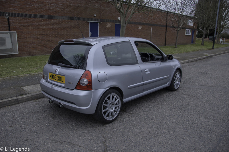

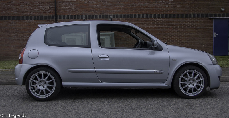

Anyway, back to the Clio. After seeing how clean the car was and with the extra bits fitted a deal was struck. Here is the car:
A 172 with 69k with a stack of service history including bills from Renault from when the car was relatively new! This car was quite a change from the other tired sheds I had seen! The cambelt had been changed at 29k with it seeming to new new Brembo Max discs braking OK (albeit a little noisy). The extras also included the following:
Refurbished Speedline Turini Wheels with Conti and Toyos all round with good tread
182 Cup rear spoiler
Proflow 182 esque Stainless Rear silencer
Renault Sport Floor mats
Cup/Fabia? front splitter
Carbon Fibre washer jet blanks
Quantum Remap

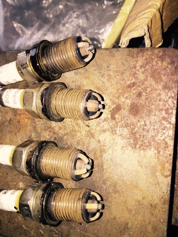

After going through the receipts I noticed someone had put the wrong spark plugs in ; Bosch Super 4s over the NGK Platinum plugs. These were changed with a full service being given at the same time. The plugs certainly looked interested after 20k miles worth of service:
At the same time I piled on quite a few miles onto the car, using it to get a friend's new purchase amongst other things ; a Pug 106 1.5D. Through all of these trips the MPG was surprising, although it was a reason why I bought the car. I am seeing around 28MPG around town, mid 30s generally and low 40s on long motorway trips keeping below 80MPH. Not bad at all IMO. Those figures were obtained via the 'tank to tank' method, not via the optimistic on board computer.
With the cambelt and dephaser (it was rattling) being due for a change at 70,000 miles as a result of the belt being 5 years old I gritted my teeth and sent the car down to BTM Performance. As always he lived up to his reputation quite well. When he offered to drop the car back to me I did warn him of the car's iffy brakes! Sure enough he did call them awful :lol:. However, the car was given a clean bill of health otherwise with the Clio said to be one of the cleaner examples :).
With this all done it was noted that the previous specialist had the timing ever so slightly out ; maybe they used a dial gauge to find TDC as opposed to the timing pin, who knows?

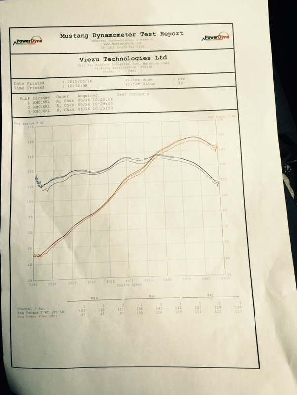

At this point it went down to a Clio Sport RR day to see what was what. For the at the wheels power it was up there with the 182s

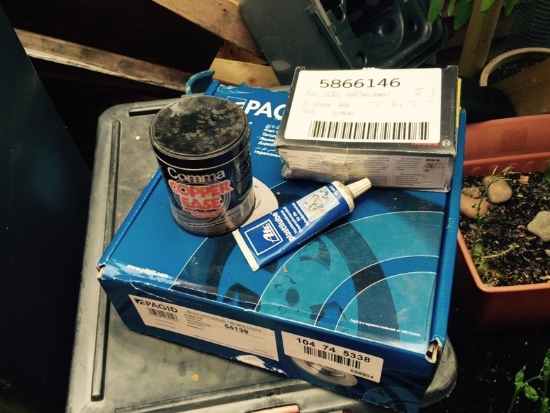

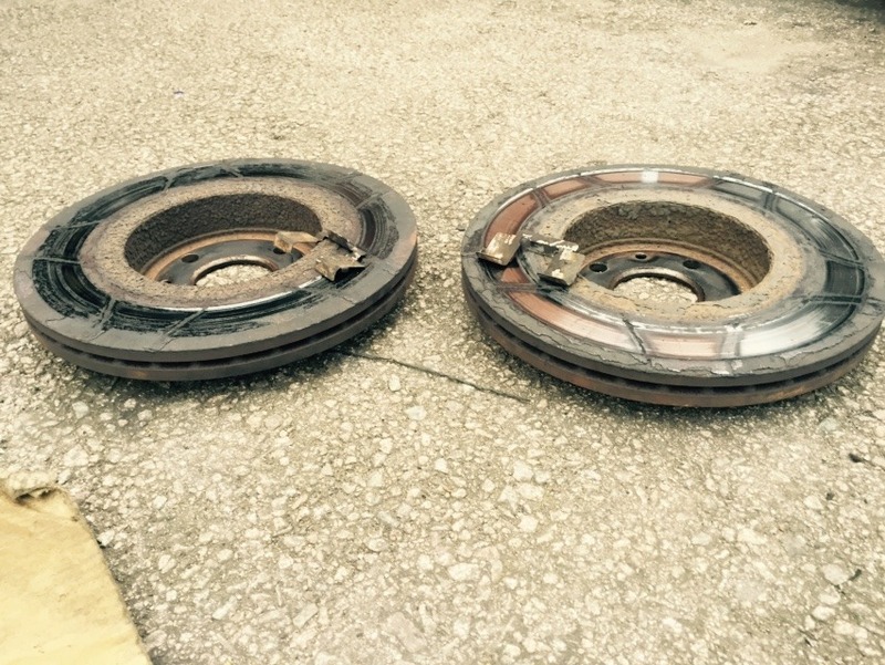

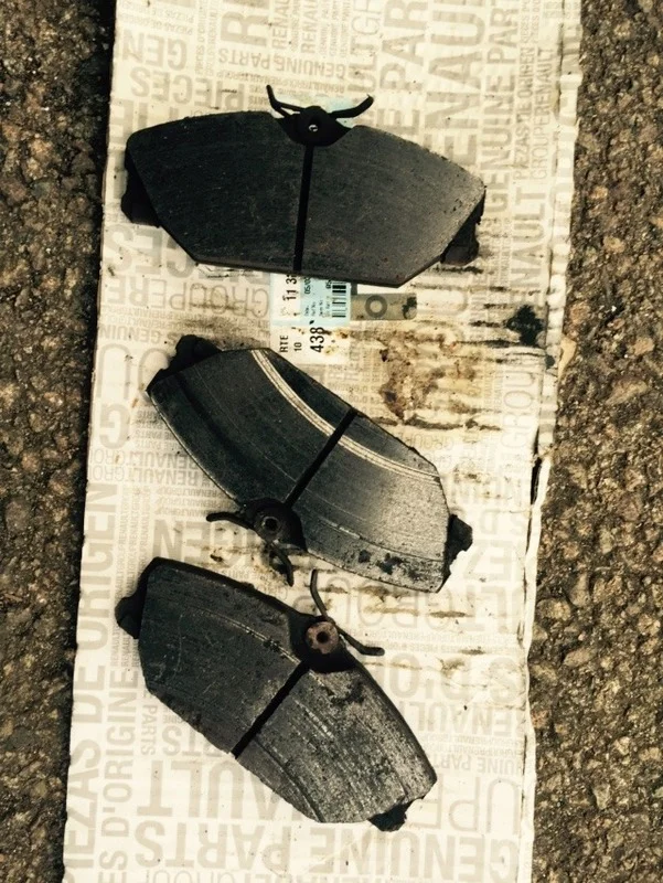

I just had the brakes left to do ; when the specialist drove the car he described the brakes as 'shocking' and when I lent the car to my sister she did comment on how the brakes were interesting for bringing the car to a halt on the motorway. Something had to be done.
The specialist noticed that I had the anti-rattle springs in place on the pad carriers, feeling that this caused my brake pads to seize in and thus ruin the discs. He said to remove them, but I was aware from people who have done this that they rattle like mad at low speed.
Enter stage left:

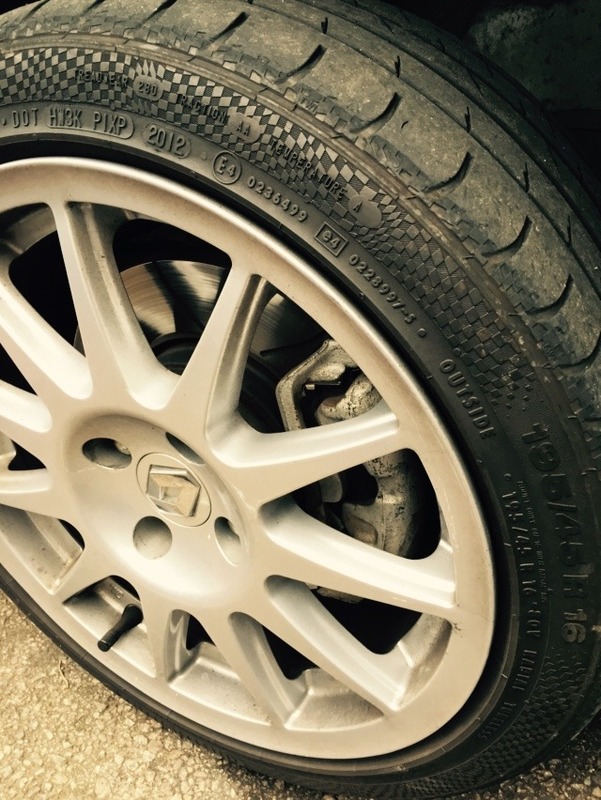

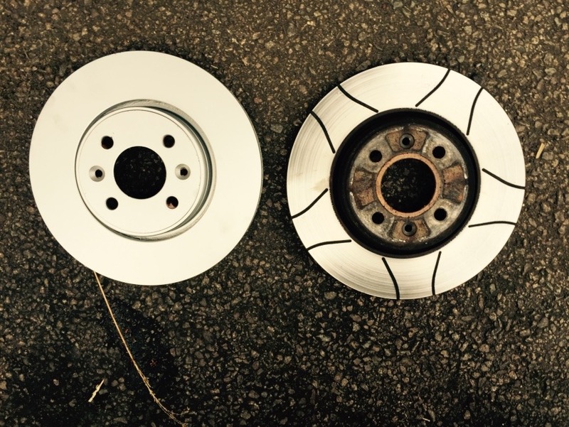

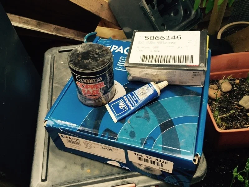

Some discs, OE spec pads, copper grease, brake grease, and some determination:
Initially, everything looked fine:

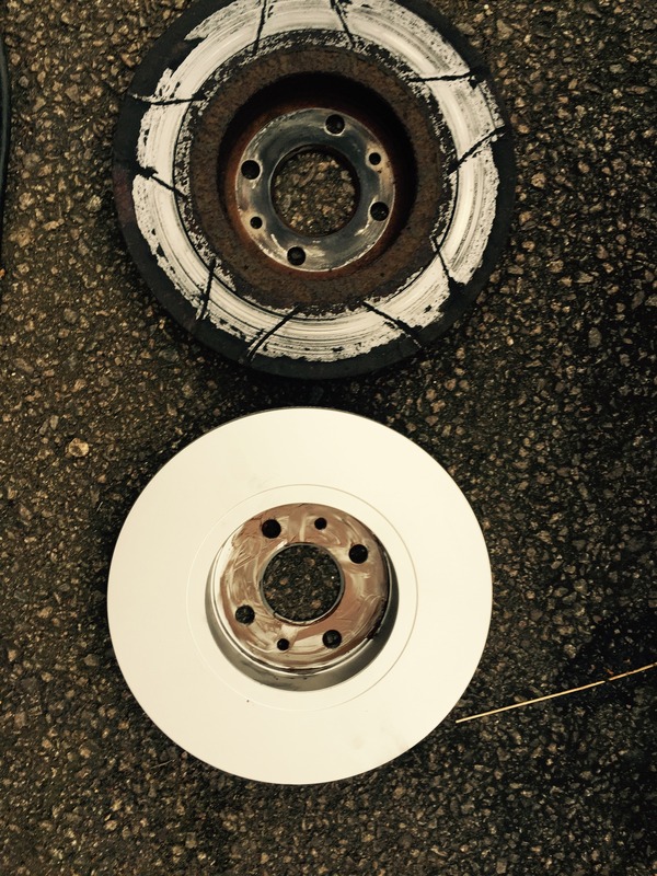

Why am I changing these?:
Ah, that will be why:
Yup, the discs were cream crackered. One of them had actually formed a 2mm step from where it had worn down so that the grooves were flush with the disc in places. I potentially could have cleaned up the plates but I simply bought new instead.

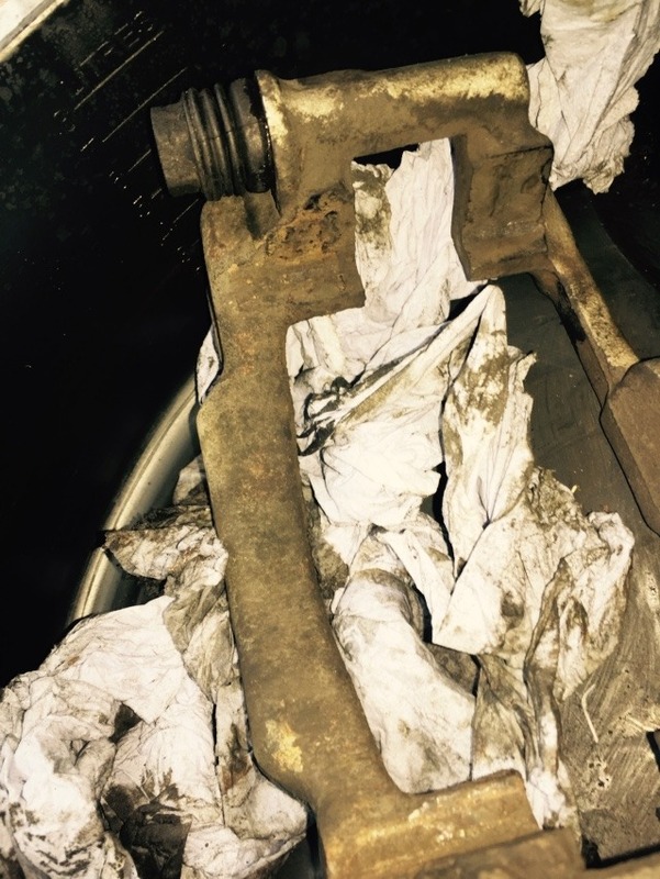

Some people love using copper grease everywhere on brakes but I am generally not a fan, finding that it can congeal and semi seize things. This sliding pin was a case in point:
I think I found out why the brake pads seized into the carrier as well. There was a slight amount of rust build up beneath the sliding plates on the carrier. On 80s Brembo 4 pots, this 'plate lift' (Google will reveal more) phenomenon will generally result in the same issue, meaning that the caliper generally has to be sent away for refurbishing ultimately. With this, I ground back the rust until they were flat once more, put some etch primer down followed by brake grease before replacing the slider plates.
After this it was a simple case of reassembly:

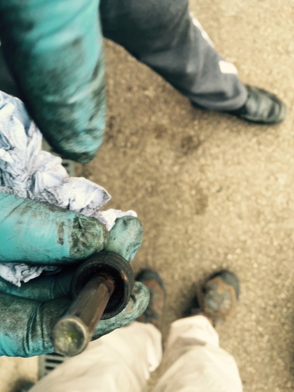

For quite some time, well, since I bought the car the reversing lights have never worked. Car parks had been interesting to say the least. I heard that the gearbox sensor was an issue here but I thought I would check the car out first, given that the gearbox has to be partially drained for the sensor to be fitted due to its location.
After obtaining a new reversing sensor, establishing that it went to a dead short upon closing I shorted the wires out on the car with the ignition on. Sure enough the reversing lights worked for the very first time ever in my ownership. With that in mind I ordered 4 litres of Elf's finest; Elf Tranself NFJ 75W80 GL4+ gearbox oil. With some food grade plastic tubing and a funnel I was ready to get stuck in.

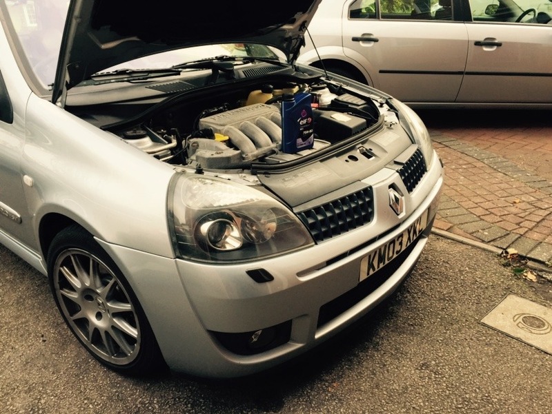

Whilst I was draining the gearbox oil I cleaned the misting oil around the selector shaft and noticed a slight amount of play in one of the linkages at the bottom of the gearbox, but the selector shaft was play free.
What was strange was how clean the gearbox oil was that came out of the gearbox! Maybe it had been done before. However, with the new Elf stuff in the gearbox is now pretty much silent :smiley:. Furthermore the gear changes improved from cold. Drivers need not have to guess when I was reversing out :smile:.

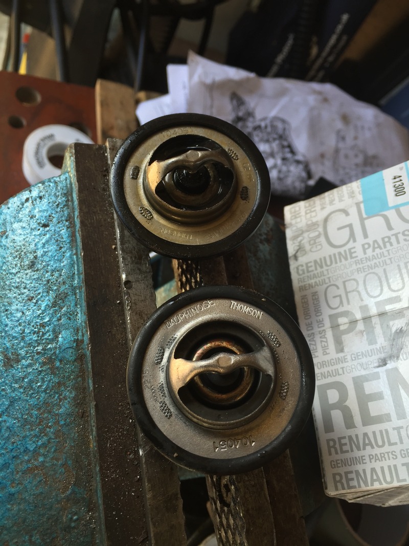

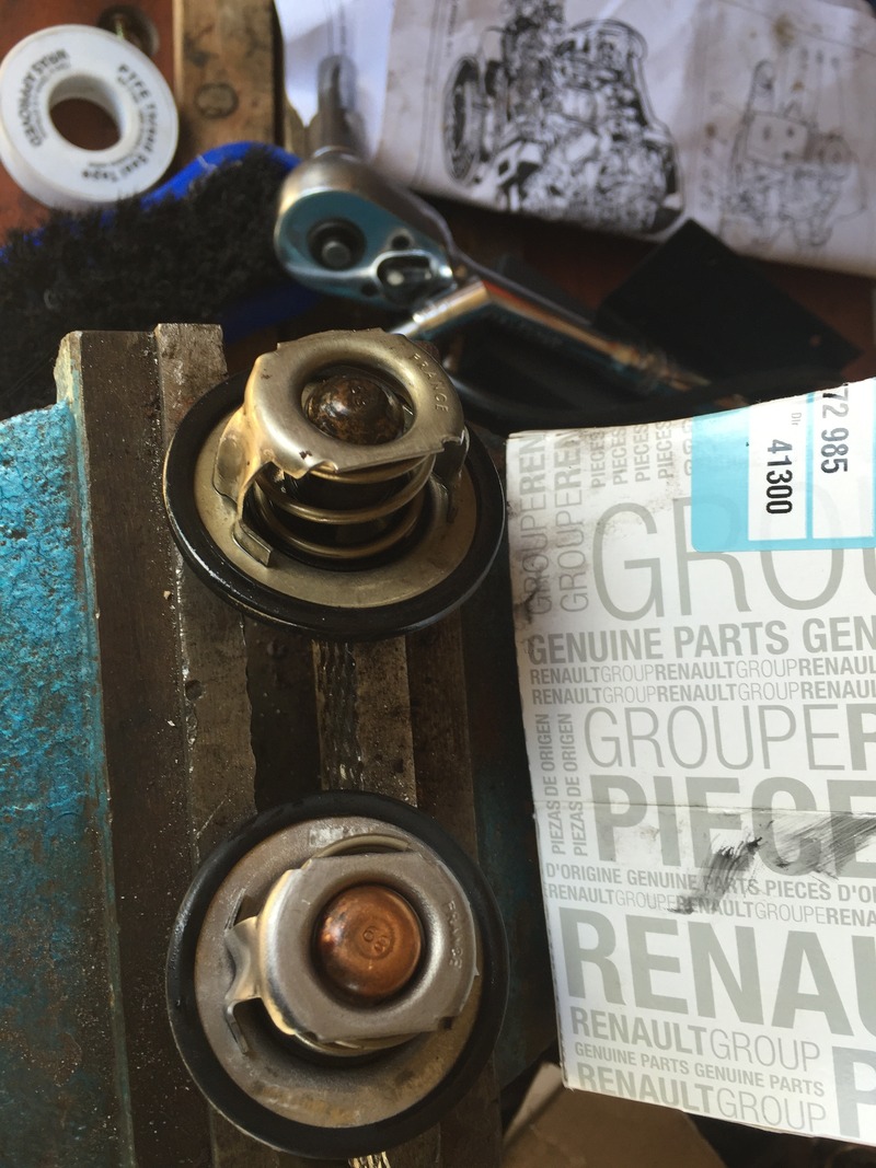

When the car went to BTM Performance Fred commented on the car's great condition but pointed out a few things I should keep an eye on. While most of these have been taken care of the thermostat had not. He reckoned that with a new one the car would run a little smoother and be just so. With the old thermostat the gauge used to sit bang on half way, maybe go under by half a mm or go the other way, where they tend to sit (slightly above halfway). On the basis that winter is coming and there seems to be little evidence of the coolant being changed I went to Renault to purchase some Type D and a new thermostat.
Initially all looked tickety boo:
Again, everything looked OK:

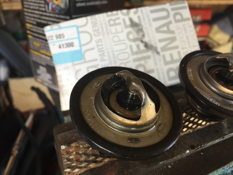

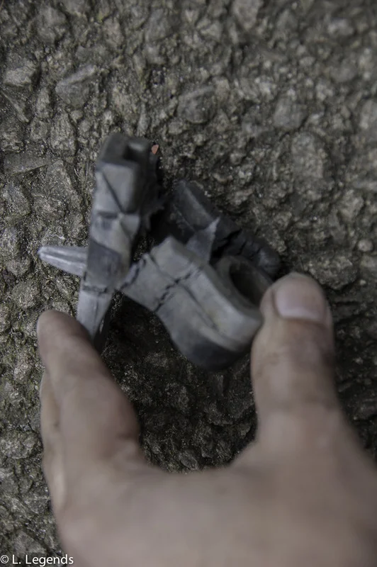

Errrr, maybe not! The inner thermostat seal had perished and split, causing one side of the seal to expand and come away.
I then filled the engine up with Type-D until coolant came out of the bleed hose when I then filled the coolant to the max and fired it up. It seemed to warm up quicker than previously and the gauge stayed just slightly above 1/2 way without budging at all! On my drive back the coolant level dropped to the minimum where I promptly topped it up once the car had cooled down. After this it seems that the coolant level has finally settled down once more back to where it used to sit (a bit below the MAXI level on the header tank).
Maybe it was placebo but the car was quite sharp on the throttle which I put down to the remap ; a friend of mine was not too keen about this from his 172. It did seem smoother than before for sure. The heater became hotter than before, handy when winter was round the corner. I had cars where the gauge does not even approach halfway!

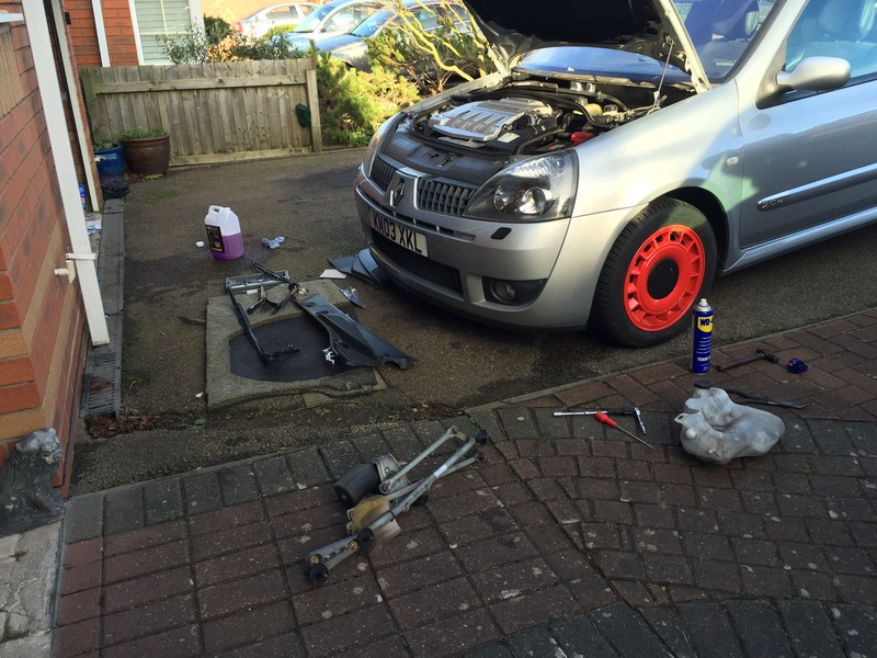

A wiper tool (the arms were stuck alot onto the shafts, I needed a gear puller on one of them!), a bit of moaning a few teas later and everything was off. However, I thought changing the motor would be the easy part! How wrong I was.
Off I went to GSF to get another motor. It looked just like the one I removed. Great I thought, just switch things across and happy days. Of course, you already know it is not going to be that simple. The Motor from GSF only put windscreen fluid onto the front screen whether you selected the front washers or the rears to work via the wiper stalk. Not a biggie but bloody annoying! After going back to GSF we concluded nothing else off their shelf would work. Would I have to spend £50 on a Renault item? Fortunately Leamco came to the rescue and with a new seal as well! An hour later and I had a full house of washers working!

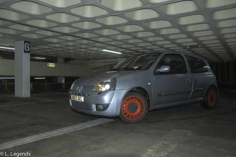

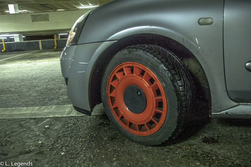

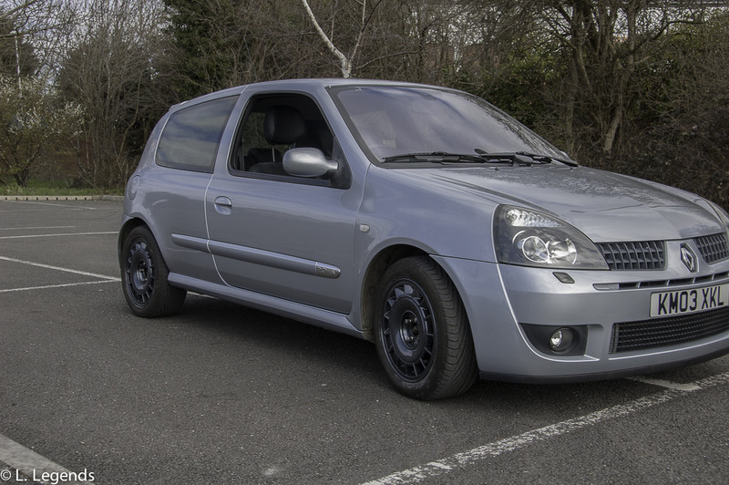

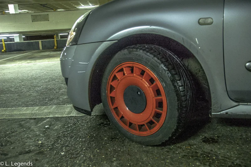

Some of you may have noticed a minor detail on my car changing. As much as I love Turinis the car is a daily, and I hate kerbed wheels, not helped on a car with appaling steering lock. I am not a kerb hunter by a long shot but the lack of rim protection on my current tyres (Contis and Toyos) really does not help. I wanted a set of 15s for this reason as well as curiosity but also for practicality. Being a little tight (when did OZ F1s and Turbines become expensive?) this is what I ended up with:
Suffice to say they looked interesting on the car:
After gathering enough cash the Turinis went back on, but not after the car saw a layer of Collinite along with the wheels. Turinis do look good eh?

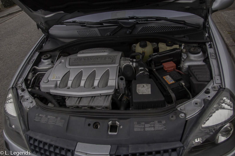

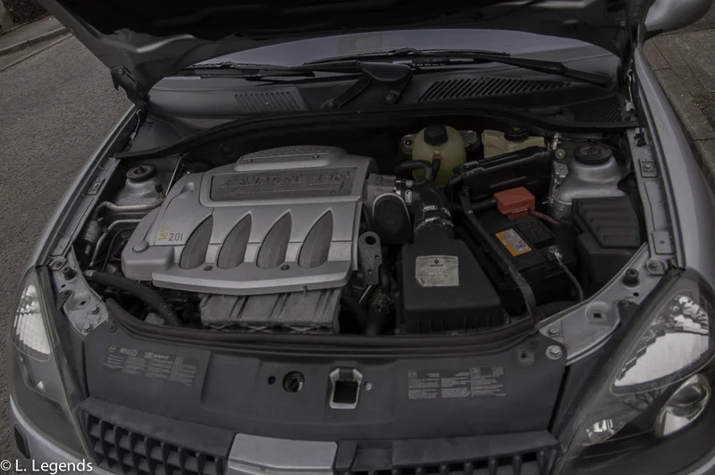

An engine cover also went onto the engine:

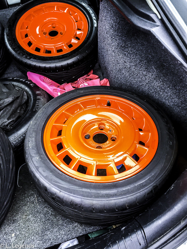

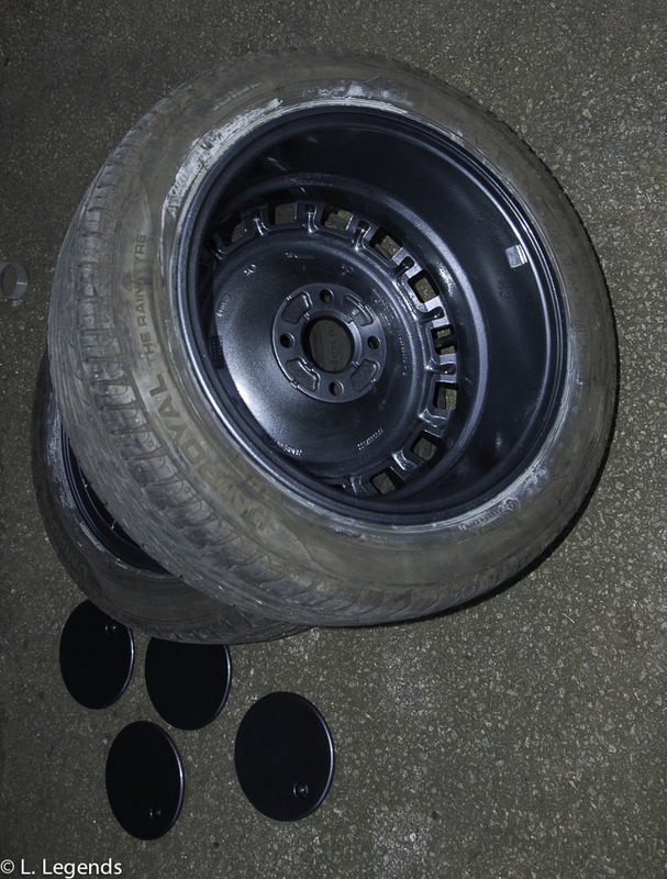

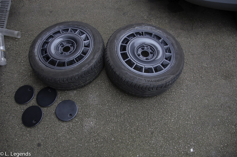

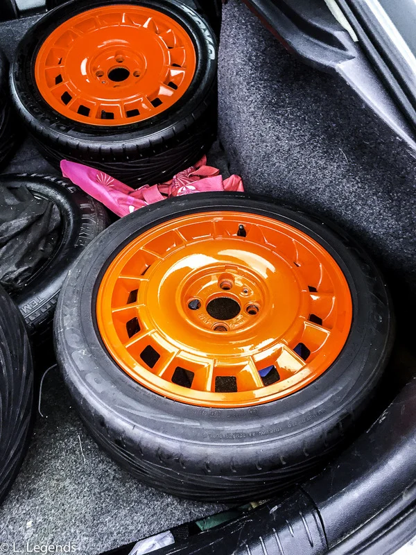

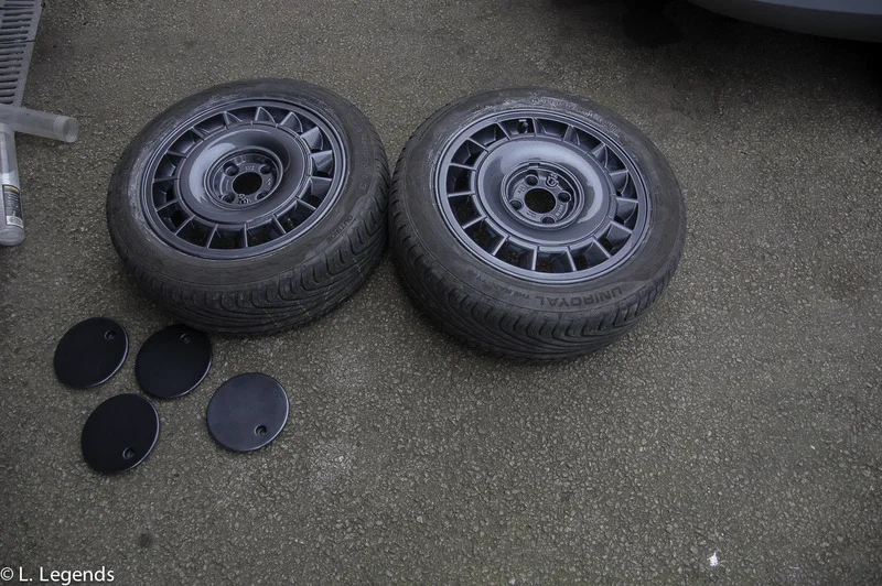

But with two Continental slicks I would hardly be able to drive it anywhere. Off they went for a refurb. Because of the Clio I ended up taking the Escort down:
Suffice to say, the wheels looked quite different when they came back!
Like the Turinis, I also treated these to a dose of Collinite in the hope of them being easier to clean in the future:
At the time I did not have the right nuts for the cap, and so I went capless. It is fair to say they look better in the new colour:

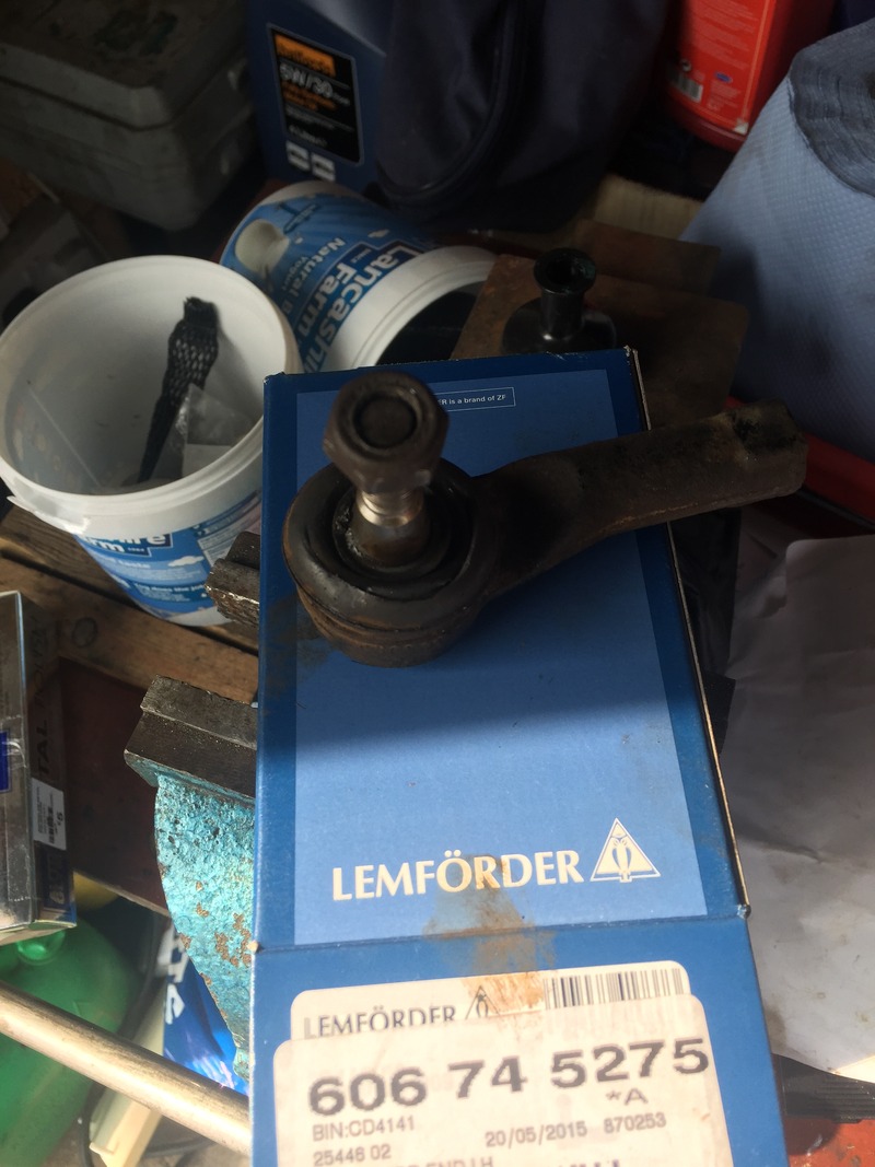

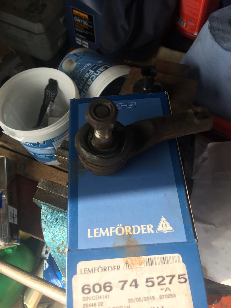

But like any Clio it can be a needy mistress. At MOT time the 2 year old track rod end decided it would have play in it after 18k. I did wonder why it felt wierd but I put it down to the tyres which are Uniroyal Rainsport 3s. They grip, but they are not most responsive of tyres from the cars I have driven with them on.
Hopefully the Lemforder item will last longer.

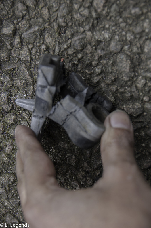

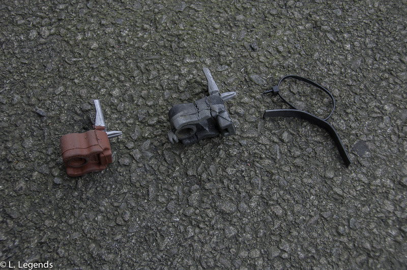

Likewise the 3 year old pattern exhaust hanger decided it would also let the exhaust hang low and knock against parts of the car. With a new item on all is well again:
Yup, that's goosed:
It may have been aided staying together with a zip tie!:
