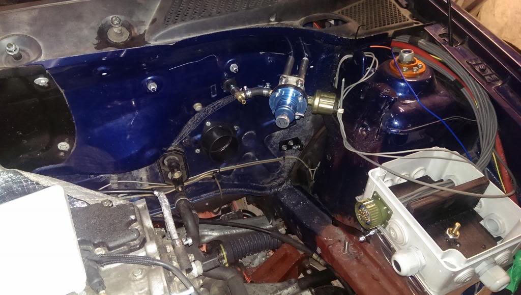

The preparation for the new season continues and we’ve made a bit more progress with the winter build. One of the most time consuming tasks on hand is the wiring; the dash assembly now includes a hinged panel containing all of the necessary dials and switches, with the ignition and starter now moved to the right hand side of the driver. No more knocking the fuel pump off in the hurry to change drivers! So, most of the wiring has been laid out, just a few more long hours needed to get it all connected up.
One of the main features of the new wiring layout is our ability to disconnect the engine harness completely from the body. This is achieved by having all low current signals sent through a detachable mil plug connector (seen in green in the pic below).

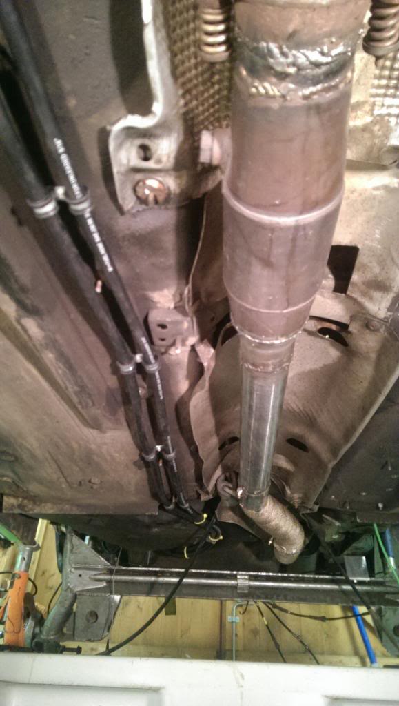

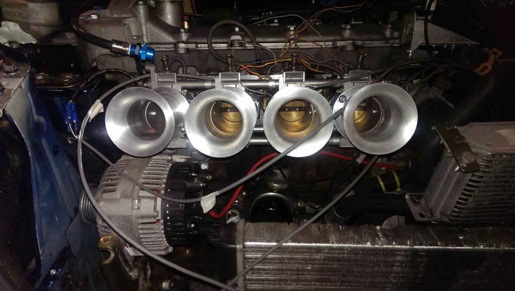

Another item that can be seen in the picture below is the addition of a fuel pressure regulator; part of the new fuel system that we’ve laid out in the car. The black cylindrical bulkhead fitting you can also see in the picture is part of the new driver ventilation system, aimed at stopping all those mid race hot flushes!
If you have a really keen eye you’ll notice that the fuel pressure regulator has 2 lines running to it, one feed and one return with a T-piece taking the fuel to the rail. Those 2 lines run through the bulkhead, down beneath the car and to the back of the car where, of course the pumps, tank and swirl pot sit.

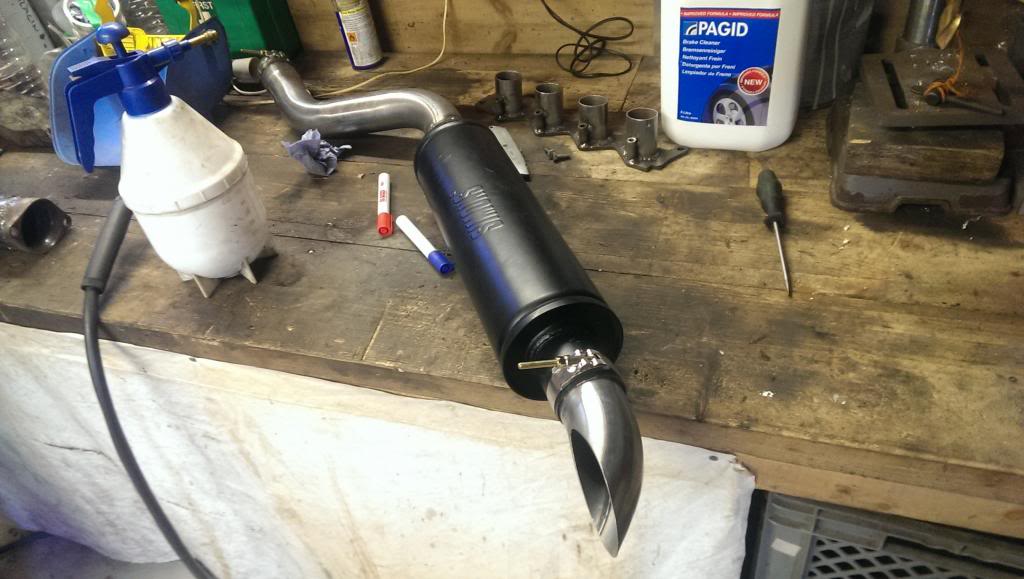

Along with all of this, we’ve made a new exhaust system. We acquired a 200 cell cat a while back and decided to mate this with a series of pipe sections from Jetex. Then, with a bit of fettling, tweaking and welding it came together quite nicely. Now we’re just hoping it’s not too loud!

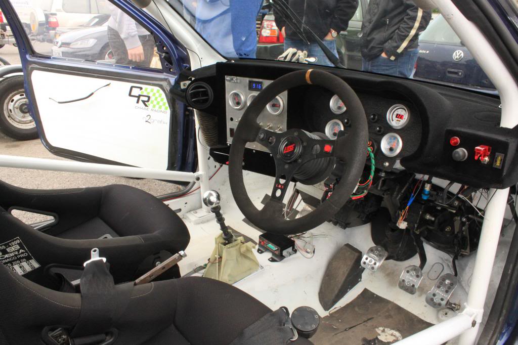

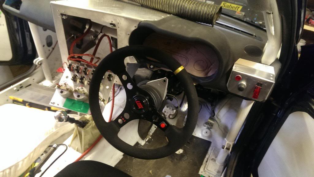

So you're taking air from the engine bay for ventilation, or is there more to go onto this and out the front of the car?
Also, have you tried getting in and out of the car quickly with that switch there, I would be worried about knocking it with my knee, but I guess you would have thought of that already.
  Chase Racing Clio
Yehh, there's more to it than that. The trumpet on the front bumper previously used for a cold air feed will now be the source of the incoming air, with a pipe running from there to the bulkhead fitting. We'll wrap it in aluminium tape too, so it should remain as cool air when it gets to the driver's face.
And that switch is a little further away than it appears in that pic, we don't get anywhere near it leaping out of the car. That shouldn't be a problem. Separating the ignition from the fuel pump switches was the most important thing, not letting that happen again!

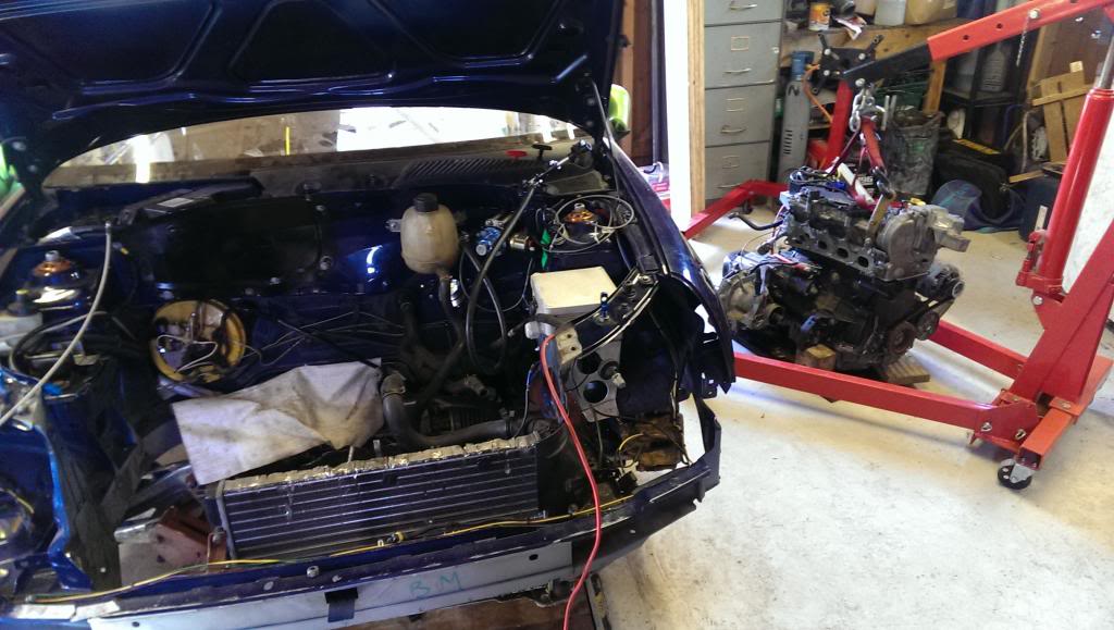

We set ourselves quite a task with the changes we wanted to make over the winter, but we are now getting close to completion. Ryan’s many hours of wiring are very nearly over and all of the little fabrication jobs are pretty much complete. These have included things like, a bracket to hold the oil cooler in a neat position just above the main radiator and a small bracket to house the coil pack on the drive end of the engine (plus many other small items).
As I mentioned in a previous post, we have routed all wires in the engine bay such that we can simply unplug the engine from the rest of the car. This has meant that removing the engine has now become quite a simple procedure. So, it’s now out of the car ready for the installation of a set of Catcam 421’s….which are due for delivery imminently!

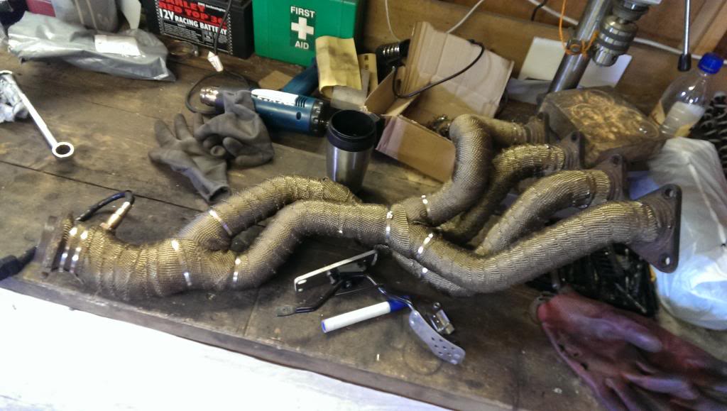

Whilst the engine is out, Rob has taken the opportunity to wrap the exhaust…… and very lovely it is.

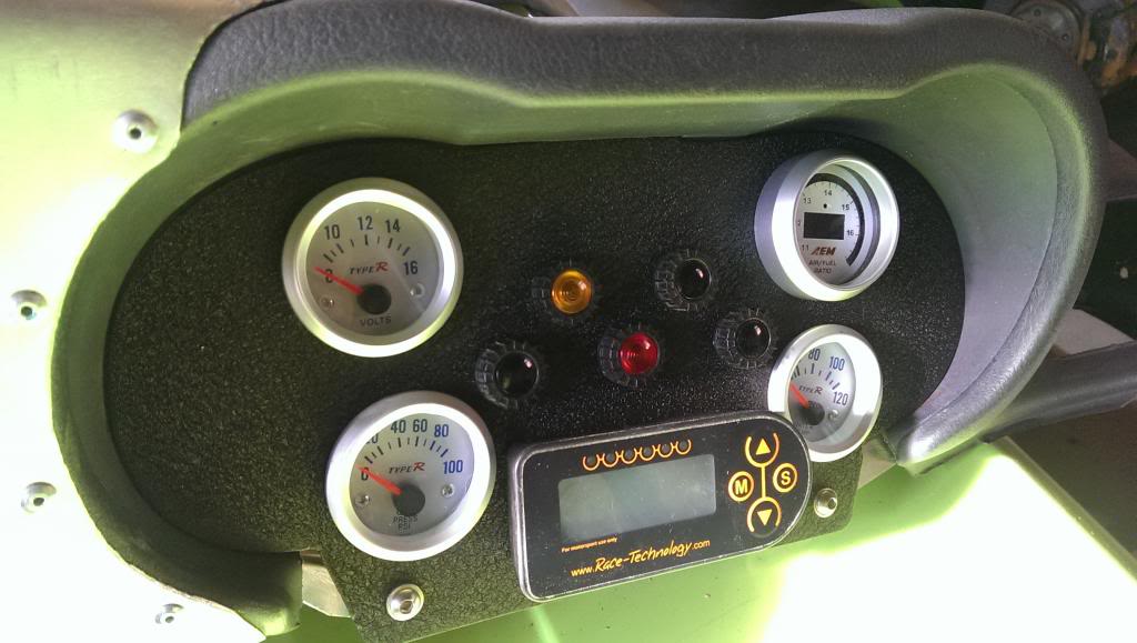

Inside the car, it will be quite visibly different with the new dash assembly and one of the main aspects from the driver’s perspective is the panel that sits under the cowl. We have made a custom piece which houses the data logger screen (showing speed, lap times and shift lights mainly), a number of warning lights, lambda, voltage, water temp and oil pressure gauges. This panel slots in to place via a tab along the top edge and is secured with two small bolts along the bottom edge. This means that if we have an issue with any of these items, they are very serviceable as this panel can be very easily removed much like the central panel. Once the wiring is fully complete, we will get the whole dash piece flocked, minus the panels.

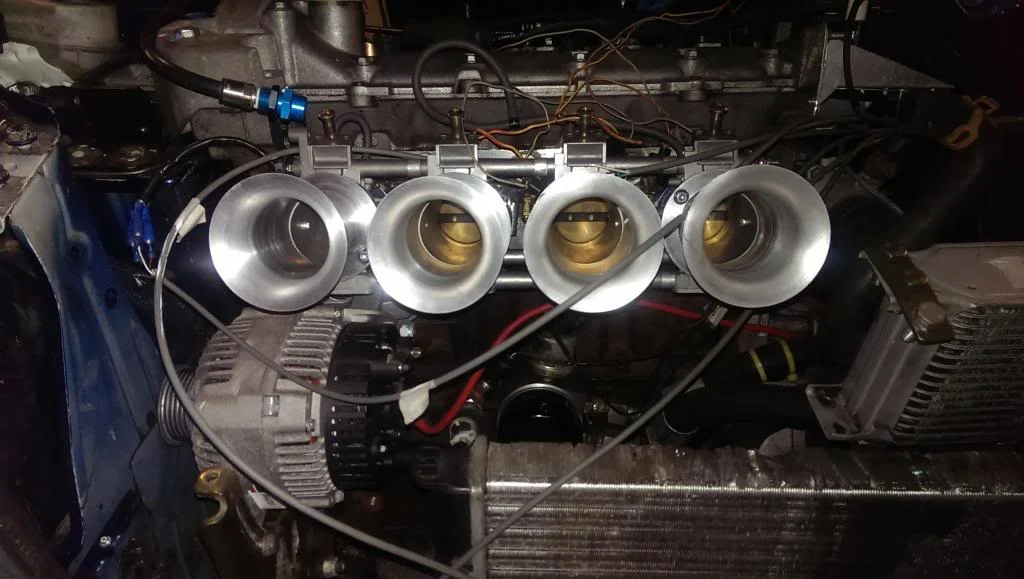

As we approach easter, we can finally say that the winter build is complete. We have spent many months putting together an engine package that we hope give us good power & torque whilst still maintaining a certain amount of reliability. We’ve spec’d it such that if we have an internal engine failure, a replacement unit would be relatively cheap. The full spec of the engine is as follows:
- Standard F4R engine bottom end with Phase 1 head (larger exhaust ports)
- Catcam 421s with VVT (inlet cam phasing)
- 182 exhaust manifold
- Full custom 2.5” jetex exhaust system with 100 cell cat & 420mm round silencer
- GSXR1000 throttle bodies with Honda S2000 360cc injectors
- 90mm trumpet length & custom intake manifold
- Emerald K3 ECU

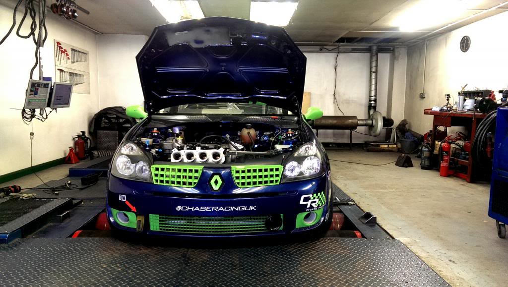

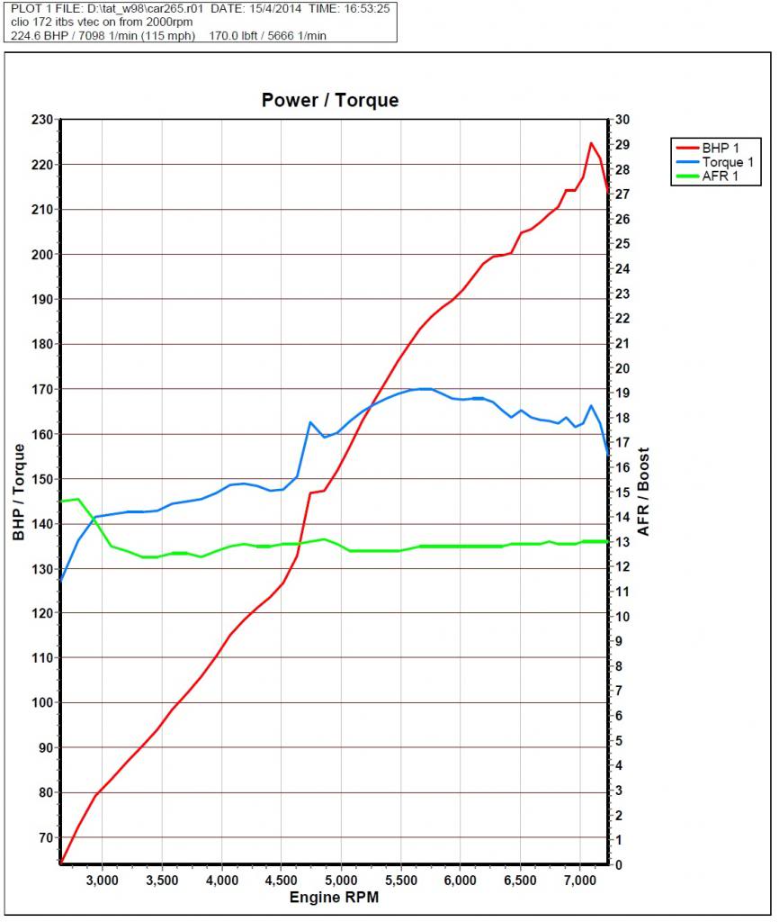

Now that the engine is running and idling, it’s time for us to get it mapped. So, we took it over to Dave Walker @ Emerald to get the job done. Here’s a video of the car on the rollers:
As you might be able to hear, it has a nice smooth delivery of power and it just seems to keep rising! We were reasonably optimistic of what kind of power it might give us, with our 3 estimates between 200 and 210 bhp. So, when we got a result of 224.6 bhp, needless to say we were pretty chuffed.
The power torque curve shows a nice delivery of torque from 4500 rpm upwards, the rev range we’ll be using when out on track. Good solid result all round!

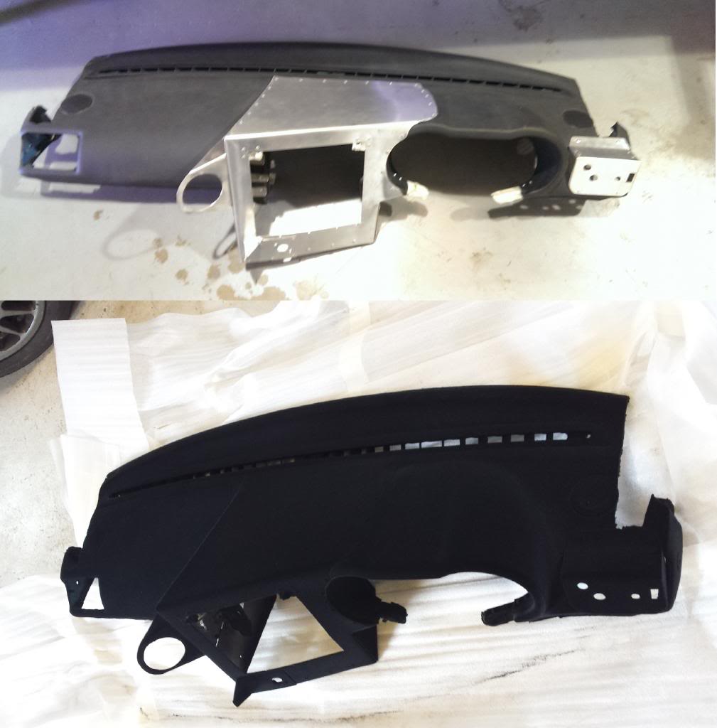

As I mentioned in the previous update, there were a few loose ends to tidy up before we heading out on our first test of the year. The dash piece has come back from being flocked and we’re pretty happy with how it has turned out. Here’s a before and after shot of it.
With the dash in place we were able to finish the routing of wiring, attach our new driver vent and hook up the data logger dash display. I mention the last item in particular, as we have also done some work programming the data logger to process a variety of inputs from the ECU. This includes all the usual temperatures and pressures, allowing us to record everything that happens as well as just being able to see them on a dial on the dash.

Do you have warning lights as well as the gauges? Only reason I ask is that from having first hand experience of gauges, in the heat of the moment you don't look at them until it's too late.
  Chase Racing Clio
Yeh, precisely that...... We had problems at castle combe last year when it got a bit hot and we didn't spot the coolant boiling. We blew it up and didn't finish the race! So we're making sure we catch things like that before it damages anything
