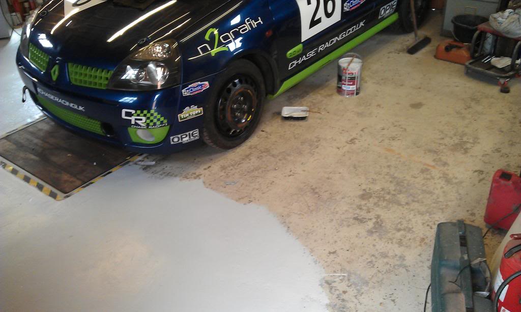

The first thing we wanted to do was to get the workshop up to scratch. So, out everything came… cars and all. That’s Rob’s BMW under the sheet, and yes, it’s green! That wasn’t deliberate though.
C:\Users\dbanks\AppData\Local\Temp\msohtmlclip1\01  \clip_image001.jpg
Time to slap on the floor paint and you can really see the difference!

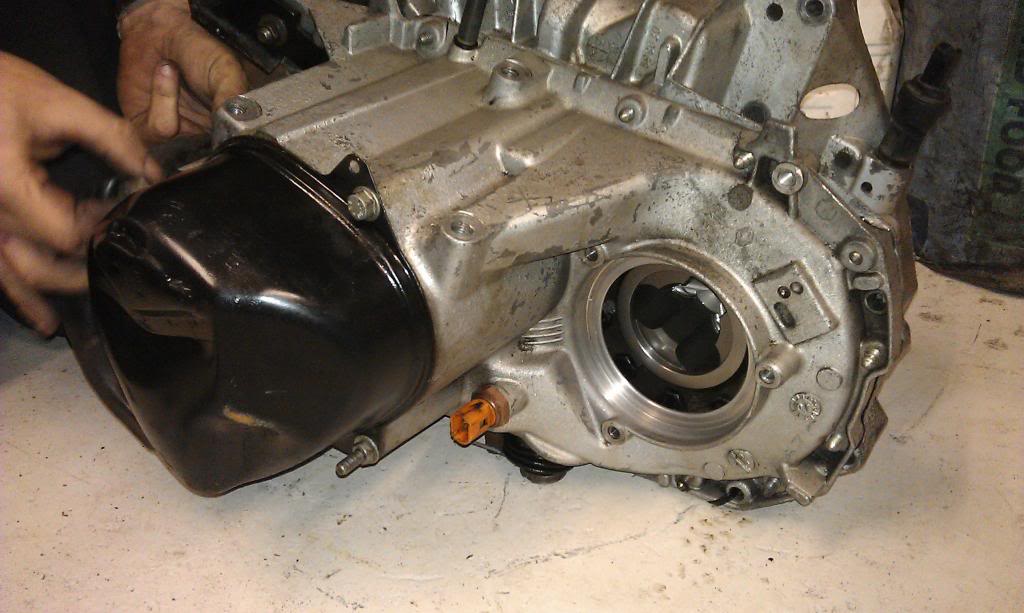

After we’d done all that, it was time for a far more important task. Over the past few months we had been chipping in together to pay for the next big modification, a limited slip differential. We decided to go with a Gripper plated diff and had lined up Dave Mac Propshafts in Coventry to fit it. We had a couple of spare standard gearboxes knocking about the garage which were a little worse for wear and the one in the car has only recently been rebuilt. In the interest of making sure we at least had a spare standard gearbox, we decided to leave the one that was in the car well alone.
Rob took the 2 spare gearboxes to Dave Mac from which they built a single good one using the better parts. We decided to keep the standard final drive which meant they had to press the crown wheel off of the open diff and weld on a plate to bolt to the LSD.
C:\Users\dbanks\AppData\Local\Temp\msohtmlclip1\01  \clip_image005.jpg
A week later and we had a fully rebuilt box with LSD. Next up, it was time to get it in the car! We’ve done this swap a few times now and with the deleted power steering, it’s even easier.

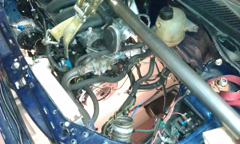

The next item, which is probably the most significant change, is our decision to fit throttle bodies. Ryan has completed the fabrication of the intake and, the picture below, shows it all mocked up in place. We have also begun the tricky task of re-wiring the car to work with all the new components. We’ve done away with the standard ECU we did have in favour of an Emerald one, which along with some cams will hopefully give us a decent power increase.
As you can see in the picture, the front slam panel has now disappeared due to the size and package of the new intake setup. This has also caused a height issue under the bonnet, so we pulled out the angle grinder and as if by magic, we now have space!
You may anticipate that all this change might have a knock on affect, and it certainly has!! We’ve done away with some of the standard Renault equipment in the cockpit and have also decided to modify the dash layout to suit. Below is a snap of where we’ve got to so far. The plan is to apply some flock material over this once all the fabrication is complete.
