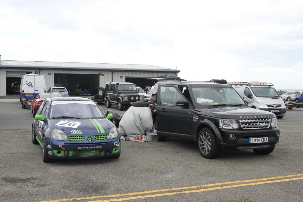

The next morning, after a nice spot of breakfast at the B&B we made our way to the track. After signing on and rolling the car through scrutineering we drove around the paddock a bit. The brakes hadn’t quite felt right since we changed all the pads and they weren’t get any better. We decided to bleed some fluid through them and got the car up on axle stands. It soon became apparent that only the rear brakes were working which gave us some cause for concern. It turned out, one of the hoses that supplies the master cylinder was kinked and wasn’t allowing fluid to flow in from the reservoir and we weren’t actually bleeding fluid through. We had moved the reservoir away from the exhaust manifold after the fire at Castle Coombe. So, with Rob holding the pipes, we managed to bleed out the trapped air and got our brake pedal back. The brakes were faultless all day after this mild panic.This weekend the CSCC were offering another race for pretty much anyone who fancied it, called “Sports vs Saloons”. There were a few Caterham 7 type cars, a couple of BMW M3s, a Porsche 968, Lotus Cortina, BMW 1800 and a few Jags as well as a couple of cars from our series. We had signed up to this along with the usual Tin Tops but had to contend with qualifying and race sessions back to back.

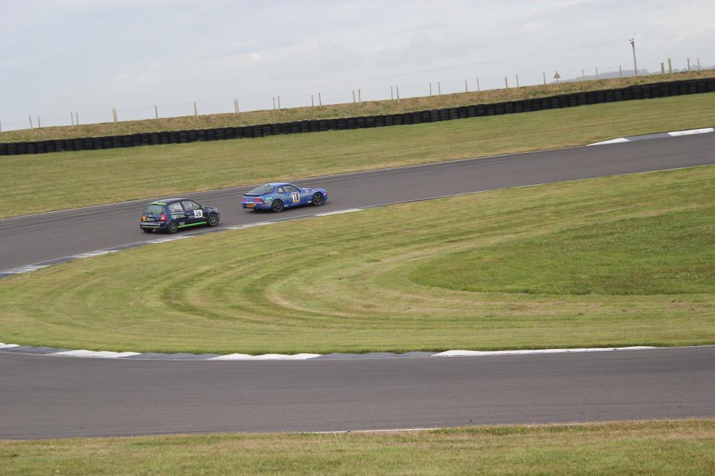

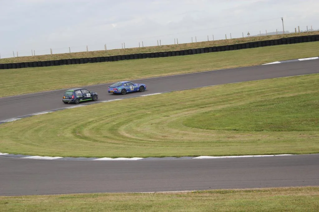

The Tin Tops was first of the sessions and there was some light drizzle and with no dry line appearing. Along with some scare stories from Northerners Masters and Lawton, we decided to fit our new wet tyres. They didn’t work very well and the track turned out to be just a little bit damp and nothing to be concerned about. We managed to qualify down in 15[SUP]th[/SUP] with a time of 1.26.5. For the next qualifying sessions, we changed back to the usual Dunlops and posted a time 5 seconds quicker which put us 8[SUP]th[/SUP] in that race and would have put us 3[SUP]rd[/SUP] on the grid for the Tin Tops race rather than the 15[SUP]th[/SUP] that we had managed. It was nice to know that our lack of pace was down to the tyres and we should be able to make up a fair few places in the race, provided we weren’t too far back to catch some of the cars further up the grid.
