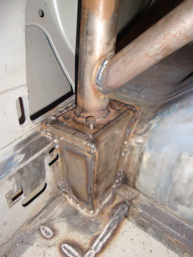

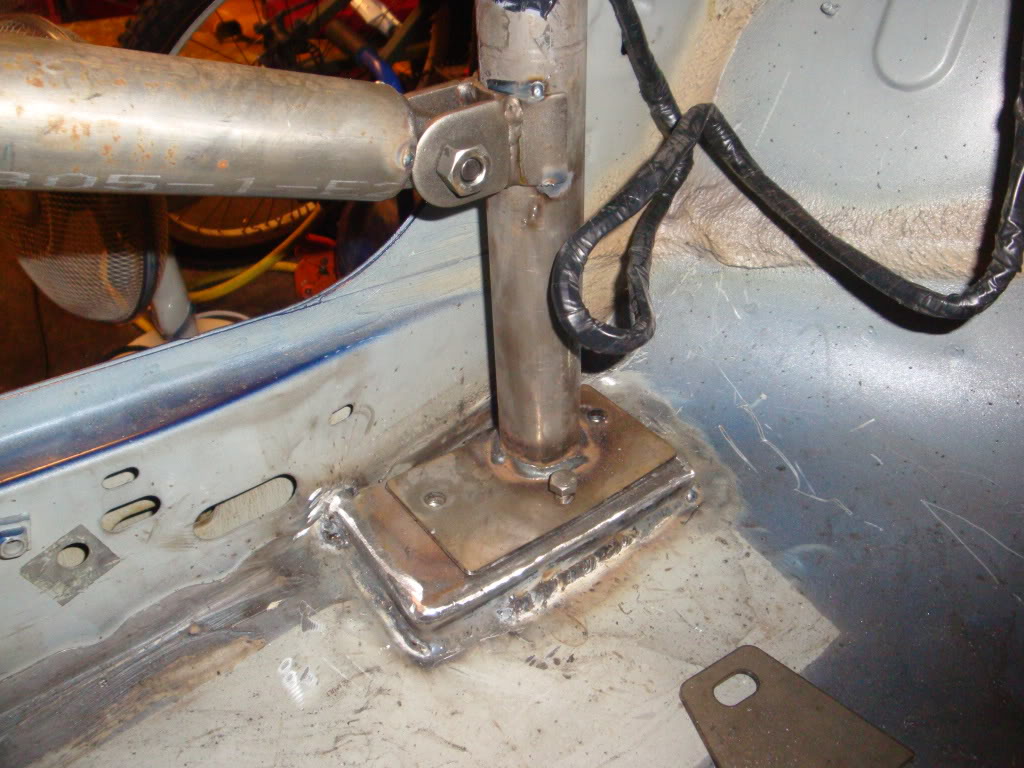

Ryan's beautiful welding really showing through now, base plates are all sorted.
He's also done the brackets for the door bars.

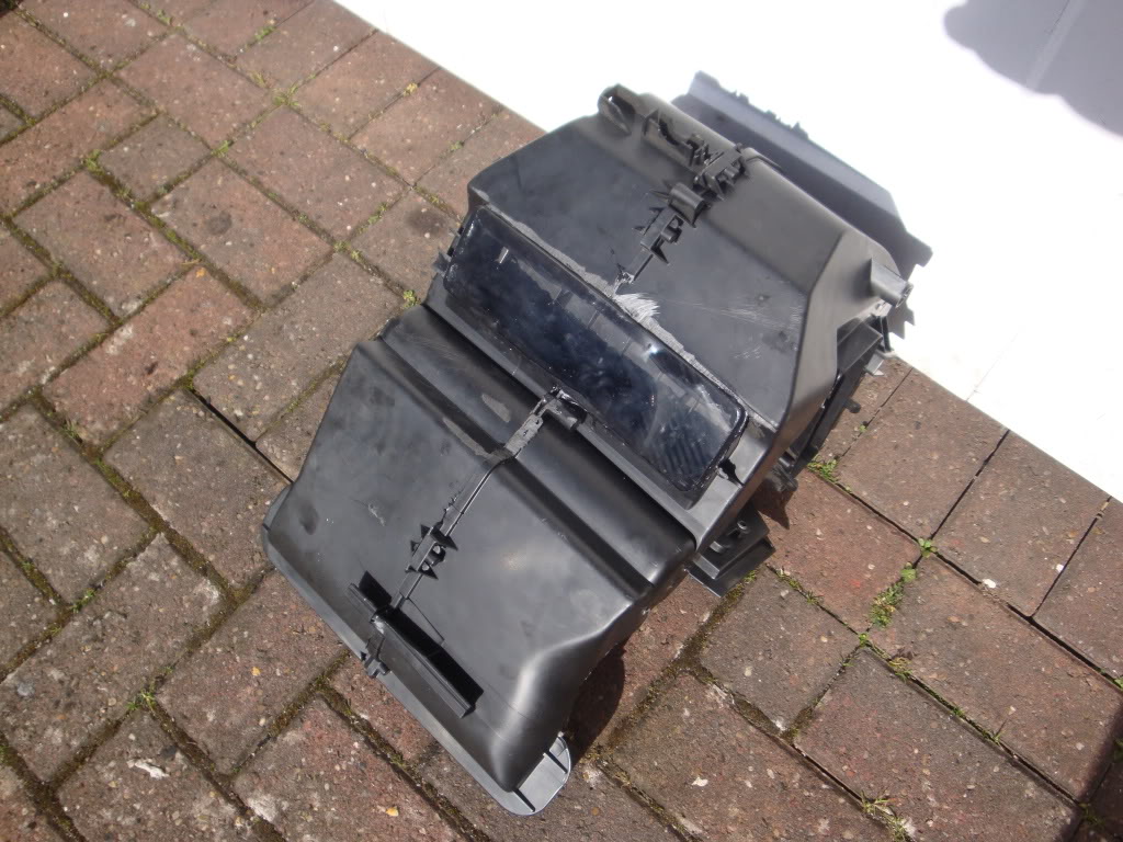

The blower assembly has had a nice little blanking plate bonded on, so as to direct all the air on to the screen. It's a see through panel too….how novelty.

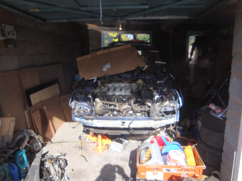

The bumper is off now too, as is the radiator and inlet. We'll be pulling the engine out for a few quick changes once the wheels are back on the car.

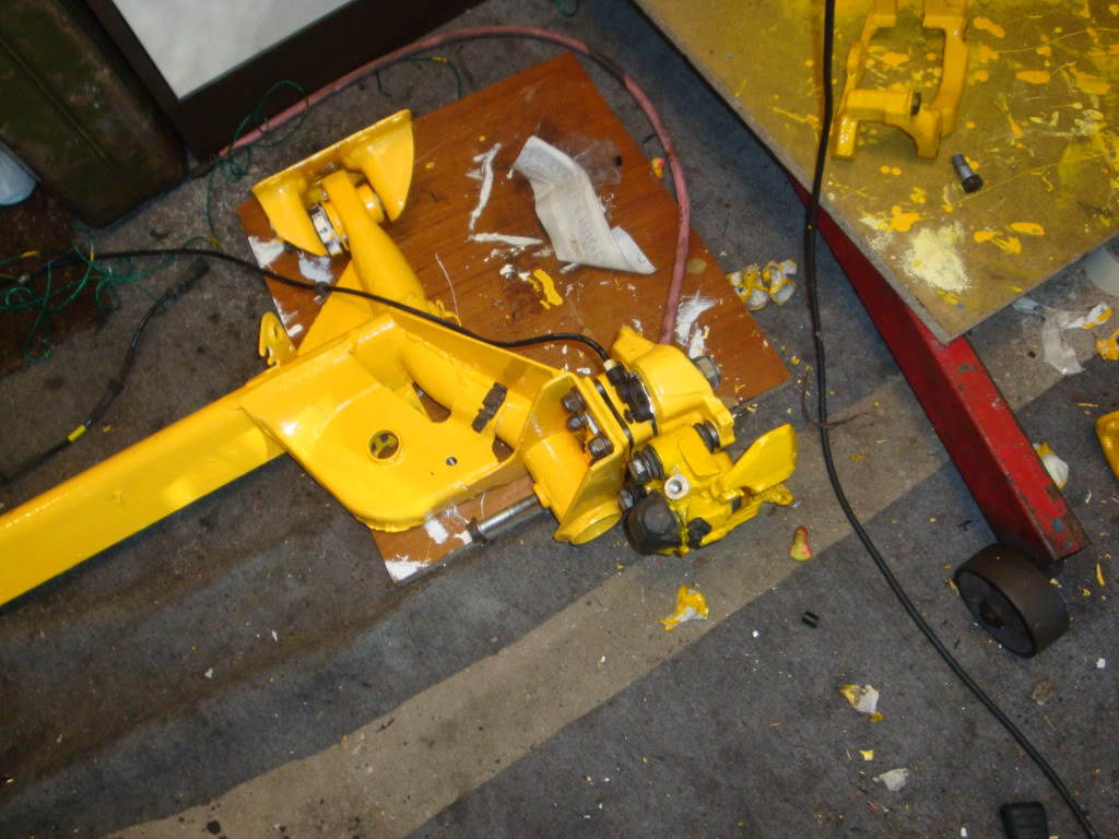

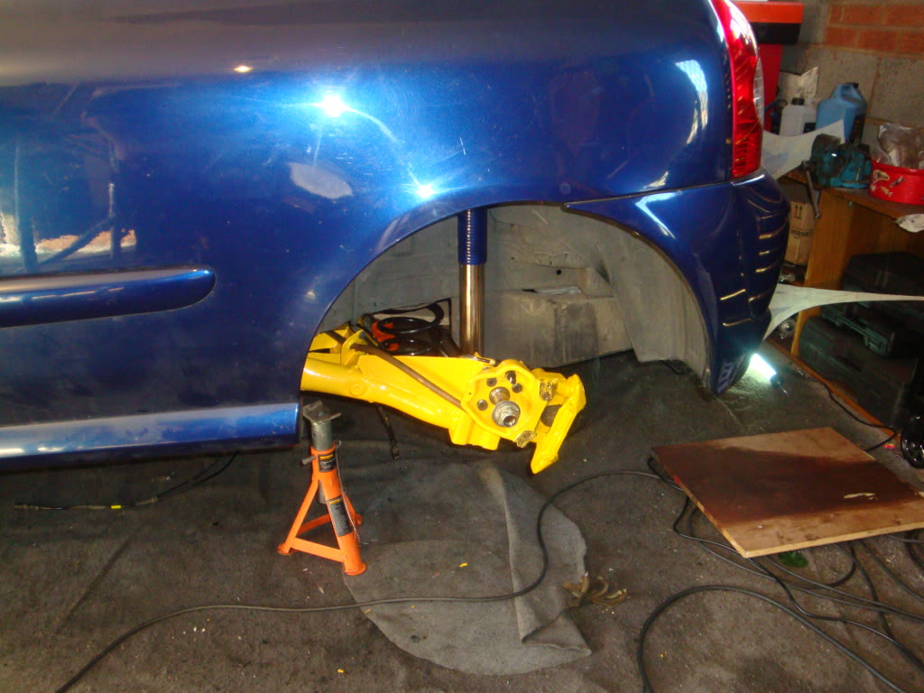

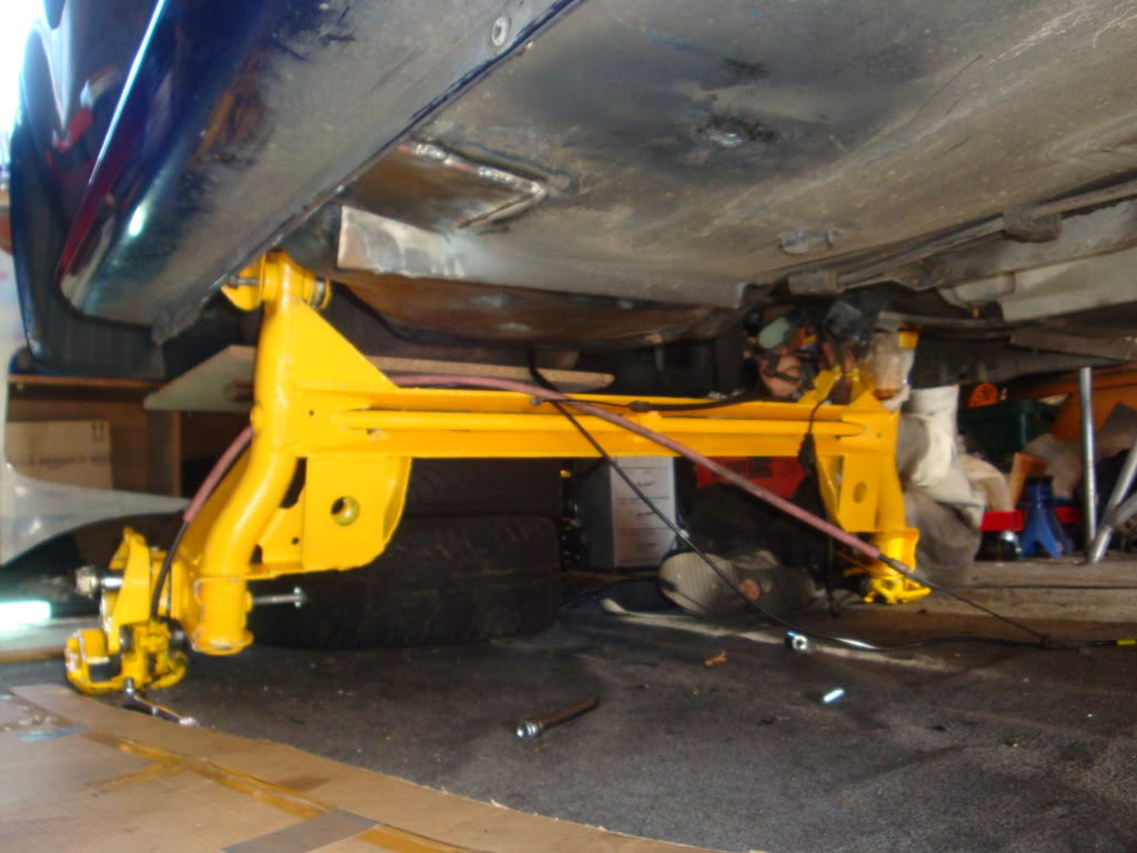

The rear suspension being re-constructed.
The rear end going back in place. You can also see the plates welded underneath the sill that'll be used as jacking points. We put these in place to give us more material to weld against when putting in the base plates for the centre section (first pic of this post)
You can also now see we have the new gaz golds in place on the rear, just waiting for the new discs, pads and camber shims to finish off that bit.

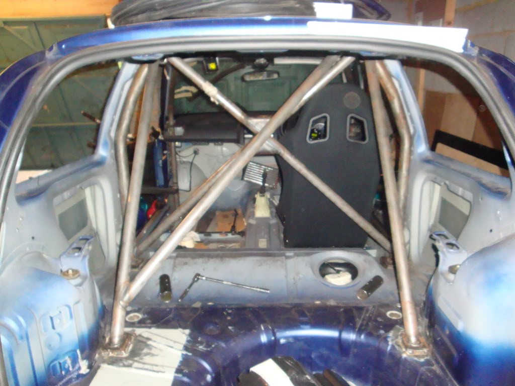

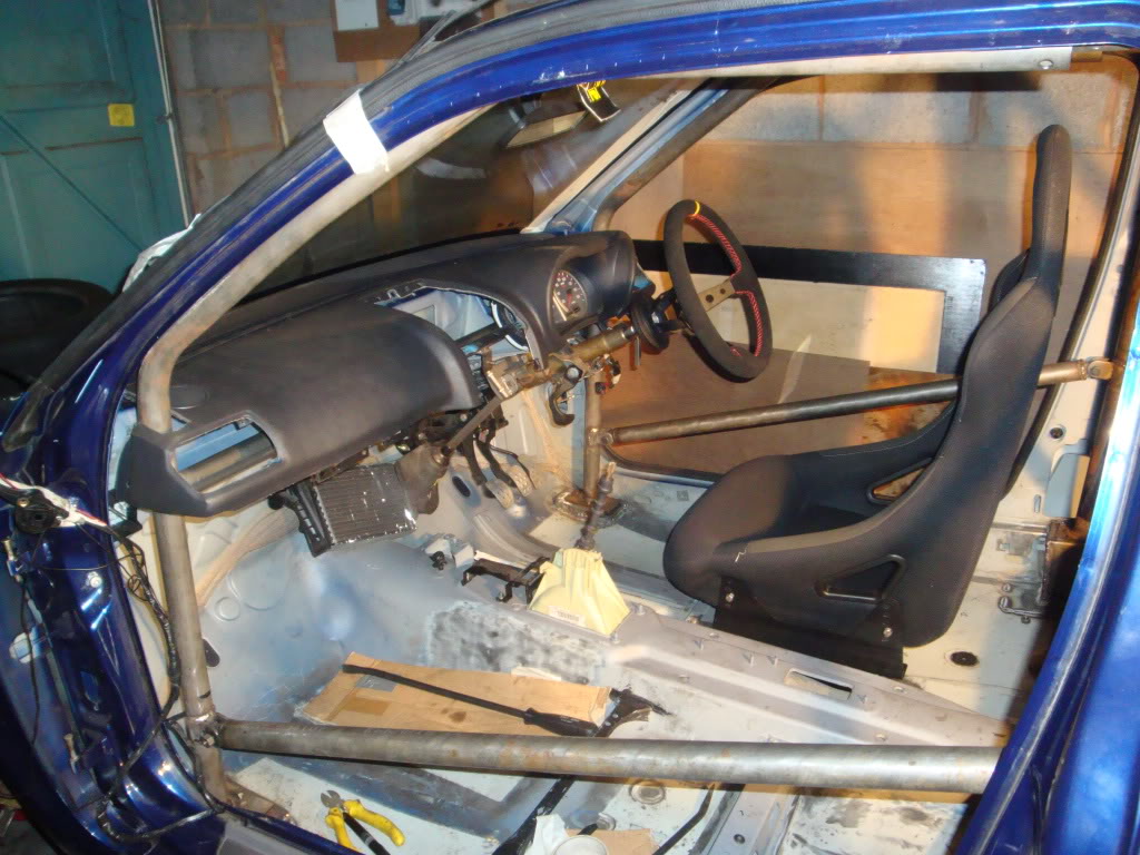

A front cross car beam has been welded in across the front section of the cage to house the modified top dash piece. This cross beam still maintains the cage as a true bolt in cage, whilst providing good mounting points for anything we need in the way of gauges, switches etc.
Here's the view from the rear…. Next jobs to do include a harness bar and some rear end stiffening. Plenty more to be getting on with anyway. Watch this space, next update in a few days.

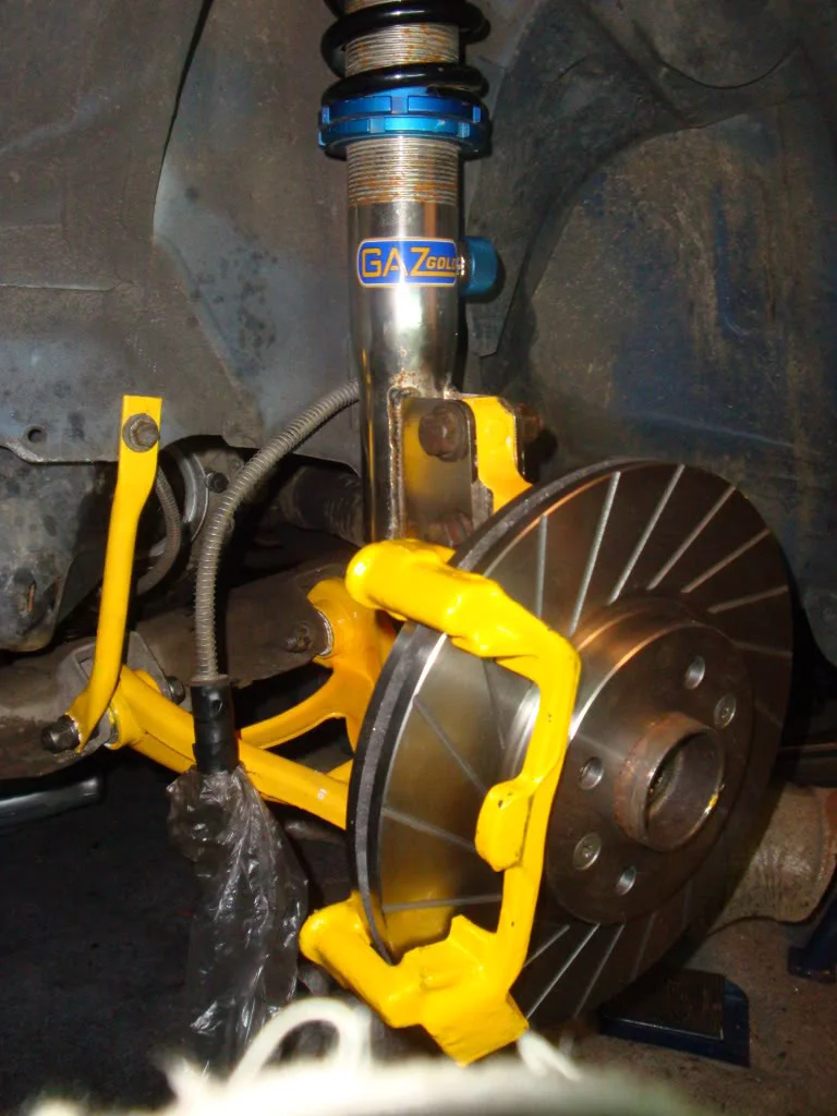

March 7[SUP]th[/SUP] 2012:

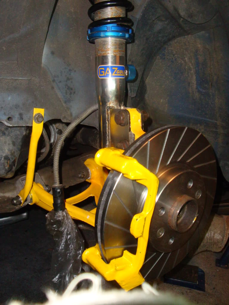

We're getting towards the stage now where we're actually putting a few things back on the car, which is a really nice feeling. The first of which is the front left corner, the brake pads are still to be bought, so we'll leave the caliper off for now until we get them.

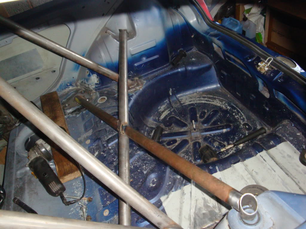

Rob and Ryan have made a nice job of fabricating a rear stiffening brace. This cross piece comes off the rear top mounts and across to the fixing position for the rear beam; a plate has been made here with encapsulated nuts, getting rid of the standard fixings which have a very awkward round head on one end. This cross piece also avoids collision with the cage, maintaining it as a true bolt-in cage.

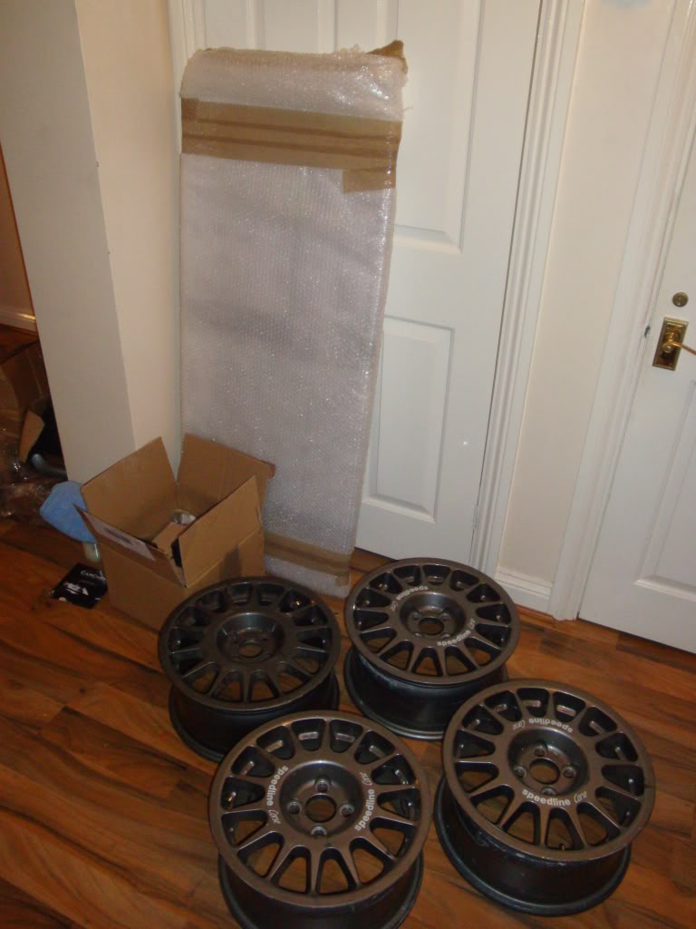

We've also had a few more parts, including the new polycarbonate which will make up the rear screen (side windows to follow), full set of discs, a new steering column (already fitted) and some speedline anthracite 15s which have come from a former 182 cup car!! It's all about who you know, 300 quid for the 4 wheels!
Nice idea, are you going to triangulate this to the cage?
I thought about tying the rear beam mounts to the cage on my car, still think about it but dont want to add anymore weight unless I have to lol.
Is that it fitted in that picture, just wondered what was going on with the N/S pick up where the shock comes through, looks off centre?
  Audi A6 & 172 Cup
I'm not aware of the finer details of all the championships and their rules, but appreciate you might not be able to do that in some of them. Given the design of that brace imho it would certainly benefit from being attached to the cage if it's allowed.
I've just been going by the Blue Book for Modified series production running in sprints and hills and there nothing to stop me using the cage to reinforce the suspension pic ups etc.
The likes of the custom cages multipoint technically does this at the front and the back
  182cup & 172 racecar
Oh I know they do, I've seen them.
They say that once the pick up points are attached to the cage, it then becomes a space frame.
  Chase Racing Clio
As I eluded to before, we won't be attaching that rear cross piece to cage. The small bit of tube sitting over the top mount in that picture won't be staying there as it means we can't access the top mount then. We need to get a larger diameter section of tube to put Re. That small piece is only tacked in for now

As far as the MSA/Blue Book is concerned you are allowed to strengthen the chassis and modify suspension pick up points, on a modified series production car anyway.
It would only become a spaceframe if you started to remove the original material from between the hub centres and therefore the loads where acting directly into the cage and any new tubes etc.
Old, rusty nuts! After all that paint it is such a shame to use old hardware! I know it is not a show queen, but new nuts or a little polish would have finished the job off nicely!
