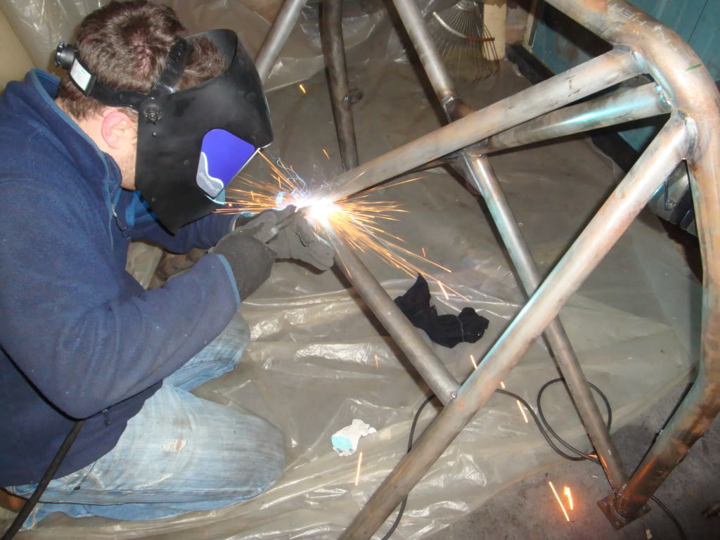

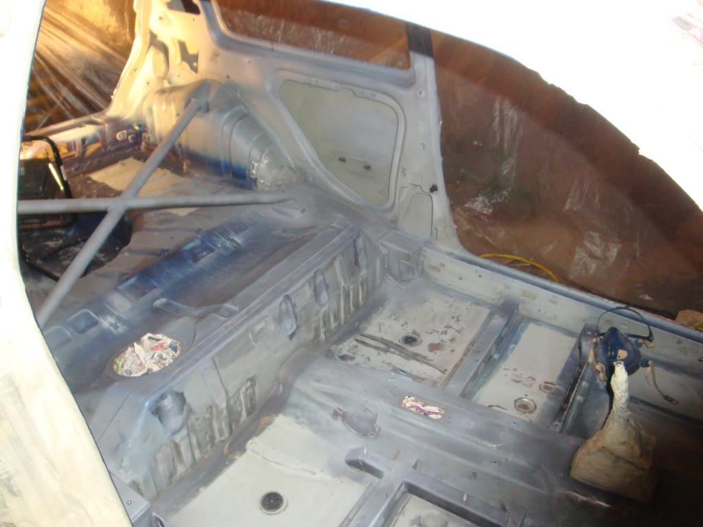

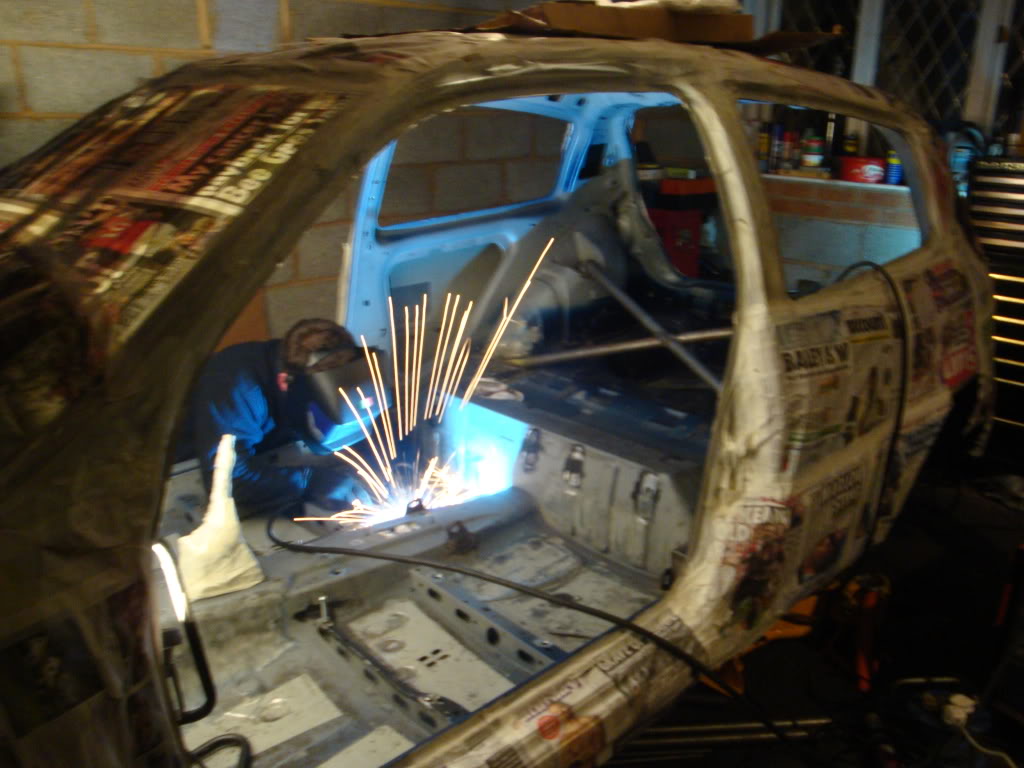

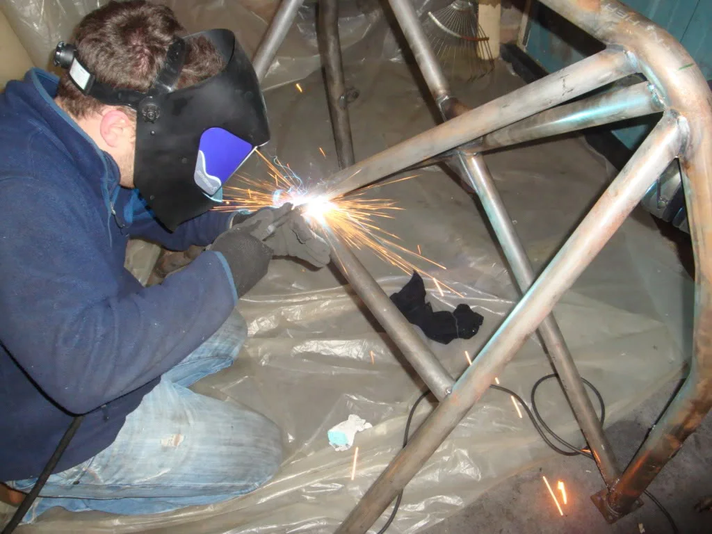

Next, a few updates on the car. It won’t really look like much, but we've been finishing off all the fabrication on the inside of the car ready for paint. Firstly, a harness bar needs to be installed:

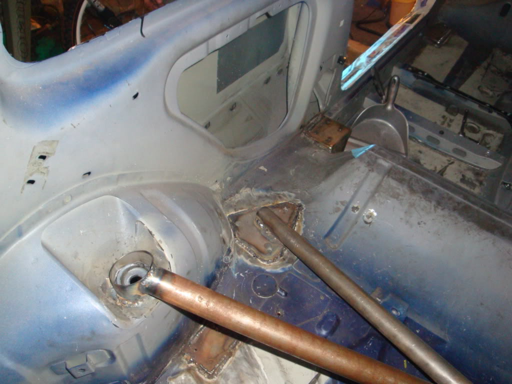

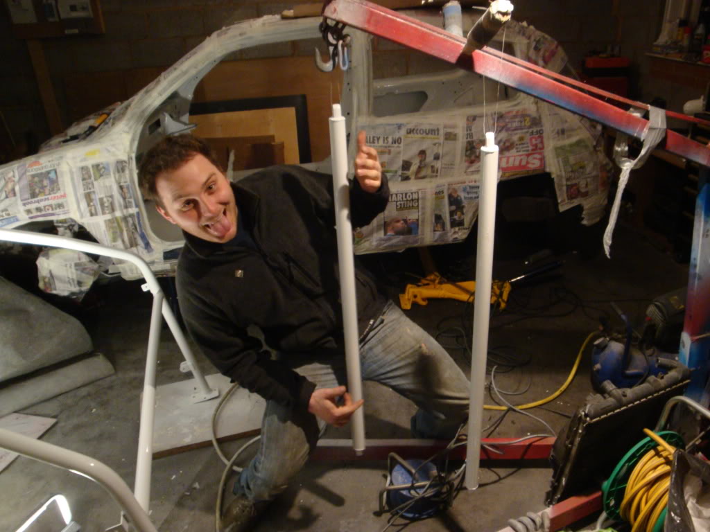

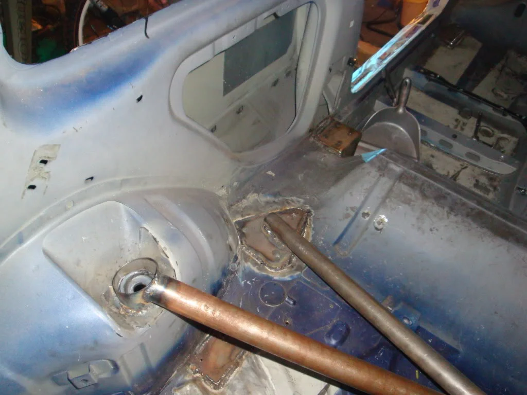

Next up, the rear stiffening section needed finishing off, complete with a nice piece of tubing to neatly fit around the top mount in order to accommodate the top mount spacers.
The last bits of fabricating are completed inside, including lap and crotch belt attachment points for the harness. The car has been completely wrapped in newspaper ready to spray up too!

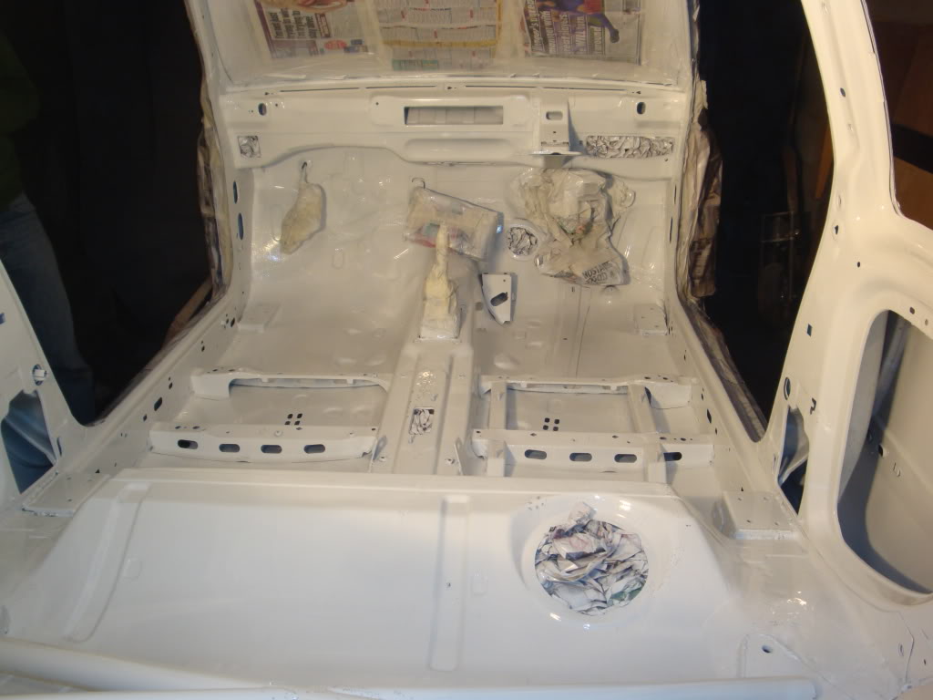

March 14[SUP]th[/SUP] 2012:
Paint is the theme of today's update.

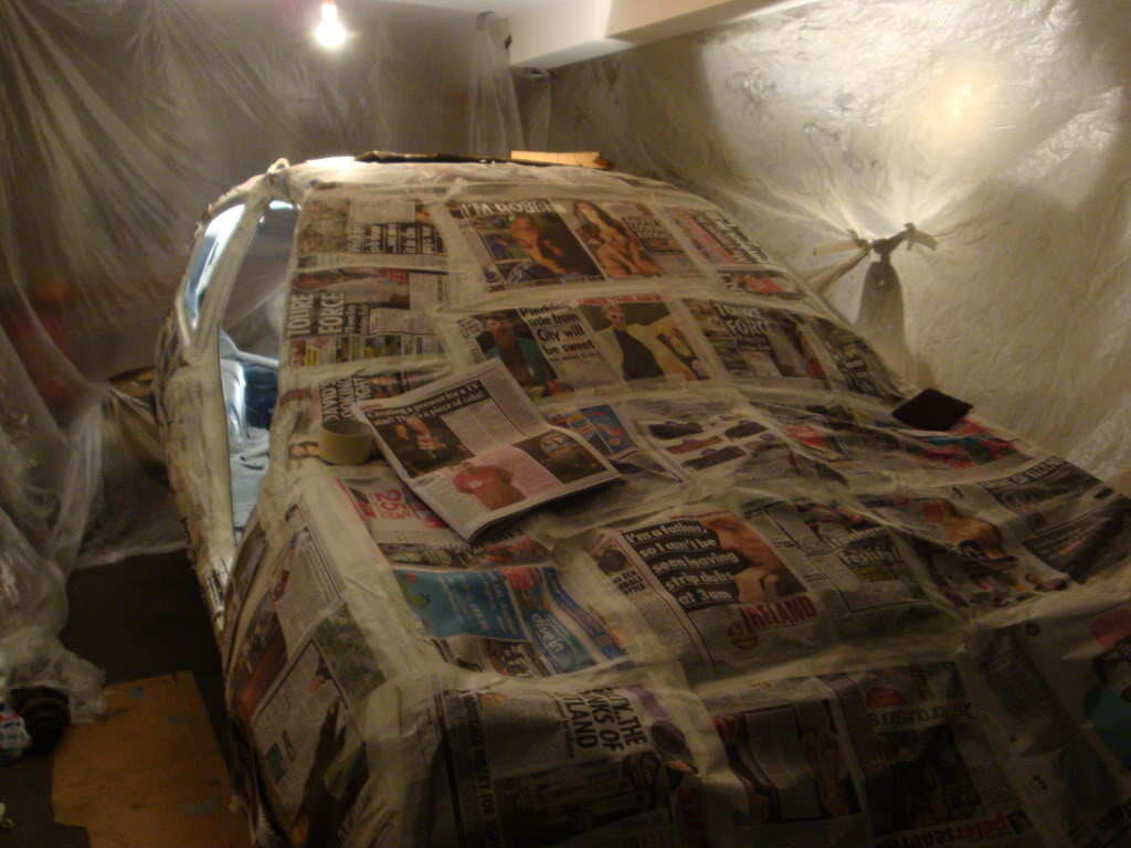

Rob has masked up the whole car, leaving just the interior exposed to the onslaught of Ryan and his gun.
After a good rubbing down and keying of the surface, we treated the fresh new exposed metal surfaces to a little bit of primer.
Rob and I then left the garage for a while whilst Ryan got stuck into the spraying. He emerged just under an hour later, looking like he'd just been a victim of "antiquing". The car came out a little better than he did, although there are a few patches that need rubbing back and treating to a second coat.
This will have to be left alone for a few days to properly harden before we do anything else. Once that is complete, we will be painting the doors and the cage.

March 19[SUP]th[/SUP] 2012:

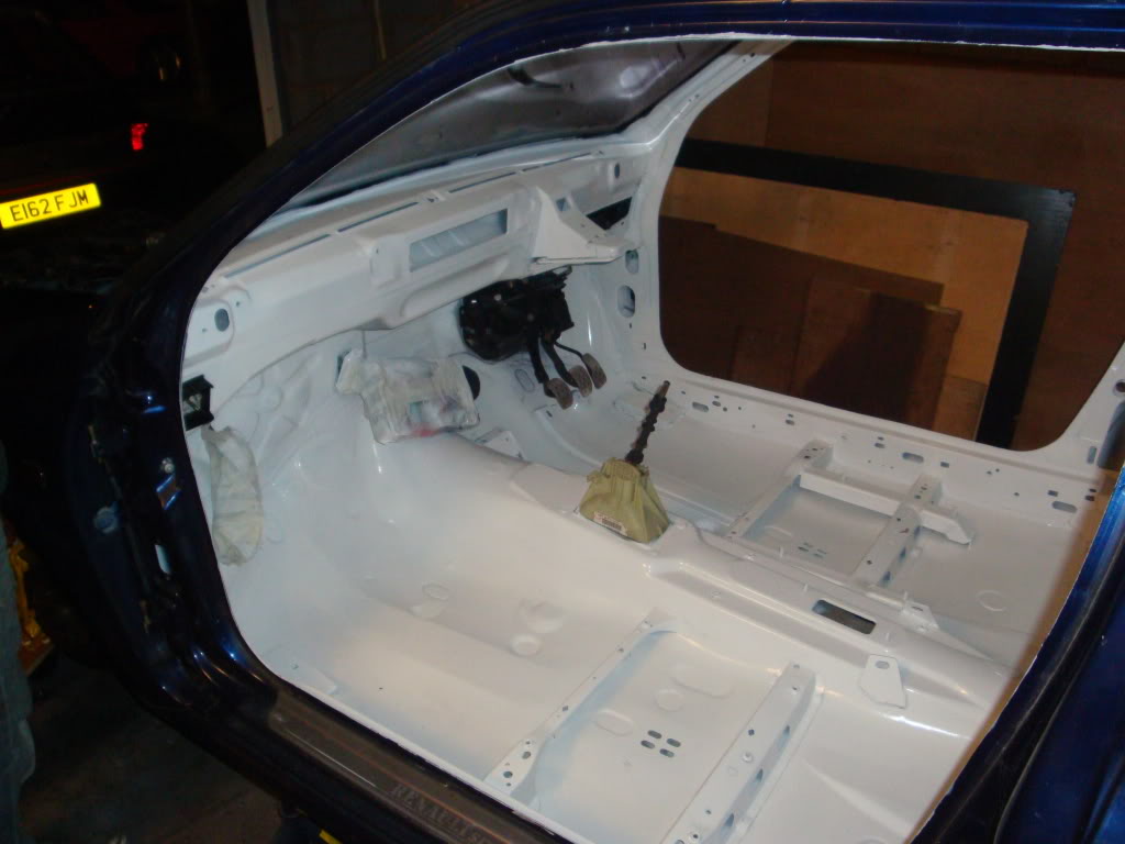

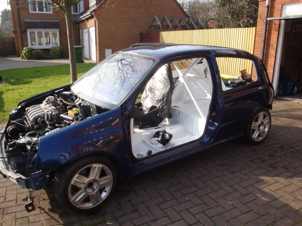

Another quick update; we've finished the painting stage!!! Ryan has been doing another wonderful job finishing off the remaining areas of paint for the interior. The inside of the car took a second coat to get rid of the imperfections of the first coat and the cage is now fully sprayed up. Once it's all dry in a few days, we can start putting the car back together, exciting times!
The white and blue seem to complement each other quite well. We had a fun 5 minutes un-wrapping the whole car; Rob likened it to Christmas time…. Ryan was just happy that he'd finished being engulfed in fumes!

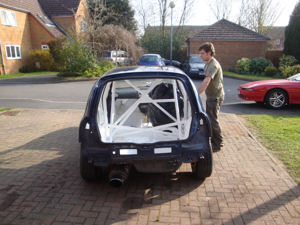

March 24[SUP]th[/SUP] 2012:

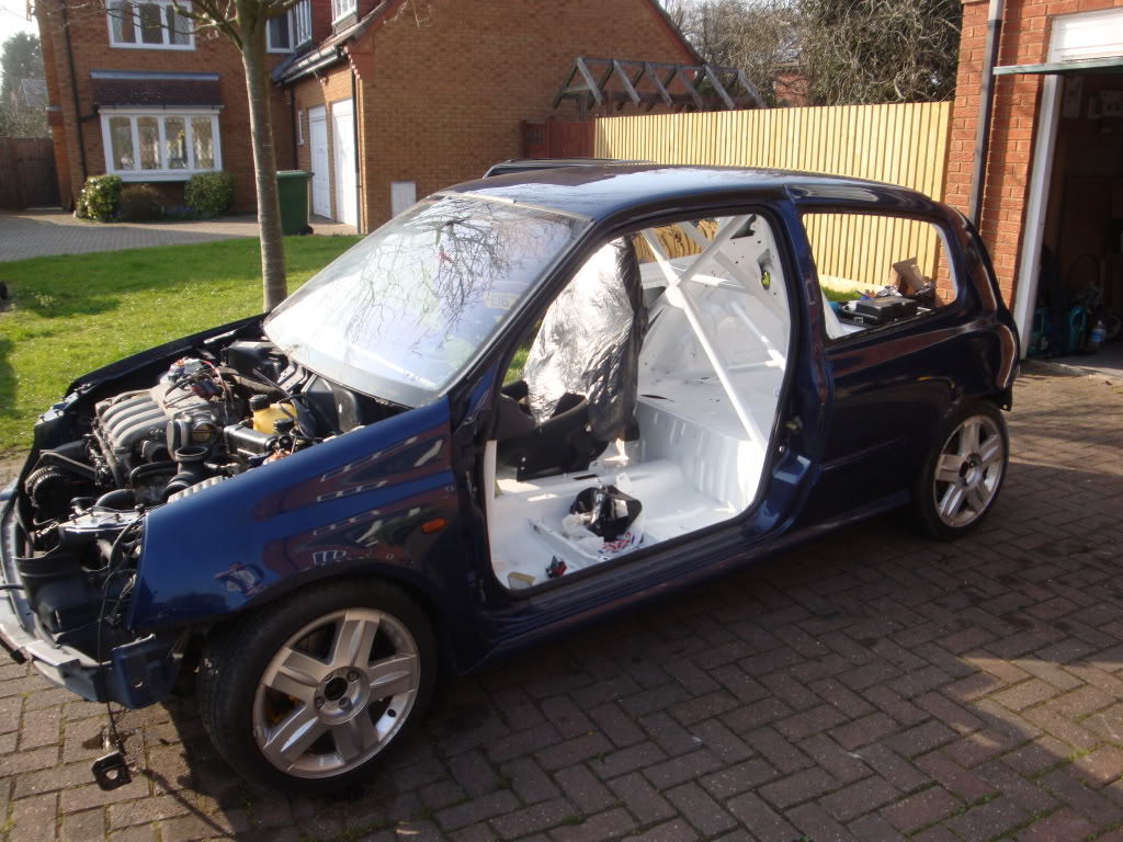

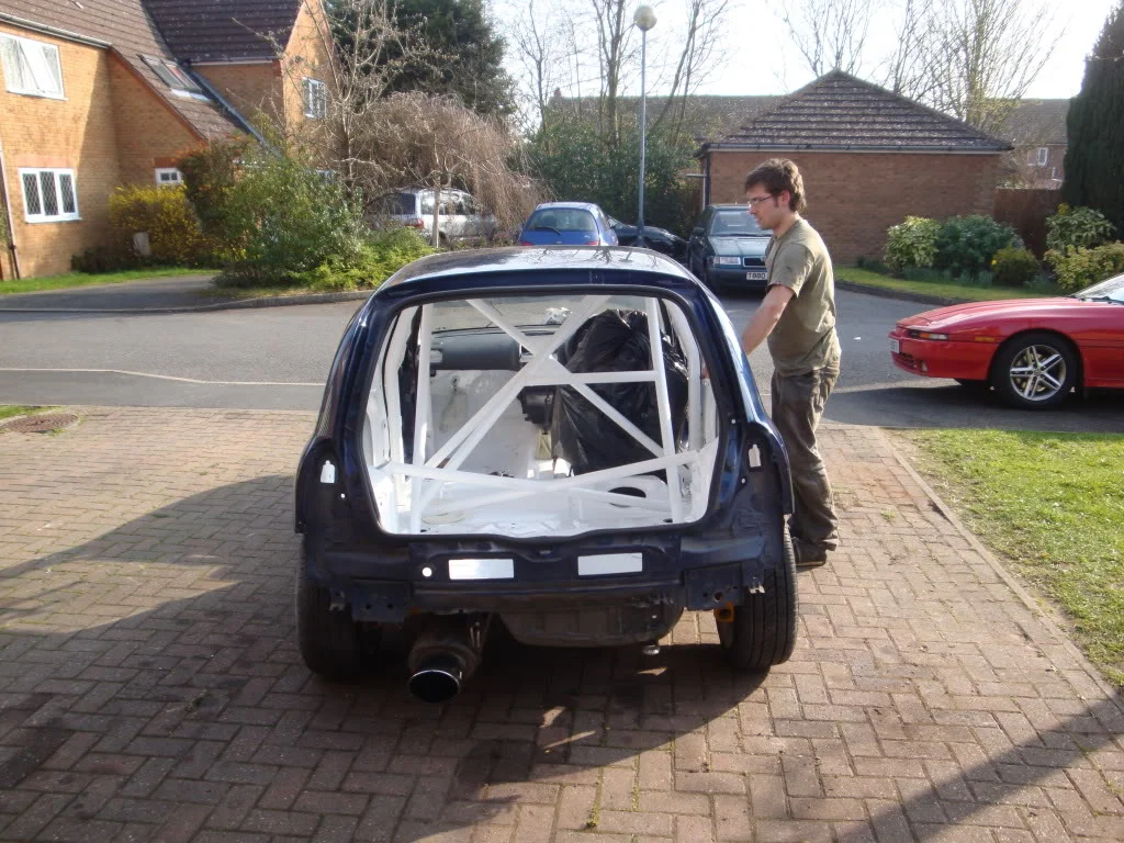

Now that the paint has properly hardened and we have stuck all the suspension in place, we have been able to roll the car out on to the drive and see what it looks like in the natural light. We are pretty pleased with it so far, plenty more to do though.

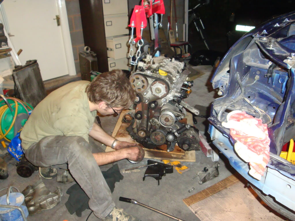

After a brief spell in the sunshine, the car was turned round and back in the garage it went for the engine to be removed. We have removed the air con and changed the cambelt, but the rest of the engine will remain standard for now, apart from an oil cooler which we will fit once its back in.

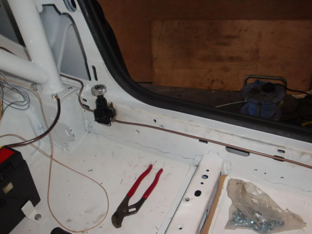

Now that the engine is out, we are going to remove the ABS module and replace the brake lines. We will then fit a bias valve to the rear circuit which we will place on the passenger side of the transmission tunnel, so we can access it easily.

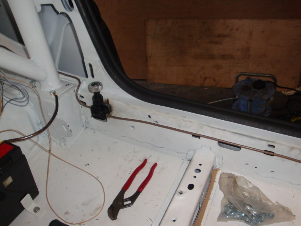

Regards using a normal brake bias adjuster, I had also intended on doing this, partly because the load adjuster/proportioning valve from the original donor 172 Cup was a ball of rust! and also to have some adjustment, appreciate they dont need much rear braking effort but figured there may be some scope for dry vs wet set ups.

we ran an adjuster and cup valve. never touched it once set so binned it off. You can use the cup valve to adjust it anyway, just means doing it under the car. easy enough.

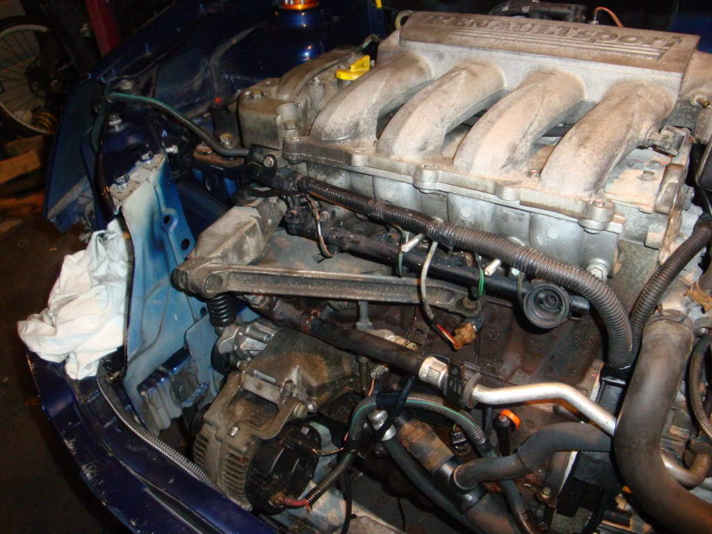

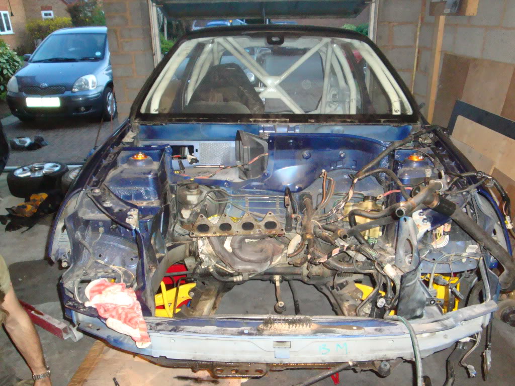

No April fools' jokes from us today……just another update on the build. A few more jobs have been completed, including the re-insertion of our lovely engine; the alternator bracket has been chopped down a bit and the alternator now sits in a lower position. Another neat mod that has saved us some money! It lowers the CofG of the alternator too.

The short Easter break can mean only one thing……more time in the garage working on the car! First job on the cards is to finish off the brake lines and fit our rear bias adjuster. We found a nice neat location on the passenger side which is out of reach of the driver and yet very accessible.

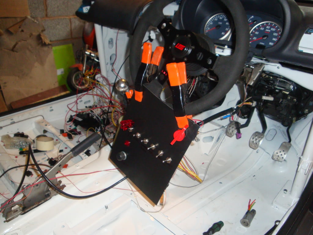

Rob's mammoth task of wiring has gone to a new level; his mock switch panel and the amount of wires everywhere show the extent to which he is going to make this all work. We still haven't had the engine running, but that isn't too far away now.

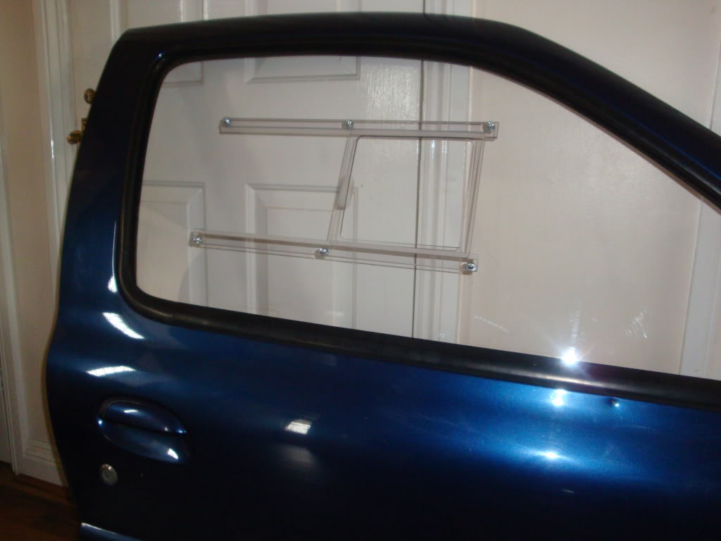

In the mean time, the polycarbonate for the doors has been fitted, complete with window slider for the driver.

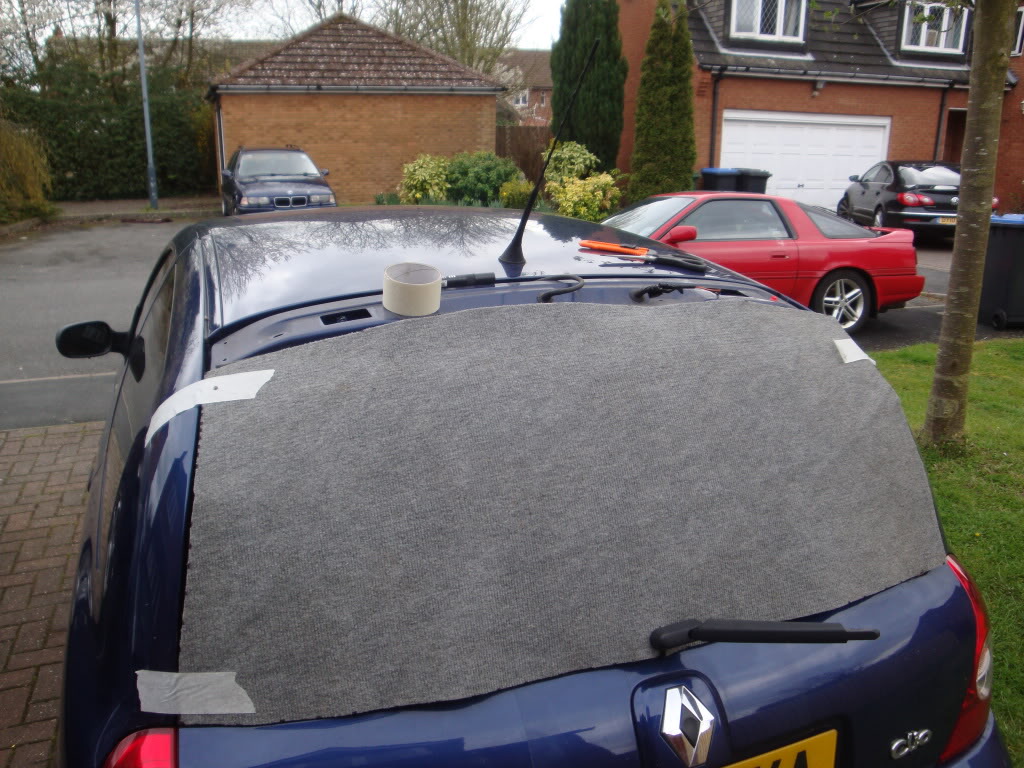

We're attempting to make our own rear screen too, using the road car we happen to have lying around as a template. We're not entirely sure if we'll manage to manipulate it in to shape, watch this space for the result of this one!

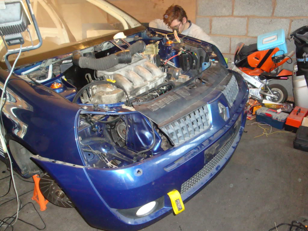

Finally, the bumper has seen a little bit of modification as we fit the towing eye and brake ducts.
