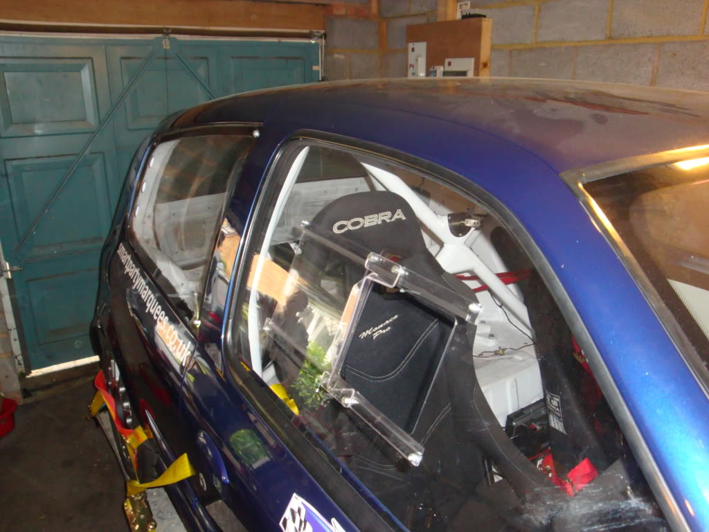

Door cards, you will fail scrutineering without.
He suggested I should get some door cards because of the sharp edges - but it seemed more like his preference than an obvious requirement.
I've just kept the std fogs for my rain light - although the scrut didn't actually check them. The way I read it it goes on about a centre light but then adds some cryptic wording that sounded very much like 2 std fog lights.
Regarding the potentially sharp edges left on the inside of the doors, why not use something like this? http://www.cbsonline.co.uk/category/Trim/Edge_Trims,b.html
I assume this is just a requirement of the Tintop series? As has been mentioned already there's nothing in the blue book i've seen which stipulates you must retain door cards, other than if your entered in production road saloons but then thats for a different reason.
By the time you have used that on all the edges, you might as well just put some kind of door card in.
We used signpost board, light as a feather.
It's also so you cannot get your hand caught in the door.
It was nothing tin tops specific. I think it was just his advice rather than a requirement.
Tony, I'm probably being thick but what is signpost board?
Im interested in making some cheap and lightweight doorcards for our car in the near future. Cheers
I used 3 or 4 mm Correx , stuff "for sale" house signs are made out off only the thinner 3 mm kind.
Link to the link in my thread.
This is perfect, just the kind of stuff I was looking for. I'll order some of that and get the door cards done in time for the first race. I was looking at other random plastics trying to work out how much it would cost but it was coming out a bit more than that.

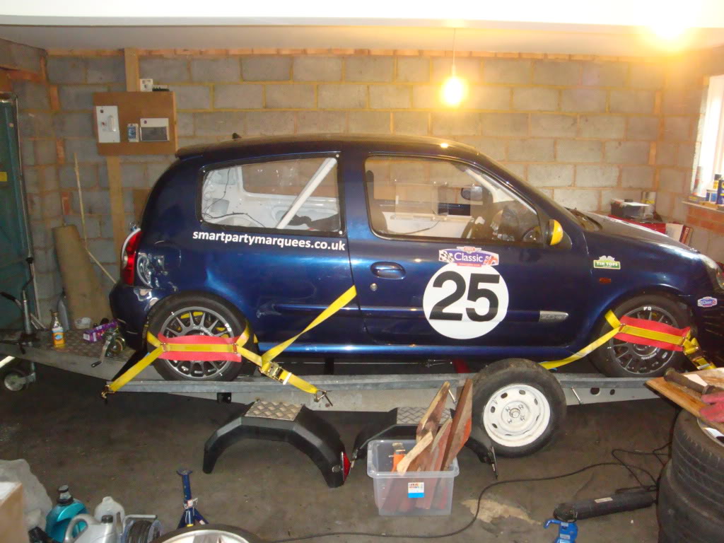

Ryan fetched the trailer from South Wales less than a week before the scheduled test day, brought it back, presuming we would just roll the car on and we were done. Not to be the case, it was 2 inches too narrow! A cardinal error by myself, looking at the track width and forgetting to add the width of a tyre on……what a rookie.
So, we figured out a way to widen the trailer and get the car on it whilst still maintaining the structure of the trailer. At the same time, we also had to fit brakes to the trailer; there was a reason it was a steal at £350!!! Nonetheless, we managed to get it all done the night before the test, finally finishing at 1am.

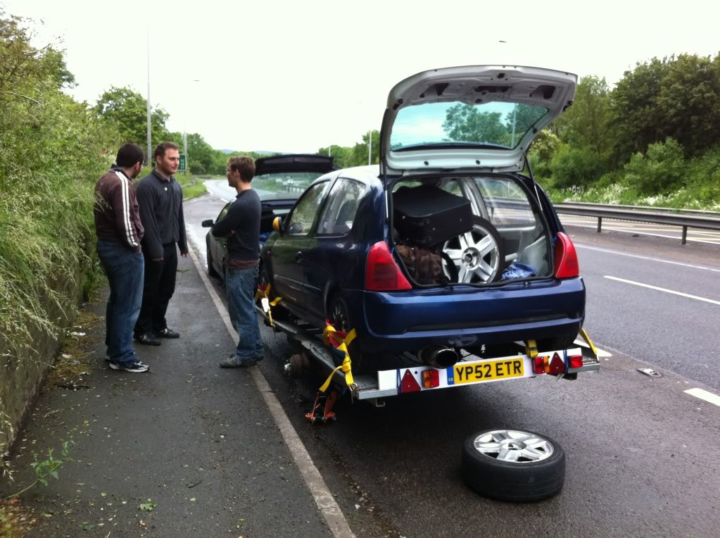

The next morning, with an early start of 6am and with everything all well secured, we set off towards Lincolnshire. We were tight for time, but we were making good progress and just about on track to reach arrive on time for the driver briefing at 9am. Then, as we got towards J28 on the M1, Ryan spotted a chunk of rubber fly off the trailer tyre!! So, he pulled over almost immediately and I joined him on the hard shoulder. We inspected the delaminated tyre; luckily it hadn’t burst, but it needed to be changed immediately. We called the track to tell them we would no doubt be late now and they said they would be able to accommodate. So it was now a case of getting the trailer off the motorway and getting the tyre replaced.
Fortunately, we were only a mile from the junction and so we limped off the motorway. The wheels were soon off and I was on my way into Mansfield to find somewhere to change a tyre at 8am on a Saturday. Luckily, we found an ATS that had 1 tyre in stock, so we replaced the failing tyre and made our way back to the rest of the gang waiting patiently with the car. We were soon on our way again and we arrived at the track at around 10.30.

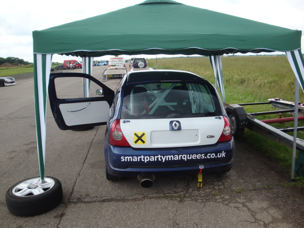

After the exclusive driver briefing for ourselves (thanks to the Javelin trackdays guys for that!), we were ready to get the car on track.
We had a little under an hour before the lunch break, so we made the priority of getting each of us on track before we had to stop for lunch. So, 5 lap runs it was. We all felt reasonably comfortable with the car, but we could all tell it needs a fair amount of setup work.
After lunch, it was time to get in the car again and get some longer runs in. We each did 10 lap runs and kept the setup the same so we could all give feedback from the same basis. We had a few friends with us, so we had passengers on board throughout the day, this might change the next time out, but that isn’t the limiting factor by any stretch at this stage.
Towards the end of Ryan’s run, he started to feel a slight loss of power and so brought the car in. When we tried to restart the car, we had no power at all and it wasn’t even trying to crank. After further inspection, we noticed that the alternator cable had come off and we were obviously getting no charge from it. A new nut and the problem was solved!
Or so we thought……that wasn’t the end of it! It was still struggling to start and we noticed that the immobiliser light was flashing again. More checking of the wiring and no errors could be found! A few more cranking attempts and then suddenly it decides to start!!! We put it down to one thing….it’s French! (Or the ECU has decided to protect itself and it needed a hard reset). Either way, the car was going again and we had about an hour left to run the car.
So, we decided to run the car for the remaining time we had left. All 3 of us would take it in turn to drive, doing around 15 mins each with a reasonably quick change over. We had changed the damping rates a small amount and lowered the front tyre pressures too. This seemed to make a positive difference, but still plenty of room for improvement! The car ran solid for a good 45 minutes and the engine didn’t miss a beat. All in all, we’re pretty happy with the car, it feels pretty solid. Another list of jobs has obviously been created, but we are very much looking forward to getting it out again and pushing it a bit harder once again.

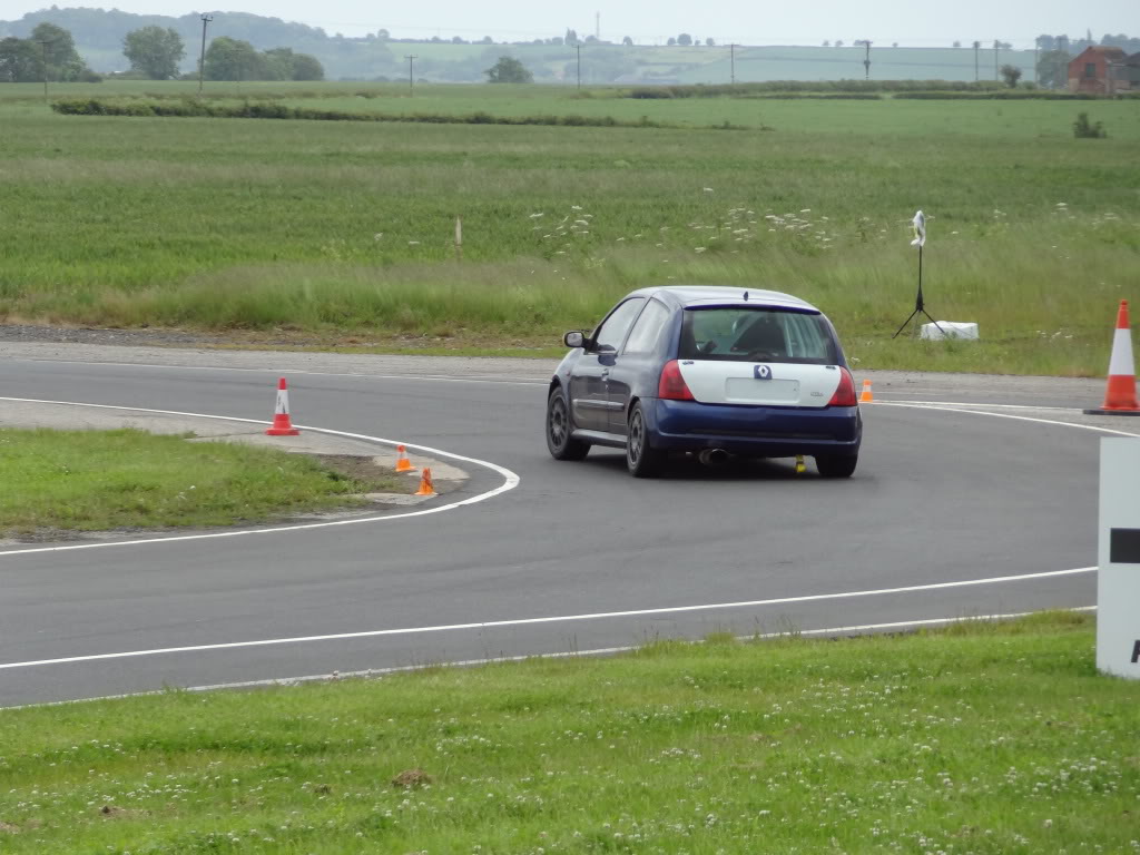

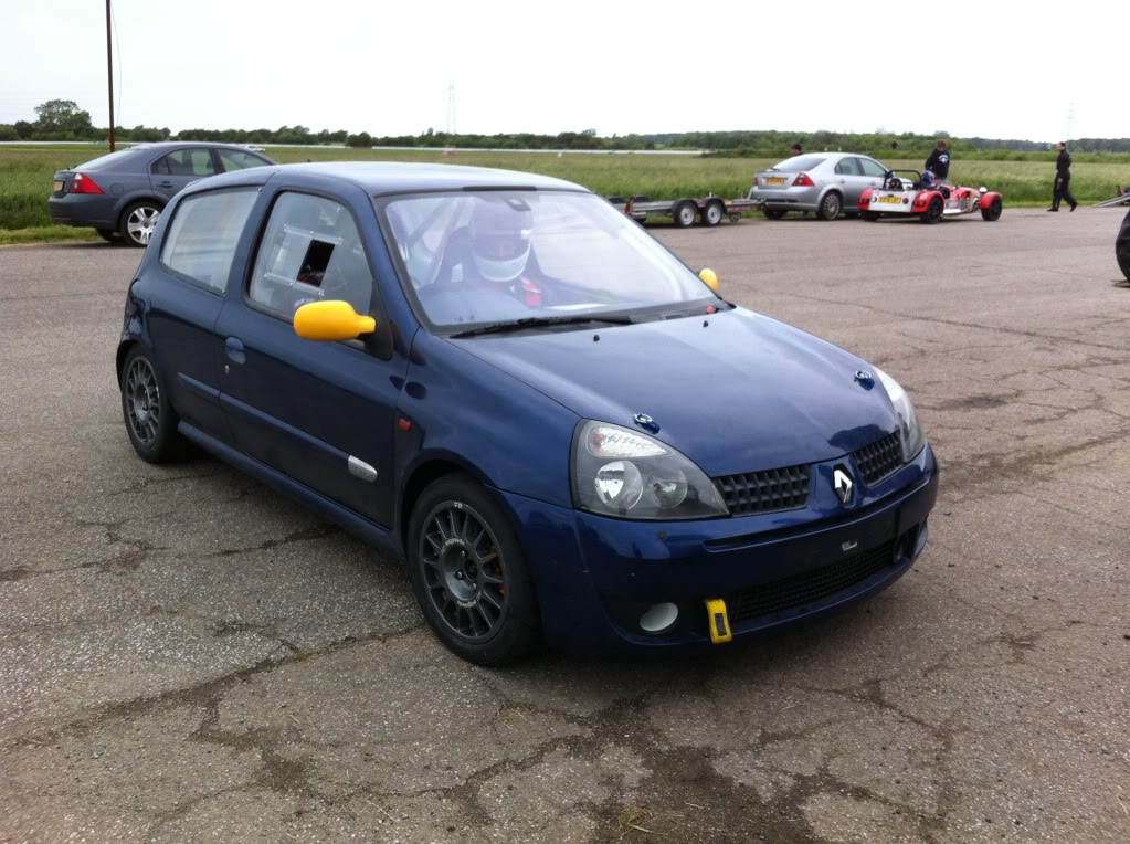

We made our way up to Blyton Park for our trackday and unlike last time, we were bang on time!! We felt a lot better prepared second time out and even got ourselves a little gazebo to protect us from any sudden downpours which were bound to come our way.
We had sat down prior to the test to draw up a bit of a test plan for the day. We would start the morning doing short runs to get the tyres up to temperature and set our pressures. Then we would monitor the temperatures across the tyres with an eye for adjust camber at front and rear. I was enlisted as driver for the morning, whilst Ryan and Rob would do all the measuring and changing of pressures. Since the last test, we had decided to fit a rear anti-roll bar and on the first run out, it already felt a little more positive. However, the car was still understeering quite a bit and in certain corners it would hop around a little.
Around 11am, the most brutal short shower fell, completely soaking the track. We decided to continue running the car so that we would get a good feel for the changing track conditions. Unfortunately at this point, we managed not to record any footage of the car which was a shame as there were a few hair raising moments! The sun came back out within an hour of the rain first starting to fall and the track began to dry up. We had been smart enough to take the opportunity for us all to get out in the wet, so we all got a feel for the wet conditions.
As we approached the lunchtime break, it was decided that we needed to remove a rear camber shim, so that is what we did! After the break, with the sun shining once again, it was time for us all to rotate in the car and start to work out how to set our dampers up, which we still had not really properly explored. We made a few minor changes which seemed to move the car in the right direction but it was still not handling great. After more adjustment, we began to realise that the springs were too soft for the damping setting we had set it to and considering that we were nowhere near the stiffest damping setting, this was worrying. Near the end of the day we made a bigger step in the soft direction with the dampers and the hopping of the car began to dial itself out, confirming our suspicions. We have decided that we need to get some stiffer springs for the next time out in order to match the capability of the dampers we have.
Nonetheless, the afternoon was a success and the weather held out for us to do a lot of dry running. We all went in the car with each other, observing closely, ready for feedback post test. Ryan managed to post the fastest time of the day and the video should be viewable below…..

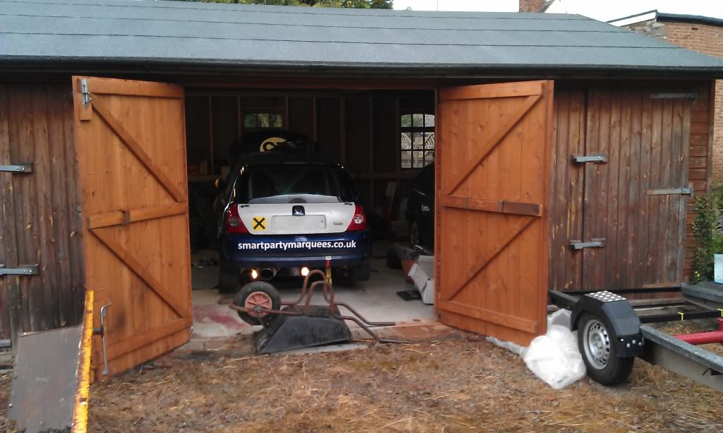

All change please, all change. As you may have read from the last update, I (Dave) have had to vacate my previous property where the car was being kept. The original plan was to keep the car at Ryan’s place, but I had an offer from a colleague at work to hire out his garage (very close to my now old house). So, we decided to take him up on the offer!
The new setup (seen above) is a 3 birth garage which we affectively have two-thirds of. We will still share the usage of the garage, but it is predominantly for us to work on the car. We can keep the trailer outside as well, as there is a gate locking it inside a small courtyard area. The garage also has the most useful pit too, it’s great! First impressions are very good, the usability of the place is even better than we had at my previous property and we even get cups of tea!! Although it will cost us, above the zero cost for Ryan’s garage, it will be far more convenient for us here and in terms of overall travel time, it will prove to be a fair bit less between us.

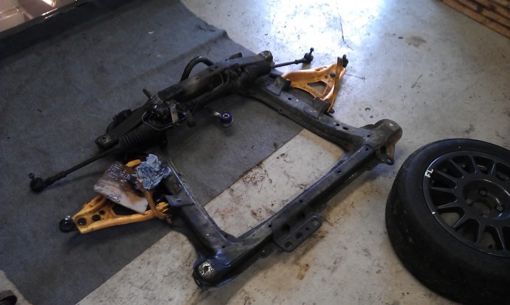

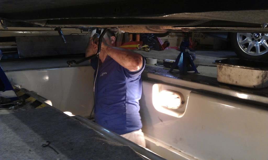

The garage and pit have already proved their worth, as we began some more work on the car. The task for the evening was to the remove the subframe along with the steering rack to carry out a few other jobs. We had a starter motor problem that needed diagnosing and our assumption was that it needed replacing, so access to this would also be essential.
We were very pleased with how the increased access helped us get to all the necessary fixings and the subframe was soon free. After being able to get to the starter motor, we can see that the feed to the solenoid has come off….so we are very much hoping that this is the reason we had a problem. We won’t find out until the subframe goes back in though, because we don’t want to start the engine whilst it’s not fully supported. Finger’s crossed that has saved us another job.
Next on the agenda is to refresh the steering rack by replacing the rod ends and get a good solid mounting for the rack on to the subframe. We will then change the wishbone mounting position for a more suitable wishbone angle. A couple more small jobs on top of this and the car will be ready again for another test on August 31[SUP]st[/SUP] down at Castle Combe. More to follow soon!
