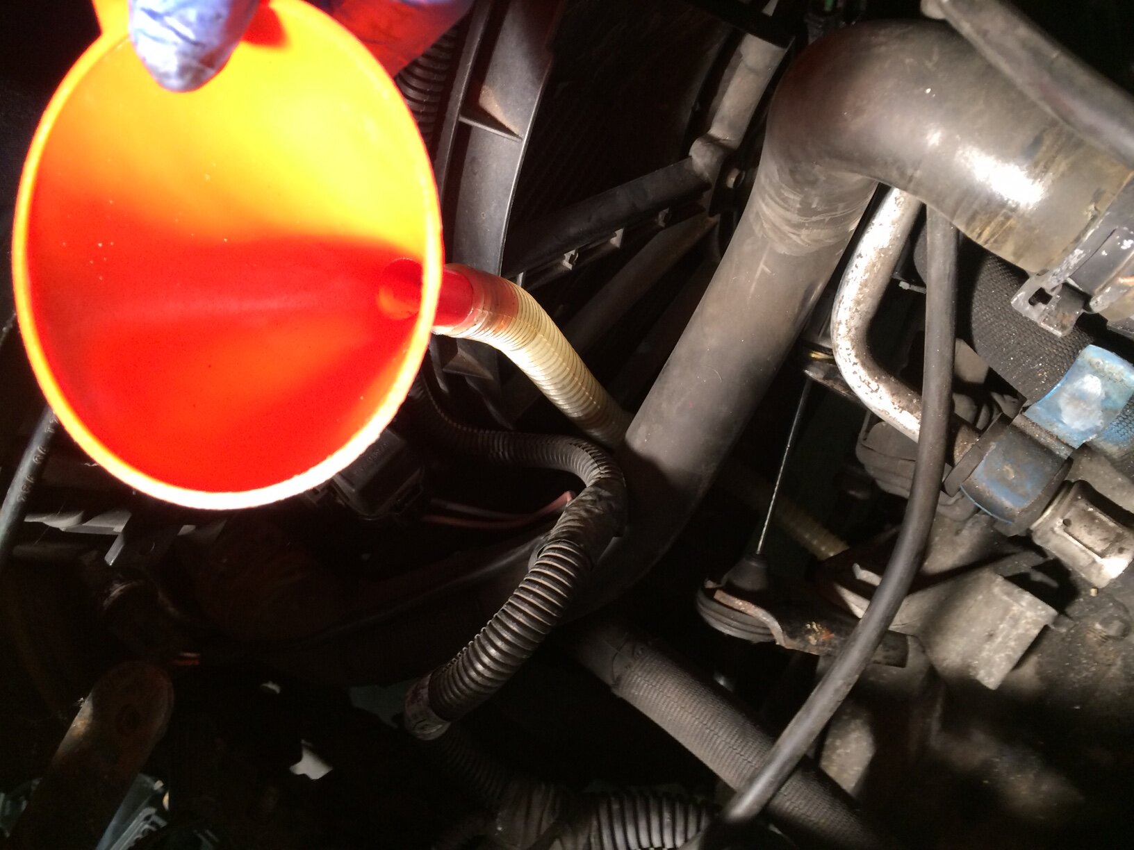

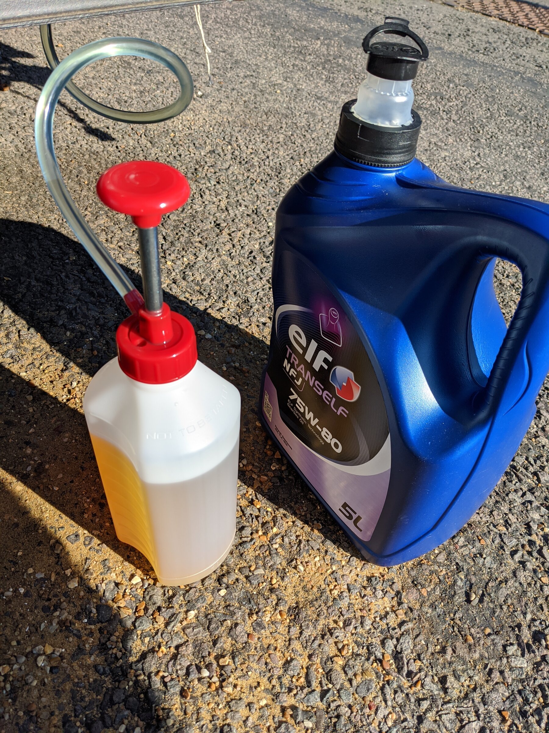

Changed the gearbox oil on my 182 yesterday and was pretty chuffed with my home made bodge to fill it, so thought I'd share.

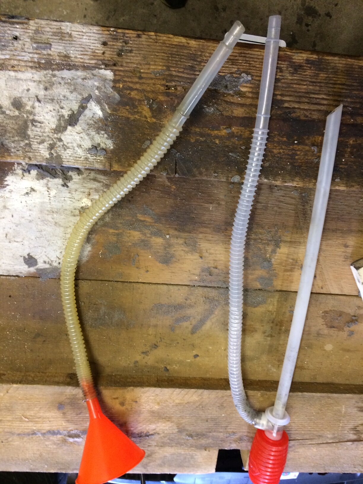

Using one of these cheapo hand pumps from ebay (pretty useless as a pump tbh), cut the flexible end down into the filling hole.

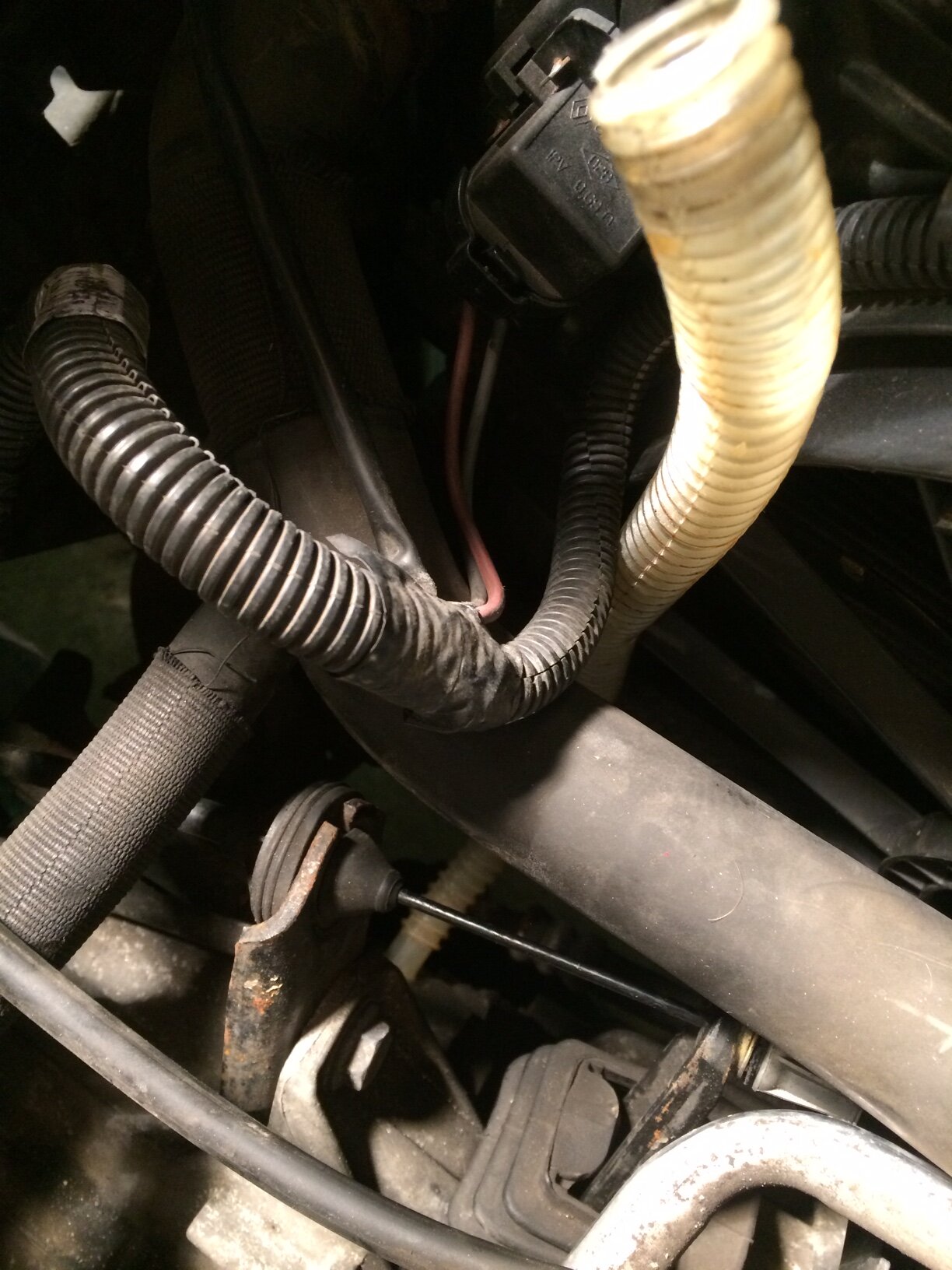

Then slotted a funnel into the tube I'd cut and voila, filled very easily. Job done!

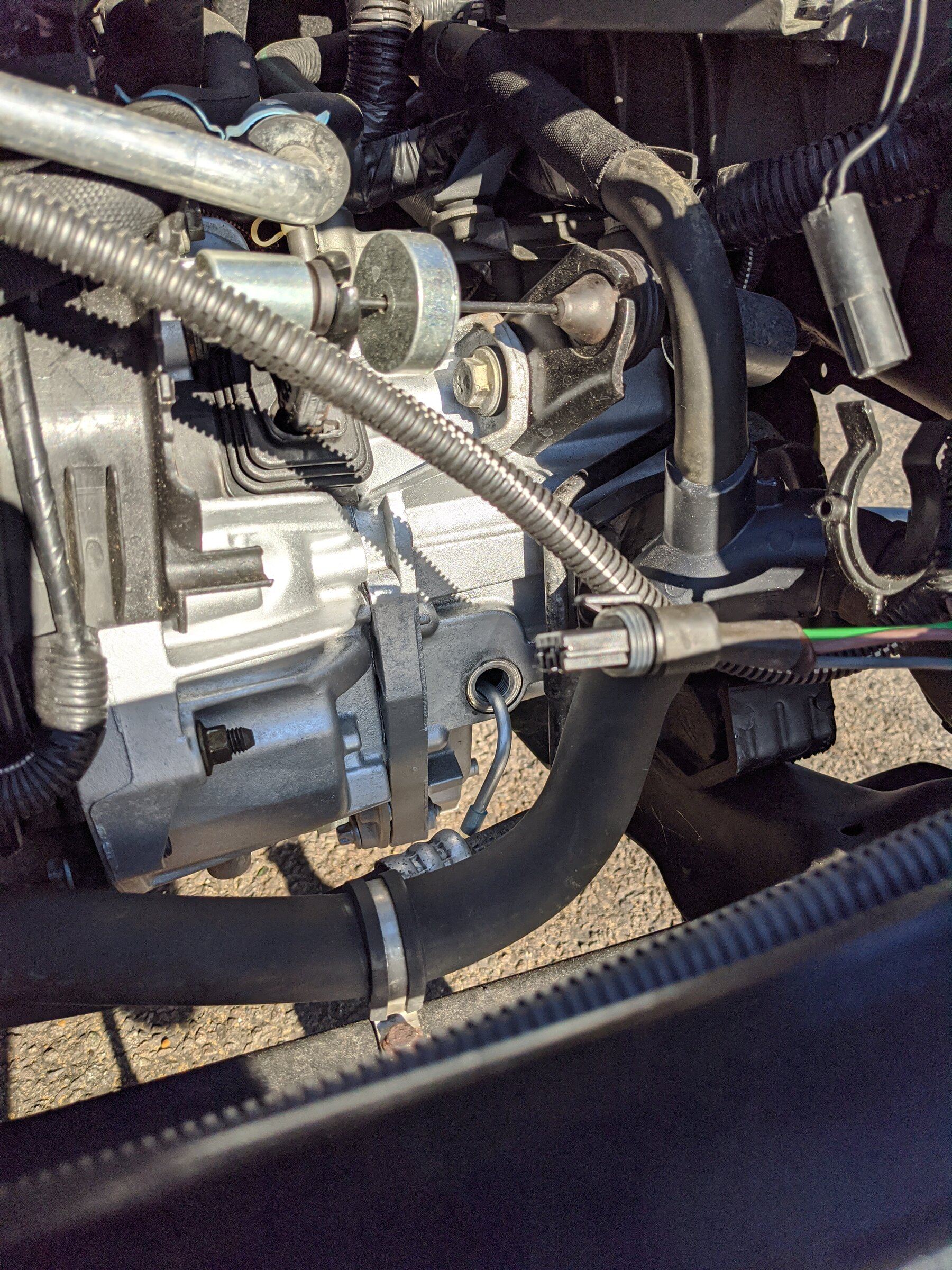

The solid bit on the end slots right into the gearbox nicely too, so doesn't fall out. Pics below.

Cut the flexible part of the pump off and fed down into gearbox filling hole... typed it a bit quick!
Just used what I already had, no expense necessary :LOL:
