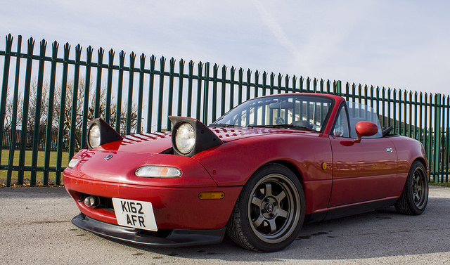

Thought I best do a massive update on where the car is at.

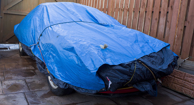

It spent about 6 months like this:
IMG_5217
by theycallmepaul, on Flickr

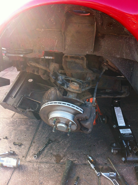

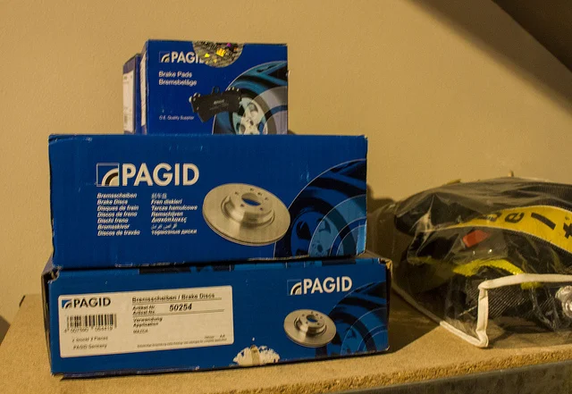

Pagid brakes for now (now it is mot'd and on the road I'll decide what I'm doing brake wise)
IMG_5221
IMG_5214

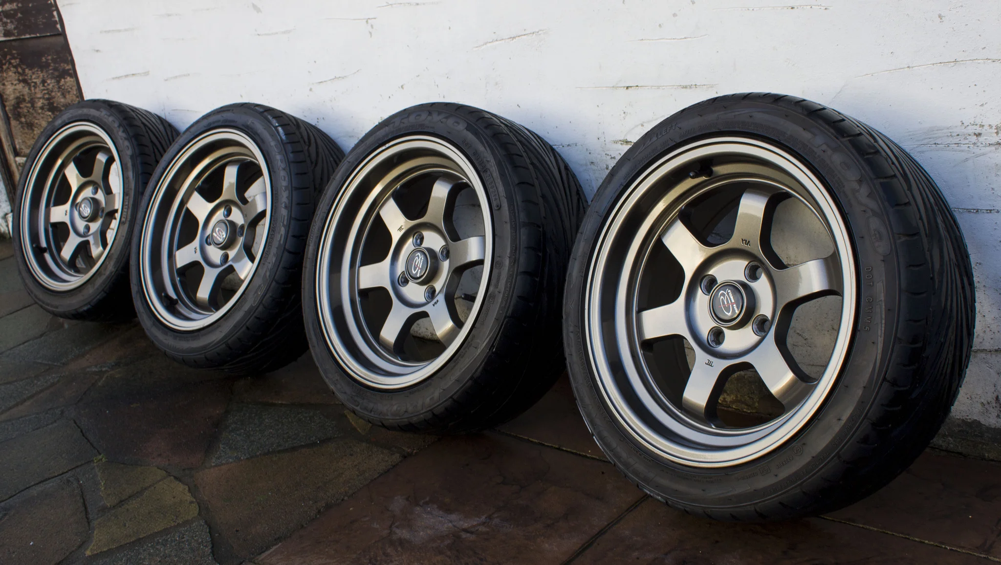

Picked up some Rota Grid V's, these currently have 45 profile tyres on but once they run out I'll be going for some 50's on there as they are much cheaper...with the main aim to be track use this is the most sensible option.

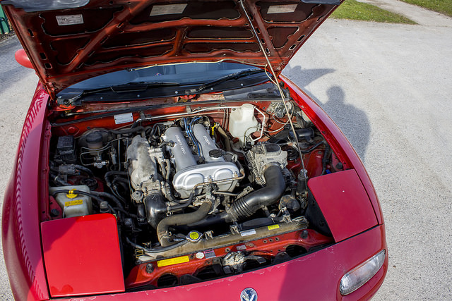

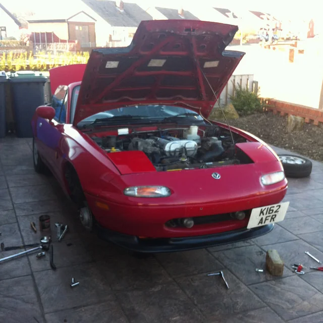

Gave the car a full service, new rocker gasket and o ring on the cas, then got it mot'd and it passed first time with only 3 advisories. I also gave the rocker cover a quick going over while it was off the car to tidy it up.
IMG_5629 by theycallmepaul, on Flickr

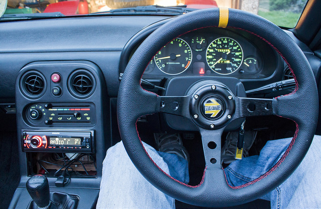

Sorted the interior out for now, smaller dished steering wheel (being 6ft 5 this helps massively with space), put in a cd player that picks up something other than radio 2, I also now run a shifter extension and have filled in the gap below the cd player.

I then picked up some coilovers, just cheap ones for now until I get sorted with some work on the clio then I'll go for some hsd or meisters, not too sure what would suit me more just yet.
Anyway I whacked it all together:
Untitled by theycallmepaul, on Flickr

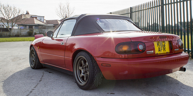

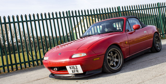

And now it looks like:
IMG_5628 by theycallmepaul, on Flickr
IMG_5635 by theycallmepaul, on Flickr
IMG_5645 by theycallmepaul, on Flickr

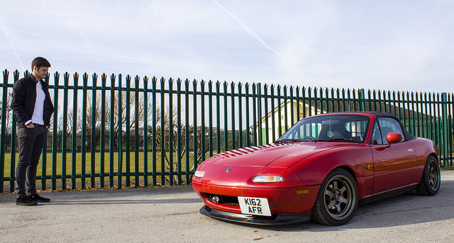

And one with my brother who is of similar size to me to show how daft we both must look with it...
IMG_5626 by theycallmepaul, on Flickr
Since the pics were taken I have raised it up a bit due to it not wanting to go anywhere without scraping with myself and a passenger in, it is now set to a much more sensible and usable height.

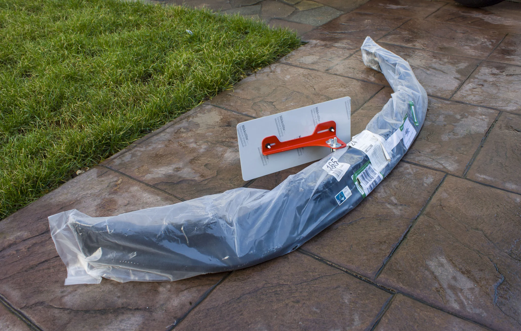

Next up I'm going to try and find a new red nosecone and passenger wing to replace the faded ones and then it will be better coilovers and half cage time along with some seats.

This looks awesome. How do you find the pagid stuff, I have them on mine and they are brilliant on the road and track
Thank you! I haven't had much experience with them yet to be honest, I've literally done about 10 miles in the car since fitting them, the 1.6 brakes are known to be quite poor anyway so somewhere down the line I'll upgrade to the 1.8 stuff which is a very easy fit.

Yep, get the brakes from a mk2.5 1.8 and, as much as it's not like wrapping your rotors in Wilwood metal, you will stop better.
