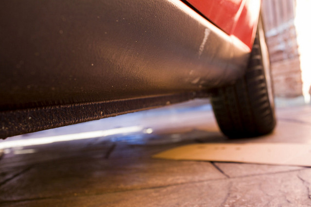

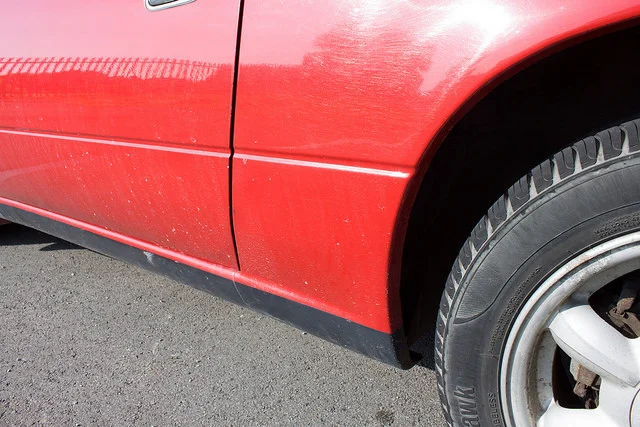

The car seems pretty solid underneath, the sills are good with only a tiny amount on the drivers rear sill, arches are all solid.

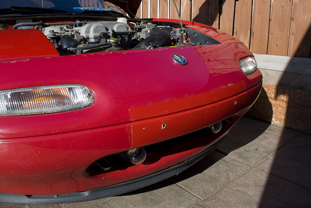

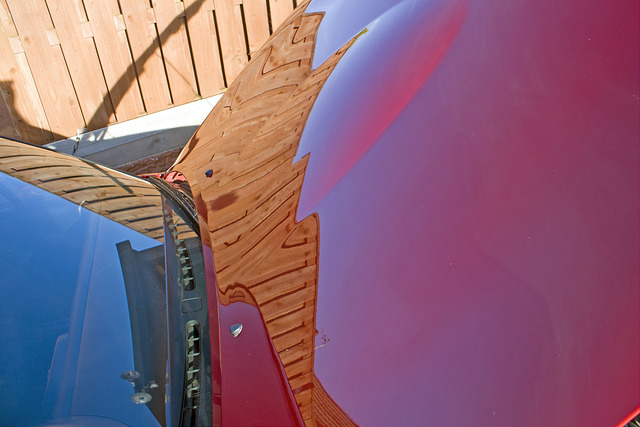

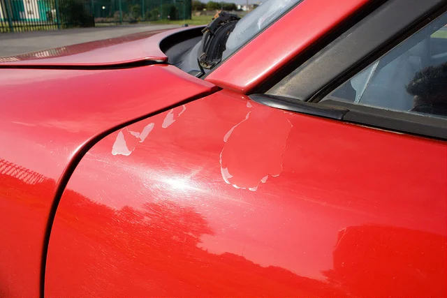

The paint needs attention, the bonnet is all faded which is an easy fix and there is laquer peel on both doors/ front bumper
Rocker gasket is seeping a small amount of oil but nothing terrible
Possible a wheel bearing or something whining a bit whilst being driven
Passenger front arch has a slight dent
I need to realign the bonnet a bit

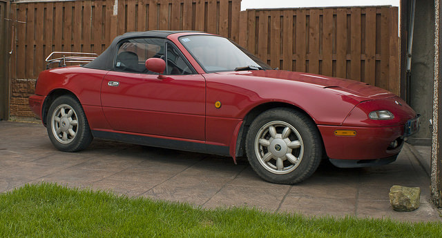

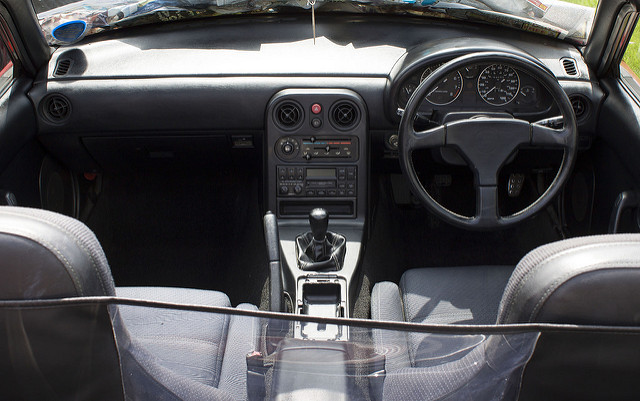

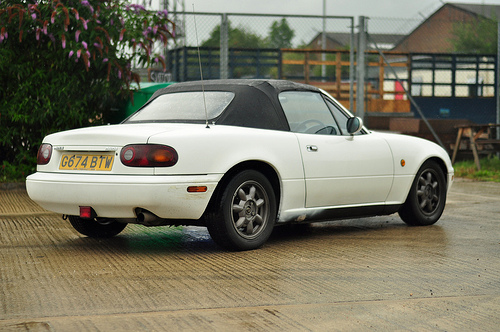

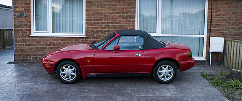

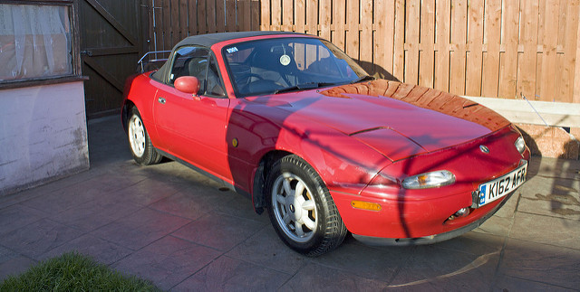

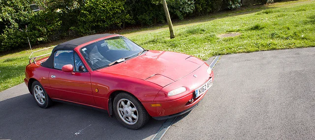

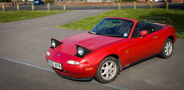

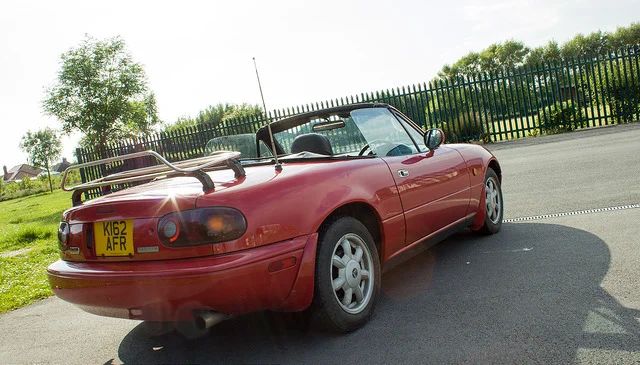

Anyway a couple of pics after I picked it up:
IMG_3745-2 by theycallmepaul, on Flickr
IMG_3749 by theycallmepaul, on Flickr
IMG_3752 by theycallmepaul, on Flickr
IMG_3757 by theycallmepaul, on Flickr
IMG_3747 by theycallmepaul, on Flickr
IMG_3748 by theycallmepaul, on Flickr

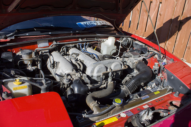

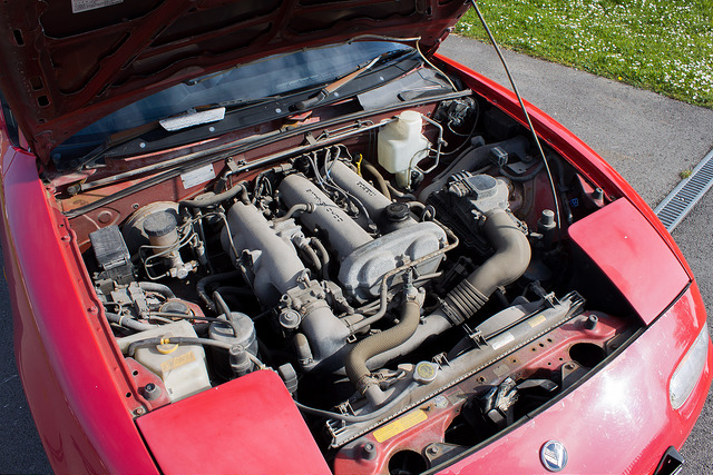

The engine bay needs a damn good clean!
IMG_3758 by theycallmepaul, on Flickr

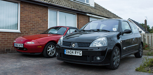

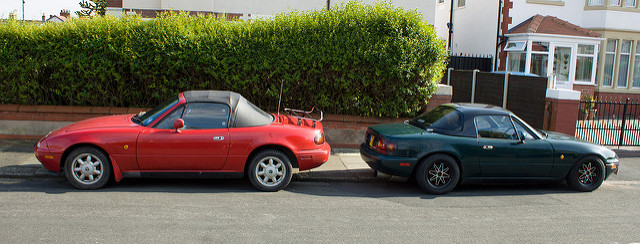

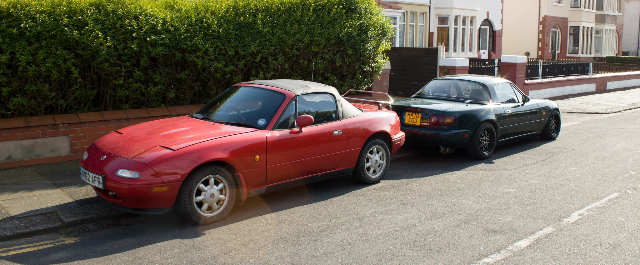

With my friends MX5:
IMG_3743-2 by theycallmepaul, on Flickr
IMG_3744-2 by theycallmepaul, on Flickr

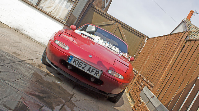

Todays job was to give the car a good clean and start doing a couple of bits and pieces.
IMG_3762 by theycallmepaul, on Flickr

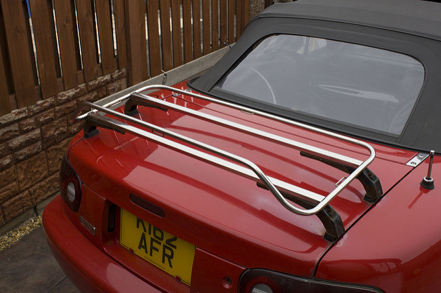

I started off by trying (and failing) to remove the luggage rack, one snapped bolt head and another rounded off torx bit (I hate these things) and it is still well and truly stuck to the boot so back to the drawing board.
IMG_3761 by theycallmepaul, on Flickr
I then gave the interior a good clean which it really needed, I'll try and pop up the video off the mats that those on my instagram may have seen.
IMG_3769 by theycallmepaul, on Flickr
I also took out the wind breaker and cover to give them a good clean, it all came up very nice considering that interior is 21 years old.

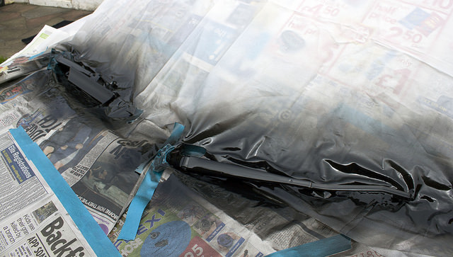

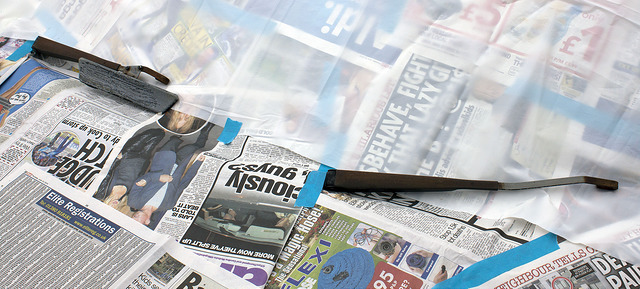

Next up I tackled the nasty rusty wiper arms, these were sanded down and then sprayed with 4 coats of hammerite spray.
IMG_3765 by theycallmepaul, on Flickr

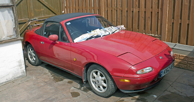

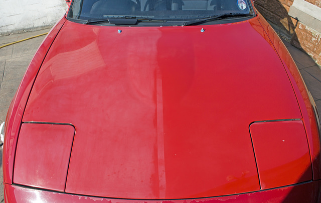

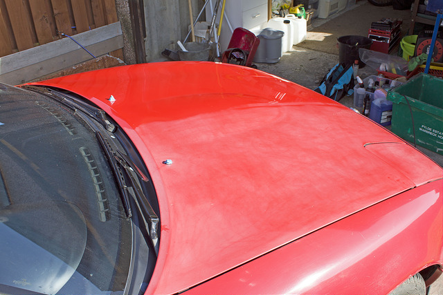

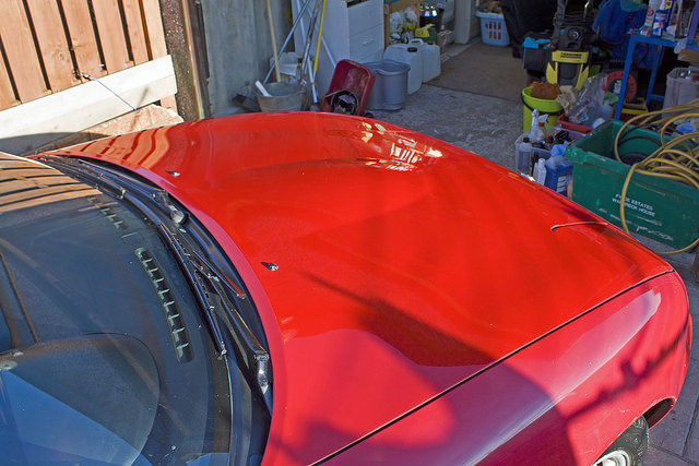

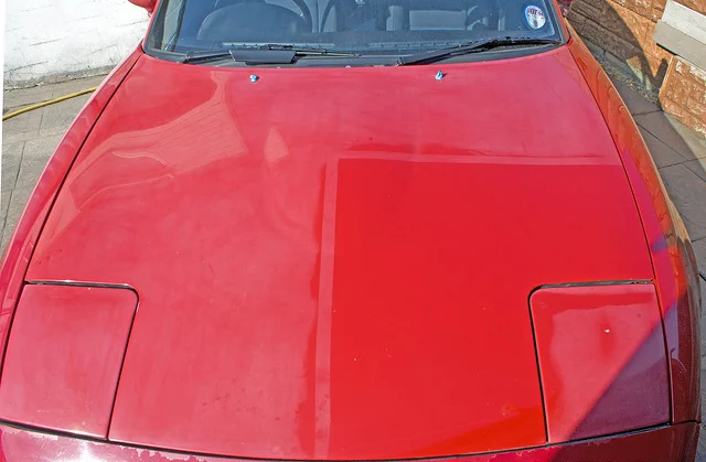

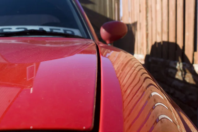

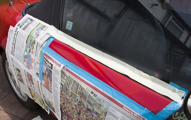

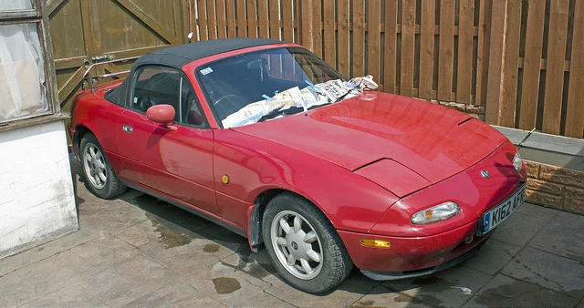

This evenings job was to give the exterior a good wash and start correcting the paint, I got the bonnet and headlight covers done, tomorrow I'll make a start on the front wings...
IMG_3775 by theycallmepaul, on Flickr
IMG_3779 by theycallmepaul, on Flickr
IMG_3777 by theycallmepaul, on Flickr
IMG_3783 by theycallmepaul, on Flickr
IMG_3784 by theycallmepaul, on Flickr
IMG_3788 by theycallmepaul, on Flickr
Looks much better, at the same time I also fitted new wipers, a new front fog light bulb so both now work and topped up all the fluids.

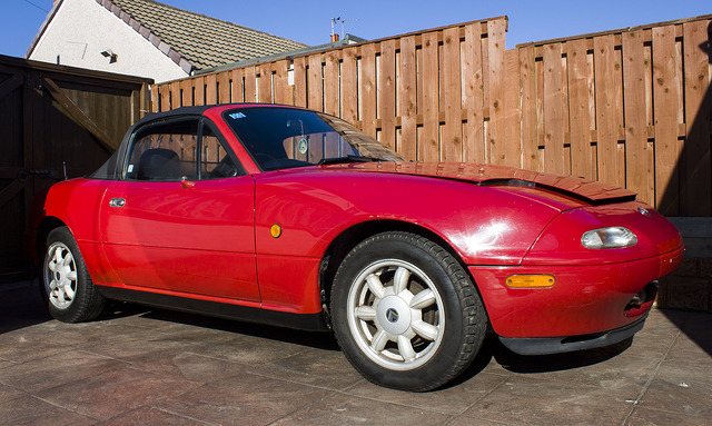

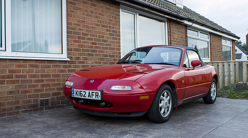

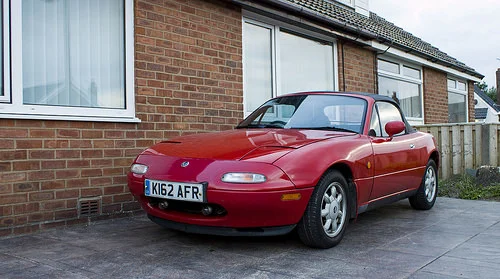

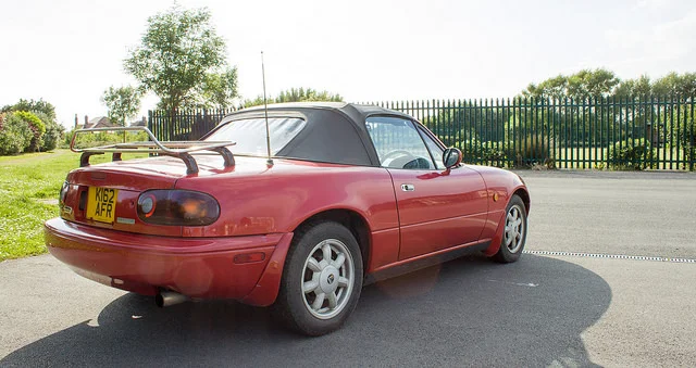

As it stands the car looks like:
IMG_3964 by theycallmepaul, on Flickr
IMG_3965 by theycallmepaul, on Flickr
I'm happy I finally got the luggage rail off! but it has left a few marks on the boot that I need to polish out.

Sort out the laquer peel on the doors

Paint the sills in black Hammerite - they'll look a lot tidier being all one shade!
So pauper, but it is a good way to keep your sills in vaguely good order.
I'd suggest a f*&^-ton of hammerite / other protective paint,then prep the surface and repaint in body colour. But I don't know about painting stuff, so that may be a bad idea

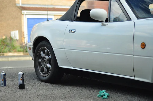

Don't bother painting them the same colour as the body. It's too hard to get a good colour match and IMO it doesn't look as good anyway. Tin of satin/gloss black hammerite, mask it off and job's a good 'en.
From:
To:
Took about ten minutes!

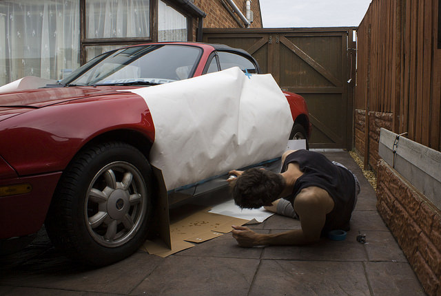

I managed to get a couple of bits and pieces done to the car this weekend.

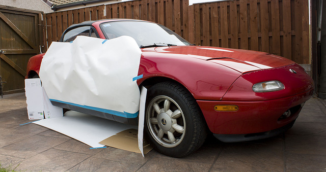

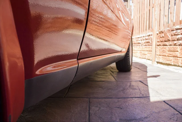

Firstly I painted the sills to keep JoeyD happy.
Before:
IMG_3979 by theycallmepaul, on Flickr
I treated them with some Kurust first underneath/ the rear of them to just be doubly safe:
IMG_3984 by theycallmepaul, on Flickr
Then masked up and sprayed:
IMG_3988 by theycallmepaul, on Flickr
During which I got papped in my gypsy vest:
IMG_3992 by theycallmepaul, on Flickr
Done and looking much better:
IMG_4004 by theycallmepaul, on Flickr

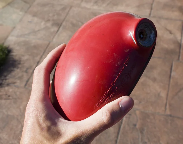

when I went to unfold my drivers wing mirror back out it popped off in my hand, turns out the bolt was rather rust and snapped clean in half
IMG_4005 by theycallmepaul, on Flickr
I then sanded down the edges of the peeling laquer on the door and put two coats of laquer over it to stop it peeling any more until I decide to sort the paintwork properly (yes that is a load of overspray on the window)
IMG_3999 by theycallmepaul, on Flickr

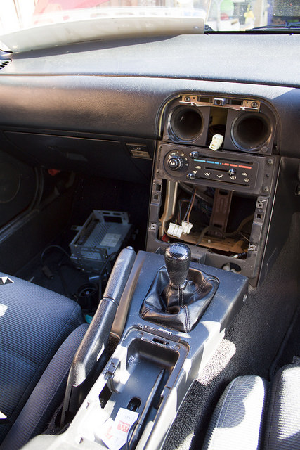

And lastly I pulled apart the interior to get rid of the awful standard tape player, I found some old japenese documents behind there which I thought were pretty cool, I think one is some sort of parking machine ticket but the rest it would be good to find out what they are.
IMG_4008 by theycallmepaul, on Flickr
IMG_4001 by theycallmepaul, on Flickr
IMG_4002 by theycallmepaul, on Flickr
I'm hoping to get a couple of bits ordered this week to start on the mechanical side of things next weekend.
