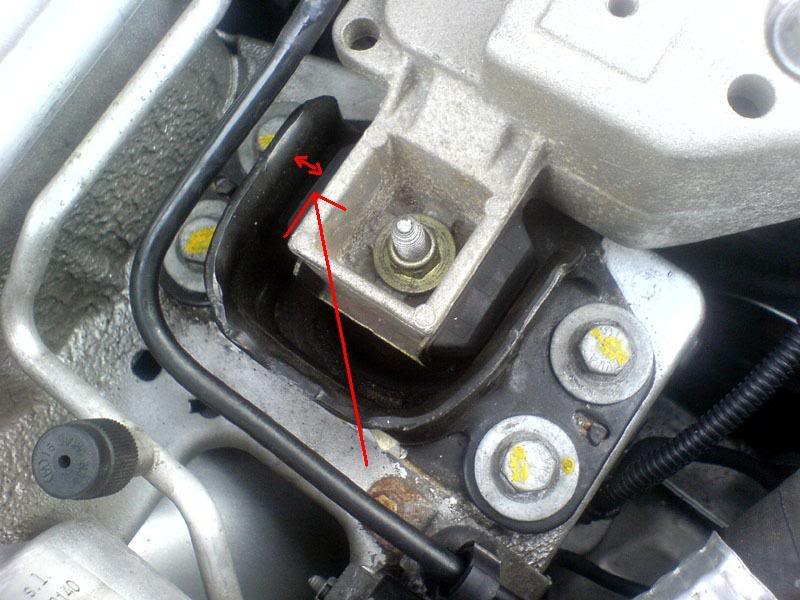

  Lots of Alfas
Fubar by the look of that they could move forward a little, loosen the bolts with the yellow marks and get someone to pull the engine with black part of the mount forward while you tighten them.
i tried that... all that happened is that the black frame moved forward and the engine went back to it original location, so it wasnt in the middle of the mount any more.
see the little pegs appearing through the hole in between the bolts?
well the stayed still and the frame on top of them moved... right or wrong? :S
  Lots of Alfas
Yeah thats right, hmmm the back rubber mount, in the pic it looks like only half of it is there. Is the rubber solid between the engine and the black mount? (see the pic)
the rubber is the same thickness as the front rubber. should that gap where the arrow is be closed up, as i can try and move the mount further forward again?
let me just check, by forward you mean towards the front of the car? lol
right that gap has now been closed up, i put more effort onto pulling the engine forward and the rubber is now against the black plate at the back.
can i just check, whats the purpose of that black "guard"? is it just there as a kind of bump stop for the engine mount, i cant see that it actually supports the engine at all!

  Scirocco GT 210
Does that mean you undid the four bolts and moved the black plate forward (towards front of car) in the direction shown with by my dodgy red arrow?
Because my ph1 was making the exact same noise your car did in your 0-60 video. This cured it. In your picture, that mount deffo needs pulling forward, it's sitting all the way back.
But it sounds like (from your quote) you've fixed it already. :approve:
yep, thats what i did.
ive got a pic of how it looks now... i'll get it up here as soon as i find my blootooth dongle :)

this is how it looks now.
as you can see from this pic, this is as far forward as the mount can possibly go (unless i remove that little metal tab)!

  Lots of Alfas
That still doesnt look right to me, Im sure there shouldnt be a gap, its as if your black holder has streched.
Gaz_
  Extreme mode
there is a gap all round (standard), but to stop the knocking mine is set up like above
