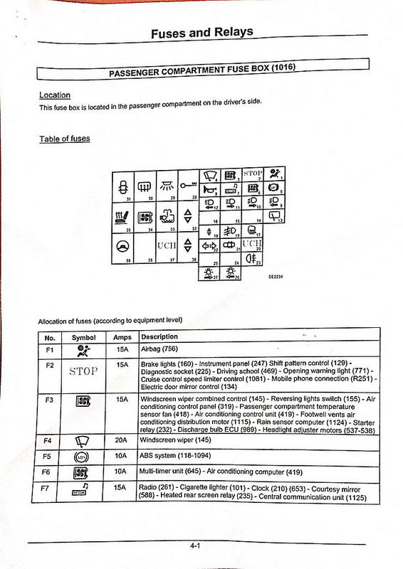

Have a Clio 182. The cigarette lighter/12V by the ash tray is not providing power when I plug chargers etc. (Have tried multiple and tested them on other cars) into it. Initially hoped it was the fuse but have been told the radio and map light run off the same fuse, which are all working fine. So is the light in the ashtray and the orange light cigarette lighter.

If it does im happy to enlightened on which one it is! Maybe what I was reading was for the non Renault Sport Clios?
Actually you're right, it's the same fuse as the stereo. Fuse F7
