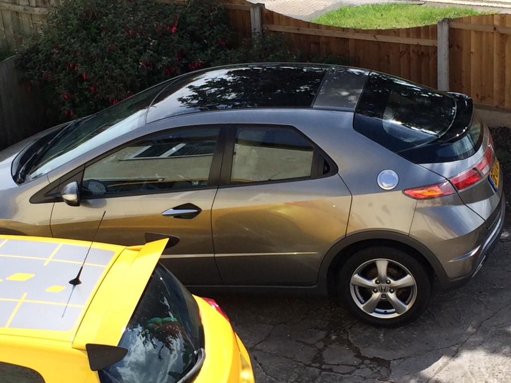

Girlfriends dirty Civic, the Clio still has Desire on.

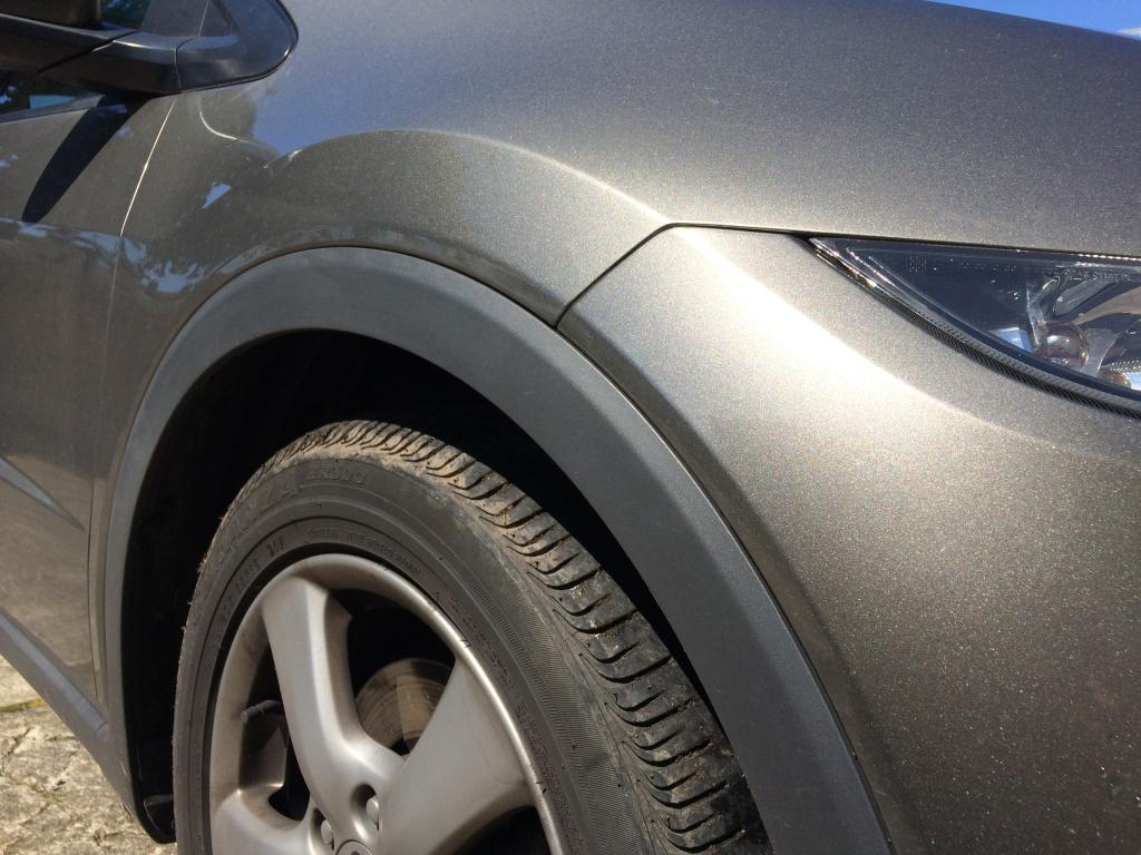

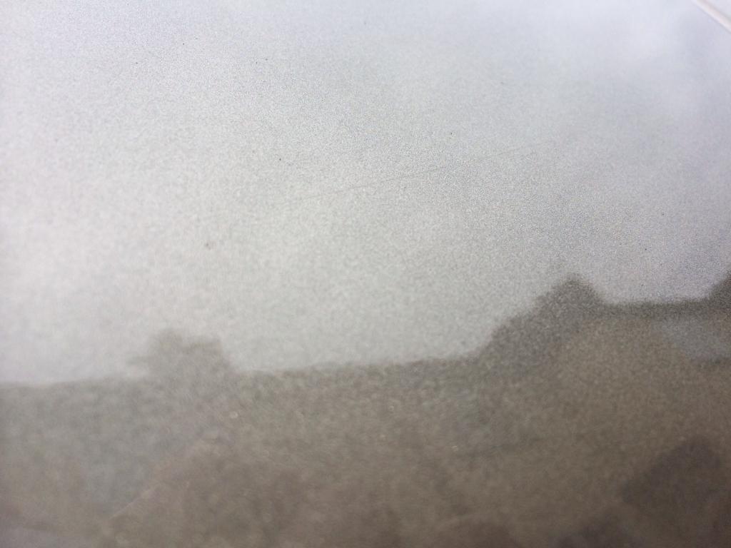

This scratch was the focus of my cleaning venture, I really wanted to try my 4.52 DA on it.

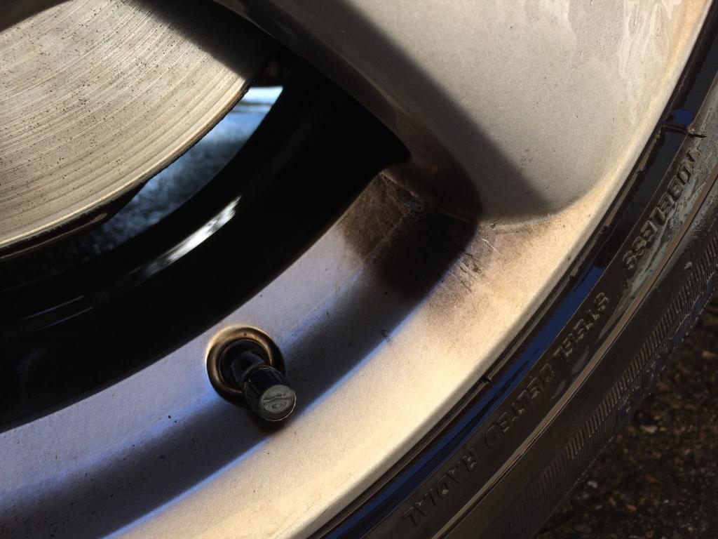

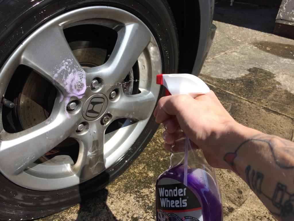

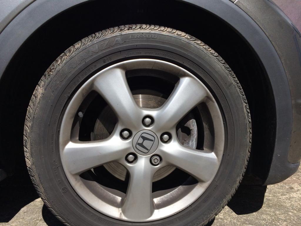

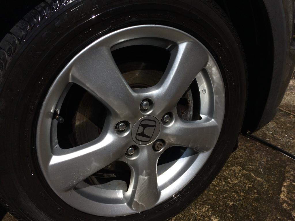

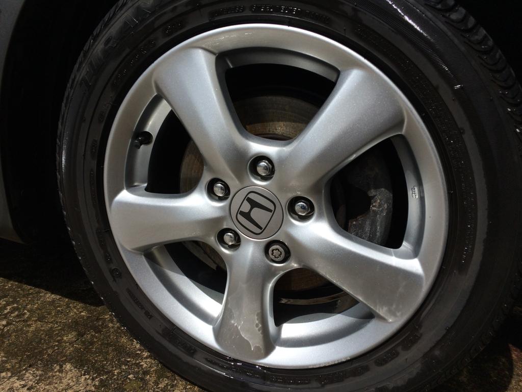

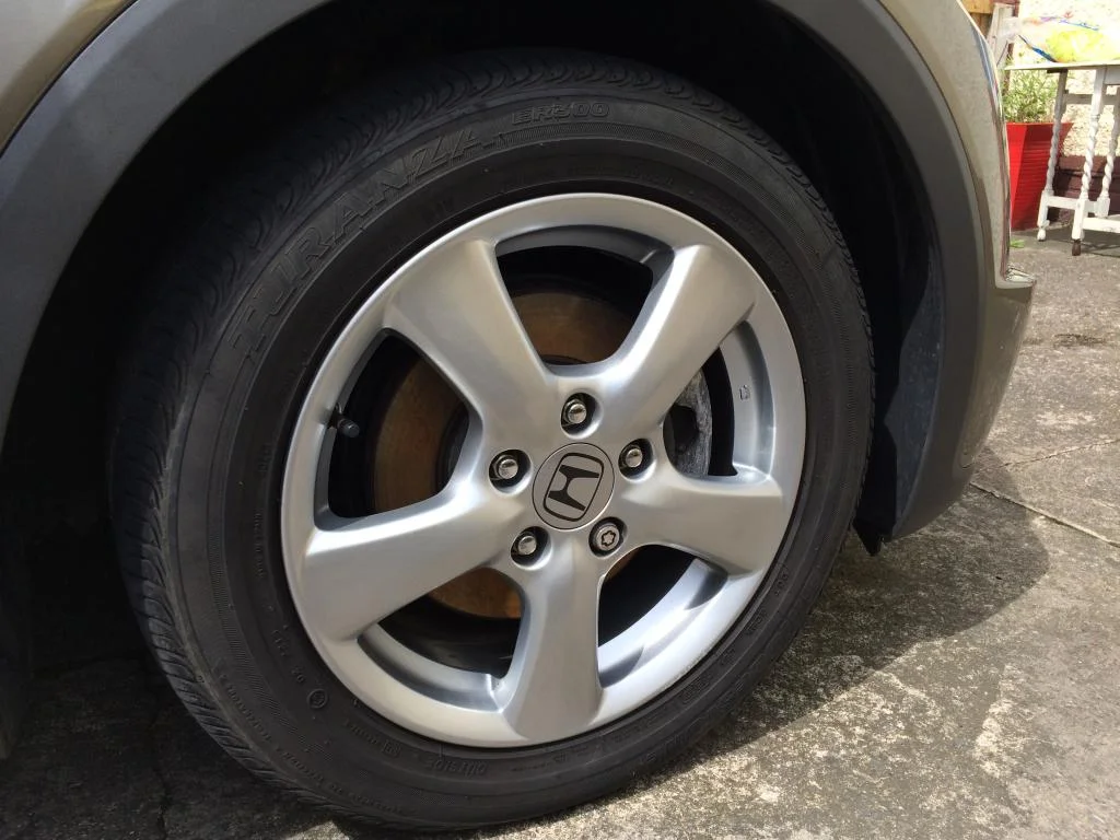

Wonder Wheels Hot Wheels on the wheels
Agitated
And rinsed

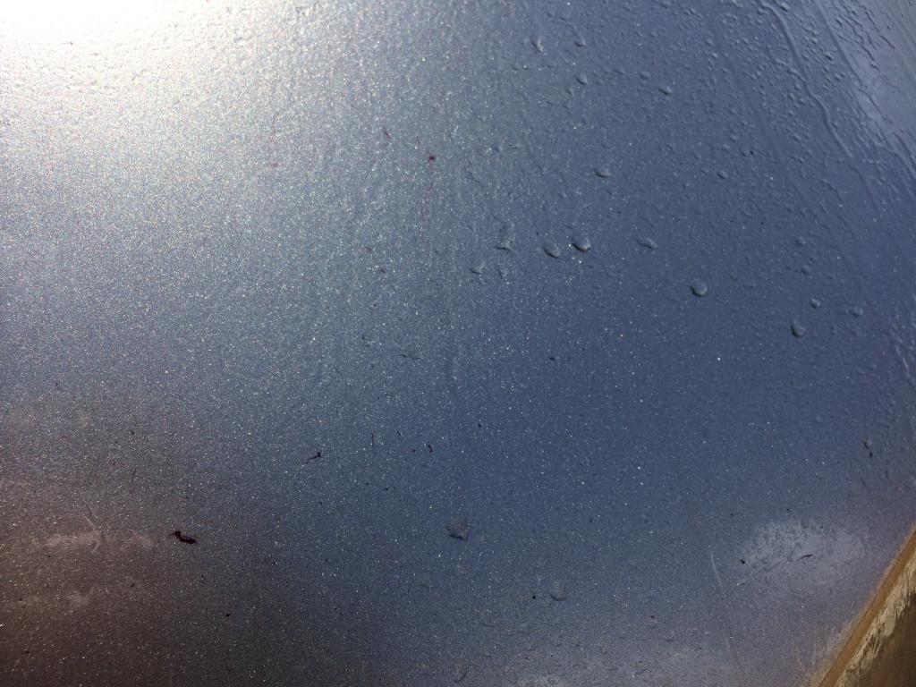

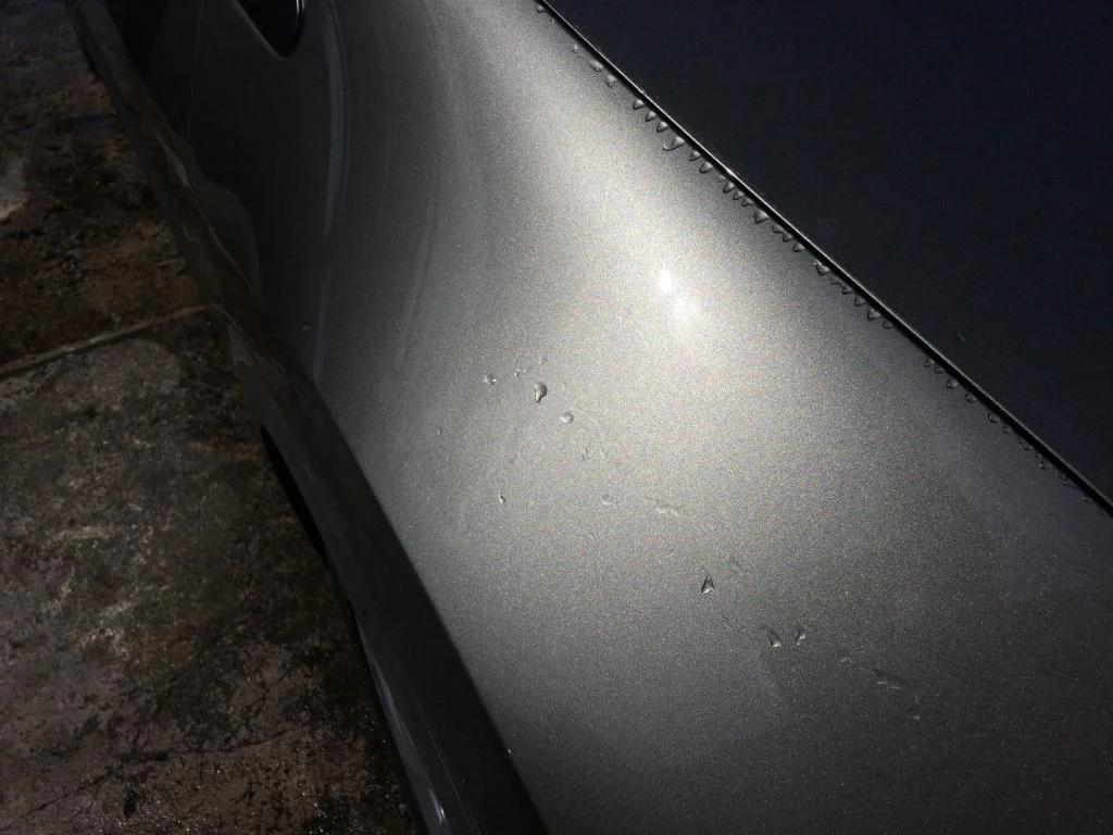

People would be happy with this finish, but I knew they weren't clean yet :o
Still a nice colour/finish/gloss though, putting that down to Tough Coat

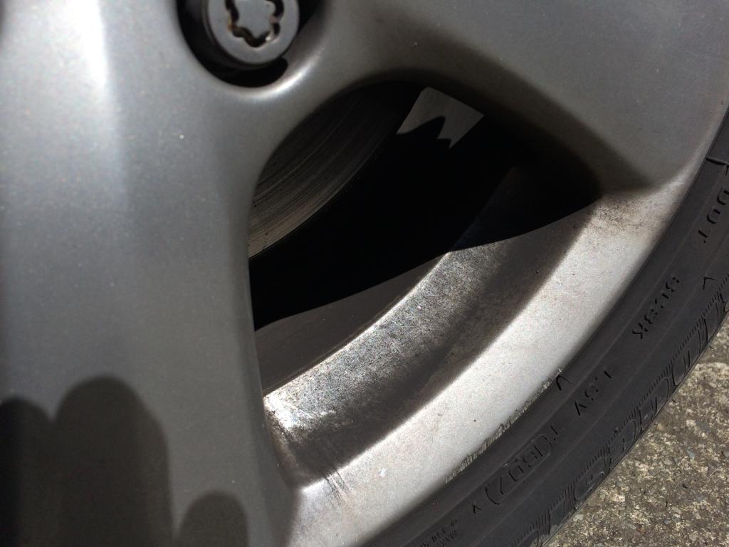

Next up, Tardis... but there wasn't much tar on the paint, surprisingly. The wheels needed a few spots agitating though, but no pics.

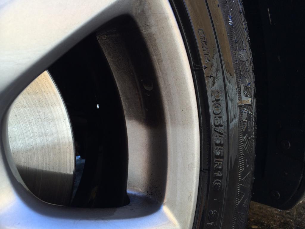

Then new Lemon Scent Iron X. Strong, strong recommendation from me on this one.
The smell is more than bearable, the lingering smell is reminiscent of spiced lemons. Nowhere near as distressing as Cherry Iron X
I was surprised at the lack of fallout considering the amount of action this car sees.
Pressure washed off to leave a decent finish

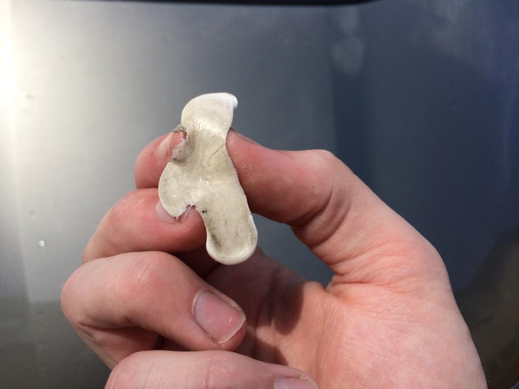

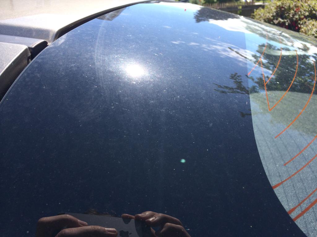

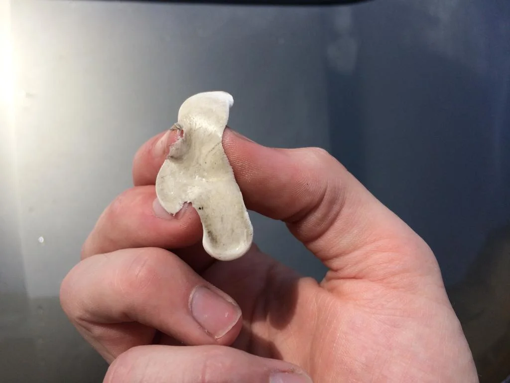

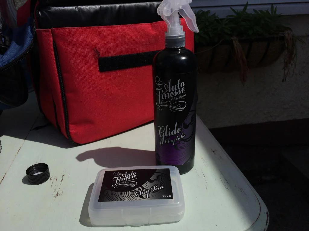

I didn't think there was much contamination left on the car, but I gave it a clay anyway.
Did the bonnet which left
Since this was the first time I used my Auto Finesse Clay, I wasn't sure if it was just really soft or if there actually was that clean... So I went over it with the last of my turtle wax clay which I know picks up a lot and it came off immaculate... Strangely clean car.

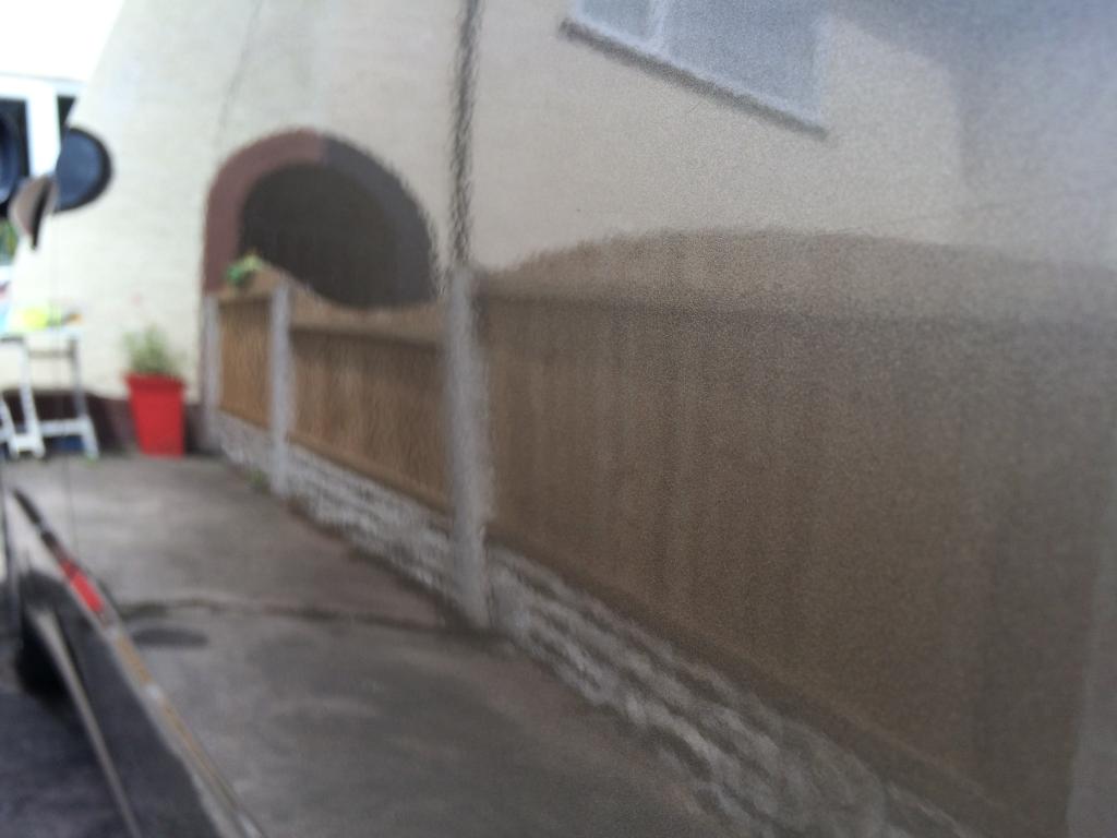

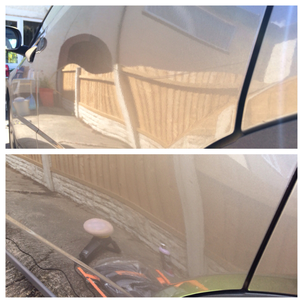

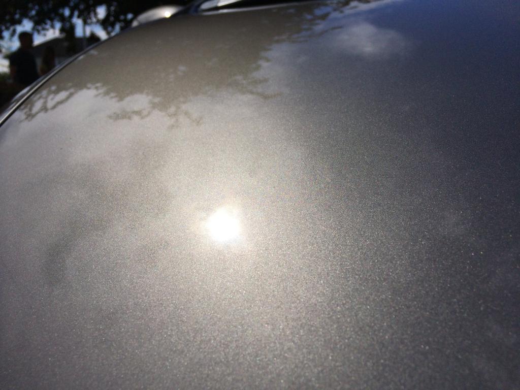

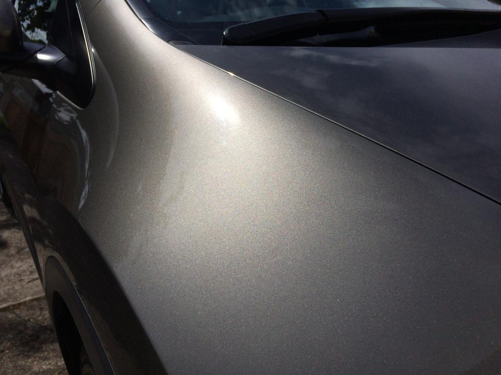

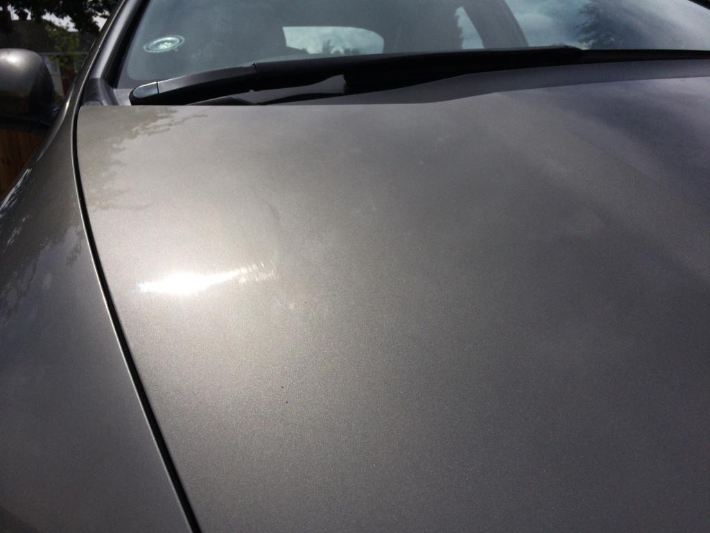

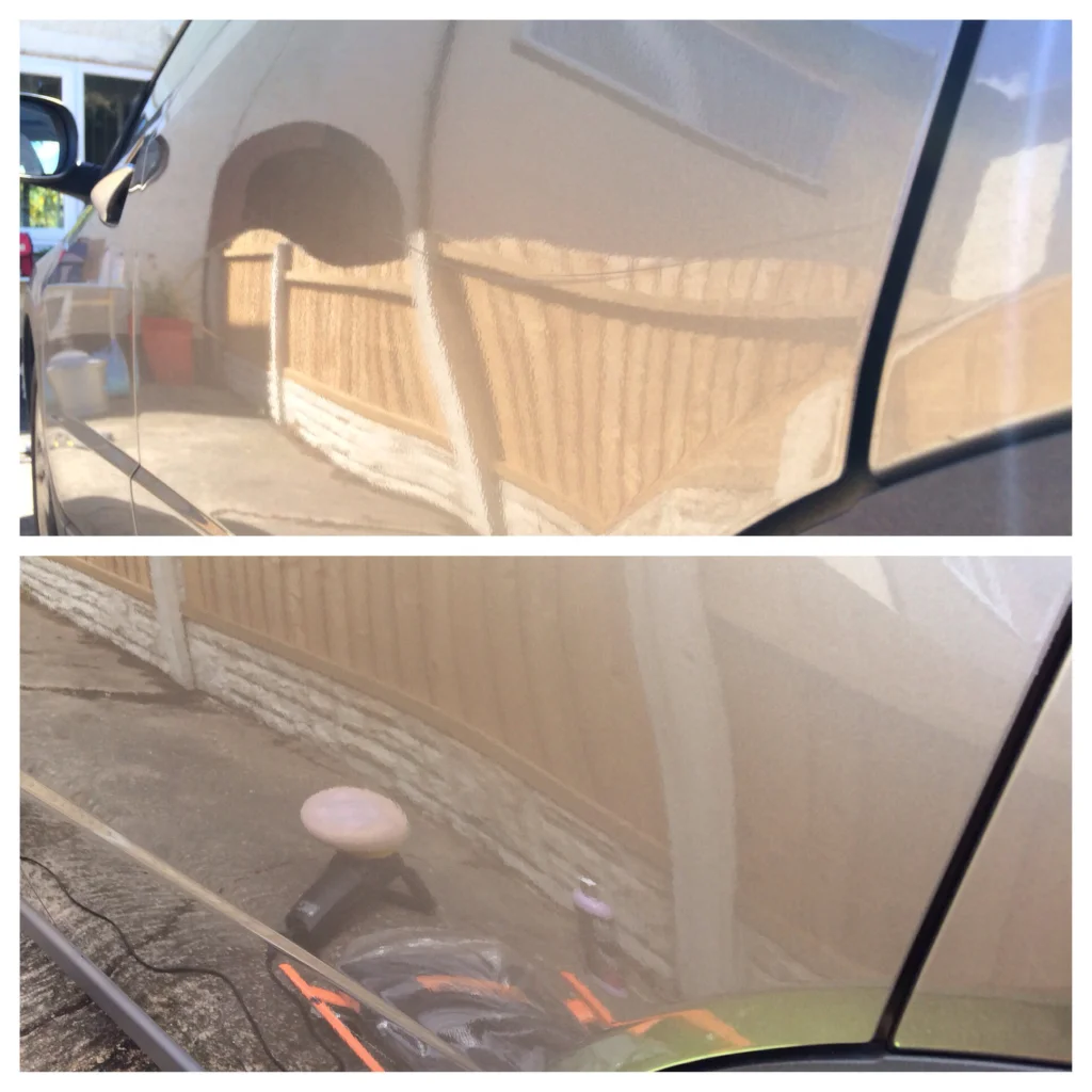

The car had minor swirling which I wanted to test Tripple against Via Dual Action Polisher.

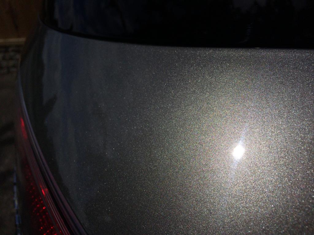

It took a few attempts but I managed to get a decent correction with just Tripple. Some of the deeper marks and swirls are still present but for now, I'm happy with this.

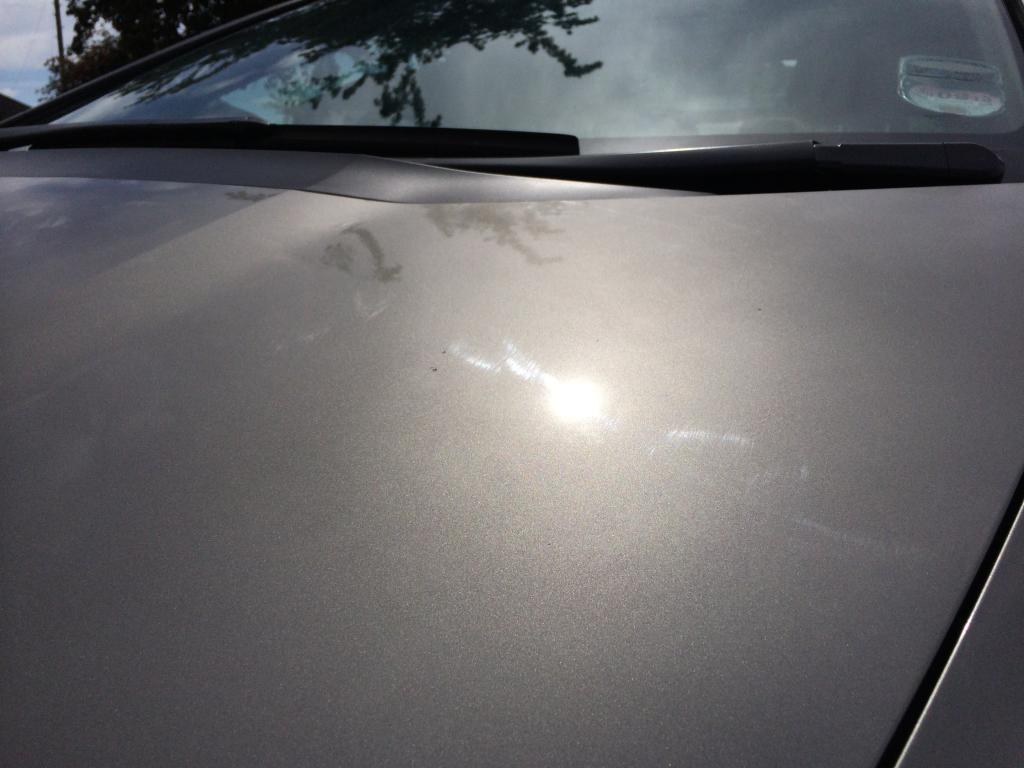

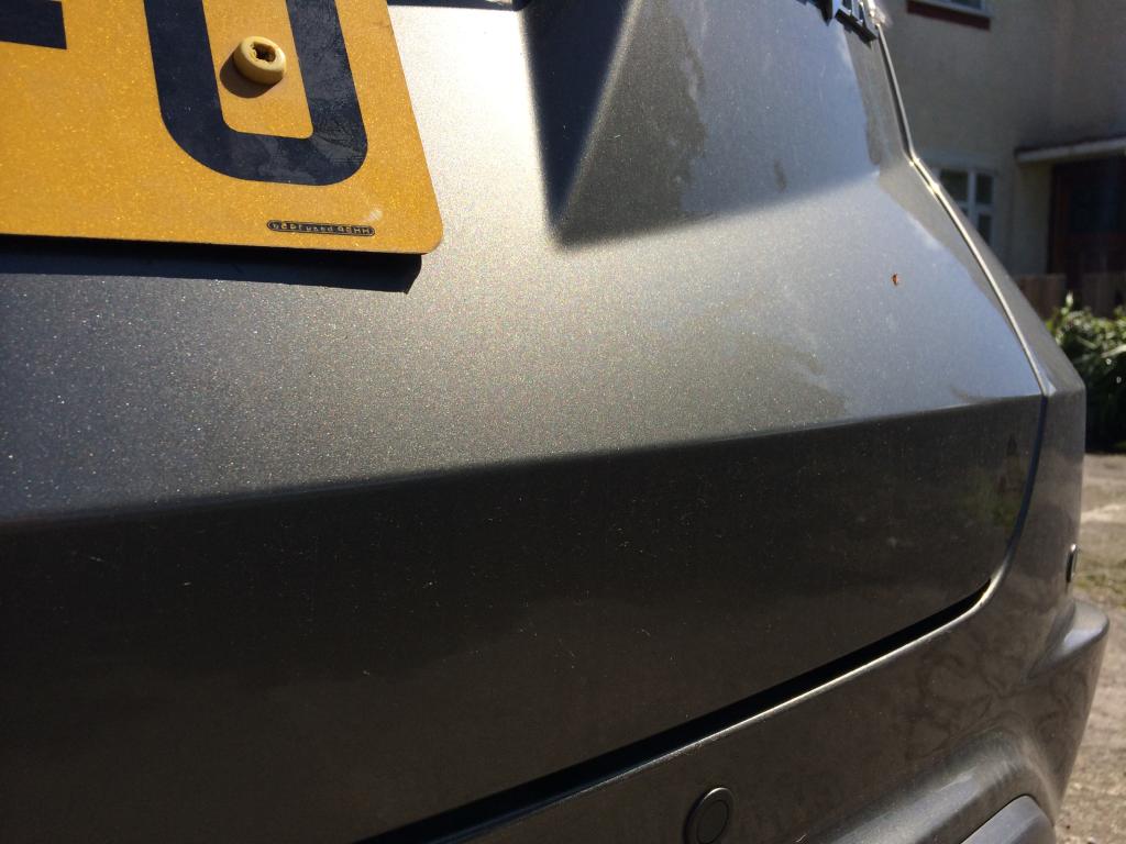

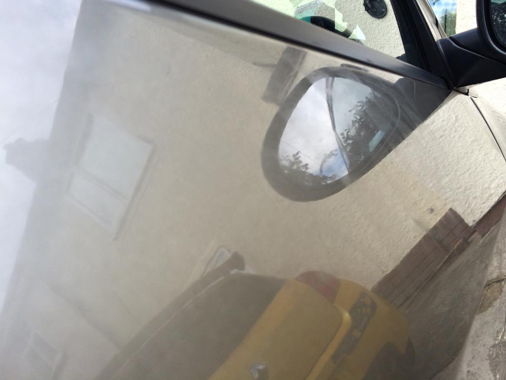

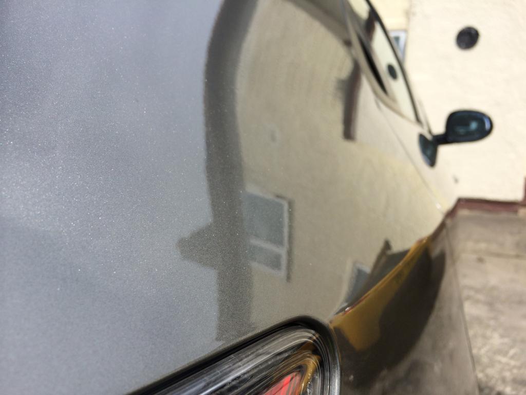

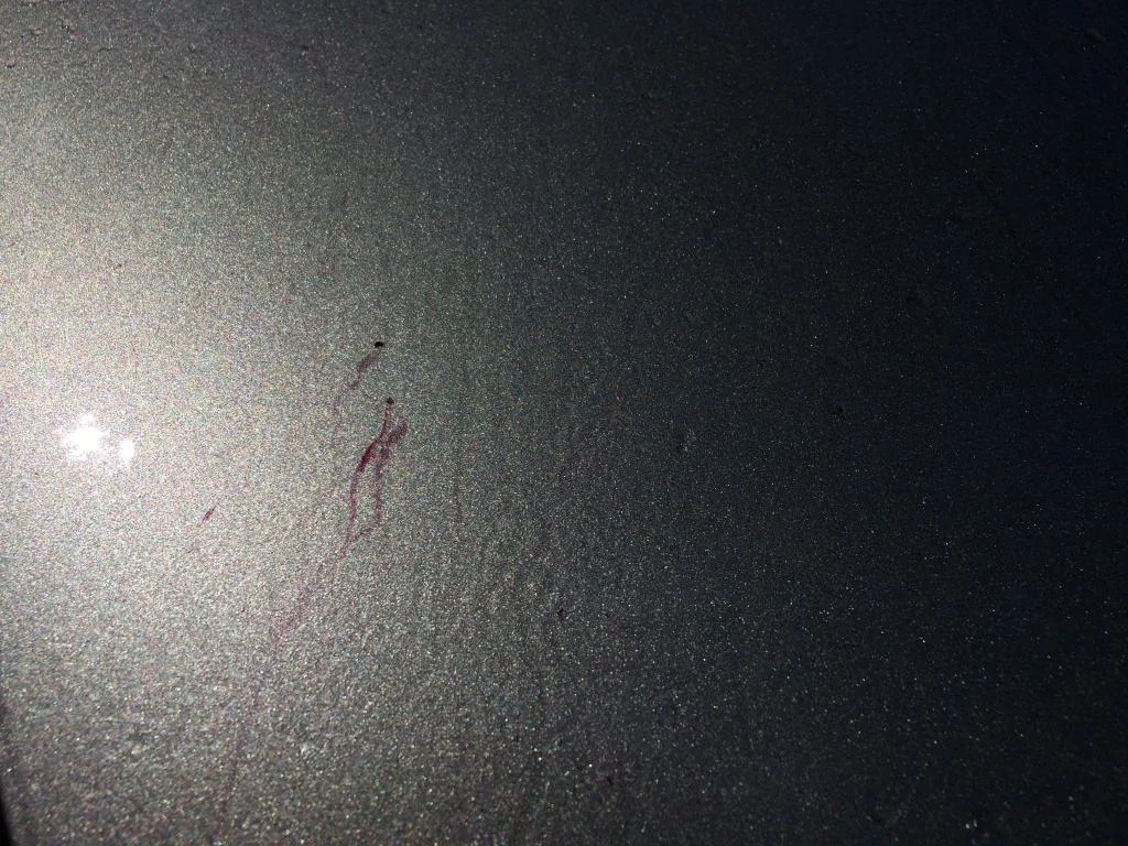

And onto the scuff.
Very content with this.

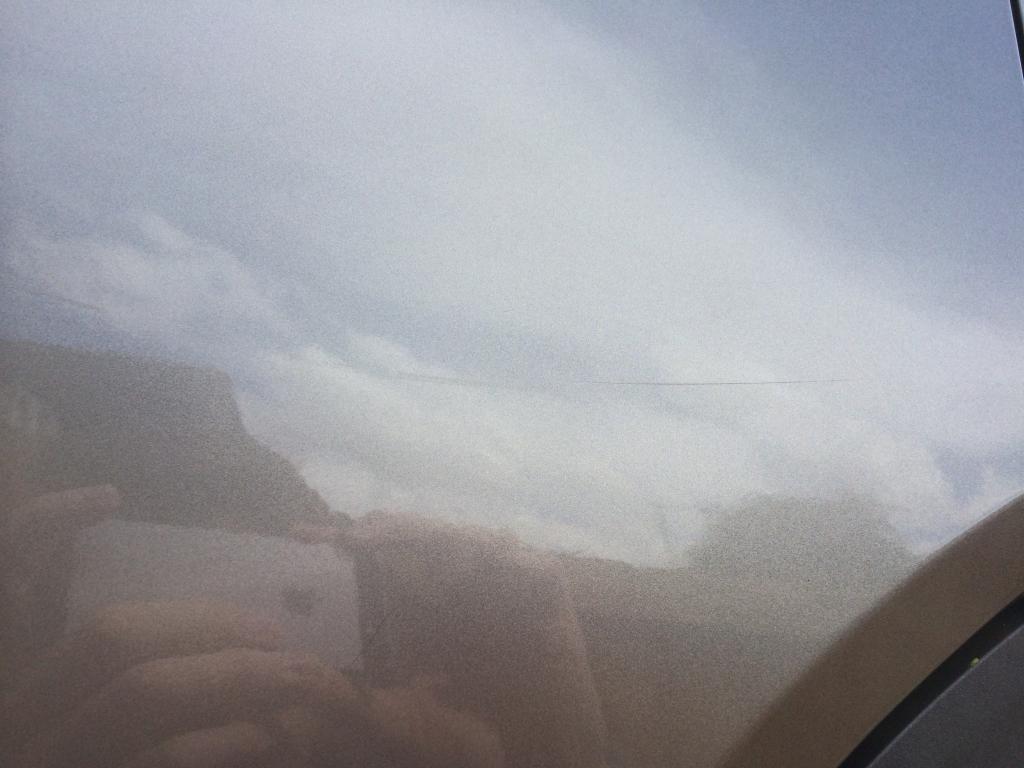

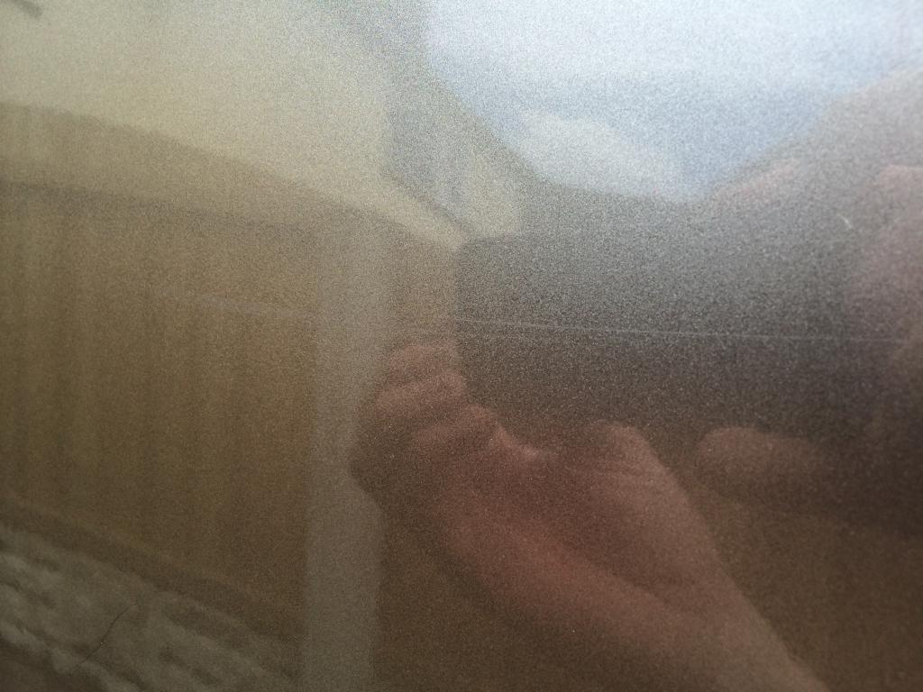

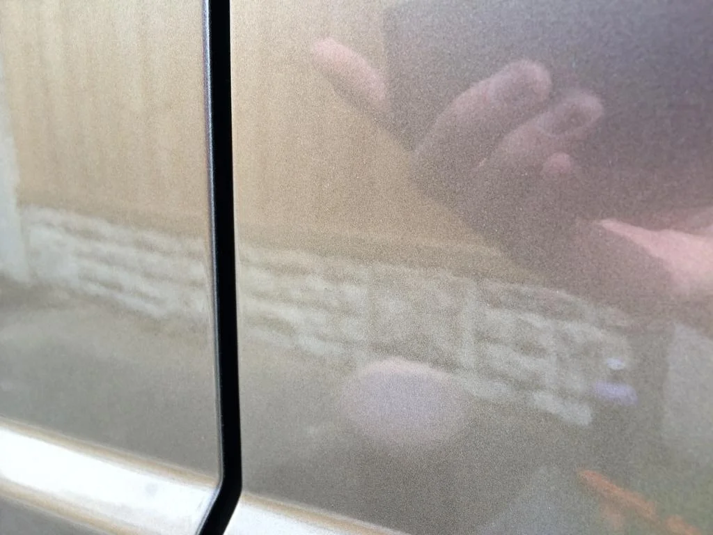

I struggled to capture it properly, but the Tripple really brought out the depth and flake in the paint. Right side Trippled, Left side not.

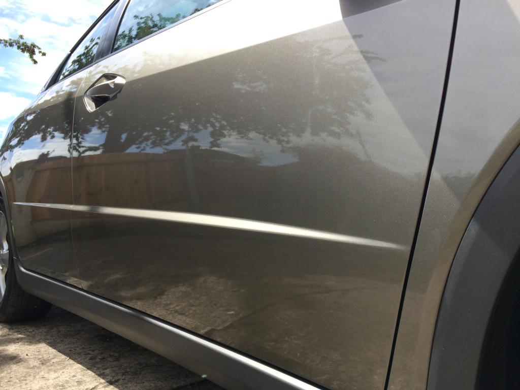

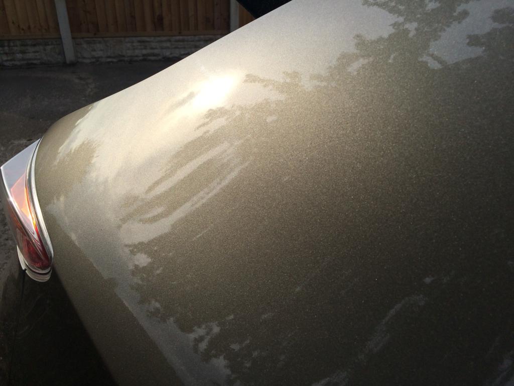

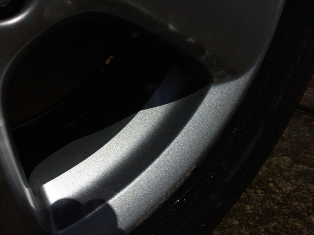

Smells better than Desire IMO, very, very oily, spreads ridiculously well and its silly easy to remove.

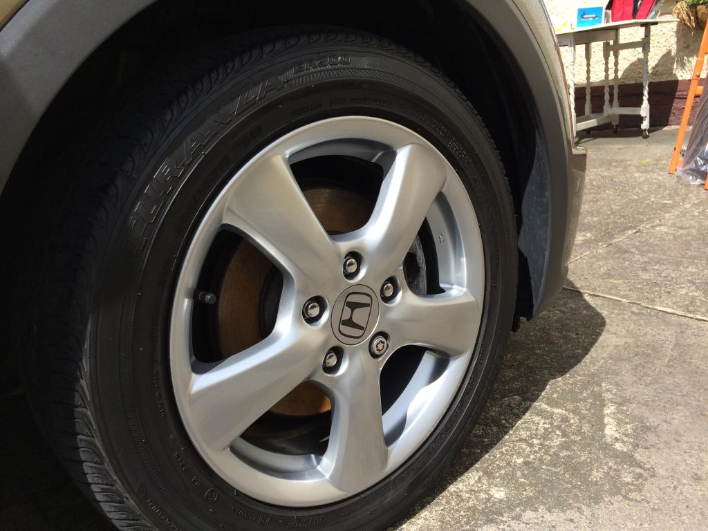

I did the whole car before buffing a corner of the first panel. It came off very easily. So I did the tyres in Auto Finesse Gloss
Ignore the filter on these, I knocked it on by accident.
It leaves a very nice, damp/natural finish but I found it very watery for a gel, could do with being a fair bit thicker IMO.

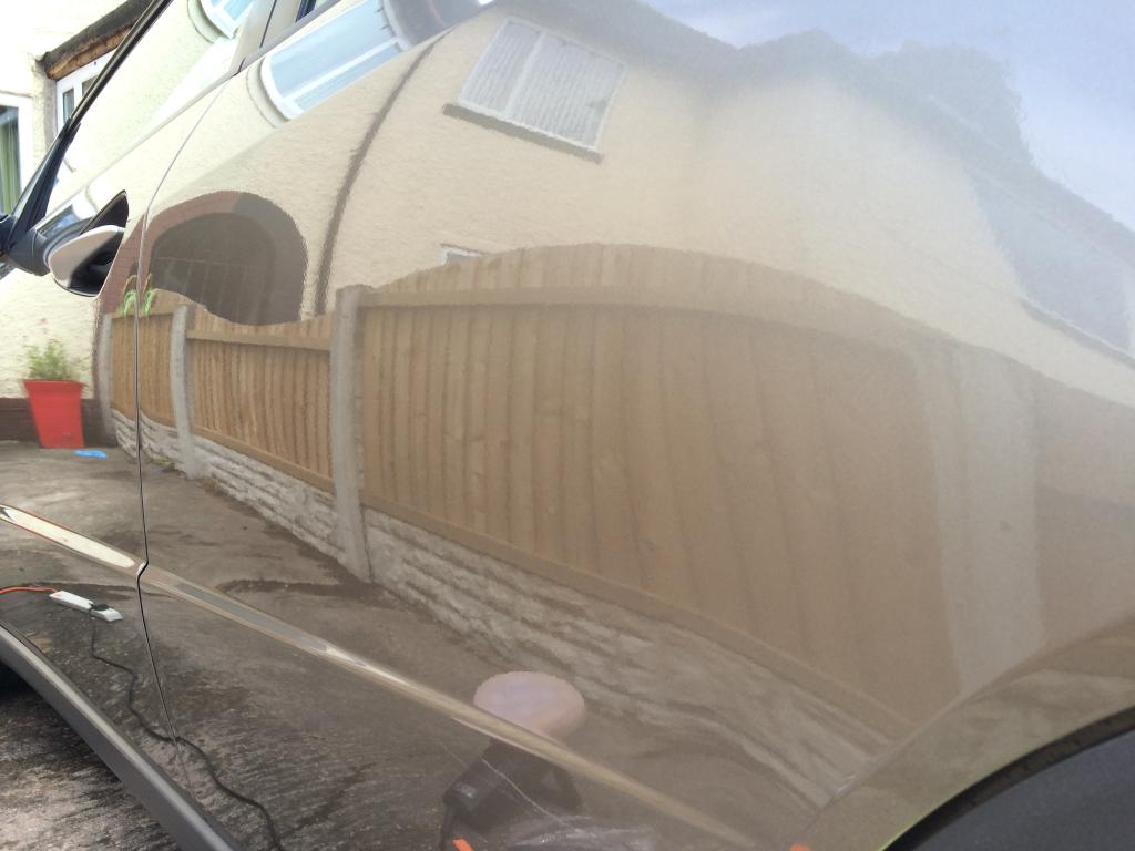

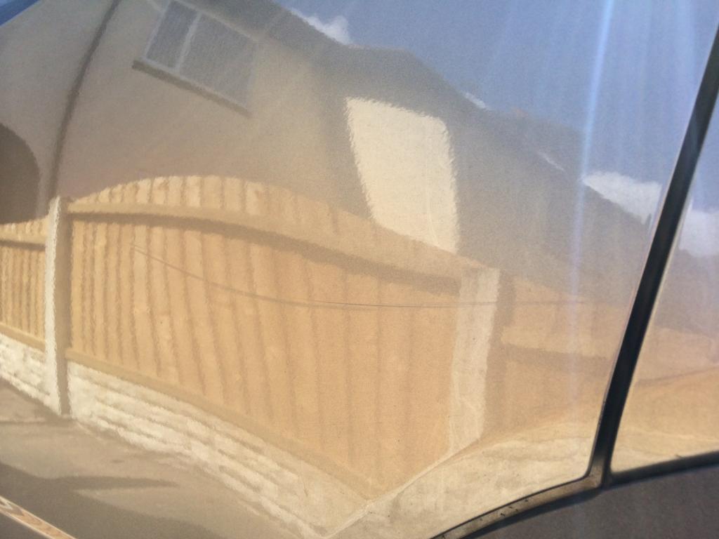

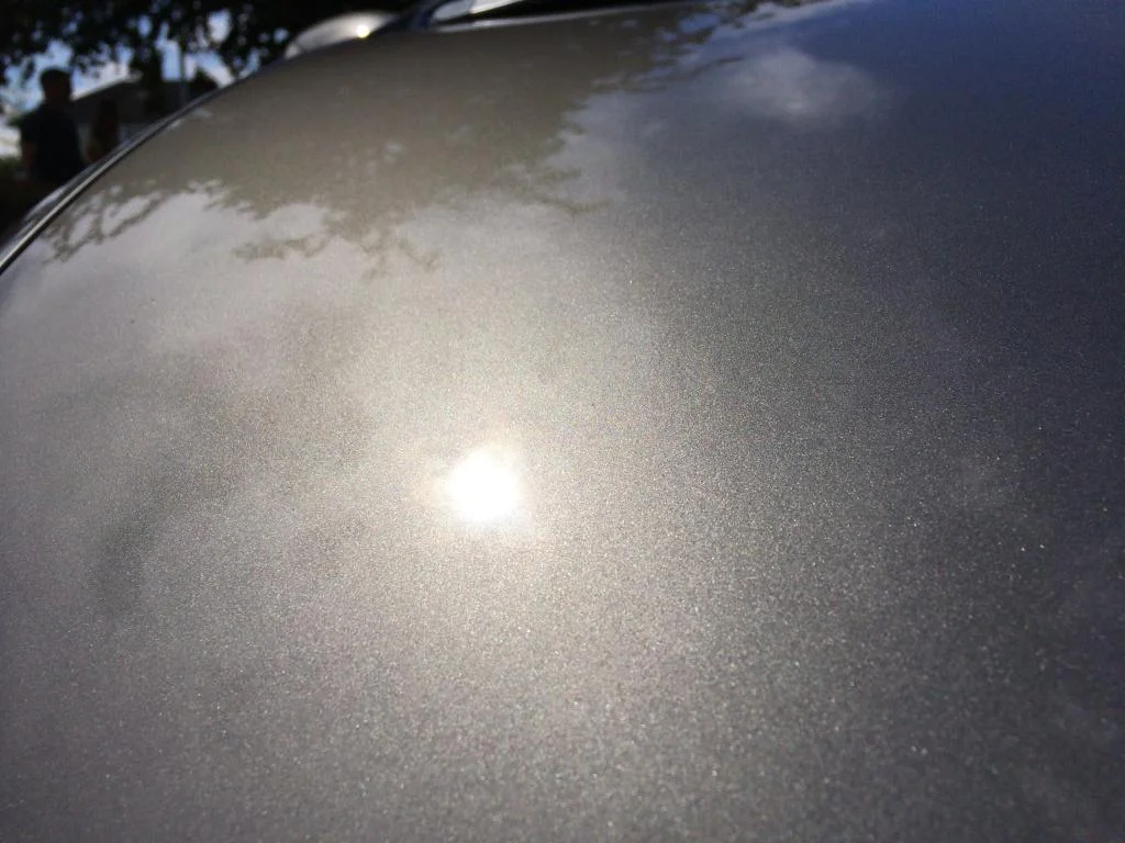

After this, I buffed off Illusion... I wanted to see how easy it came off after a bit of reading on here. I feel I really took the piss, caked it on in places, left it for a good 20/30 mins (in the sun) and it was only a little grabby on removal in places.

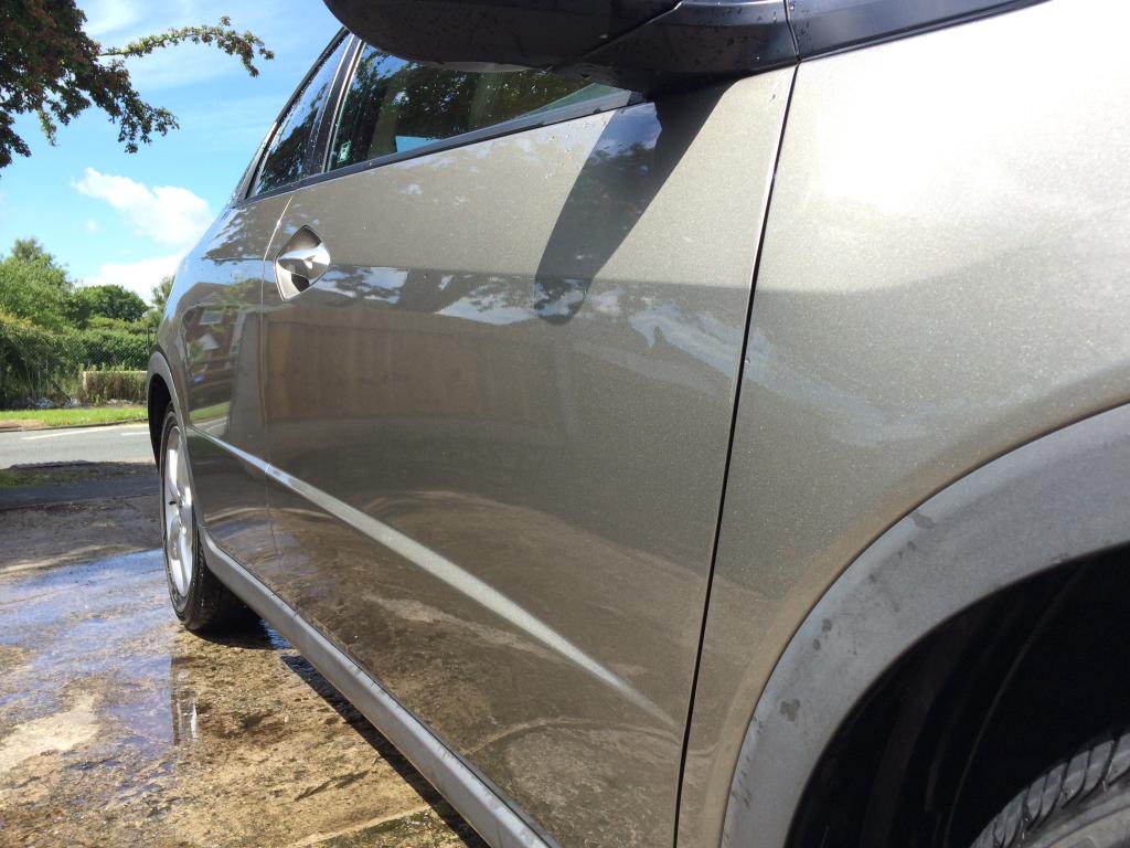

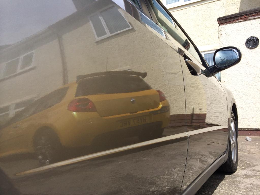

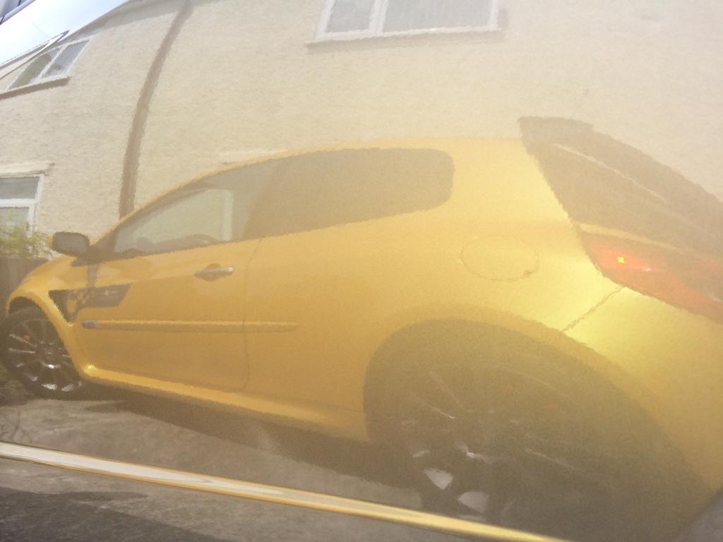

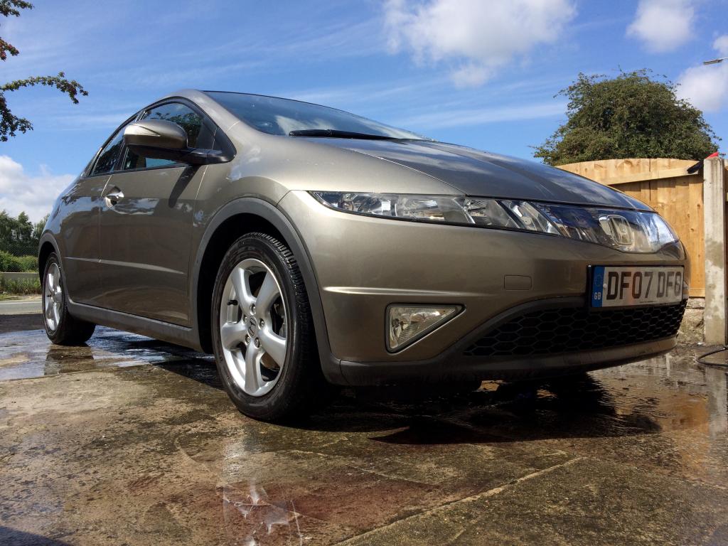

some before and afters

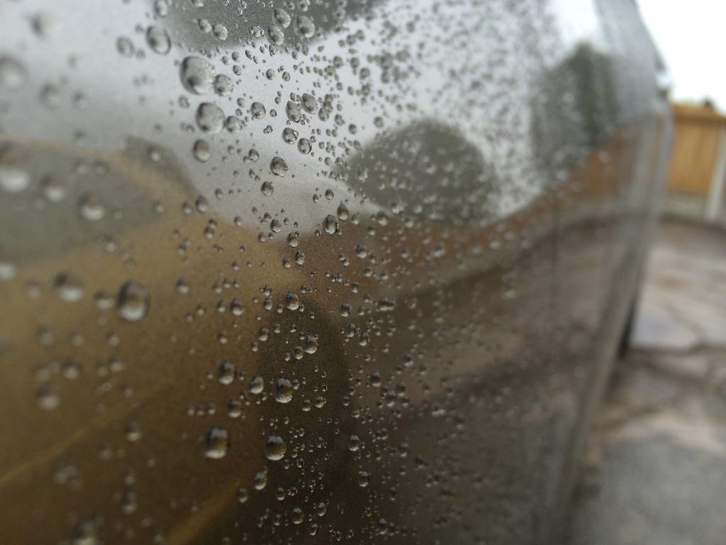

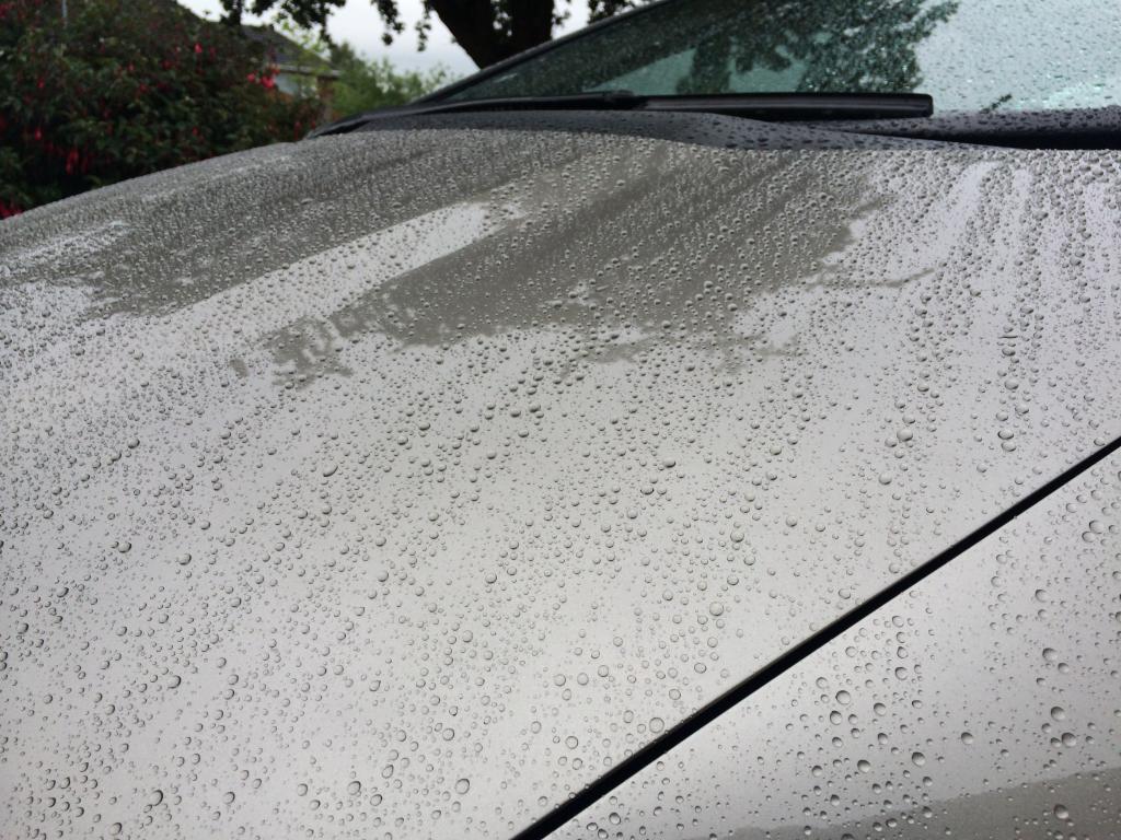

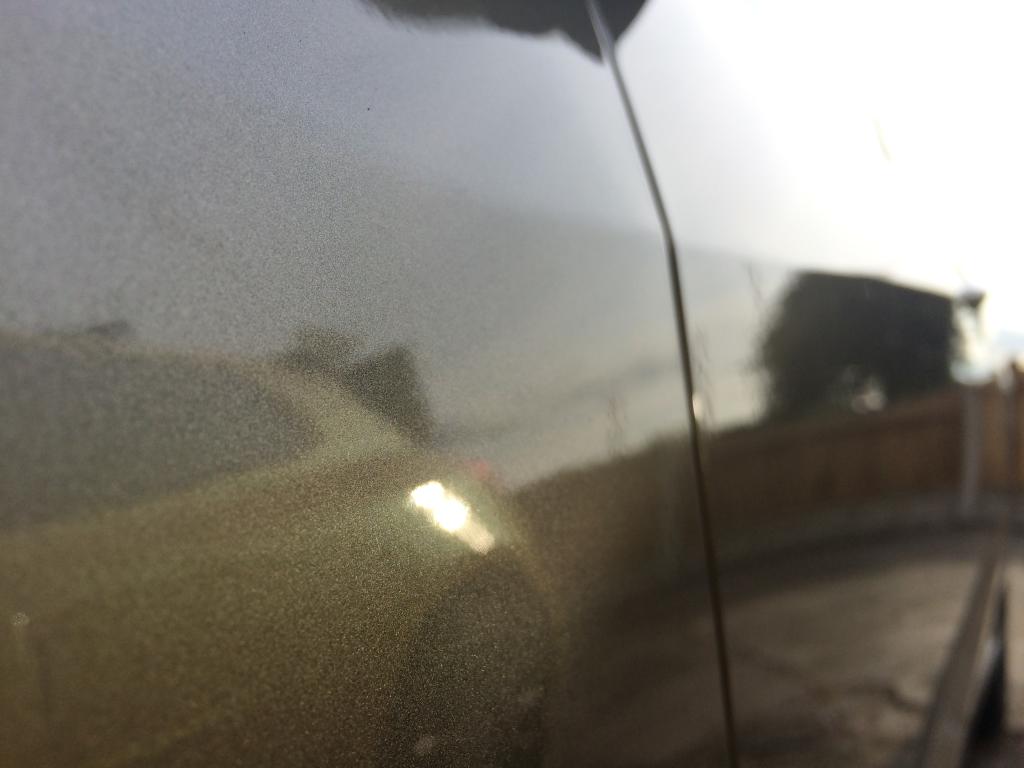

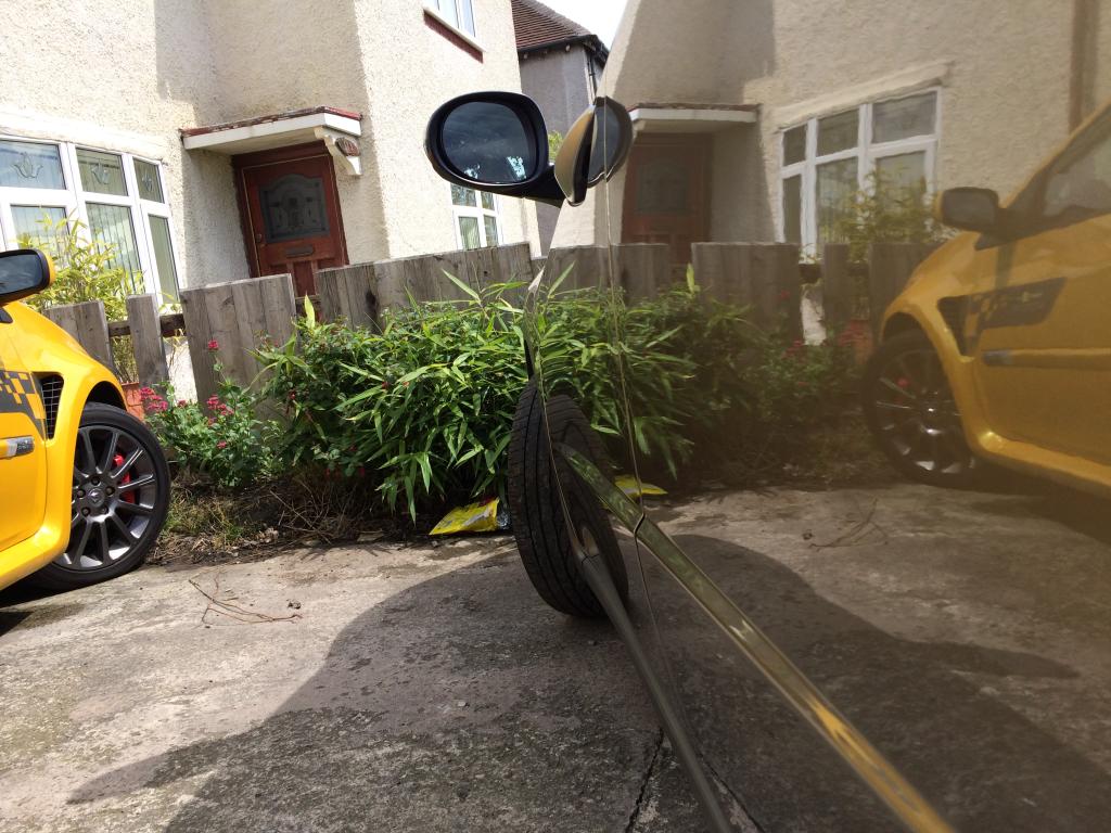

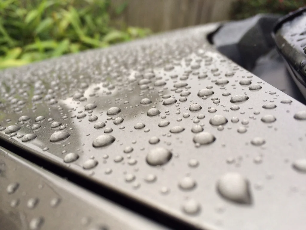

and some beading
I just really like this one.

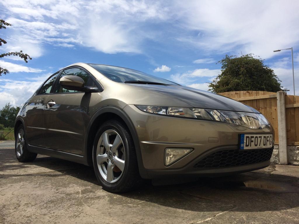

In summary
Very easy to use, apply and remove, smells awesome and leaves an incredible finish. Very deep and glossy. Apparently it gives 2/3 month protection which, if true, is amazing. I expected a month tops from a pure show wax, hopefully it lasts the test of time.

great fill/correction by da, did you use a finishing pad? If so which brand?

The tripple actually cut it all out, which I was surprised about tbh.
I used a meguiars w9006 (iirc) soft buff finishing pad as I need to buy more pads and Honda paint is silly soft.

Lovely work Scott, how did you check for any filling from Tripple?
Cheers, I didn't :o didn't have time to wipe it back and as I wasn't going for/expecting much correction, I was happy with it.
Would a watered down IPA be sufficient to remove any fillers in the future?

But you said the Tripple cut it all out? How would you know?
IPA on it's own is what most use. I use Spies Hecker panel wipe. Similar idea but better.
Oh, sorry, I was talking about the swirls.
The scuff, I couldn't see or feel it any more and I doubt the fillers which are meant to mask swirls would be sufficient to fill the scuff. ill double check nex time I clean it though.
Are they a trade only product or are they available for the public to buy?
@gally, the tripple didn't cut it all out. But it cut it/rounded off the edges so you can only see it from a couple of angles. It was a right pain to photograph
Still, I'm more than happy with it as you would t know if was there if you weren't looking
