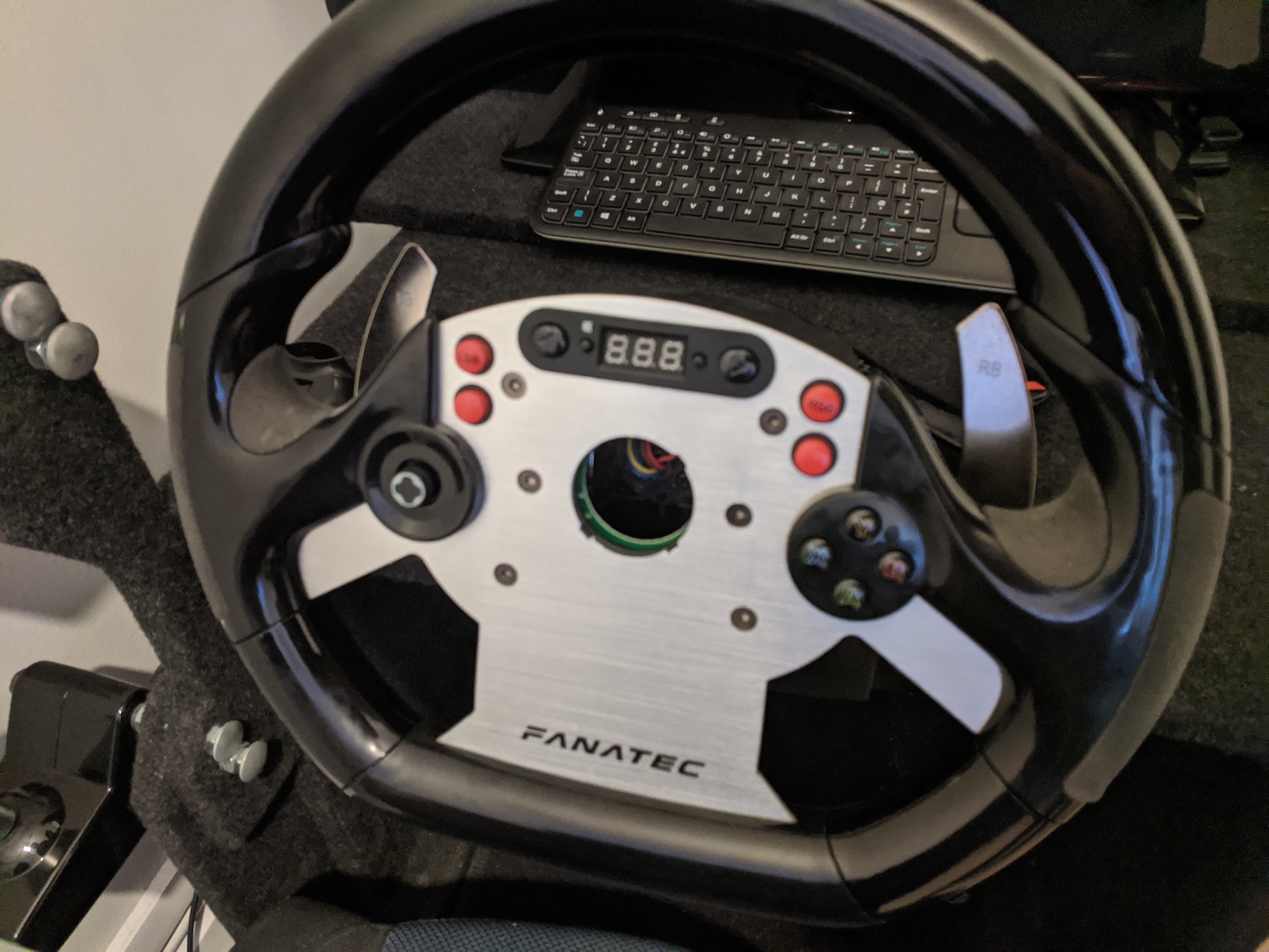

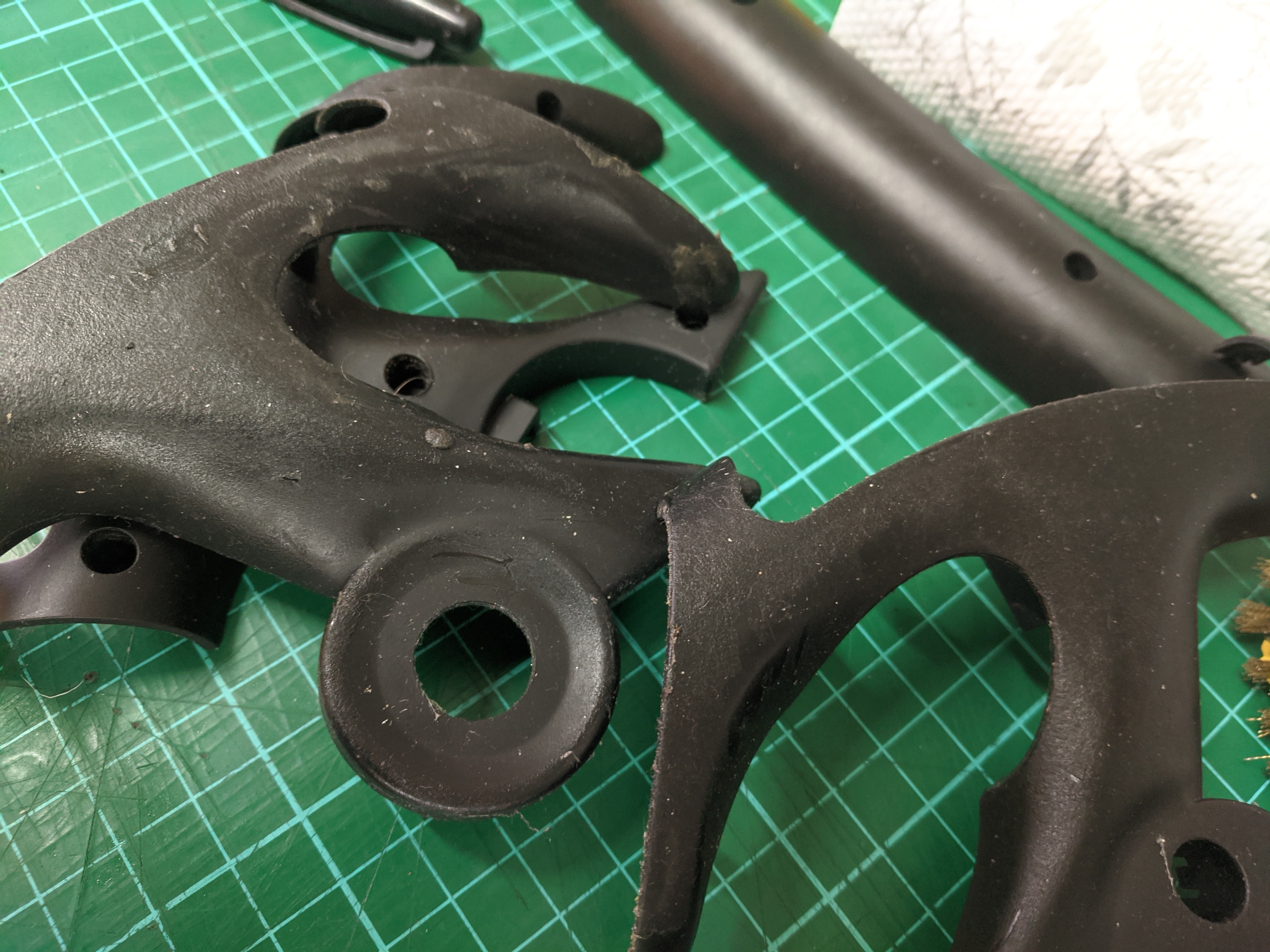

Just stripped down an old Fanatec steering wheel cos the silicone coating stuff has failed (it's about 10 years old, not sure if its just age or if it got hit by some Mr Sheen and that's done it?!).
Have tried some diluted alcohol but will hit it harder this time. :unsure:
