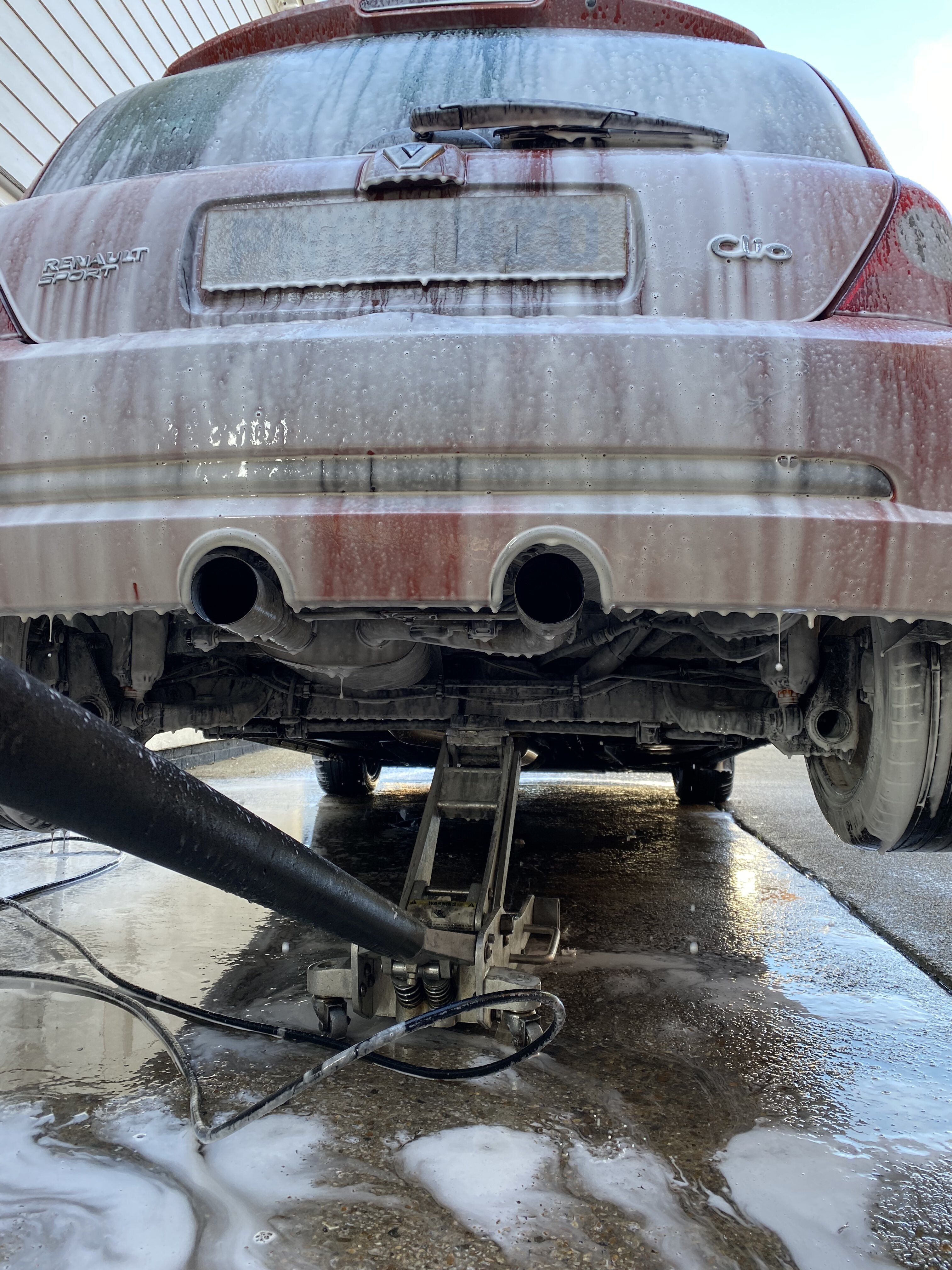

My cars my daily driver so does about 250-300miles a week in all weathers Inc all this salty shite. I clean the car once/twice a week time dependant and use one of the eBay specials for the underside. Put the rear up on a Jack and snow lance underneath and a wash down.
it’s not a thorough job as I’d like but goes some way to preserving what I have left. Lol.

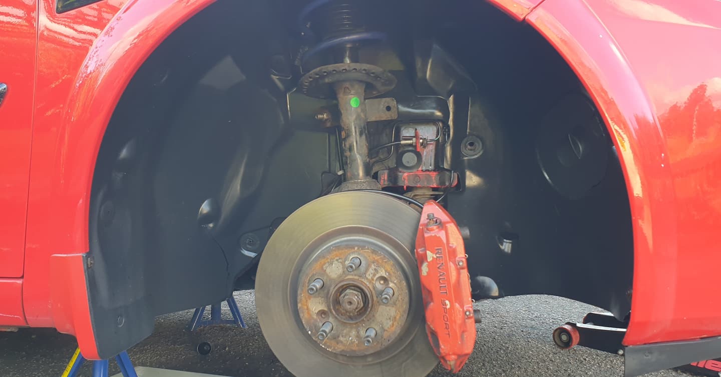

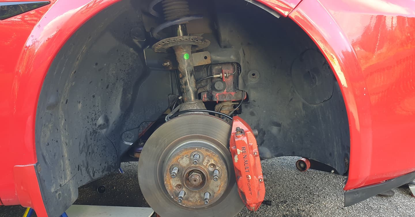

I spray it on my brakes/wheels prior to jet washing. Disperses water and leaves a nice thin coating. No more rusty discs after a wash.
Picture below is from the rear discs off my RB resto which had new discs and pads in October. It’s sat outside my garage since then while I do the front end. As you can see, no rust. I spray it underneath my BG which is an all season car. It’s magic stuff.
