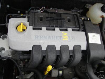

2004 will have a differnt throttle body setup, external type, your throttle body is internal.

Your throttle body is inside the inlet manifold, the newer very late 04 onward are bolted to the side of the inlet manifold. Wiring will be differnt, also injection computer was relocated behind the battery unlike yours which is bolted to the back of the engine.

Heres your one
2004 onward engine

It would fit, but it wouldn't be a straight job of taking one out and plugging the new one in.
