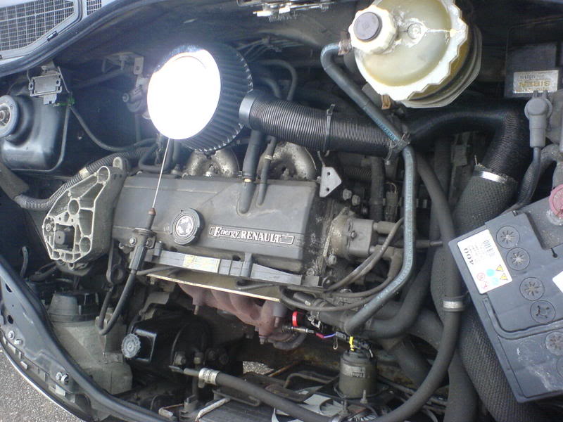

As nobody else has replied, this is a 1.4 mk1. but you get the idea.

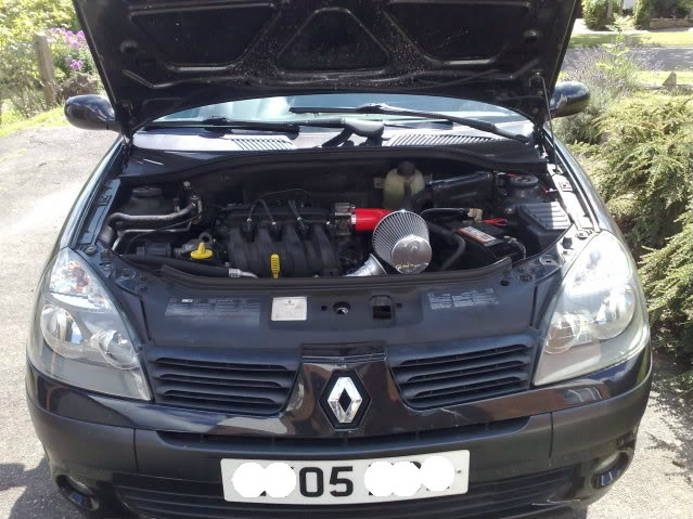

wouldnt bother, have seen a significant change in torque loss since i fitted it, looking to get my old box back on me thinks, heres how it looks anywho; hill power 1.2 specific

On a 1.2 16v the longer the cold feed or inlet pipe to the induction kit the bigger the loss of torque. Im talking about the K-tec, vipers w/cold air feed and the hill power as pictured above the 1.2 16v's inlet length is already five miles long as it is.
The only reason you should buy one is for noise

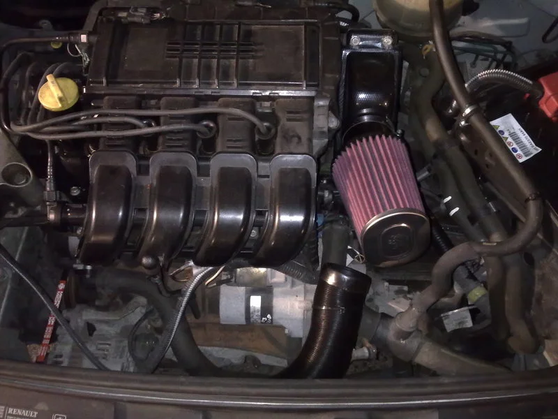

Thats my induction kit. Lot of people telling me that is s**t!, This filter taking hot from engine... paramiters are going down... torque and acceleration.. but Vmax go up:D My idea is put some thermal cover and add another pipe for cold air intake.
