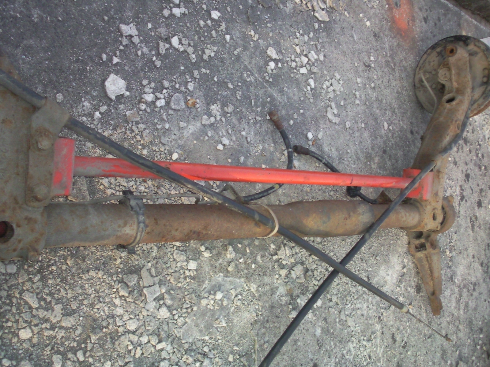

*Swap the rear suspension from the Original Clio 1.4 CUP

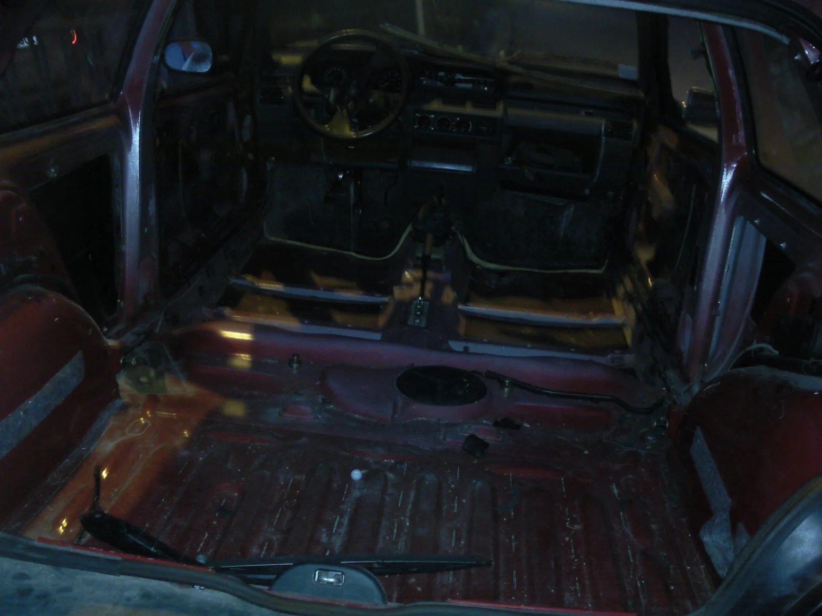

*Stripped interiour:

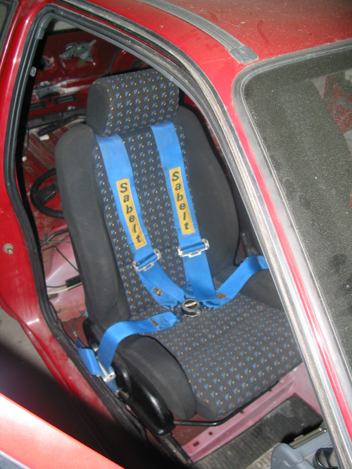

I also got a racing seat and harness that still need to go into the car:
Test fitted one harnes to my 16v seat:

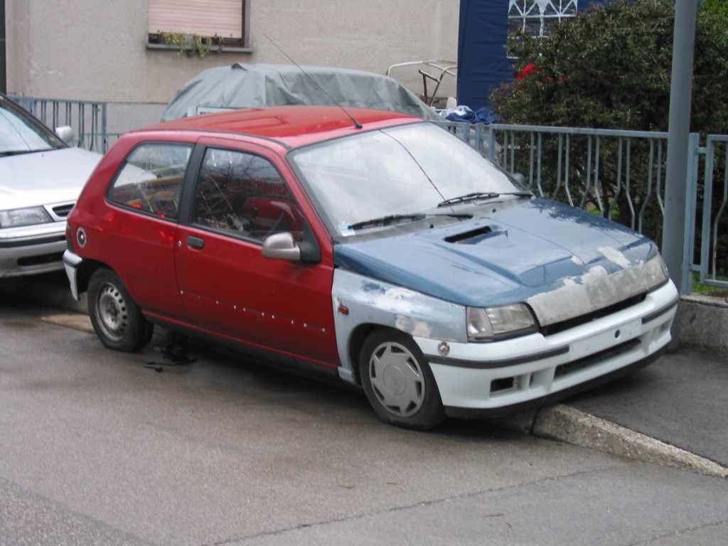

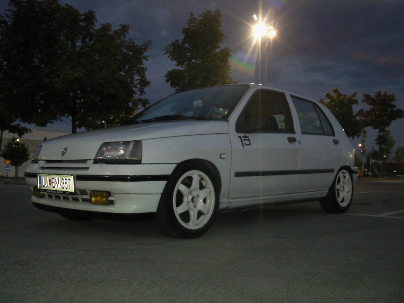

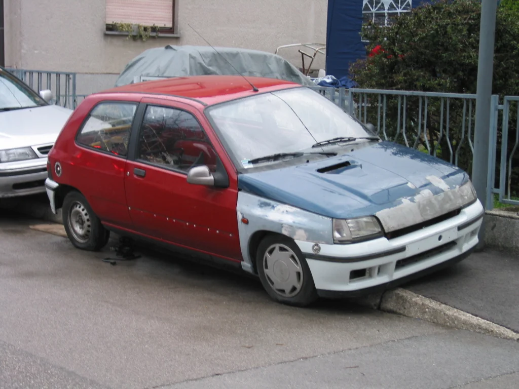

Oh and i forgot to put up a photo of my daily car and donor of some parts :D

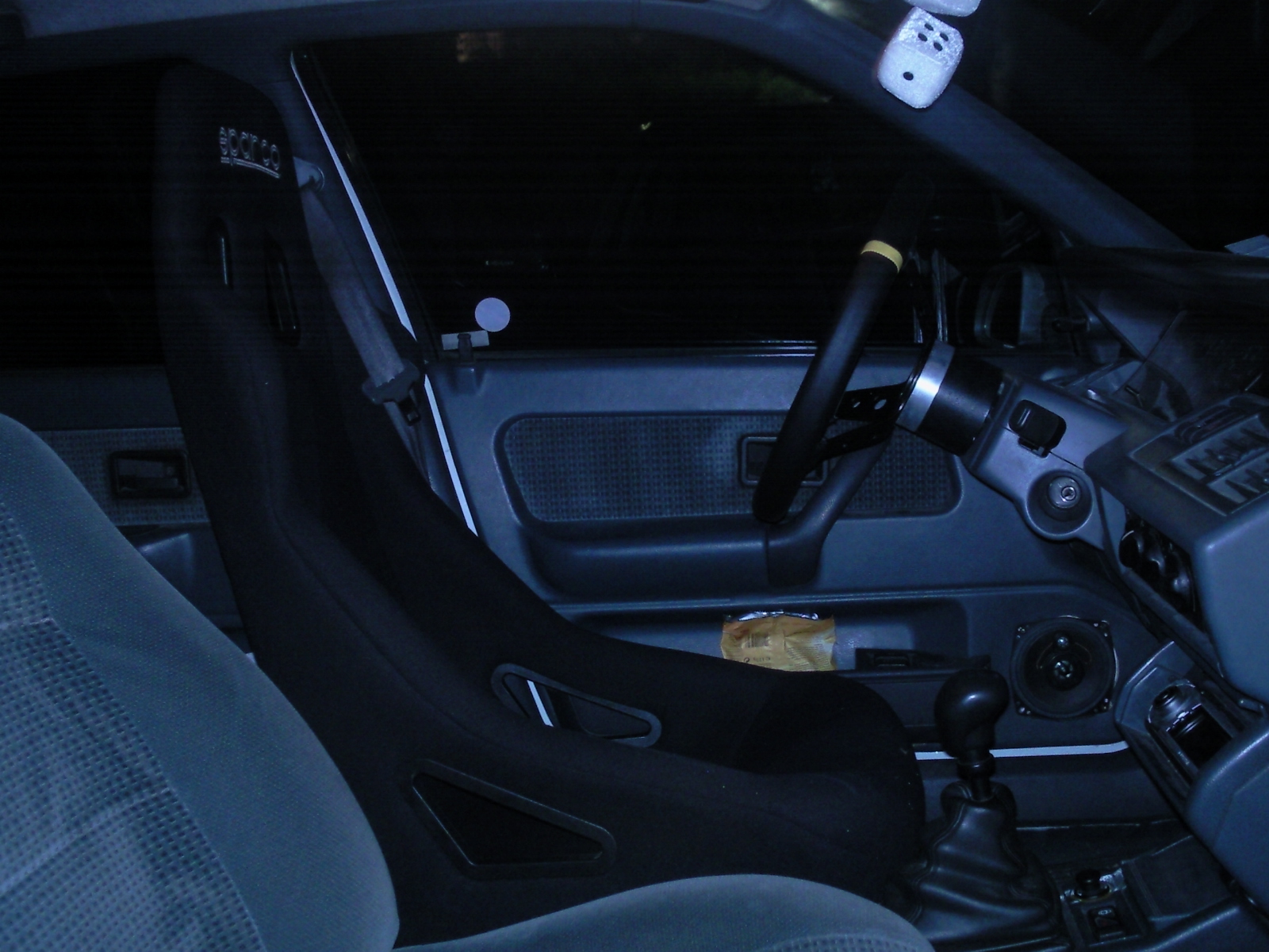

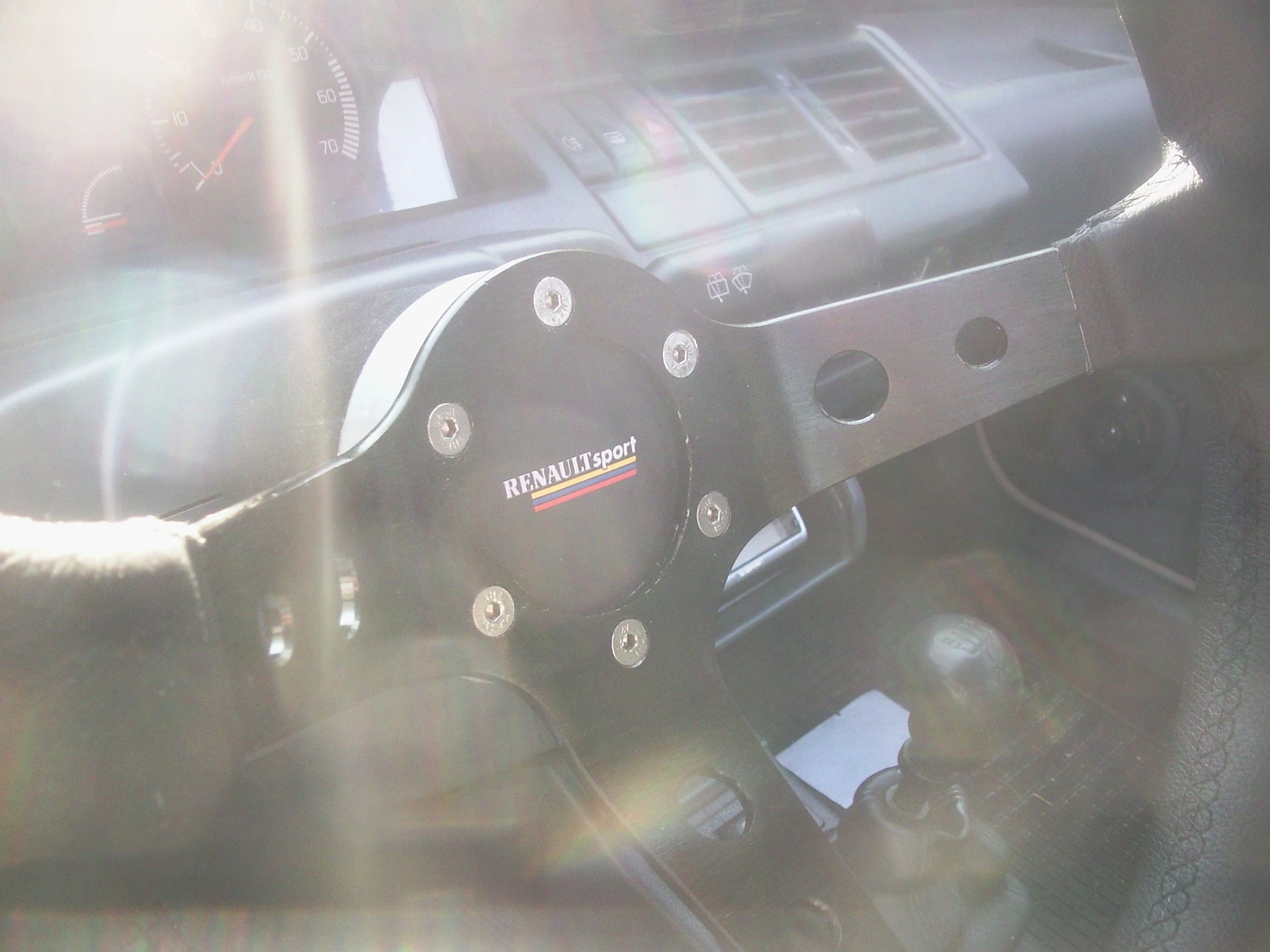

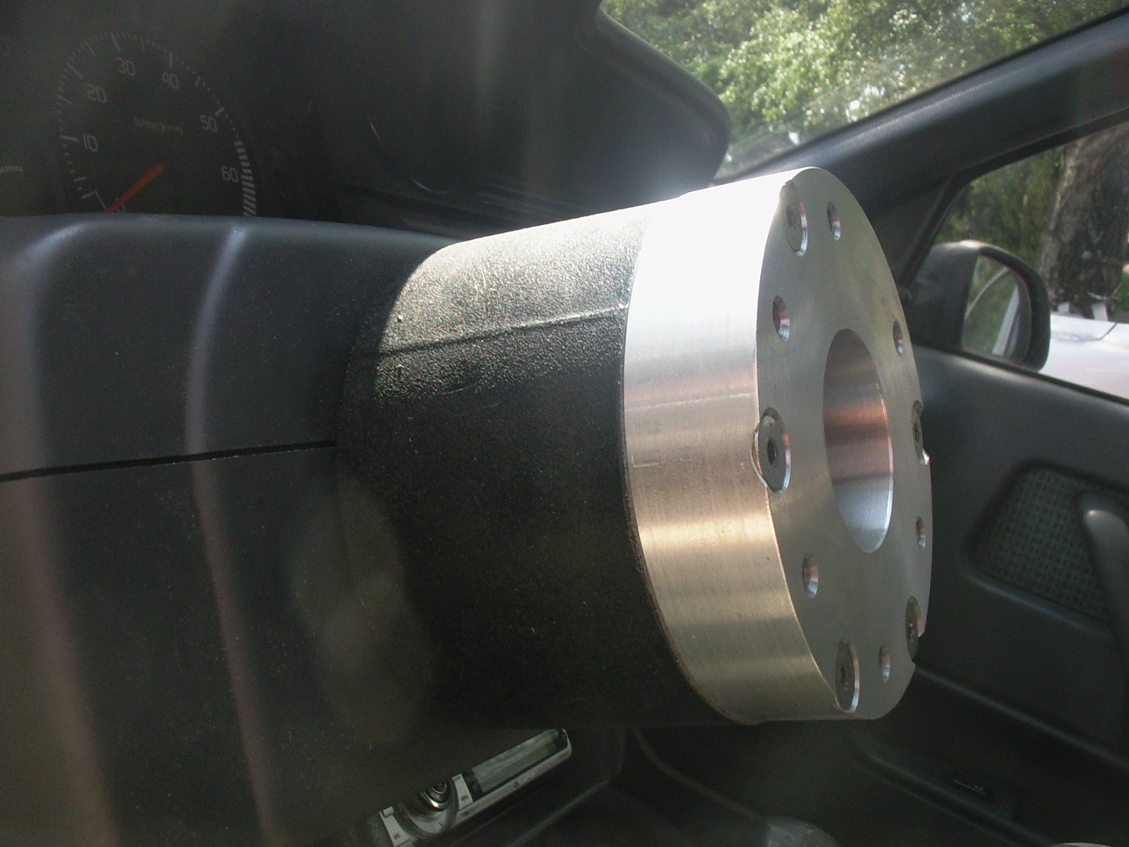

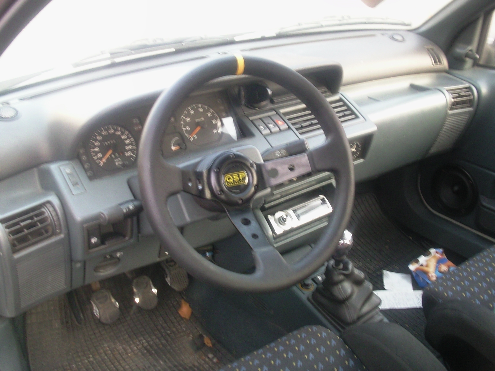

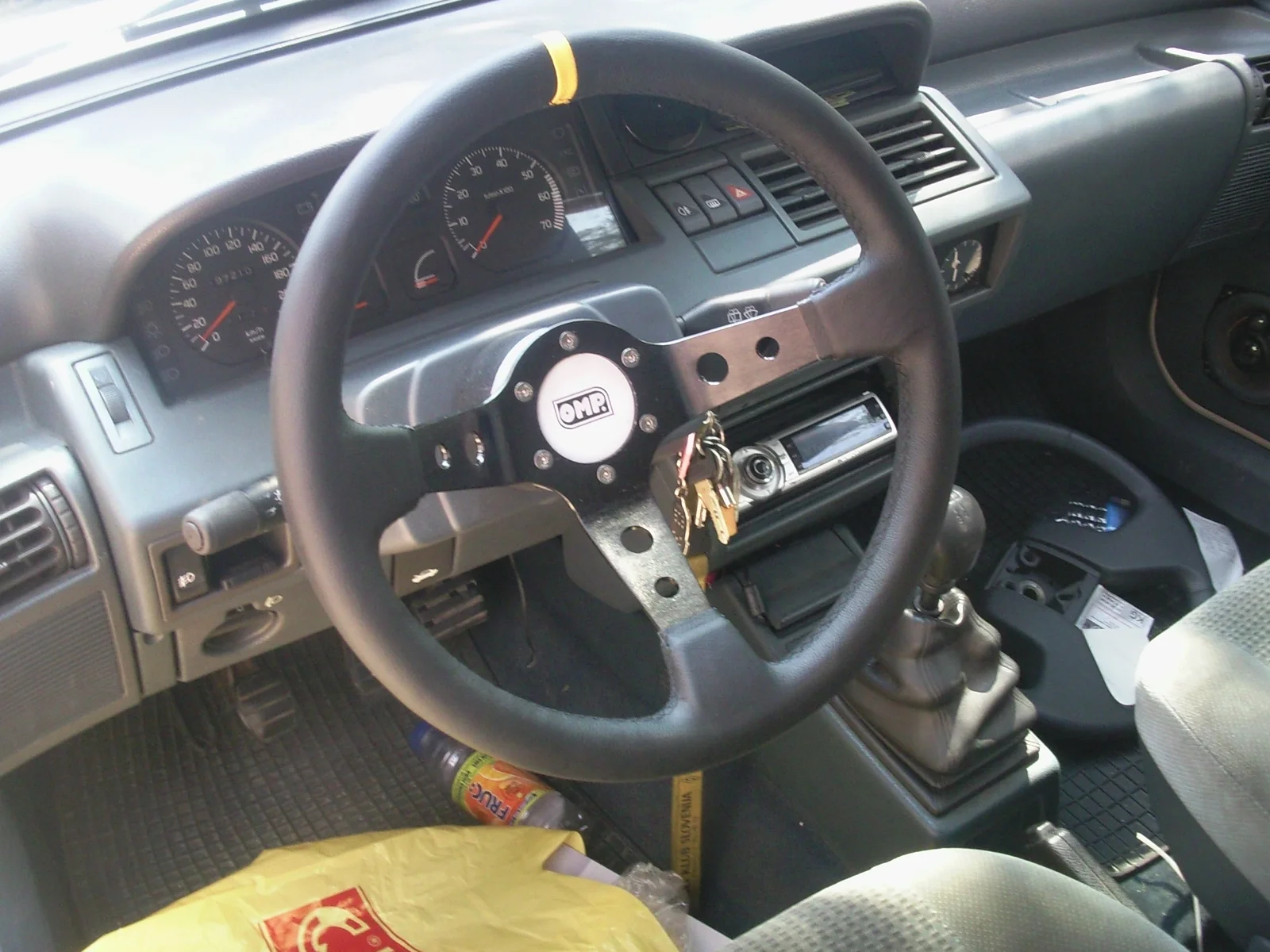

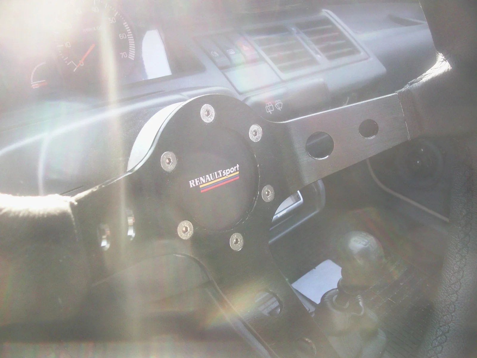

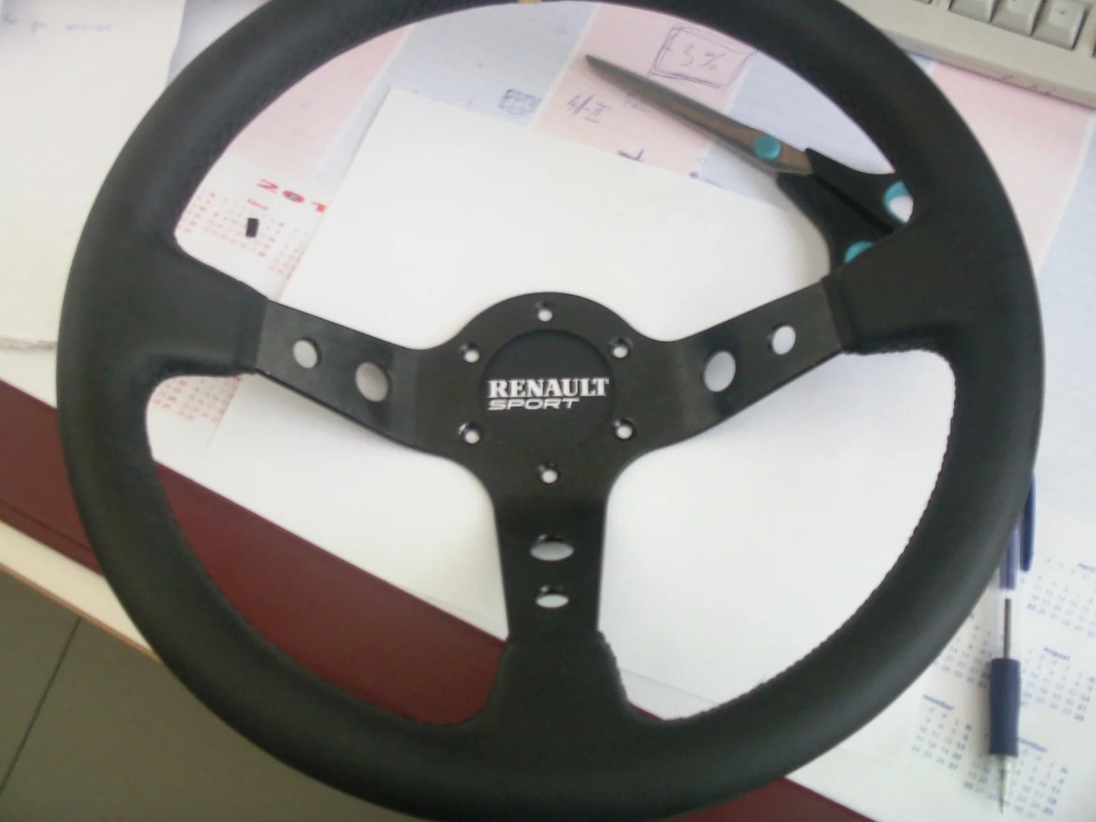

Today i test fitted my Deepdish steerin wheel into my "mule car".

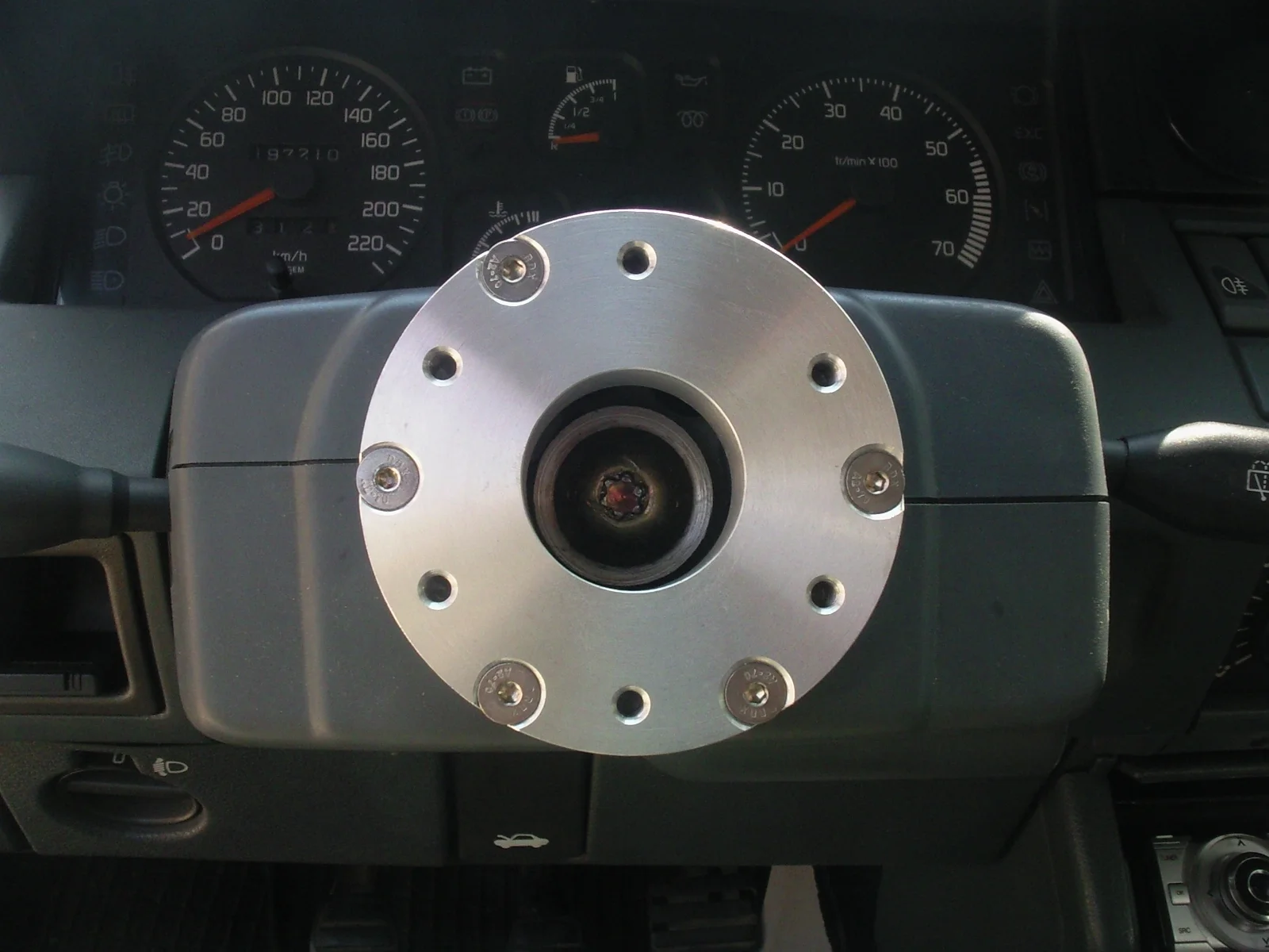

we made a spacer that bolts on to the original williams/16v steering wheel hub:
and then the steering wheel:
since i don't need a horn button i had a litle fun and made this:
and when i mounted it i didn't like it, so I made a nother one :D
I tested it today and im verry happy with the driving position. Damn i wish my "mule" had 20-30 BHP more :D

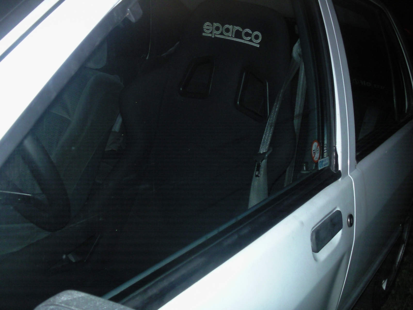

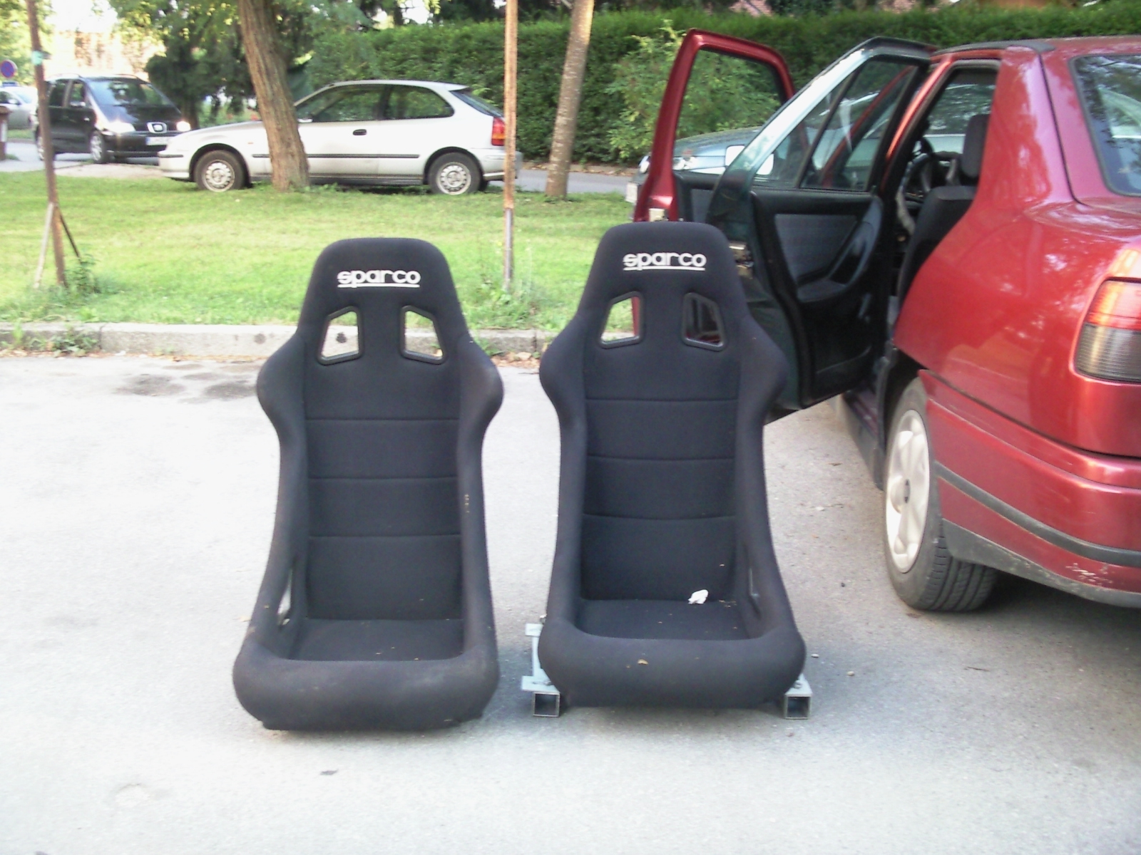

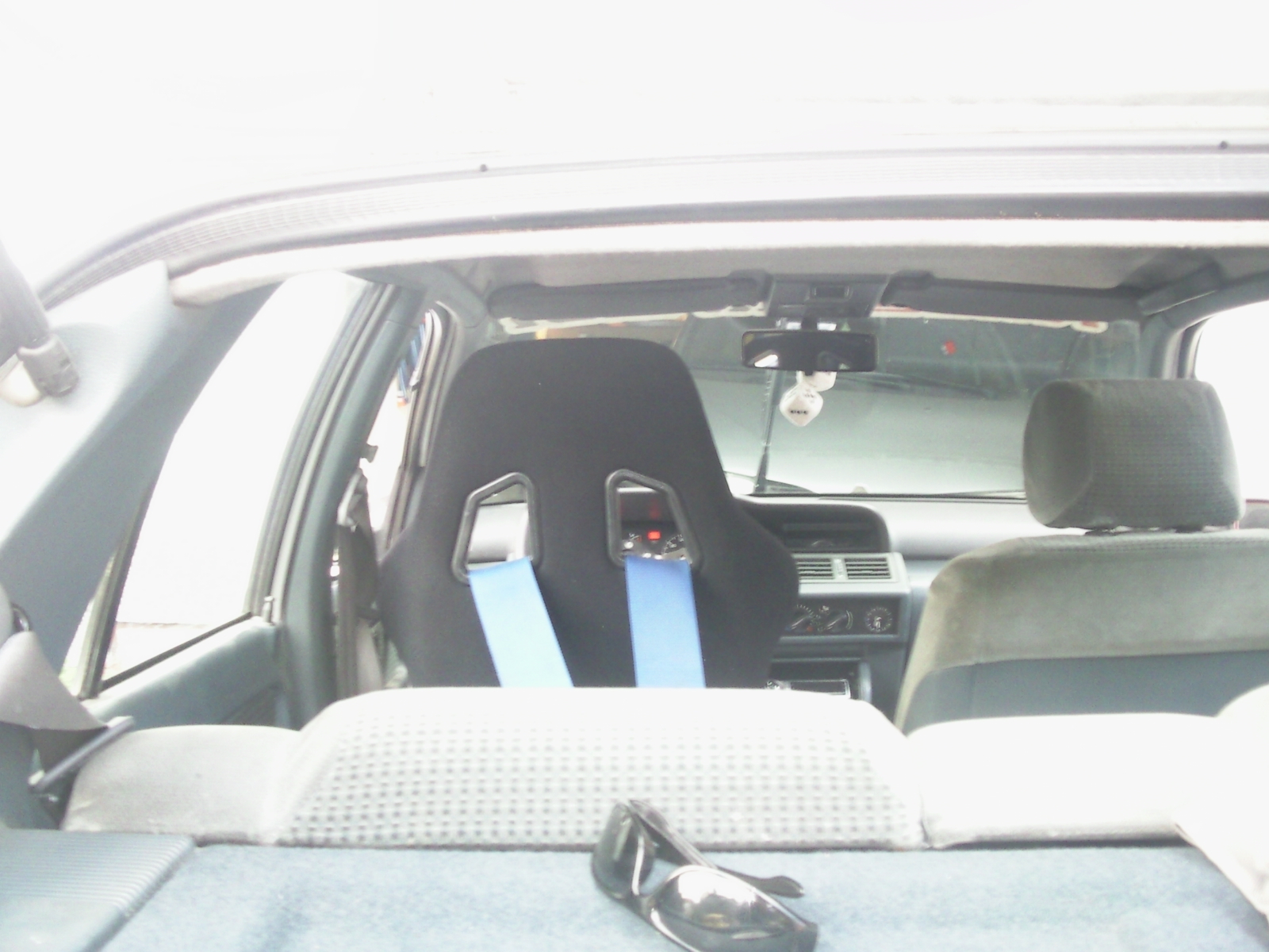

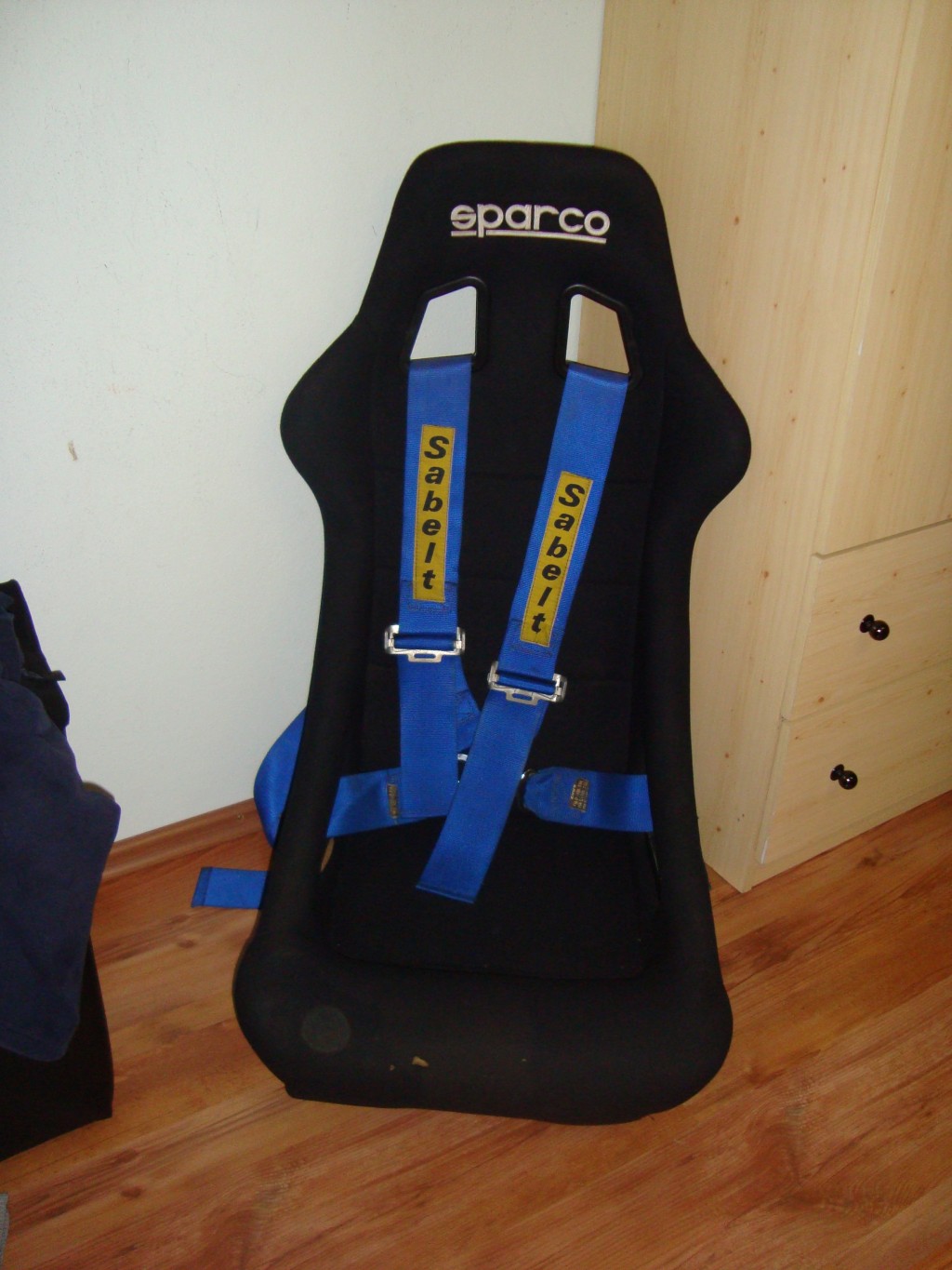

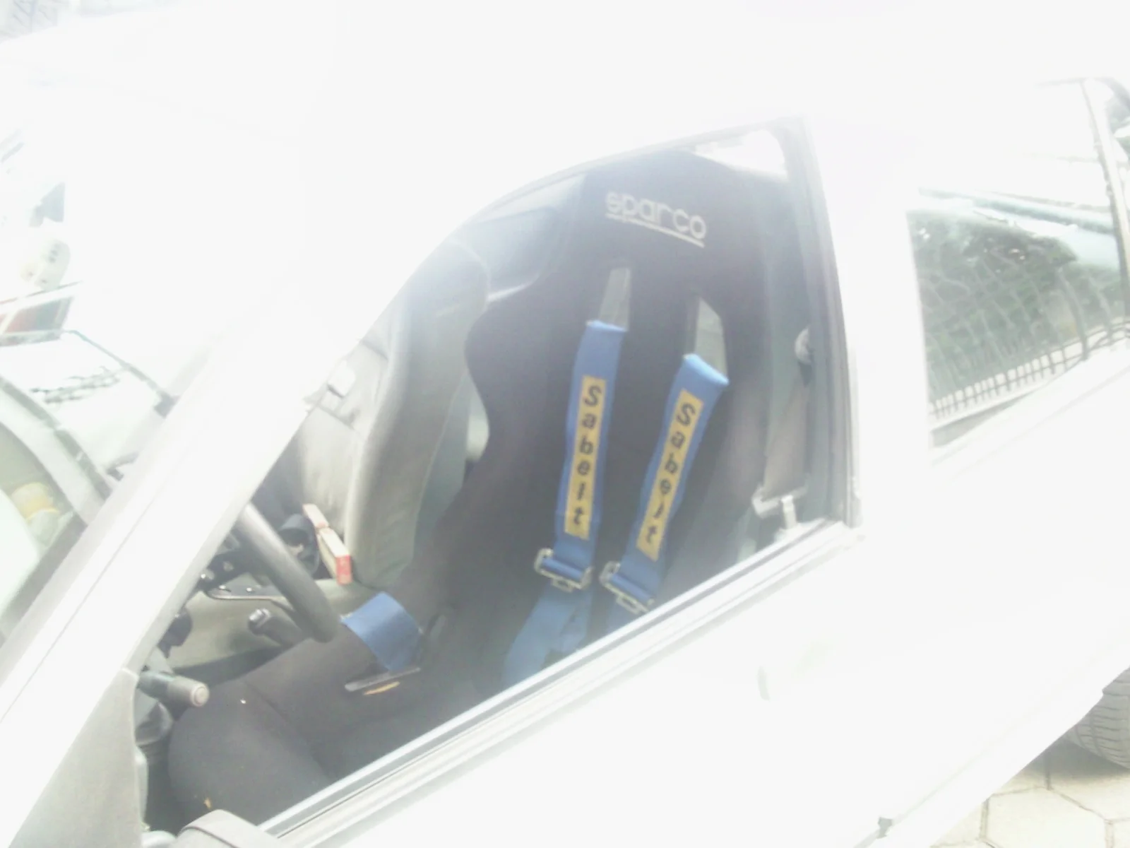

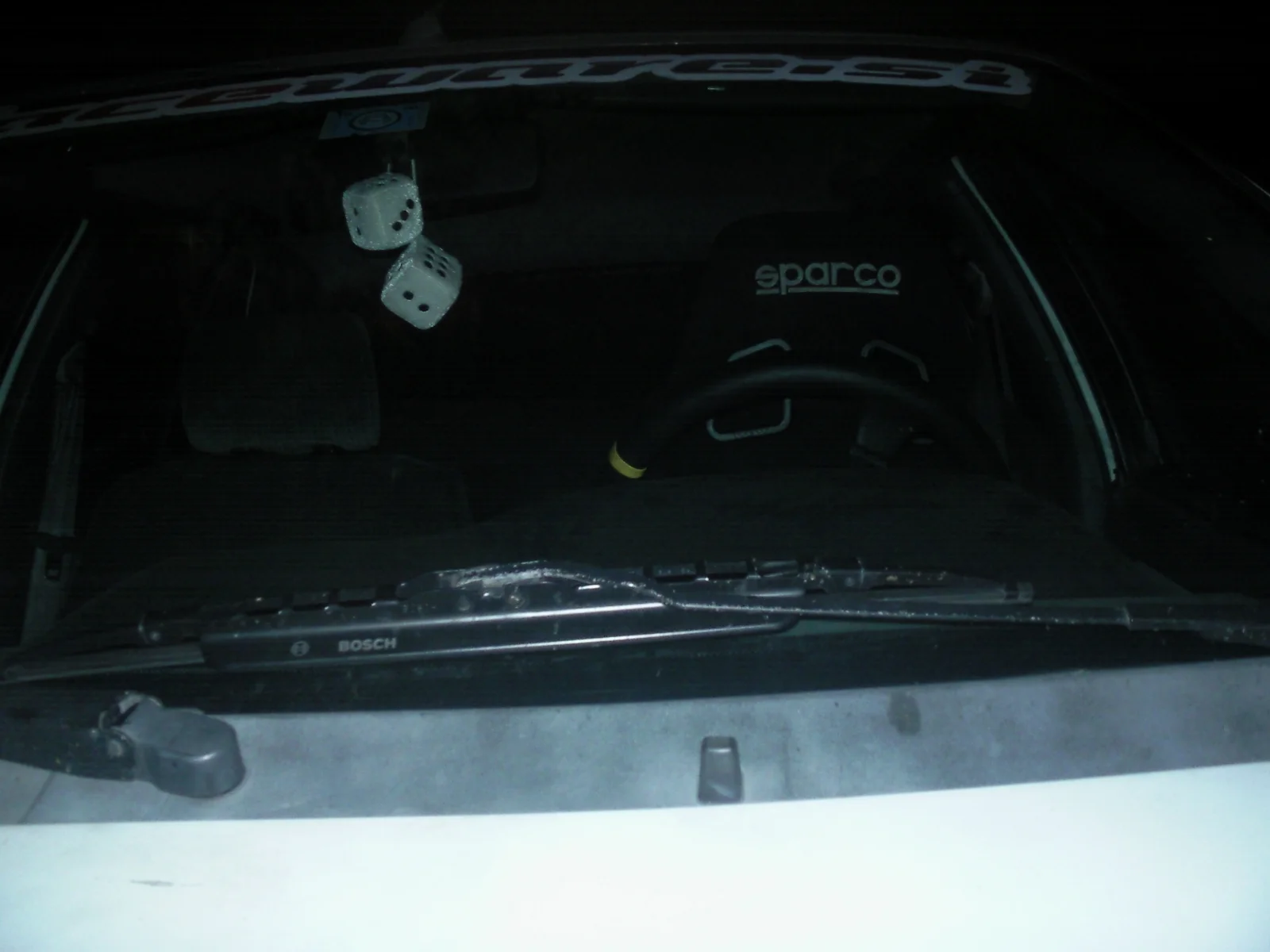

Today I got myself to get the sparco seat into my car :)
This is what I ended up with :)
It needs some more tweeks to be parfect :)

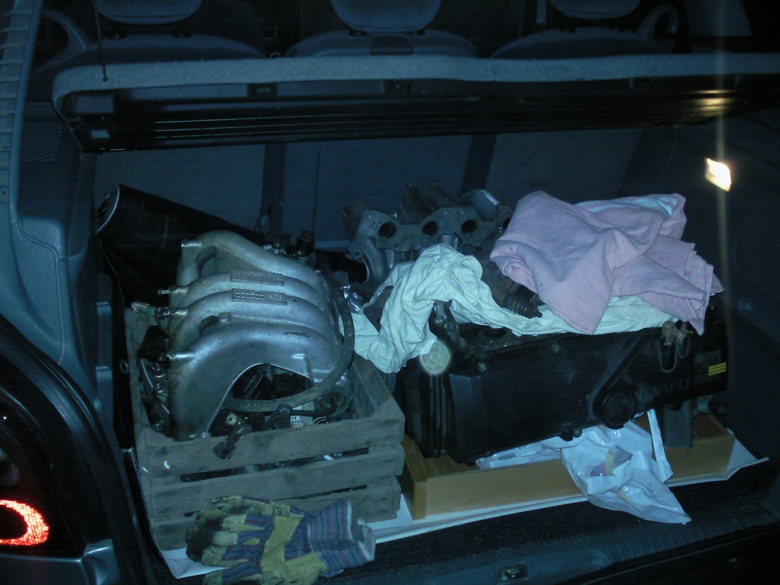

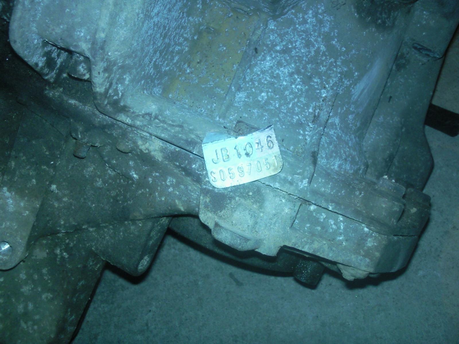

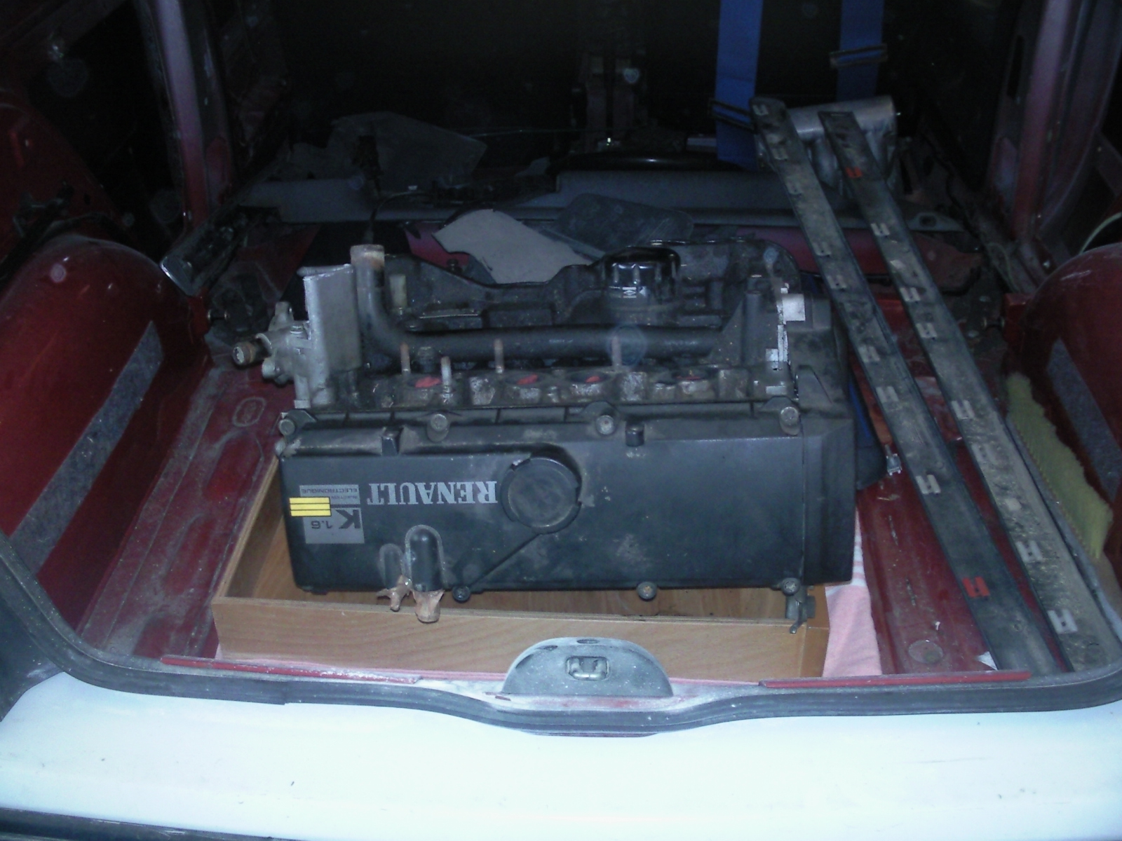

First of all i've sourced a 1.6e engine from the Megane, and the shortest possible gearbox from an Express Diesel :)
Photos of the engine:
During transport
Waiting to be refurbed and installed :)
Gearbox
All the parts i've got with the engine:

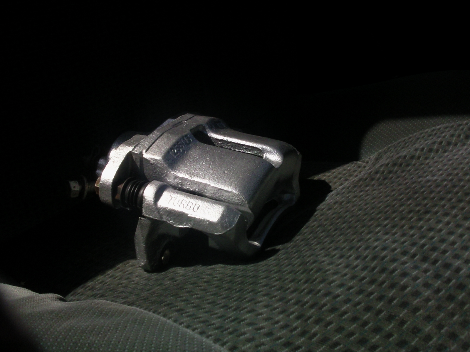

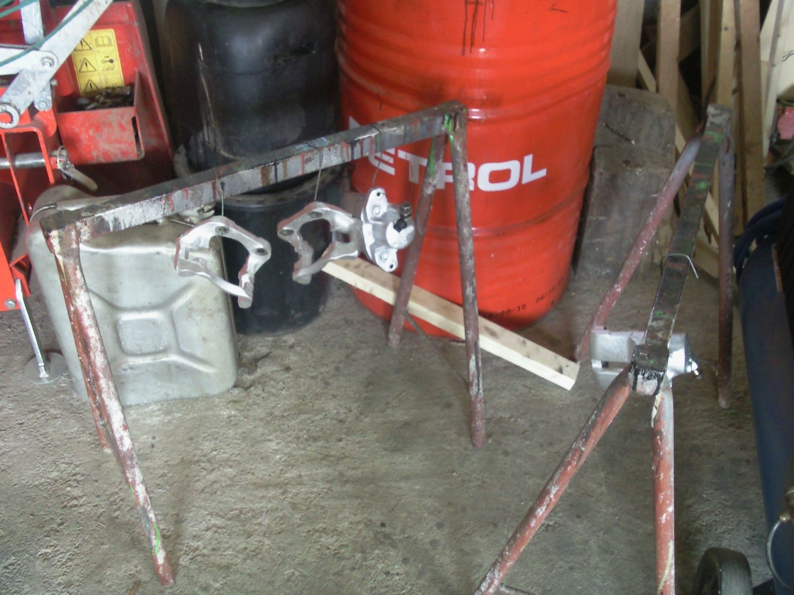

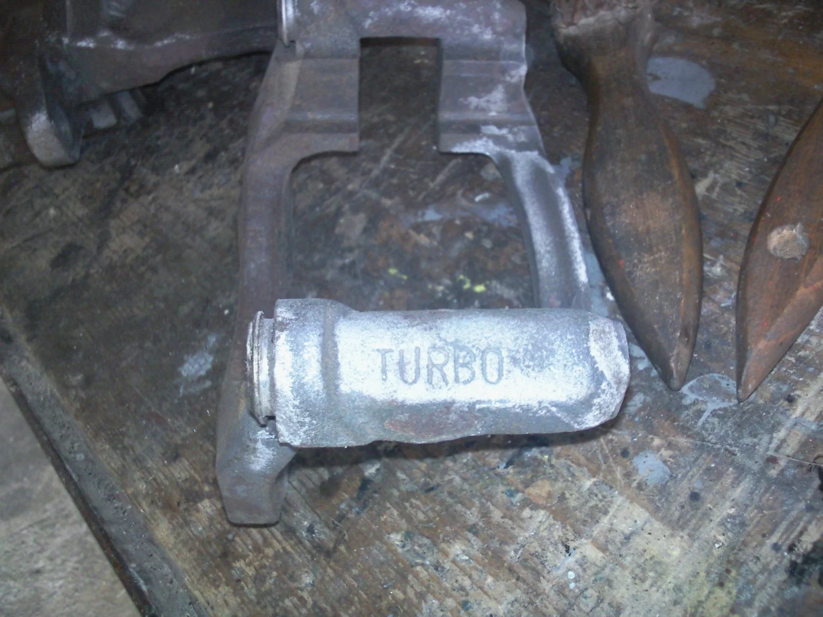

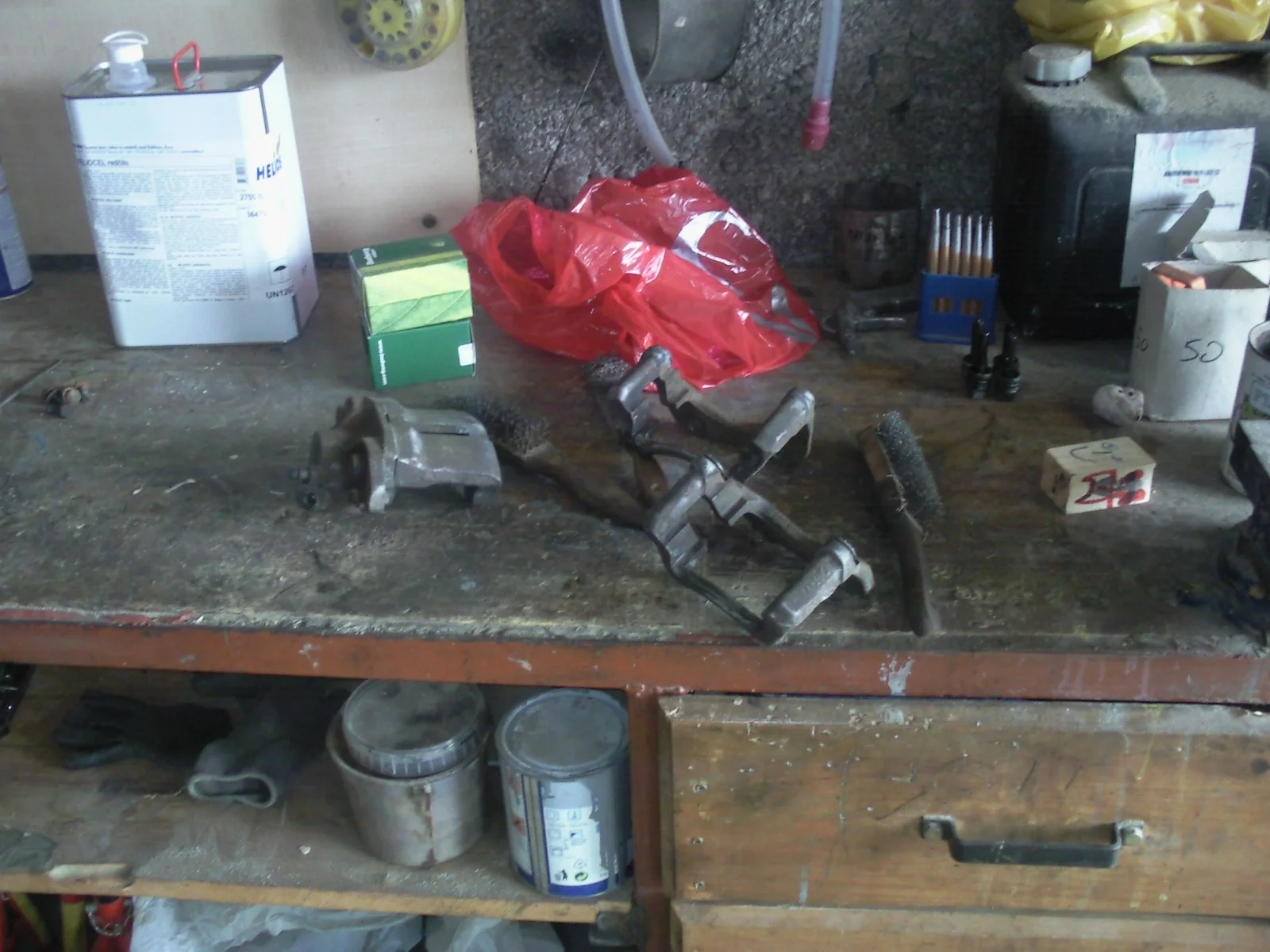

Also we have refurbished the brake callipers from a 1.8 16v clio.
Finished product:
Also i've sourced a second seat:

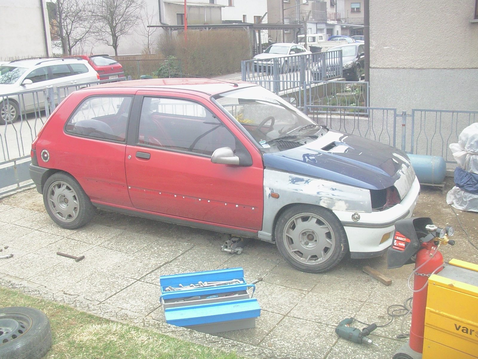

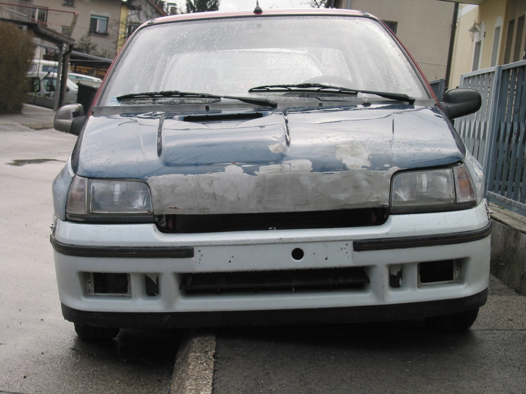

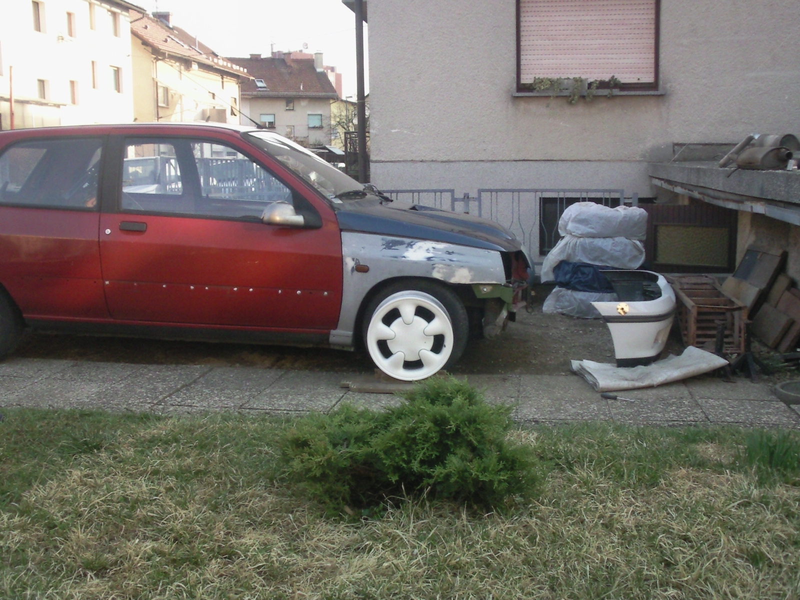

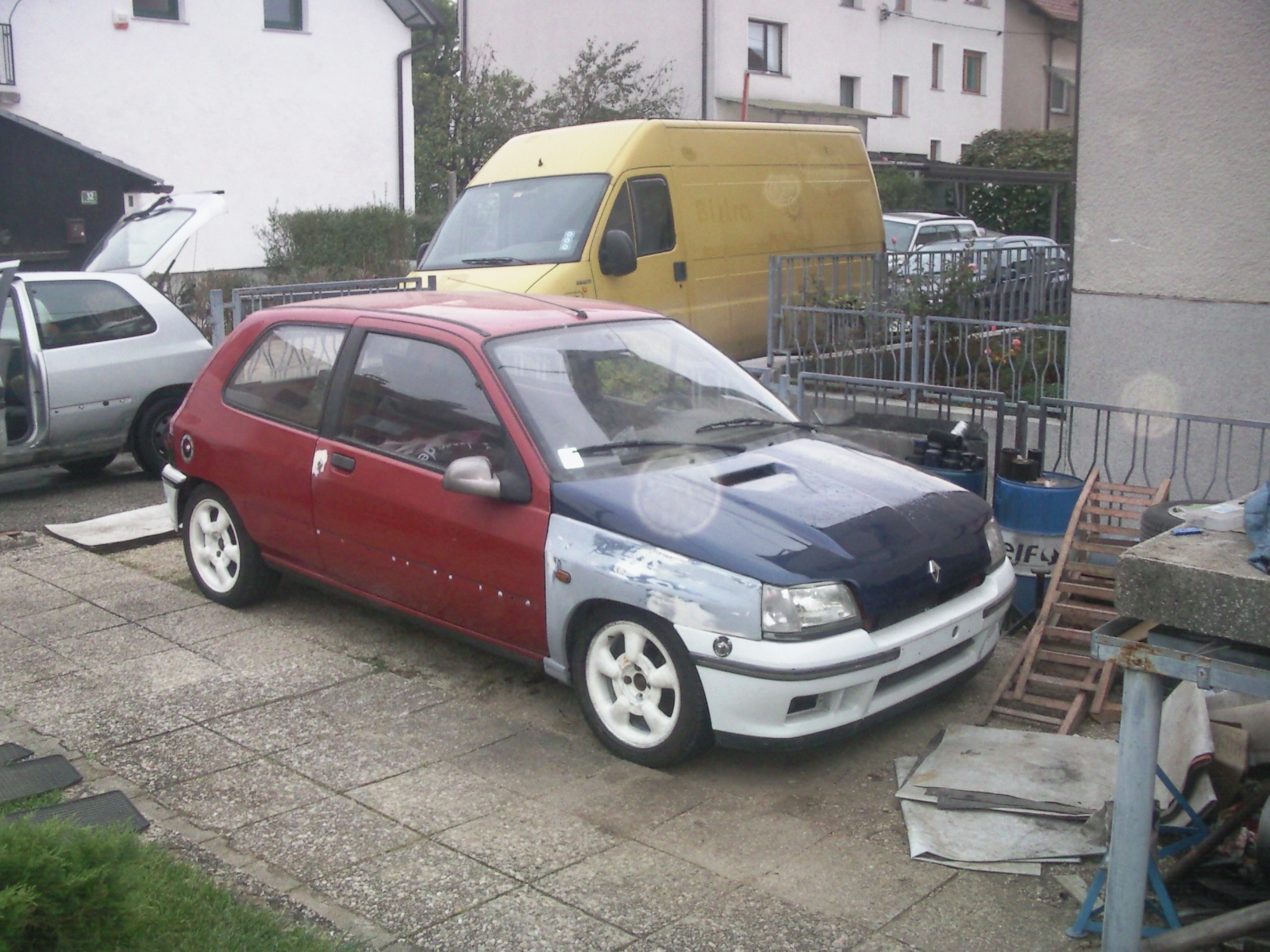

The project has Been kickstarted into life once again.

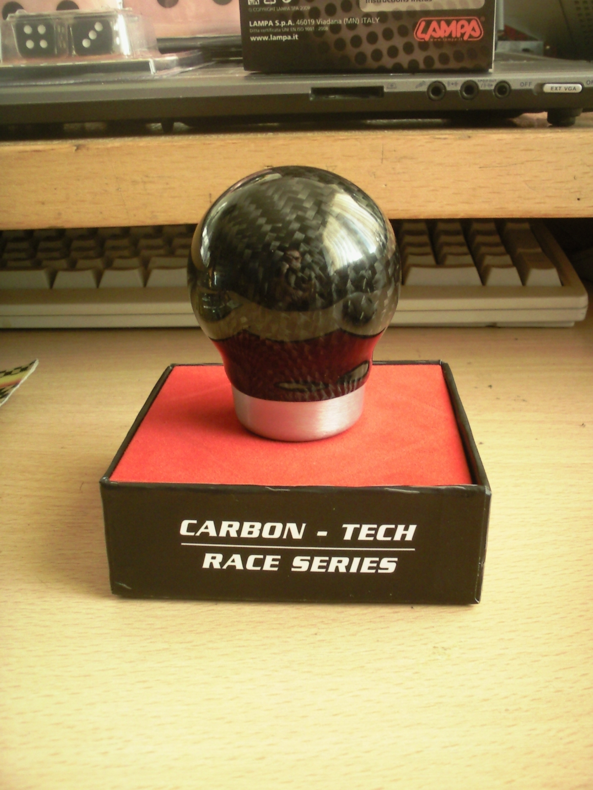

Something i just culd not resist:

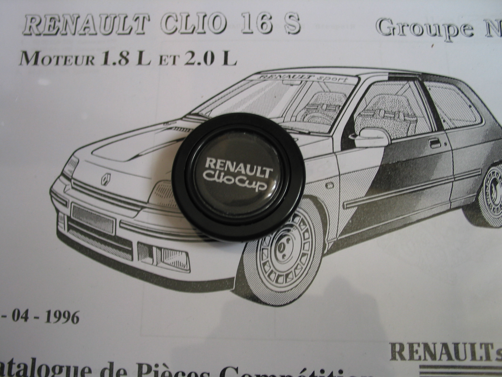

New horn button for the racing steering wheel:
New bonnet:

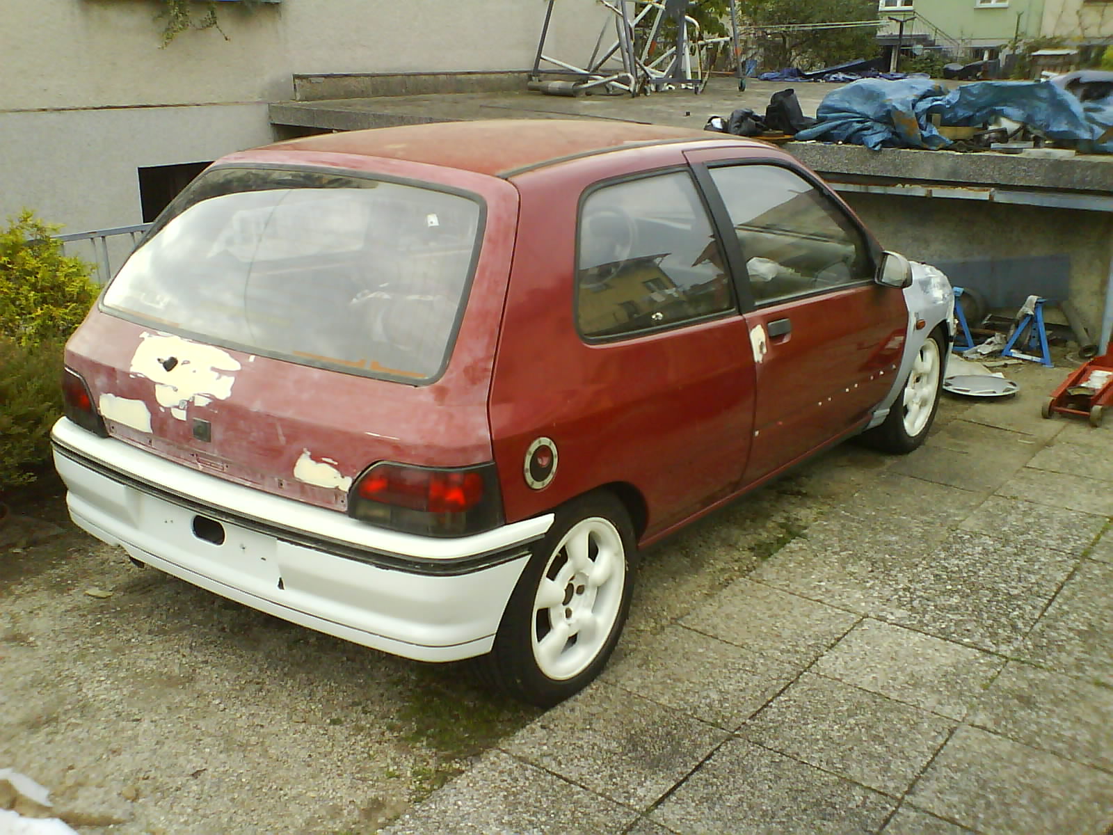

Rear of the car:

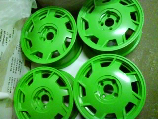

Newley painted wheels:
  Renault Clio 1.6 CUP

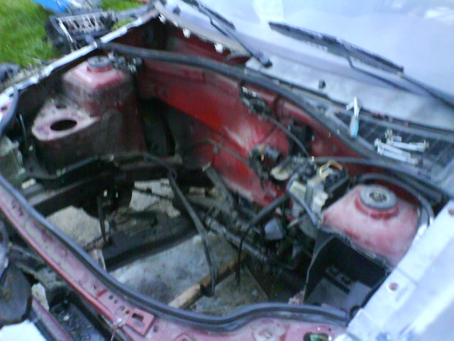

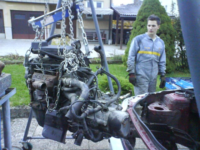

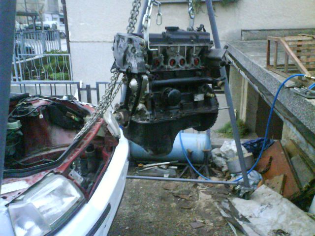

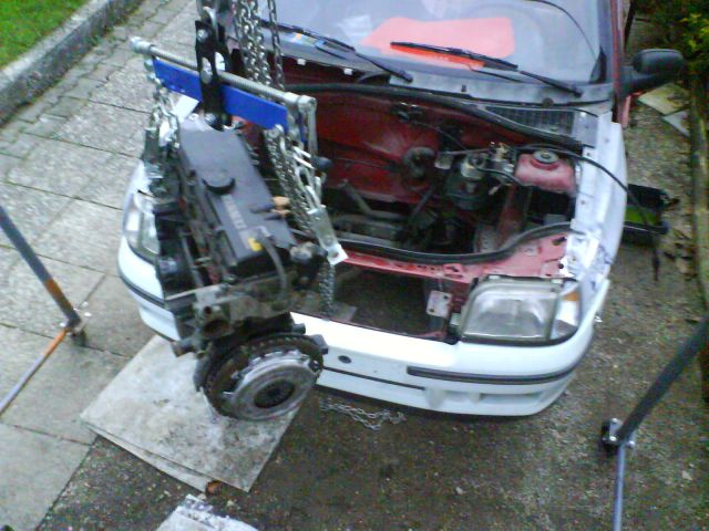

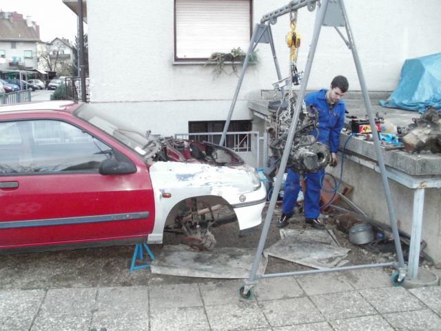

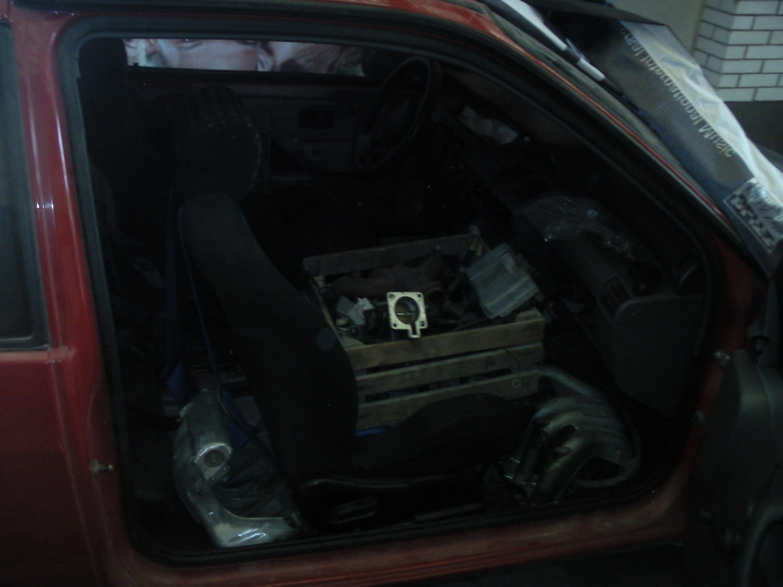

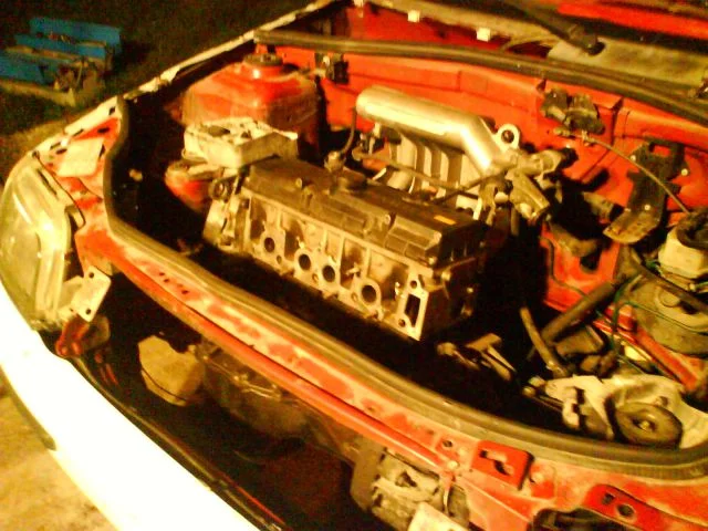

Ok finaly the crappy 1.2 engine is out :)
time taken: 1.5 hours :)
The new one wil probably be fitted on monday. Damn clutch....
(ps sorry for the crappy cell phone pics)
Ok, we have got a new clutch, new oil for the engine and the gearbox, new gaskets for the ehaust and inlet manifold, modified the hell out the inlet manifold to fit the engine mount, so close yet so far. As my friend said like takeing the antlers of a raindeer :)

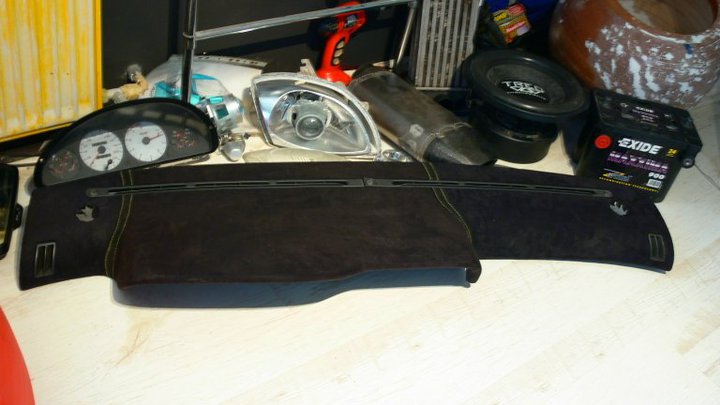

And something else for the inerior :) The dashboard cover covered in swade :)

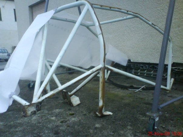

a 9-point weld in rollcage:

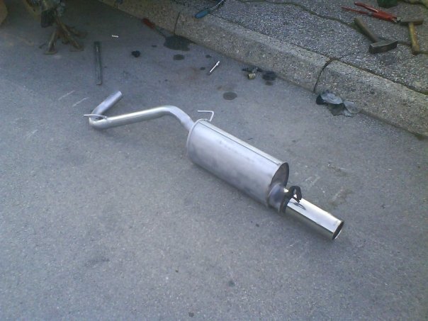

and an asso sport rear box:
