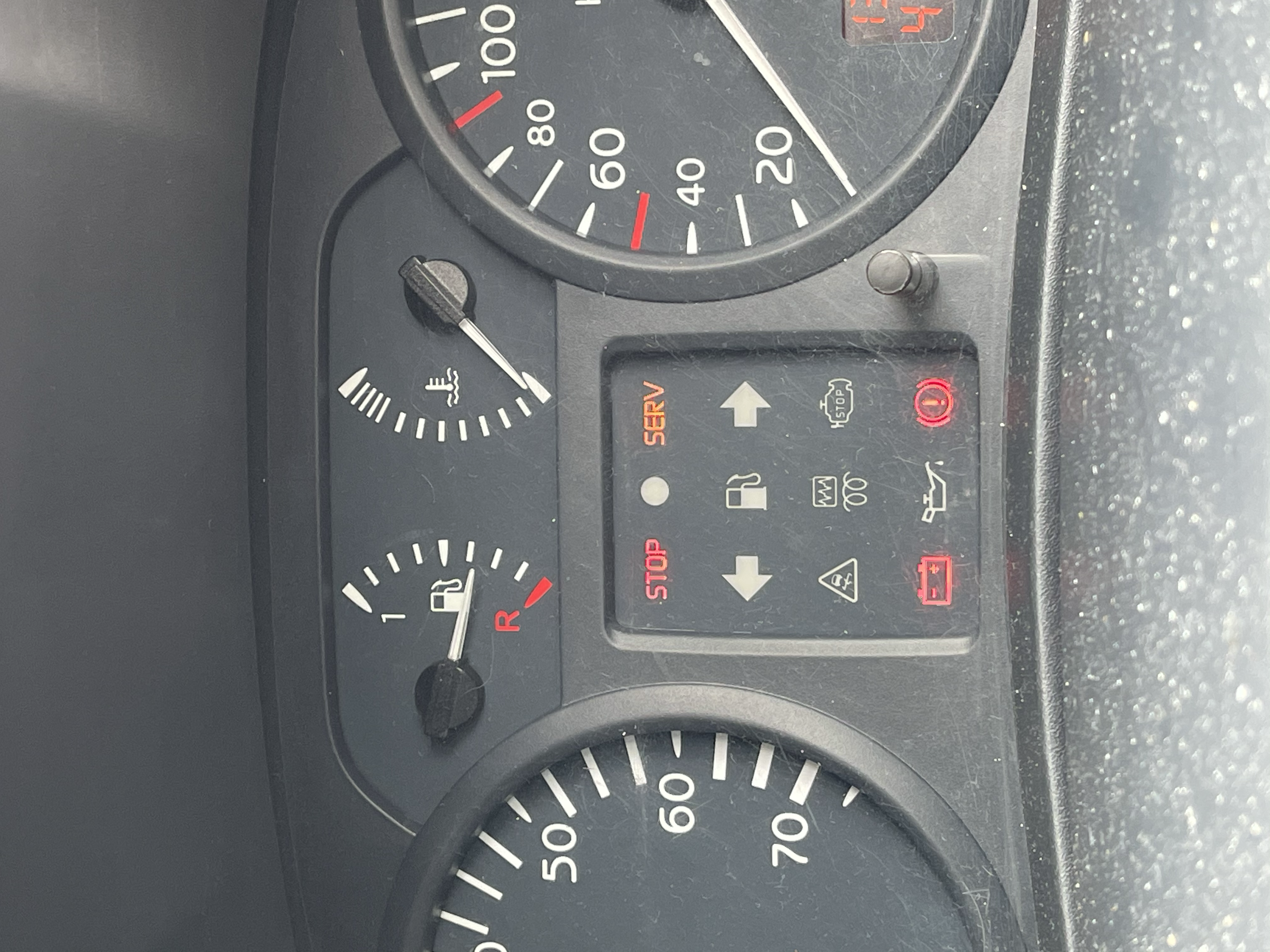

I've attached a video of what happens when I try starting it, and a photo of the lights on the dash.

Maybe a fuel supply issue if everything is cranking. E.G fuel injectors , fuel filter.
I could of course be wrong
From the sound of your first video, I'm sorry to say, it sounds like your timing has slipped and you've got no compression.
Two ways to confirm/deny:
1 - Plugs out and carry out a compression test
2 - Check timing (Insert crank pin at TDC and check camshaft positions are correct).
