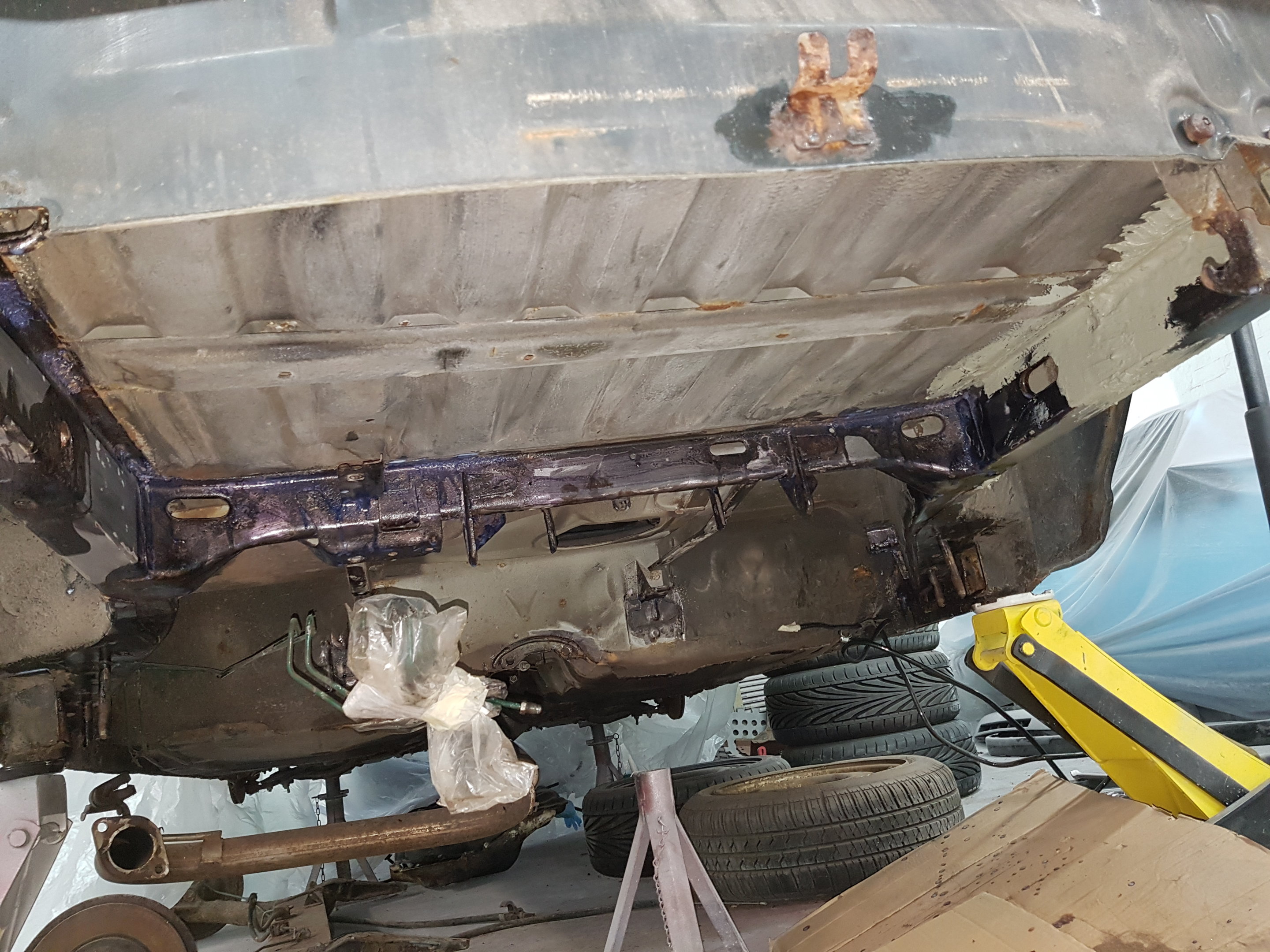

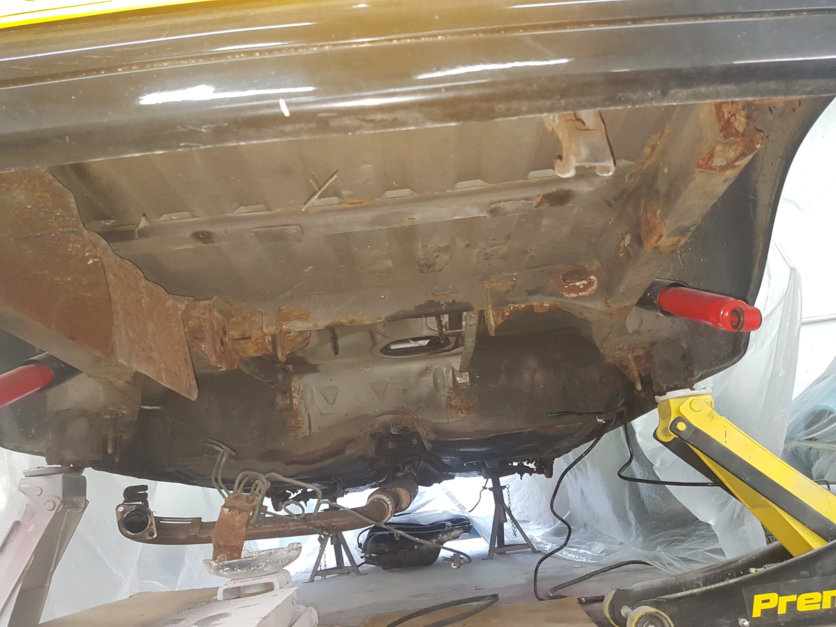

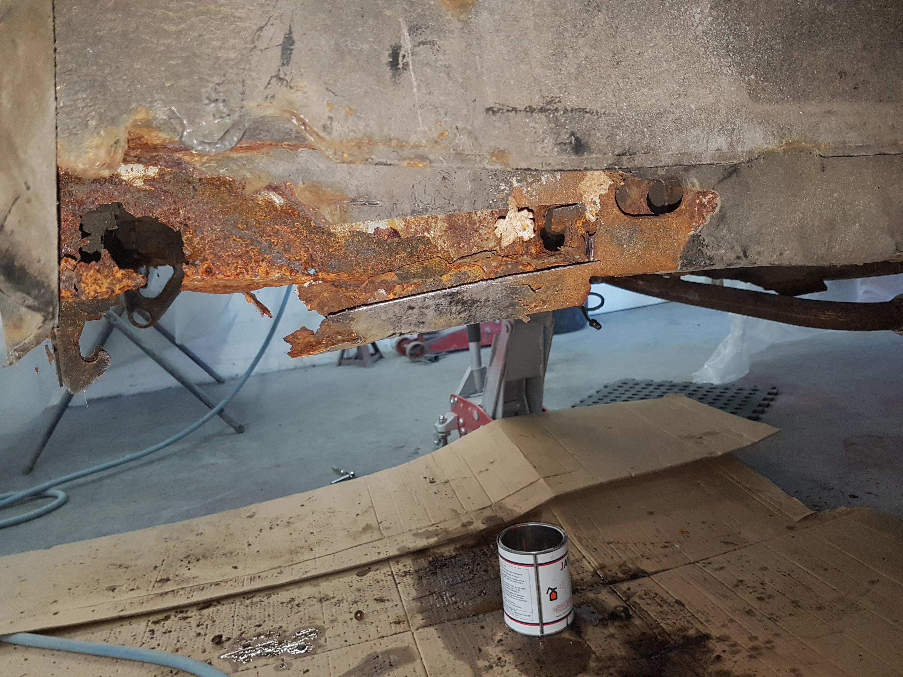

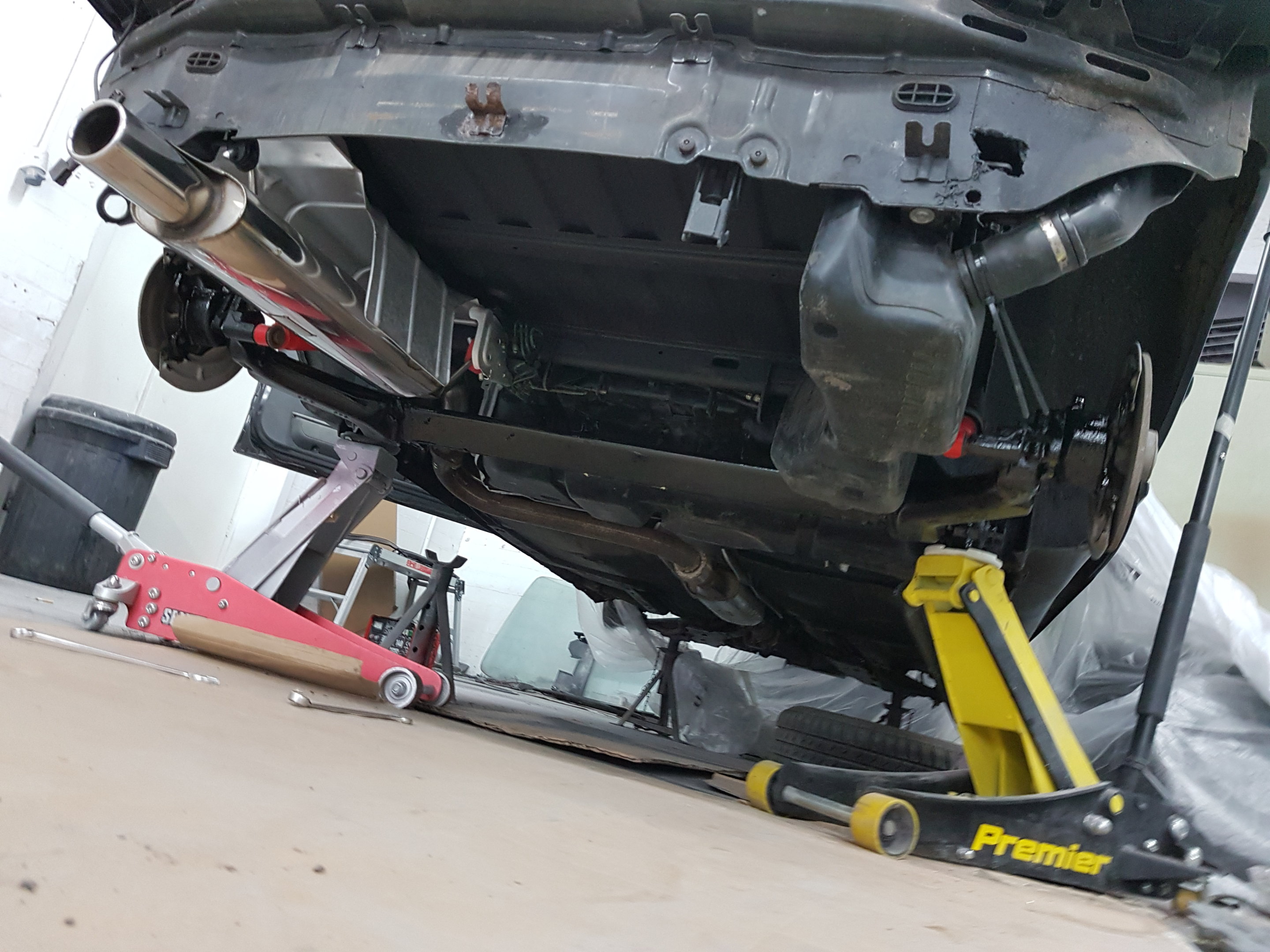

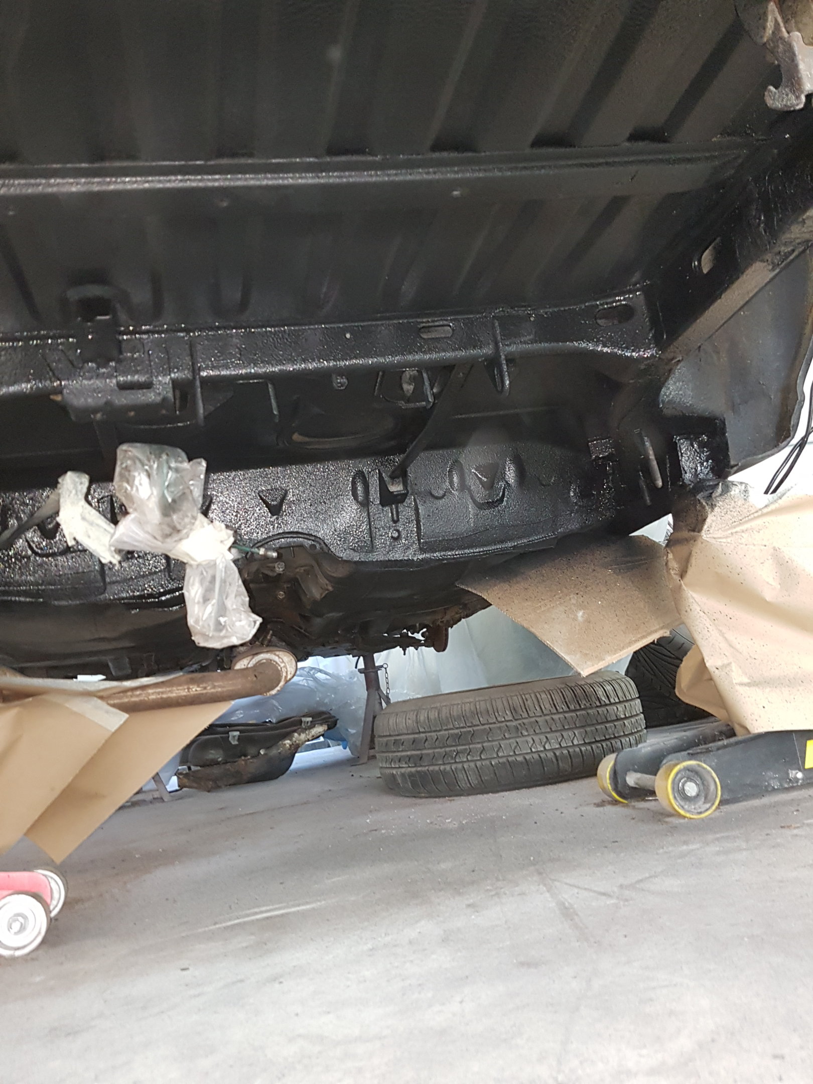

Without even looking around the car ive jacked it up and I've dropped out the res/main tanks along with the axle, then spent a few days grinding and wire brushing under the car and getting rid off loose Rust and then rust converted the lot.
Also cut out the rotten Chassis rail. And welded in a fresh piece..
All sealed nice and messy.

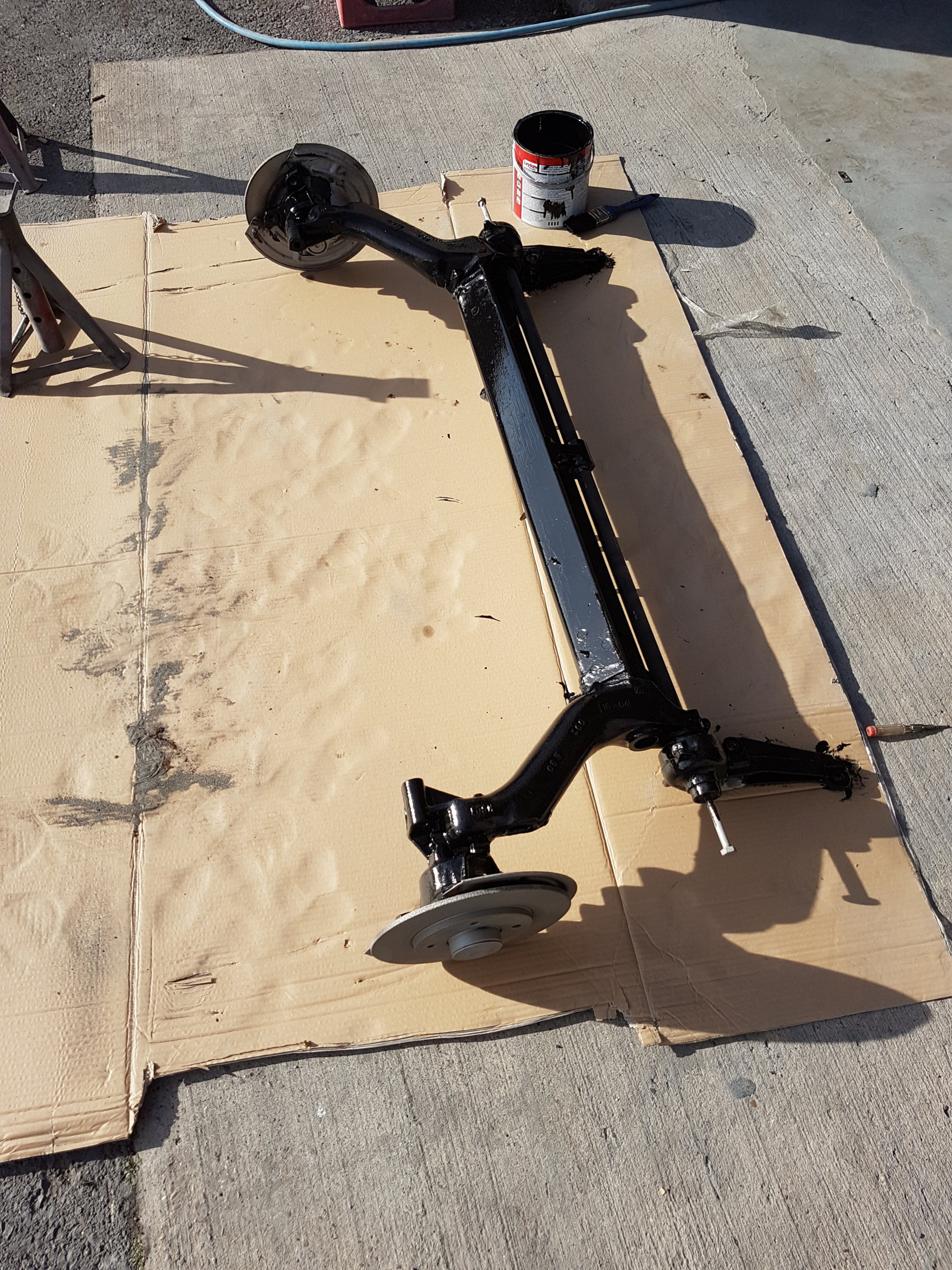

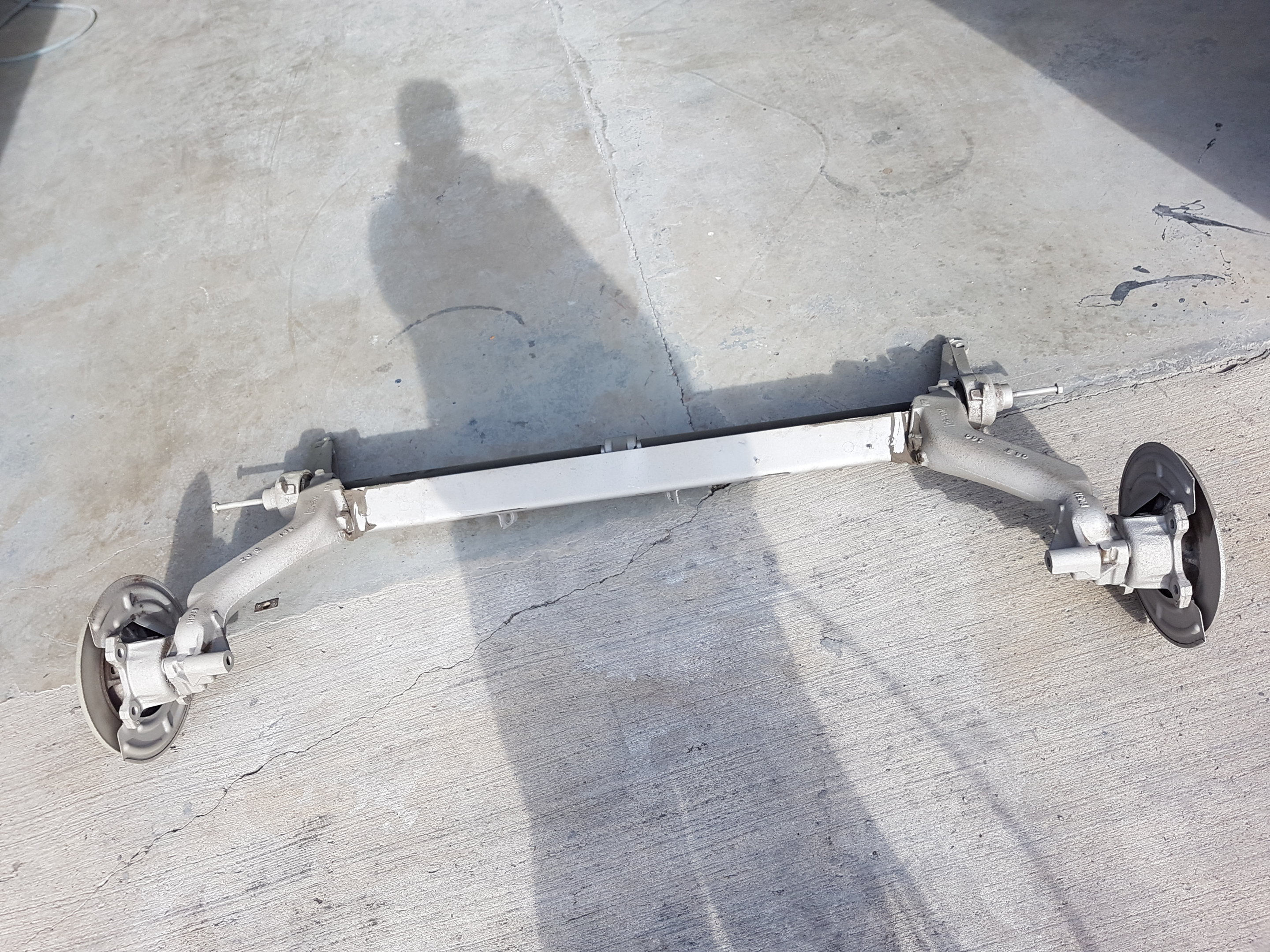

Axle blasted and brushed with some nice black paint. Unknown of brand atm.
Stone guarded the underneath after the rust converter did it's job
Super happy with how that came out.

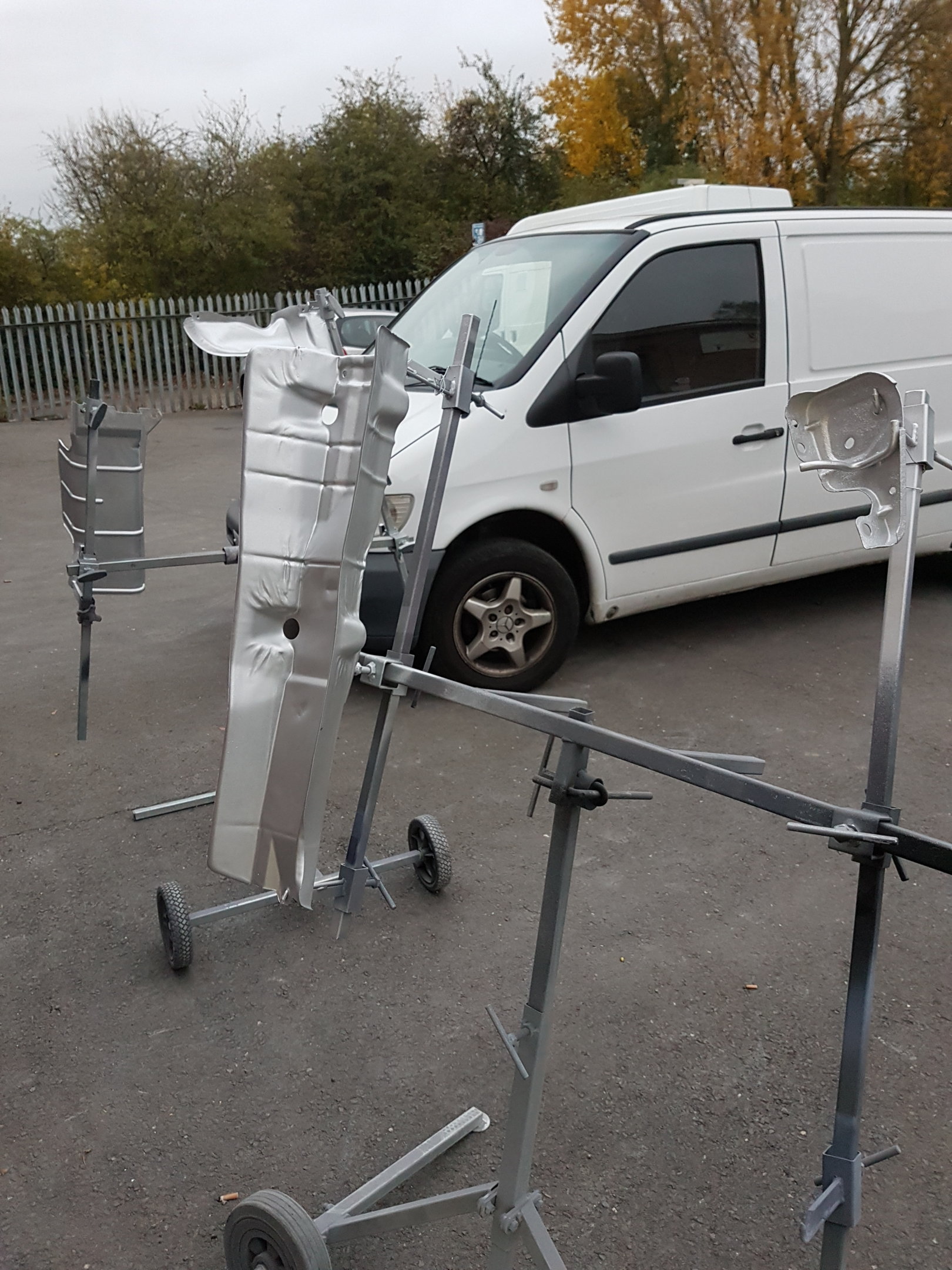

Then had various bits sand blasted and decided to paint them in heat resistant silver.
Finished product incoming:
That's the back end sorted out, other than calipers refurb and new handbrake lines rear bearings ECT..

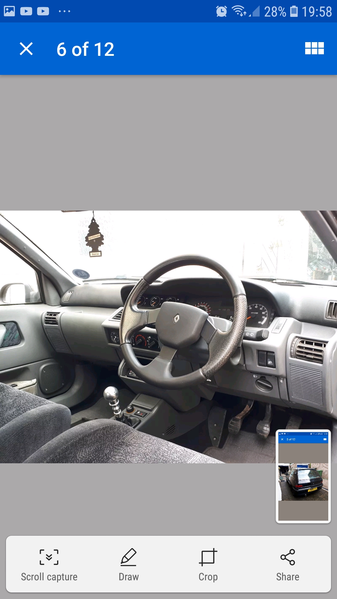

Paint is bit scruffy and has Williams Interior.
Interior:.
To be fair the paint job and interior are both in decent condition.
But I'm a car painter so I'll be aiming for better ? maybe a respray in future..

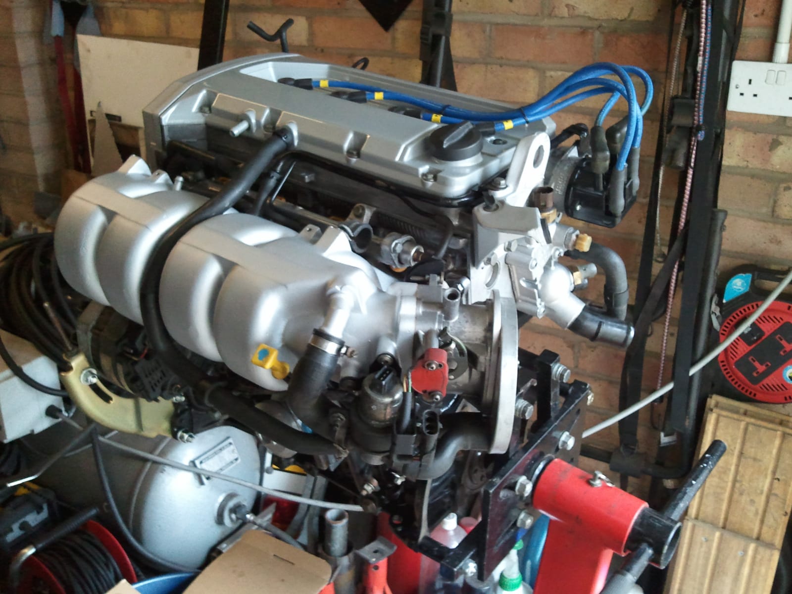

The guy I bought it off done a engine rebuilt I'm guessing about 6-7 years ago. Drove it for a few months then left it sitting in till now..
Engine was hunting on cold. But that's all sorted, story for another day ?

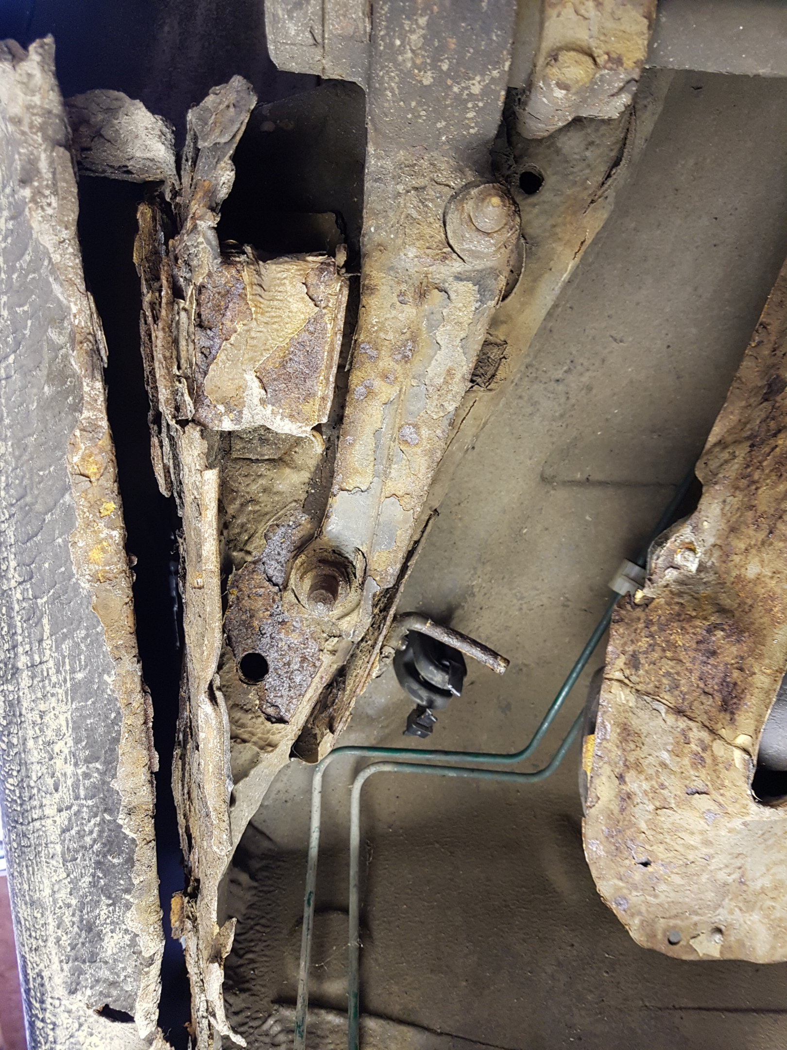

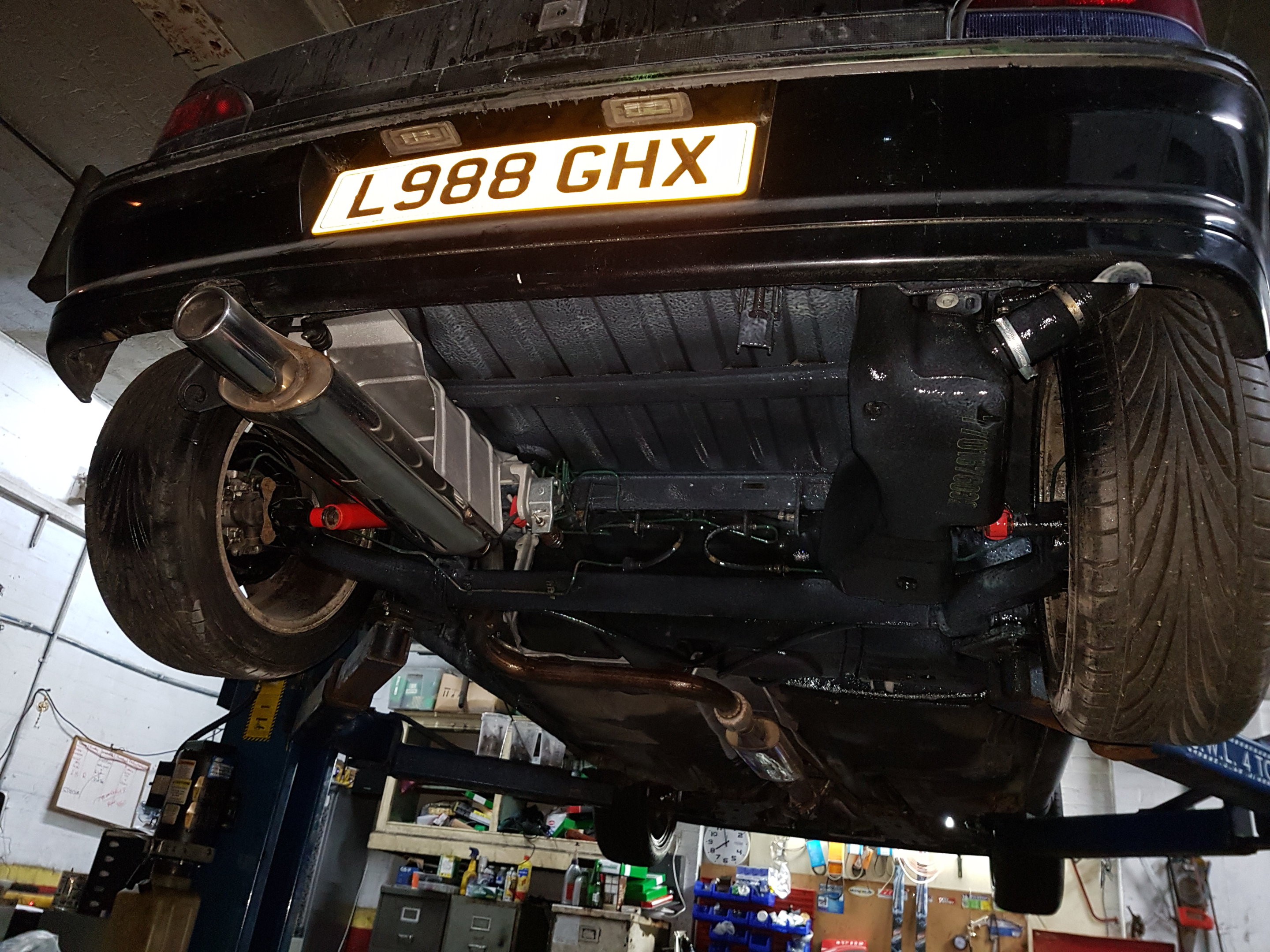

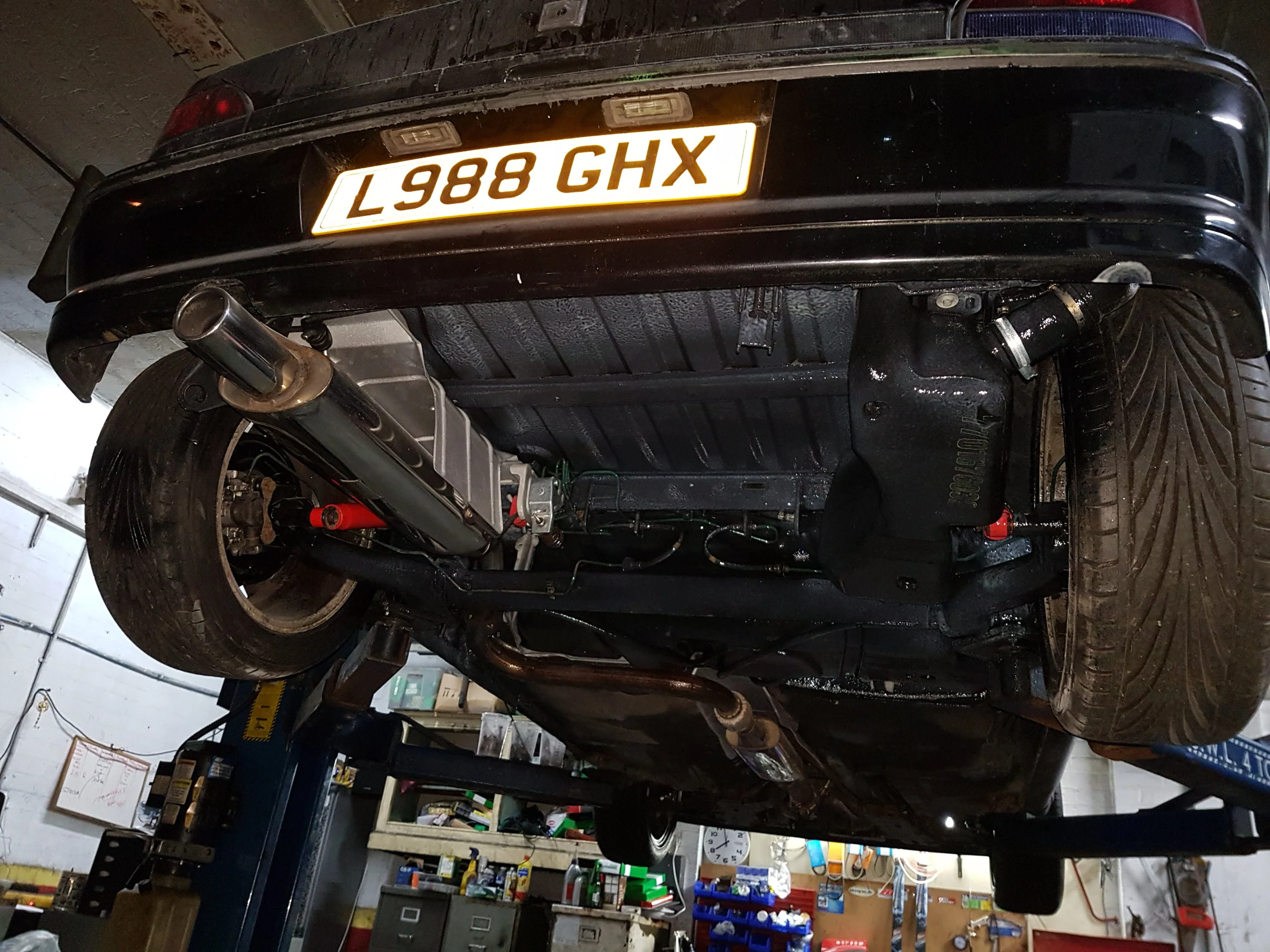

I've today got it on the Ramp to have a real good inspection and waxoil the back end.
I'm positive the back end is complete. But as I looked further down noticed the front jacking points are real bad. No pics of that but that Definetly on the list.

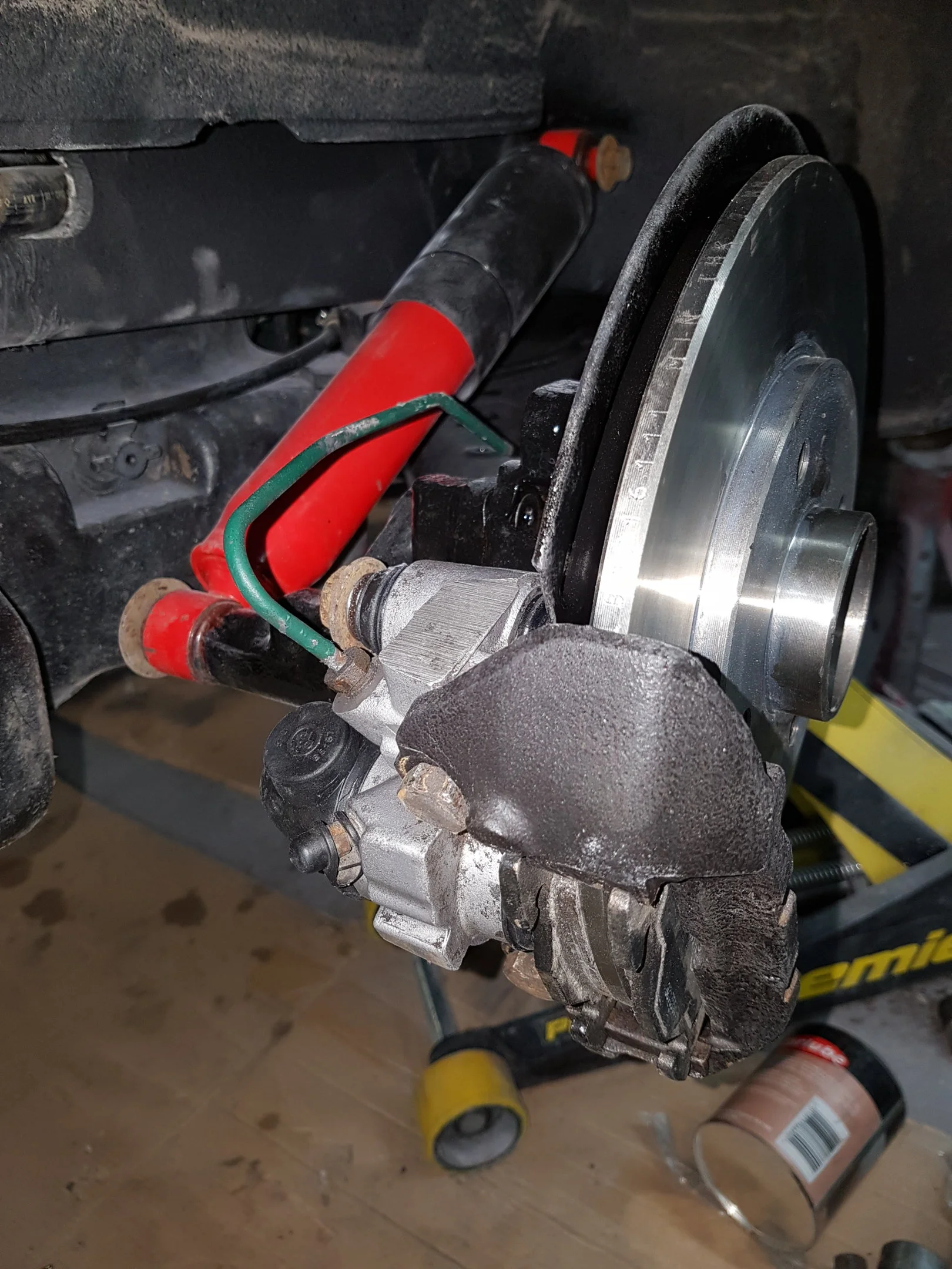

Also rebuilt the brake calipers ( back)

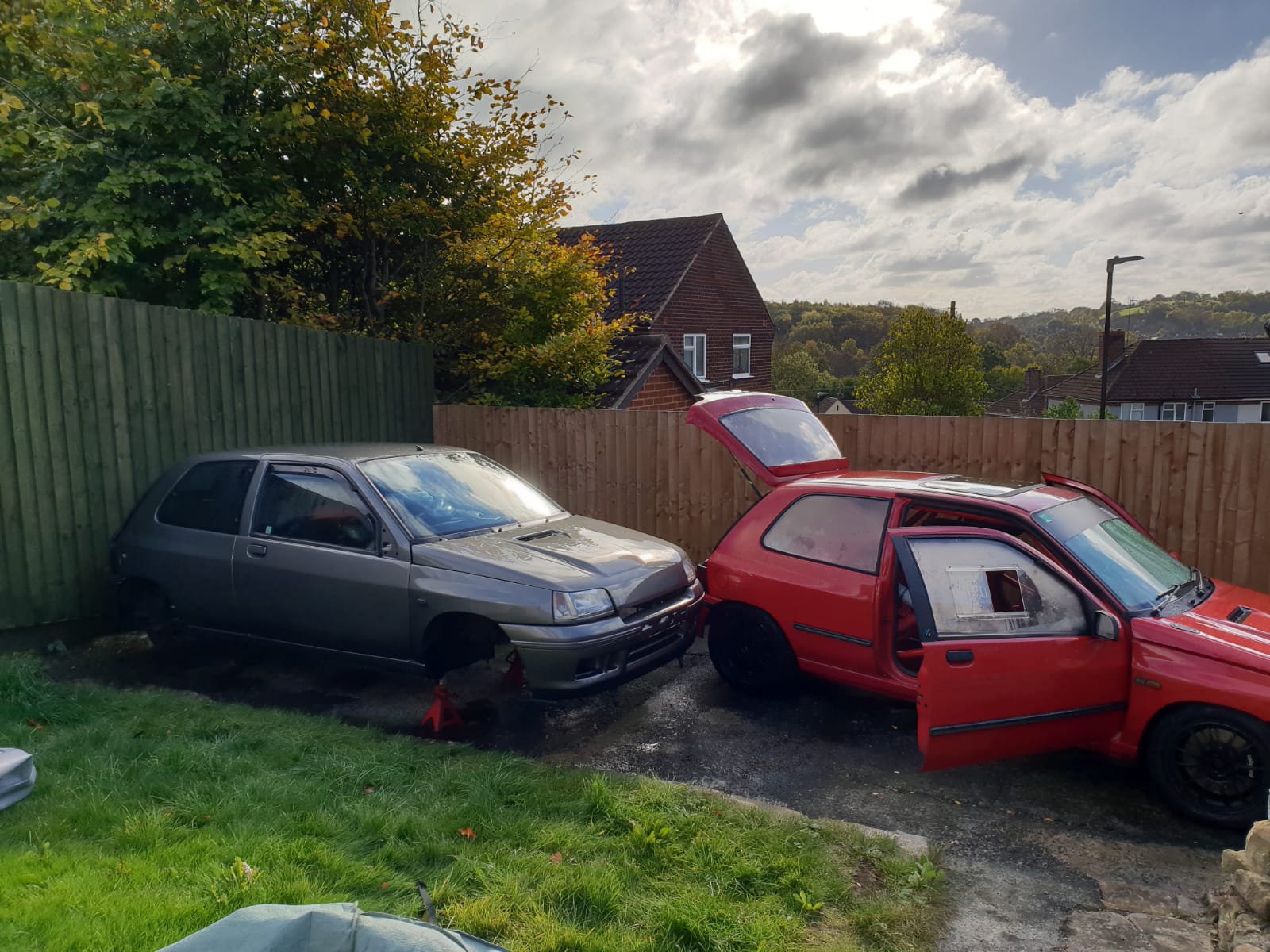

Is yours off road because off the rust? Have you got any pics?
Coops Mk1
  Lots of Scrap...

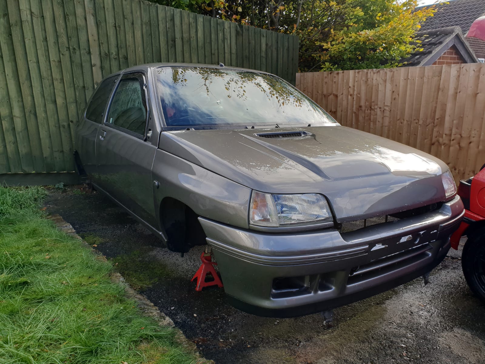

Yeah it's got front jacking point issues too and needs sills ideally. It was boosted but I got into trackdays and bought another one for that so grey one was decommissioned and has sat ever since
Looks like this at mo
