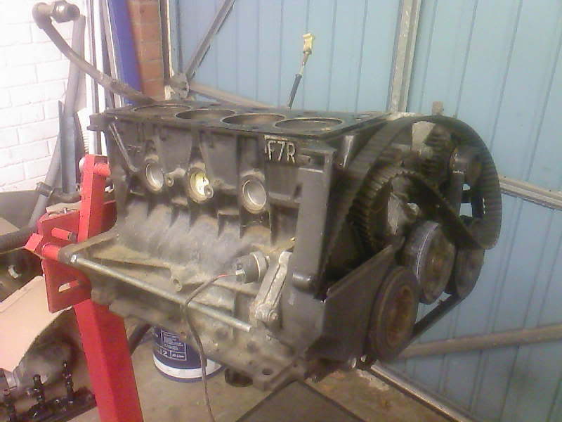

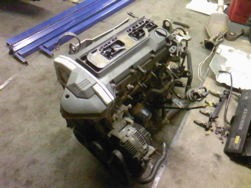

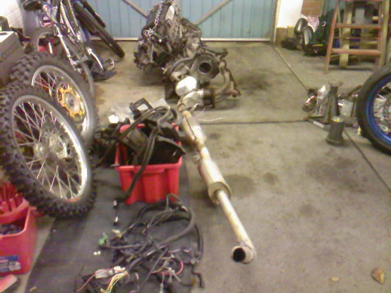

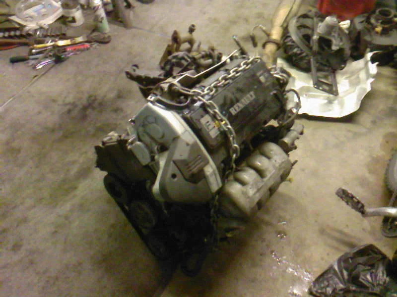

Went down to Portsmouth yesterday and picked myself up a Megane F7R with everything on it (Gearbox, loom, ecu, manifolds and a few other bits and bobs). This is going to be my toy to tinker with in the garage now over the winter. I won'y be putting it in until about spring unless my engine or gearbox blows up! (more than likely will).
Here's a couple of pics. Excuse the quality, I don't think I can stand still as my phones pics aren't usually this bad!
Plan to clean it all up, paint and polish some bits.
I also have some kent cams and piper verniers for a clio 16v head. Anyone know if they'll fit the megane head or will I need to use my 16v head?
For the gurus on here. I may be in contact with one or 2 of you at some point for some advice on which head, ecu, chip to fit etc.
Thanks Brad

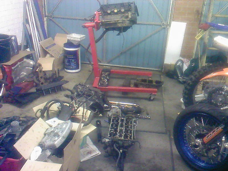

Few updates. Apologies for quality of pics and lighting again, mum and dad have gone away with the digital camera.
I've made a mess so far of my dads garage. Which I said I wouldn't, whoopsie.

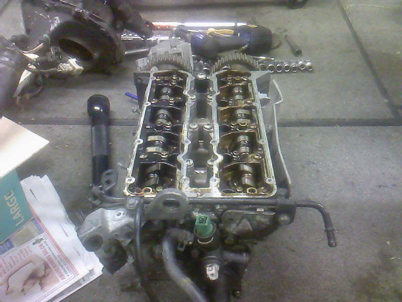

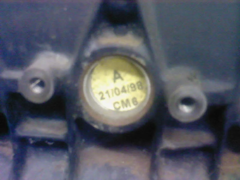

Megane head. Will be selling this and fitting a 16v head.

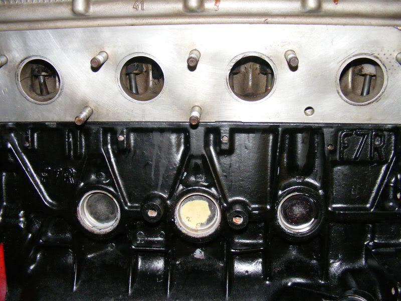

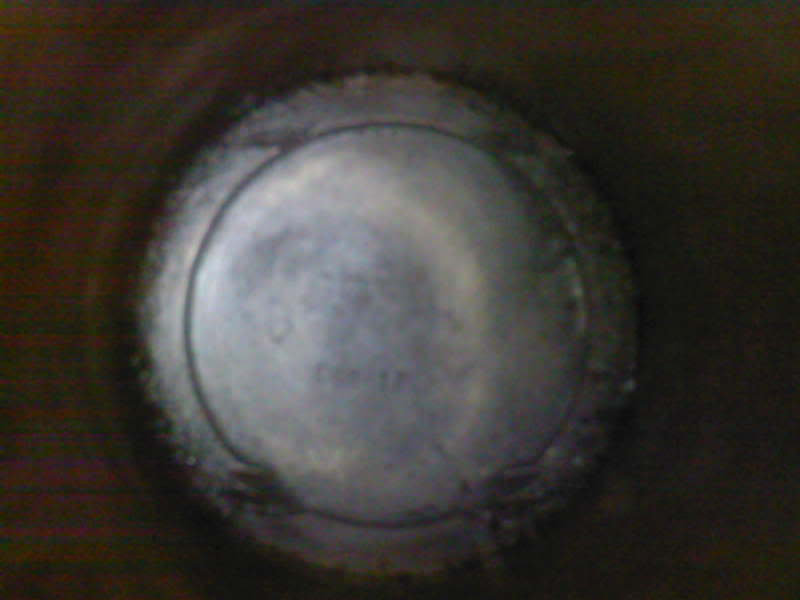

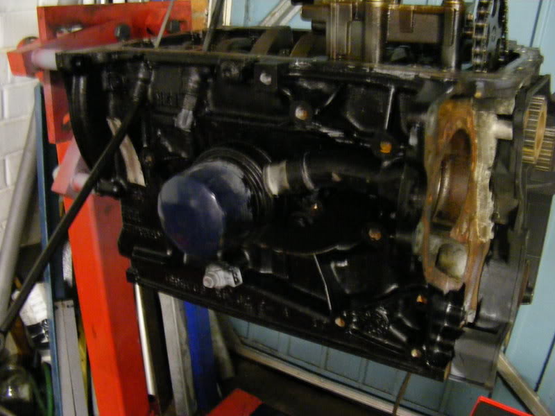

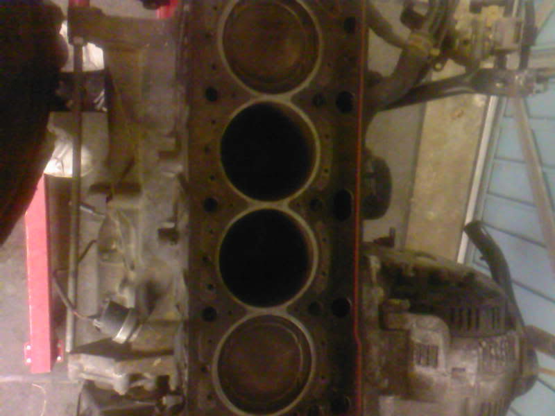

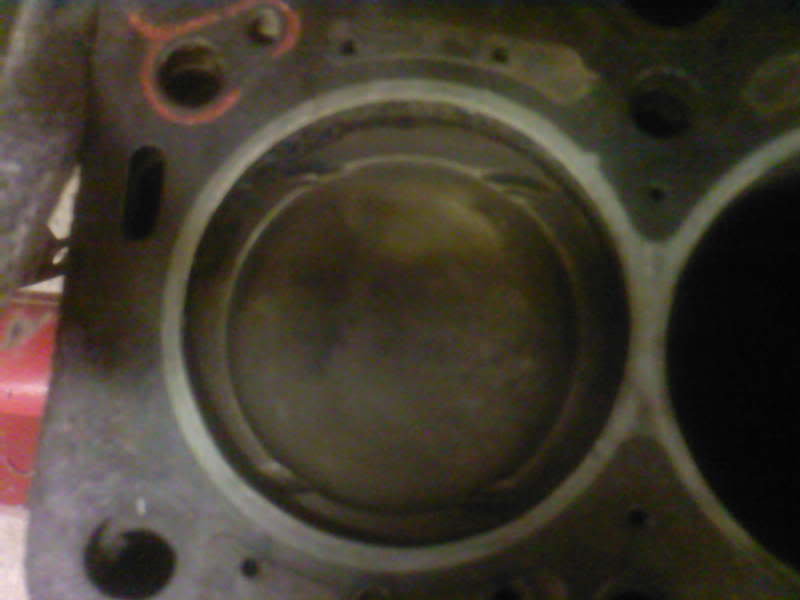

Was quite worried when I saw these scores, look quite deep! Someone obviously didn't set the timing up right :p Should be okay though...

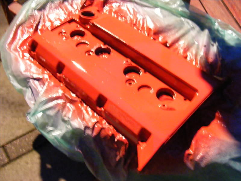

Quick update for anyone that might be interested. Not much so far I'm afraid due to fundage. But got some bits painted up:

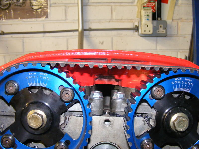

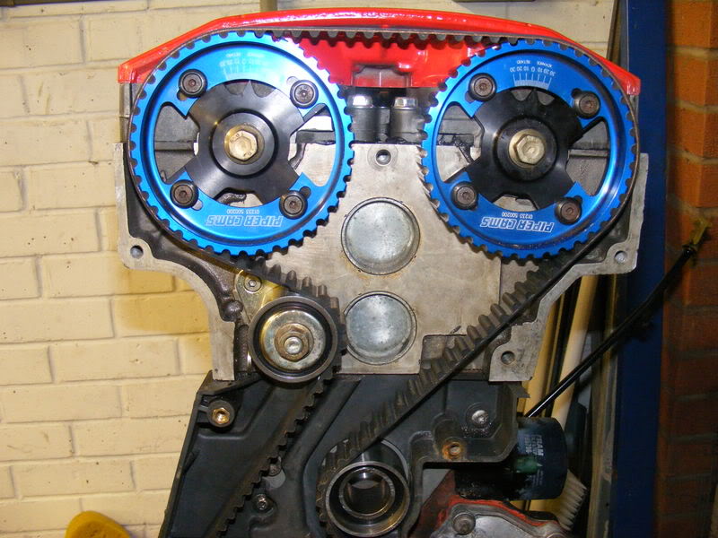

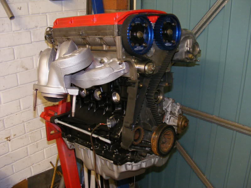

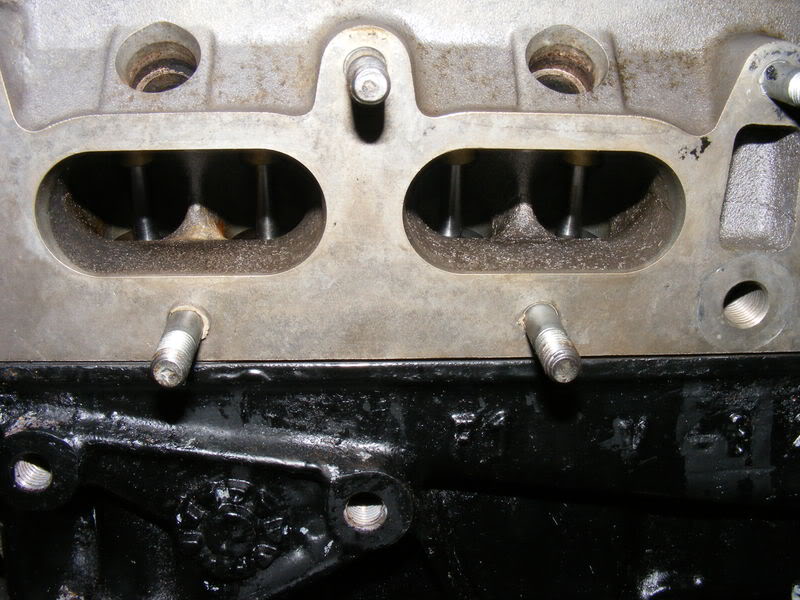

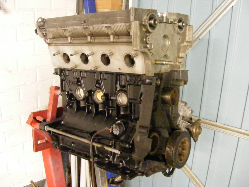

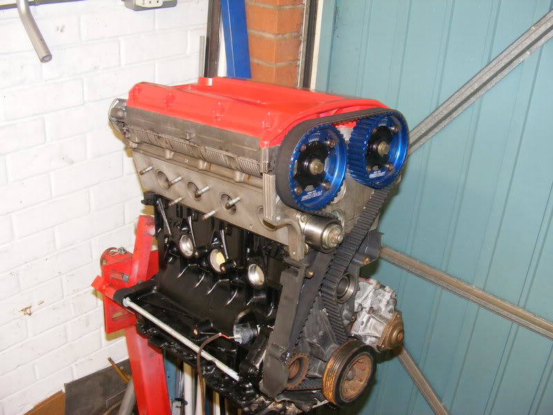

Cleaned the head and ports up a lot, got it skimmed, removed the valves, cleaned them and relapped them.
Head is now assembled with kent cams, piper pulleys, new headgasket, new valve stem oil seals and headbolts and fitted onto the bottom end.
Put a brand new cambelt kit (belt, idler and tensioner) on and timed it up. Getting there :D

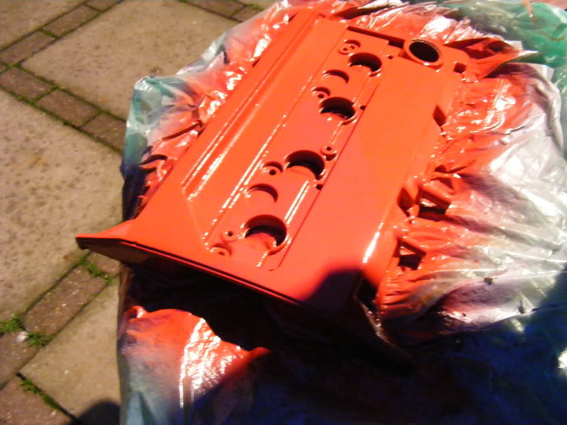

Was hoping the red cam cover will sort of blend in with my red seats and red calipers. We will see when it's in. Not sure what to do with the plastics yet, but that's a while off.

Little bumpage.
Looking very nice that mate. Keep up the good work.

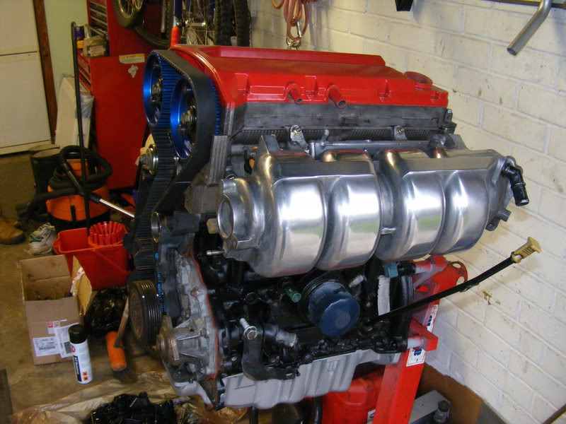

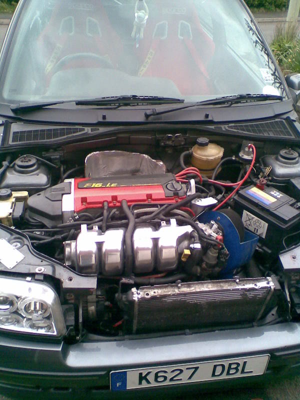

Here is a few pics how it sits now:

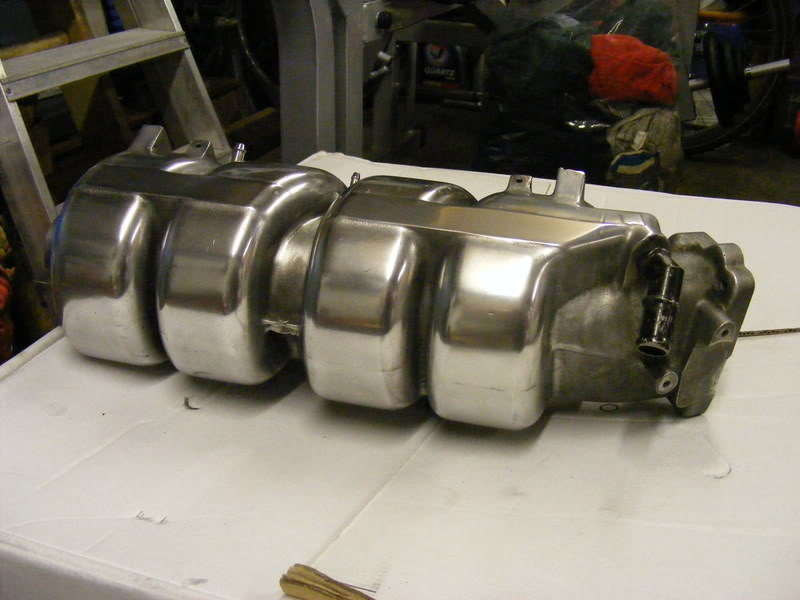

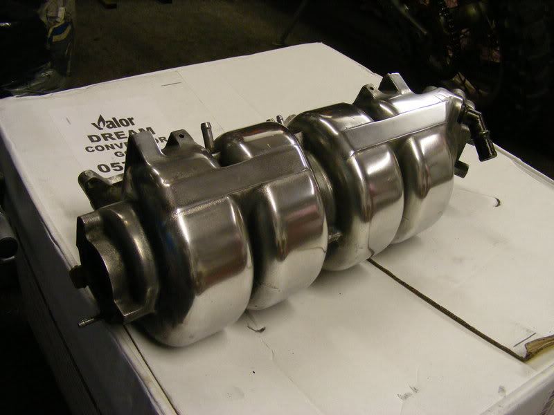

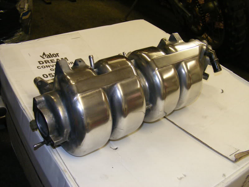

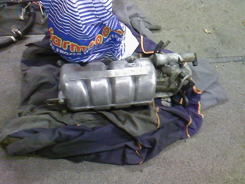

My inlet which I've spent over 4 hours polishing. It's far from perfect, and I've only polished what can be seen. But it looks okay:
And how it looks on the engine:

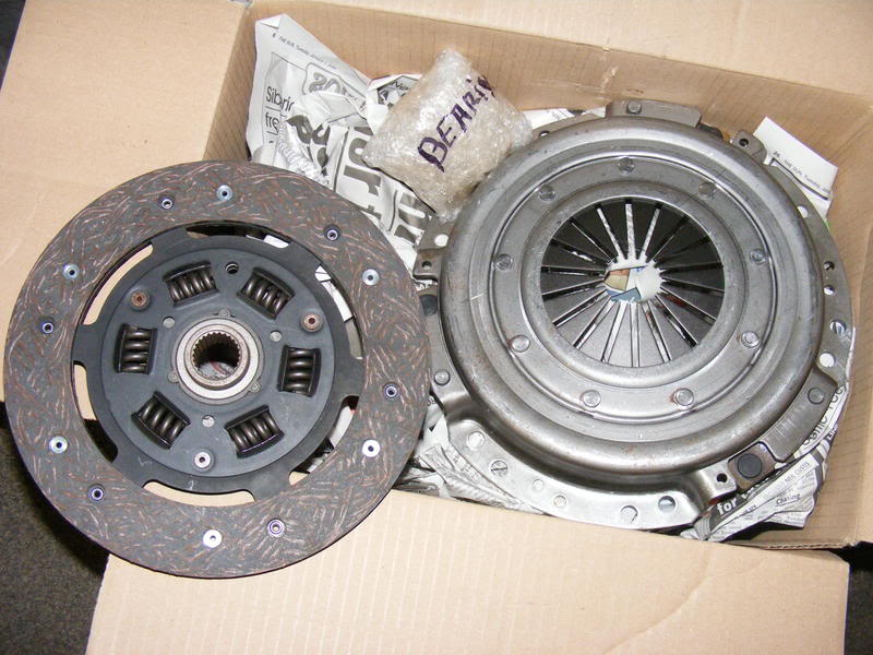

And my nice new GTT uprated clutch:
Sorry about the pics size! Cba to crop them.
Hopefully she'll be about ready to go in in a few weeks :)

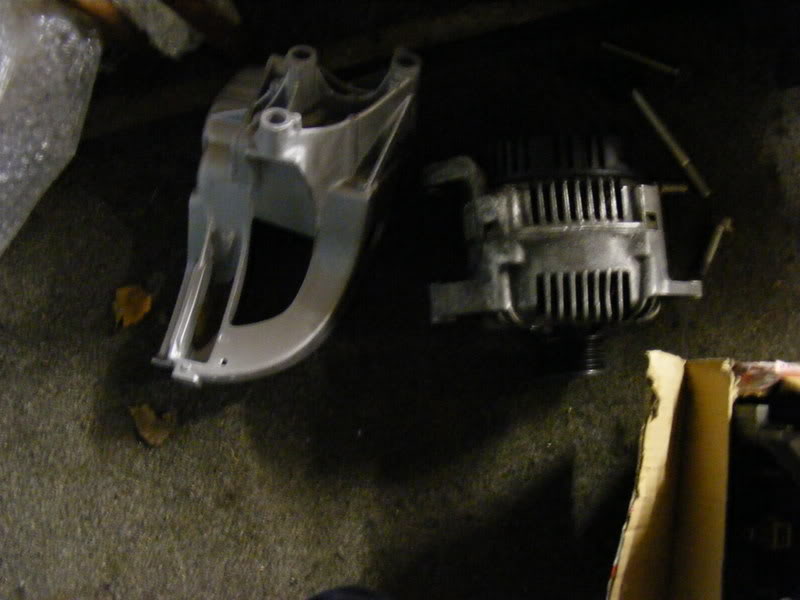

P.S Some bits e.g. Crank pulley etc will be cleaned up and sprayed before they go on properly. Just incase anyone pics some faults :p

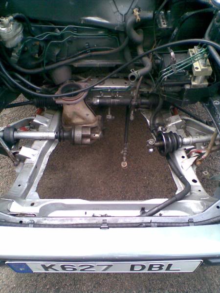

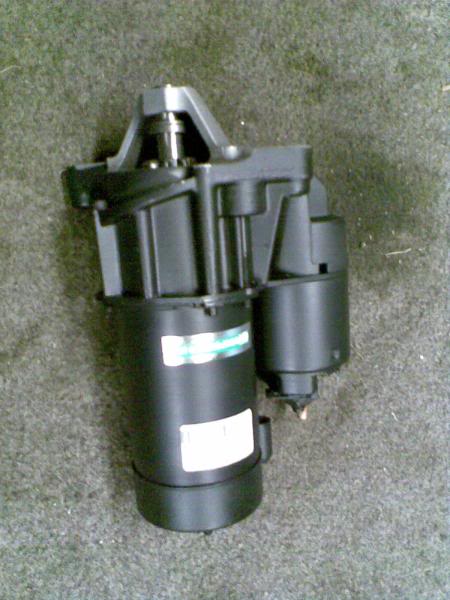

Well... Was hoping to get it done this weekend but it didn't hapen due to a few hold ups :( Found out earlier today the starter motor was damaged and not really useable, and my valver one was too fat! But eventually I managed to source a refurbed one from a motor factors. Looks brand new! :D
Gave the subframe and bay a quick pressure wash as it was a reet mess. Must get some arch liners soon :p Came up okay.
Anywas I finnaly got it in place and a few things buttoned up before calling it a day just before 6, so I could spend half hour or so with Rachel before she went home, as I've been working on it all weekend. Should have it all linked up and *touches wood* running in the next couple of days :D

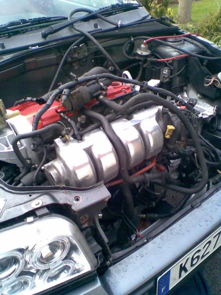

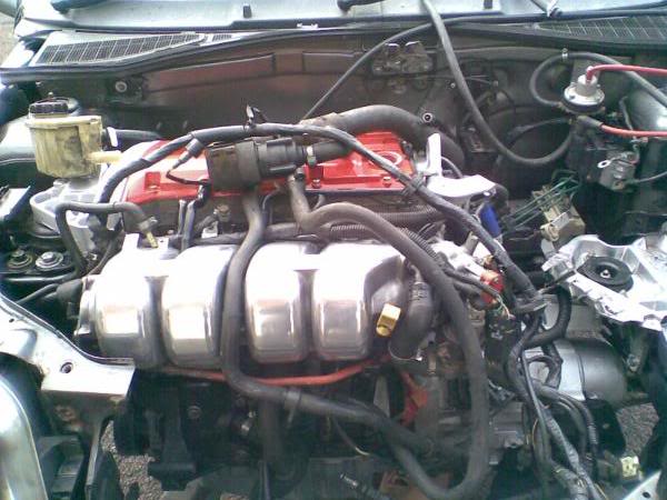

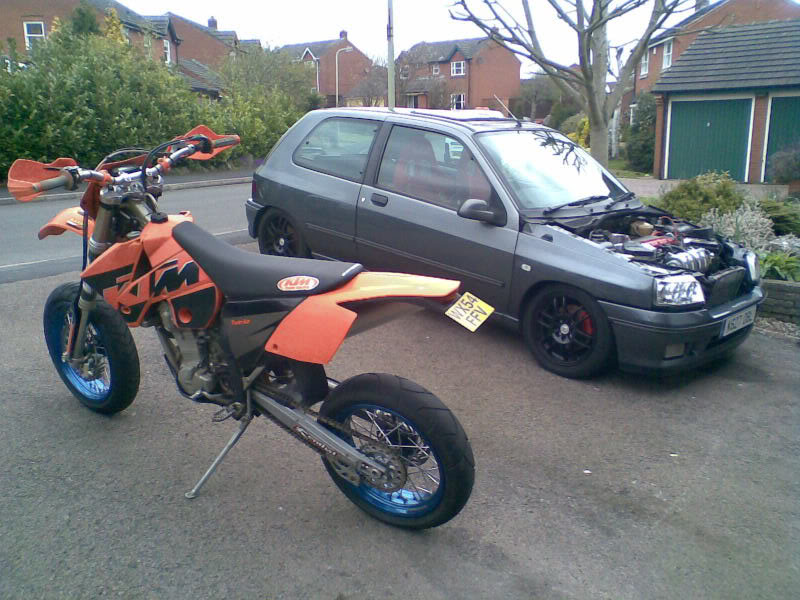

All up and working :). Still want to tidy the bay up a bit. FIrst off is a new Induction kit as this one njust doesn't blend in! And repaint my strut brace and put that back in, and new plastics! Maybe new hearder tank! And new fuel hosing!
2 Beasts!
And she is running a dream! :D
