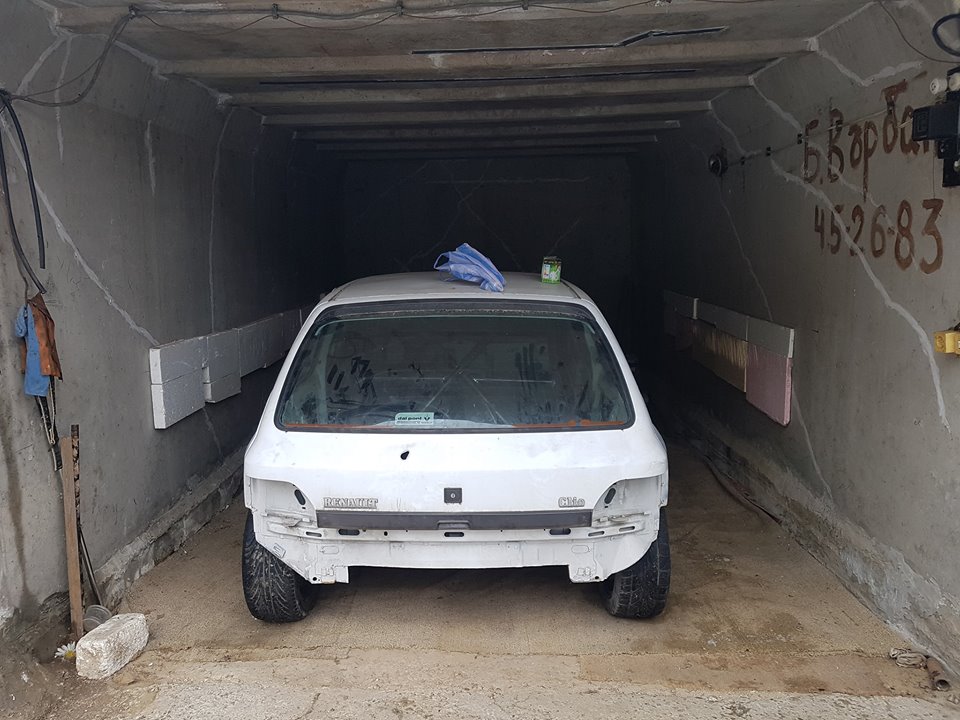

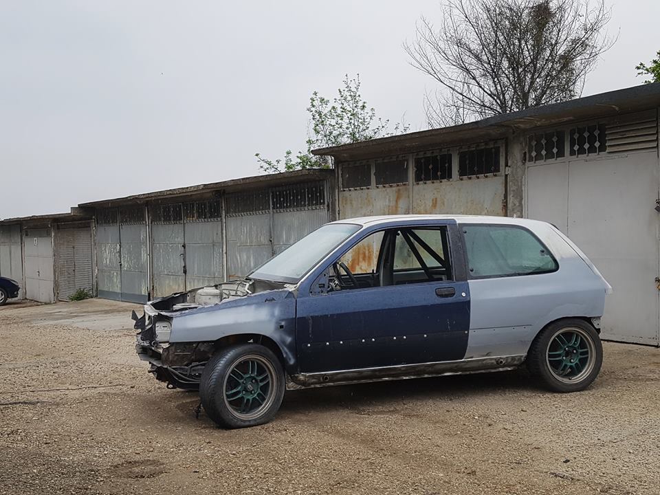

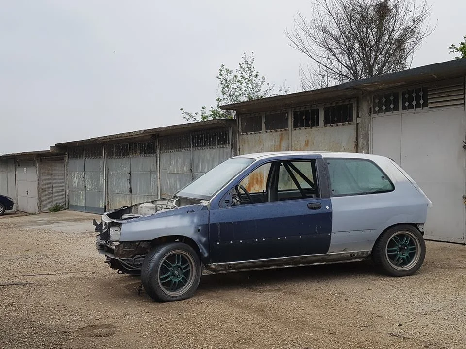

well it looks like a bit like a off road machine, but i think its because its really lightweight now.

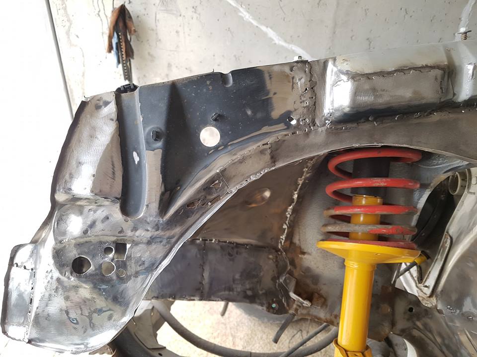

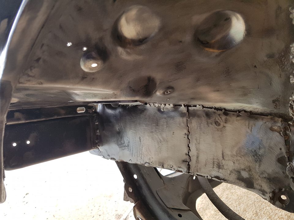

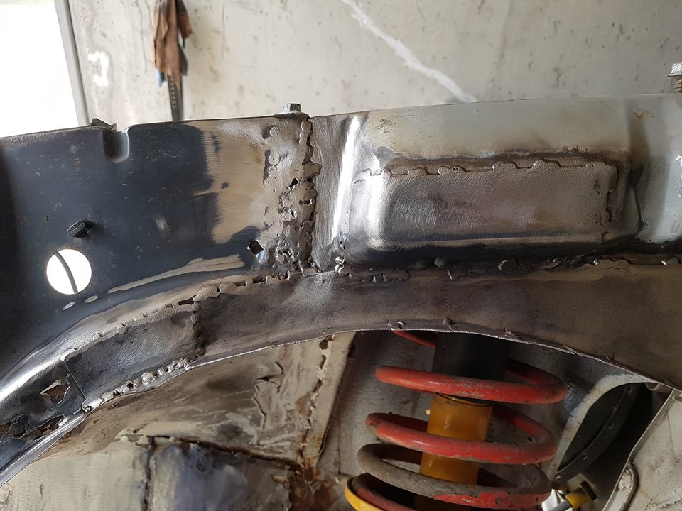

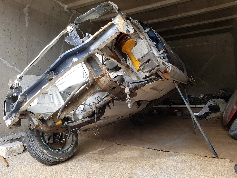

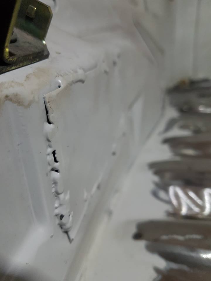

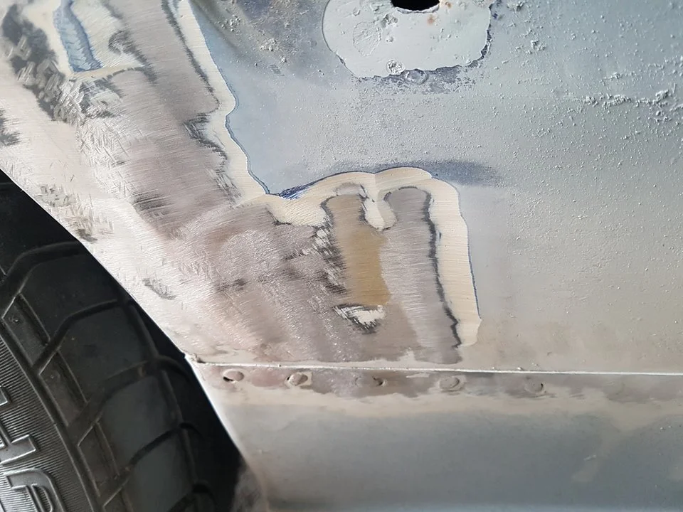

Quick jack points look good. Any pics of how they are tied into the inner cill ? I fancy doing this to my extra van, was thinking about tieing the fronts into the cage i have planned
sorry, do not have pics, they are just welded to the inside, and some extra tube welded so they can manage the weight of the car, looks like something like the letter A, but one side is 90deg to the sill

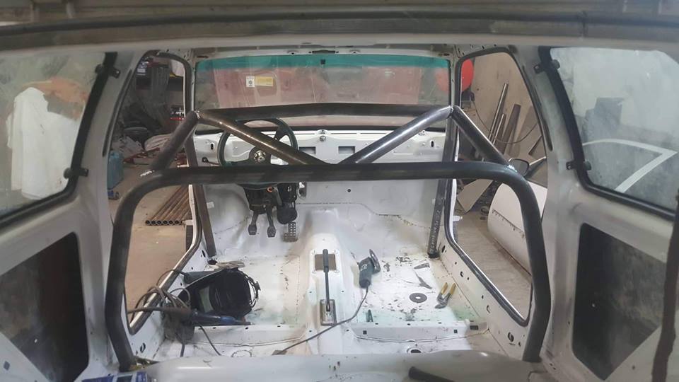

Well, everything is ready and waiting for: roll cage, fuel cell tank, fuel pump, seat and harness.

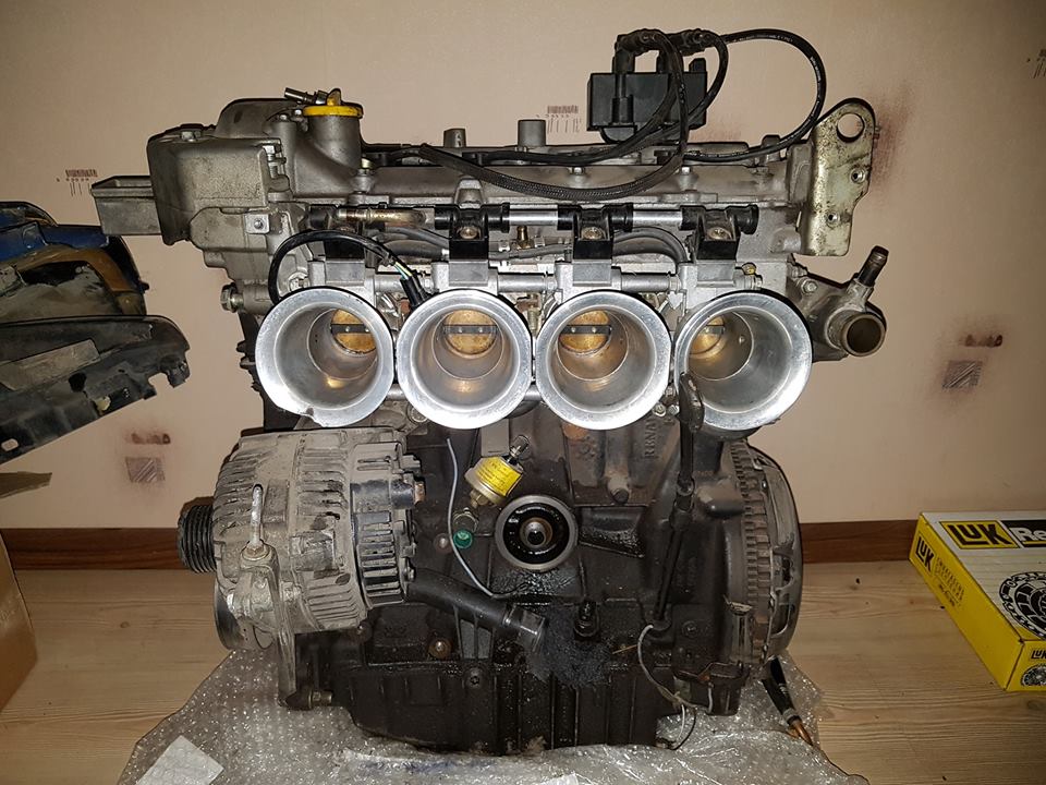

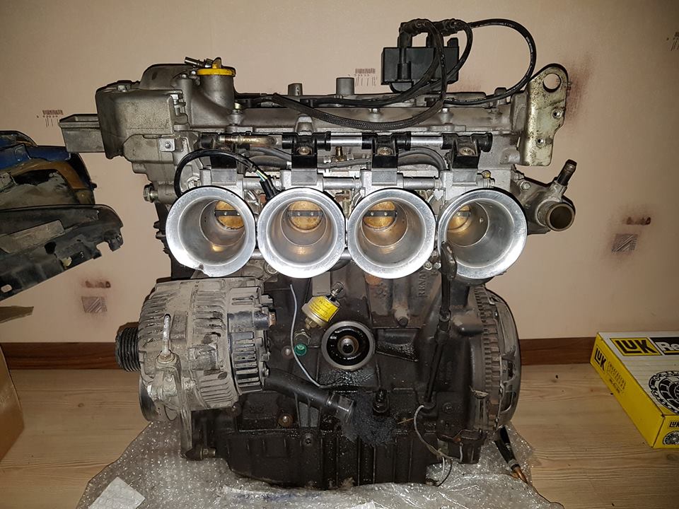

engine needs some little changes

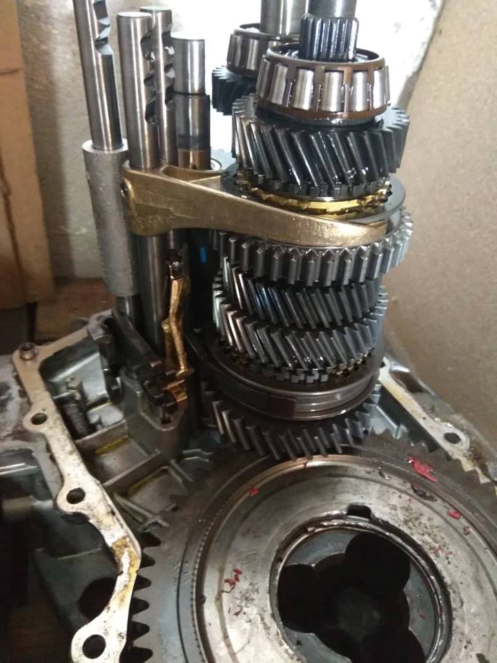

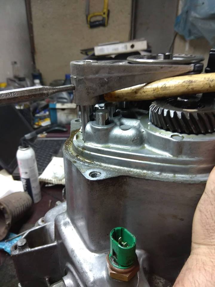

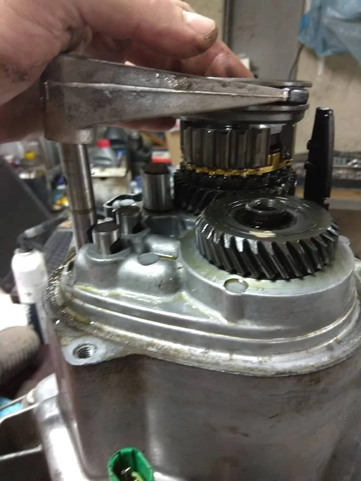

gearbox will be fully disassembled and some major changes to be done.
next update will be in the autumn probably

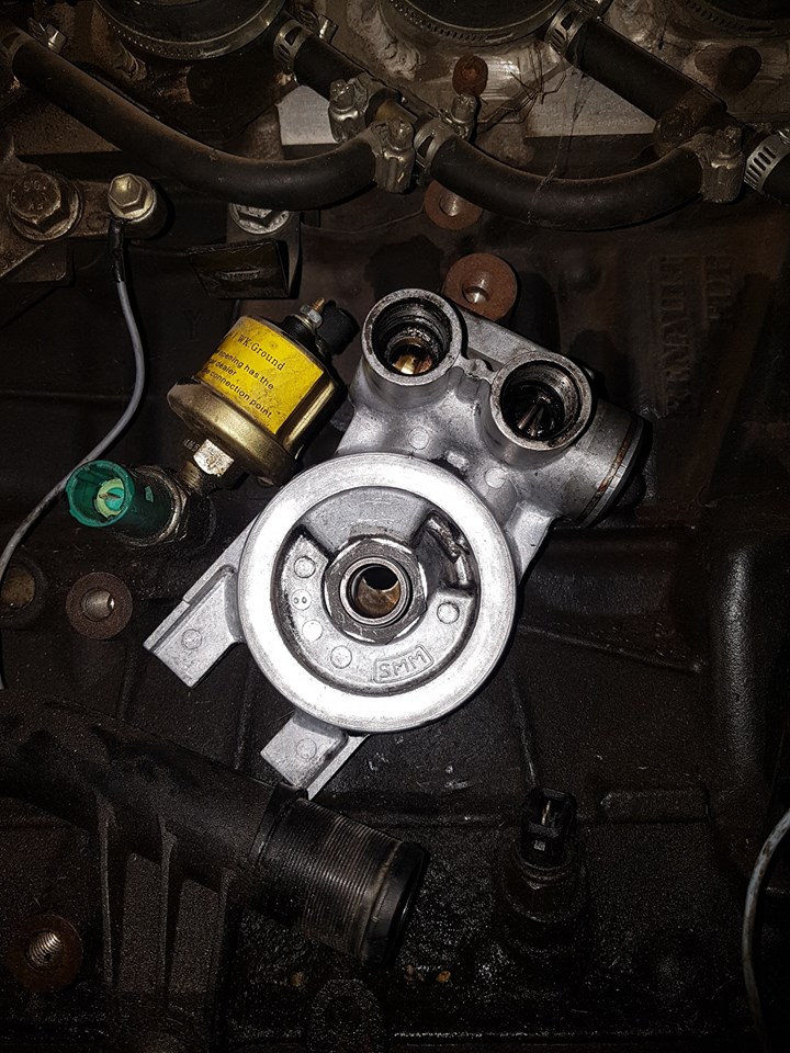

then i bought sandwish plate with 95gr thermostat off the scrapyard.

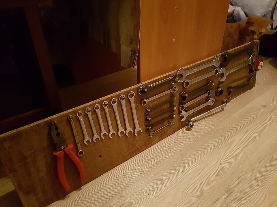

and thats what i found in the basement and made a shelf for it.

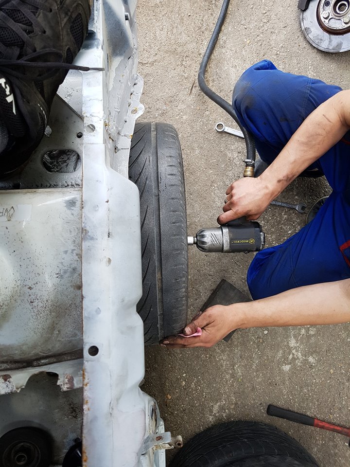

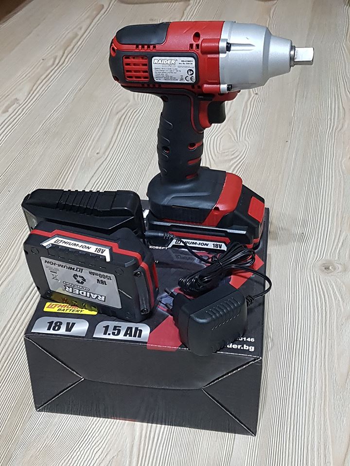

so... my gift for christmas from my girlfriend was... cordless impactdriver 1/2 320nm and spare battery lol

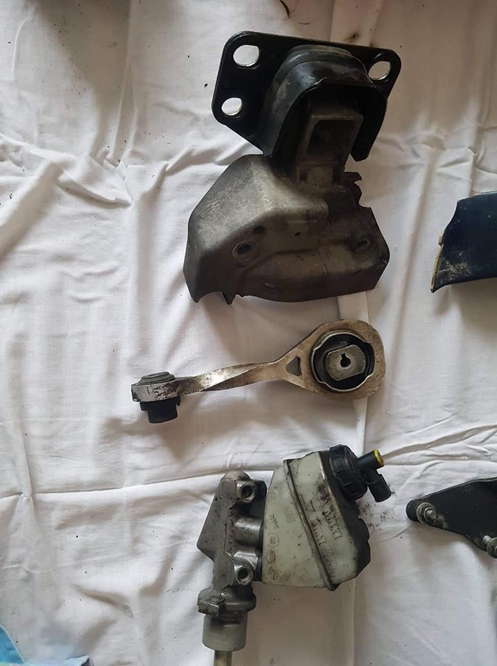

engine mounts and brake pump form Clio sport - which are very rare in my country at the moment...

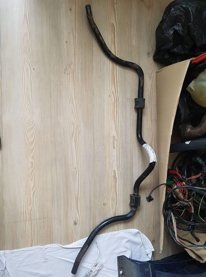

arb form Clio Sport again...

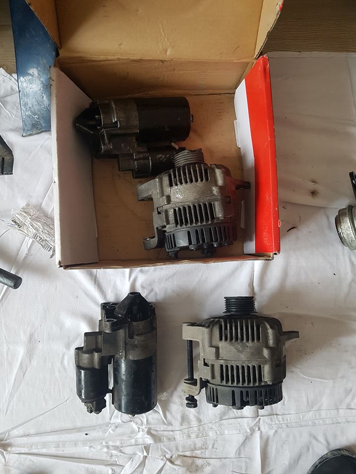

working starter and alternator, because the old ones are smashed from the crash (will stay for parts)

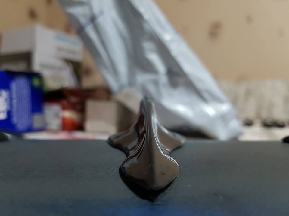

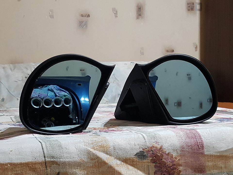

short sidemirrors I dont know how you call them... I call them "waterdrops style"

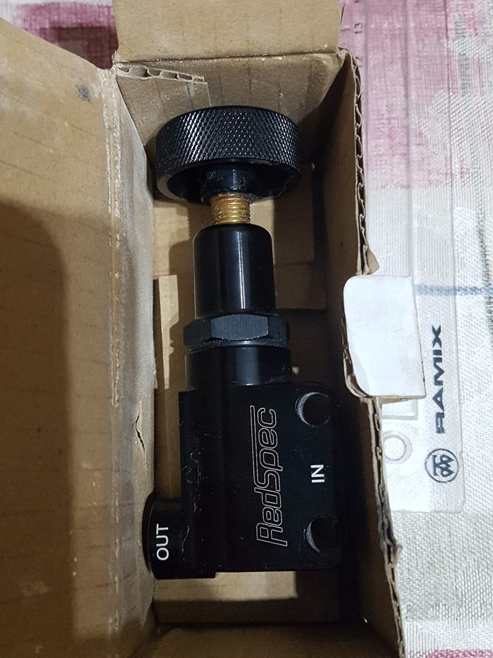

rear brake proportion device

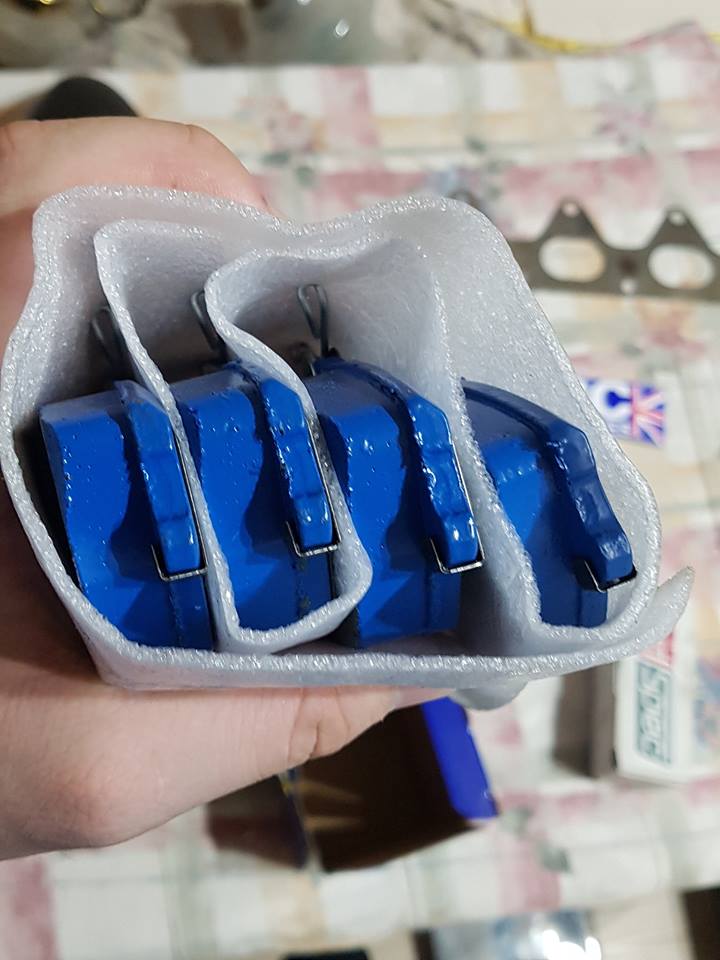

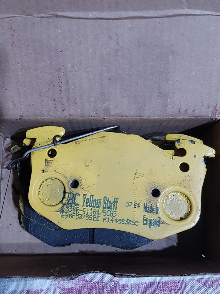

new line EBC BlueStuff front pads

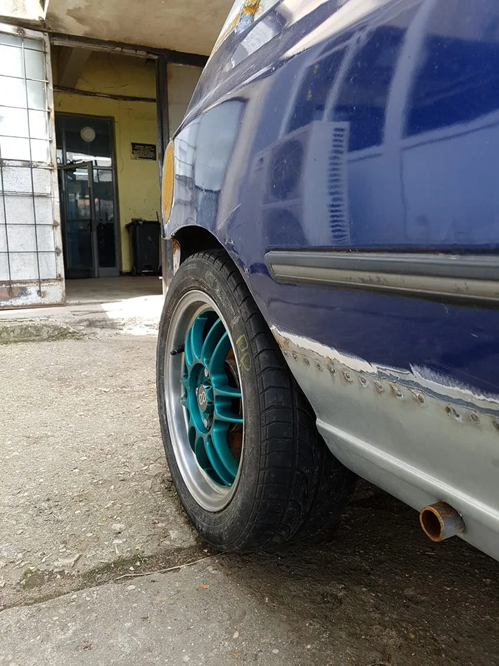

Well... some of the work done last month... in pics

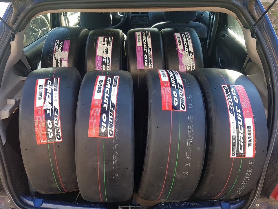

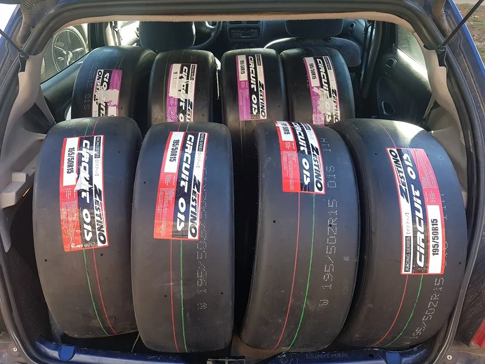

got new full slicks

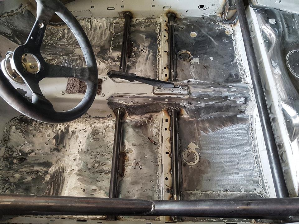

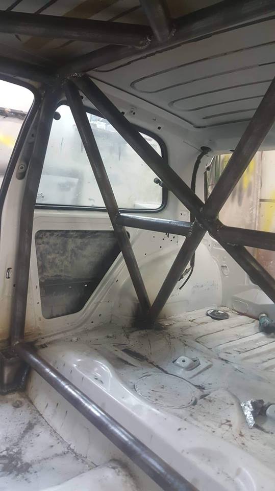

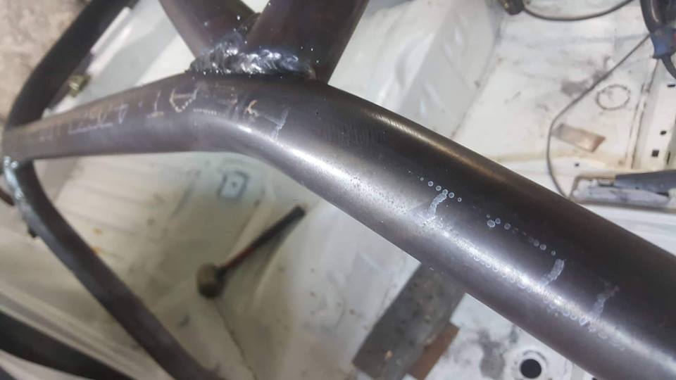

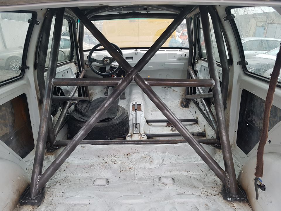

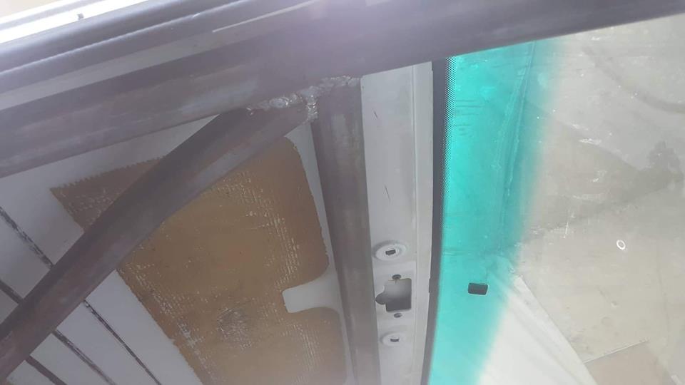

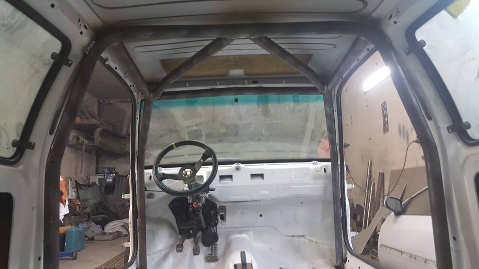

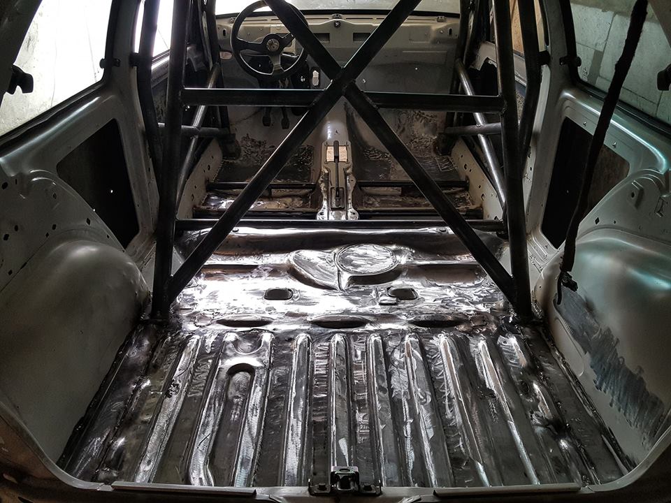

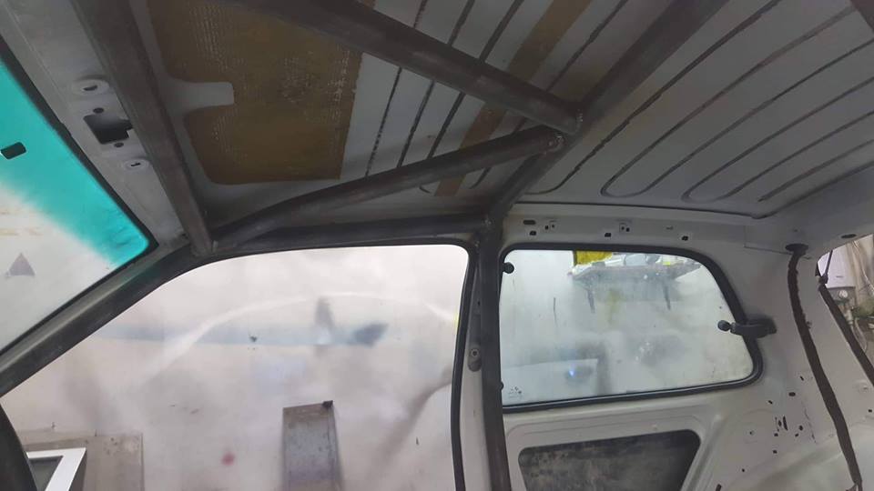

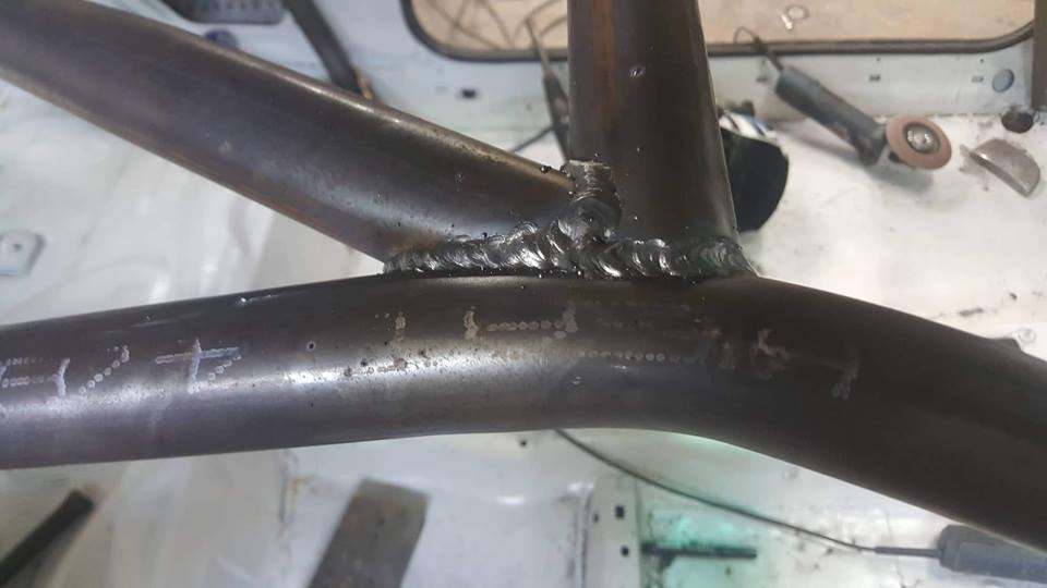

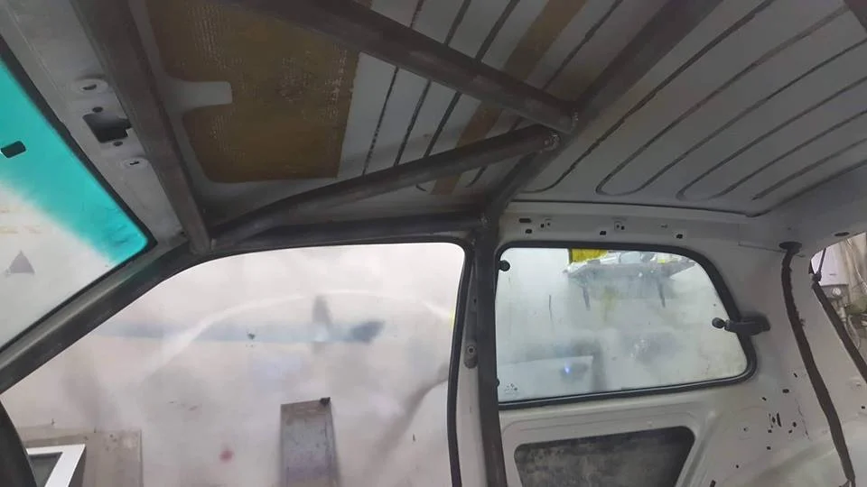

got full cage welded under FIA regulations

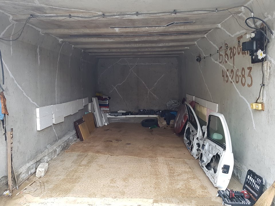

finally got new garage where to work... not under the rain...

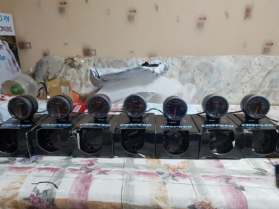

and new gauges for dashboard...

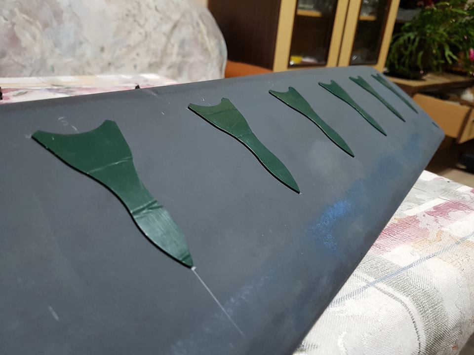

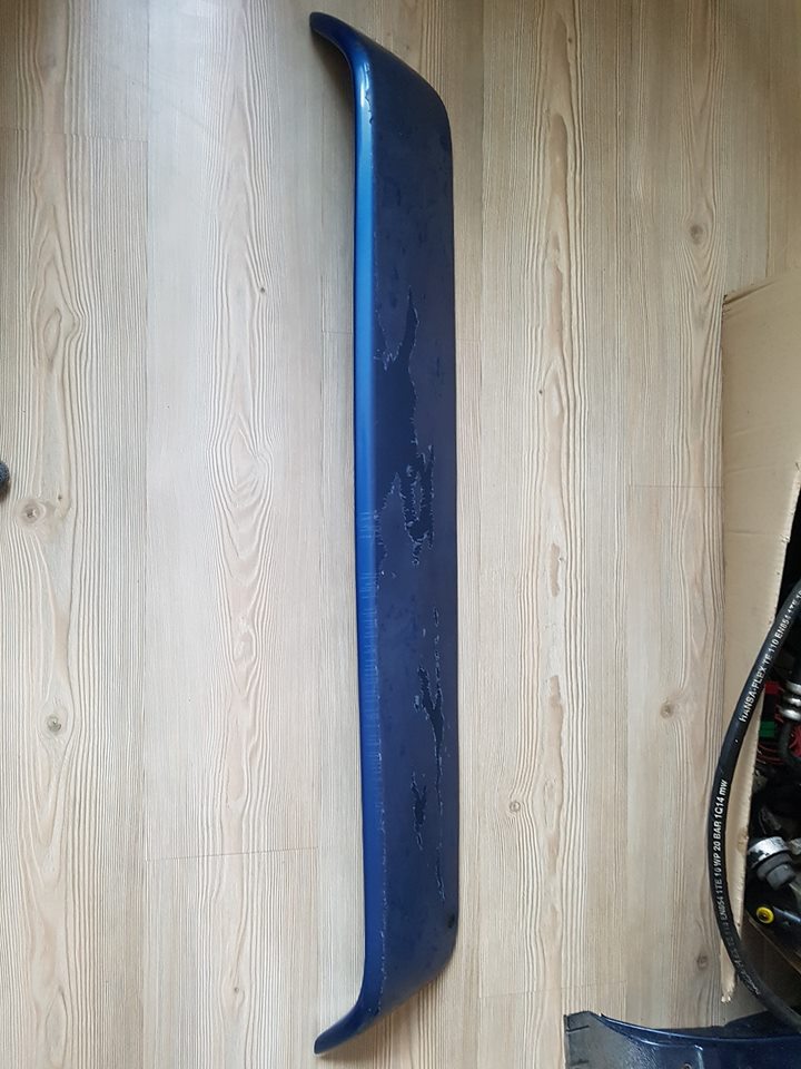

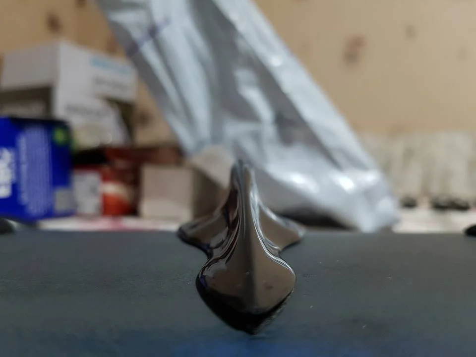

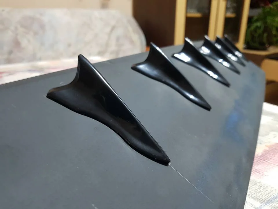

and new original wide rear spoiler + some vortexgeneratiors lol
and...

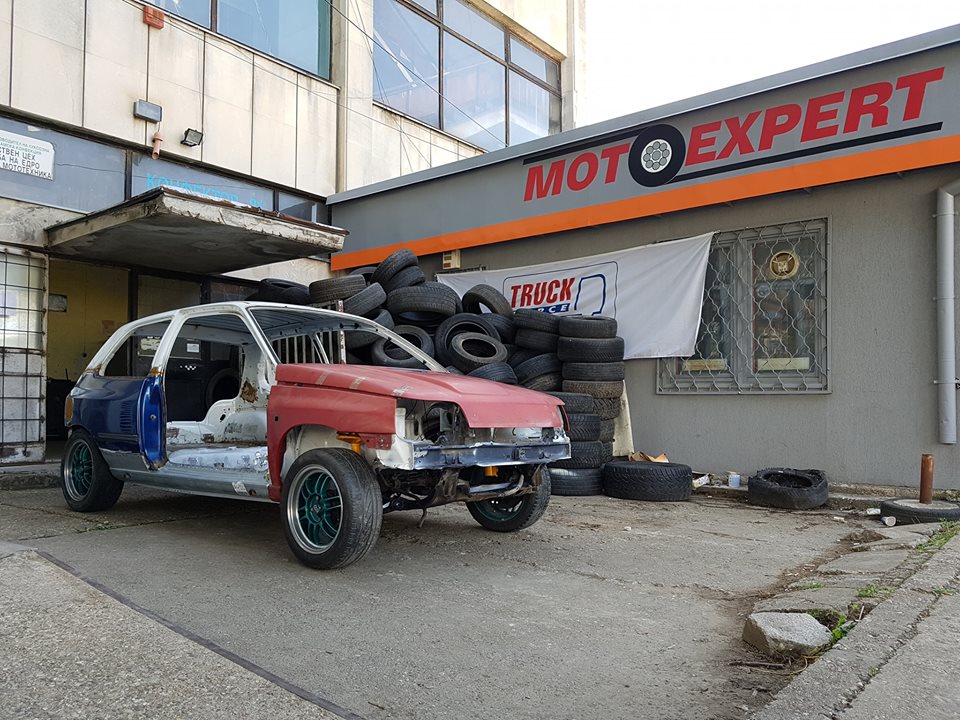

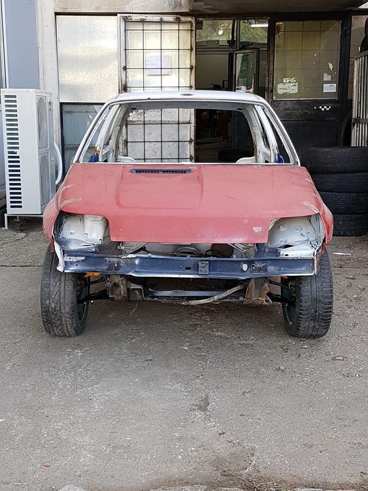

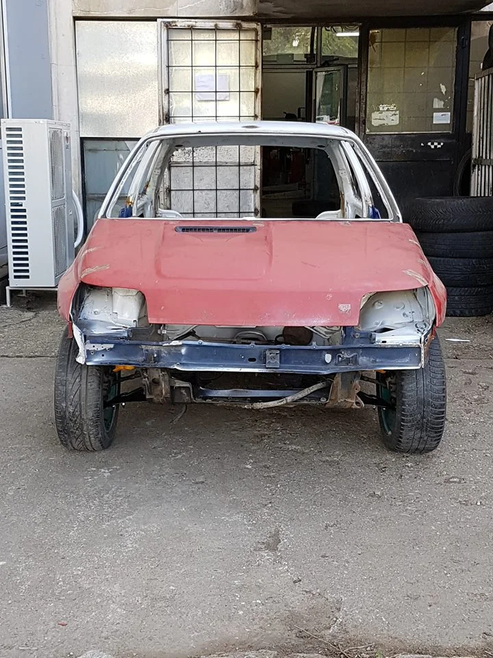

a little update... been busy at work, and didnt had any time to work on the car or log in here lol

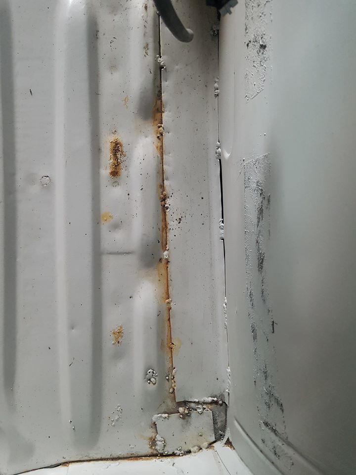

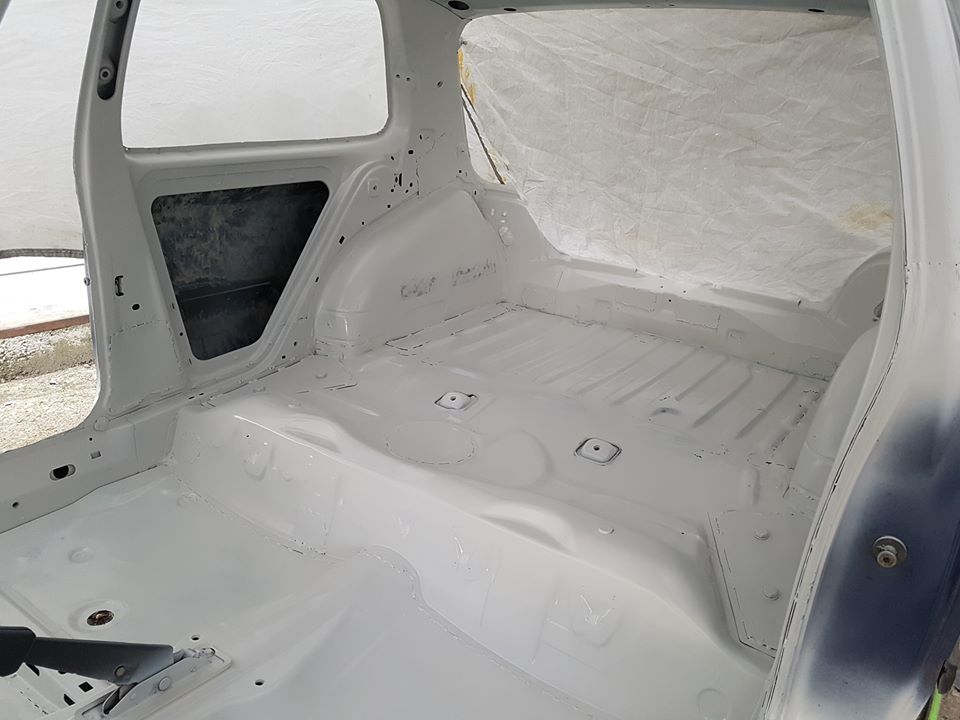

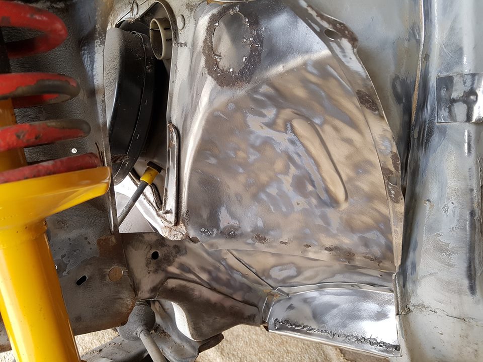

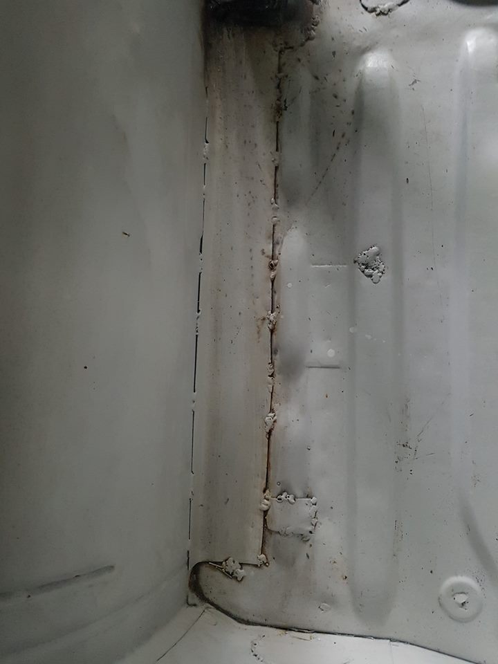

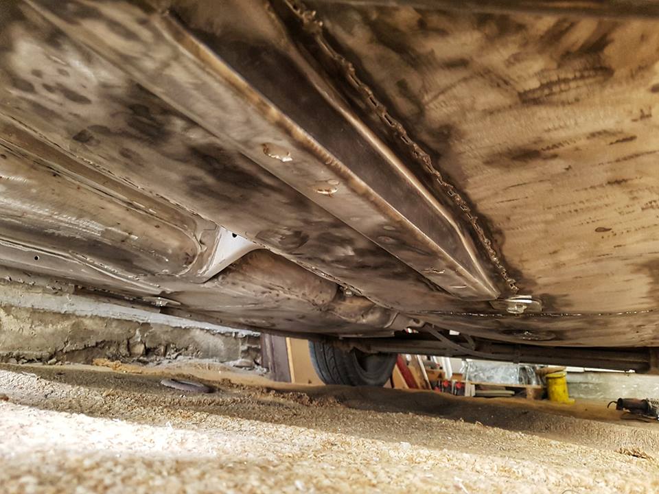

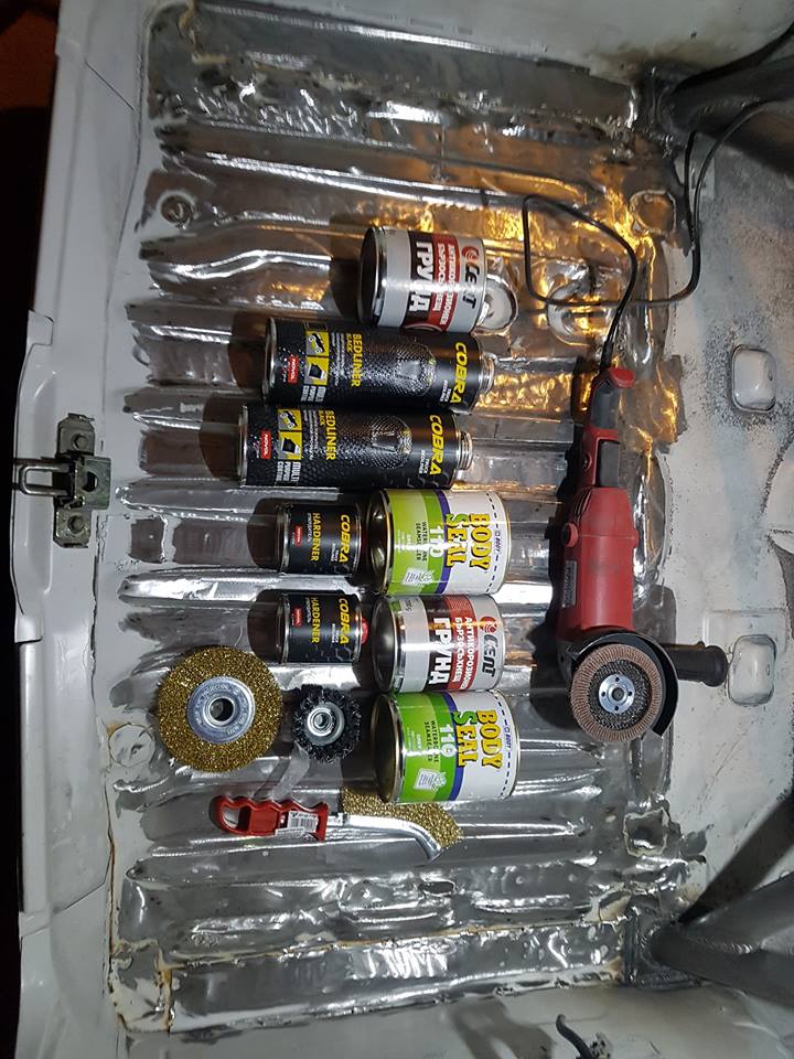

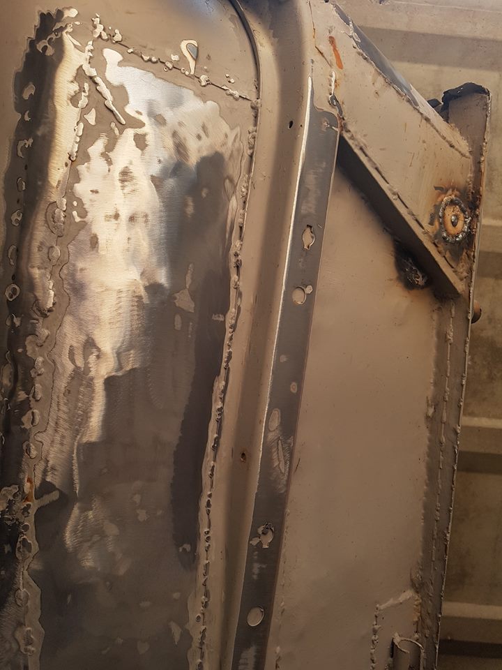

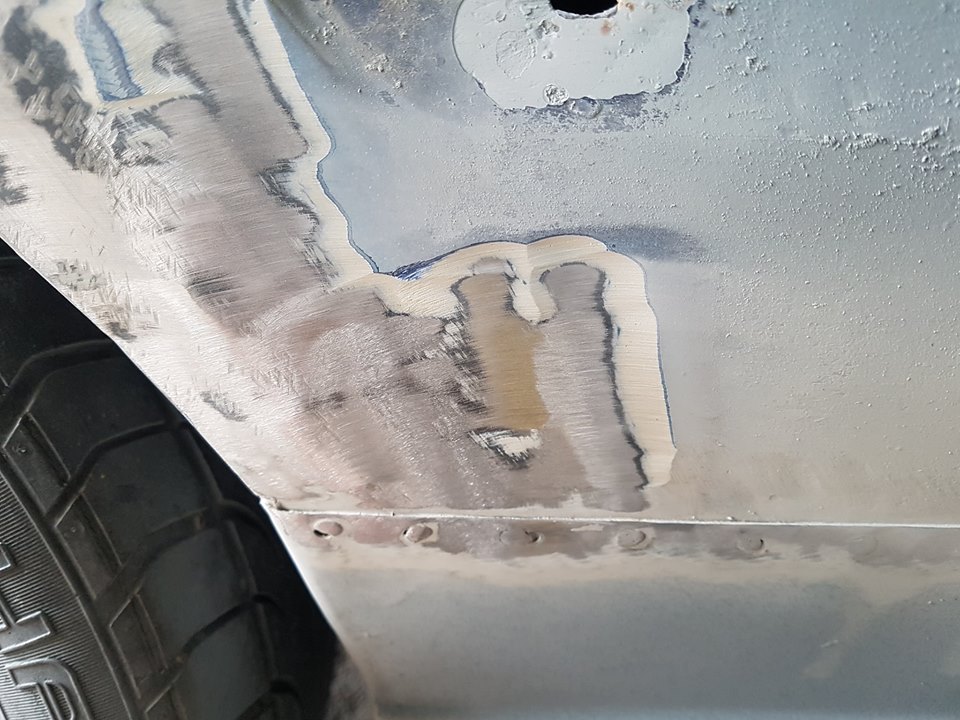

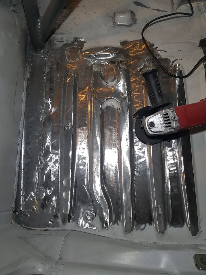

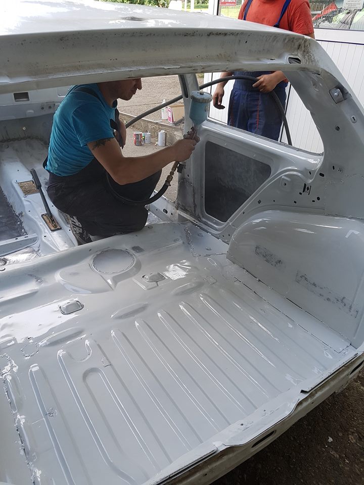

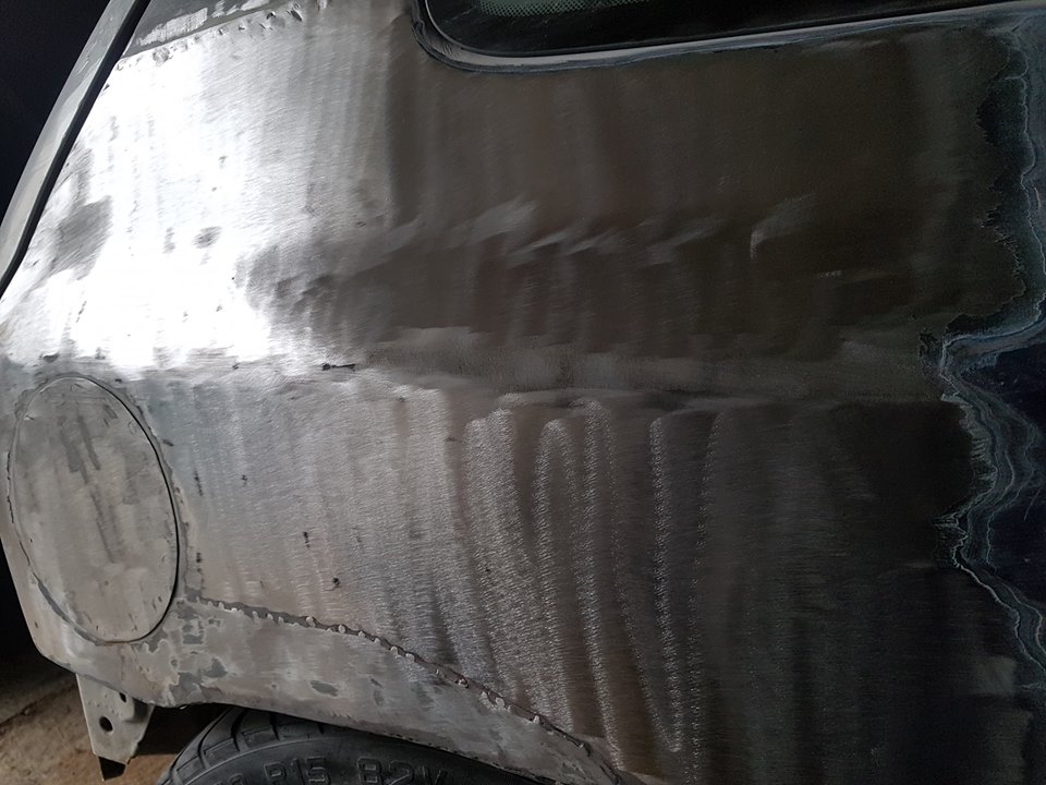

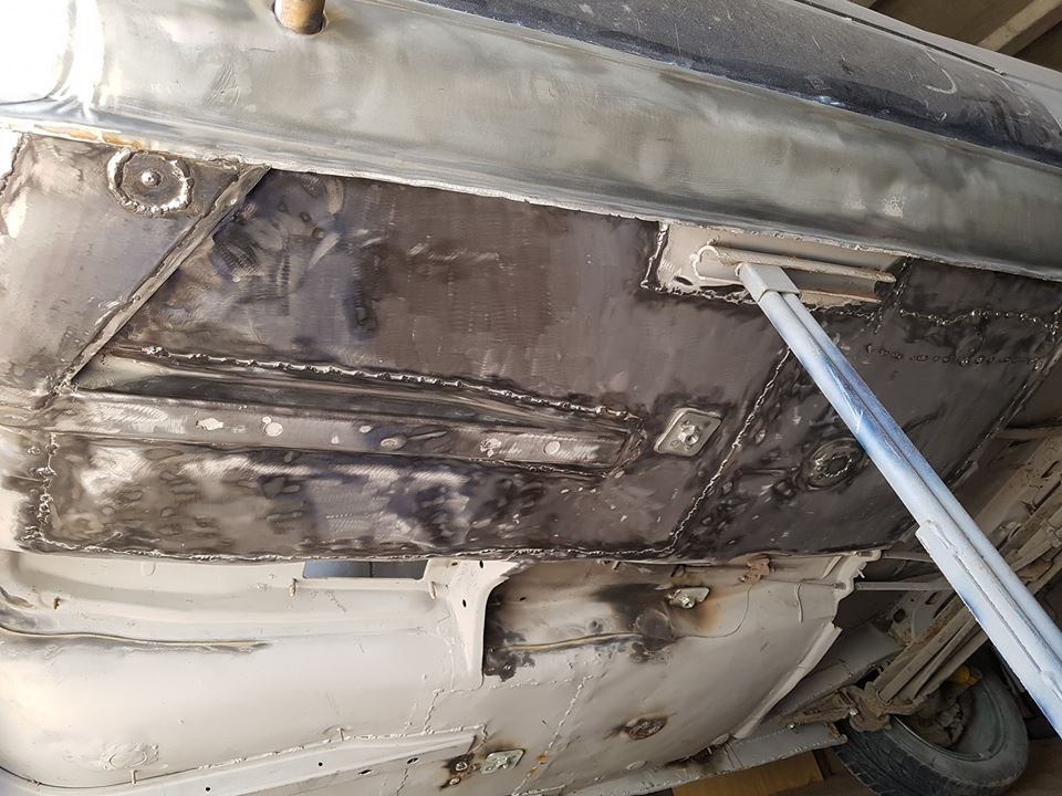

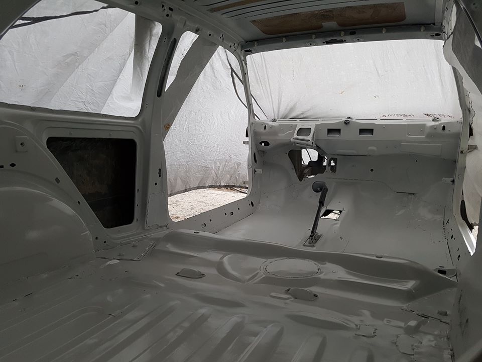

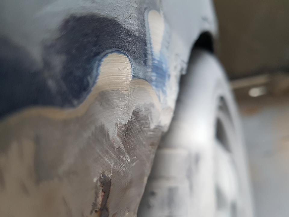

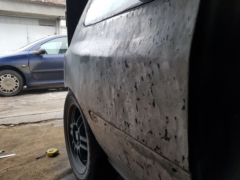

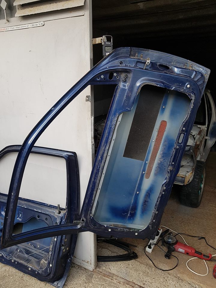

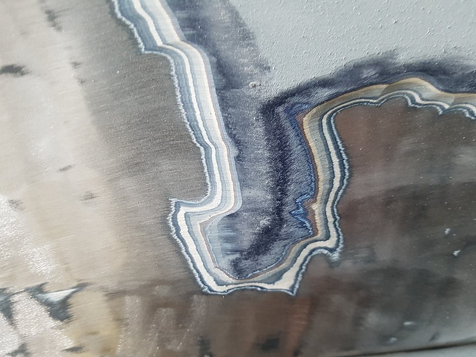

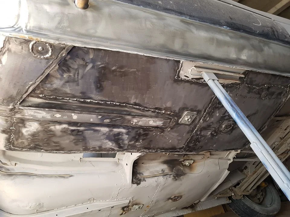

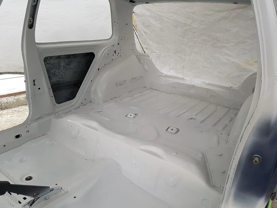

the body started getting rusty again and decided to go to bare metal again... with the angle grinder and sand blasting lol and do it like NEW
also to do some lightweightening

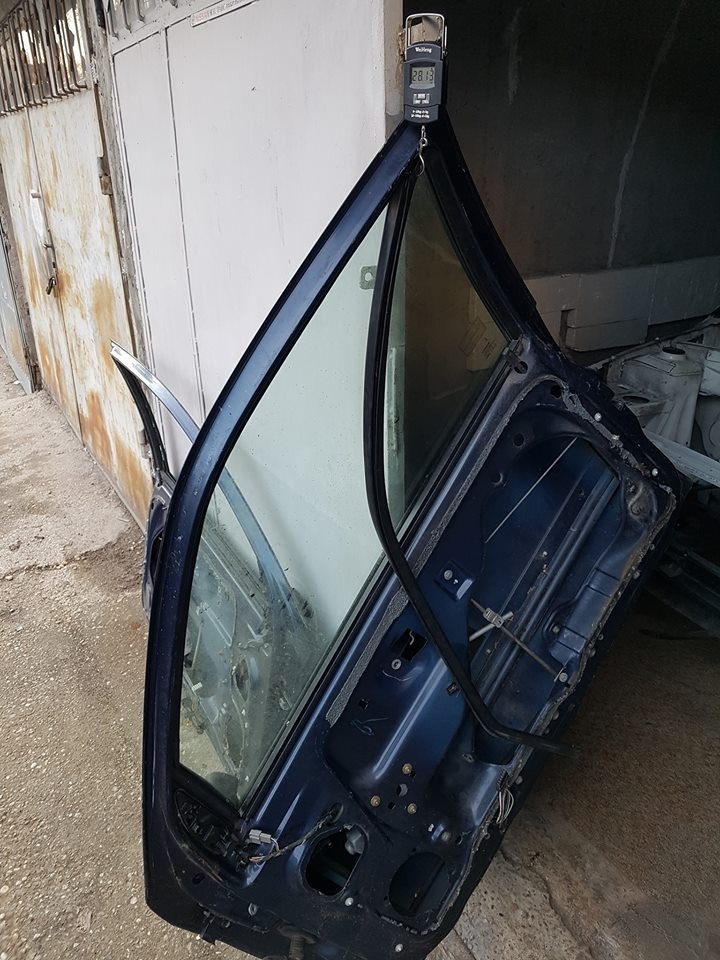

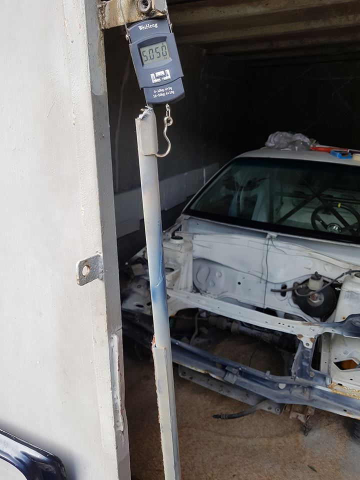

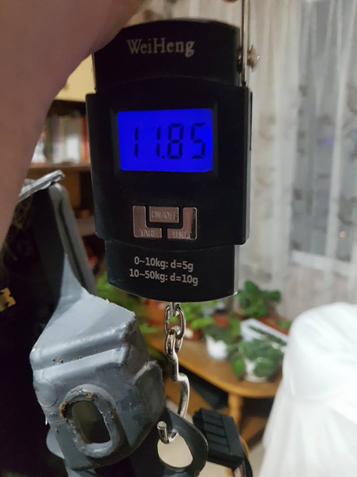

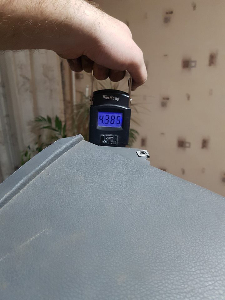

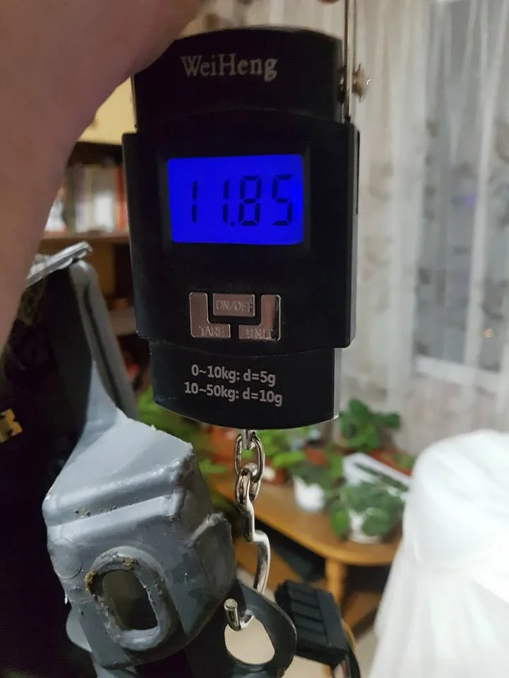

So far done:
seats - 25kg
door cards and plastics - 5kg
carpet - 15kg

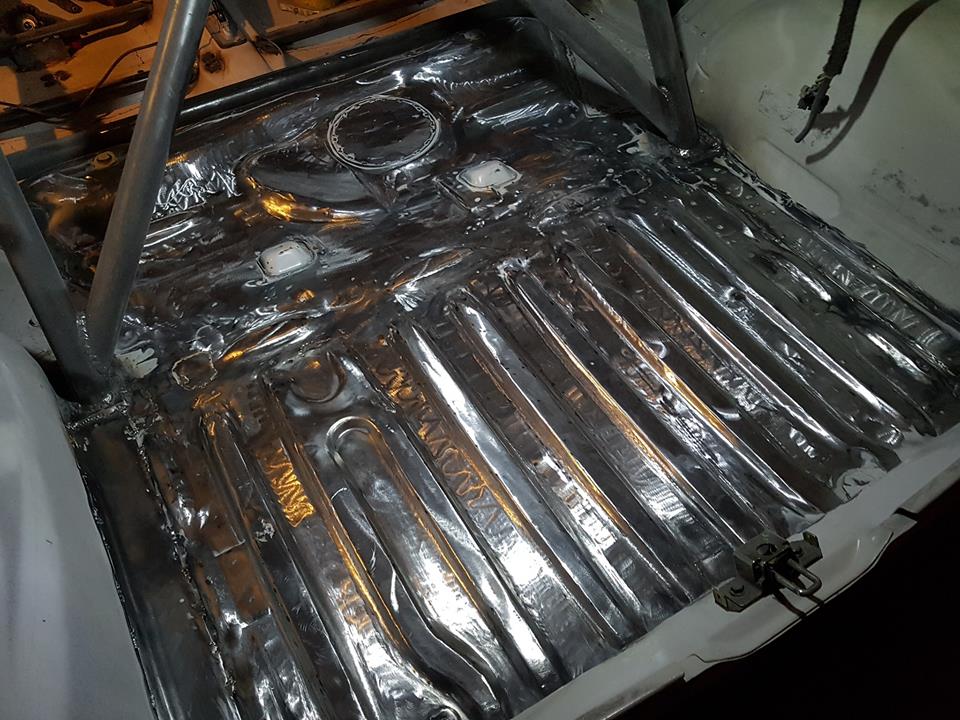

sound deadning - 20kg
underbody coat - 20kg

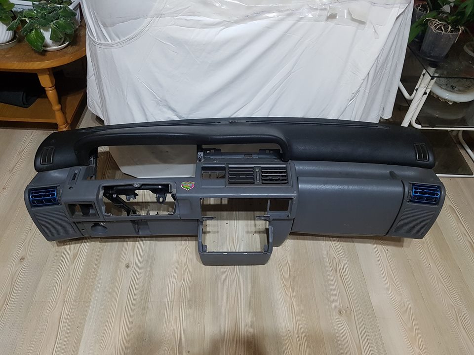

dashboard - 7kg

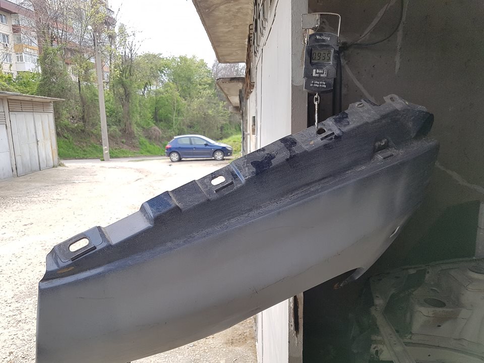

front doors - 30kg
trunk door - 10kg
under body rim+tire+frame- 20kg
cables - 10kg
new rims are 2.5kg each lighter than normal 15'' so another - 10kg
so in total aproximetly - 160-180kg
the rollcage total weight is 75kg because is made with very strong metal - 45mm x 3,6mm all around, 26metes long tubes
