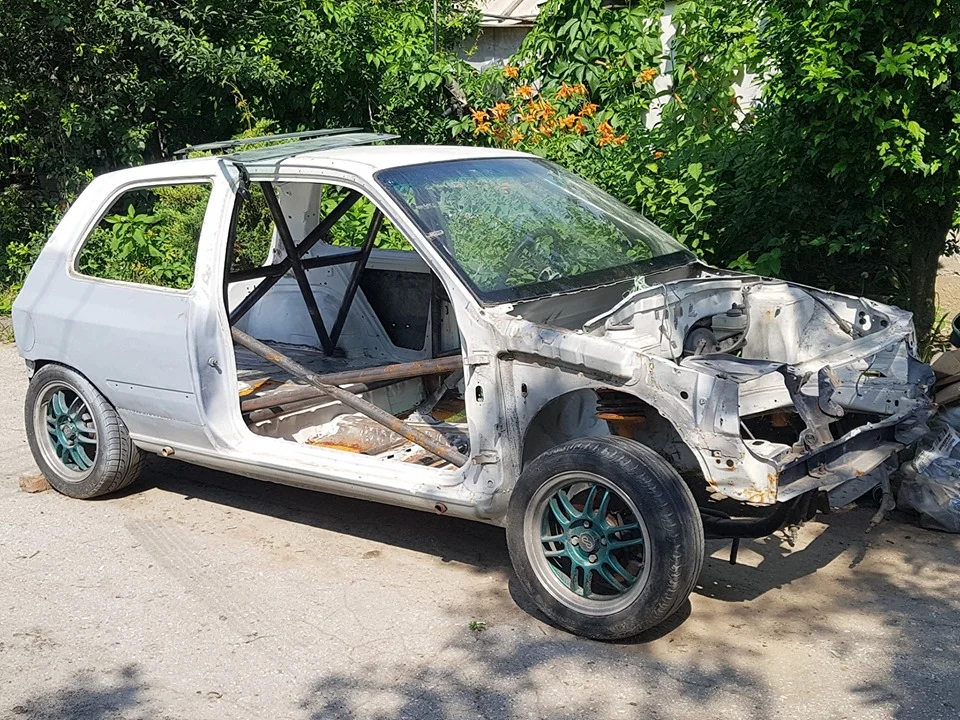

well... the body is already in the paint shop and in the meantime...

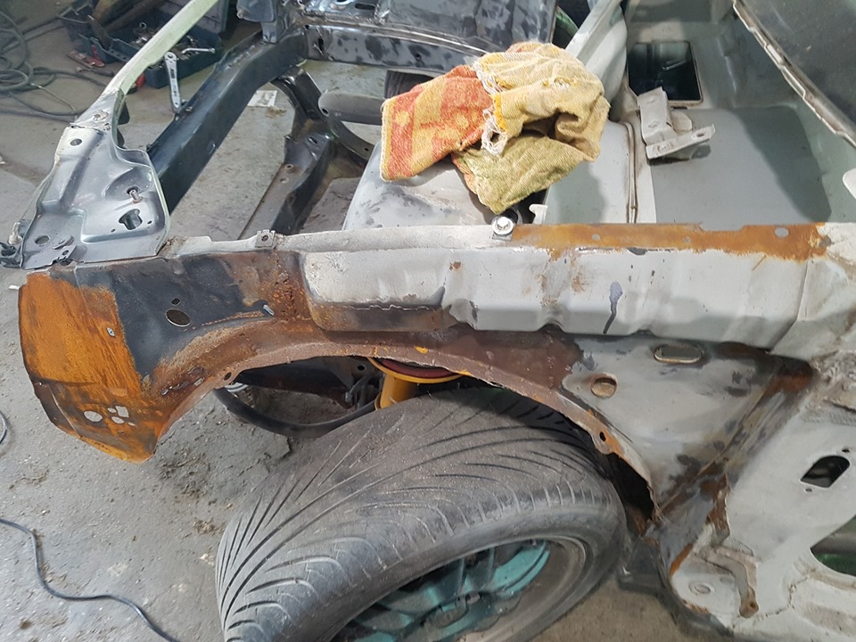

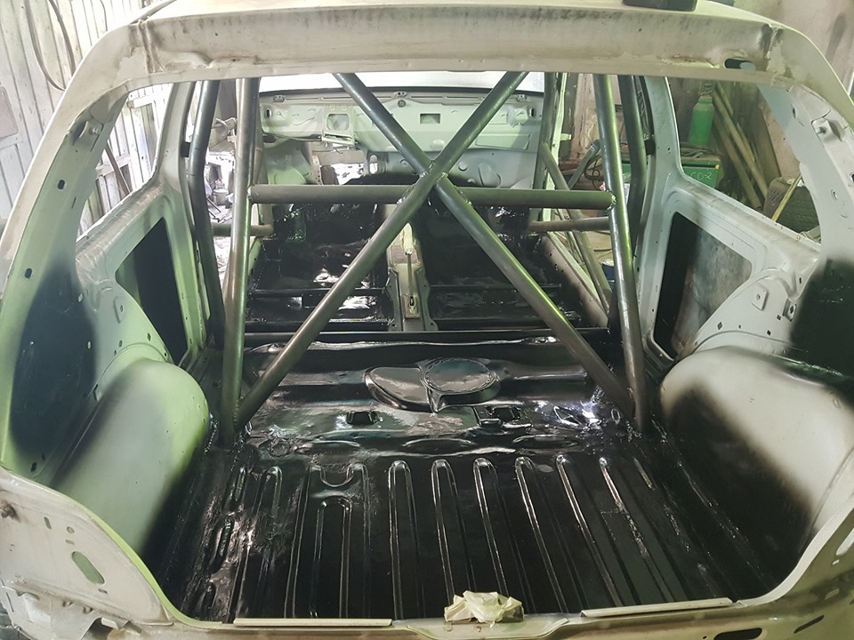

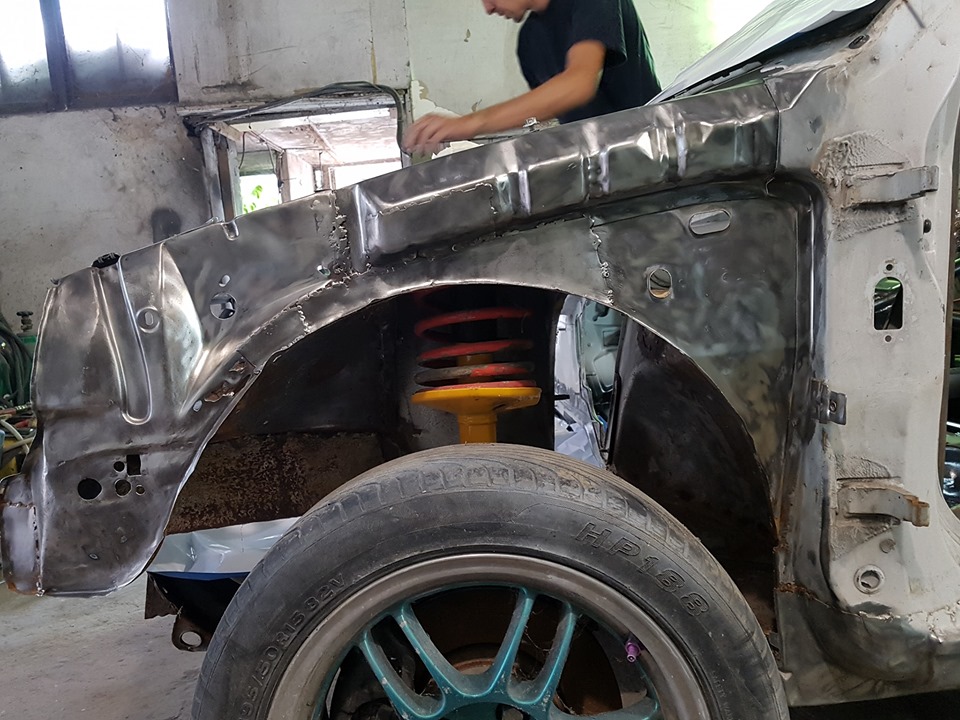

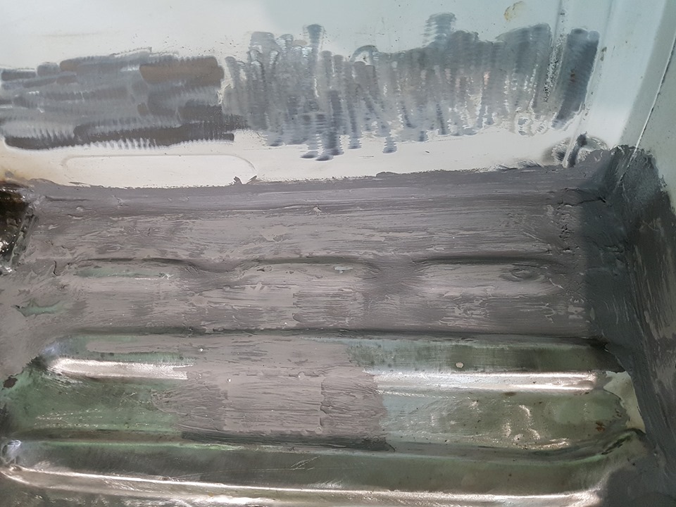

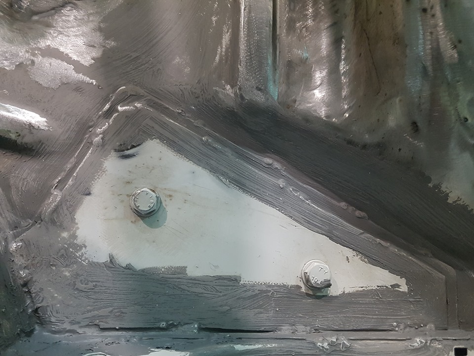

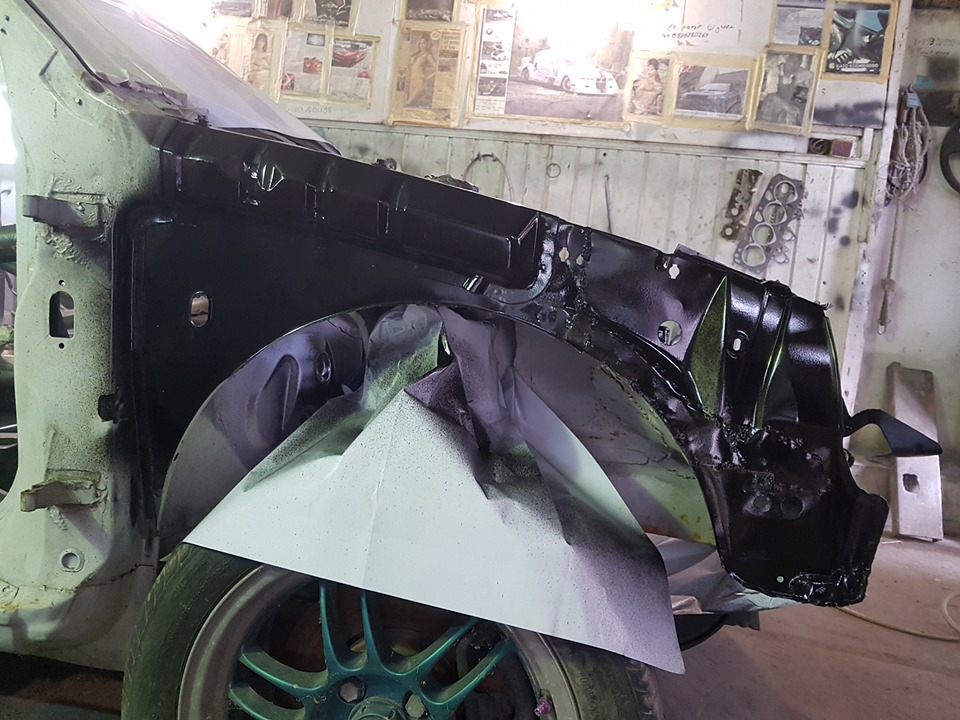

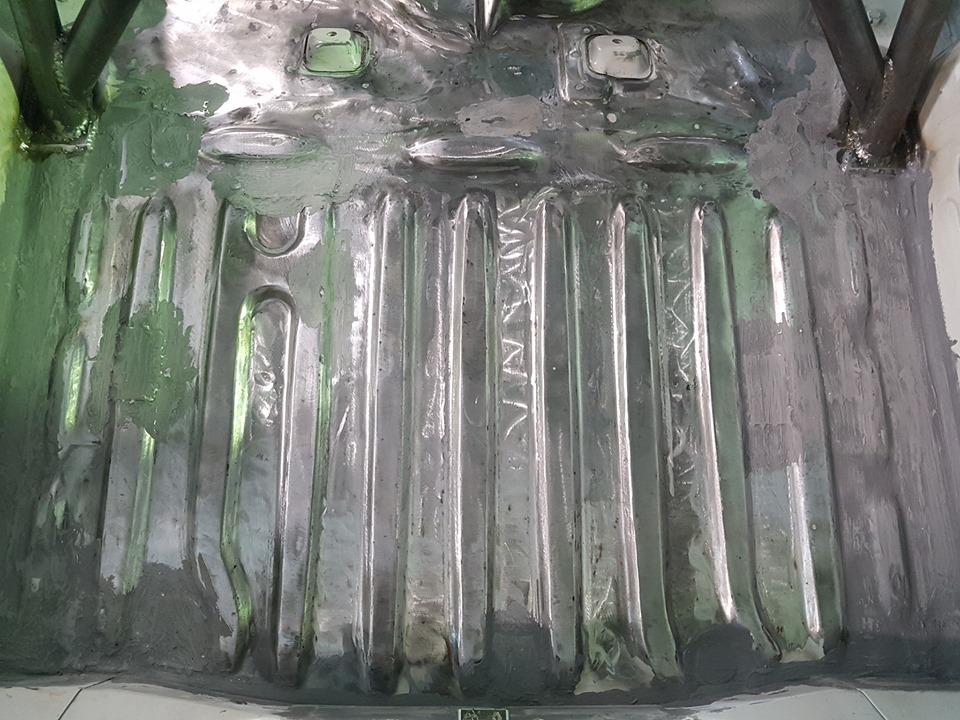

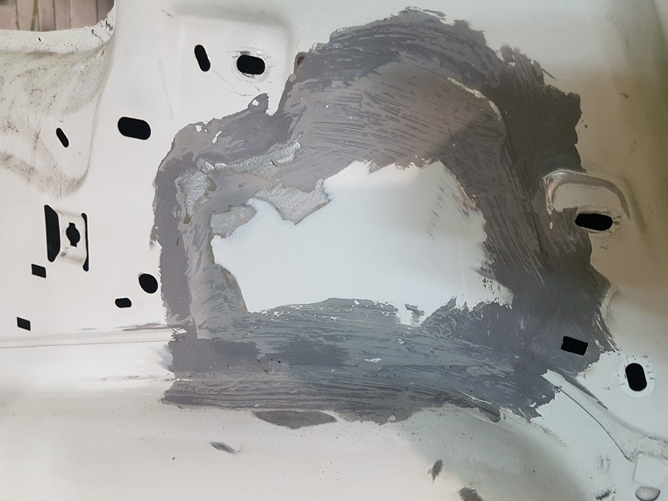

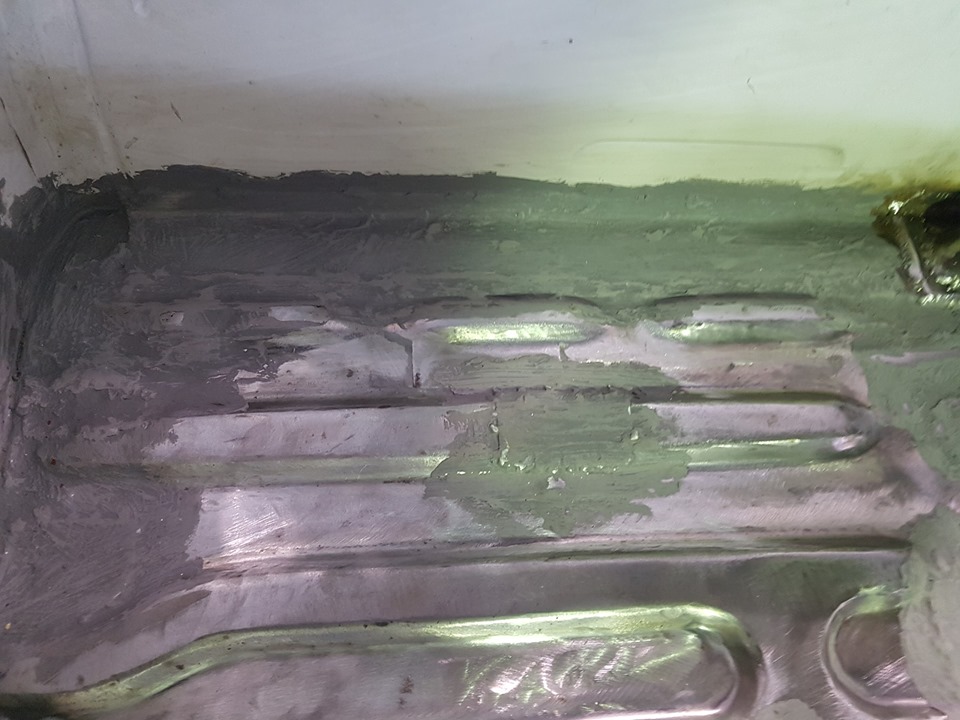

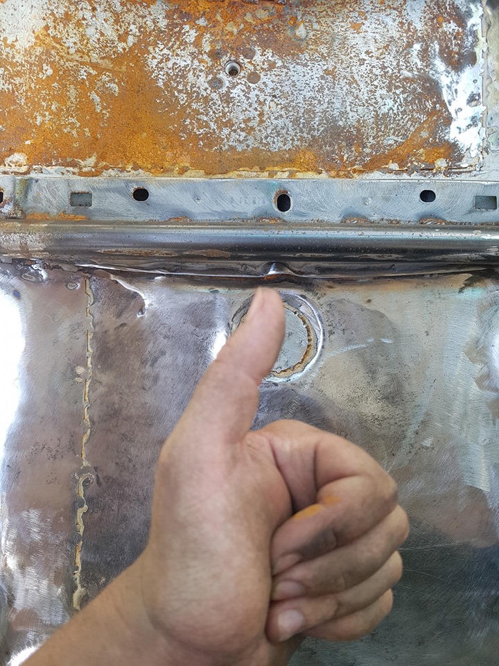

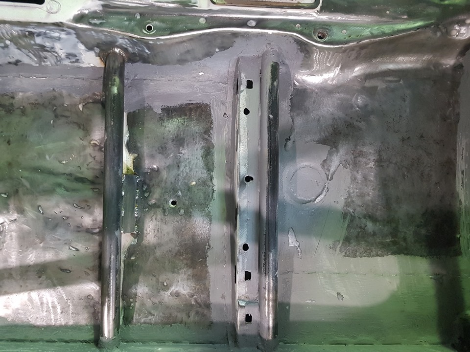

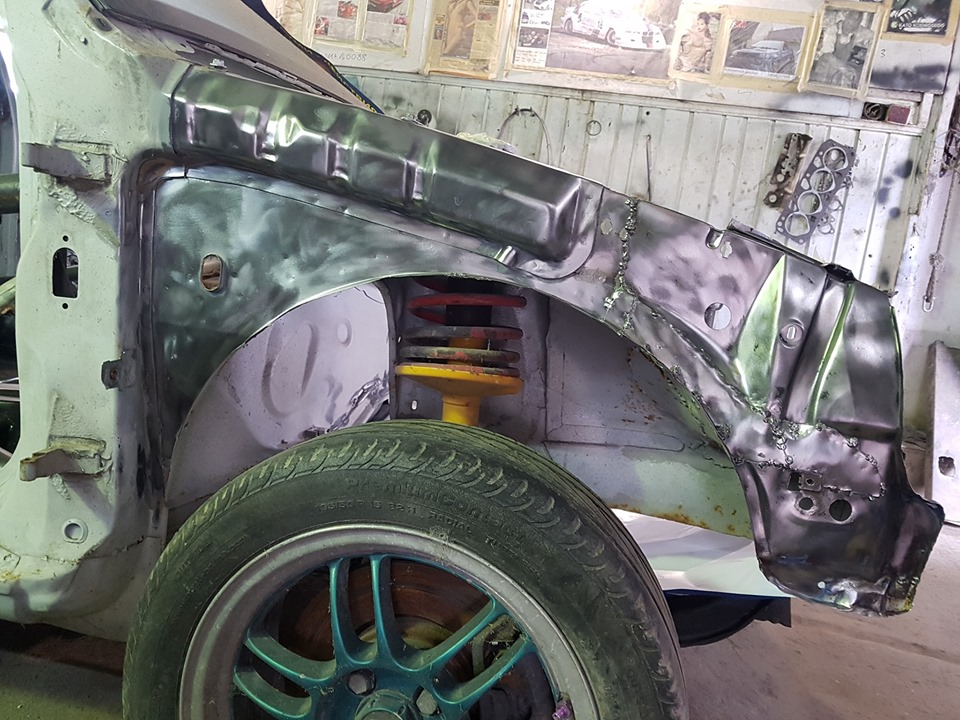

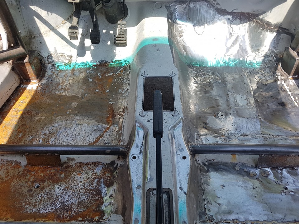

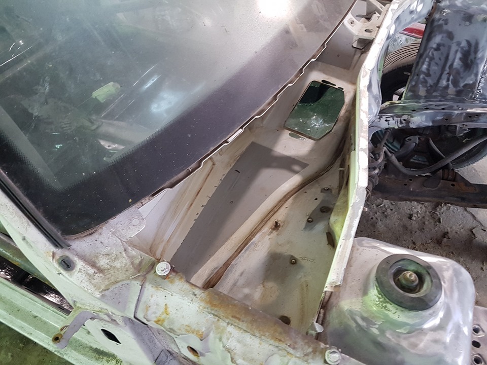

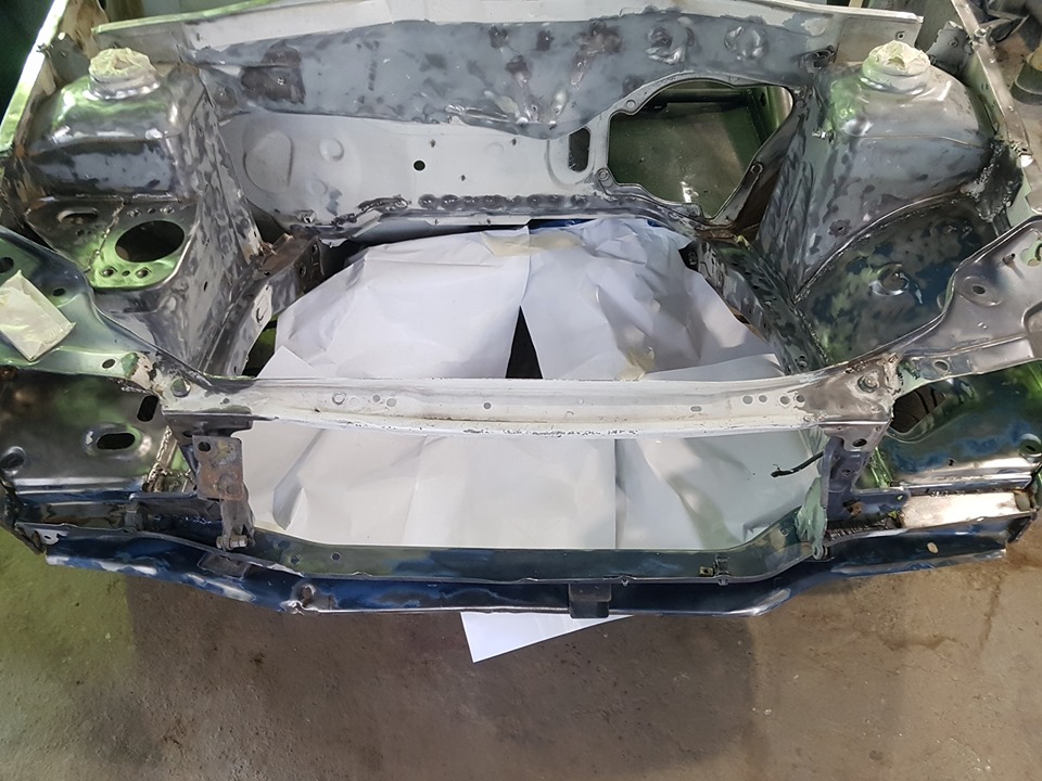

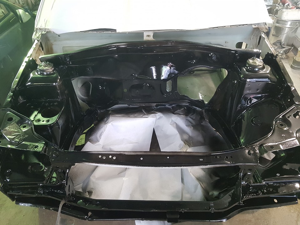

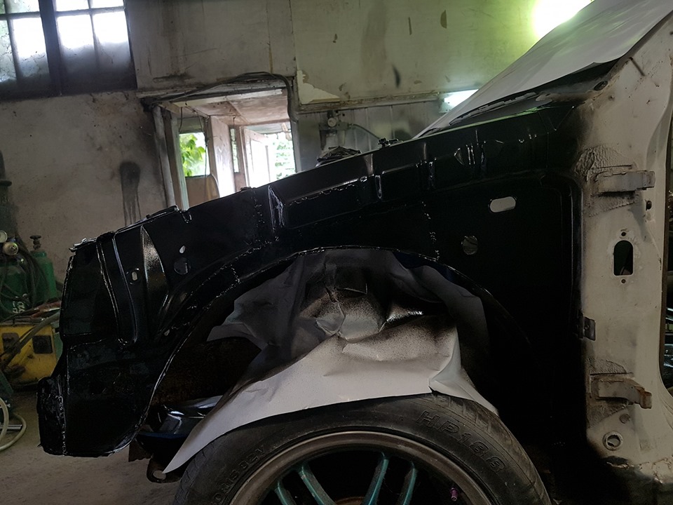

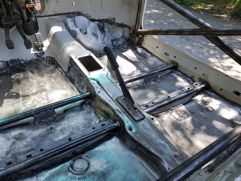

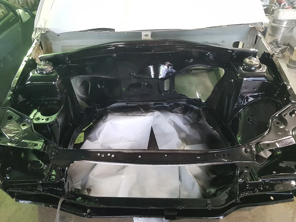

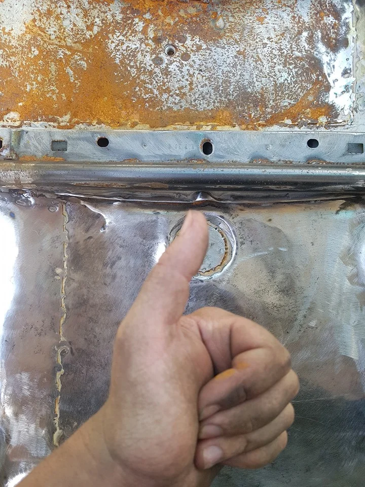

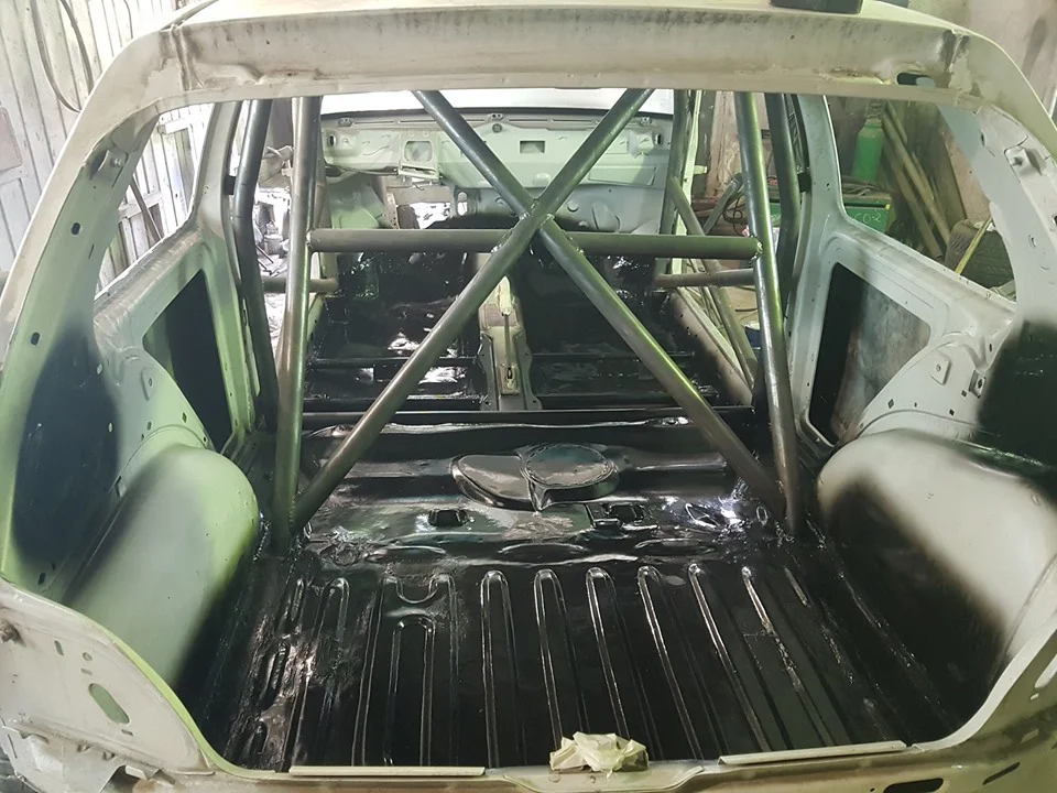

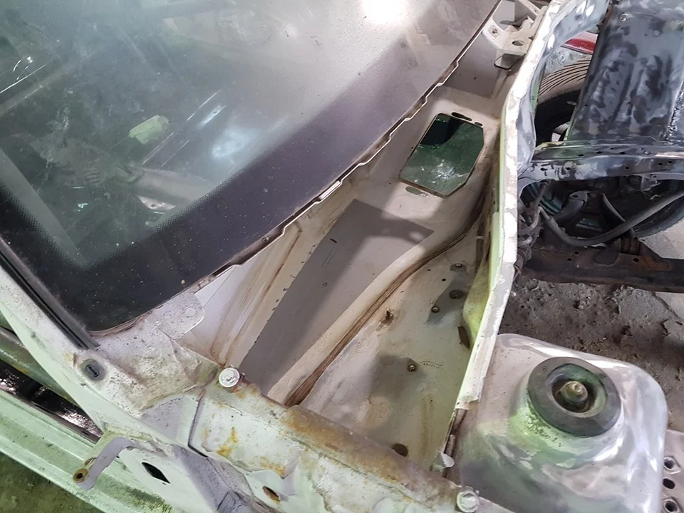

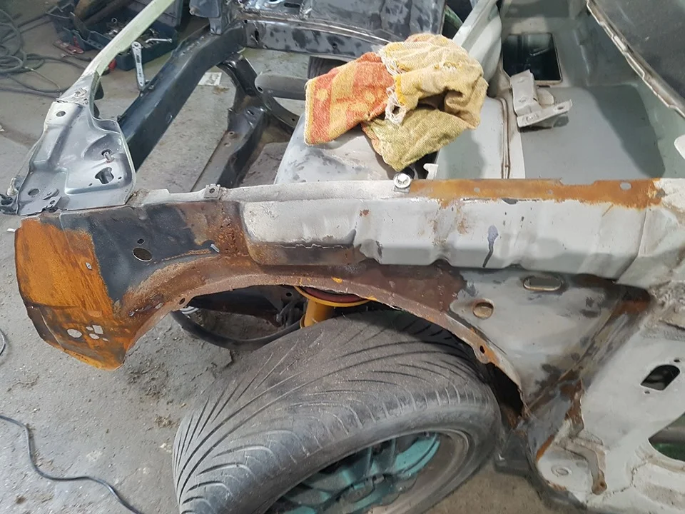

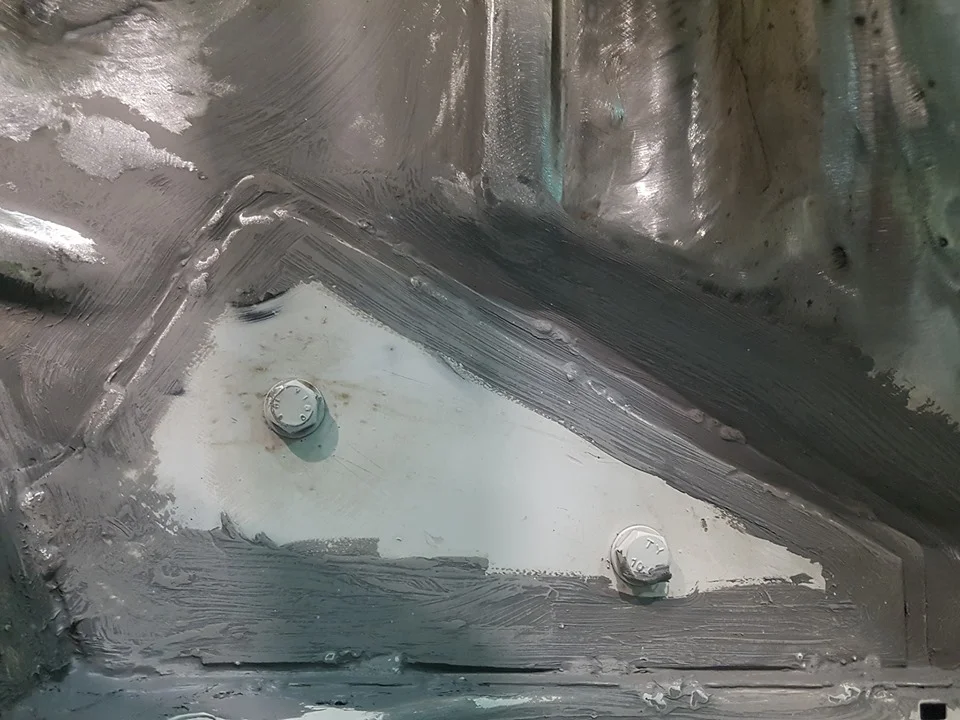

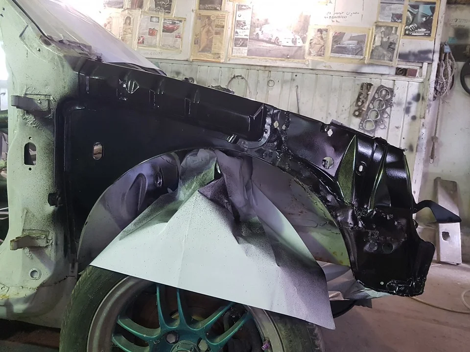

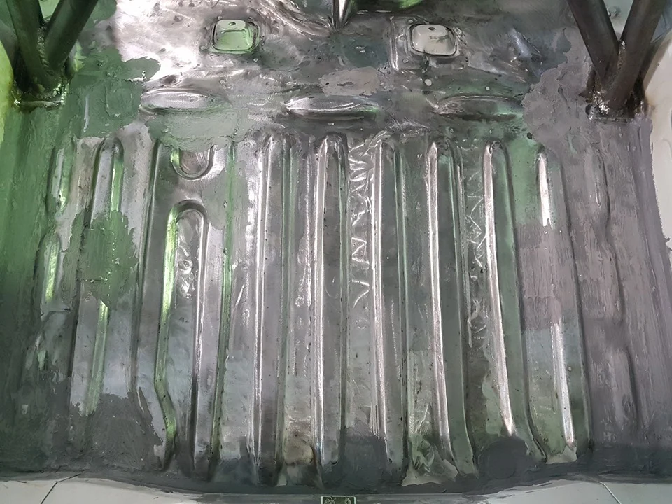

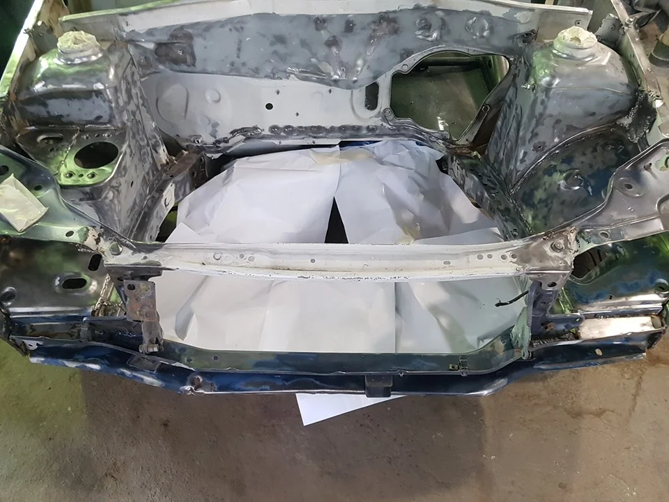

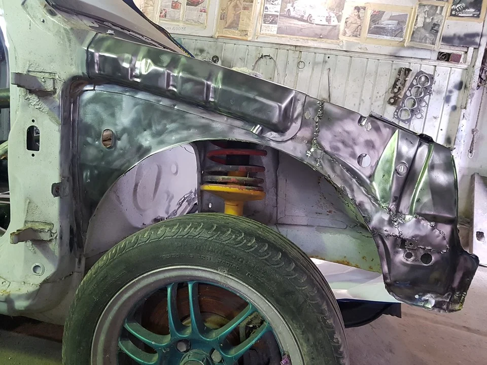

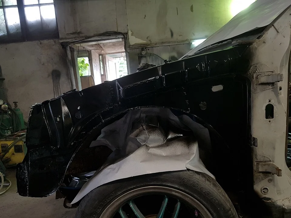

Well after sitting almost 2 months under the rain waiting for paint has got some rust again...

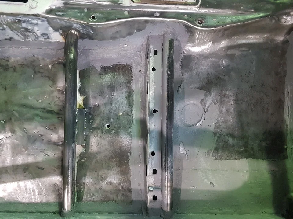

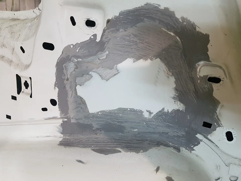

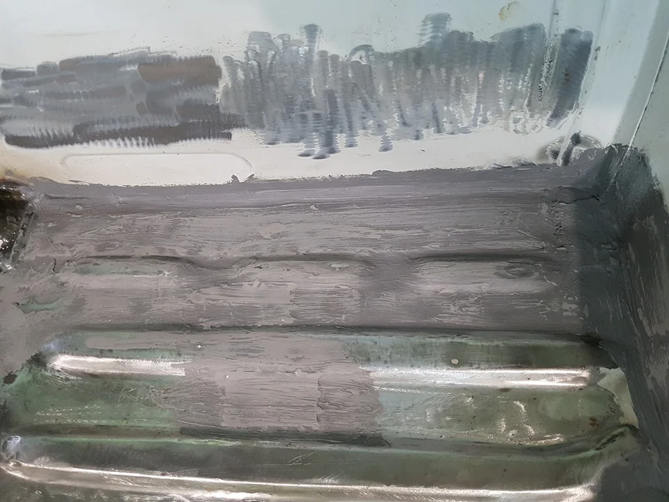

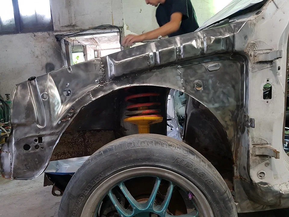

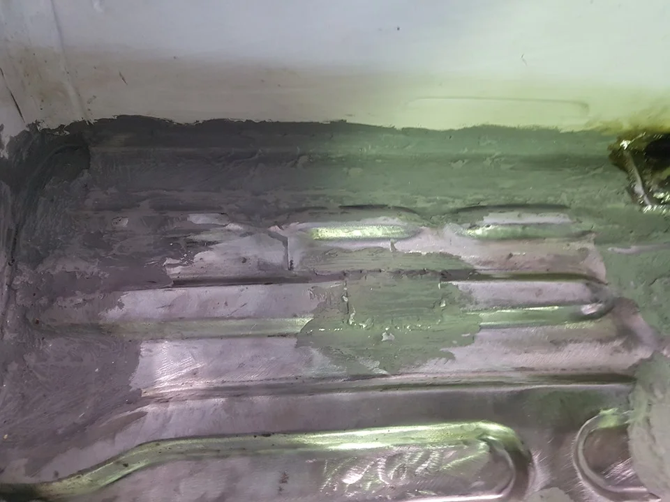

but... grinded all down to bare metal, body sealed and spayed with special primer with cink inside.
its not a big update but...
