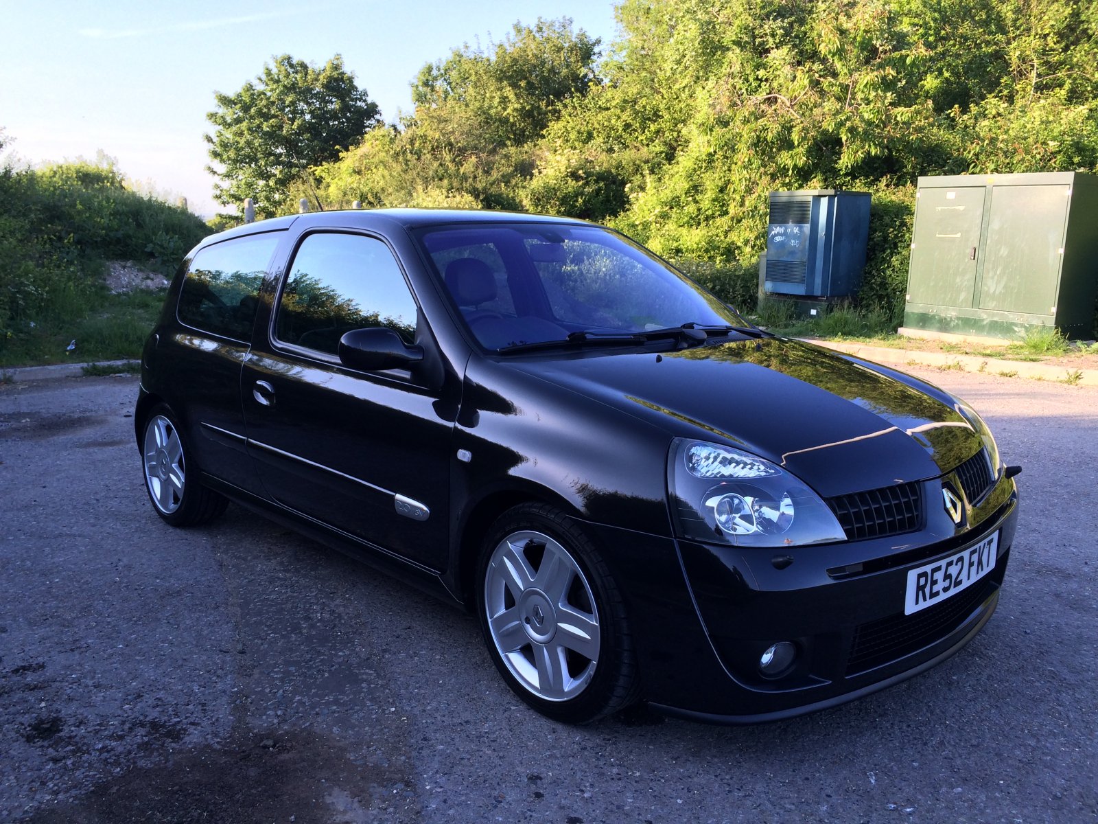

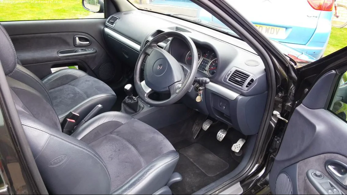

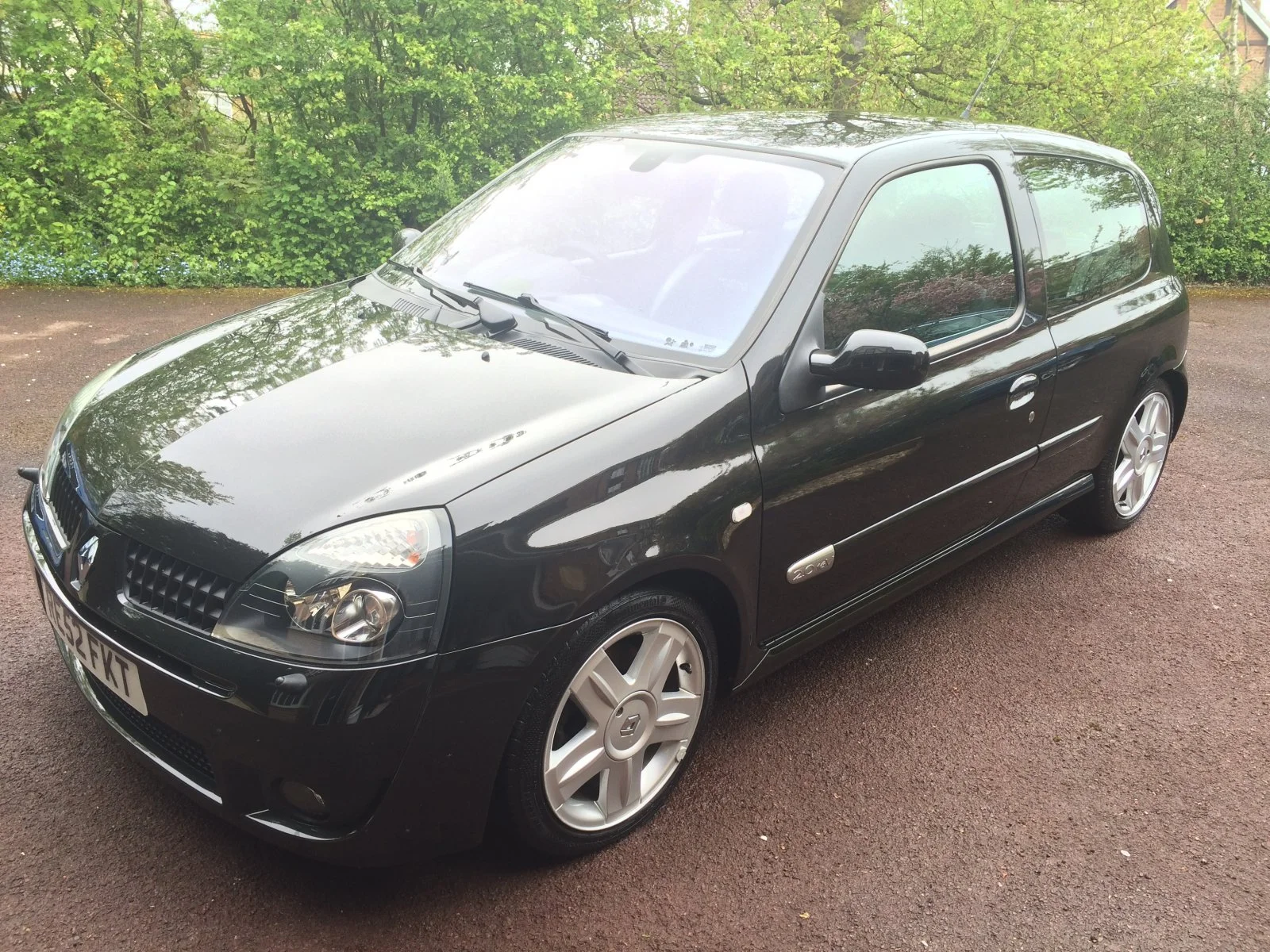

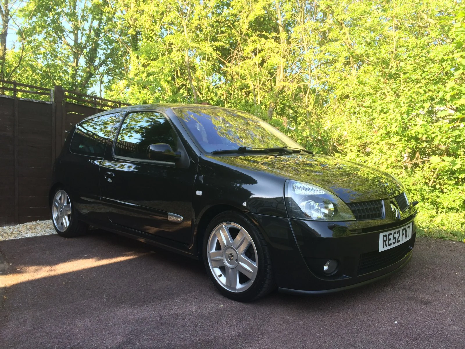

Thought it's about time i shared my project, it started 2 years ago. I was randomly searching Autotrader and i found a 50k 172. Had a quick look and it seemed clean and in "ok" condition. I only really had the intention to use at the weekends and trips to the Nurburgring etc. I wanted a decent car i could use on the road and track so some comforts were really imports. This started the "172 Clubsport project"

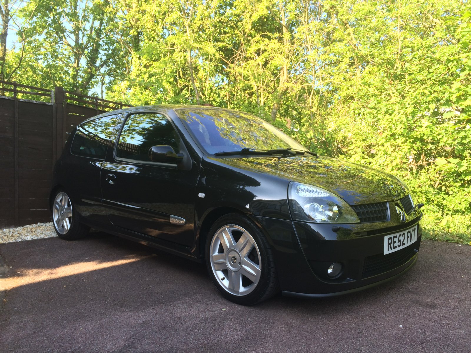

Totally standard car on purchase day.

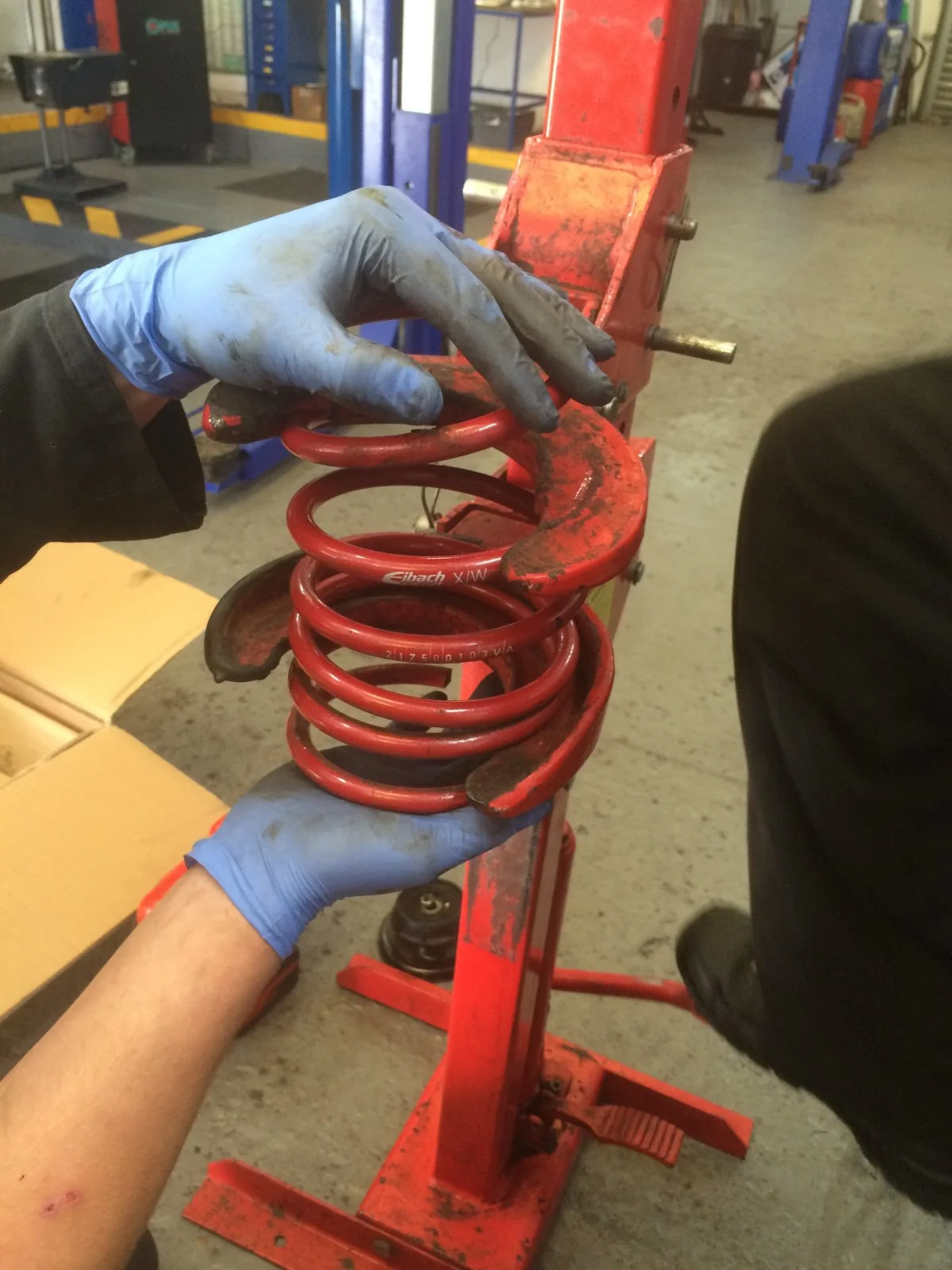

Eibach springs with new Cup shocks all round

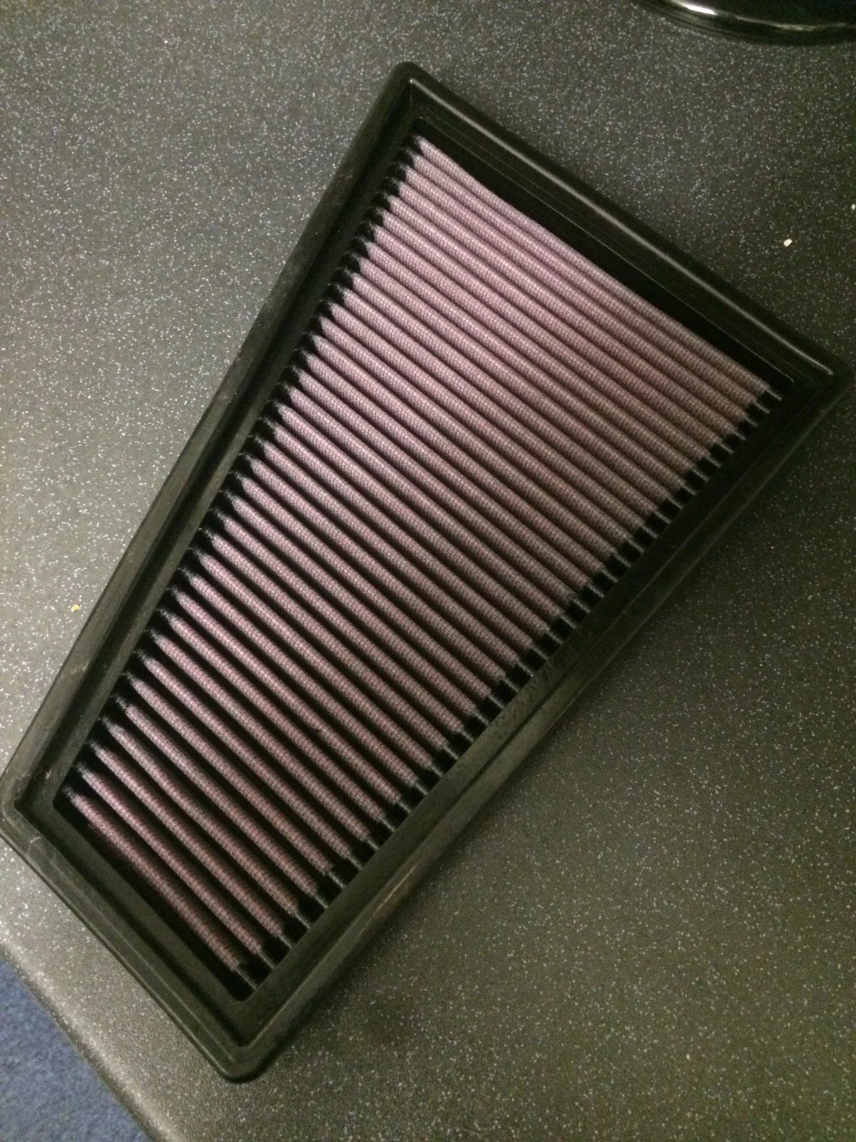

K&N

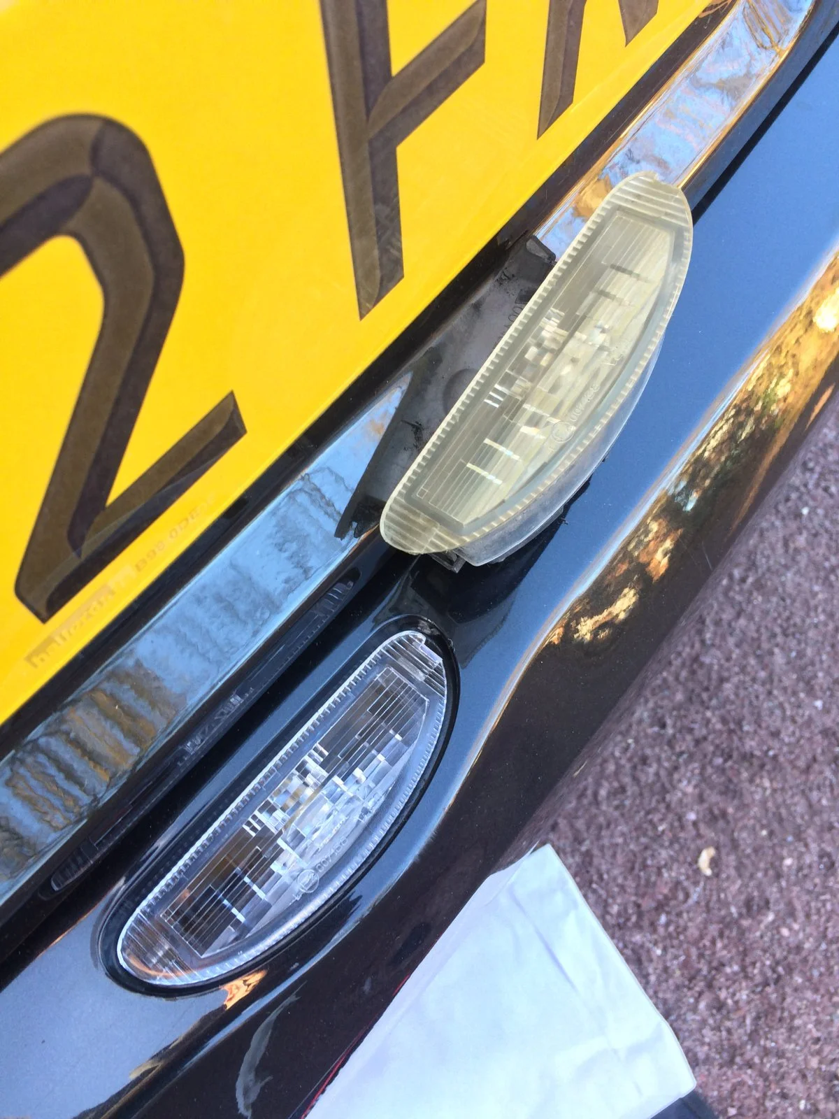

New Plates and Lights

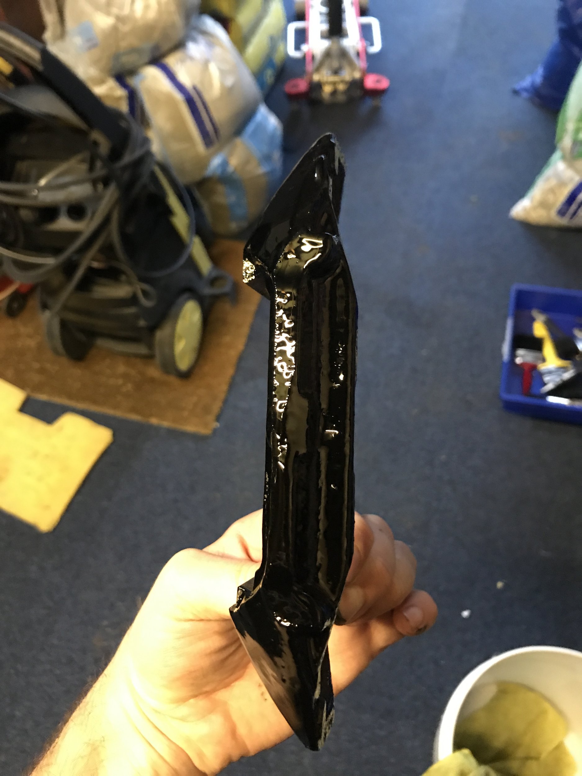

Broken genuine splitter, 3 parts!

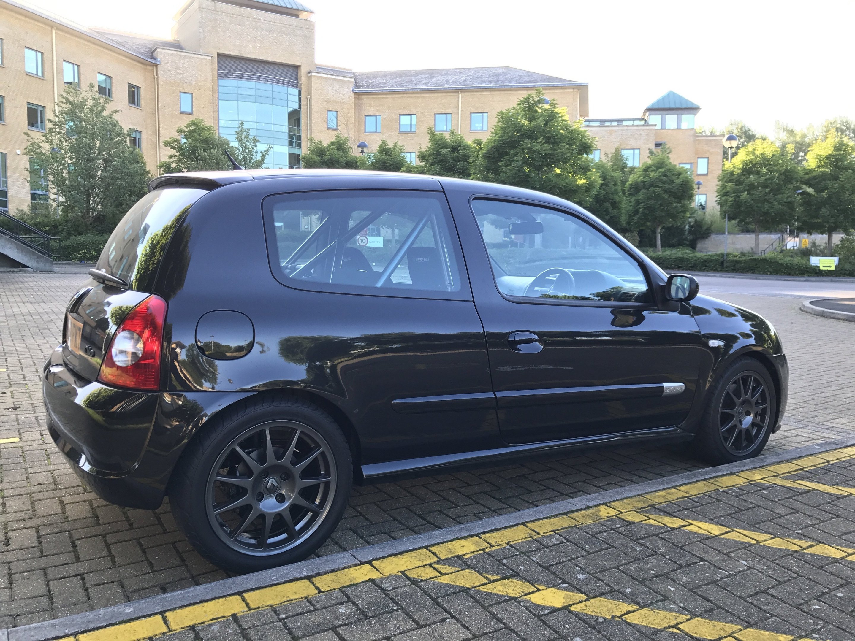

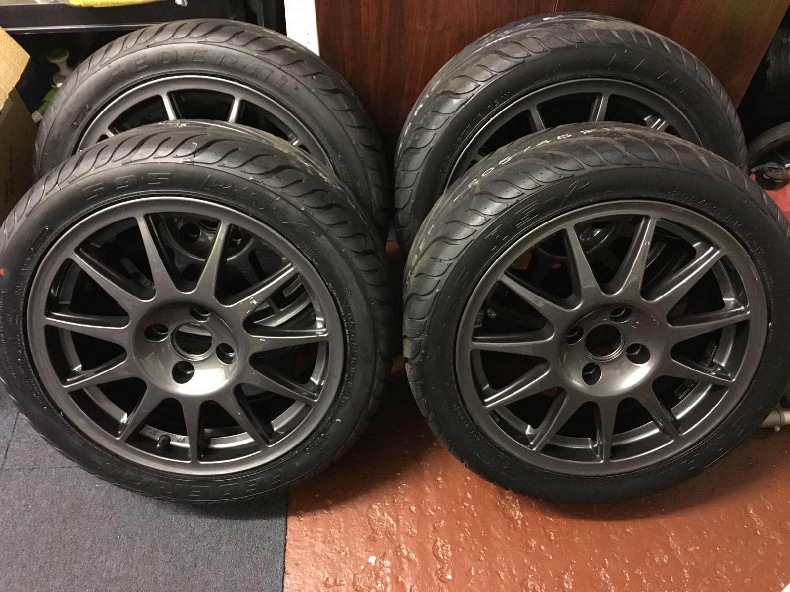

Steering Wheel, New Alloys and some Sticky tyres on..

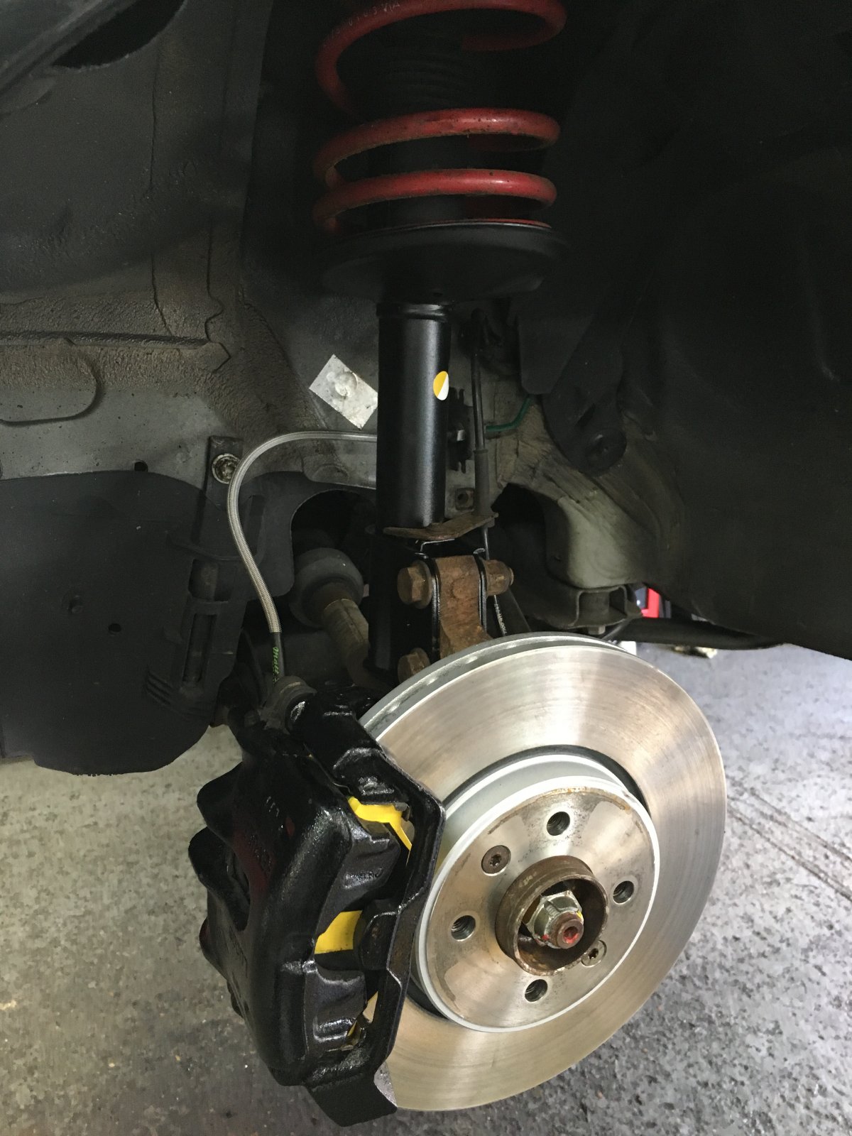

Brembo HC discs and Yellow stuff all round
Front Airducts to replace Fogs

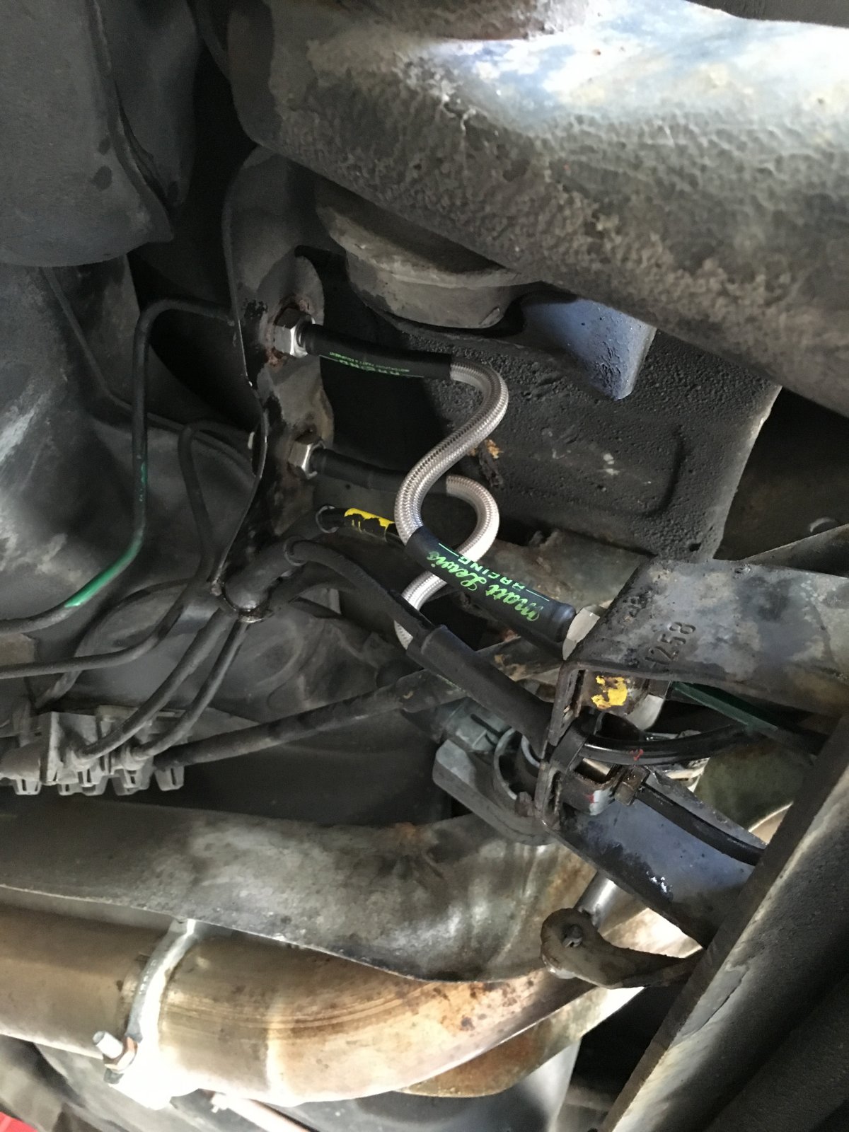

Braided Brake hoses

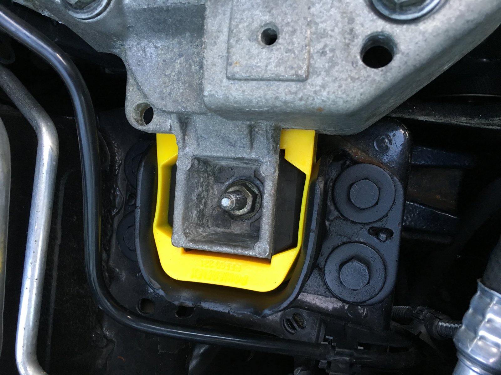

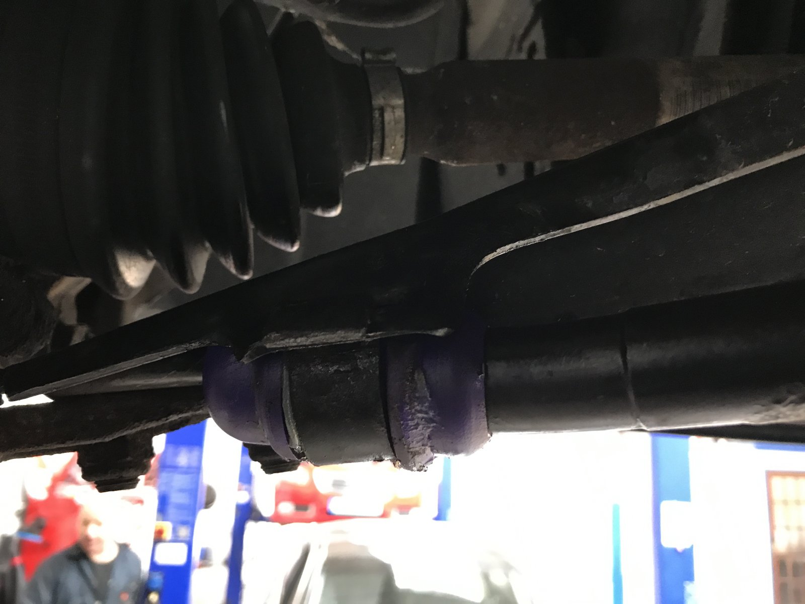

Powerflex Dog Bone and Exhaust hangers

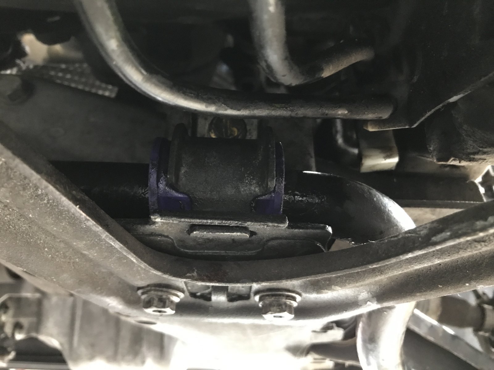

Powerflex front ARB bushes

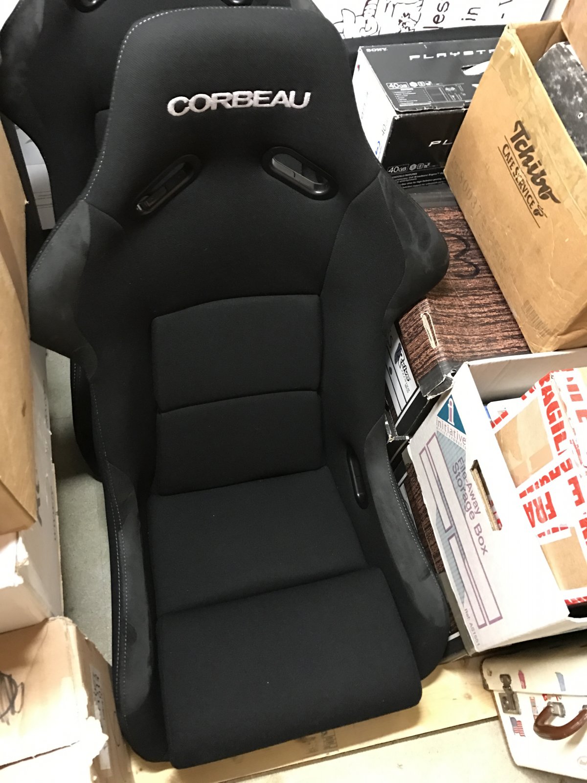

Clubsports are the best bang for buck seat out there, proven by how fast they sell out. Had a pair in my 172 cup and they were awesome for the price.

The clubsports are a great seat, especially for the money they cost.

Great purchase on the seats! I've been waiting for mine since March! :(

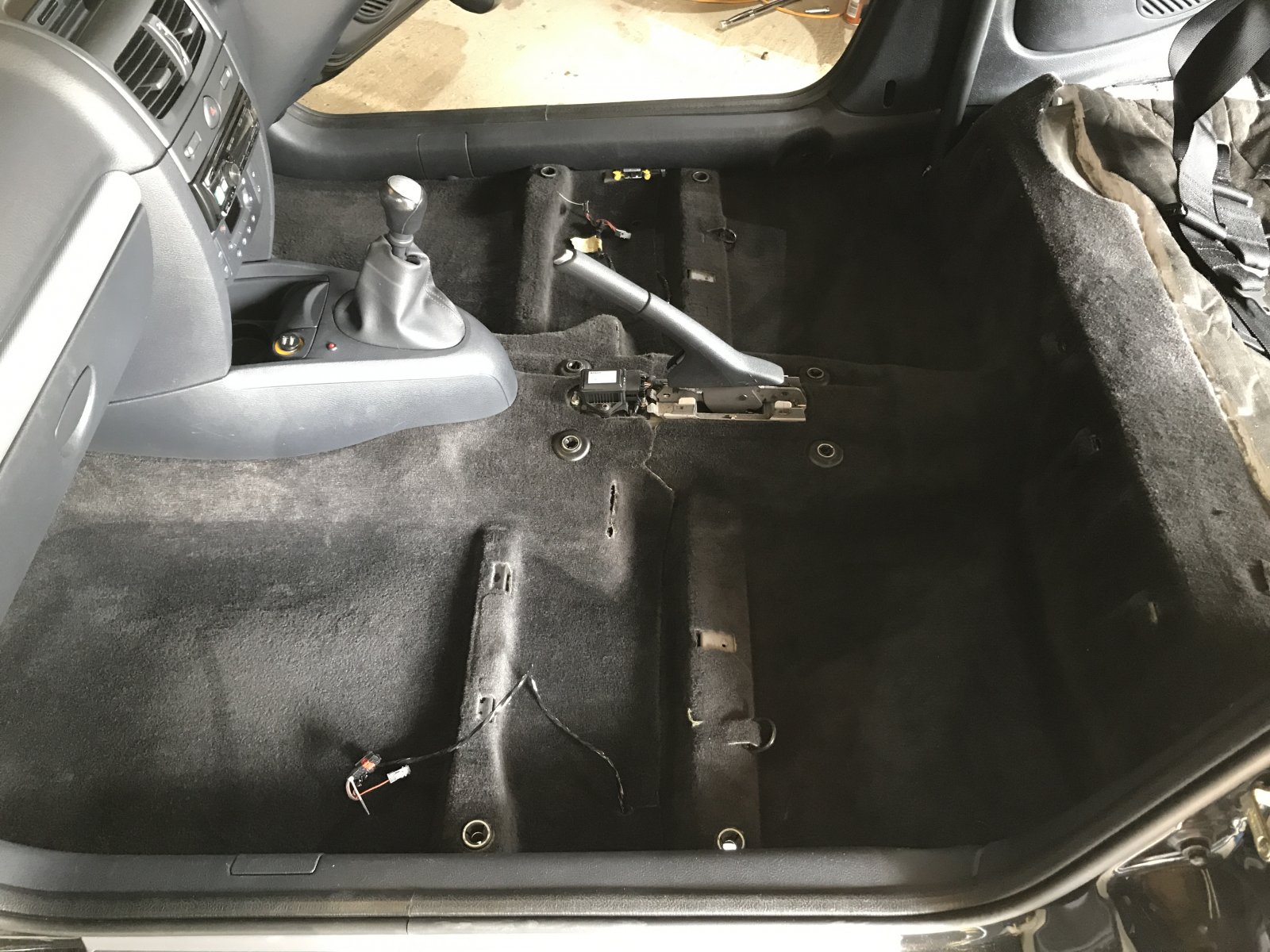

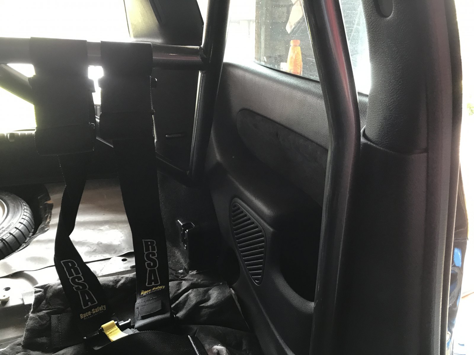

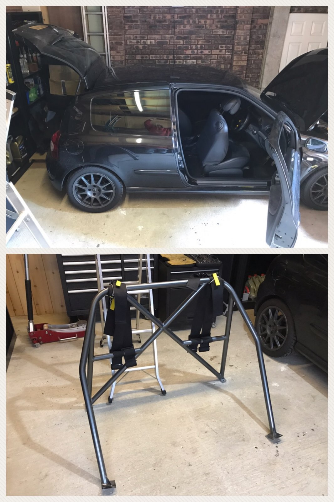

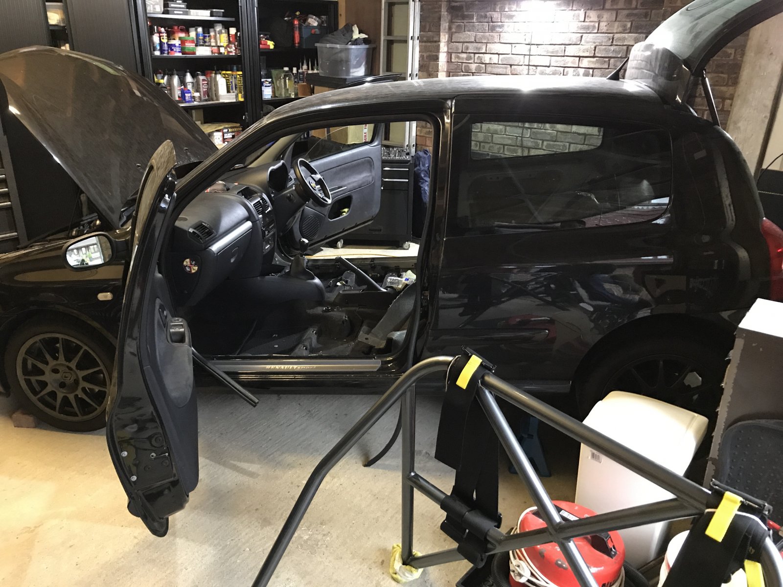

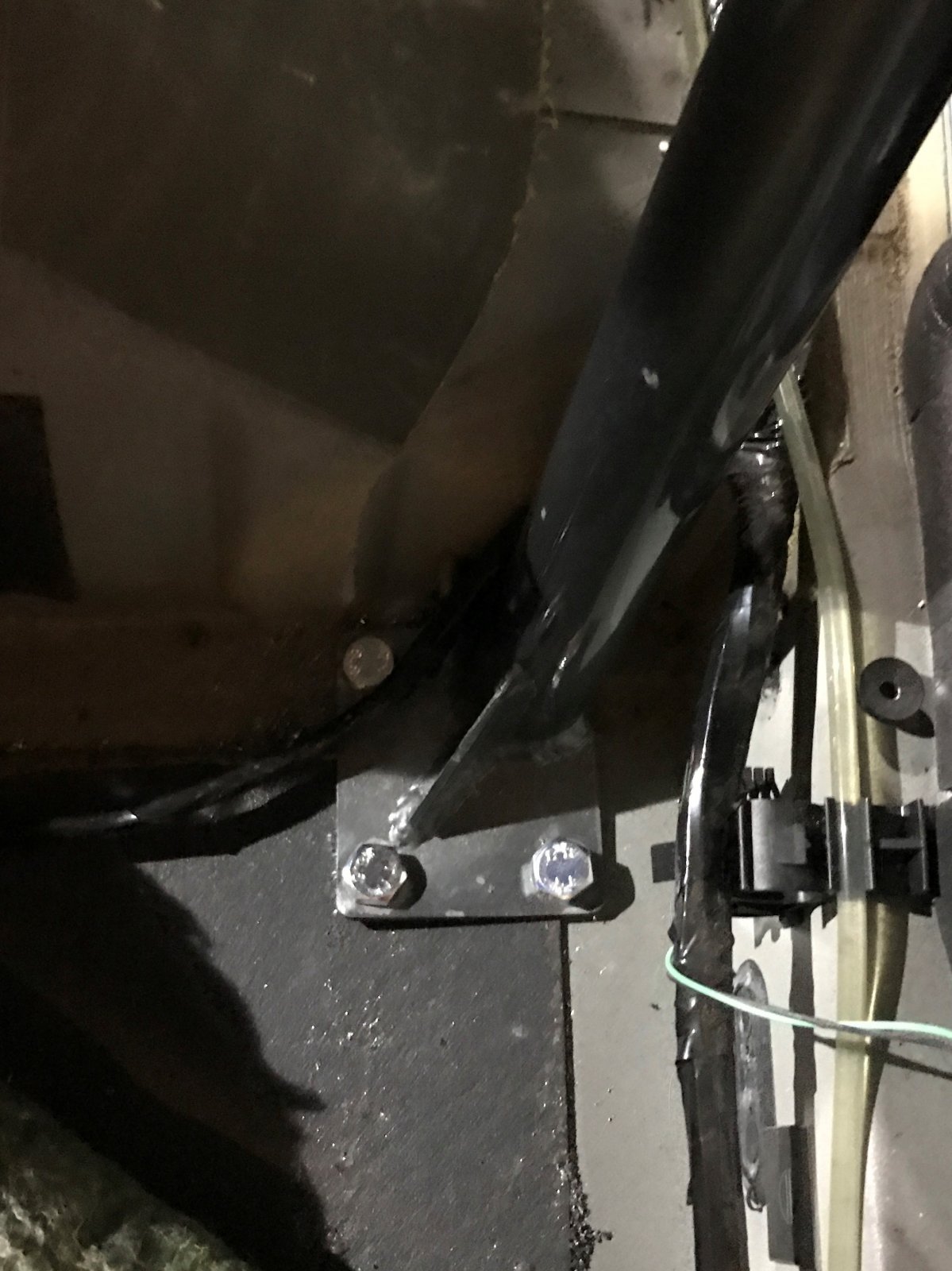

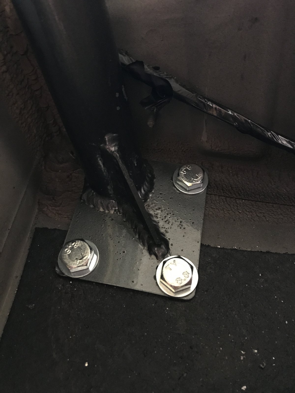

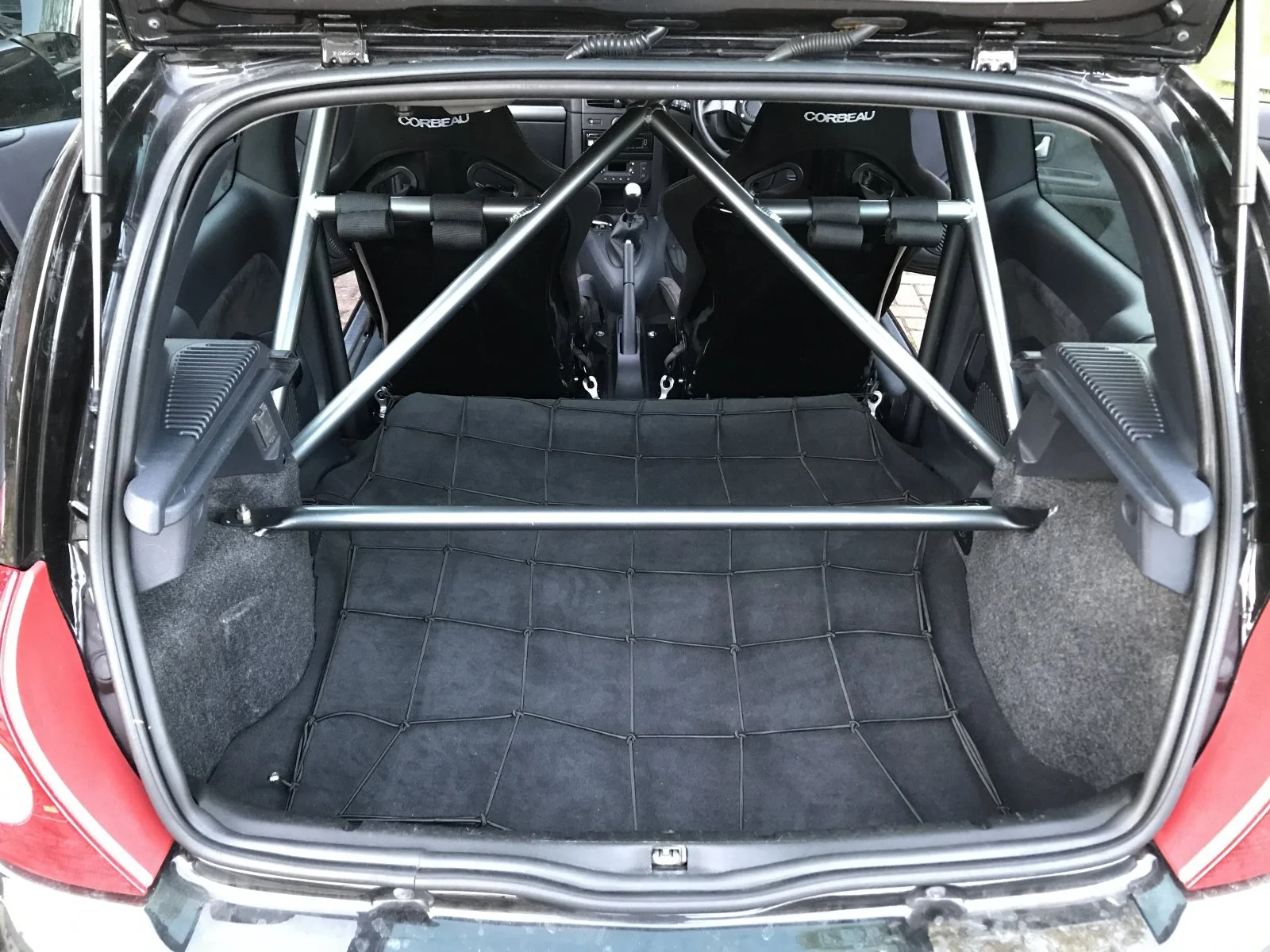

Small update, manged to get the cage in and drill the holes. Now need pull it forward to make space to put some of the side trims back in.
Drivers seat also in position, but that will also come out again. Lots of fun this! :)
Parked the car across the garage to give me enough space to work.
Holes drilled and bolts dropped in to test fit.
Cage in!

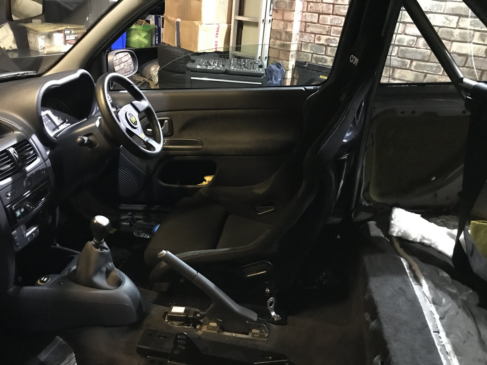

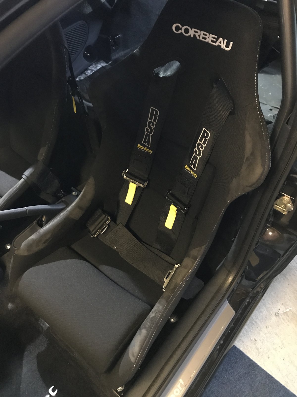

Test fitting the seats

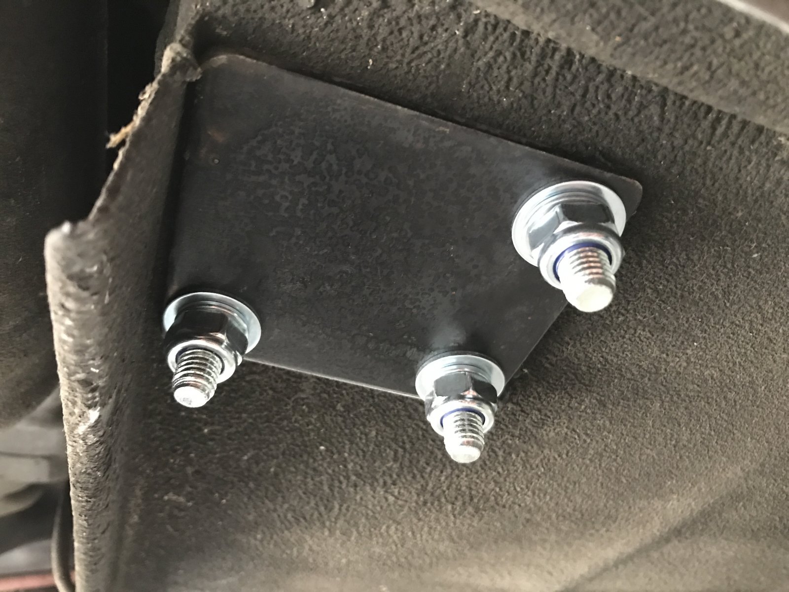

Underside spreader plates are currently being treated with curust before being fitted.
Next up will be to fit the cage permanently in place and get the seats in.
  RS 172

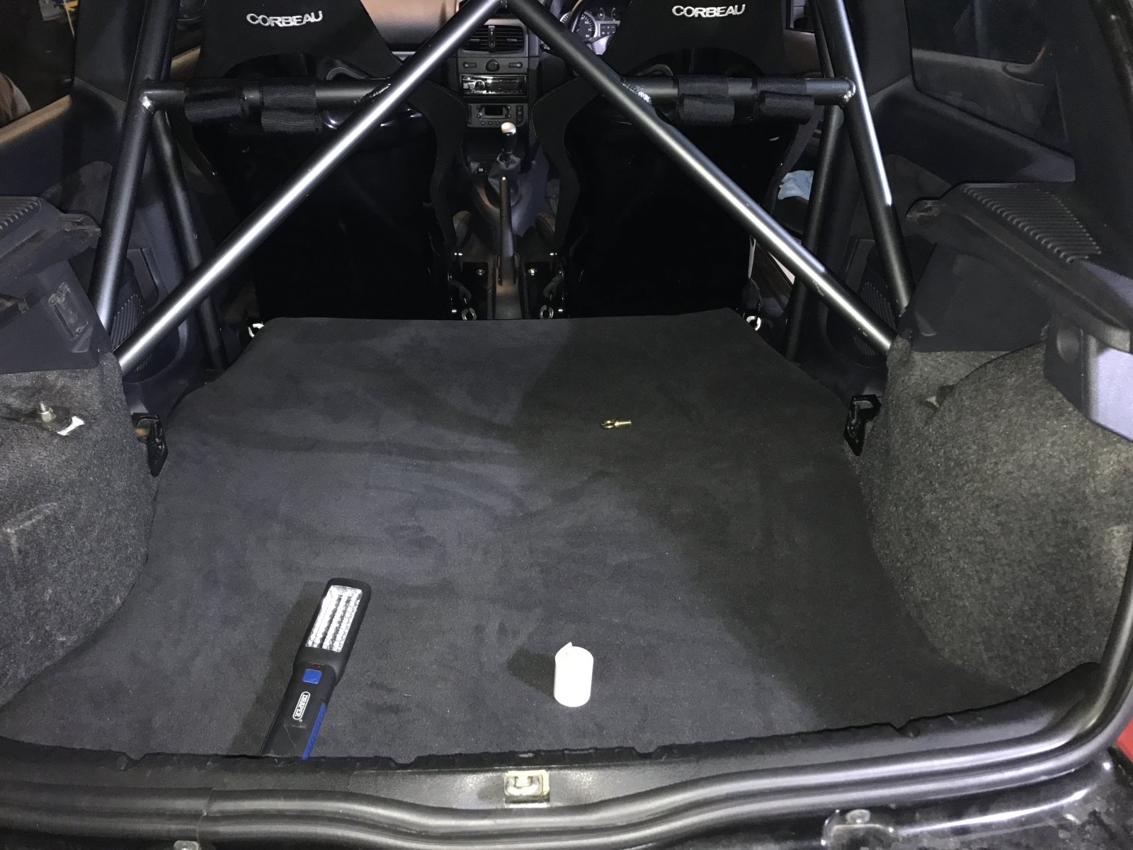

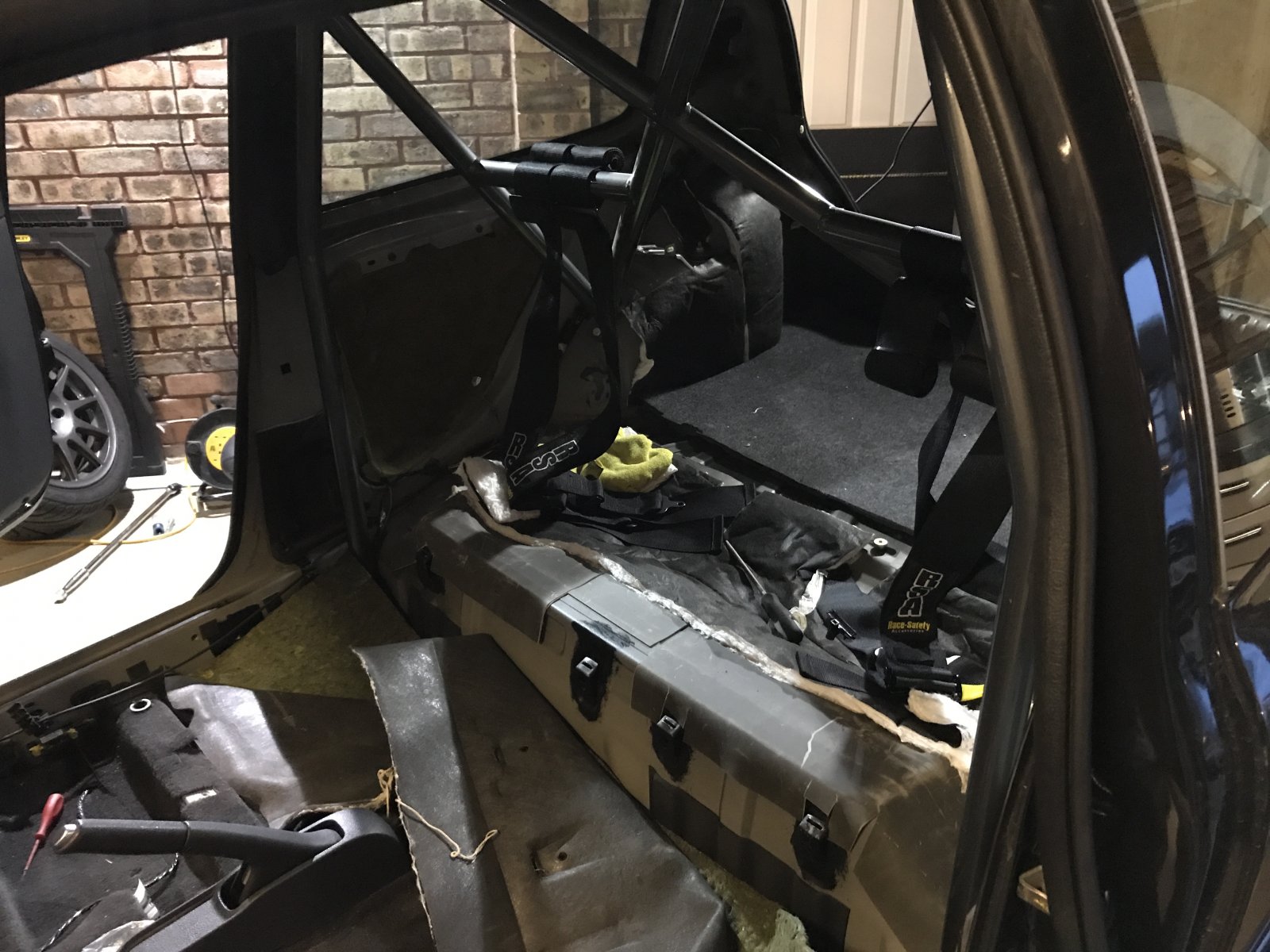

So for now the interior is finished. I do want to move the passenger seat slightly, but i can either do this in Germany or when i get back.
Cage bolted down with spreader plates.

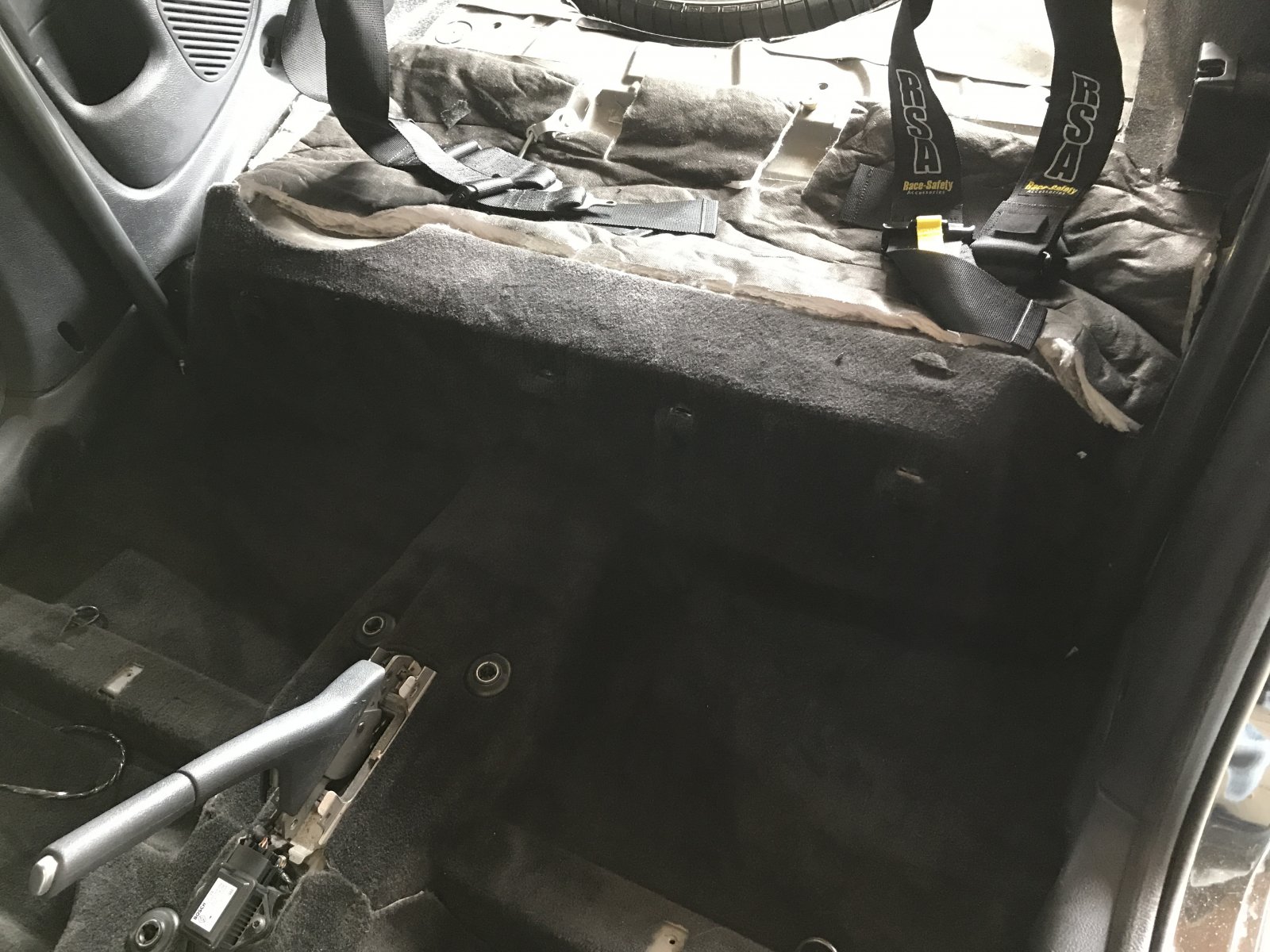

I had to remove the air ducks to the rear to get the lowered sub frames in, but this isn't an issue. All seat belts were removed and the rear trims refitted.

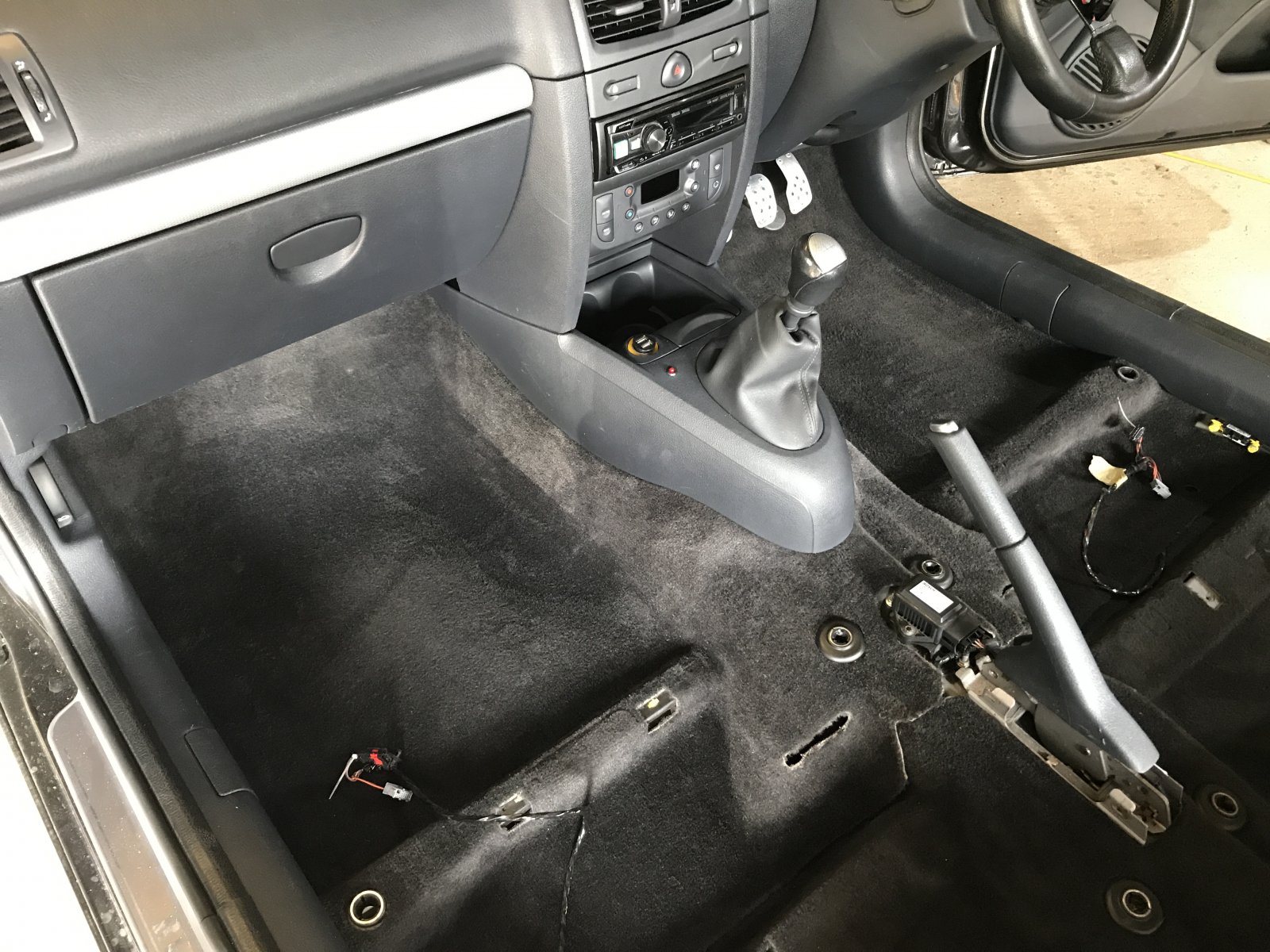

Carpet trimmed to fit.
The trims are really hard to fit with a cage in, but i got them all in and it's look smart. Having own a few fully stripped cars, i really didn't want this to be like that.
Seats went in:

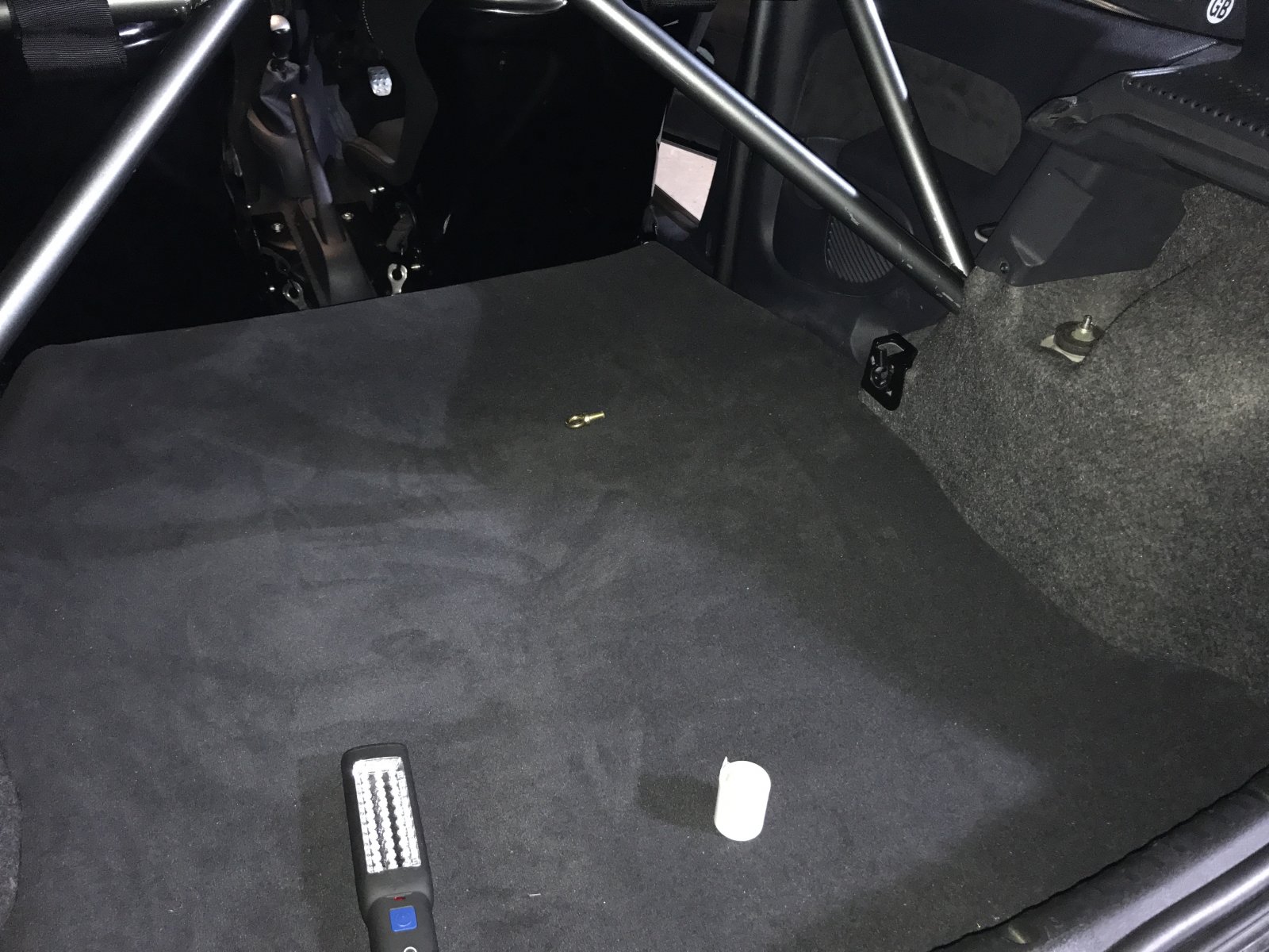

Next up was carpeting the rear, i was going to buy the rear mat but it was £60, so decided on some black carpet.
The carpet is cut round the boot and tucked under the plastic trims. The end has been tapped down with carpet tape and seems to be ok.

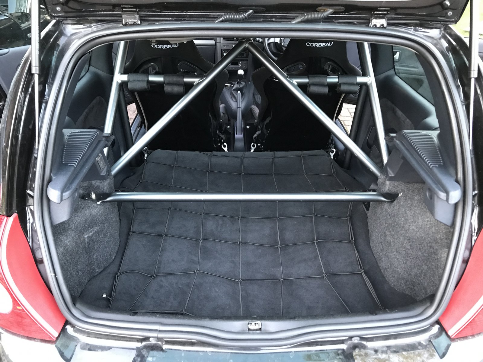

Strut brace and cargo net added:

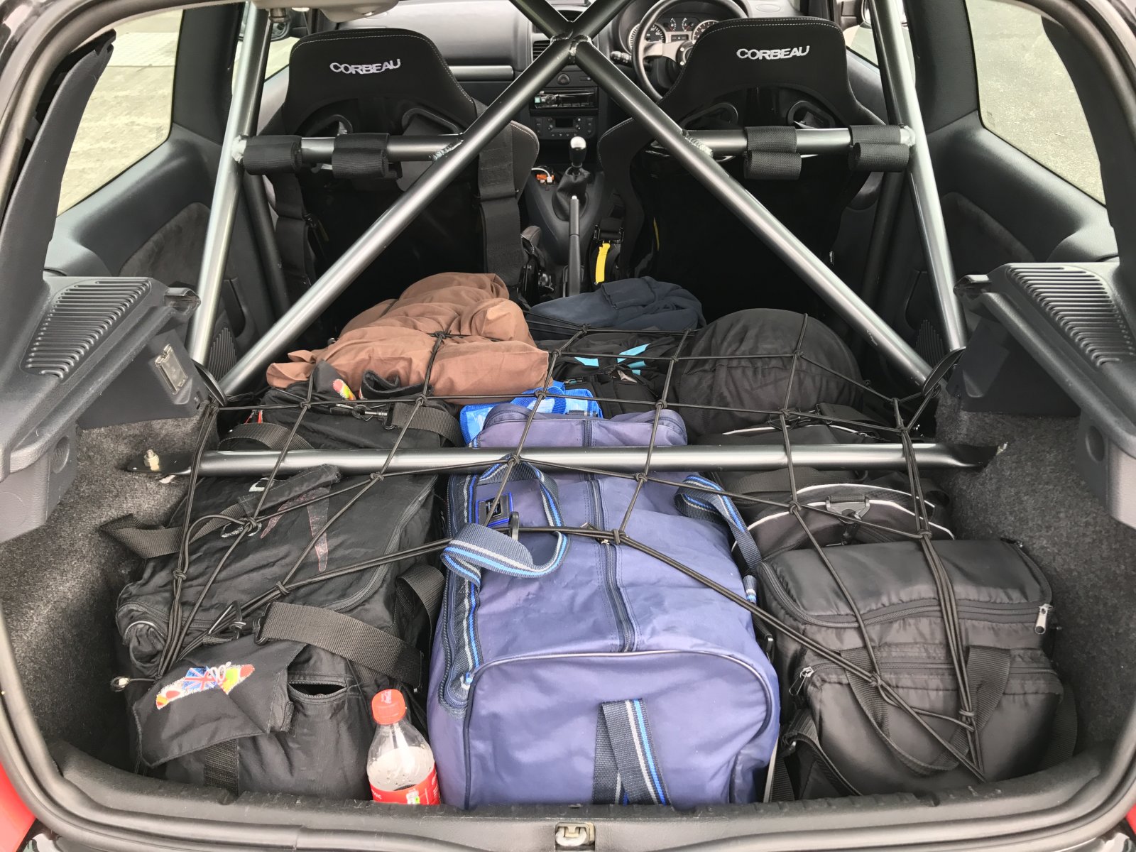

Just a small update - Car made it to the ring and back with no major problems, however there were a few issues that could be fixed at the hotel. I got 9 laps in this year, before i decided that was enough this year with a rear wheel bearing getting noisy.

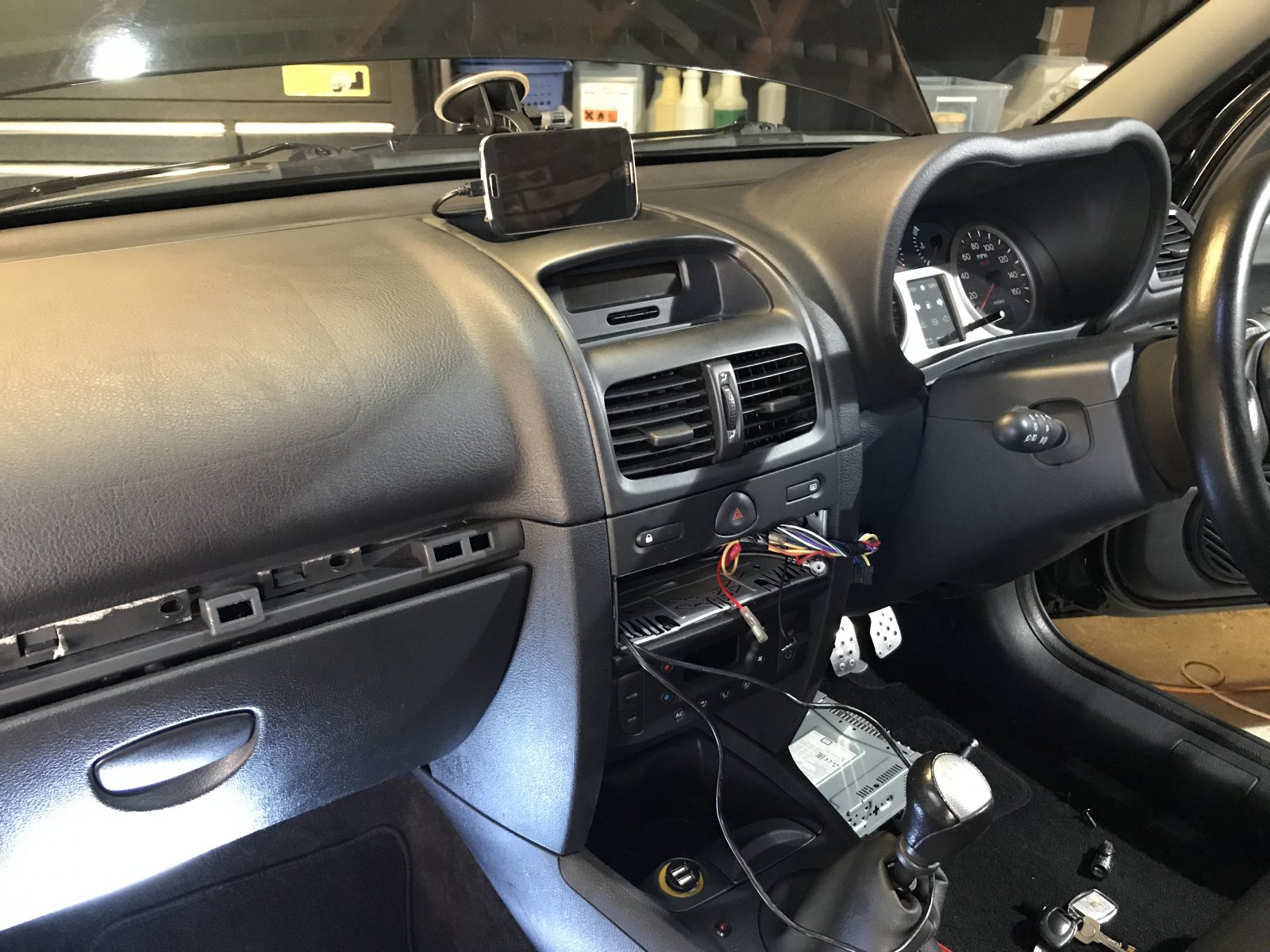

Hard wired the sat nav (phone)
Gave the car a good clean
Loaded the car, i'd defo advise this cargo net. Perfect for not rear seats.

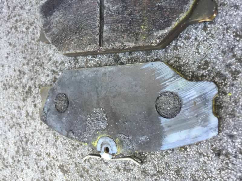

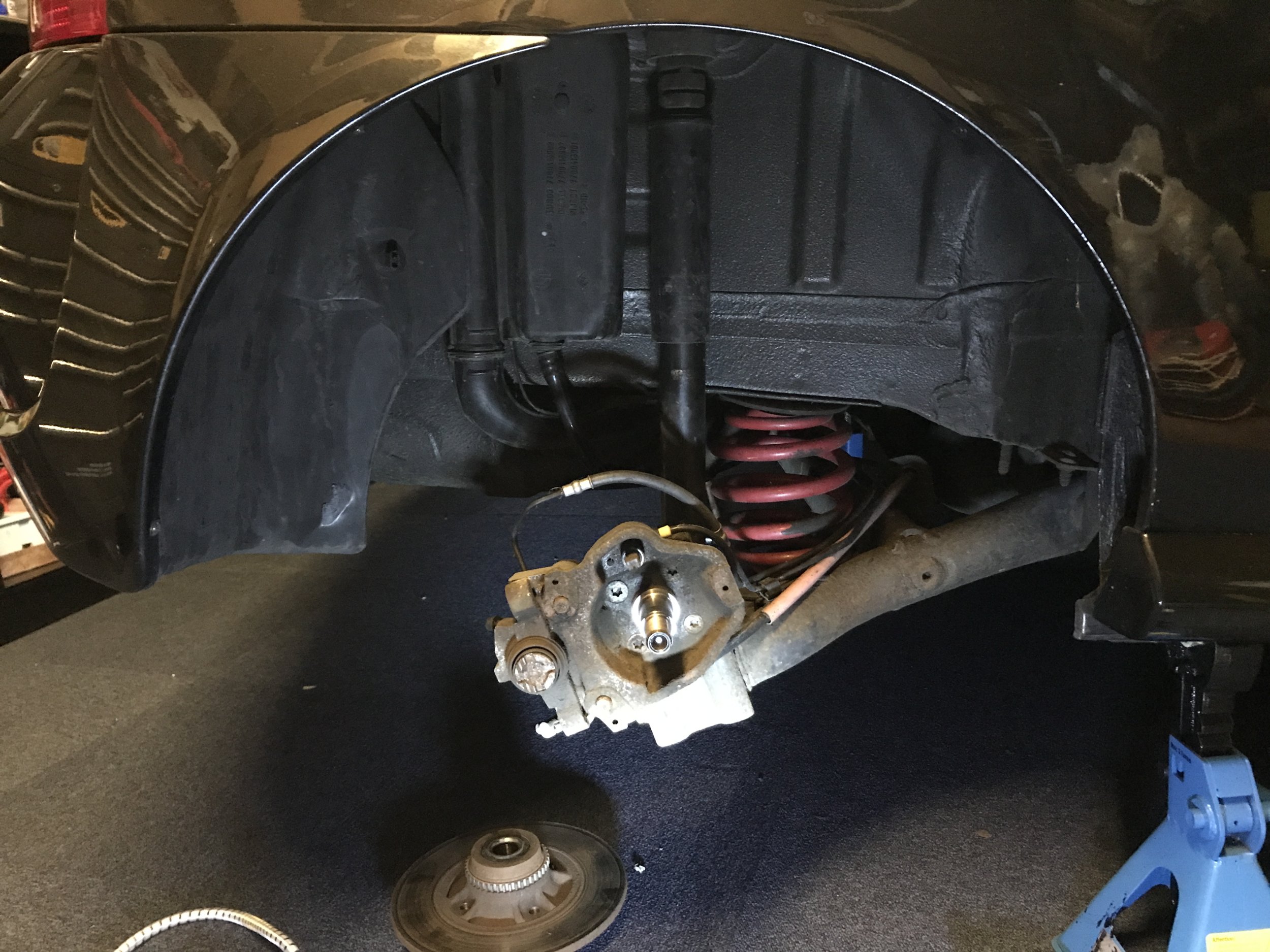

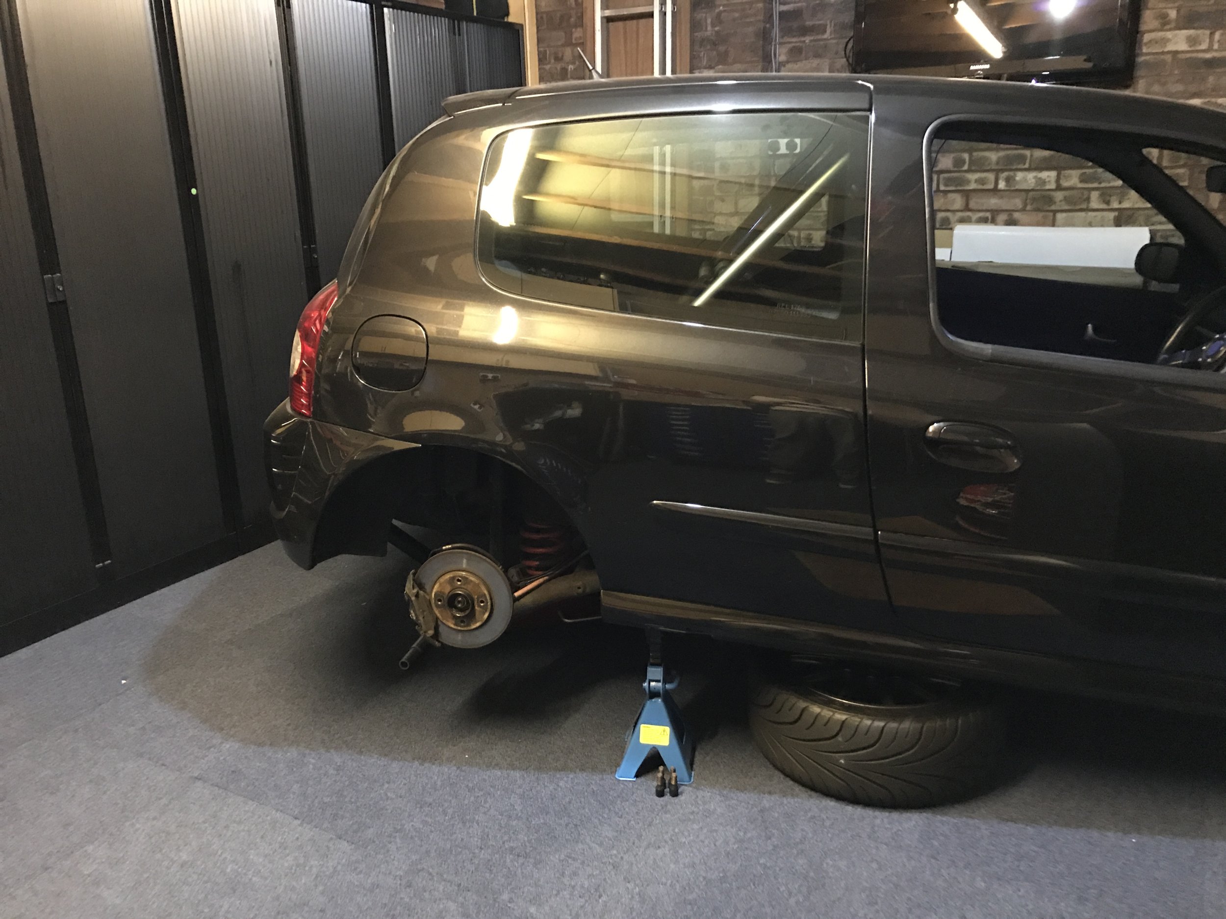

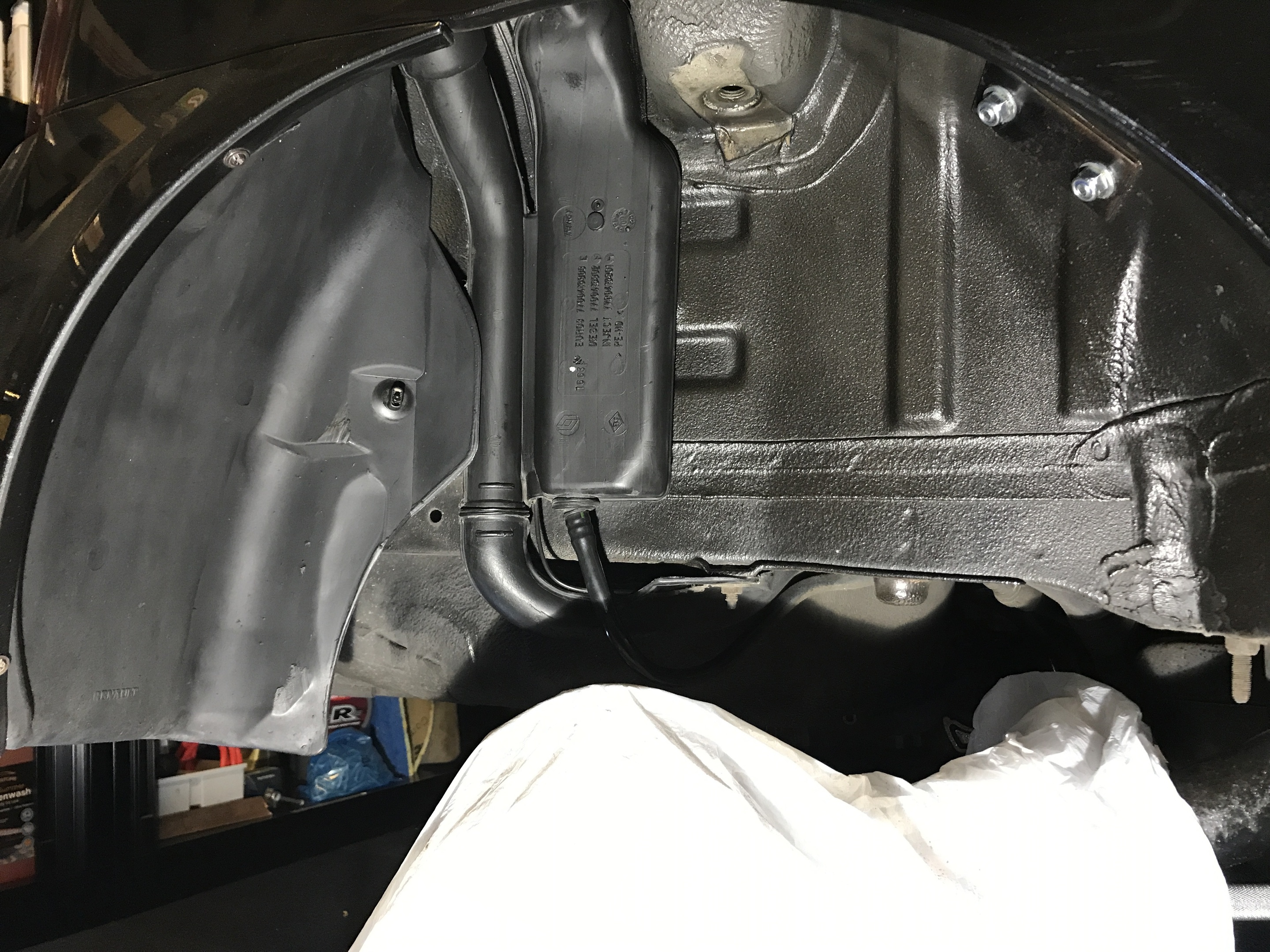

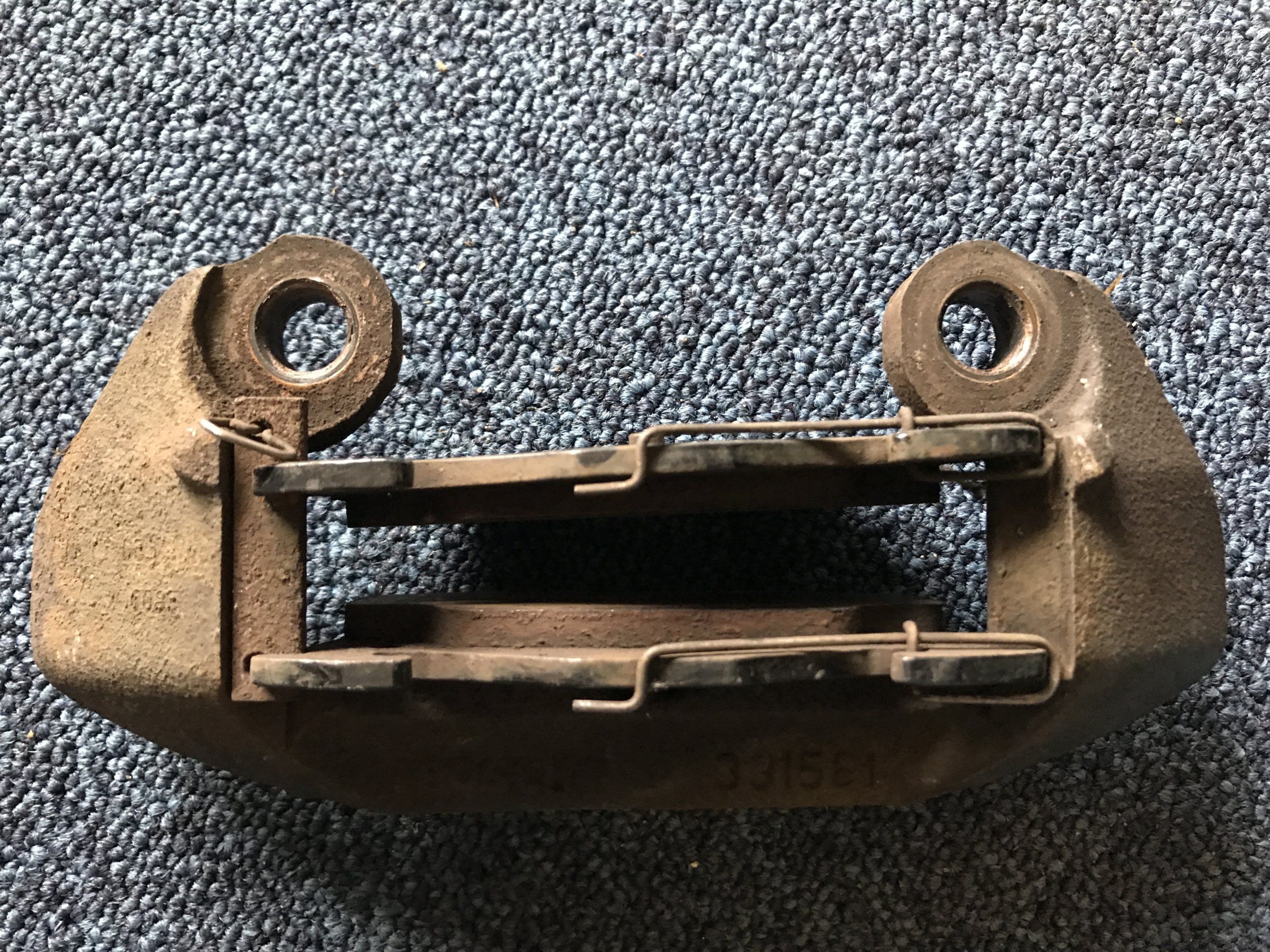

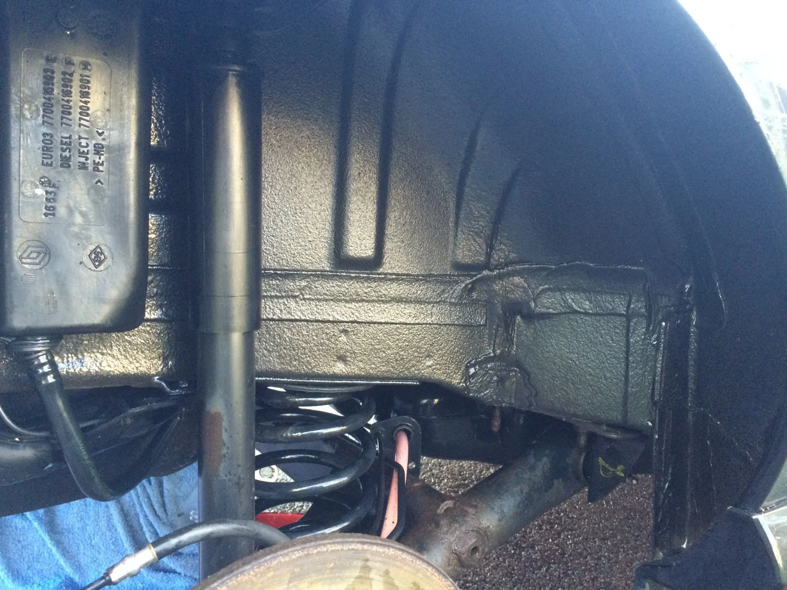

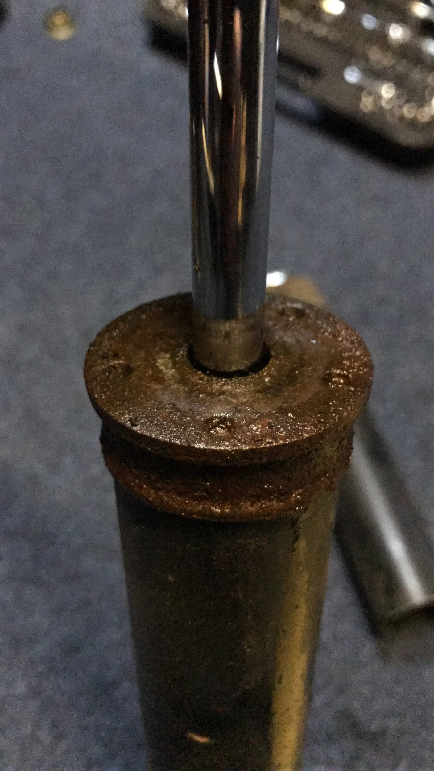

Only had one advisory, which i knew was going to pop up and that was a noisy wheel bearing. The guy before me had fitted Mintex discs, which are s**t. They've done about 6k and the bearing was fucked. I've purchased OEM discs, along with Cup shocks, powerflex upper mounts and new OEM pads. Potentially i'll had Yellow stuff pads in the future, but for now this will do.
Rear end is pretty clean.
Painted the rear calipers to match the front.
One of the rear shocks looked pretty fucked and was leaking. Still seems ok though.
While this is all out i'll treat all the metal with kurust and generally tidy up.

Manged to get the rear end sorted and car back on the road. So much nicer with new wheel bearing, new shocks and solid top mount.
Treated all the metal and gave a good clean. Didn't manage to take many pictures as i was trying to get it all back together.

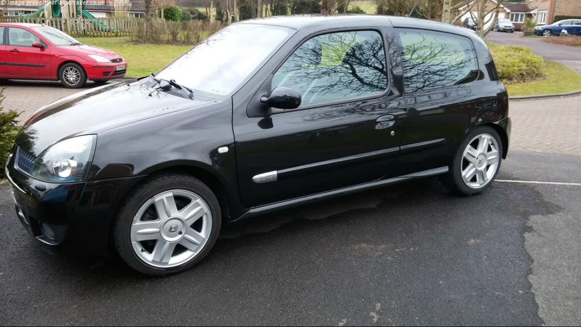

Did have time to try the wife's 19's...
Cleaned up...
Cleaned and used :)

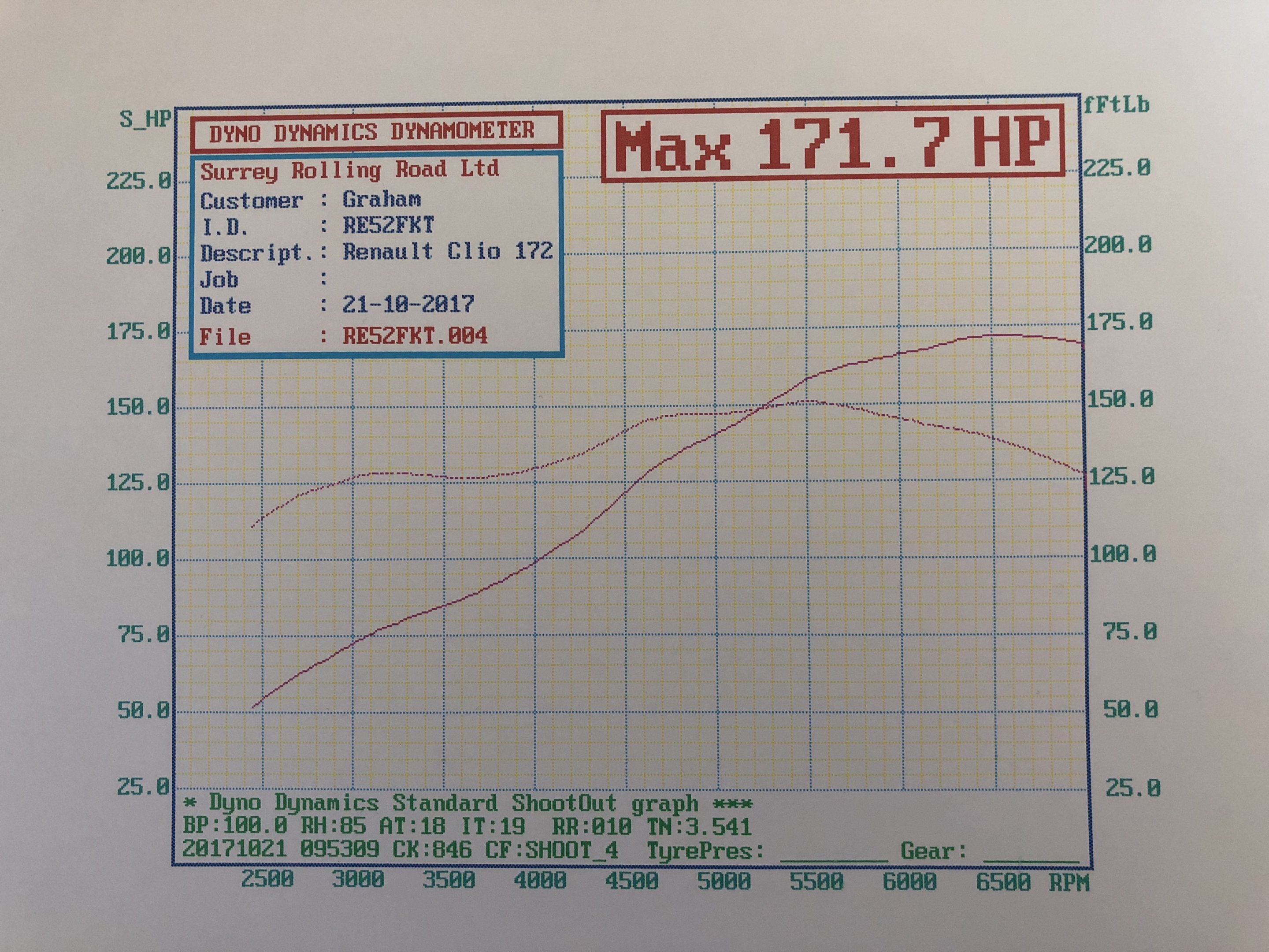

No updates apart from a Rolling Road day to give me some idea of what the car is doing with current mods.
171.7HP
Still not sure what route I’ll take for modifications, but i like to get to around 180/185. Maybe, matched inlets, biggie throttle body and induction? Then remap... I’ll have a good think about this.

The look on Charlie's face said it all this morning mate - nice one.
Cub.
Great project this.
I also went down the “clubsport” route with mine.
Power wise, tbh those are good results. I wouldn’t mess about too much as I’m not sure the benefit is worth the cost unless you go into the charging route.
