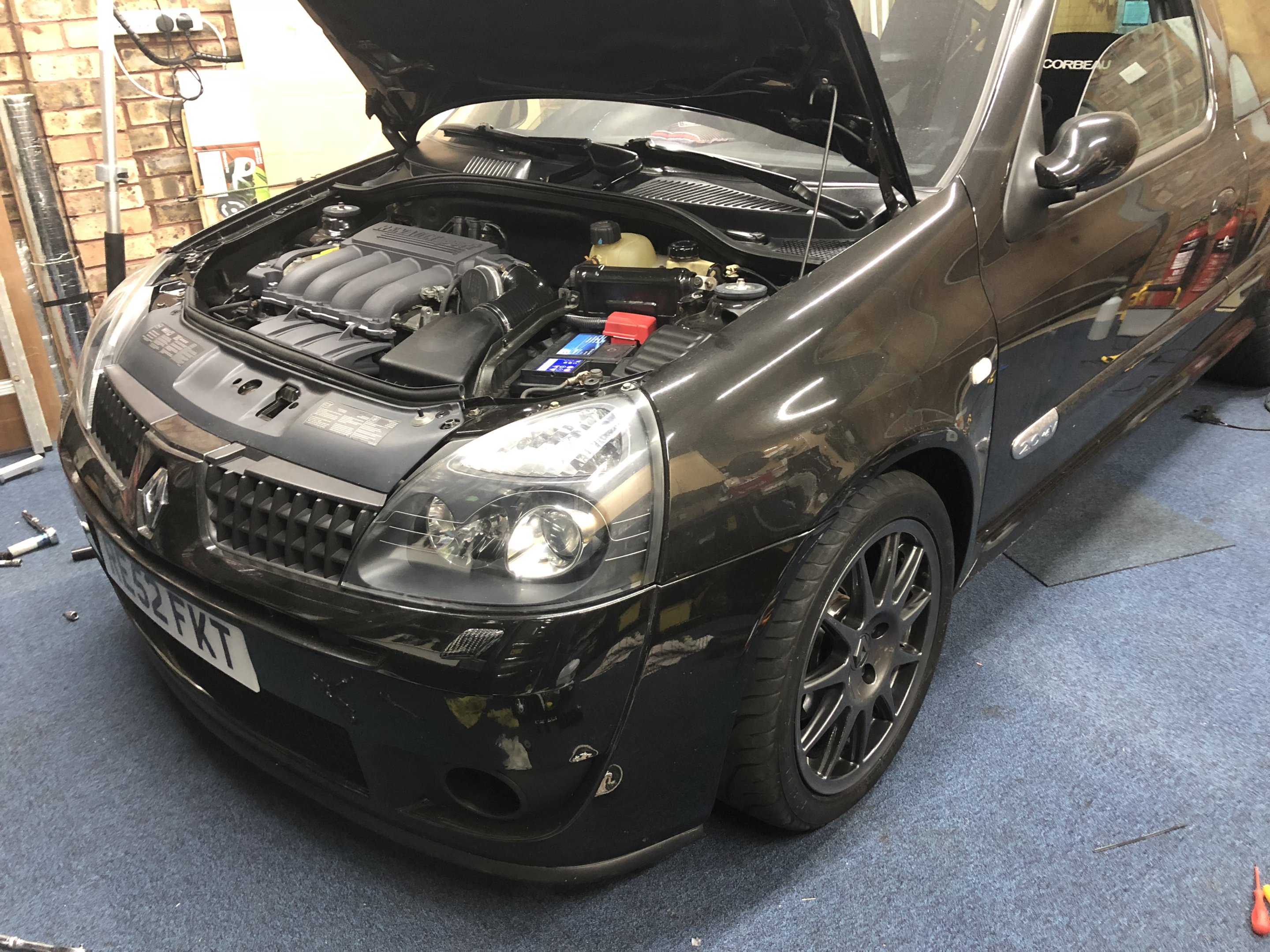

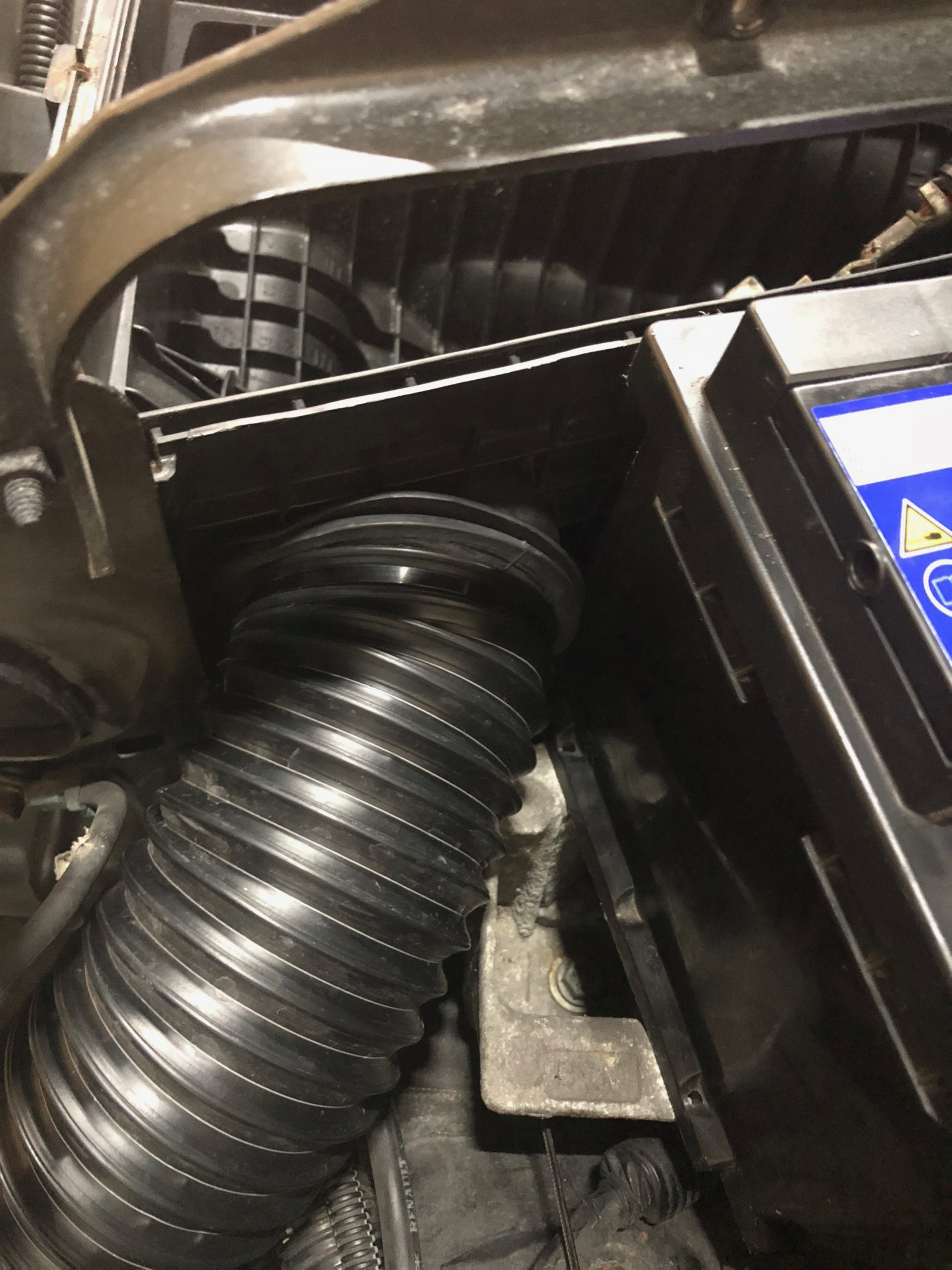

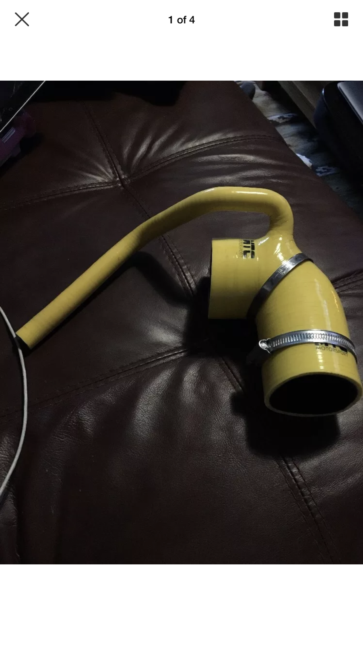

So far i've just manage to take things apart and do a little cleaning... I'm still currently a fan on the original airbox, so for now i've ditched the old airfeed completely and added a larger feed from lower in the bumper. The plan is still to do a little more engine work, but not until the summer.

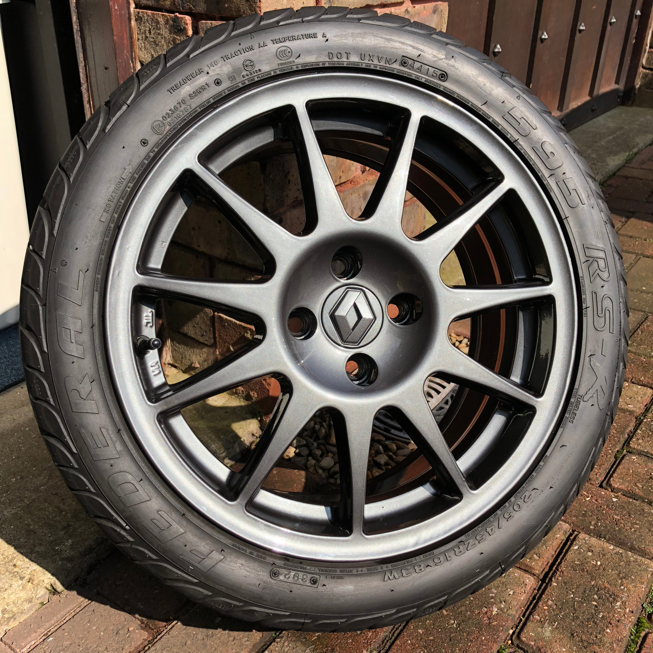

Still one of the best looking wheels for a clio...

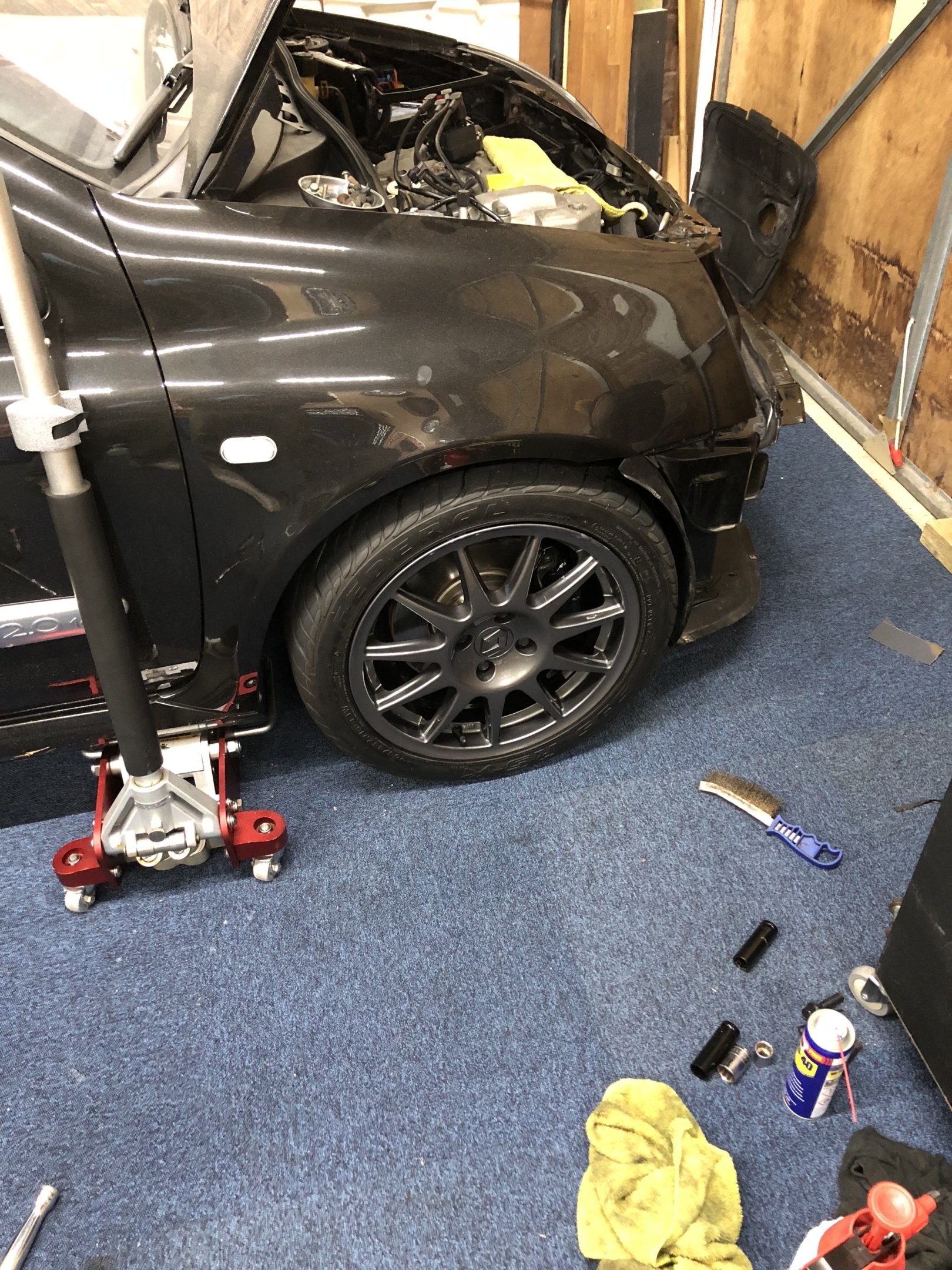

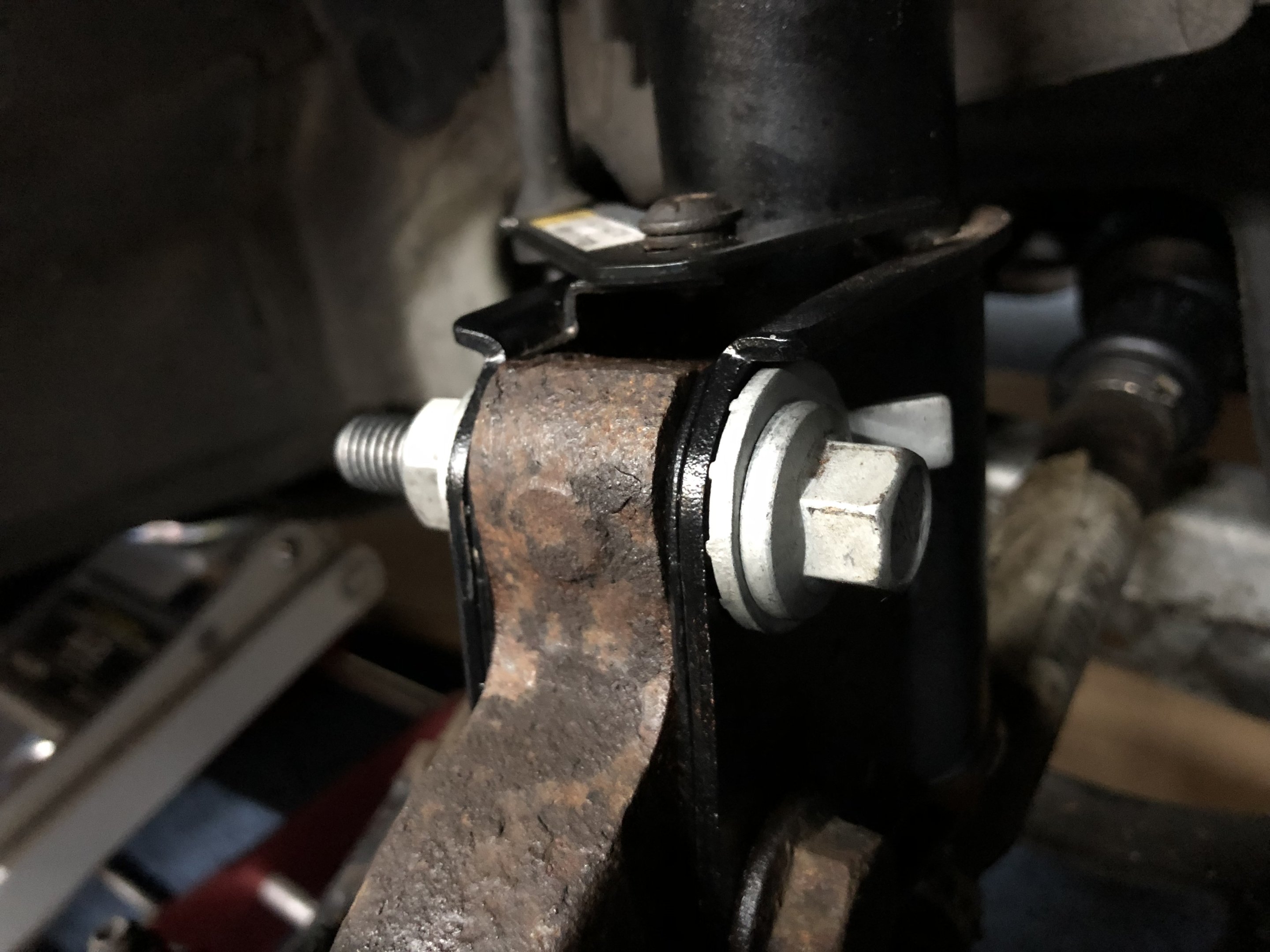

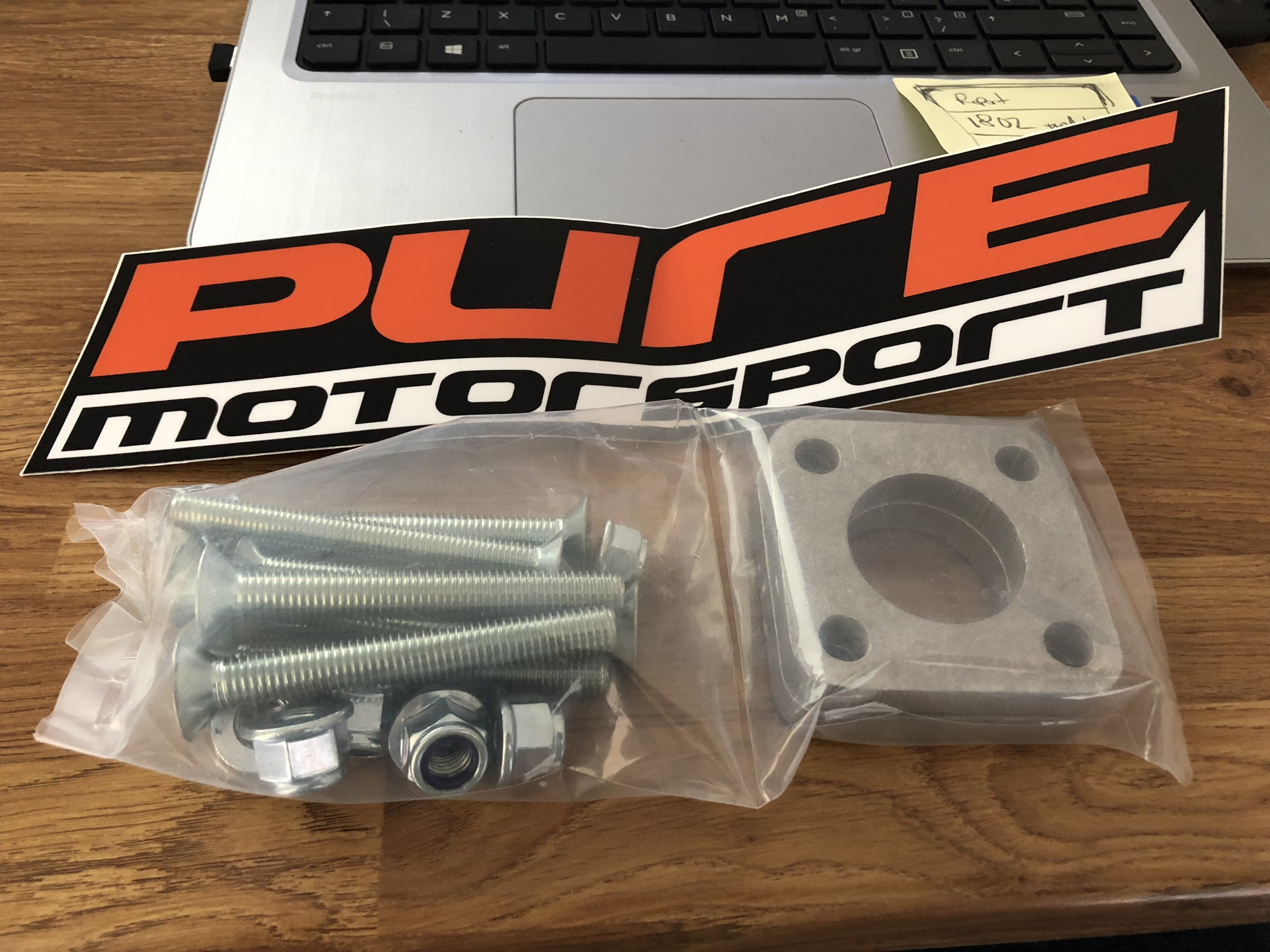

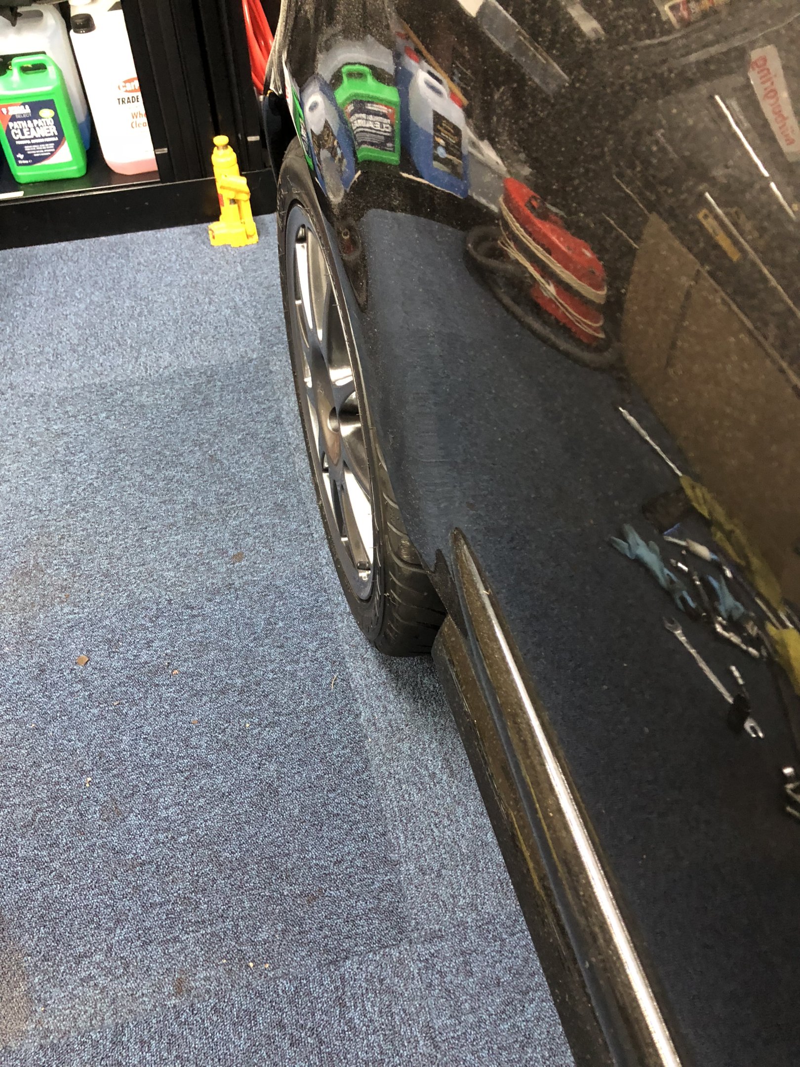

Front camber bolts are now fitted, just need final setup. I’ve purchased a camber tool, so will attempt this at the weekend. I’ve also fitted front spacer. Happy with the look, which is a bonus.
Rear hub spacers on next.

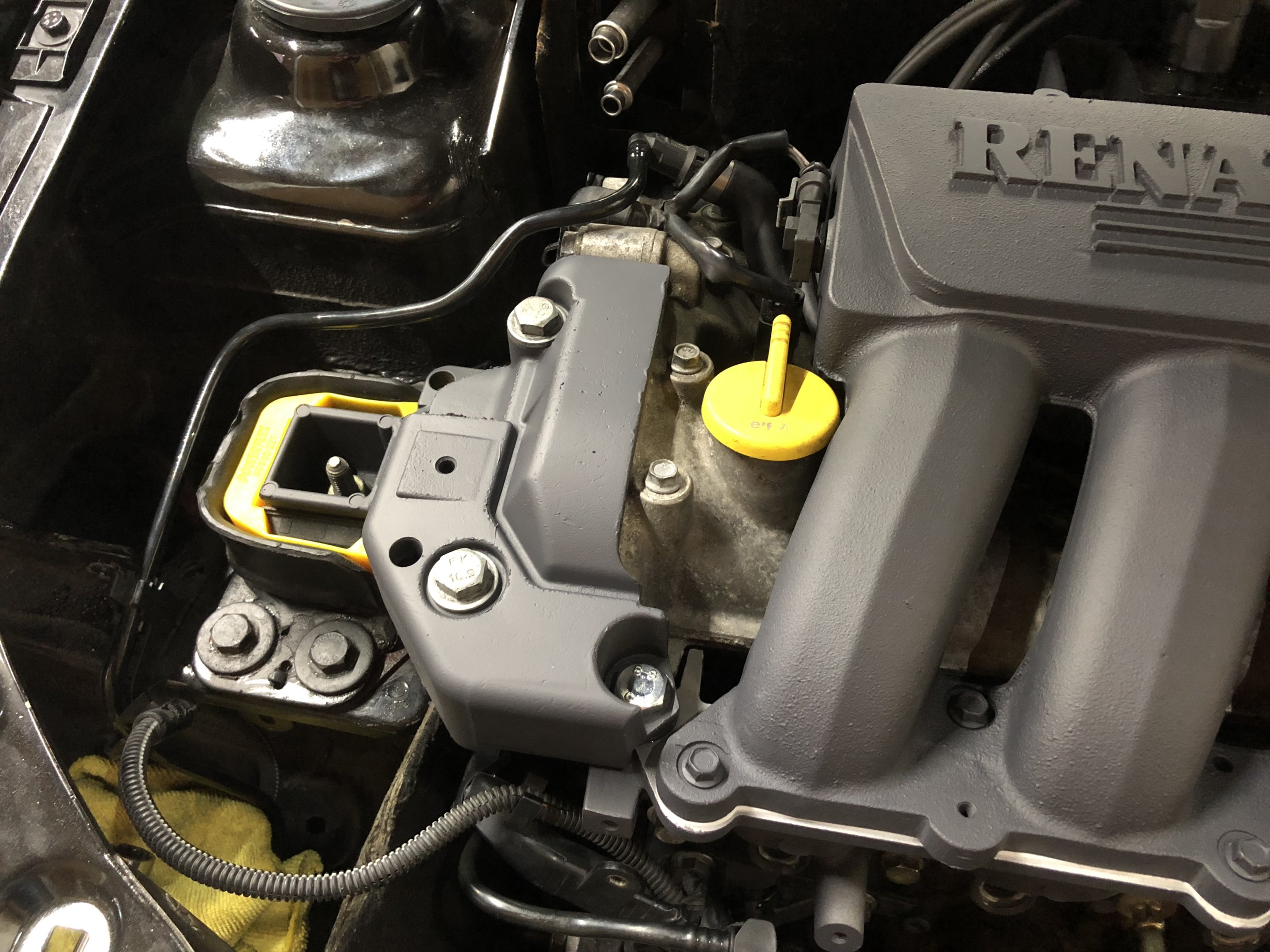

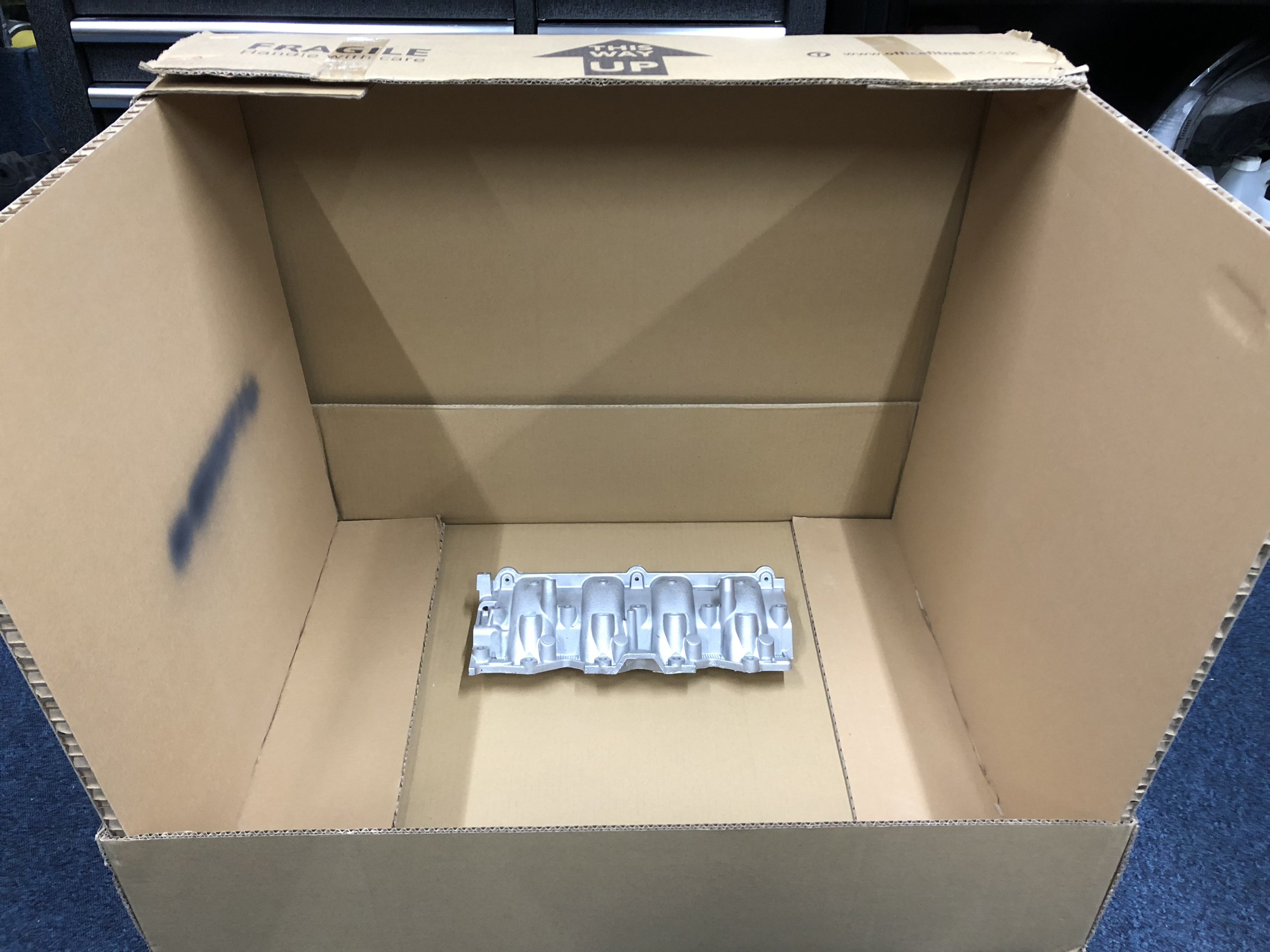

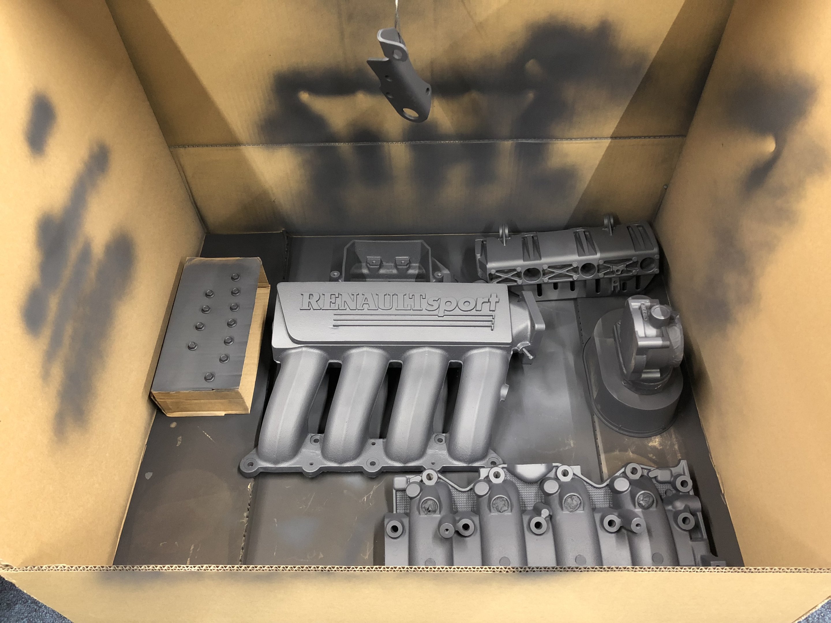

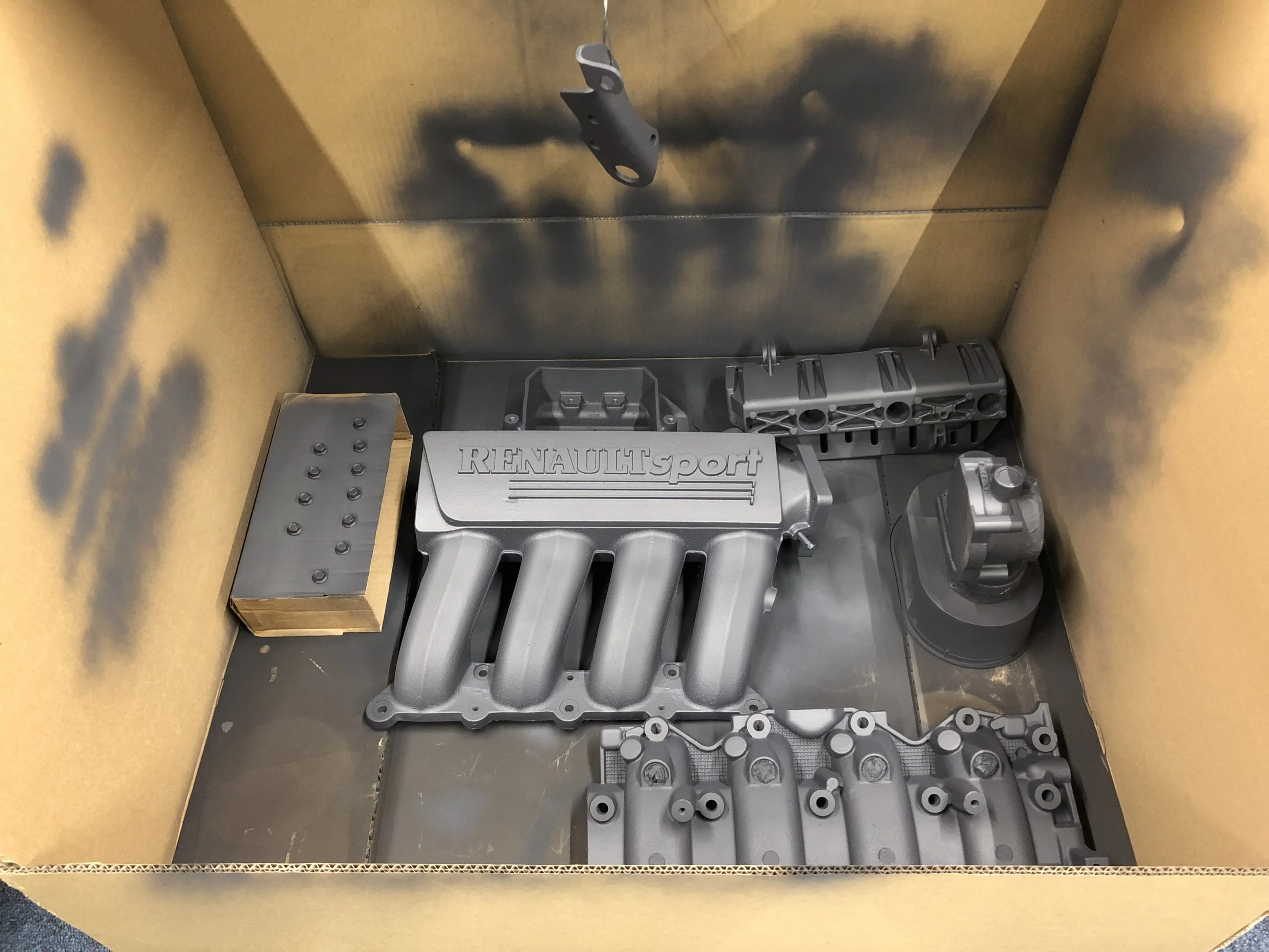

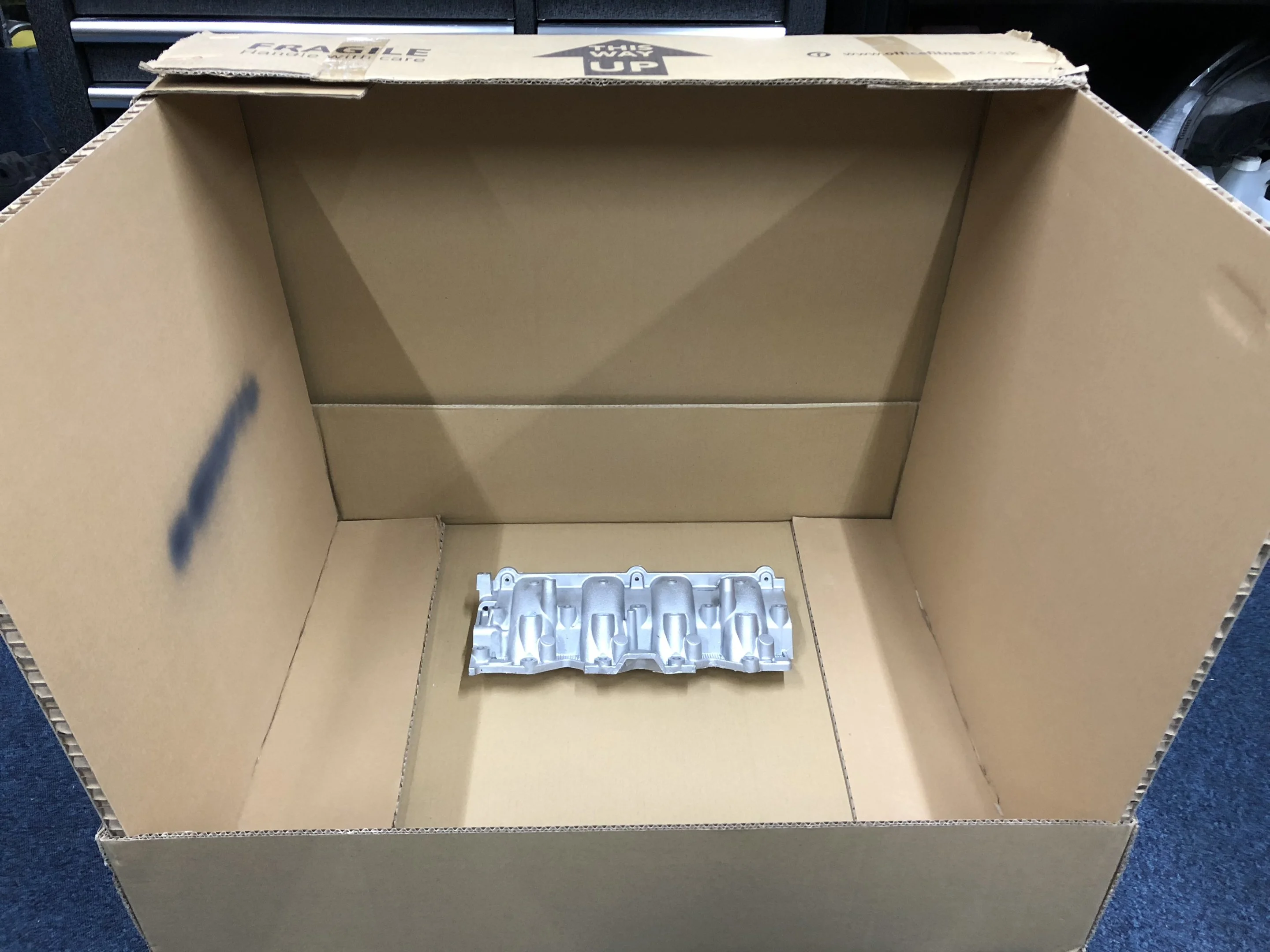

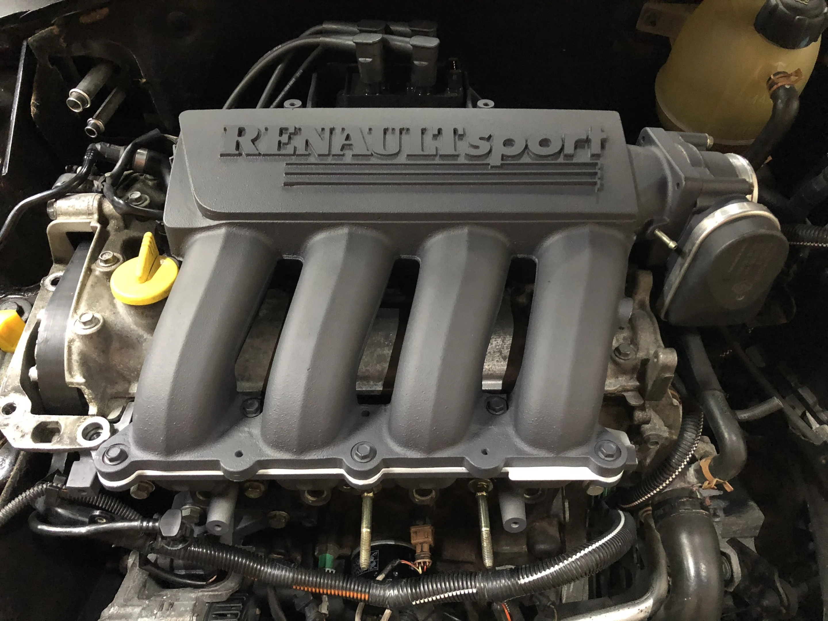

Managed to spend some time this afternoon getting a few things done. Picked up a ported inlet from @JKING3008 so thought it would be a good idea to paint that along with all the other engine parts. Happy with the result as I wanted a nice matte finish.
Made my own paint booth
Painted parts:

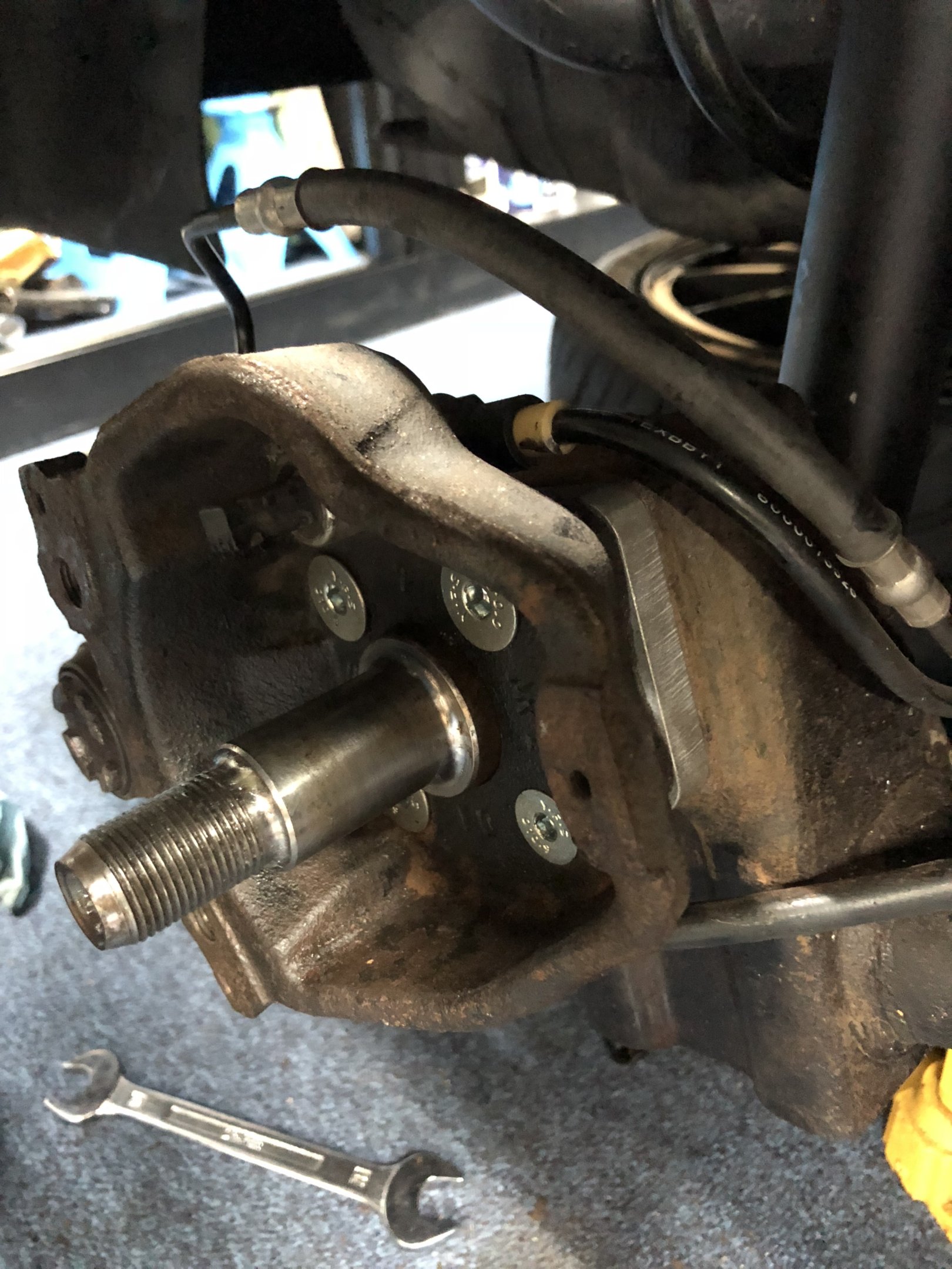

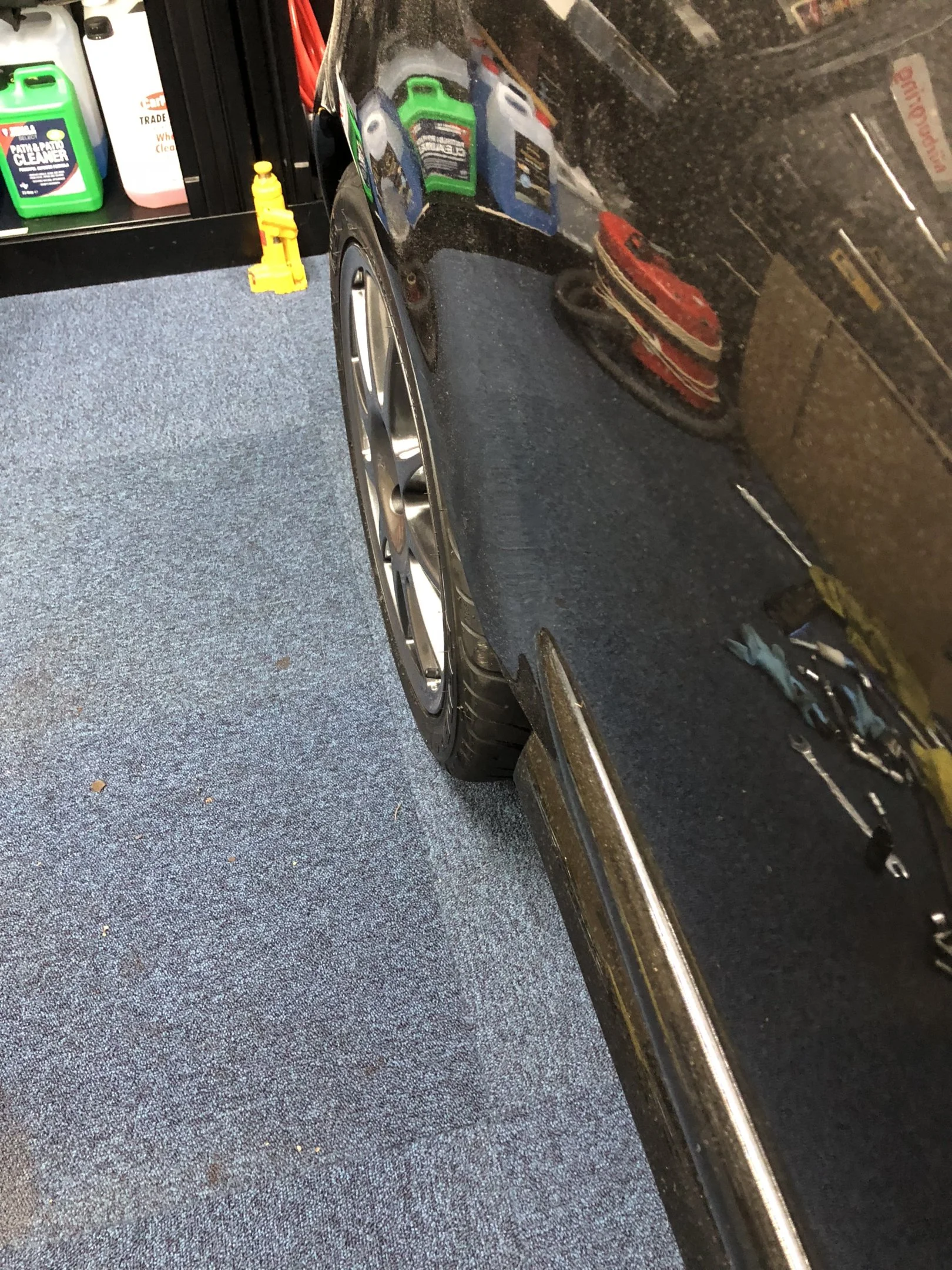

Also managed to fit one side of the hub spacers.
Happy with how they sit, which is an added bonus

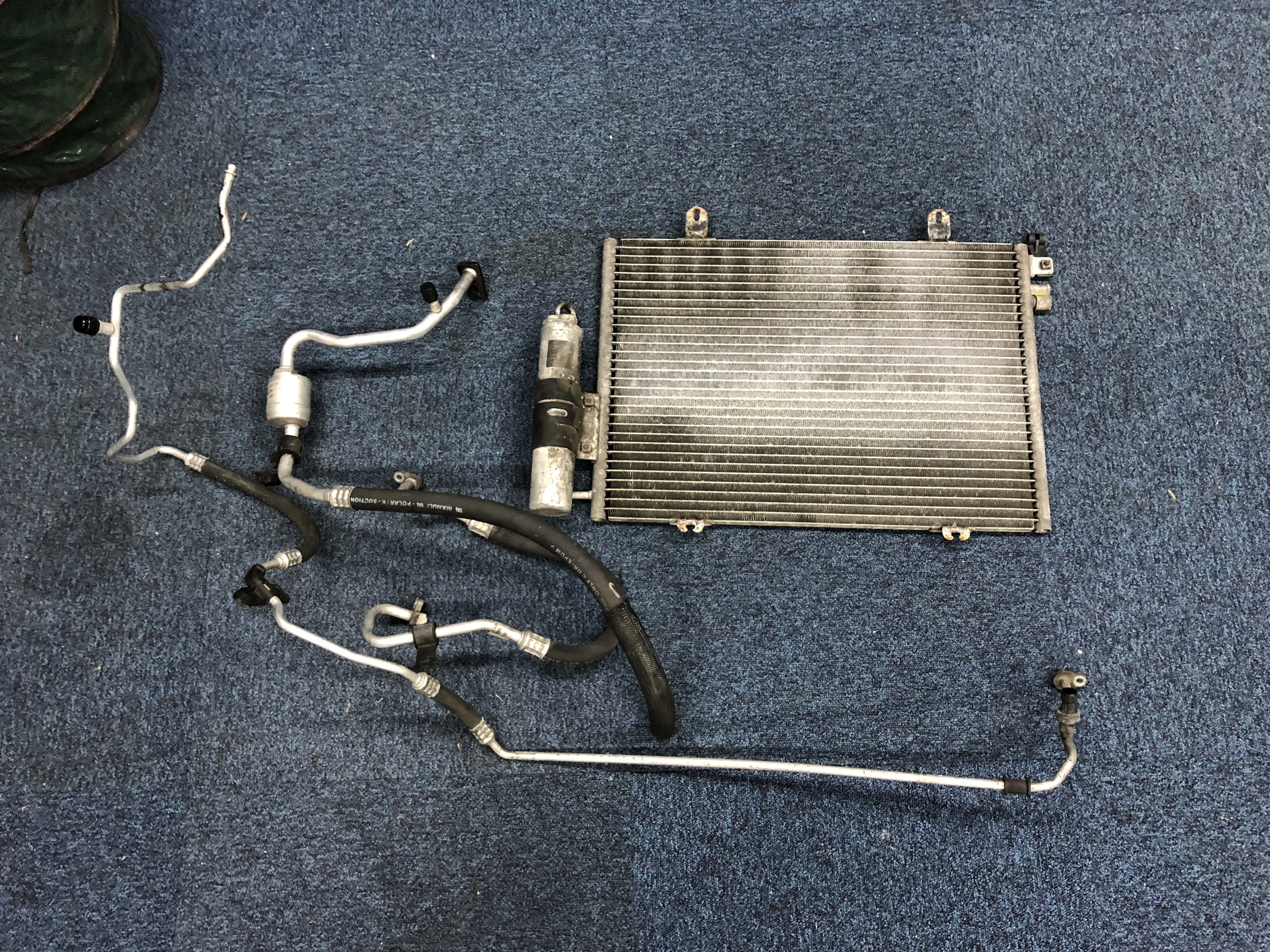

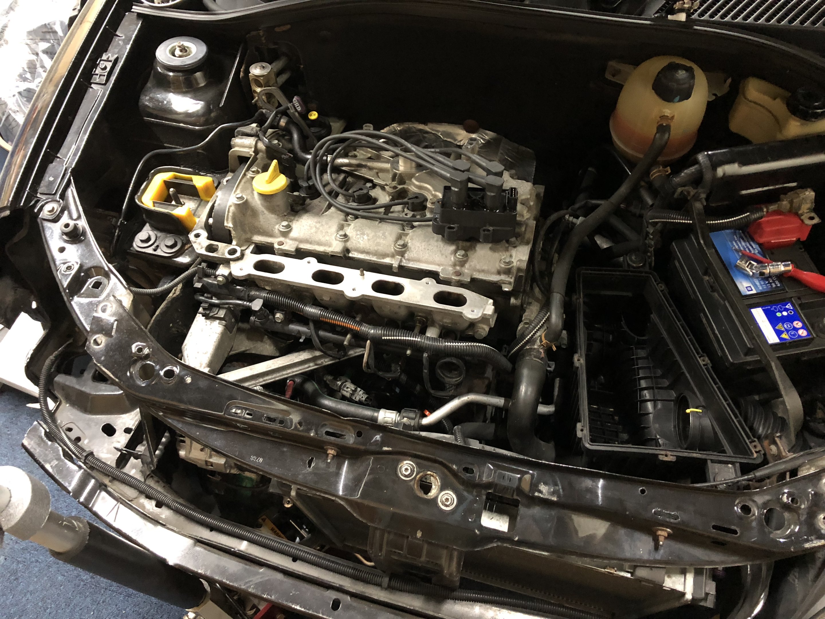

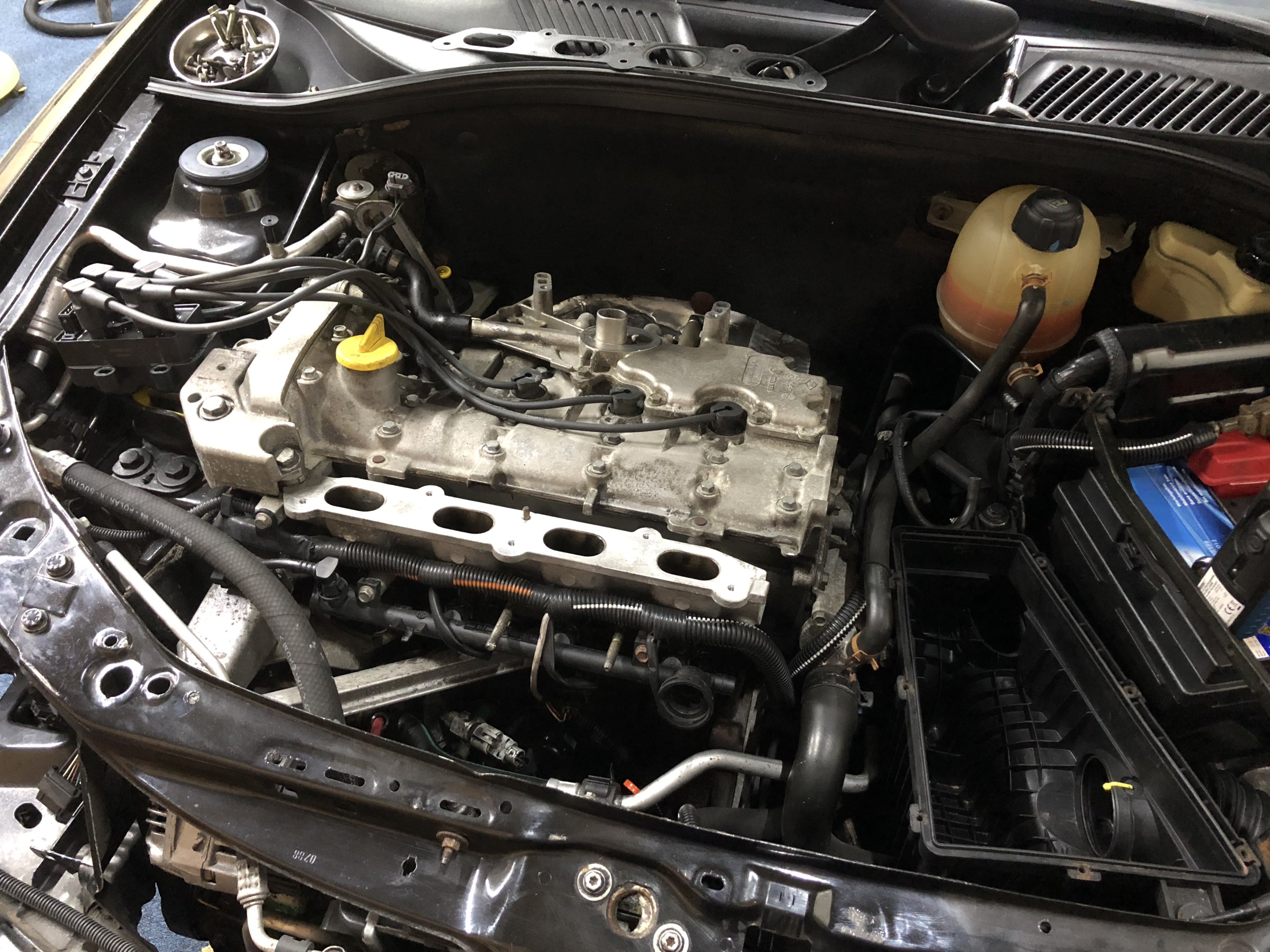

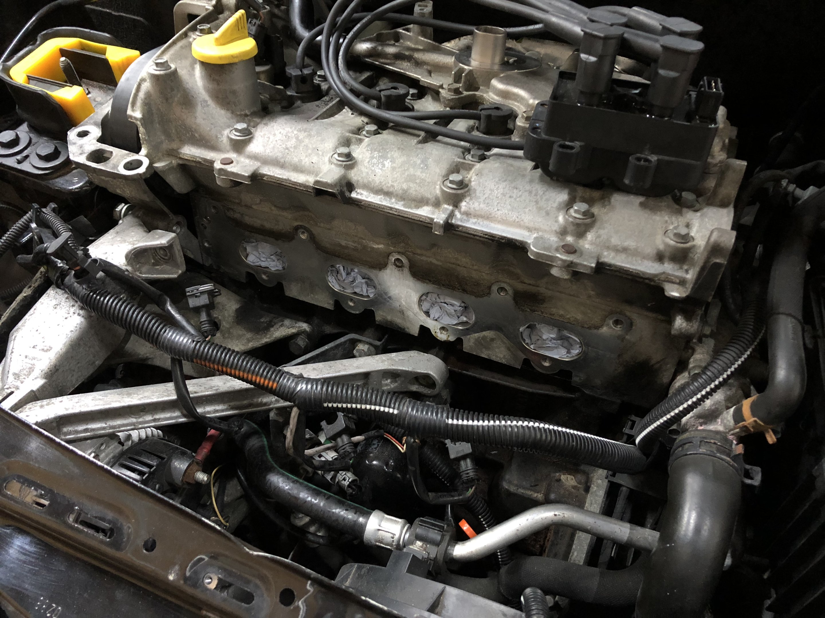

Managed to get some more done tonight. Half of the AC is now out without breaking anything.
As I don’t have the AC delete kit yet and I don’t want to start removing the compressor until it’s here, I made a start on removing the inlet. It’s pretty easy except for the side bolt and how tight it is against the pig iron brackets. I guess I’ll need to file down that a little to get the ptfe gaskets in.
Next up is making the call on removing he compressor before my trip. Slowly running out of working hours.
  RS 172
Don’t have enough time to take the AC part out that is under the scuttle panel, it looks a nightmare! So I decided to change the filter and hoover out a lot of dust and s**t. I’ve still got two pipes poking out, but I guess I’ll just cap them off.

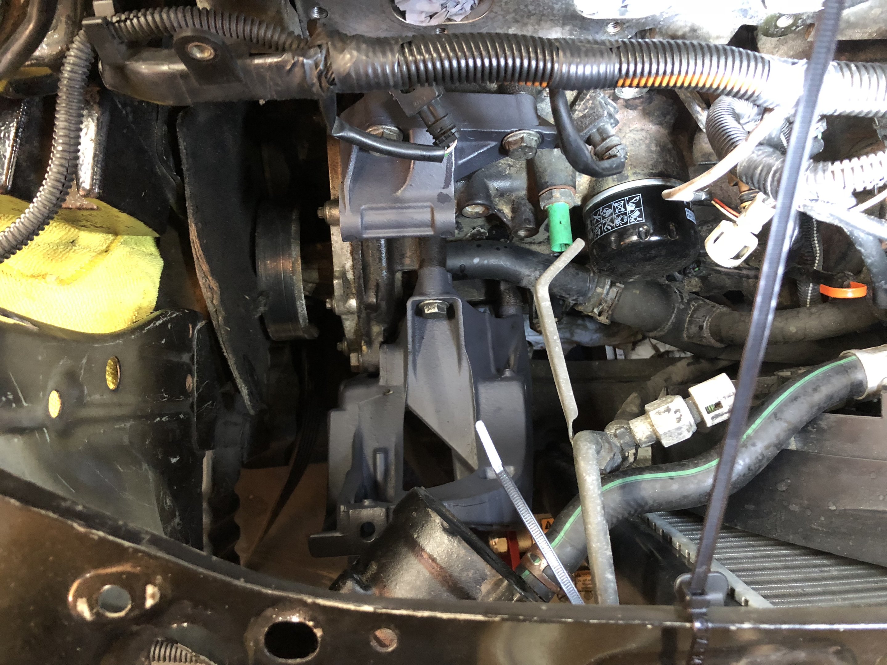

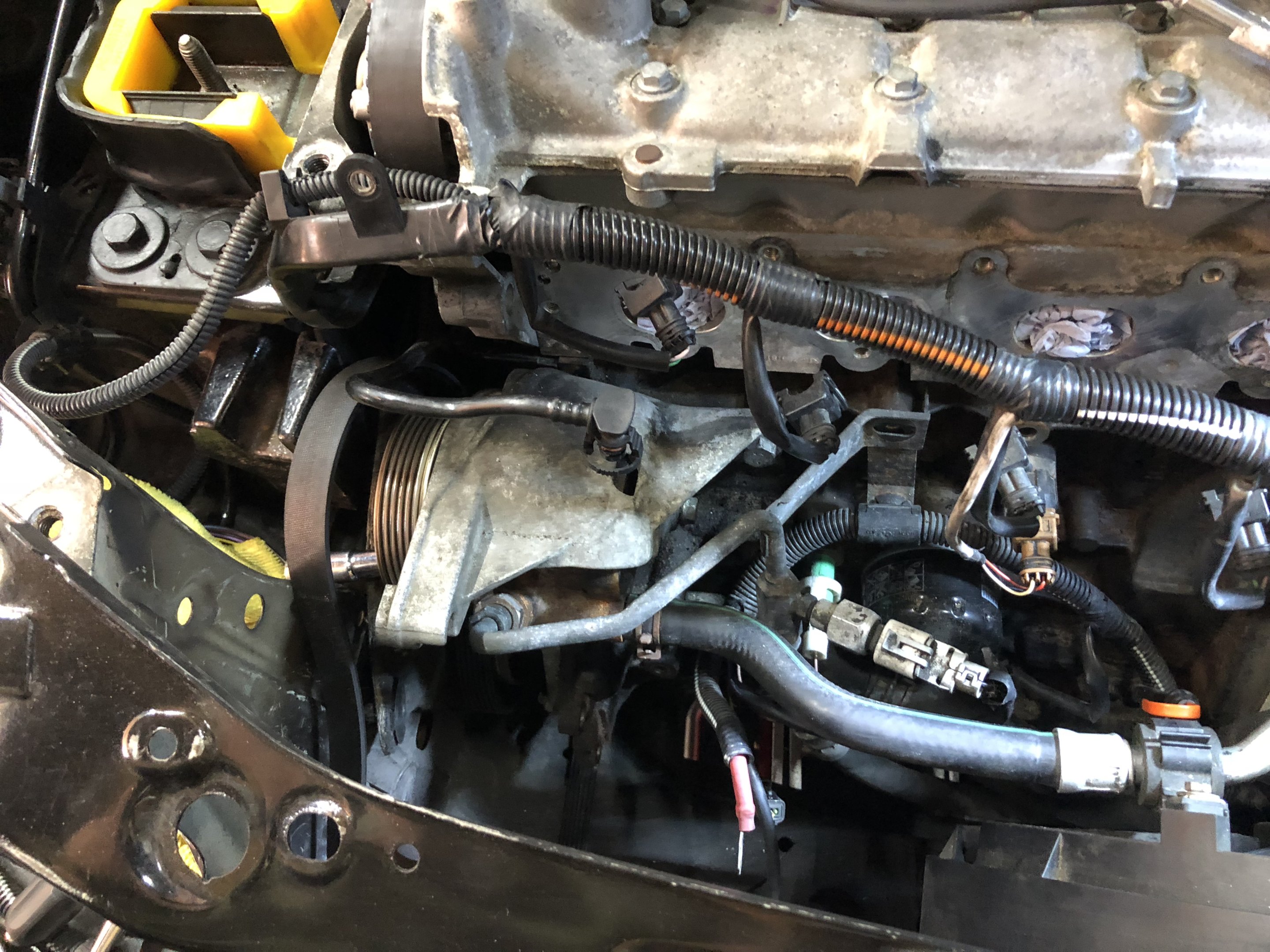

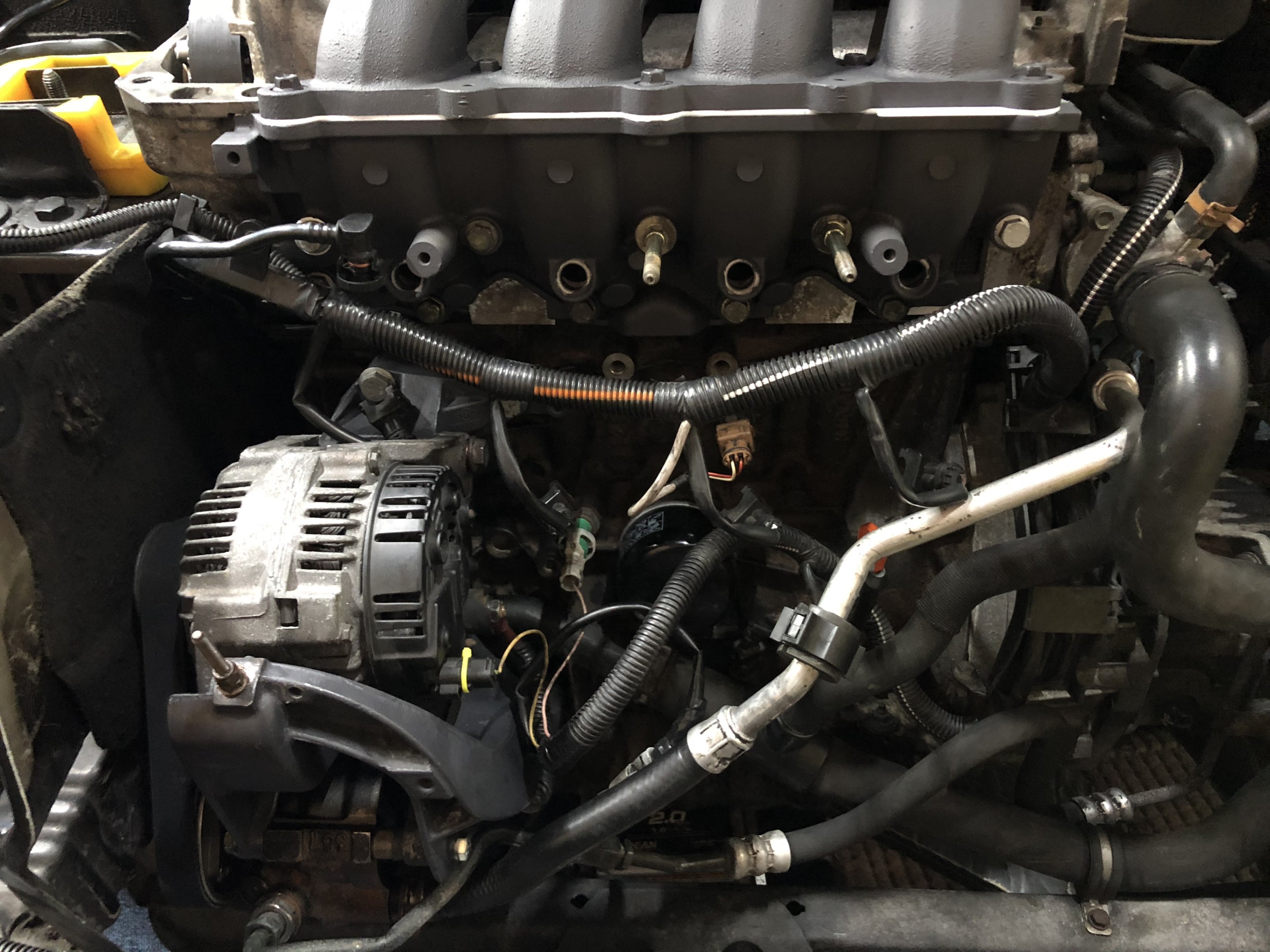

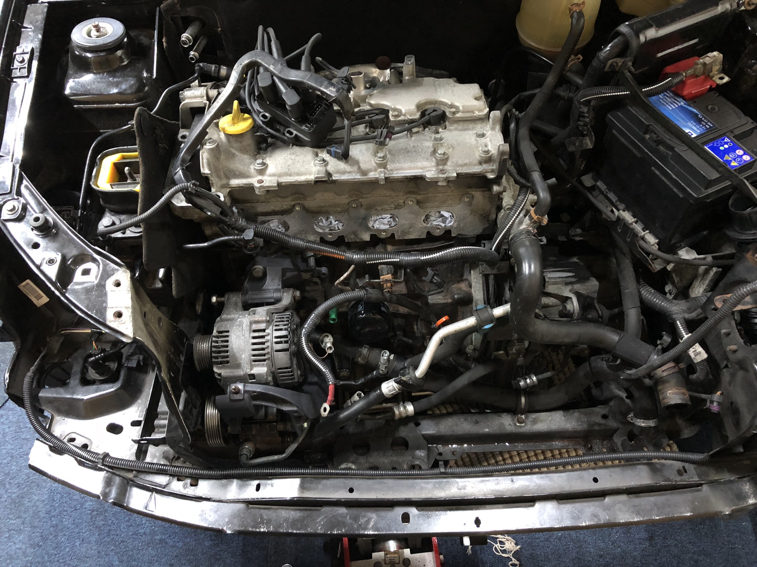

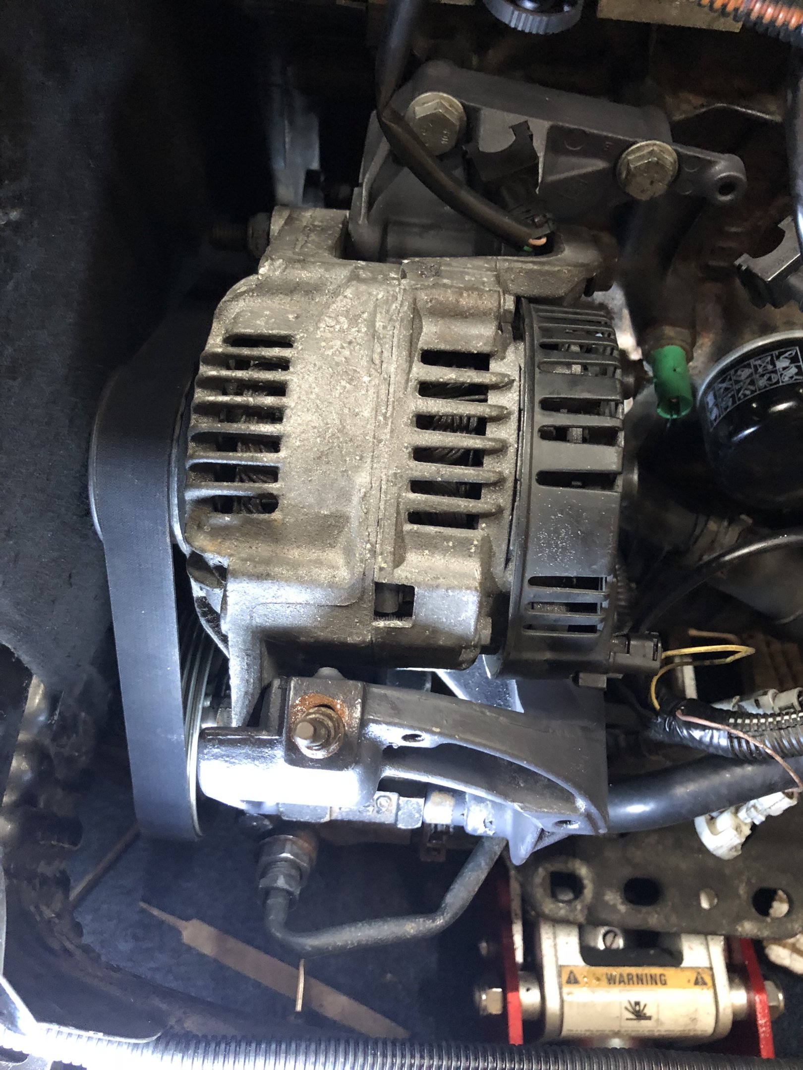

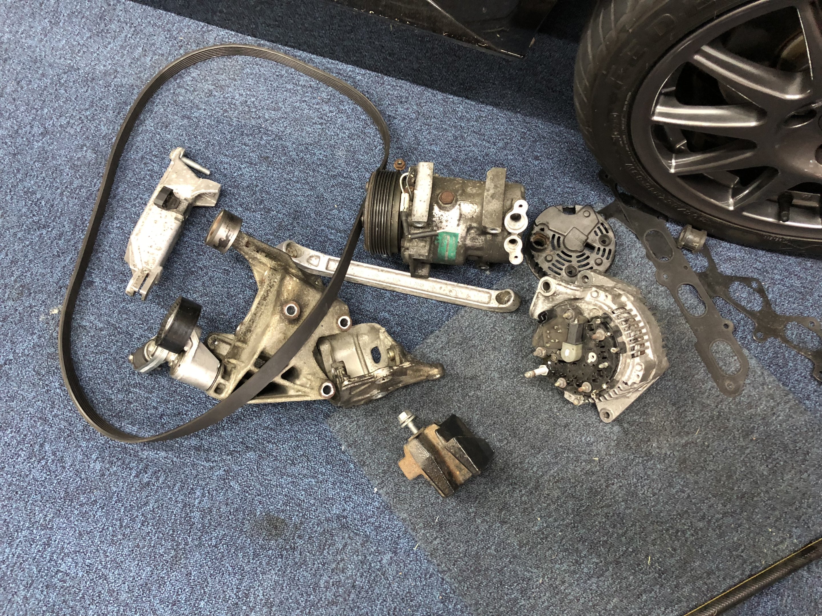

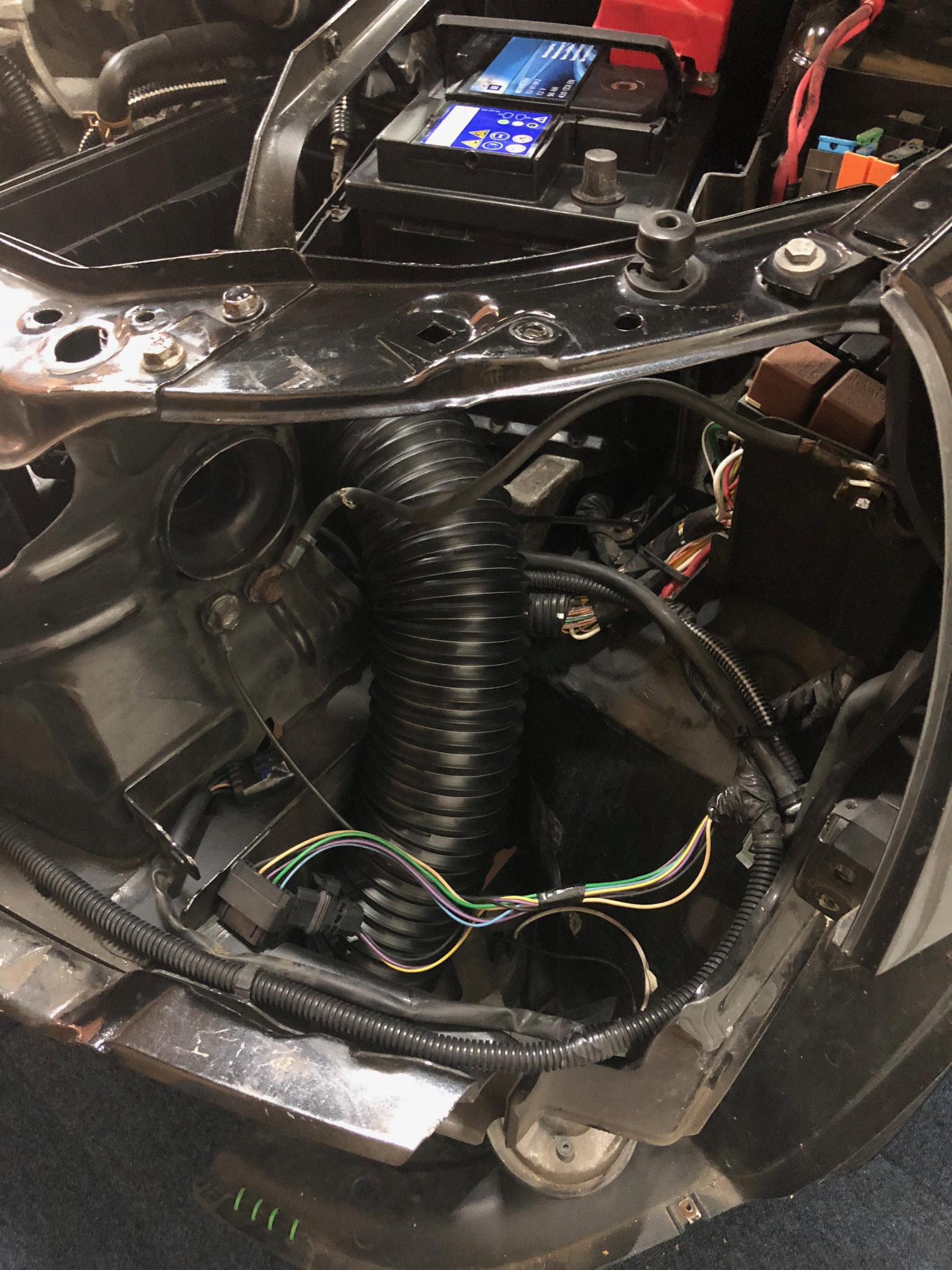

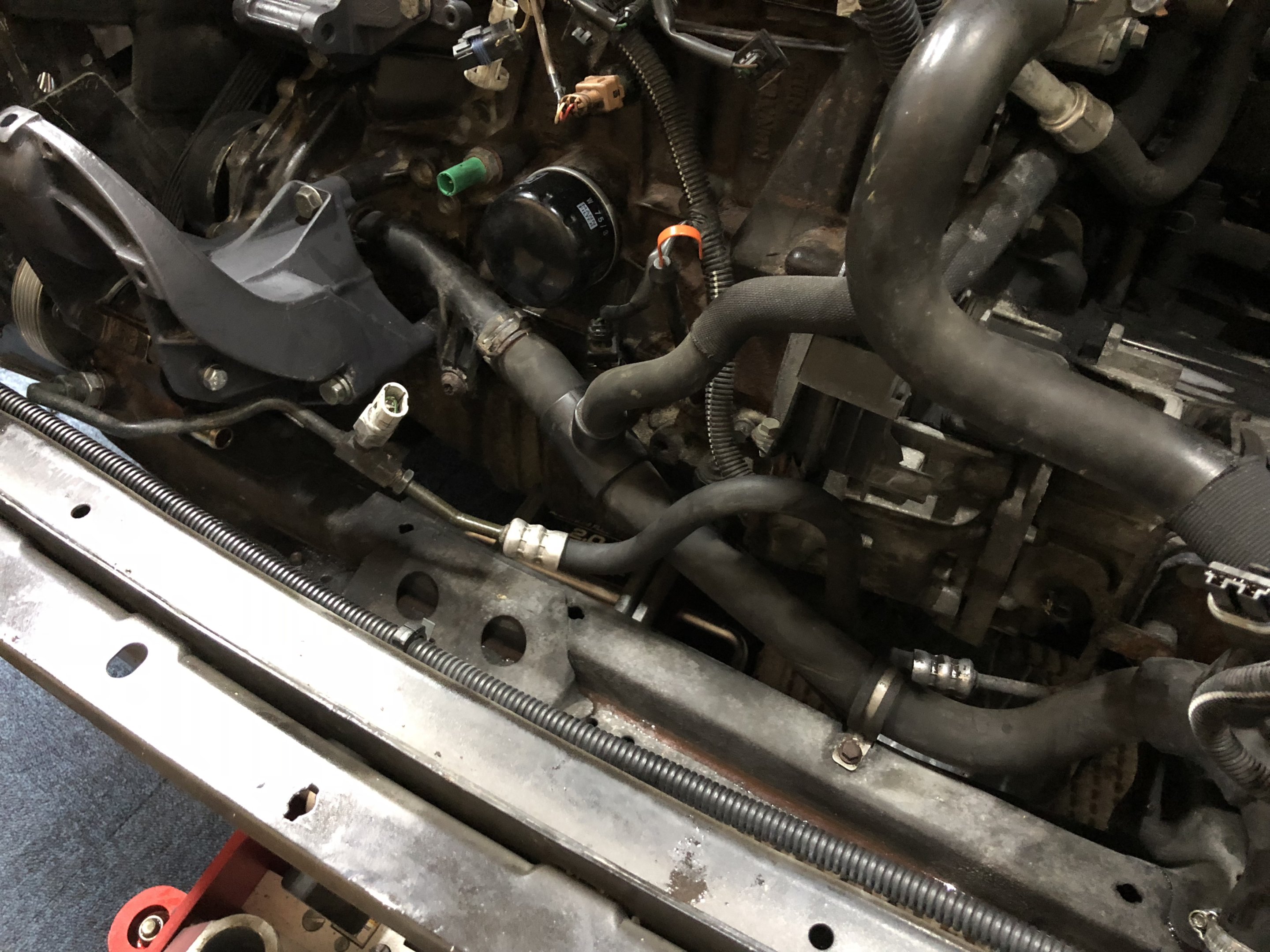

It turned out to be an extremely long day, had to remove a lot more of the car than I thought to get the FF power steering alongside the cup AC delete kit. I think I’m nearly there with it and have it routed nicely. Just need to start putting things back now.
The strip down of old parts starts ok..
New alternator brackets went in easy, but then I noticed that I couldn’t get the pump in without disconnecting the pipes.
After a few more hours and removing the radiator I’d come up with a nice route for the pipe to take. Took a fair bit of gentle bending, but now is ok. Just hopefully now leaks!
Top pipe reconnected and alternator in. Just need to make sure none of the pipes rub.
Hopefully now I can start getting parts back on.

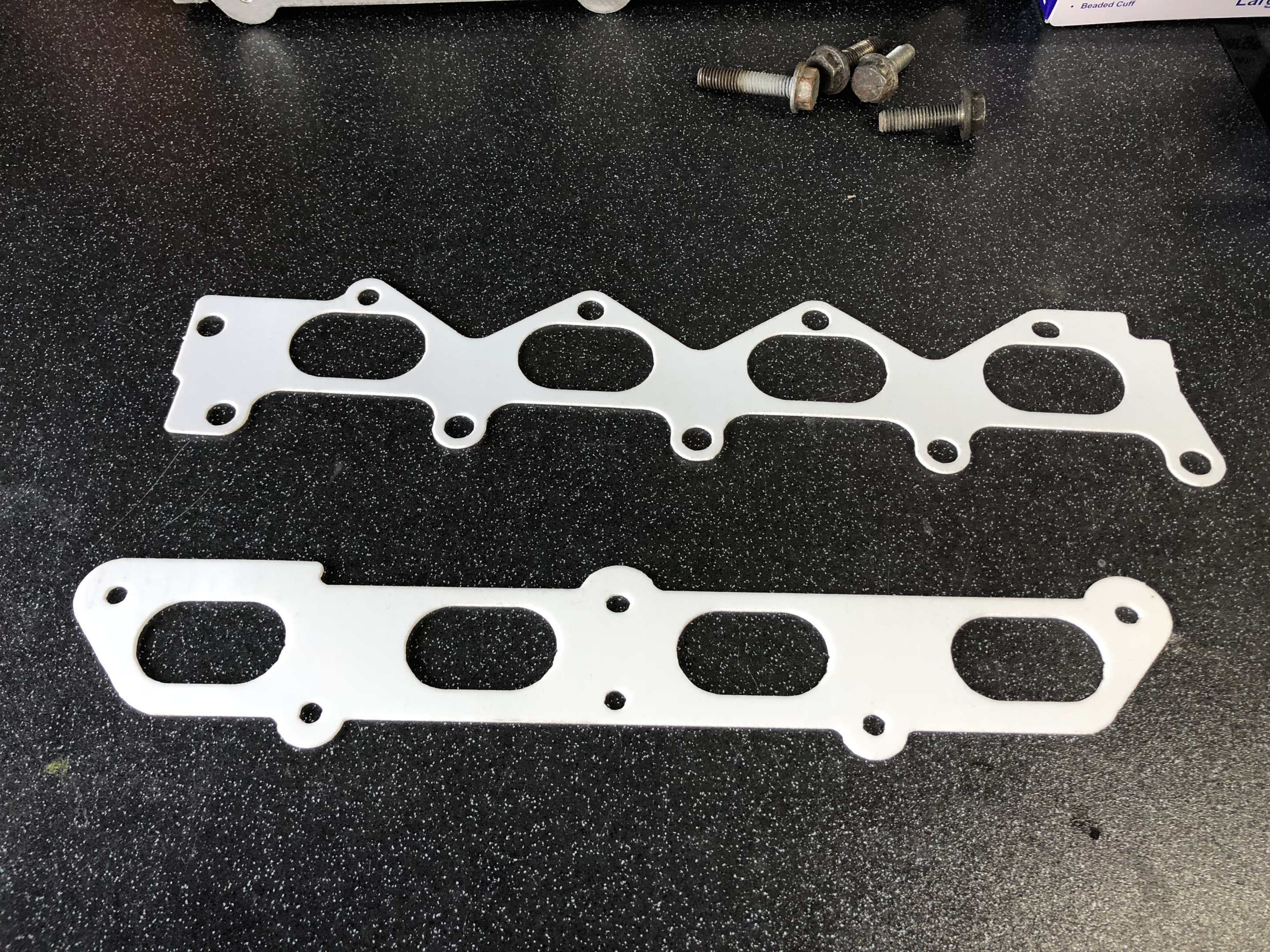

Picked up these lovely PTFE gaskets from KTec. Hopefully they’ll make some difference.

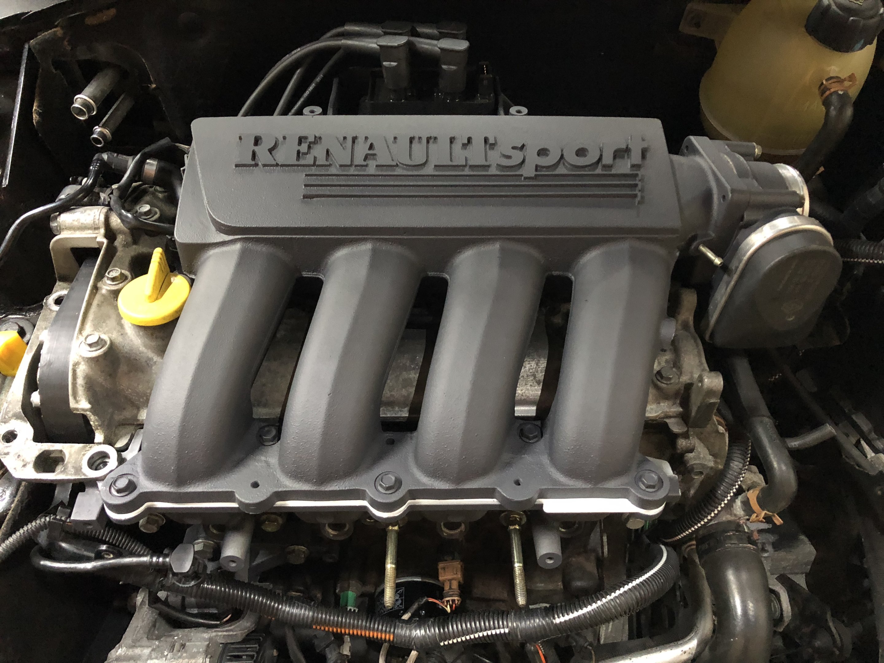

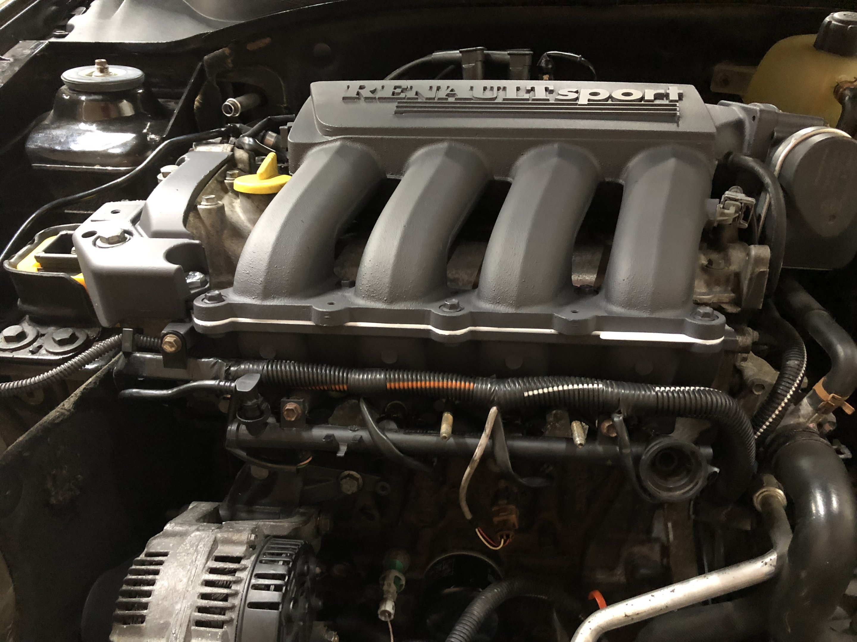

Lower and upper inlet manifolds refitted.

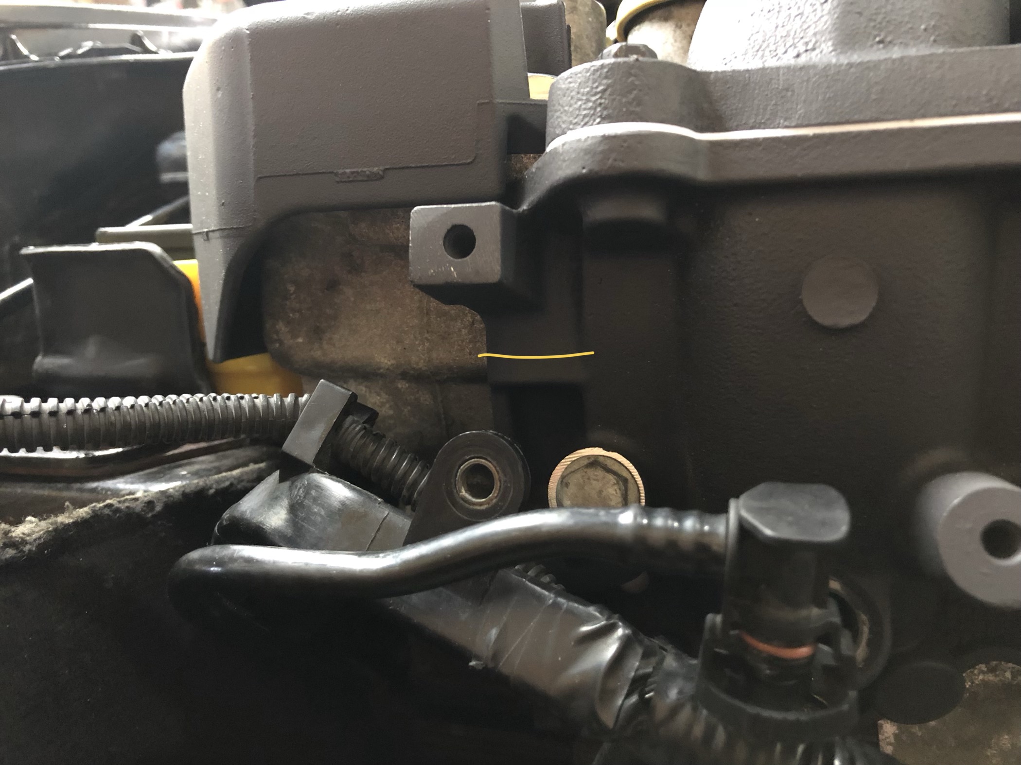

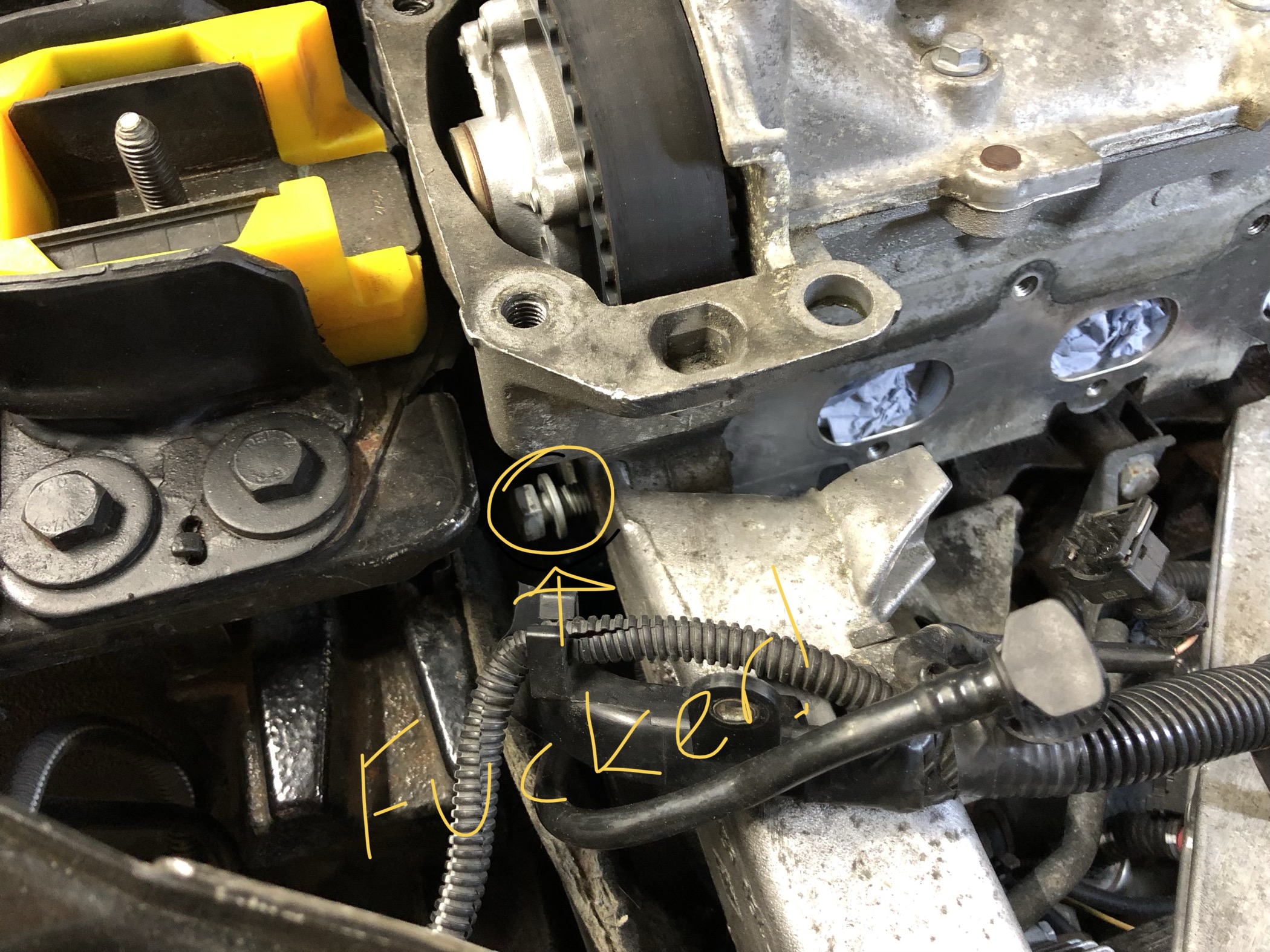

Bolted some more bits back on. Mainly the engine mount, had some fun as one of the bolts (the one that goes through the inlet) decided to thread at the very bottom. I’ve marked where it fucked up. I’m going to run a tap through it, but for now I’ve put a slightly shorter bolt in.

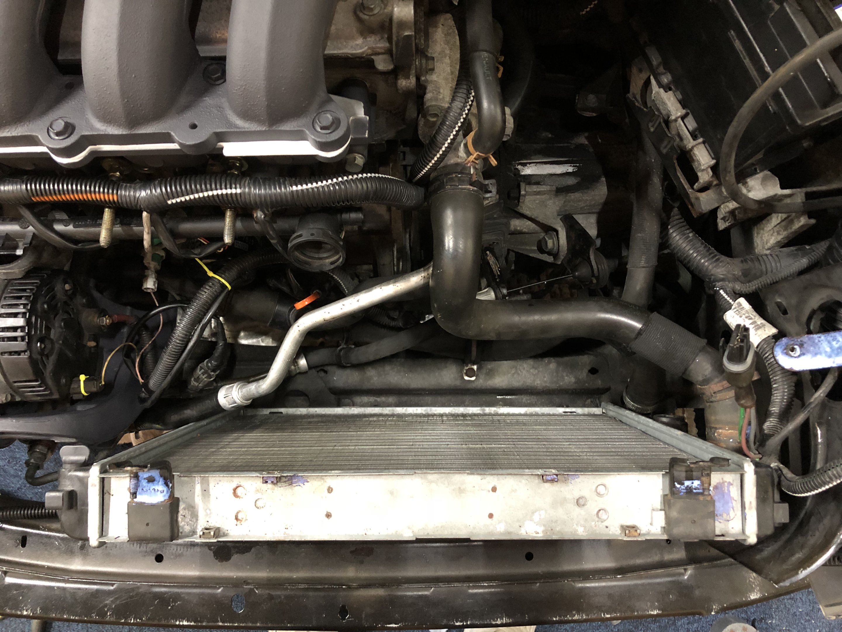

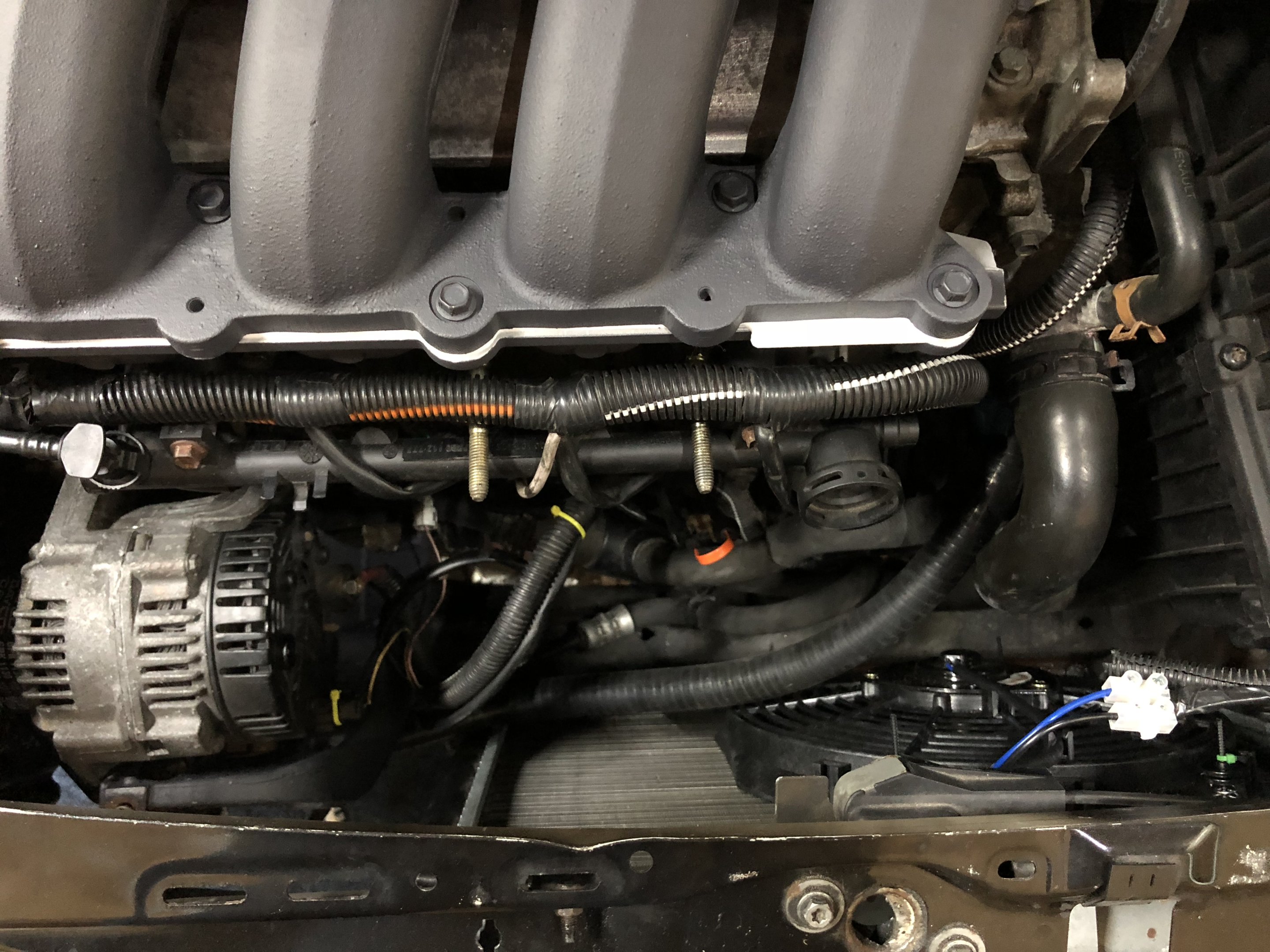

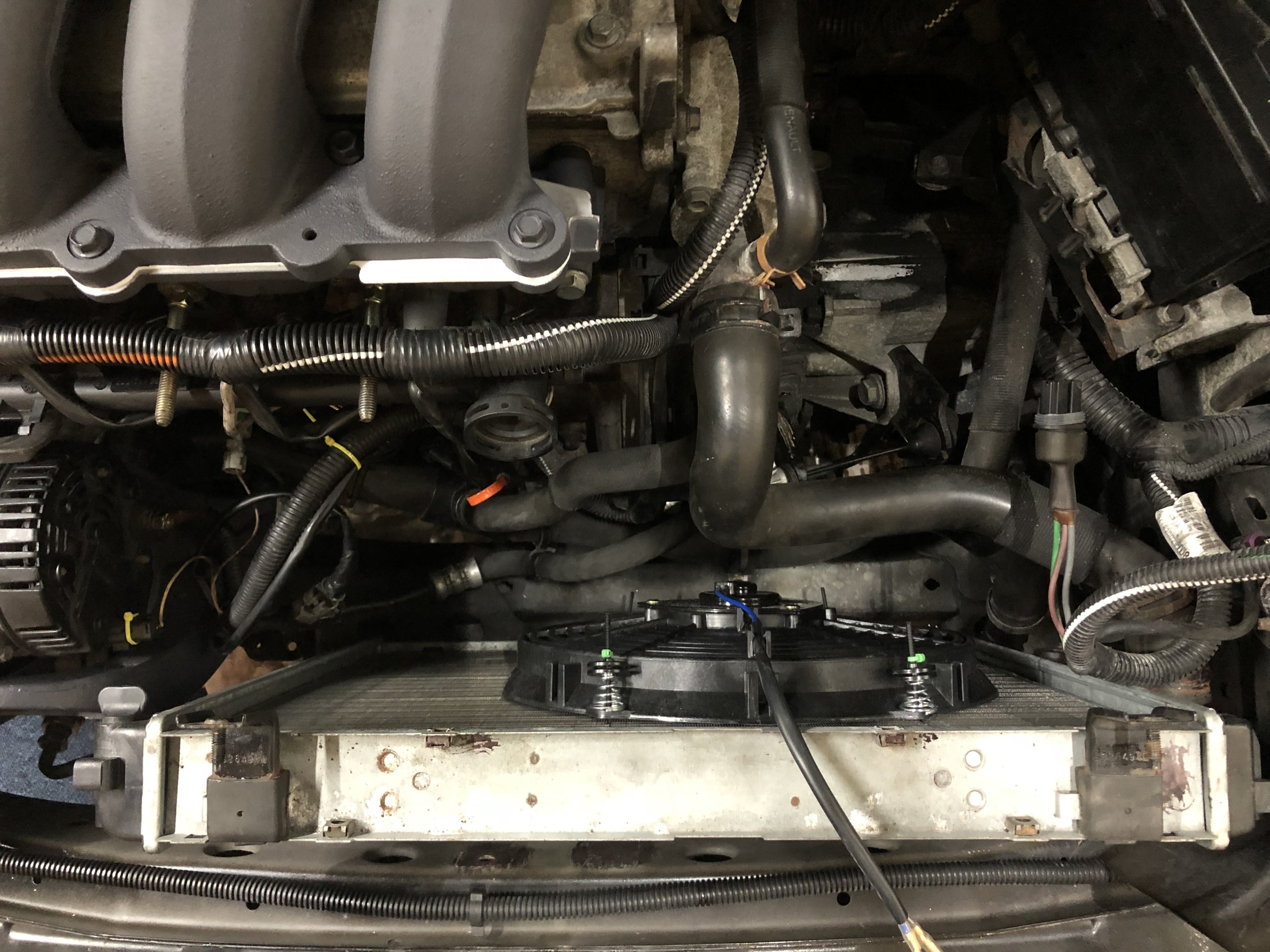

So it turns out my pipe work wasn’t as good as I thought and when I put the radiator back in it was all too tight. The lower pipe is fine, but the one with the ali pipe work is just awkward so I’ve ordered some new pipe work to remake that. Also now I’ve ordered a slimline fan. Hopefully this will make it all fit nicely.
You can see what it’s like with no fan, with the fan it’s just too tight.

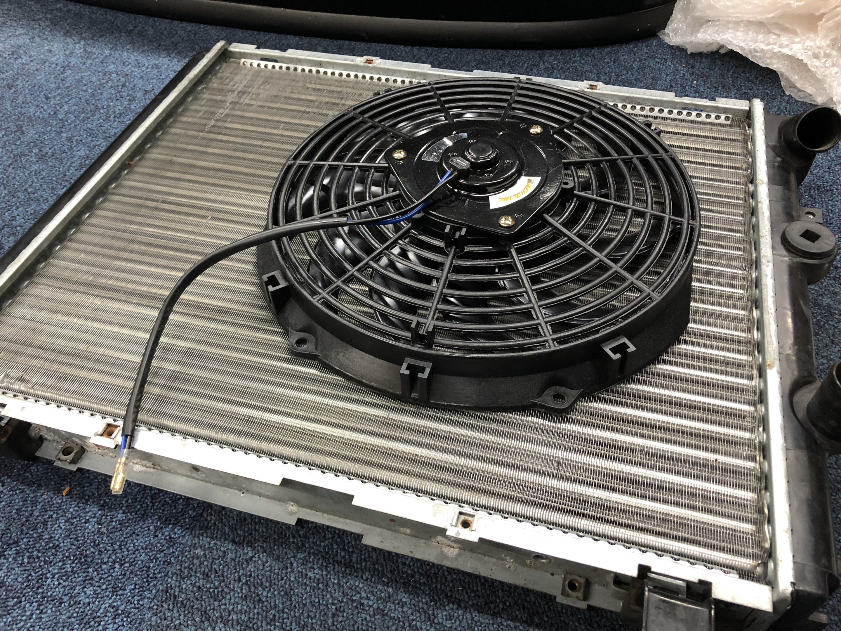

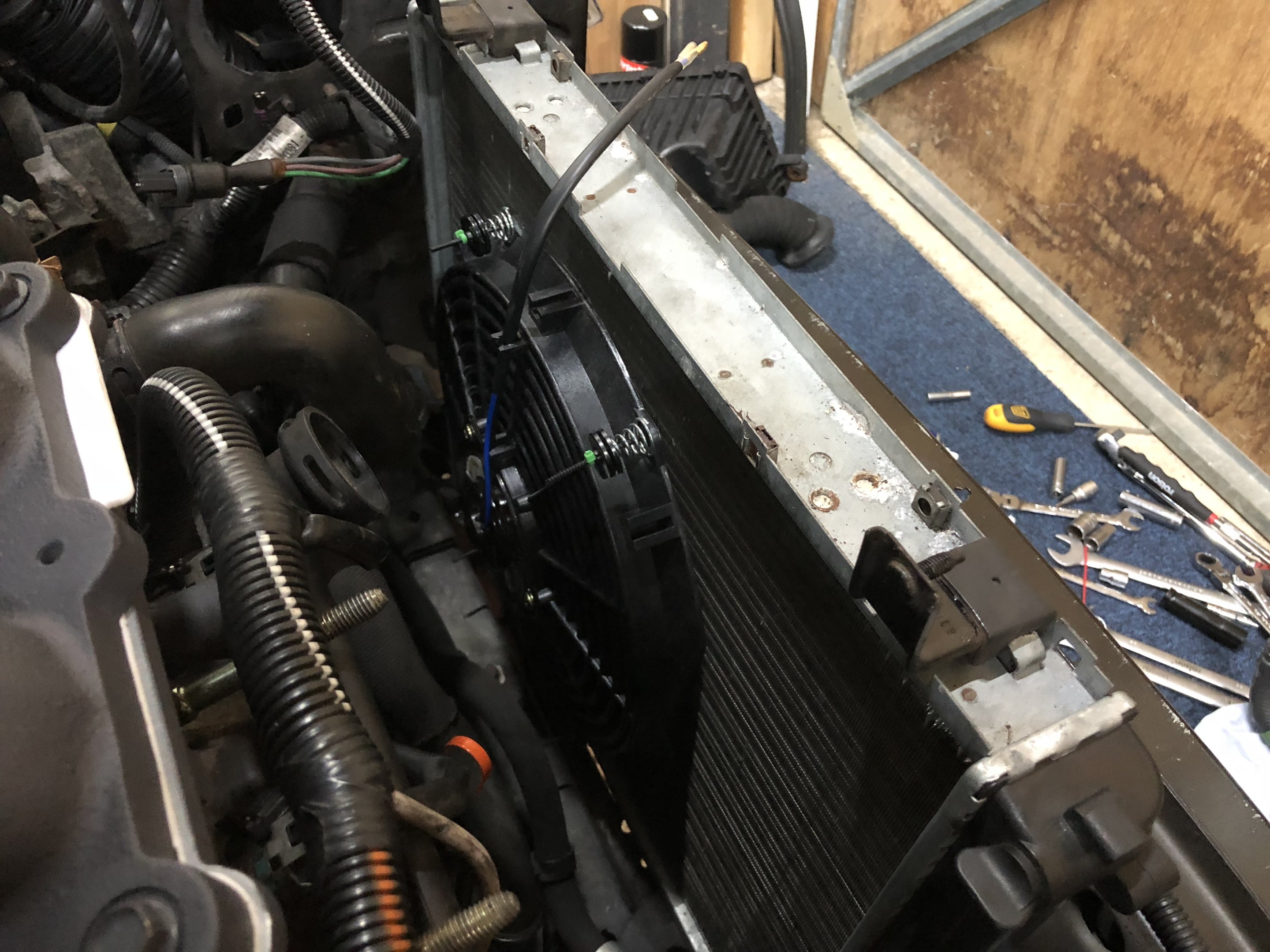

120w 12v fan. Hopefully this will do the job nicely.
Im going to have a few days off now... hopefully all the bits will be here for Monday.
  RS 172
Managed to get out and fit the new cooling fan. It’s pretty easy, although feels strange poking the brackets through the rad. Anyhow, much better and frees up so much room
Hopefully new pipe work will arrive tomorrow for power steering and then I’ll be able to put the rest back and get it running.
  RS 172
It’s running!
Managed to get loads done tonight, started off by finally getting the car running. This was important as it was stuck in the garage and I could only work on one side ?.
New pipe arrived and I’ve now got a new power steering return feed sorted. Also wired and tested the fan. Works a well, however I’m going to swap for two smaller fans.

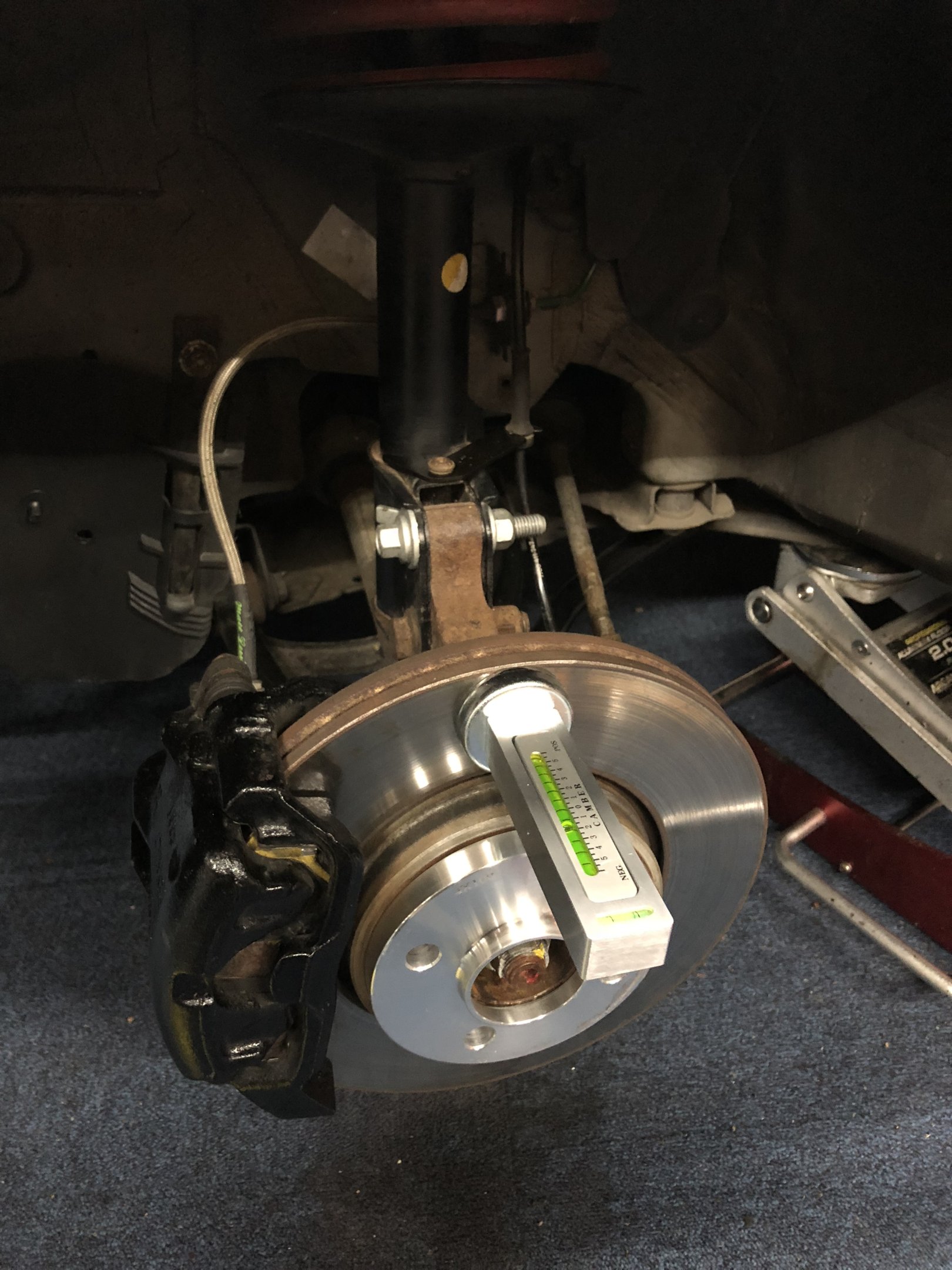

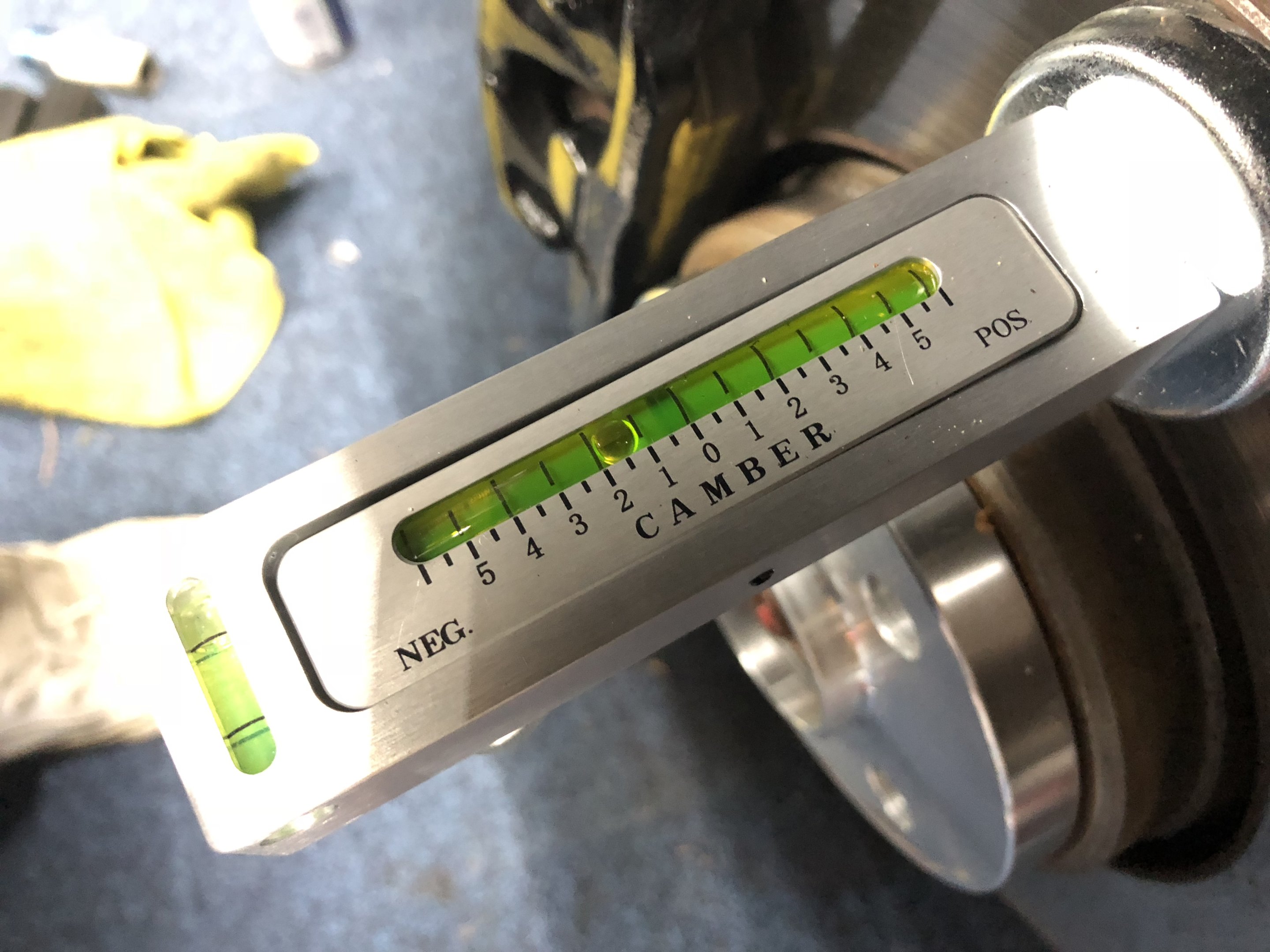

Camber Setup, I’ve never done this before so will be interesting to see the results.
Once that was done I’ve put most things back on. Will be using the car tomorrow for the first time in 6 months.

The suspension is at full droop too, surely the camber will read differently at actual ride height?
So you can set the camber to zero on the gauge from any position. I did this before adjusting the bolts. So what ever it was from standard, I added 1.5 degrees. Well, that’s what I think I did ??

I've tried these, they are ok as a guide, but no replacement for a laser alignment. Its also worth moving it to the hub face as the disc face doesnt always wear evenly.
True, but you can take it off stands and use a trolley jack to lift on the wishbone which would appy a similar load and set from there. But whenever Ive used them its not been to accurately set the camber, but just to ensure I was getting it even on both sides.
  PH2 172
A spirit level strategically placed on the centre of the roof is required to confirm that the car is level left to right, in order to have any valid readings.
Make adjustments to achieve this with an axle stand on one side, and a jack on the other.

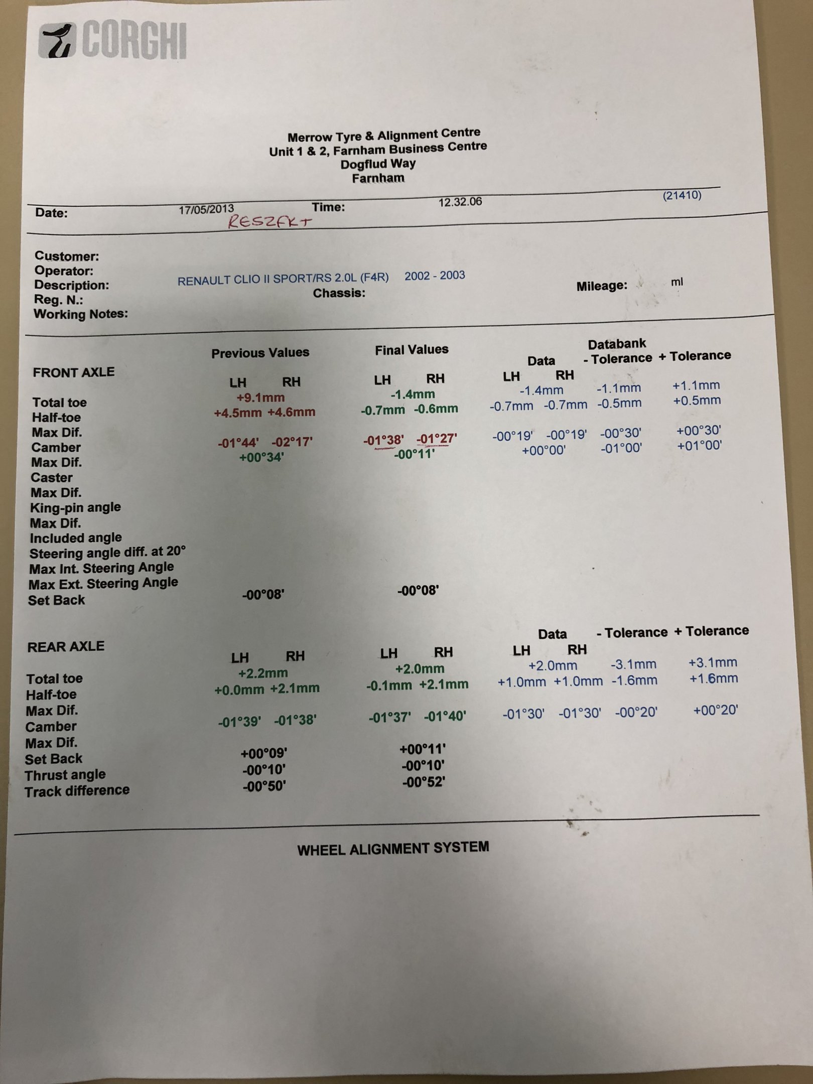

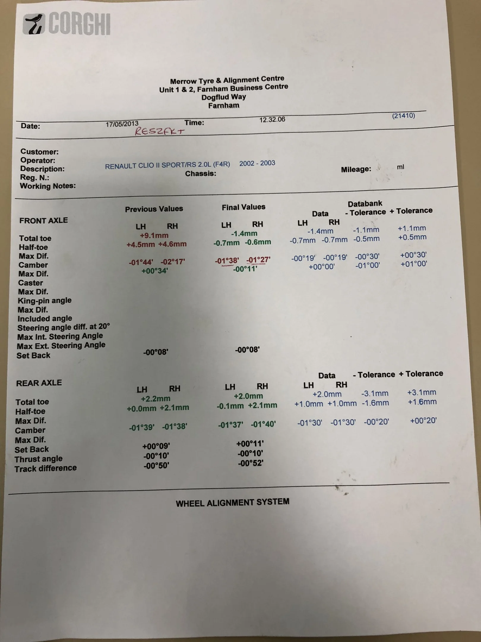

Full alignment done, the guy knew what he was doing, which was great. One guy I called said they didn’t have a ramp, so could only do tracking wtf.
My go at doing the camber wasn’t too bad. One side was worse than the other. The tracking wasn’t great either, although I didn’t touch this.
The toe is a little out on the rear, not sure how bad this is and if I should correct it?
