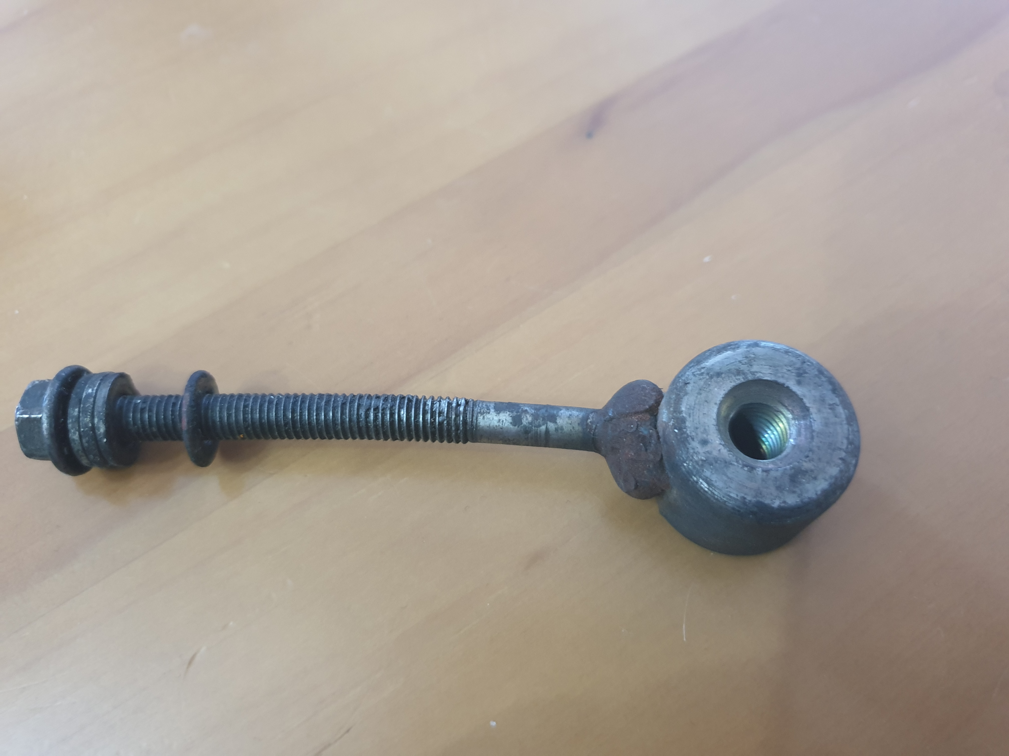

Any ideas where i can get the bits from to make one of these ? I dont fancy paying £38 for one !
Anybody sourced some threaded bar and the threaded spacer , eyelet . Not even sure what to call in 😂🙈🙈

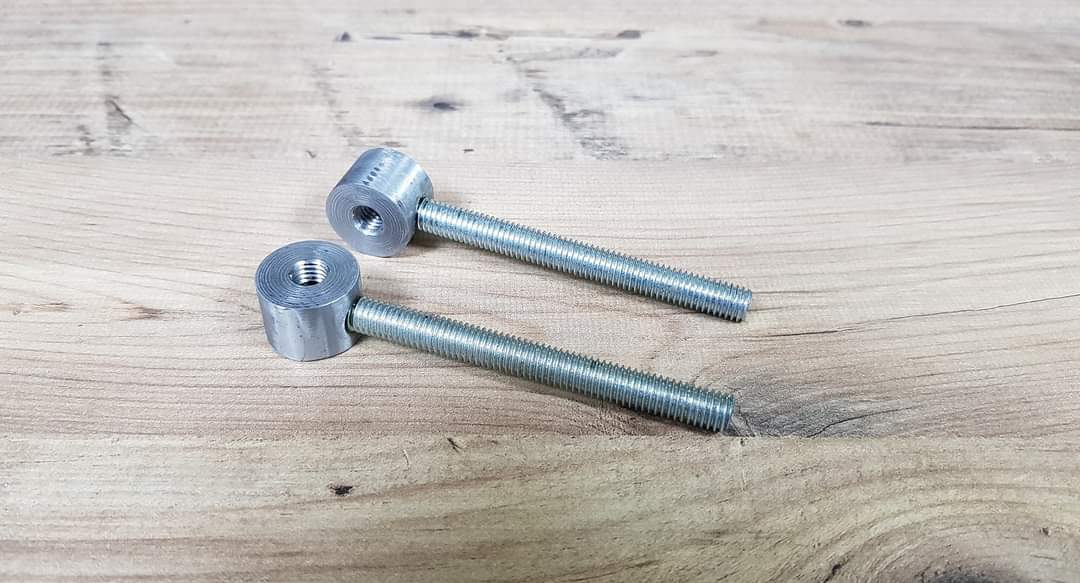

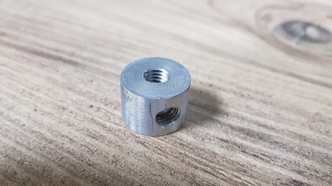

I was going to make another batch of these. These have been threaded inside the sleeve to accommodate a M8 stud over the normal M6. They have been loctighted in with high strength loctight as shown for extra security. All that's needs doing is the hole on the alternator bracket where the stud goes through needs filing out. Mine was about 1mm so it's very minimal and the bracket is aluminium so it's easy to do.
However I haven't made any yet. So if your in a rush, perhaps go with @plees Ones above.
