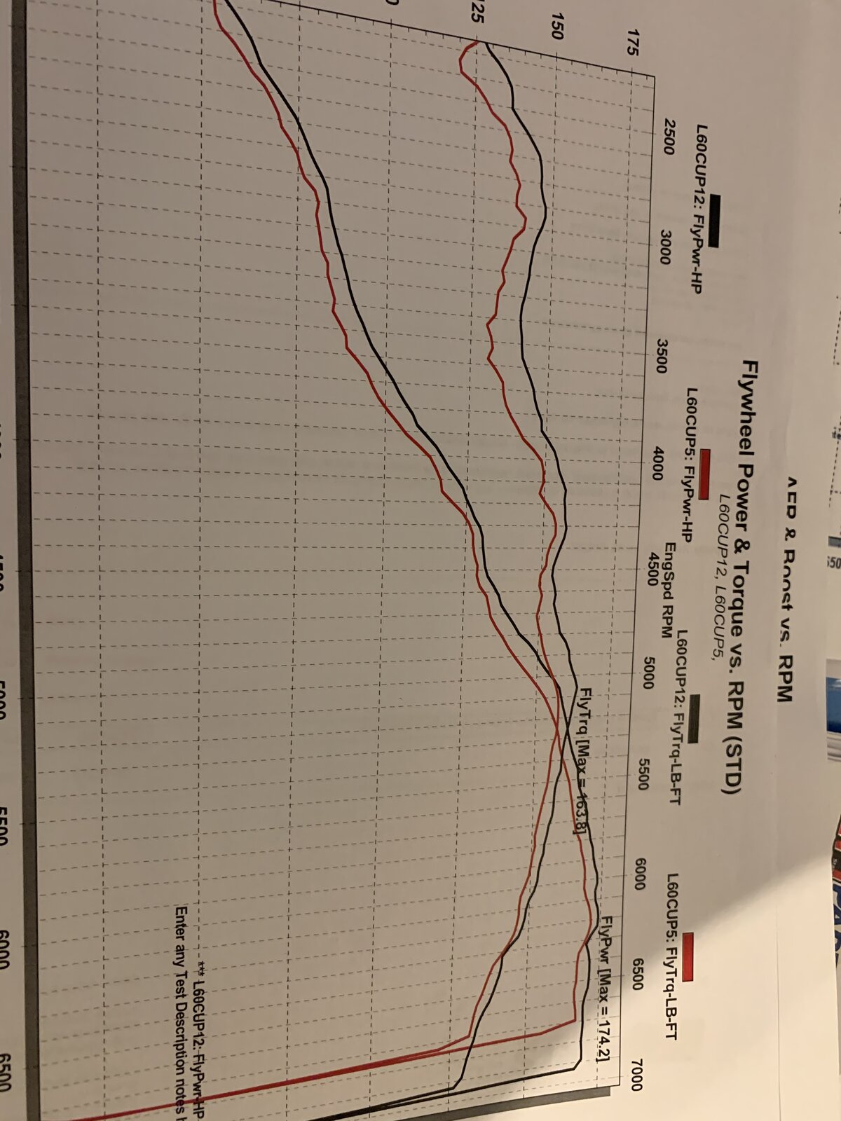

I know there has been a lot of discussion about remaps lately so thought I would share my final map that Chris done on my 172 Cup, happy with the results as power wise just basic mods

Strong before figure! Good engine there matey.

looks better the right way round ;)
nice torque figure considering power isn't anything special, what's it had done?

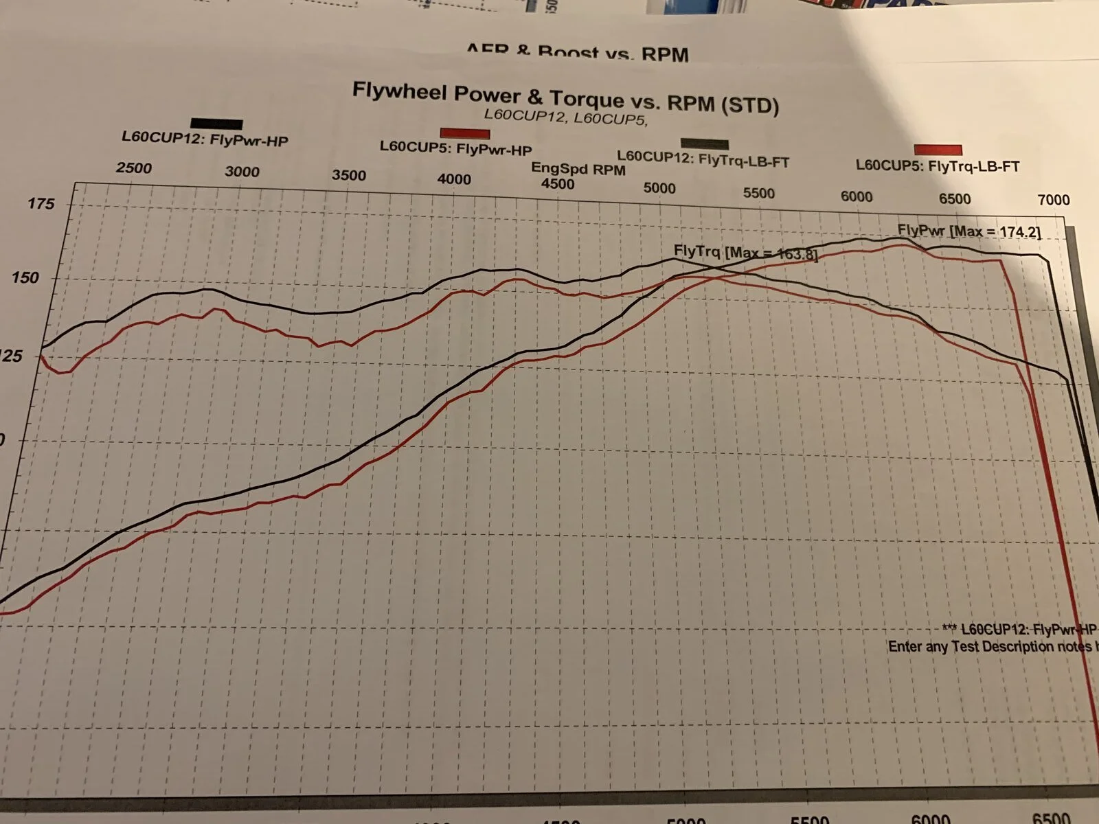

Yes mate I live in claregate so always around that area mrs works in bikbrook too , @ bloke that was the initial map it made 189 bhp on Monday which I was really pleased with it’s just ktec induction, ktec sports cat and stealth resonated exhaust that’s it power wise
171lb/ft is a good figure.
182 manifold would of been worth fitting, give a nice gain over the 4-1.
yeah, nice difference. feels more than it looks on the graph though.

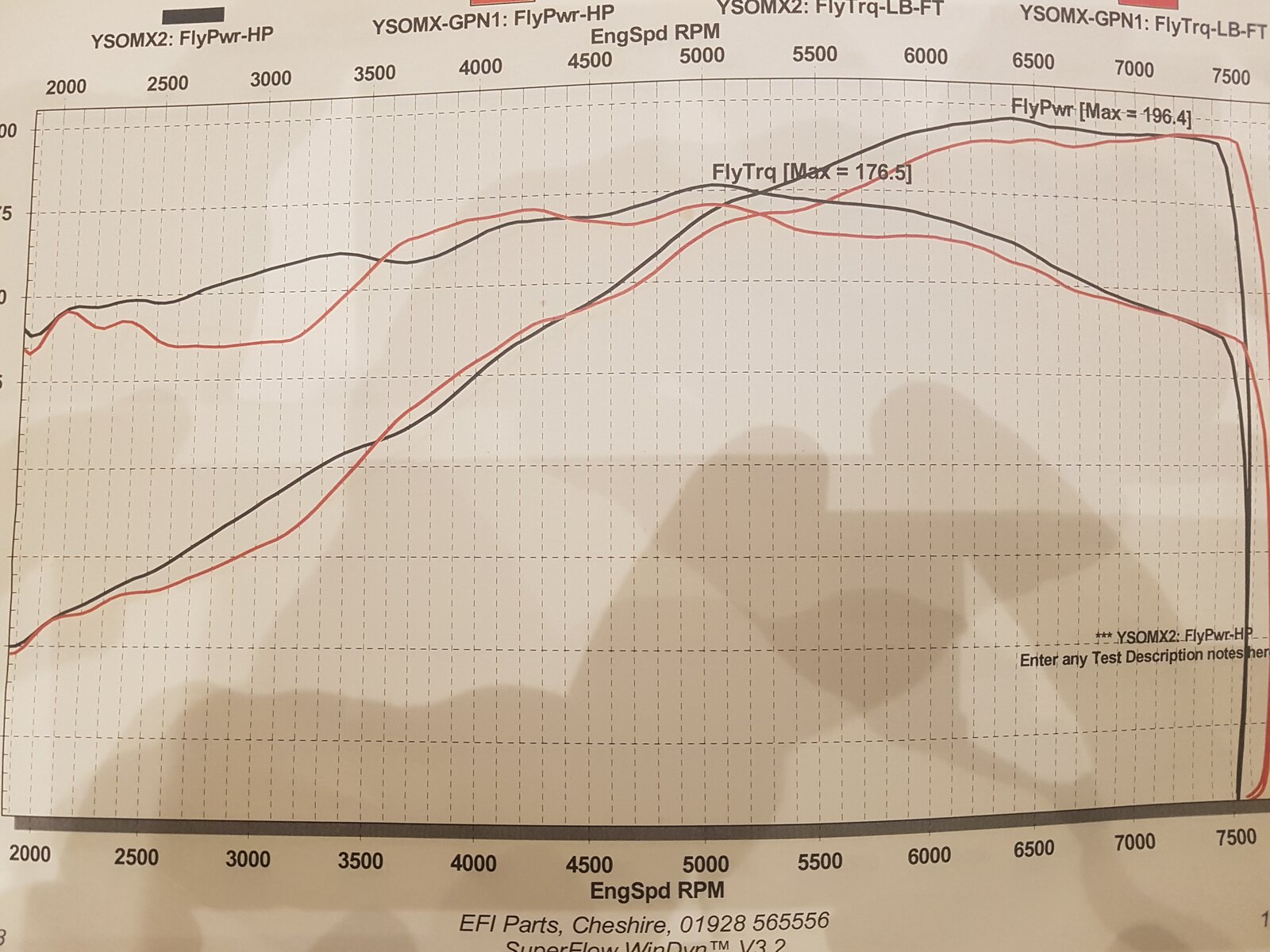

red was before and black after, only change was the manifold and bit of a play with the map. chris thought it would only need a 15 minute tweak but ended up on it over an hour.

always noticed it most low down but the graph makes that pretty much obvious. 100% worth doing though.
that was a job, group n timing, 182 manifold, can't remember what exhaust sorry, decat and open cone filter.

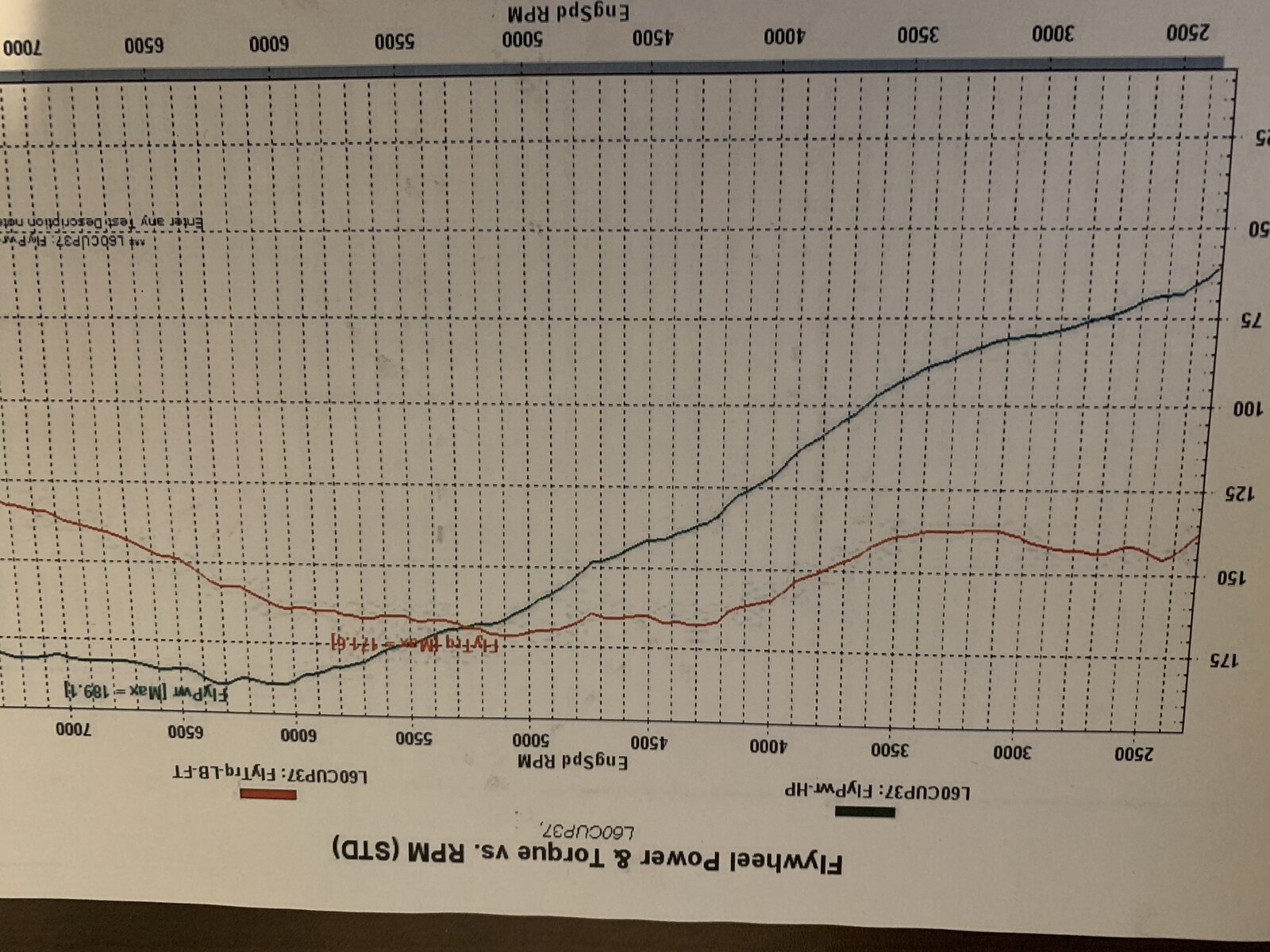

need to ignore the figures though as it made 191bhp before we did the timing and manifold. made that on standard map as well!!
